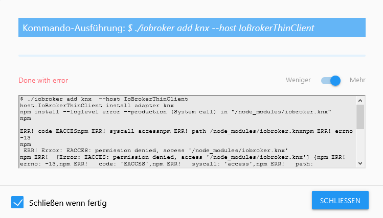

    Bei der Installation des KNX Adapters treten jedoch Probleme auf:
    1. Die aktuelle Version im IoBroker wird mit Ver. 10.0.39 angezeigt obwohl schon die 10.0.42 aktuell ist.
    2. Ein Auszug aus der Logdatei der Installation.
    $ ./iobroker add knx  --host IoBrokerThinClient
    host.IoBrokerThinClient install adapter knx
    npm install --loglevel error --production (System call) in "/node_modules/iobroker.knx"
    npm
    ERR!
     code EACCESnpm
     ERR! syscall accessnpm ERR! path /node_modules/iobroker.knxnpm ERR! errno -13
    npm
    ERR!
     Error: EACCES: permission denied, access '/node_modules/iobroker.knx'npm ERR!  [Error: EACCES: permission denied, access '/node_modules/iobroker.knx'] {npm
     ERR!   errno: -13,npm ERR!   code: 'EACCES',npm ERR!   syscall: 'access',npm ERR!   path: '/node_modules/iobroker.knx'npm ERR! }npm ERR! npm ERR! The operation was rejected by your operating system.npm ERR! It is likely you do not have the permissions to access this file as the current usernpm ERR! npm ERR! If you believe this might be a permissions issue, please double-check thenpm ERR! permissions of the file and its containing directories, or try runningnpm ERR! the command again as root/Administrator.
    npm
     ERR! A complete log of this run can be found in:npm
     ERR!     /home/iobroker/.npm/_logs/2020-11-02T17_33_16_319Z-debug.log
    Cannot install iobroker.knx: 243
    ERROR: process exited with code 25
    Dies wird angezeigt wenn ich per IoBroker Admin Oberfläche zu installieren.

                            • T tobiii1810
                              @Thomas-Braun
                              Beim Installationsversuch über die Konsole mit folgendem Befehl
                              sudo npm i iobroker.knx
                              kommt dies hier
                              iobroker@IoBrokerThinClient:~$ sudo npm i iobroker.knx                                      [sudo] Passwort für iobroker:
                              npm WARN saveError ENOENT: no such file or directory, open '/home/iobroker/packa            ge.json'
                              npm WARN enoent ENOENT: no such file or directory, open '/home/iobroker/package.            json'
                              npm WARN iobroker No description
                              npm WARN iobroker No repository field.
                              npm WARN iobroker No README data
                              npm WARN iobroker No license field.
                              + iobroker.knx@1.0.42
                              updated 1 package and audited 53 packages in 3.075s
                              3 packages are looking for funding
                                run `npm fund` for details
                              found 0 vulnerabilities
                              @tobiii1810
                              Mit npm machst du da nix. Insbesondere nicht in Verbindung mit sudo!
                              Zumal das im falschen Verzeichnis ausgeführt wurde.
                                @tobiii1810
                                iobroker add knx
                                Ausgabe posten.
                                tobiii1810
                                @Thomas-Braun
                                iobroker@IoBrokerThinClient:~$ iobroker add knx
                                npm ERR! code EACCES
                                npm ERR! syscall access
                                npm ERR! errno -13
                                npm ERR! Error: EACCES: permission denied, access '/node_modules/iobroker.knx'
                                npm ERR!   errno: -13,
                                npm ERR! }
                                npm ERR!
                                npm ERR!
                                npm ERR!     /home/iobroker/.npm/_logs/2020-11-02T19_48_30_277Z-debug.log
                                • T tobiii1810
                                  @Thomas-Braun
                                  npm ERR! errno -13
                                  npm ERR! }
                                  npm ERR!
                                  npm ERR!
                                  @tobiii1810
                                  Da stimmt der prefix offenbar nicht.
                                  cd /opt/iobroker
                                  iobroker add knx
