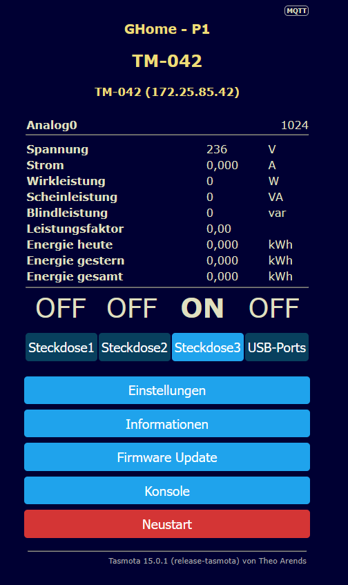

                              Mal ein vorschlag für die Webbuttons:
                              Webbuttons neu
                              backlog savedata 1; webbutton1 Steckdose1 ;webbutton2 Steckdose2 ;webbutton3 Steckdose3 ;webbutton4 USB-Ports ;savedata 0
                              Webbuttons default:
                              backlog savedata 1; webbutton1 "" ;webbutton2 "" ;webbutton3 "" ;webbutton4 "" ;savedata 0
                              Farbe ist "Navy": https://tasmota.github.io/docs/WebUI/#themes
                              WebColor {"WebColor":["#e0e0c0","#000033","#4f4f4f","#000000","#dddddd","#a7f432","#1e1e1e","#ff0000","#008000","#ffffff","#1fa3ec","#0e70a4","#d43535","#931f1f","#47c266","#5aaf6f","#ffffff","#999999","#eedd77"]}
