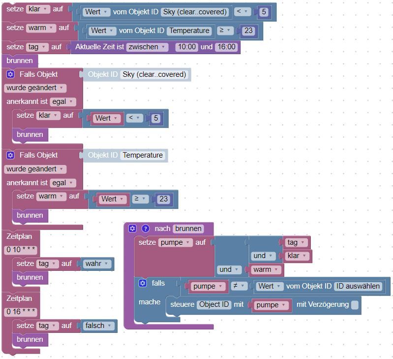

                  @ludino sagte:
                  wenn keine Wolken oder so am Himmel sind.
                  "weatherunderground.0.forecastHourly.0h.sky" zeigt den Bewölkungsgrad.
                   <variables>
                     <variable id=",M31ZIHriy(;VTv#AabD">klar</variable>
                     <variable id="z)bBrT_=Qa}nntTZyK]t">pumpe</variable>
                     <variable id="J6UJa*F5f#(..*aQUelj">warm</variable>
                     <variable id="iDUQK#=PvhD$XCt1$7TB">tag</variable>
                   </variables>
                   <block type="variables_set" id="GqifyOyD:O]k~eJ3y!5%" x="112" y="-63">
                     <field name="VAR" id=",M31ZIHriy(;VTv#AabD">klar</field>
                     <value name="VALUE">
                       <block type="logic_compare" id="hPYymt1#X.H=)4_OTyH*">
                         <field name="OP">LT</field>
                         <value name="A">
                           <block type="get_value" id="=L=H%QR)T9wg@pUGqjAF">
                             <field name="OID">weatherunderground.0.forecastHourly.0h.sky</field>
                           </block>
                         </value>
                         <value name="B">
                           <block type="math_number" id="!z0[S|Iz)wcUOy#+g%+5">
                             <field name="NUM">5</field>
                           </block>
                         </value>
                       </block>
                     </value>
                     <next>
                       <block type="variables_set" id="DMB@g$d?{X|WwJ5[(*iN">
                         <field name="VAR" id="J6UJa*F5f#(..*aQUelj">warm</field>
                           <block type="logic_compare" id="JNUNK5Ki=?}_h.rPZ*dC">
                             <field name="OP">GTE</field>
                             <value name="A">
                               <block type="get_value" id="Yqao*$4xuQ|$DR}`1s3K">
                                 <field name="OID">weatherunderground.0.forecastHourly.0h.temp</field>
                               </block>
                             </value>
                             <value name="B">
                               <block type="math_number" id=";pX+k0vIBdBg1aVvKY@R">
                                 <field name="NUM">23</field>
                               </block>
                             </value>
                           </block>
                         </value>
                         <next>
                           <block type="variables_set" id=",bUQt9cy]3[.!Ks)*tci">
                             <field name="VAR" id="iDUQK#=PvhD$XCt1$7TB">tag</field>
                               <block type="time_compare" id="_~_gcv8RFP)g|TT^)GfV">
                                 <mutation xmlns="http://www.w3.org/1999/xhtml" end_time="true"></mutation>
                                 <field name="OPTION">between</field>
                                 <field name="START_TIME">10:00</field>
                                 <field name="END_TIME">16:00</field>
                               </block>
                             </value>
                             <next>
                               <block type="procedures_callnoreturn" id="[,Z.57D?maKZn8;a034C">
                                 <mutation name="brunnen"></mutation>
                                 <next>
                                   <block type="on_ext" id="G,4a0%9h^oM]/]YjMy^?">
                                     <value name="OID0">
                                       <shadow type="field_oid" id="V-xsTXHio}fBZffuETLI">
                                         <field name="oid">weatherunderground.0.forecastHourly.0h.sky</field>
                                       </shadow>
                                     </value>
                                     <statement name="STATEMENT">
                                       <block type="variables_set" id="|A/S2w[w,ATG!oU,N,tX">
                                           <block type="logic_compare" id="Dq)AkU/7P?Bs6zXm~Vq[">
                                             <value name="A">
                                               <block type="on_source" id="lLtD~VhI0%nGZJ,f4}=t">
                                               </block>
                                             </value>
                                             <value name="B">
                                               <block type="math_number" id=":G!Psg~Oor5Zf11[@x,E">
                                               </block>
                                             </value>
                                           </block>
                                         </value>
                                         <next>
                                           <block type="procedures_callnoreturn" id="v1W.eS@:RWXTEq?TKVc3">
                                           </block>
                                         </next>
                                       </block>
                                     </statement>
                                     <next>
                                       <block type="on_ext" id="Luxc,f2koS4})TMAt+67">
                                         <value name="OID0">
                                           <shadow type="field_oid" id="85l=_1{:i}`gQ:qJL}.Z">
                                             <field name="oid">weatherunderground.0.forecastHourly.0h.temp</field>
                                           </shadow>
                                         </value>
                                           <block type="variables_set" id="jp=*S-M6~u5wu3Yf3NR}">
                                               <block type="logic_compare" id="R+tcC)P-#%*rd%1cJ;3t">
                                                 <value name="A">
                                                   <block type="on_source" id="]pRi71f/t61Yh9U=prsr">
                                                   </block>
                                                 </value>
                                                 <value name="B">
                                                   <block type="math_number" id="H}O23feXzQON`4eDw!De">
                                                   </block>
                                                 </value>
                                               </block>
                                             </value>
                                             <next>
                                               <block type="procedures_callnoreturn" id="xejO1ZRhE0q^mB@rC,2c">
                                               </block>
                                             </next>
                                           </block>
                                         </statement>
                                         <next>
                                           <block type="schedule" id="{_u3e:-{yb|2HNhtxw4z">
                                             <field name="SCHEDULE">0 10 * * *</field>
                                               <block type="variables_set" id="3{xDEMIYa6=p{k^4ore-">
                                                   <block type="logic_boolean" id="-k9eykRfZTx|V!iTWDTH">
                                                   </block>
                                                 </value>
                                                 <next>
                                                   <block type="procedures_callnoreturn" id="IMGyR6.}I),dR805JJbg">
                                                   </block>
                                                 </next>
                                               </block>
                                             </statement>
                                             <next>
                                               <block type="schedule" id="R5*C-VR*0|@eaDpd;{1z">
                                                 <field name="SCHEDULE">0 16 * * *</field>
                                                   <block type="variables_set" id="3h8ZSPW?Qwm57rr;YEEp">
                                                       <block type="logic_boolean" id="4_cKvoa2?c5@Wm/)o5p3">
                                                       </block>
                                                     </value>
                                                     <next>
                                                       <block type="procedures_callnoreturn" id="zBMW;!_@@$hxQ^xU[rq7">
                                                       </block>
                                                     </next>
                                                   </block>
                                                 </statement>
                                               </block>
                                             </next>
                                           </block>
                                         </next>
                                       </block>
                                     </next>
                                   </block>
                                 </next>
                               </block>
                             </next>
                           </block>
                         </next>
                       </block>
                     </next>
                   </block>
                   <block type="procedures_defnoreturn" id="vzGMQ,t2DcGWWUAdkFqw" x="362" y="387">
                     <field name="NAME">brunnen</field>
                     <statement name="STACK">
                       <block type="variables_set" id="zWk*}({DUc7Pd=qhz!II">
                         <field name="VAR" id="z)bBrT_=Qa}nntTZyK]t">pumpe</field>
                           <block type="logic_operation" id="G{W:SE]wzuk,)PBv00ll" inline="false">
                             <field name="OP">AND</field>
                             <value name="A">
                               <block type="logic_operation" id="qx]wOPscc{gEJuFBz$$B" inline="false">
                                 <value name="A">
                                   <block type="variables_get" id="_^G%eS:^u+o#W:xByTgP">
                                   </block>
                                 </value>
                                 <value name="B">
                                   <block type="variables_get" id="PdZSfAj6TZLOHZuE4g#V">
                                   </block>
                                 </value>
                               </block>
                             </value>
                             <value name="B">
                               <block type="variables_get" id="sM{|2T!!TpLvoJXEd(wE">
                               </block>
                             </value>
                           </block>
                         </value>
                         <next>
                           <block type="controls_if" id="0nrCy5=7SznT.aaV2W,O">
                             <value name="IF0">
                               <block type="logic_compare" id="Y^q#3@j)YK79`273n*=H">
                                 <field name="OP">NEQ</field>
                                 <value name="A">
                                   <block type="variables_get" id="0MZE@27S-tLv!D]2MmKe">
                                   </block>
                                 </value>
                                 <value name="B">
                                   <block type="get_value" id="jU,iT51B6xN%Aqd#|-7W">
                                     <field name="OID">ID auswählen</field>
                                   </block>
                                 </value>
                               </block>
                             </value>
                             <statement name="DO0">
                               <block type="control" id="o1,Sl?cF:wXh]0BDACtL">
                                   <block type="variables_get" id="![S{0H,(Fvlued*cZ9=^">
                                   </block>
                                 </value>
                               </block>
                             </statement>
                           </block>
                         </next>
                       </block>
                     </statement>
                   </block>
                  </xml>

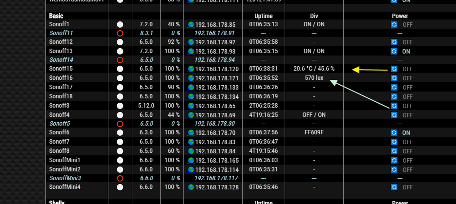

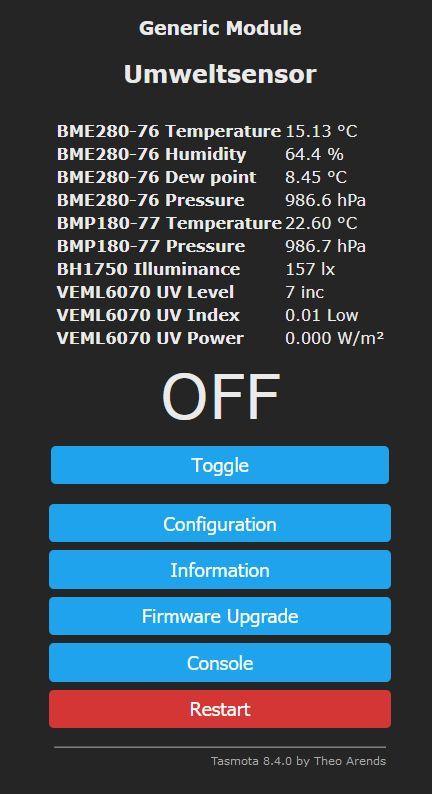

                    liv-in-skyL Offline
                    liv-in-skyL Offline
                    liv-in-sky
                    @ludino bei mir stimmen die wetterdaten eigentlich fast nie - liegt wohl an der gegend
                    habe daher einen sonoff (tasmota) mit lichtmesser am fenster verbaut und einen sonoff mit tempfühler (sonoff innen - tempfühler außerhalb)
                    damit kann man das alles sehr einfach steuern und hat die tatsächlichen werte

                      Meine Idee dazu wenn Sonne da und Temp über 23 Grad Brunnen an in der Zeit von bis...!
                      Als Hardware habe ich ein Aussentemp sensor, als eigentlich kein Problem die Temp abfrage, aber den Sonnen zustand abfrage bekomme ich nicht hin bzw keine Idee wie ich das Lösen könnte vielleicht gibt es ja ein Adapter.
                      Also bin für jede Idee/Vorschlag dankbar.
                      Ludino
                      Albert KA Offline
                      Albert KA Offline
                      Albert K
                      @ludino
                      "Das Wetter" Adapter bringt Wolkenindex nach Standort.
                      OpenUV bringt den Roh UV Wert.
                      Daraus dann den lokalen UV Wert berechnen (bei OpenUV erklârt)
                      Dann schalten bei lokalem UV Wert > 6

                        @ludino
                        Warum machst du dir keinen passenden Sensor dran. Ich würde da einen BH1750 nehmen und dann auf den gewünschten Helligkeitswert triggern. Werte kommen über den Sonoff Adapter in den iobroker.
                        Der VEML 6070 macht nur die reine UV Strahlung und zeigt auch teilweise bei leichter Bewölkung an. Beim BH1750 hast du direkt den Helligkeitswert. Dazu noch eine kleine Verzögerung falls gerade mal eine Wolke durchhuscht oder sich einer vor den Sensor stellt und fertig sollte es sein.
