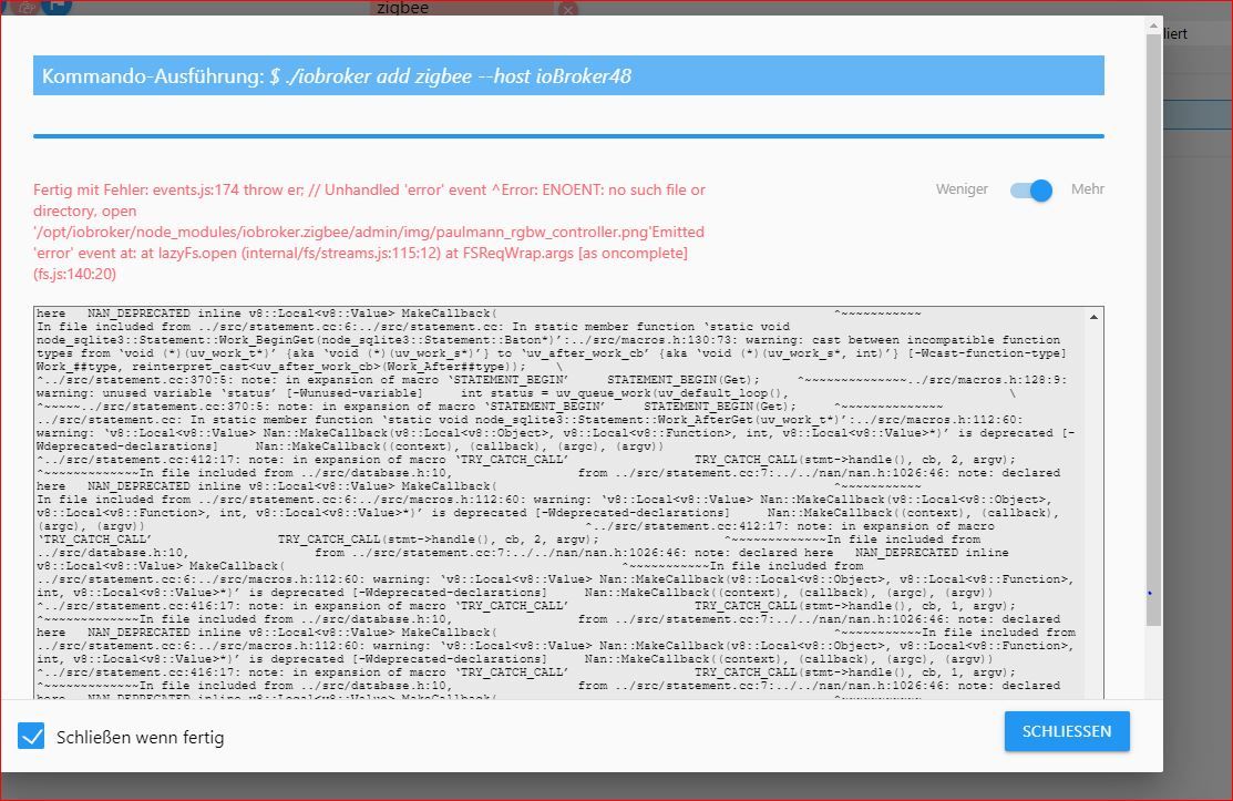

    ich wollte auf den ZigBee Adapter ganz normal aus den Adaptern im ioBroker installieren.
    Die Installation war nicht erfolgreich und wurde mit folgendem Fehler beendet:
    Kann mir jemand dabei helfen, was hat das zu sagen und wie bekomme ich den Adapter installiert.

      @TomsHome Meldungen bitte nicht als Screenshot sondern in Textform in den Thread kopieren, mit CodeTags versehen.

        $ ./iobroker add zigbee  --host ioBroker48
        NPM version: 6.14.4
        npm install iobroker.zigbee@1.1.1 --loglevel error --prefix "/opt/iobroker" (System call)
        Release/obj/gen/sqlite-autoconf-3310100/sqlite3.c: In function ‘strftimeFunc’:
        Release/obj/gen/sqlite-autoconf-3310100/sqlite3.c:14483:27: warning: cast between incompatible function types from ‘int (*)(void *)’ to ‘void (*)(void *)’ [-Wcast-function-type]                                                                                                   ^
        ^~~~~~~~~~~~~~~~~~~~~~~In file included from ../../nan/nan.h:284,                 from ../src/database.h:10,                 from ../src/node_sqlite3.cc:8:../../nan/nan_maybe_43_inl.h:117:35: note: declared here NAN_DEPRECATED inline Maybe<bool> ForceSet(                                   ^~~~~~~~In file included from ../src/node_sqlite3.cc:7:../src/macros.h:64:10: warning: ‘Nan::Maybe<bool> Nan::ForceSet(v8::Local<v8::Object>, v8::Local<v8::Value>, v8::Local<v8::Value>, v8::PropertyAttribute)’ is deprecated [-Wdeprecated-declarations]     Nan::ForceSet(target,                                                      \          ^~~~~~~~../src/node_sqlite3.cc:39:5: note: in expansion of macro ‘DEFINE_CONSTANT_INTEGER’     DEFINE_CONSTANT_INTEGER(target, SQLITE_PERM, PERM);     ^~~~~~~~~~~~~~~~~~~~~~~In file included from ../../nan/nan.h:284,                 from ../src/database.h:10,                 from ../src/node_sqlite3.cc:8:../../nan/nan_maybe_43_inl.h:117:35: note: declared here NAN_DEPRECATED inline Maybe<bool> ForceSet(                                   ^~~~~~~~
        In file included from ../src/node_sqlite3.cc:7:../src/macros.h:68:5: warning: ‘Nan::Maybe<bool> Nan::ForceSet(v8::Local<v8::Object>, v8::Local<v8::Value>, v8::Local<v8::Value>, v8::PropertyAttribute)’ is deprecated [-Wdeprecated-declarations]     );     ^../src/node_sqlite3.cc:39:5: note: in expansion of macro ‘DEFINE_CONSTANT_INTEGER’     DEFINE_CONSTANT_INTEGER(target, SQLITE_PERM, PERM);     ^~~~~~~~~~~~~~~~~~~~~~~In file included from ../../nan/nan.h:284,                 from ../src/database.h:10,                 from ../src/node_sqlite3.cc:8:../../nan/nan_maybe_43_inl.h:117:35: note: declared here NAN_DEPRECATED inline Maybe<bool> ForceSet(                                   ^~~~~~~~In file included from ../src/node_sqlite3.cc:7:../src/macros.h:68:5: warning: ‘Nan::Maybe<bool> Nan::ForceSet(v8::Local<v8::Object>, v8::Local<v8::Value>, v8::Local<v8::Value>, v8::PropertyAttribute)’ is deprecated [-Wdeprecated-declarations]     );     ^../src/node_sqlite3.cc:39:5: note: in expansion of macro ‘DEFINE_CONSTANT_INTEGER’     DEFINE_CONSTANT_INTEGER(target, SQLITE_PERM, PERM);     ^~~~~~~~~~~~~~~~~~~~~~~In file included from ../../nan/nan.h:284,                 from ../src/database.h:10,                 from ../src/node_sqlite3.cc:8:../../nan/nan_maybe_43_inl.h:117:35: note: declared here NAN_DEPRECATED inline Maybe<bool> ForceSet(                                   ^~~~~~~~In file included from ../src/node_sqlite3.cc:7:../src/macros.h:64:10: warning: ‘Nan::Maybe<bool> Nan::ForceSet(v8::Local<v8::Object>, v8::Local<v8::Value>, v8::Local<v8::Value>, v8::PropertyAttribute)’ is deprecated [-Wdeprecated-declarations]     Nan::ForceSet(target,                                                      \          ^~~~~~~~../src/node_sqlite3.cc:40:5: note: in expansion of macro ‘DEFINE_CONSTANT_INTEGER’     DEFINE_CONSTANT_INTEGER(target, SQLITE_ABORT, ABORT);     ^~~~~~~~~~~~~~~~~~~~~~~In file included from ../../nan/nan.h:284,                 from ../src/database.h:10,                 from ../src/node_sqlite3.cc:8:../../nan/nan_maybe_43_inl.h:117:35: note: declared here NAN_DEPRECATED inline Maybe<bool> ForceSet(                                   ^~~~~~~~In file included from ../src/node_sqlite3.cc:7:../src/macros.h:68:5: warning: ‘Nan::Maybe<bool> Nan::ForceSet(v8::Local<v8::Object>, v8::Local<v8::Value>, v8::Local<v8::Value>, v8::PropertyAttribute)’ is deprecated [-Wdeprecated-declarations]     );     ^../src/node_sqlite3.cc:40:5: note: in expansion of macro ‘DEFINE_CONSTANT_INTEGER’     DEFINE_CONSTANT_INTEGER(target, SQLITE_ABORT, ABORT);     ^~~~~~~~~~~~~~~~~~~~~~~In file included from ../../nan/nan.h:284,                 from ../src/database.h:10,                 from ../src/node_sqlite3.cc:8:../../nan/nan_maybe_43_inl.h:117:35: note: declared here NAN_DEPRECATED inline Maybe<bool> ForceSet(                                   ^~~~~~~~
        In file included from ../src/node_sqlite3.cc:7:../src/macros.h:68:5: warning: ‘Nan::Maybe<bool> Nan::ForceSet(v8::Local<v8::Object>, v8::Local<v8::Value>, v8::Local<v8::Value>, v8::PropertyAttribute)’ is deprecated [-Wdeprecated-declarations]     );     ^../src/node_sqlite3.cc:40:5: note: in expansion of macro ‘DEFINE_CONSTANT_INTEGER’     DEFINE_CONSTANT_INTEGER(target, SQLITE_ABORT, ABORT);     ^~~~~~~~~~~~~~~~~~~~~~~In file included from ../../nan/nan.h:284,                 from ../src/database.h:10,                 from ../src/node_sqlite3.cc:8:../../nan/nan_maybe_43_inl.h:117:35: note: declared here NAN_DEPRECATED inline Maybe<bool> ForceSet(                                   ^~~~~~~~In file included from ../src/node_sqlite3.cc:7:../src/macros.h:64:10: warning: ‘Nan::Maybe<bool> Nan::ForceSet(v8::Local<v8::Object>, v8::Local<v8::Value>, v8::Local<v8::Value>, v8::PropertyAttribute)’ is deprecated [-Wdeprecated-declarations]     Nan::ForceSet(target,                                                      \          ^~~~~~~~../src/node_sqlite3.cc:41:5: note: in expansion of macro ‘DEFINE_CONSTANT_INTEGER’     DEFINE_CONSTANT_INTEGER(target, SQLITE_BUSY, BUSY);     ^~~~~~~~~~~~~~~~~~~~~~~In file included from ../../nan/nan.h:284,                 from ../src/database.h:10,                 from ../src/node_sqlite3.cc:8:../../nan/nan_maybe_43_inl.h:117:35: note: declared here NAN_DEPRECATED inline Maybe<bool> ForceSet(                                   ^~~~~~~~
        In file included from ../src/node_sqlite3.cc:7:../src/macros.h:68:5: warning: ‘Nan::Maybe<bool> Nan::ForceSet(v8::Local<v8::Object>, v8::Local<v8::Value>, v8::Local<v8::Value>, v8::PropertyAttribute)’ is deprecated [-Wdeprecated-declarations]     );     ^../src/node_sqlite3.cc:41:5: note: in expansion of macro ‘DEFINE_CONSTANT_INTEGER’     DEFINE_CONSTANT_INTEGER(target, SQLITE_BUSY, BUSY);     ^~~~~~~~~~~~~~~~~~~~~~~In file included from ../../nan/nan.h:284,                 from ../src/database.h:10,                 from ../src/node_sqlite3.cc:8:../../nan/nan_maybe_43_inl.h:117:35: note: declared here NAN_DEPRECATED inline Maybe<bool> ForceSet(                                   ^~~~~~~~In file included from ../src/node_sqlite3.cc:7:../src/macros.h:68:5: warning: ‘Nan::Maybe<bool> Nan::ForceSet(v8::Local<v8::Object>, v8::Local<v8::Value>, v8::Local<v8::Value>, v8::PropertyAttribute)’ is deprecated [-Wdeprecated-declarations]     );     ^../src/node_sqlite3.cc:41:5: note: in expansion of macro ‘DEFINE_CONSTANT_INTEGER’     DEFINE_CONSTANT_INTEGER(target, SQLITE_BUSY, BUSY);     ^~~~~~~~~~~~~~~~~~~~~~~In file included from ../../nan/nan.h:284,                 from ../src/database.h:10,                 from ../src/node_sqlite3.cc:8:../../nan/nan_maybe_43_inl.h:117:35: note: declared here NAN_DEPRECATED inline Maybe<bool> ForceSet(                                   ^~~~~~~~In file included from ../src/node_sqlite3.cc:7:../src/macros.h:64:10: warning: ‘Nan::Maybe<bool> Nan::ForceSet(v8::Local<v8::Object>, v8::Local<v8::Value>, v8::Local<v8::Value>, v8::PropertyAttribute)’ is deprecated [-Wdeprecated-declarations]     Nan::ForceSet(target,                                                      \          ^~~~~~~~../src/node_sqlite3.cc:42:5: note: in expansion of macro ‘DEFINE_CONSTANT_INTEGER’     DEFINE_CONSTANT_INTEGER(target, SQLITE_LOCKED, LOCKED);     ^~~~~~~~~~~~~~~~~~~~~~~In file included from ../../nan/nan.h:284,                 from ../src/database.h:10,                 from ../src/node_sqlite3.cc:8:../../nan/nan_maybe_43_inl.h:117:35: note: declared here NAN_DEPRECATED inline Maybe<bool> ForceSet(                                   ^~~~~~~~In file included from ../src/node_sqlite3.cc:7:../src/macros.h:68:5: warning: ‘Nan::Maybe<bool> Nan::ForceSet(v8::Local<v8::Object>, v8::Local<v8::Value>, v8::Local<v8::Value>, v8::PropertyAttribute)’ is deprecated [-Wdeprecated-declarations]     );     ^../src/node_sqlite3.cc:42:5: note: in expansion of macro ‘DEFINE_CONSTANT_INTEGER’     DEFINE_CONSTANT_INTEGER(target, SQLITE_LOCKED, LOCKED);     ^~~~~~~~~~~~~~~~~~~~~~~In file included from ../../nan/nan.h:284,                 from ../src/database.h:10,                 from ../src/node_sqlite3.cc:8:../../nan/nan_maybe_43_inl.h:117:35: note: declared here NAN_DEPRECATED inline Maybe<bool> ForceSet(                                   ^~~~~~~~In file included from ../src/node_sqlite3.cc:7:../src/macros.h:68:5: warning: ‘Nan::Maybe<bool> Nan::ForceSet(v8::Local<v8::Object>, v8::Local<v8::Value>, v8::Local<v8::Value>, v8::PropertyAttribute)’ is deprecated [-Wdeprecated-declarations]     );     ^../src/node_sqlite3.cc:42:5: note: in expansion of macro ‘DEFINE_CONSTANT_INTEGER’     DEFINE_CONSTANT_INTEGER(target, SQLITE_LOCKED, LOCKED);     ^~~~~~~~~~~~~~~~~~~~~~~In file included from ../../nan/nan.h:284,                 from ../src/database.h:10,                 from ../src/node_sqlite3.cc:8:../../nan/nan_maybe_43_inl.h:117:35: note: declared here NAN_DEPRECATED inline Maybe<bool> ForceSet(                                   ^~~~~~~~In file included from ../src/node_sqlite3.cc:7:../src/macros.h:64:10: warning: ‘Nan::Maybe<bool> Nan::ForceSet(v8::Local<v8::Object>, v8::Local<v8::Value>, v8::Local<v8::Value>, v8::PropertyAttribute)’ is deprecated [-Wdeprecated-declarations]     Nan::ForceSet(target,                                                      \          ^~~~~~~~../src/node_sqlite3.cc:43:5: note: in expansion of macro ‘DEFINE_CONSTANT_INTEGER’     DEFINE_CONSTANT_INTEGER(target, SQLITE_NOMEM, NOMEM);     ^~~~~~~~~~~~~~~~~~~~~~~
        In file included from ../../nan/nan.h:284,                 from ../src/database.h:10,                 from ../src/node_sqlite3.cc:8:../../nan/nan_maybe_43_inl.h:117:35: note: declared here NAN_DEPRECATED inline Maybe<bool> ForceSet(                                   ^~~~~~~~In file included from ../src/node_sqlite3.cc:7:../src/macros.h:68:5: warning: ‘Nan::Maybe<bool> Nan::ForceSet(v8::Local<v8::Object>, v8::Local<v8::Value>, v8::Local<v8::Value>, v8::PropertyAttribute)’ is deprecated [-Wdeprecated-declarations]     );     ^../src/node_sqlite3.cc:43:5: note: in expansion of macro ‘DEFINE_CONSTANT_INTEGER’     DEFINE_CONSTANT_INTEGER(target, SQLITE_NOMEM, NOMEM);     ^~~~~~~~~~~~~~~~~~~~~~~In file included from ../../nan/nan.h:284,                 from ../src/database.h:10,                 from ../src/node_sqlite3.cc:8:../../nan/nan_maybe_43_inl.h:117:35: note: declared here NAN_DEPRECATED inline Maybe<bool> ForceSet(                                   ^~~~~~~~In file included from ../src/node_sqlite3.cc:7:../src/macros.h:68:5: warning: ‘Nan::Maybe<bool> Nan::ForceSet(v8::Local<v8::Object>, v8::Local<v8::Value>, v8::Local<v8::Value>, v8::PropertyAttribute)’ is deprecated [-Wdeprecated-declarations]     );     ^../src/node_sqlite3.cc:43:5: note: in expansion of macro ‘DEFINE_CONSTANT_INTEGER’     DEFINE_CONSTANT_INTEGER(target, SQLITE_NOMEM, NOMEM);     ^~~~~~~~~~~~~~~~~~~~~~~In file included from ../../nan/nan.h:284,                 from ../src/database.h:10,                 from ../src/node_sqlite3.cc:8:../../nan/nan_maybe_43_inl.h:117:35: note: declared here NAN_DEPRECATED inline Maybe<bool> ForceSet(                                   ^~~~~~~~In file included from ../src/node_sqlite3.cc:7:../src/macros.h:64:10: warning: ‘Nan::Maybe<bool> Nan::ForceSet(v8::Local<v8::Object>, v8::Local<v8::Value>, v8::Local<v8::Value>, v8::PropertyAttribute)’ is deprecated [-Wdeprecated-declarations]     Nan::ForceSet(target,                                                      \          ^~~~~~~~../src/node_sqlite3.cc:44:5: note: in expansion of macro ‘DEFINE_CONSTANT_INTEGER’     DEFINE_CONSTANT_INTEGER(target, SQLITE_READONLY, READONLY);     ^~~~~~~~~~~~~~~~~~~~~~~In file included from ../../nan/nan.h:284,                 from ../src/database.h:10,                 from ../src/node_sqlite3.cc:8:../../nan/nan_maybe_43_inl.h:117:35: note: declared here NAN_DEPRECATED inline Maybe<bool> ForceSet(                                   ^~~~~~~~
        In file included from ../src/node_sqlite3.cc:7:../src/macros.h:68:5: warning: ‘Nan::Maybe<bool> Nan::ForceSet(v8::Local<v8::Object>, v8::Local<v8::Value>, v8::Local<v8::Value>, v8::PropertyAttribute)’ is deprecated [-Wdeprecated-declarations]     );     ^../src/node_sqlite3.cc:44:5: note: in expansion of macro ‘DEFINE_CONSTANT_INTEGER’     DEFINE_CONSTANT_INTEGER(target, SQLITE_READONLY, READONLY);     ^~~~~~~~~~~~~~~~~~~~~~~In file included from ../../nan/nan.h:284,                 from ../src/database.h:10,                 from ../src/node_sqlite3.cc:8:../../nan/nan_maybe_43_inl.h:117:35: note: declared here NAN_DEPRECATED inline Maybe<bool> ForceSet(                                   ^~~~~~~~In file included from ../src/node_sqlite3.cc:7:../src/macros.h:68:5: warning: ‘Nan::Maybe<bool> Nan::ForceSet(v8::Local<v8::Object>, v8::Local<v8::Value>, v8::Local<v8::Value>, v8::PropertyAttribute)’ is deprecated [-Wdeprecated-declarations]     );     ^../src/node_sqlite3.cc:44:5: note: in expansion of macro ‘DEFINE_CONSTANT_INTEGER’     DEFINE_CONSTANT_INTEGER(target, SQLITE_READONLY, READONLY);     ^~~~~~~~~~~~~~~~~~~~~~~In file included from ../../nan/nan.h:284,                 from ../src/database.h:10,                 from ../src/node_sqlite3.cc:8:../../nan/nan_maybe_43_inl.h:117:35: note: declared here NAN_DEPRECATED inline Maybe<bool> ForceSet(                                   ^~~~~~~~In file included from ../src/node_sqlite3.cc:7:../src/macros.h:64:10: warning: ‘Nan::Maybe<bool> Nan::ForceSet(v8::Local<v8::Object>, v8::Local<v8::Value>, v8::Local<v8::Value>, v8::PropertyAttribute)’ is deprecated [-Wdeprecated-declarations]     Nan::ForceSet(target,                                                      \          ^~~~~~~~../src/node_sqlite3.cc:45:5: note: in expansion of macro ‘DEFINE_CONSTANT_INTEGER’     DEFINE_CONSTANT_INTEGER(target, SQLITE_INTERRUPT, INTERRUPT);     ^~~~~~~~~~~~~~~~~~~~~~~In file included from ../../nan/nan.h:284,                 from ../src/database.h:10,                 from ../src/node_sqlite3.cc:8:../../nan/nan_maybe_43_inl.h:117:35: note: declared here NAN_DEPRECATED inline Maybe<bool> ForceSet(                                   ^~~~~~~~
        In file included from ../src/node_sqlite3.cc:7:../src/macros.h:68:5: warning: ‘Nan::Maybe<bool> Nan::ForceSet(v8::Local<v8::Object>, v8::Local<v8::Value>, v8::Local<v8::Value>, v8::PropertyAttribute)’ is deprecated [-Wdeprecated-declarations]     );     ^../src/node_sqlite3.cc:45:5: note: in expansion of macro ‘DEFINE_CONSTANT_INTEGER’     DEFINE_CONSTANT_INTEGER(target, SQLITE_INTERRUPT, INTERRUPT);     ^~~~~~~~~~~~~~~~~~~~~~~In file included from ../../nan/nan.h:284,                 from ../src/database.h:10,                 from ../src/node_sqlite3.cc:8:../../nan/nan_maybe_43_inl.h:117:35: note: declared here NAN_DEPRECATED inline Maybe<bool> ForceSet(                                   ^~~~~~~~In file included from ../src/node_sqlite3.cc:7:../src/macros.h:68:5: warning: ‘Nan::Maybe<bool> Nan::ForceSet(v8::Local<v8::Object>, v8::Local<v8::Value>, v8::Local<v8::Value>, v8::PropertyAttribute)’ is deprecated [-Wdeprecated-declarations]     );     ^../src/node_sqlite3.cc:45:5: note: in expansion of macro ‘DEFINE_CONSTANT_INTEGER’     DEFINE_CONSTANT_INTEGER(target, SQLITE_INTERRUPT, INTERRUPT);     ^~~~~~~~~~~~~~~~~~~~~~~In file included from ../../nan/nan.h:284,                 from ../src/database.h:10,                 from ../src/node_sqlite3.cc:8:../../nan/nan_maybe_43_inl.h:117:35: note: declared here NAN_DEPRECATED inline Maybe<bool> ForceSet(                                   ^~~~~~~~In file included from ../src/node_sqlite3.cc:7:../src/macros.h:64:10: warning: ‘Nan::Maybe<bool> Nan::ForceSet(v8::Local<v8::Object>, v8::Local<v8::Value>, v8::Local<v8::Value>, v8::PropertyAttribute)’ is deprecated [-Wdeprecated-declarations]     Nan::ForceSet(target,                                                      \          ^~~~~~~~../src/node_sqlite3.cc:46:5: note: in expansion of macro ‘DEFINE_CONSTANT_INTEGER’     DEFINE_CONSTANT_INTEGER(target, SQLITE_IOERR, IOERR);     ^~~~~~~~~~~~~~~~~~~~~~~In file included from ../../nan/nan.h:284,                 from ../src/database.h:10,                 from ../src/node_sqlite3.cc:8:../../nan/nan_maybe_43_inl.h:117:35: note: declared here NAN_DEPRECATED inline Maybe<bool> ForceSet(                                   ^~~~~~~~In file included from ../src/node_sqlite3.cc:7:../src/macros.h:68:5: warning: ‘Nan::Maybe<bool> Nan::ForceSet(v8::Local<v8::Object>, v8::Local<v8::Value>, v8::Local<v8::Value>, v8::PropertyAttribute)’ is deprecated [-Wdeprecated-declarations]     );     ^../src/node_sqlite3.cc:46:5: note: in expansion of macro ‘DEFINE_CONSTANT_INTEGER’     DEFINE_CONSTANT_INTEGER(target, SQLITE_IOERR, IOERR);     ^~~~~~~~~~~~~~~~~~~~~~~In file included from ../../nan/nan.h:284,                 from ../src/database.h:10,                 from ../src/node_sqlite3.cc:8:../../nan/nan_maybe_43_inl.h:117:35: note: declared here NAN_DEPRECATED inline Maybe<bool> ForceSet(                                   ^~~~~~~~
        In file included from ../src/node_sqlite3.cc:7:../src/macros.h:68:5: warning: ‘Nan::Maybe<bool> Nan::ForceSet(v8::Local<v8::Object>, v8::Local<v8::Value>, v8::Local<v8::Value>, v8::PropertyAttribute)’ is deprecated [-Wdeprecated-declarations]     );     ^../src/node_sqlite3.cc:46:5: note: in expansion of macro ‘DEFINE_CONSTANT_INTEGER’     DEFINE_CONSTANT_INTEGER(target, SQLITE_IOERR, IOERR);     ^~~~~~~~~~~~~~~~~~~~~~~In file included from ../../nan/nan.h:284,                 from ../src/database.h:10,                 from ../src/node_sqlite3.cc:8:../../nan/nan_maybe_43_inl.h:117:35: note: declared here NAN_DEPRECATED inline Maybe<bool> ForceSet(                                   ^~~~~~~~In file included from ../src/node_sqlite3.cc:7:../src/macros.h:64:10: warning: ‘Nan::Maybe<bool> Nan::ForceSet(v8::Local<v8::Object>, v8::Local<v8::Value>, v8::Local<v8::Value>, v8::PropertyAttribute)’ is deprecated [-Wdeprecated-declarations]     Nan::ForceSet(target,                                                      \          ^~~~~~~~../src/node_sqlite3.cc:47:5: note: in expansion of macro ‘DEFINE_CONSTANT_INTEGER’     DEFINE_CONSTANT_INTEGER(target, SQLITE_CORRUPT, CORRUPT);     ^~~~~~~~~~~~~~~~~~~~~~~In file included from ../../nan/nan.h:284,                 from ../src/database.h:10,                 from ../src/node_sqlite3.cc:8:../../nan/nan_maybe_43_inl.h:117:35: note: declared here NAN_DEPRECATED inline Maybe<bool> ForceSet(                                   ^~~~~~~~In file included from ../src/node_sqlite3.cc:7:../src/macros.h:68:5: warning: ‘Nan::Maybe<bool> Nan::ForceSet(v8::Local<v8::Object>, v8::Local<v8::Value>, v8::Local<v8::Value>, v8::PropertyAttribute)’ is deprecated [-Wdeprecated-declarations]     );     ^../src/node_sqlite3.cc:47:5: note: in expansion of macro ‘DEFINE_CONSTANT_INTEGER’     DEFINE_CONSTANT_INTEGER(target, SQLITE_CORRUPT, CORRUPT);     ^~~~~~~~~~~~~~~~~~~~~~~In file included from ../../nan/nan.h:284,                 from ../src/database.h:10,                 from ../src/node_sqlite3.cc:8:../../nan/nan_maybe_43_inl.h:117:35: note: declared here NAN_DEPRECATED inline Maybe<bool> ForceSet(                                   ^~~~~~~~In file included from ../src/node_sqlite3.cc:7:../src/macros.h:68:5: warning: ‘Nan::Maybe<bool> Nan::ForceSet(v8::Local<v8::Object>, v8::Local<v8::Value>, v8::Local<v8::Value>, v8::PropertyAttribute)’ is deprecated [-Wdeprecated-declarations]     );     ^../src/node_sqlite3.cc:47:5: note: in expansion of macro ‘DEFINE_CONSTANT_INTEGER’     DEFINE_CONSTANT_INTEGER(target, SQLITE_CORRUPT, CORRUPT);     ^~~~~~~~~~~~~~~~~~~~~~~In file included from ../../nan/nan.h:284,                 from ../src/database.h:10,                 from ../src/node_sqlite3.cc:8:../../nan/nan_maybe_43_inl.h:117:35: note: declared here NAN_DEPRECATED inline Maybe<bool> ForceSet(                                   ^~~~~~~~In file included from ../src/node_sqlite3.cc:7:../src/macros.h:64:10: warning: ‘Nan::Maybe<bool> Nan::ForceSet(v8::Local<v8::Object>, v8::Local<v8::Value>, v8::Local<v8::Value>, v8::PropertyAttribute)’ is deprecated [-Wdeprecated-declarations]     Nan::ForceSet(target,                                                      \          ^~~~~~~~../src/node_sqlite3.cc:48:5: note: in expansion of macro ‘DEFINE_CONSTANT_INTEGER’     DEFINE_CONSTANT_INTEGER(target, SQLITE_NOTFOUND, NOTFOUND);     ^~~~~~~~~~~~~~~~~~~~~~~In file included from ../../nan/nan.h:284,                 from ../src/database.h:10,                 from ../src/node_sqlite3.cc:8:../../nan/nan_maybe_43_inl.h:117:35: note: declared here NAN_DEPRECATED inline Maybe<bool> ForceSet(                                   ^~~~~~~~
        In file included from ../src/node_sqlite3.cc:7:../src/macros.h:68:5: warning: ‘Nan::Maybe<bool> Nan::ForceSet(v8::Local<v8::Object>, v8::Local<v8::Value>, v8::Local<v8::Value>, v8::PropertyAttribute)’ is deprecated [-Wdeprecated-declarations]     );     ^../src/node_sqlite3.cc:48:5: note: in expansion of macro ‘DEFINE_CONSTANT_INTEGER’     DEFINE_CONSTANT_INTEGER(target, SQLITE_NOTFOUND, NOTFOUND);     ^~~~~~~~~~~~~~~~~~~~~~~In file included from ../../nan/nan.h:284,                 from ../src/database.h:10,                 from ../src/node_sqlite3.cc:8:../../nan/nan_maybe_43_inl.h:117:35: note: declared here NAN_DEPRECATED inline Maybe<bool> ForceSet(                                   ^~~~~~~~In file included from ../src/node_sqlite3.cc:7:../src/macros.h:68:5: warning: ‘Nan::Maybe<bool> Nan::ForceSet(v8::Local<v8::Object>, v8::Local<v8::Value>, v8::Local<v8::Value>, v8::PropertyAttribute)’ is deprecated [-Wdeprecated-declarations]     );     ^../src/node_sqlite3.cc:48:5: note: in expansion of macro ‘DEFINE_CONSTANT_INTEGER’     DEFINE_CONSTANT_INTEGER(target, SQLITE_NOTFOUND, NOTFOUND);     ^~~~~~~~~~~~~~~~~~~~~~~In file included from ../../nan/nan.h:284,                 from ../src/database.h:10,                 from ../src/node_sqlite3.cc:8:../../nan/nan_maybe_43_inl.h:117:35: note: declared here NAN_DEPRECATED inline Maybe<bool> ForceSet(                                   ^~~~~~~~In file included from ../src/node_sqlite3.cc:7:../src/macros.h:64:10: warning: ‘Nan::Maybe<bool> Nan::ForceSet(v8::Local<v8::Object>, v8::Local<v8::Value>, v8::Local<v8::Value>, v8::PropertyAttribute)’ is deprecated [-Wdeprecated-declarations]     Nan::ForceSet(target,                                                      \          ^~~~~~~~../src/node_sqlite3.cc:49:5: note: in expansion of macro ‘DEFINE_CONSTANT_INTEGER’     DEFINE_CONSTANT_INTEGER(target, SQLITE_FULL, FULL);     ^~~~~~~~~~~~~~~~~~~~~~~In file included from ../../nan/nan.h:284,                 from ../src/database.h:10,                 from ../src/node_sqlite3.cc:8:../../nan/nan_maybe_43_inl.h:117:35: note: declared here NAN_DEPRECATED inline Maybe<bool> ForceSet(                                   ^~~~~~~~
        In file included from ../src/node_sqlite3.cc:7:../src/macros.h:68:5: warning: ‘Nan::Maybe<bool> Nan::ForceSet(v8::Local<v8::Object>, v8::Local<v8::Value>, v8::Local<v8::Value>, v8::PropertyAttribute)’ is deprecated [-Wdeprecated-declarations]     );     ^../src/node_sqlite3.cc:49:5: note: in expansion of macro ‘DEFINE_CONSTANT_INTEGER’     DEFINE_CONSTANT_INTEGER(target, SQLITE_FULL, FULL);     ^~~~~~~~~~~~~~~~~~~~~~~In file included from ../../nan/nan.h:284,                 from ../src/database.h:10,                 from ../src/node_sqlite3.cc:8:../../nan/nan_maybe_43_inl.h:117:35: note: declared here NAN_DEPRECATED inline Maybe<bool> ForceSet(                                   ^~~~~~~~In file included from ../src/node_sqlite3.cc:7:../src/macros.h:68:5: warning: ‘Nan::Maybe<bool> Nan::ForceSet(v8::Local<v8::Object>, v8::Local<v8::Value>, v8::Local<v8::Value>, v8::PropertyAttribute)’ is deprecated [-Wdeprecated-declarations]     );     ^../src/node_sqlite3.cc:49:5: note: in expansion of macro ‘DEFINE_CONSTANT_INTEGER’     DEFINE_CONSTANT_INTEGER(target, SQLITE_FULL, FULL);     ^~~~~~~~~~~~~~~~~~~~~~~In file included from ../../nan/nan.h:284,                 from ../src/database.h:10,                 from ../src/node_sqlite3.cc:8:../../nan/nan_maybe_43_inl.h:117:35: note: declared here NAN_DEPRECATED inline Maybe<bool> ForceSet(                                   ^~~~~~~~In file included from ../src/node_sqlite3.cc:7:../src/macros.h:64:10: warning: ‘Nan::Maybe<bool> Nan::ForceSet(v8::Local<v8::Object>, v8::Local<v8::Value>, v8::Local<v8::Value>, v8::PropertyAttribute)’ is deprecated [-Wdeprecated-declarations]     Nan::ForceSet(target,                                                      \          ^~~~~~~~../src/node_sqlite3.cc:50:5: note: in expansion of macro ‘DEFINE_CONSTANT_INTEGER’     DEFINE_CONSTANT_INTEGER(target, SQLITE_CANTOPEN, CANTOPEN);     ^~~~~~~~~~~~~~~~~~~~~~~In file included from ../../nan/nan.h:284,                 from ../src/database.h:10,                 from ../src/node_sqlite3.cc:8:../../nan/nan_maybe_43_inl.h:117:35: note: declared here NAN_DEPRECATED inline Maybe<bool> ForceSet(                                   ^~~~~~~~
        In file included from ../src/node_sqlite3.cc:7:../src/macros.h:68:5: warning: ‘Nan::Maybe<bool> Nan::ForceSet(v8::Local<v8::Object>, v8::Local<v8::Value>, v8::Local<v8::Value>, v8::PropertyAttribute)’ is deprecated [-Wdeprecated-declarations]     );     ^../src/node_sqlite3.cc:50:5: note: in expansion of macro ‘DEFINE_CONSTANT_INTEGER’     DEFINE_CONSTANT_INTEGER(target, SQLITE_CANTOPEN, CANTOPEN);     ^~~~~~~~~~~~~~~~~~~~~~~In file included from ../../nan/nan.h:284,                 from ../src/database.h:10,                 from ../src/node_sqlite3.cc:8:../../nan/nan_maybe_43_inl.h:117:35: note: declared here NAN_DEPRECATED inline Maybe<bool> ForceSet(                                   ^~~~~~~~In file included from ../src/node_sqlite3.cc:7:../src/macros.h:68:5: warning: ‘Nan::Maybe<bool> Nan::ForceSet(v8::Local<v8::Object>, v8::Local<v8::Value>, v8::Local<v8::Value>, v8::PropertyAttribute)’ is deprecated [-Wdeprecated-declarations]     );     ^../src/node_sqlite3.cc:50:5: note: in expansion of macro ‘DEFINE_CONSTANT_INTEGER’     DEFINE_CONSTANT_INTEGER(target, SQLITE_CANTOPEN, CANTOPEN);     ^~~~~~~~~~~~~~~~~~~~~~~In file included from ../../nan/nan.h:284,                 from ../src/database.h:10,                 from ../src/node_sqlite3.cc:8:../../nan/nan_maybe_43_inl.h:117:35: note: declared here NAN_DEPRECATED inline Maybe<bool> ForceSet(                                   ^~~~~~~~In file included from ../src/node_sqlite3.cc:7:../src/macros.h:64:10: warning: ‘Nan::Maybe<bool> Nan::ForceSet(v8::Local<v8::Object>, v8::Local<v8::Value>, v8::Local<v8::Value>, v8::PropertyAttribute)’ is deprecated [-Wdeprecated-declarations]     Nan::ForceSet(target,                                                      \          ^~~~~~~~../src/node_sqlite3.cc:51:5: note: in expansion of macro ‘DEFINE_CONSTANT_INTEGER’     DEFINE_CONSTANT_INTEGER(target, SQLITE_PROTOCOL, PROTOCOL);     ^~~~~~~~~~~~~~~~~~~~~~~In file included from ../../nan/nan.h:284,                 from ../src/database.h:10,                 from ../src/node_sqlite3.cc:8:../../nan/nan_maybe_43_inl.h:117:35: note: declared here NAN_DEPRECATED inline Maybe<bool> ForceSet(                                   ^~~~~~~~
        In file included from ../src/node_sqlite3.cc:7:../src/macros.h:68:5: warning: ‘Nan::Maybe<bool> Nan::ForceSet(v8::Local<v8::Object>, v8::Local<v8::Value>, v8::Local<v8::Value>, v8::PropertyAttribute)’ is deprecated [-Wdeprecated-declarations]     );     ^../src/node_sqlite3.cc:51:5: note: in expansion of macro ‘DEFINE_CONSTANT_INTEGER’     DEFINE_CONSTANT_INTEGER(target, SQLITE_PROTOCOL, PROTOCOL);     ^~~~~~~~~~~~~~~~~~~~~~~In file included from ../../nan/nan.h:284,                 from ../src/database.h:10,                 from ../src/node_sqlite3.cc:8:../../nan/nan_maybe_43_inl.h:117:35: note: declared here NAN_DEPRECATED inline Maybe<bool> ForceSet(                                   ^~~~~~~~In file included from ../src/node_sqlite3.cc:7:../src/macros.h:68:5: warning: ‘Nan::Maybe<bool> Nan::ForceSet(v8::Local<v8::Object>, v8::Local<v8::Value>, v8::Local<v8::Value>, v8::PropertyAttribute)’ is deprecated [-Wdeprecated-declarations]     );     ^../src/node_sqlite3.cc:51:5: note: in expansion of macro ‘DEFINE_CONSTANT_INTEGER’     DEFINE_CONSTANT_INTEGER(target, SQLITE_PROTOCOL, PROTOCOL);     ^~~~~~~~~~~~~~~~~~~~~~~In file included from ../../nan/nan.h:284,                 from ../src/database.h:10,                 from ../src/node_sqlite3.cc:8:../../nan/nan_maybe_43_inl.h:117:35: note: declared here NAN_DEPRECATED inline Maybe<bool> ForceSet(                                   ^~~~~~~~In file included from ../src/node_sqlite3.cc:7:../src/macros.h:64:10: warning: ‘Nan::Maybe<bool> Nan::ForceSet(v8::Local<v8::Object>, v8::Local<v8::Value>, v8::Local<v8::Value>, v8::PropertyAttribute)’ is deprecated [-Wdeprecated-declarations]     Nan::ForceSet(target,                                                      \          ^~~~~~~~../src/node_sqlite3.cc:52:5: note: in expansion of macro ‘DEFINE_CONSTANT_INTEGER’     DEFINE_CONSTANT_INTEGER(target, SQLITE_EMPTY, EMPTY);     ^~~~~~~~~~~~~~~~~~~~~~~In file included from ../../nan/nan.h:284,                 from ../src/database.h:10,                 from ../src/node_sqlite3.cc:8:../../nan/nan_maybe_43_inl.h:117:35: note: declared here NAN_DEPRECATED inline Maybe<bool> ForceSet(                                   ^~~~~~~~
        In file included from ../src/node_sqlite3.cc:7:../src/macros.h:68:5: warning: ‘Nan::Maybe<bool> Nan::ForceSet(v8::Local<v8::Object>, v8::Local<v8::Value>, v8::Local<v8::Value>, v8::PropertyAttribute)’ is deprecated [-Wdeprecated-declarations]     );     ^../src/node_sqlite3.cc:52:5: note: in expansion of macro ‘DEFINE_CONSTANT_INTEGER’     DEFINE_CONSTANT_INTEGER(target, SQLITE_EMPTY, EMPTY);     ^~~~~~~~~~~~~~~~~~~~~~~In file included from ../../nan/nan.h:284,                 from ../src/database.h:10,                 from ../src/node_sqlite3.cc:8:../../nan/nan_maybe_43_inl.h:117:35: note: declared here NAN_DEPRECATED inline Maybe<bool> ForceSet(                                   ^~~~~~~~In file included from ../src/node_sqlite3.cc:7:../src/macros.h:68:5: warning: ‘Nan::Maybe<bool> Nan::ForceSet(v8::Local<v8::Object>, v8::Local<v8::Value>, v8::Local<v8::Value>, v8::PropertyAttribute)’ is deprecated [-Wdeprecated-declarations]     );     ^../src/node_sqlite3.cc:52:5: note: in expansion of macro ‘DEFINE_CONSTANT_INTEGER’     DEFINE_CONSTANT_INTEGER(target, SQLITE_EMPTY, EMPTY);     ^~~~~~~~~~~~~~~~~~~~~~~In file included from ../../nan/nan.h:284,                 from ../src/database.h:10,                 from ../src/node_sqlite3.cc:8:../../nan/nan_maybe_43_inl.h:117:35: note: declared here NAN_DEPRECATED inline Maybe<bool> ForceSet(                                   ^~~~~~~~In file included from ../src/node_sqlite3.cc:7:../src/macros.h:64:10: warning: ‘Nan::Maybe<bool> Nan::ForceSet(v8::Local<v8::Object>, v8::Local<v8::Value>, v8::Local<v8::Value>, v8::PropertyAttribute)’ is deprecated [-Wdeprecated-declarations]     Nan::ForceSet(target,                                                      \          ^~~~~~~~../src/node_sqlite3.cc:53:5: note: in expansion of macro ‘DEFINE_CONSTANT_INTEGER’     DEFINE_CONSTANT_INTEGER(target, SQLITE_SCHEMA, SCHEMA);     ^~~~~~~~~~~~~~~~~~~~~~~In file included from ../../nan/nan.h:284,                 from ../src/database.h:10,                 from ../src/node_sqlite3.cc:8:../../nan/nan_maybe_43_inl.h:117:35: note: declared here NAN_DEPRECATED inline Maybe<bool> ForceSet(                                   ^~~~~~~~In file included from ../src/node_sqlite3.cc:7:../src/macros.h:68:5: warning: ‘Nan::Maybe<bool> Nan::ForceSet(v8::Local<v8::Object>, v8::Local<v8::Value>, v8::Local<v8::Value>, v8::PropertyAttribute)’ is deprecated [-Wdeprecated-declarations]     );     ^../src/node_sqlite3.cc:53:5: note: in expansion of macro ‘DEFINE_CONSTANT_INTEGER’     DEFINE_CONSTANT_INTEGER(target, SQLITE_SCHEMA, SCHEMA);     ^~~~~~~~~~~~~~~~~~~~~~~In file included from ../../nan/nan.h:284,                 from ../src/database.h:10,                 from ../src/node_sqlite3.cc:8:../../nan/nan_maybe_43_inl.h:117:35: note: declared here NAN_DEPRECATED inline Maybe<bool> ForceSet(                                   ^~~~~~~~In file included from ../src/node_sqlite3.cc:7:../src/macros.h:68:5: warning: ‘Nan::Maybe<bool> Nan::ForceSet(v8::Local<v8::Object>, v8::Local<v8::Value>, v8::Local<v8::Value>, v8::PropertyAttribute)’ is deprecated [-Wdeprecated-declarations]     );     ^../src/node_sqlite3.cc:53:5: note: in expansion of macro ‘DEFINE_CONSTANT_INTEGER’     DEFINE_CONSTANT_INTEGER(target, SQLITE_SCHEMA, SCHEMA);     ^~~~~~~~~~~~~~~~~~~~~~~In file included from ../../nan/nan.h:284,                 from ../src/database.h:10,                 from ../src/node_sqlite3.cc:8:../../nan/nan_maybe_43_inl.h:117:35: note: declared here NAN_DEPRECATED inline Maybe<bool> ForceSet(                                   ^~~~~~~~In file included from ../src/node_sqlite3.cc:7:../src/macros.h:64:10: warning: ‘Nan::Maybe<bool> Nan::ForceSet(v8::Local<v8::Object>, v8::Local<v8::Value>, v8::Local<v8::Value>, v8::PropertyAttribute)’ is deprecated [-Wdeprecated-declarations]     Nan::ForceSet(target,                                                      \          ^~~~~~~~../src/node_sqlite3.cc:54:5: note: in expansion of macro ‘DEFINE_CONSTANT_INTEGER’     DEFINE_CONSTANT_INTEGER(target, SQLITE_TOOBIG, TOOBIG);     ^~~~~~~~~~~~~~~~~~~~~~~In file included from ../../nan/nan.h:284,                 from ../src/database.h:10,                 from ../src/node_sqlite3.cc:8:../../nan/nan_maybe_43_inl.h:117:35: note: declared here NAN_DEPRECATED inline Maybe<bool> ForceSet(                                   ^~~~~~~~In file included from ../src/node_sqlite3.cc:7:../src/macros.h:68:5: warning: ‘Nan::Maybe<bool> Nan::ForceSet(v8::Local<v8::Object>, v8::Local<v8::Value>, v8::Local<v8::Value>, v8::PropertyAttribute)’ is deprecated [-Wdeprecated-declarations]     );     ^../src/node_sqlite3.cc:54:5: note: in expansion of macro ‘DEFINE_CONSTANT_INTEGER’     DEFINE_CONSTANT_INTEGER(target, SQLITE_TOOBIG, TOOBIG);     ^~~~~~~~~~~~~~~~~~~~~~~In file included from ../../nan/nan.h:284,                 from ../src/database.h:10,                 from ../src/node_sqlite3.cc:8:../../nan/nan_maybe_43_inl.h:117:35: note: declared here NAN_DEPRECATED inline Maybe<bool> ForceSet(                                   ^~~~~~~~
        In file included from ../src/node_sqlite3.cc:7:../src/macros.h:68:5: warning: ‘Nan::Maybe<bool> Nan::ForceSet(v8::Local<v8::Object>, v8::Local<v8::Value>, v8::Local<v8::Value>, v8::PropertyAttribute)’ is deprecated [-Wdeprecated-declarations]     );     ^../src/node_sqlite3.cc:54:5: note: in expansion of macro ‘DEFINE_CONSTANT_INTEGER’     DEFINE_CONSTANT_INTEGER(target, SQLITE_TOOBIG, TOOBIG);     ^~~~~~~~~~~~~~~~~~~~~~~In file included from ../../nan/nan.h:284,                 from ../src/database.h:10,                 from ../src/node_sqlite3.cc:8:../../nan/nan_maybe_43_inl.h:117:35: note: declared here NAN_DEPRECATED inline Maybe<bool> ForceSet(                                   ^~~~~~~~In file included from ../src/node_sqlite3.cc:7:../src/macros.h:64:10: warning: ‘Nan::Maybe<bool> Nan::ForceSet(v8::Local<v8::Object>, v8::Local<v8::Value>, v8::Local<v8::Value>, v8::PropertyAttribute)’ is deprecated [-Wdeprecated-declarations]     Nan::ForceSet(target,                                                      \          ^~~~~~~~../src/node_sqlite3.cc:55:5: note: in expansion of macro ‘DEFINE_CONSTANT_INTEGER’     DEFINE_CONSTANT_INTEGER(target, SQLITE_CONSTRAINT, CONSTRAINT);     ^~~~~~~~~~~~~~~~~~~~~~~In file included from ../../nan/nan.h:284,                 from ../src/database.h:10,                 from ../src/node_sqlite3.cc:8:../../nan/nan_maybe_43_inl.h:117:35: note: declared here NAN_DEPRECATED inline Maybe<bool> ForceSet(                                   ^~~~~~~~In file included from ../src/node_sqlite3.cc:7:../src/macros.h:68:5: warning: ‘Nan::Maybe<bool> Nan::ForceSet(v8::Local<v8::Object>, v8::Local<v8::Value>, v8::Local<v8::Value>, v8::PropertyAttribute)’ is deprecated [-Wdeprecated-declarations]     );     ^../src/node_sqlite3.cc:55:5: note: in expansion of macro ‘DEFINE_CONSTANT_INTEGER’     DEFINE_CONSTANT_INTEGER(target, SQLITE_CONSTRAINT, CONSTRAINT);     ^~~~~~~~~~~~~~~~~~~~~~~In file included from ../../nan/nan.h:284,                 from ../src/database.h:10,                 from ../src/node_sqlite3.cc:8:../../nan/nan_maybe_43_inl.h:117:35: note: declared here NAN_DEPRECATED inline Maybe<bool> ForceSet(                                   ^~~~~~~~In file included from ../src/node_sqlite3.cc:7:../src/macros.h:68:5: warning: ‘Nan::Maybe<bool> Nan::ForceSet(v8::Local<v8::Object>, v8::Local<v8::Value>, v8::Local<v8::Value>, v8::PropertyAttribute)’ is deprecated [-Wdeprecated-declarations]     );     ^../src/node_sqlite3.cc:55:5: note: in expansion of macro ‘DEFINE_CONSTANT_INTEGER’     DEFINE_CONSTANT_INTEGER(target, SQLITE_CONSTRAINT, CONSTRAINT);     ^~~~~~~~~~~~~~~~~~~~~~~In file included from ../../nan/nan.h:284,                 from ../src/database.h:10,                 from ../src/node_sqlite3.cc:8:../../nan/nan_maybe_43_inl.h:117:35: note: declared here NAN_DEPRECATED inline Maybe<bool> ForceSet(                                   ^~~~~~~~In file included from ../src/node_sqlite3.cc:7:../src/macros.h:64:10: warning: ‘Nan::Maybe<bool> Nan::ForceSet(v8::Local<v8::Object>, v8::Local<v8::Value>, v8::Local<v8::Value>, v8::PropertyAttribute)’ is deprecated [-Wdeprecated-declarations]     Nan::ForceSet(target,                                                      \          ^~~~~~~~../src/node_sqlite3.cc:56:5: note: in expansion of macro ‘DEFINE_CONSTANT_INTEGER’     DEFINE_CONSTANT_INTEGER(target, SQLITE_MISMATCH, MISMATCH);     ^~~~~~~~~~~~~~~~~~~~~~~In file included from ../../nan/nan.h:284,                 from ../src/database.h:10,                 from ../src/node_sqlite3.cc:8:../../nan/nan_maybe_43_inl.h:117:35: note: declared here NAN_DEPRECATED inline Maybe<bool> ForceSet(                                   ^~~~~~~~
        In file included from ../src/node_sqlite3.cc:7:../src/macros.h:68:5: warning: ‘Nan::Maybe<bool> Nan::ForceSet(v8::Local<v8::Object>, v8::Local<v8::Value>, v8::Local<v8::Value>, v8::PropertyAttribute)’ is deprecated [-Wdeprecated-declarations]     );     ^../src/node_sqlite3.cc:56:5: note: in expansion of macro ‘DEFINE_CONSTANT_INTEGER’     DEFINE_CONSTANT_INTEGER(target, SQLITE_MISMATCH, MISMATCH);     ^~~~~~~~~~~~~~~~~~~~~~~In file included from ../../nan/nan.h:284,                 from ../src/database.h:10,                 from ../src/node_sqlite3.cc:8:../../nan/nan_maybe_43_inl.h:117:35: note: declared here NAN_DEPRECATED inline Maybe<bool> ForceSet(                                   ^~~~~~~~In file included from ../src/node_sqlite3.cc:7:../src/macros.h:68:5: warning: ‘Nan::Maybe<bool> Nan::ForceSet(v8::Local<v8::Object>, v8::Local<v8::Value>, v8::Local<v8::Value>, v8::PropertyAttribute)’ is deprecated [-Wdeprecated-declarations]     );     ^../src/node_sqlite3.cc:56:5: note: in expansion of macro ‘DEFINE_CONSTANT_INTEGER’     DEFINE_CONSTANT_INTEGER(target, SQLITE_MISMATCH, MISMATCH);     ^~~~~~~~~~~~~~~~~~~~~~~In file included from ../../nan/nan.h:284,                 from ../src/database.h:10,                 from ../src/node_sqlite3.cc:8:../../nan/nan_maybe_43_inl.h:117:35: note: declared here NAN_DEPRECATED inline Maybe<bool> ForceSet(                                   ^~~~~~~~In file included from ../src/node_sqlite3.cc:7:../src/macros.h:64:10: warning: ‘Nan::Maybe<bool> Nan::ForceSet(v8::Local<v8::Object>, v8::Local<v8::Value>, v8::Local<v8::Value>, v8::PropertyAttribute)’ is deprecated [-Wdeprecated-declarations]     Nan::ForceSet(target,                                                      \          ^~~~~~~~../src/node_sqlite3.cc:57:5: note: in expansion of macro ‘DEFINE_CONSTANT_INTEGER’     DEFINE_CONSTANT_INTEGER(target, SQLITE_MISUSE, MISUSE);     ^~~~~~~~~~~~~~~~~~~~~~~In file included from ../../nan/nan.h:284,                 from ../src/database.h:10,                 from ../src/node_sqlite3.cc:8:../../nan/nan_maybe_43_inl.h:117:35: note: declared here NAN_DEPRECATED inline Maybe<bool> ForceSet(                                   ^~~~~~~~
        In file included from ../src/node_sqlite3.cc:7:../src/macros.h:68:5: warning: ‘Nan::Maybe<bool> Nan::ForceSet(v8::Local<v8::Object>, v8::Local<v8::Value>, v8::Local<v8::Value>, v8::PropertyAttribute)’ is deprecated [-Wdeprecated-declarations]     );     ^../src/node_sqlite3.cc:57:5: note: in expansion of macro ‘DEFINE_CONSTANT_INTEGER’     DEFINE_CONSTANT_INTEGER(target, SQLITE_MISUSE, MISUSE);     ^~~~~~~~~~~~~~~~~~~~~~~In file included from ../../nan/nan.h:284,                 from ../src/database.h:10,                 from ../src/node_sqlite3.cc:8:../../nan/nan_maybe_43_inl.h:117:35: note: declared here NAN_DEPRECATED inline Maybe<bool> ForceSet(                                   ^~~~~~~~In file included from ../src/node_sqlite3.cc:7:../src/macros.h:68:5: warning: ‘Nan::Maybe<bool> Nan::ForceSet(v8::Local<v8::Object>, v8::Local<v8::Value>, v8::Local<v8::Value>, v8::PropertyAttribute)’ is deprecated [-Wdeprecated-declarations]     );     ^../src/node_sqlite3.cc:57:5: note: in expansion of macro ‘DEFINE_CONSTANT_INTEGER’     DEFINE_CONSTANT_INTEGER(target, SQLITE_MISUSE, MISUSE);     ^~~~~~~~~~~~~~~~~~~~~~~In file included from ../../nan/nan.h:284,                 from ../src/database.h:10,                 from ../src/node_sqlite3.cc:8:../../nan/nan_maybe_43_inl.h:117:35: note: declared here NAN_DEPRECATED inline Maybe<bool> ForceSet(                                   ^~~~~~~~In file included from ../src/node_sqlite3.cc:7:../src/macros.h:64:10: warning: ‘Nan::Maybe<bool> Nan::ForceSet(v8::Local<v8::Object>, v8::Local<v8::Value>, v8::Local<v8::Value>, v8::PropertyAttribute)’ is deprecated [-Wdeprecated-declarations]     Nan::ForceSet(target,                                                      \          ^~~~~~~~../src/node_sqlite3.cc:58:5: note: in expansion of macro ‘DEFINE_CONSTANT_INTEGER’     DEFINE_CONSTANT_INTEGER(target, SQLITE_NOLFS, NOLFS);     ^~~~~~~~~~~~~~~~~~~~~~~In file included from ../../nan/nan.h:284,                 from ../src/database.h:10,                 from ../src/node_sqlite3.cc:8:../../nan/nan_maybe_43_inl.h:117:35: note: declared here NAN_DEPRECATED inline Maybe<bool> ForceSet(                                   ^~~~~~~~
        In file included from ../src/node_sqlite3.cc:7:../src/macros.h:68:5: warning: ‘Nan::Maybe<bool> Nan::ForceSet(v8::Local<v8::Object>, v8::Local<v8::Value>, v8::Local<v8::Value>, v8::PropertyAttribute)’ is deprecated [-Wdeprecated-declarations]     );     ^../src/node_sqlite3.cc:58:5: note: in expansion of macro ‘DEFINE_CONSTANT_INTEGER’     DEFINE_CONSTANT_INTEGER(target, SQLITE_NOLFS, NOLFS);     ^~~~~~~~~~~~~~~~~~~~~~~In file included from ../../nan/nan.h:284,                 from ../src/database.h:10,                 from ../src/node_sqlite3.cc:8:../../nan/nan_maybe_43_inl.h:117:35: note: declared here NAN_DEPRECATED inline Maybe<bool> ForceSet(                                   ^~~~~~~~In file included from ../src/node_sqlite3.cc:7:../src/macros.h:68:5: warning: ‘Nan::Maybe<bool> Nan::ForceSet(v8::Local<v8::Object>, v8::Local<v8::Value>, v8::Local<v8::Value>, v8::PropertyAttribute)’ is deprecated [-Wdeprecated-declarations]     );     ^../src/node_sqlite3.cc:58:5: note: in expansion of macro ‘DEFINE_CONSTANT_INTEGER’     DEFINE_CONSTANT_INTEGER(target, SQLITE_NOLFS, NOLFS);     ^~~~~~~~~~~~~~~~~~~~~~~In file included from ../../nan/nan.h:284,                 from ../src/database.h:10,                 from ../src/node_sqlite3.cc:8:../../nan/nan_maybe_43_inl.h:117:35: note: declared here NAN_DEPRECATED inline Maybe<bool> ForceSet(                                   ^~~~~~~~In file included from ../src/node_sqlite3.cc:7:../src/macros.h:64:10: warning: ‘Nan::Maybe<bool> Nan::ForceSet(v8::Local<v8::Object>, v8::Local<v8::Value>, v8::Local<v8::Value>, v8::PropertyAttribute)’ is deprecated [-Wdeprecated-declarations]     Nan::ForceSet(target,                                                      \          ^~~~~~~~../src/node_sqlite3.cc:59:5: note: in expansion of macro ‘DEFINE_CONSTANT_INTEGER’     DEFINE_CONSTANT_INTEGER(target, SQLITE_AUTH, AUTH);     ^~~~~~~~~~~~~~~~~~~~~~~In file included from ../../nan/nan.h:284,                 from ../src/database.h:10,                 from ../src/node_sqlite3.cc:8:../../nan/nan_maybe_43_inl.h:117:35: note: declared here NAN_DEPRECATED inline Maybe<bool> ForceSet(                                   ^~~~~~~~
        In file included from ../src/node_sqlite3.cc:7:../src/macros.h:68:5: warning: ‘Nan::Maybe<bool> Nan::ForceSet(v8::Local<v8::Object>, v8::Local<v8::Value>, v8::Local<v8::Value>, v8::PropertyAttribute)’ is deprecated [-Wdeprecated-declarations]     );     ^../src/node_sqlite3.cc:59:5: note: in expansion of macro ‘DEFINE_CONSTANT_INTEGER’     DEFINE_CONSTANT_INTEGER(target, SQLITE_AUTH, AUTH);     ^~~~~~~~~~~~~~~~~~~~~~~In file included from ../../nan/nan.h:284,                 from ../src/database.h:10,                 from ../src/node_sqlite3.cc:8:../../nan/nan_maybe_43_inl.h:117:35: note: declared here NAN_DEPRECATED inline Maybe<bool> ForceSet(                                   ^~~~~~~~In file included from ../src/node_sqlite3.cc:7:../src/macros.h:68:5: warning: ‘Nan::Maybe<bool> Nan::ForceSet(v8::Local<v8::Object>, v8::Local<v8::Value>, v8::Local<v8::Value>, v8::PropertyAttribute)’ is deprecated [-Wdeprecated-declarations]     );     ^../src/node_sqlite3.cc:59:5: note: in expansion of macro ‘DEFINE_CONSTANT_INTEGER’     DEFINE_CONSTANT_INTEGER(target, SQLITE_AUTH, AUTH);     ^~~~~~~~~~~~~~~~~~~~~~~In file included from ../../nan/nan.h:284,                 from ../src/database.h:10,                 from ../src/node_sqlite3.cc:8:../../nan/nan_maybe_43_inl.h:117:35: note: declared here NAN_DEPRECATED inline Maybe<bool> ForceSet(                                   ^~~~~~~~In file included from ../src/node_sqlite3.cc:7:../src/macros.h:64:10: warning: ‘Nan::Maybe<bool> Nan::ForceSet(v8::Local<v8::Object>, v8::Local<v8::Value>, v8::Local<v8::Value>, v8::PropertyAttribute)’ is deprecated [-Wdeprecated-declarations]     Nan::ForceSet(target,                                                      \          ^~~~~~~~../src/node_sqlite3.cc:60:5: note: in expansion of macro ‘DEFINE_CONSTANT_INTEGER’     DEFINE_CONSTANT_INTEGER(target, SQLITE_FORMAT, FORMAT);     ^~~~~~~~~~~~~~~~~~~~~~~In file included from ../../nan/nan.h:284,                 from ../src/database.h:10,                 from ../src/node_sqlite3.cc:8:../../nan/nan_maybe_43_inl.h:117:35: note: declared here NAN_DEPRECATED inline Maybe<bool> ForceSet(                                   ^~~~~~~~
        In file included from ../src/node_sqlite3.cc:7:../src/macros.h:68:5: warning: ‘Nan::Maybe<bool> Nan::ForceSet(v8::Local<v8::Object>, v8::Local<v8::Value>, v8::Local<v8::Value>, v8::PropertyAttribute)’ is deprecated [-Wdeprecated-declarations]     );     ^../src/node_sqlite3.cc:60:5: note: in expansion of macro ‘DEFINE_CONSTANT_INTEGER’     DEFINE_CONSTANT_INTEGER(target, SQLITE_FORMAT, FORMAT);     ^~~~~~~~~~~~~~~~~~~~~~~In file included from ../../nan/nan.h:284,                 from ../src/database.h:10,                 from ../src/node_sqlite3.cc:8:../../nan/nan_maybe_43_inl.h:117:35: note: declared here NAN_DEPRECATED inline Maybe<bool> ForceSet(                                   ^~~~~~~~
        In file included from ../src/node_sqlite3.cc:7:../src/macros.h:68:5: warning: ‘Nan::Maybe<bool> Nan::ForceSet(v8::Local<v8::Object>, v8::Local<v8::Value>, v8::Local<v8::Value>, v8::PropertyAttribute)’ is deprecated [-Wdeprecated-declarations]     );     ^../src/node_sqlite3.cc:60:5: note: in expansion of macro ‘DEFINE_CONSTANT_INTEGER’     DEFINE_CONSTANT_INTEGER(target, SQLITE_FORMAT, FORMAT);     ^~~~~~~~~~~~~~~~~~~~~~~In file included from ../../nan/nan.h:284,                 from ../src/database.h:10,                 from ../src/node_sqlite3.cc:8:../../nan/nan_maybe_43_inl.h:117:35: note: declared here NAN_DEPRECATED inline Maybe<bool> ForceSet(                                   ^~~~~~~~In file included from ../src/node_sqlite3.cc:7:../src/macros.h:64:10: warning: ‘Nan::Maybe<bool> Nan::ForceSet(v8::Local<v8::Object>, v8::Local<v8::Value>, v8::Local<v8::Value>, v8::PropertyAttribute)’ is deprecated [-Wdeprecated-declarations]     Nan::ForceSet(target,                                                      \          ^~~~~~~~../src/node_sqlite3.cc:61:5: note: in expansion of macro ‘DEFINE_CONSTANT_INTEGER’     DEFINE_CONSTANT_INTEGER(target, SQLITE_RANGE, RANGE);     ^~~~~~~~~~~~~~~~~~~~~~~In file included from ../../nan/nan.h:284,                 from ../src/database.h:10,                 from ../src/node_sqlite3.cc:8:../../nan/nan_maybe_43_inl.h:117:35: note: declared here NAN_DEPRECATED inline Maybe<bool> ForceSet(                                   ^~~~~~~~In file included from ../src/node_sqlite3.cc:7:../src/macros.h:68:5: warning: ‘Nan::Maybe<bool> Nan::ForceSet(v8::Local<v8::Object>, v8::Local<v8::Value>, v8::Local<v8::Value>, v8::PropertyAttribute)’ is deprecated [-Wdeprecated-declarations]     );     ^../src/node_sqlite3.cc:61:5: note: in expansion of macro ‘DEFINE_CONSTANT_INTEGER’     DEFINE_CONSTANT_INTEGER(target, SQLITE_RANGE, RANGE);     ^~~~~~~~~~~~~~~~~~~~~~~In file included from ../../nan/nan.h:284,                 from ../src/database.h:10,                 from ../src/node_sqlite3.cc:8:../../nan/nan_maybe_43_inl.h:117:35: note: declared here NAN_DEPRECATED inline Maybe<bool> ForceSet(                                   ^~~~~~~~
        In file included from ../src/node_sqlite3.cc:7:../src/macros.h:68:5: warning: ‘Nan::Maybe<bool> Nan::ForceSet(v8::Local<v8::Object>, v8::Local<v8::Value>, v8::Local<v8::Value>, v8::PropertyAttribute)’ is deprecated [-Wdeprecated-declarations]     );     ^../src/node_sqlite3.cc:61:5: note: in expansion of macro ‘DEFINE_CONSTANT_INTEGER’     DEFINE_CONSTANT_INTEGER(target, SQLITE_RANGE, RANGE);     ^~~~~~~~~~~~~~~~~~~~~~~In file included from ../../nan/nan.h:284,                 from ../src/database.h:10,                 from ../src/node_sqlite3.cc:8:../../nan/nan_maybe_43_inl.h:117:35: note: declared here NAN_DEPRECATED inline Maybe<bool> ForceSet(                                   ^~~~~~~~In file included from ../src/node_sqlite3.cc:7:../src/macros.h:64:10: warning: ‘Nan::Maybe<bool> Nan::ForceSet(v8::Local<v8::Object>, v8::Local<v8::Value>, v8::Local<v8::Value>, v8::PropertyAttribute)’ is deprecated [-Wdeprecated-declarations]     Nan::ForceSet(target,                                                      \          ^~~~~~~~../src/node_sqlite3.cc:62:5: note: in expansion of macro ‘DEFINE_CONSTANT_INTEGER’     DEFINE_CONSTANT_INTEGER(target, SQLITE_NOTADB, NOTADB);     ^~~~~~~~~~~~~~~~~~~~~~~In file included from ../../nan/nan.h:284,                 from ../src/database.h:10,                 from ../src/node_sqlite3.cc:8:../../nan/nan_maybe_43_inl.h:117:35: note: declared here NAN_DEPRECATED inline Maybe<bool> ForceSet(                                   ^~~~~~~~
        In file included from ../src/node_sqlite3.cc:7:../src/macros.h:68:5: warning: ‘Nan::Maybe<bool> Nan::ForceSet(v8::Local<v8::Object>, v8::Local<v8::Value>, v8::Local<v8::Value>, v8::PropertyAttribute)’ is deprecated [-Wdeprecated-declarations]     );     ^../src/node_sqlite3.cc:62:5: note: in expansion of macro ‘DEFINE_CONSTANT_INTEGER’     DEFINE_CONSTANT_INTEGER(target, SQLITE_NOTADB, NOTADB);     ^~~~~~~~~~~~~~~~~~~~~~~In file included from ../../nan/nan.h:284,                 from ../src/database.h:10,                 from ../src/node_sqlite3.cc:8:../../nan/nan_maybe_43_inl.h:117:35: note: declared here NAN_DEPRECATED inline Maybe<bool> ForceSet(                                   ^~~~~~~~In file included from ../src/node_sqlite3.cc:7:../src/macros.h:68:5: warning: ‘Nan::Maybe<bool> Nan::ForceSet(v8::Local<v8::Object>, v8::Local<v8::Value>, v8::Local<v8::Value>, v8::PropertyAttribute)’ is deprecated [-Wdeprecated-declarations]     );     ^../src/node_sqlite3.cc:62:5: note: in expansion of macro ‘DEFINE_CONSTANT_INTEGER’     DEFINE_CONSTANT_INTEGER(target, SQLITE_NOTADB, NOTADB);     ^~~~~~~~~~~~~~~~~~~~~~~In file included from ../../nan/nan.h:284,                 from ../src/database.h:10,                 from ../src/node_sqlite3.cc:8:../../nan/nan_maybe_43_inl.h:117:35: note: declared here NAN_DEPRECATED inline Maybe<bool> ForceSet(                                   ^~~~~~~~
        In file included from ../../nan/nan.h:56,                 from ../src/database.h:10,                 from ../src/node_sqlite3.cc:8:../src/node_sqlite3.cc: At global scope:/home/iobroker/.cache/node-gyp/10.21.0/include/node/node.h:573:43: warning: cast between incompatible function types from ‘void (*)(Nan::ADDON_REGISTER_FUNCTION_ARGS_TYPE)’ {aka ‘void (*)(v8::Local<v8::Object>)’} to ‘node::addon_register_func’ {aka ‘void (*)(v8::Local<v8::Object>, v8::Local<v8::Value>, void*)’} [-Wcast-function-type]       (node::addon_register_func) (regfunc),                          \                                           ^/home/iobroker/.cache/node-gyp/10.21.0/include/node/node.h:607:3: note: in expansion of macro ‘NODE_MODULE_X’   NODE_MODULE_X(modname, regfunc, NULL, 0)  // NOLINT (readability/null_usage)   ^~~~~~~~~~~~~../src/node_sqlite3.cc:111:1: note: in expansion of macro ‘NODE_MODULE’ NODE_MODULE(node_sqlite3, RegisterModule) ^~~~~~~~~~~
        In file included from /home/iobroker/.cache/node-gyp/10.21.0/include/node/node.h:63,                 from ../../nan/nan.h:56,                 from ../src/database.h:10,                 from ../src/node_sqlite3.cc:8:/home/iobroker/.cache/node-gyp/10.21.0/include/node/v8.h: In instantiation of ‘void v8::PersistentBase<T>::SetWeak(P*, typename v8::WeakCallbackInfo<P>::Callback, v8::WeakCallbackType) [with P = node::ObjectWrap; T = v8::Object; typename v8::WeakCallbackInfo<P>::Callback = void (*)(const v8::WeakCallbackInfo<node::ObjectWrap>&)]’:/home/iobroker/.cache/node-gyp/10.21.0/include/node/node_object_wrap.h:84:78:   required from here/home/iobroker/.cache/node-gyp/10.21.0/include/node/v8.h:9502:16: warning: cast between incompatible function types from ‘v8::WeakCallbackInfo<node::ObjectWrap>::Callback’ {aka ‘void (*)(const v8::WeakCallbackInfo<node::ObjectWrap>&)’} to ‘Callback’ {aka ‘void (*)(const v8::WeakCallbackInfo<void>&)’} [-Wcast-function-type]                reinterpret_cast<Callback>(callback), type);                ^~~~~~~~~~~~~~~~~~~~~~~~~~~~~~~~~~~~
        /home/iobroker/.cache/node-gyp/10.21.0/include/node/v8.h: In instantiation of ‘void v8::PersistentBase<T>::SetWeak(P*, typename v8::WeakCallbackInfo<P>::Callback, v8::WeakCallbackType) [with P = Nan::ObjectWrap; T = v8::Object; typename v8::WeakCallbackInfo<P>::Callback = void (*)(const v8::WeakCallbackInfo<Nan::ObjectWrap>&)]’:../../nan/nan_object_wrap.h:65:61:   required from here/home/iobroker/.cache/node-gyp/10.21.0/include/node/v8.h:9502:16: warning: cast between incompatible function types from ‘v8::WeakCallbackInfo<Nan::ObjectWrap>::Callback’ {aka ‘void (*)(const v8::WeakCallbackInfo<Nan::ObjectWrap>&)’} to ‘Callback’ {aka ‘void (*)(const v8::WeakCallbackInfo<void>&)’} [-Wcast-function-type]
        In file included from ../src/database.h:10,                 from ../src/statement.cc:7:../../nan/nan.h: In function ‘void Nan::AsyncQueueWorker(Nan::AsyncWorker*)’:../../nan/nan.h:2294:62: warning: cast between incompatible function types from ‘void (*)(uv_work_t*)’ {aka ‘void (*)(uv_work_s*)’} to ‘uv_after_work_cb’ {aka ‘void (*)(uv_work_s*, int)’} [-Wcast-function-type]     , reinterpret_cast<uv_after_work_cb>(AsyncExecuteComplete)                                                              ^
        In file included from ../src/statement.cc:6:../src/statement.cc: In static member function ‘static void node_sqlite3::Statement::Error(T*)’:../src/macros.h:112:60: warning: ‘v8::Local<v8::Value> Nan::MakeCallback(v8::Local<v8::Object>, v8::Local<v8::Function>, int, v8::Local<v8::Value>*)’ is deprecated [-Wdeprecated-declarations]     Nan::MakeCallback((context), (callback), (argc), (argv))                                                            ^../src/statement.cc:74:9: note: in expansion of macro ‘TRY_CATCH_CALL’         TRY_CATCH_CALL(stmt->handle(), cb, 1, argv);         ^~~~~~~~~~~~~~In file included from ../src/database.h:10,                 from ../src/statement.cc:7:../../nan/nan.h:1026:46: note: declared here   NAN_DEPRECATED inline v8::Local<v8::Value> MakeCallback(                                              ^~~~~~~~~~~~
        In file included from ../src/statement.cc:6:../src/macros.h:112:60: warning: ‘v8::Local<v8::Value> Nan::MakeCallback(v8::Local<v8::Object>, v8::Local<v8::Function>, int, v8::Local<v8::Value>*)’ is deprecated [-Wdeprecated-declarations]     Nan::MakeCallback((context), (callback), (argc), (argv))                                                            ^../src/macros.h:105:5: note: in expansion of macro ‘TRY_CATCH_CALL’     TRY_CATCH_CALL((obj),                                                      \     ^~~~~~~~~~~~~~../src/statement.cc:78:9: note: in expansion of macro ‘EMIT_EVENT’         EMIT_EVENT(stmt->handle(), 2, argv);         ^~~~~~~~~~In file included from ../src/database.h:10,                 from ../src/statement.cc:7:../../nan/nan.h:1026:46: note: declared here   NAN_DEPRECATED inline v8::Local<v8::Value> MakeCallback(                                              ^~~~~~~~~~~~
        ../src/statement.cc: In static member function ‘static Nan::NAN_METHOD_RETURN_TYPE node_sqlite3::Statement::New(Nan::NAN_METHOD_ARGS_TYPE)’:../src/statement.cc:103:10: warning: ‘Nan::Maybe<bool> Nan::ForceSet(v8::Local<v8::Object>, v8::Local<v8::Value>, v8::Local<v8::Value>, v8::PropertyAttribute)’ is deprecated [-Wdeprecated-declarations]     Nan::ForceSet(info.This(),Nan::New("sql").ToLocalChecked(), sql, ReadOnly);          ^~~~~~~~In file included from ../../nan/nan.h:284,                 from ../src/database.h:10,                 from ../src/statement.cc:7:../../nan/nan_maybe_43_inl.h:117:35: note: declared here NAN_DEPRECATED inline Maybe<bool> ForceSet(                                   ^~~~~~~~
        ../src/statement.cc:103:78: warning: ‘Nan::Maybe<bool> Nan::ForceSet(v8::Local<v8::Object>, v8::Local<v8::Value>, v8::Local<v8::Value>, v8::PropertyAttribute)’ is deprecated [-Wdeprecated-declarations]     Nan::ForceSet(info.This(),Nan::New("sql").ToLocalChecked(), sql, ReadOnly);                                                                              ^In file included from ../../nan/nan.h:284,                 from ../src/database.h:10,                 from ../src/statement.cc:7:../../nan/nan_maybe_43_inl.h:117:35: note: declared here NAN_DEPRECATED inline Maybe<bool> ForceSet(                                   ^~~~~~~~../src/statement.cc:103:78: warning: ‘Nan::Maybe<bool> Nan::ForceSet(v8::Local<v8::Object>, v8::Local<v8::Value>, v8::Local<v8::Value>, v8::PropertyAttribute)’ is deprecated [-Wdeprecated-declarations]     Nan::ForceSet(info.This(),Nan::New("sql").ToLocalChecked(), sql, ReadOnly);                                                                              ^In file included from ../../nan/nan.h:284,                 from ../src/database.h:10,                 from ../src/statement.cc:7:../../nan/nan_maybe_43_inl.h:117:35: note: declared here NAN_DEPRECATED inline Maybe<bool> ForceSet(                                   ^~~~~~~~
        ../src/statement.cc: In static member function ‘static void node_sqlite3::Statement::Work_BeginPrepare(node_sqlite3::Database::Baton*)’:../src/statement.cc:119:58: warning: cast between incompatible function types from ‘void (*)(uv_work_t*)’ {aka ‘void (*)(uv_work_s*)’} to ‘uv_after_work_cb’ {aka ‘void (*)(uv_work_s*, int)’} [-Wcast-function-type]         &baton->request, Work_Prepare, (uv_after_work_cb)Work_AfterPrepare);                                                          ^~~~~~~~~~~~~~~~~
        ../src/statement.cc:118:9: warning: unused variable ‘status’ [-Wunused-variable]     int status = uv_queue_work(uv_default_loop(),         ^~~~~~
        In file included from ../src/statement.cc:6:../src/statement.cc: In static member function ‘static void node_sqlite3::Statement::Work_AfterPrepare(uv_work_t*)’:../src/macros.h:112:60: warning: ‘v8::Local<v8::Value> Nan::MakeCallback(v8::Local<v8::Object>, v8::Local<v8::Function>, int, v8::Local<v8::Value>*)’ is deprecated [-Wdeprecated-declarations]     Nan::MakeCallback((context), (callback), (argc), (argv))                                                            ^../src/statement.cc:161:13: note: in expansion of macro ‘TRY_CATCH_CALL’             TRY_CATCH_CALL(stmt->handle(), cb, 1, argv);             ^~~~~~~~~~~~~~In file included from ../src/database.h:10,                 from ../src/statement.cc:7:../../nan/nan.h:1026:46: note: declared here   NAN_DEPRECATED inline v8::Local<v8::Value> MakeCallback(                                              ^~~~~~~~~~~~
        In file included from ../src/statement.cc:6:../src/macros.h:112:60: warning: ‘v8::Local<v8::Value> Nan::MakeCallback(v8::Local<v8::Object>, v8::Local<v8::Function>, int, v8::Local<v8::Value>*)’ is deprecated [-Wdeprecated-declarations]     Nan::MakeCallback((context), (callback), (argc), (argv))                                                            ^../src/statement.cc:161:13: note: in expansion of macro ‘TRY_CATCH_CALL’             TRY_CATCH_CALL(stmt->handle(), cb, 1, argv);             ^~~~~~~~~~~~~~In file included from ../src/database.h:10,                 from ../src/statement.cc:7:../../nan/nan.h:1026:46: note: declared here   NAN_DEPRECATED inline v8::Local<v8::Value> MakeCallback(                                              ^~~~~~~~~~~~
        In file included from ../src/statement.cc:6:../src/statement.cc: In static member function ‘static void node_sqlite3::Statement::Work_BeginBind(node_sqlite3::Statement::Baton*)’:../src/macros.h:130:73: warning: cast between incompatible function types from ‘void (*)(uv_work_t*)’ {aka ‘void (*)(uv_work_s*)’} to ‘uv_after_work_cb’ {aka ‘void (*)(uv_work_s*, int)’} [-Wcast-function-type]         Work_##type, reinterpret_cast<uv_after_work_cb>(Work_After##type));    \                                                                         ^../src/statement.cc:322:5: note: in expansion of macro ‘STATEMENT_BEGIN’     STATEMENT_BEGIN(Bind);     ^~~~~~~~~~~~~~~
        ../src/macros.h:128:9: warning: unused variable ‘status’ [-Wunused-variable]     int status = uv_queue_work(uv_default_loop(),                              \         ^~~~~~../src/statement.cc:322:5: note: in expansion of macro ‘STATEMENT_BEGIN’     STATEMENT_BEGIN(Bind);     ^~~~~~~~~~~~~~~../src/statement.cc: In static member function ‘static void node_sqlite3::Statement::Work_AfterBind(uv_work_t*)’:../src/macros.h:112:60: warning: ‘v8::Local<v8::Value> Nan::MakeCallback(v8::Local<v8::Object>, v8::Local<v8::Function>, int, v8::Local<v8::Value>*)’ is deprecated [-Wdeprecated-declarations]     Nan::MakeCallback((context), (callback), (argc), (argv))                                                            ^../src/statement.cc:347:13: note: in expansion of macro ‘TRY_CATCH_CALL’             TRY_CATCH_CALL(stmt->handle(), cb, 1, argv);             ^~~~~~~~~~~~~~In file included from ../src/database.h:10,                 from ../src/statement.cc:7:../../nan/nan.h:1026:46: note: declared here   NAN_DEPRECATED inline v8::Local<v8::Value> MakeCallback(                                              ^~~~~~~~~~~~
        In file included from ../src/statement.cc:6:../src/macros.h:112:60: warning: ‘v8::Local<v8::Value> Nan::MakeCallback(v8::Local<v8::Object>, v8::Local<v8::Function>, int, v8::Local<v8::Value>*)’ is deprecated [-Wdeprecated-declarations]     Nan::MakeCallback((context), (callback), (argc), (argv))                                                            ^../src/statement.cc:347:13: note: in expansion of macro ‘TRY_CATCH_CALL’             TRY_CATCH_CALL(stmt->handle(), cb, 1, argv);             ^~~~~~~~~~~~~~In file included from ../src/database.h:10,                 from ../src/statement.cc:7:../../nan/nan.h:1026:46: note: declared here   NAN_DEPRECATED inline v8::Local<v8::Value> MakeCallback(                                              ^~~~~~~~~~~~
        In file included from ../src/statement.cc:6:../src/statement.cc: In static member function ‘static void node_sqlite3::Statement::Work_BeginGet(node_sqlite3::Statement::Baton*)’:../src/macros.h:130:73: warning: cast between incompatible function types from ‘void (*)(uv_work_t*)’ {aka ‘void (*)(uv_work_s*)’} to ‘uv_after_work_cb’ {aka ‘void (*)(uv_work_s*, int)’} [-Wcast-function-type]         Work_##type, reinterpret_cast<uv_after_work_cb>(Work_After##type));    \                                                                         ^../src/statement.cc:370:5: note: in expansion of macro ‘STATEMENT_BEGIN’     STATEMENT_BEGIN(Get);     ^~~~~~~~~~~~~~~
        ../src/macros.h:128:9: warning: unused variable ‘status’ [-Wunused-variable]     int status = uv_queue_work(uv_default_loop(),                              \         ^~~~~~../src/statement.cc:370:5: note: in expansion of macro ‘STATEMENT_BEGIN’     STATEMENT_BEGIN(Get);     ^~~~~~~~~~~~~~~
        ../src/statement.cc: In static member function ‘static void node_sqlite3::Statement::Work_AfterGet(uv_work_t*)’:../src/macros.h:112:60: warning: ‘v8::Local<v8::Value> Nan::MakeCallback(v8::Local<v8::Object>, v8::Local<v8::Function>, int, v8::Local<v8::Value>*)’ is deprecated [-Wdeprecated-declarations]     Nan::MakeCallback((context), (callback), (argc), (argv))                                                            ^../src/statement.cc:412:17: note: in expansion of macro ‘TRY_CATCH_CALL’                 TRY_CATCH_CALL(stmt->handle(), cb, 2, argv);                 ^~~~~~~~~~~~~~In file included from ../src/database.h:10,                 from ../src/statement.cc:7:../../nan/nan.h:1026:46: note: declared here   NAN_DEPRECATED inline v8::Local<v8::Value> MakeCallback(                                              ^~~~~~~~~~~~
        In file included from ../src/statement.cc:6:../src/macros.h:112:60: warning: ‘v8::Local<v8::Value> Nan::MakeCallback(v8::Local<v8::Object>, v8::Local<v8::Function>, int, v8::Local<v8::Value>*)’ is deprecated [-Wdeprecated-declarations]     Nan::MakeCallback((context), (callback), (argc), (argv))                                                            ^../src/statement.cc:412:17: note: in expansion of macro ‘TRY_CATCH_CALL’                 TRY_CATCH_CALL(stmt->handle(), cb, 2, argv);                 ^~~~~~~~~~~~~~In file included from ../src/database.h:10,                 from ../src/statement.cc:7:../../nan/nan.h:1026:46: note: declared here   NAN_DEPRECATED inline v8::Local<v8::Value> MakeCallback(                                              ^~~~~~~~~~~~In file included from ../src/statement.cc:6:../src/macros.h:112:60: warning: ‘v8::Local<v8::Value> Nan::MakeCallback(v8::Local<v8::Object>, v8::Local<v8::Function>, int, v8::Local<v8::Value>*)’ is deprecated [-Wdeprecated-declarations]     Nan::MakeCallback((context), (callback), (argc), (argv))                                                            ^../src/statement.cc:416:17: note: in expansion of macro ‘TRY_CATCH_CALL’                 TRY_CATCH_CALL(stmt->handle(), cb, 1, argv);                 ^~~~~~~~~~~~~~In file included from ../src/database.h:10,                 from ../src/statement.cc:7:../../nan/nan.h:1026:46: note: declared here   NAN_DEPRECATED inline v8::Local<v8::Value> MakeCallback(                                              ^~~~~~~~~~~~
        In file included from ../src/statement.cc:6:../src/statement.cc: In static member function ‘static void node_sqlite3::Statement::Work_BeginRun(node_sqlite3::Statement::Baton*)’:../src/macros.h:130:73: warning: cast between incompatible function types from ‘void (*)(uv_work_t*)’ {aka ‘void (*)(uv_work_s*)’} to ‘uv_after_work_cb’ {aka ‘void (*)(uv_work_s*, int)’} [-Wcast-function-type]         Work_##type, reinterpret_cast<uv_after_work_cb>(Work_After##type));    \                                                                         ^../src/statement.cc:438:5: note: in expansion of macro ‘STATEMENT_BEGIN’     STATEMENT_BEGIN(Run);     ^~~~~~~~~~~~~~~
        host.ioBroker48 install adapter zigbee
        upload [200] zigbee.admin /opt/iobroker/node_modules/iobroker.zigbee/admin/index_m.html index_m.html text/html
        upload [150] zigbee.admin /opt/iobroker/node_modules/iobroker.zigbee/admin/img/philips_hue_lightbar.png img/philips_hue_lightbar.png image/png
        ERROR: events.js:174      throw er; // Unhandled 'error' event      ^Error: ENOENT: no such file or directory, open '/opt/iobroker/node_modules/iobroker.zigbee/admin/img/paulmann_cct_spot.png'Emitted 'error' event at:    at lazyFs.open (internal/fs/streams.js:115:12)    at FSReqWrap.args [as oncomplete] (fs.js:140:20)
        ERROR: process exited with code 1
        So, jetzt noch mal das halbe Logfile der Installation vom Zigbee-Adapter, alles kann ich hier nicht posten, es sind zu viele Zeichen, Ich habe es aber gespeichert, falls jemand eine Idee hat, kann ich den Rest noch posten.
        1 Reply Last reply
        • A Offline
          A Offline
          Atticus
          wrote on last edited by
          Fertig mit Fehler: events.js:174 throw er; // Unhandled 'error' event ^Error: ENOENT: no such file or directory, open '/opt/iobroker/node_modules/iobroker.zigbee/admin/img/paulmann_cct_spot.png'Emitted 'error' event at: at lazyFs.open (internal/fs/streams.js:115:12) at FSReqWrap.args [as oncomplete] (fs.js:140:20)
          Und hier noch mal die rote Fehlermeldung, welche über dem LogFileFenster stand
          1 Reply Last reply

            Ich wiederhole es immer wieder - das mit den fehlenden png Dateien ist ein Fehler des Adapters und habe es deshalb schon mehrfach gepostet:
            Hab es hier, als ein anderes Forummitglied das Problem hatte über das Installieren der Version 1.0.0 geschafft und danach Update.
            Siehe https://forum.iobroker.net/topic/31143/installationsproblem-mit-adapter-zigbee-1-0-3
            Also auf Kommandozeile npm i iobroker.zigbee@1.0.0 eingeben
            Vorher würde ich den Adapter aber nochmal deinstallieren.
            Inzwischen kannst ja dann das Update auf die aktuelle Version machen - in dem Thread war es noch 1.0.3
            1 Reply Last reply

                                    Auch nach der Deinstallation ohne Versionsnummer, iobroker danach neu gestartet, und einer weiteren Installation der Version 1.0.0 wird im iobroker keine Instanz angezeigt?!?
                                    Sollte ich vielleicht eine ältere Version versuchen zu installieren?
                                    Ich möchte mir aber auch nicht das ganze System abschießen, das soll Produktivsystem sein/werden
                                    mickymM Offline

                                    @TomsHome Nein ein Version unter 1.0.0 bringt nichts - da diese nicht mehr als kompatibel angesehen wird. Das funktioniert definitiv nicht.
                                    Kommen den bei der V. 1.0.0 auch irgendwelchen PNG Fehler?

                                      Wenn ich Version 1.0.4 über Script installiere, kommen auch png-Fehler, allerdings andere als bei Version 1.1.1.
                                      Ich davon keinen Screenshot gemacht, kann ich aber noch mal laufen lassen, dann könnte ich die Fehlermeldung genau mitteilen

                                        Hilft Dir zwar nichts - aber hier siehst dass ich sowas mal auf gitHub als Problem gemeldet habe - aber letztlich scheint dieses Problem mit diesen fehlenden Dateien niemand zu interessieren. (https://github.com/ioBroker/ioBroker.zigbee/issues/505)
                                        Wie gesagt mit der Version 1.0.0 habe ich es zusammen mit einem anderen User mal hin gebracht - aber ansonsten bin ich hier mit meiner Weisheit am Ende

                                          OK, dann vielen dank für Deine nette Hilfe, vielleicht bekomme ich es ja noch hin.
                                          Kannst du noch kurz was zu den png-Fehler sagen? PNG's sind doch Bilddateien, und die fehlen dann bei der Installation, oder was sagt mir das??
