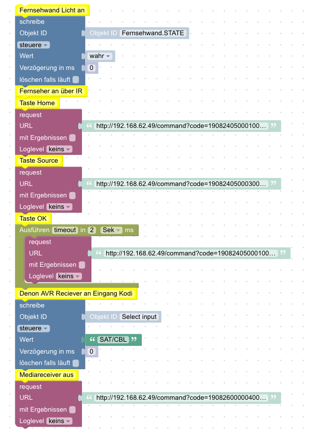

        Hier noch mal die Blocklys in Script Tags
        1. Fernseh an aus
        <xml xmlns="http://www.w3.org/1999/xhtml">
          <variables>
            <variable type="undefined" id="timeout">timeout</variable>
          </variables>
          <block type="on" id="jRjs/3s:?^/m#vpLkzCK" x="-363" y="-62">
            <field name="OID">javascript.0.Eigene_Datenpunkte.Weiter_Ordner.Fernseh</field>
            <statement name="STATEMENT">
              <block type="controls_if" id="}/;-2Ry9%j5=uY[%{HQ3">
                <value name="IF0">
                  <block type="on_source" id="*R05zM|3x}O4bQf?YvFo">
                  </block>
                </value>
                <statement name="DO0">
                  <block type="comment" id="zEMR]ud?J1hB-+lfMX(H">
                    <field name="COMMENT">Fernsehwand Licht an</field>
                    <next>
                      <block type="control_ex" id="f?QPcUe994$((Xpq}n6p">
                        <field name="TYPE">false</field>
                        <value name="OID">
                          <shadow type="field_oid" id="7[5_8M?5vlpN1+_An5{C">
                            <field name="oid">hm-rpc.2.IEQ0006850.1.STATE</field>
                          </shadow>
                        </value>
                        <value name="VALUE">
                          <shadow type="logic_boolean" id="pYLT[|5qmz?^jLYb?Z.Z">
                          </shadow>
                        </value>
                        <value name="DELAY_MS">
                          <shadow type="math_number" id="]0xKTQ_fiKO#t_i;LwV~">
                            <field name="NUM">0</field>
                          </shadow>
                        </value>
                        <next>
                          <block type="comment" id="#-?UQ$i$8MOzF%U8J(lL">
                            <field name="COMMENT">Fernseher an über IR</field>
                            <next>
                              <block type="comment" id="d~za$GFnVG@36kLopq}^">
                                <field name="COMMENT">Taste Home</field>
                                <next>
                                  <block type="request" id="s=`sgcjH7J)9d;32WQcp">
                                    <mutation with_statement="false"></mutation>
                                    <field name="WITH_STATEMENT">FALSE</field>
                                    <field name="LOG"></field>
                                    <value name="URL">
                                      <shadow type="text" id="C.,fQMx/K`m.1c+E3z,q">
                                        <field name="TEXT">http://192.168.62.49/command?code=1908240500010000000054&amp;XC_USER=user&amp;XC_PASS=210370&amp;XC_FNC=Send2</field>
                                      </shadow>
                                    </value>
                                    <next>
                                      <block type="comment" id="21?scwCBk(Dn8QL/7lTa">
                                        <field name="COMMENT">Taste Source</field>
                                        <next>
                                          <block type="request" id="*2ks5eknwMZA$%[/l-Z,">
                                            <value name="URL">
                                              <shadow type="text" id="MFyi[P`T/6R@h~QJW?R6">
                                                <field name="TEXT">http://192.168.62.49/command?code=1908240500030000000038&amp;XC_USER=user&amp;XC_PASS=210370&amp;XC_FNC=Send2</field>
                                              </shadow>
                                            </value>
                                            <next>
                                              <block type="comment" id="`FcxaSiu.8=WV!W+{$(}">
                                                <field name="COMMENT">Denon AVR Reciever an Eingang TV</field>
                                                <next>
                                                  <block type="control_ex" id="eNA(Dyv[:}OUfg+$Ta_P">
                                                    <value name="OID">
                                                      <shadow type="field_oid" id="2q$!3.N66|HKEEPoz(?3">
                                                        <field name="oid">denon.0.zoneMain.selectInput</field>
                                                      </shadow>
                                                    </value>
                                                      <shadow type="logic_boolean" id="?9fs.VWmdYQrccxQ757q">
                                                      </shadow>
                                                      <block type="text" id="0Cb8LmleVo|6B94?xK6Q">
                                                        <field name="TEXT">BD</field>
                                                      </block>
                                                    </value>
                                                      <shadow type="math_number" id="jsI+:ja9+(0F;n94`9s`">
                                                      </shadow>
                                                    </value>
                                                    <next>
                                                      <block type="comment" id="lM)zdO2]0OGZjH?u[uBk">
                                                        <field name="COMMENT">Media Receiver Power on</field>
                                                        <next>
                                                          <block type="request" id="uhb[9XiJv7.(lUr~9yx0">
                                                            <value name="URL">
                                                              <shadow type="text" id=".YP1Ii$%sw1o65b?Yf[B">
                                                                <field name="TEXT">http://192.168.62.49/command?code=190826000002000D050050008D0050004C009F004A009F00900050582B00010200010303010102000204&amp;XC_USER=user&amp;XC_PASS=210370&amp;XC_FNC=Send2</field>
                                                              </shadow>
                                                            </value>
                                                            <next>
                                                              <block type="comment" id="WHUjM|nUW;:1dfT8]oT6">
                                                                <field name="COMMENT">Taste OK am Fernseher</field>
                                                                <next>
                                                                  <block type="timeouts_settimeout" id="Q(Z}(QI}i*_#p_fe_nHe">
                                                                    <field name="DELAY">4</field>
                                                                      <block type="request" id="O{X)8-5d3#Od(h/`Z0MU">
                                                                        <value name="URL">
                                                                          <shadow type="text" id="Nfn0Xi[#,jlm1ix+js`~">
                                                                            <field name="TEXT">http://192.168.62.49/command?code=190824050001000000005C&amp;XC_USER=user&amp;XC_PASS=210370&amp;XC_FNC=Send2</field>
                                                                          </shadow>
                                                                        </value>
                                                                      </block>
                                                                    </statement>
                                                                  </block>
                                                                </next>
                                                              </block>
                                                            </next>
                                                          </block>
                                                        </next>
                                                      </block>
                                                    </next>
                                                  </block>
                                                </next>
                                              </block>
                                            </next>
                                          </block>
                                        </next>
                                      </block>
                                    </next>
                                  </block>
                                </next>
                              </block>
                            </next>
                          </block>
                        </next>
                      </block>
                    </next>
                  </block>
                </statement>
                <statement name="ELSE">
                  <block type="comment" id="9,+/w8$-w4biu.24~pA|">
                    <field name="COMMENT">Fernsehwand Lich aus</field>
                    <next>
                      <block type="control_ex" id="bZx6vIY2:b7M$nTARQ(8">
                        <value name="OID">
                          <shadow type="field_oid" id="N_N;yC~GQ3K@P}^0HTTw">
                          </shadow>
                        </value>
                          <shadow type="logic_boolean" id="tp/ei-]T4YhSdX^P`jZO">
                          </shadow>
                        </value>
                          <shadow type="math_number" id="dqg^(SE_0TF4s!V(hTy1">
                          </shadow>
                        </value>
                        <next>
                          <block type="comment" id="jrUhf9atkf,f,v?!u0-p">
                            <field name="COMMENT">Fernseher aus</field>
                            <next>
                              <block type="request" id="uQmuZAp#r4h^9?l/XX4h">
                                <value name="URL">
                                  <shadow type="text" id="IdCZc7,.THgOr7Rg~,VJ">
                                    <field name="TEXT">http://192.168.62.49/command?code=190824050001000000000C&amp;XC_USER=user&amp;XC_PASS=210370&amp;XC_FNC=Send2</field>
                                  </shadow>
                                </value>
                                <next>
                                  <block type="comment" id="zD8CwvFQg[fP#WDv#O3U">
                                    <field name="COMMENT">Denon AVR aus</field>
                                    <next>
                                      <block type="control_ex" id="[6TioCx0f!8,5#4tlWa/">
                                        <value name="OID">
                                          <shadow type="field_oid" id="J1*6J805s@_Oa/8]wN^_">
                                            <field name="oid">denon.0.zoneMain.powerZone</field>
                                          </shadow>
                                        </value>
                                          <shadow type="logic_boolean" id="wR$(Os[|JbXdSNXzclG;">
                                          </shadow>
                                        </value>
                                          <shadow type="math_number" id="Y)[3dd/X77Y1f`$b:M33">
                                          </shadow>
                                        </value>
                                        <next>
                                          <block type="comment" id=":D|ev]0AbNF8FPr?f.G#">
                                            <field name="COMMENT">Media Receiver aus</field>
                                            <next>
                                              <block type="request" id="_ZnGfx7Z0!H[U9i/*kAb">
                                                <value name="URL">
                                                  <shadow type="text" id="pY%#I{90}$qN;TygLCxS">
                                                    <field name="TEXT">http://192.168.62.49/command?code=190826000004000D050056008A0056004500A5004100A5008B0056582500010200010303030301010104&amp;XC_USER=user&amp;XC_PASS=210370&amp;XC_FNC=Send2</field>
                                                  </shadow>
                                                </value>
                                              </block>
                                            </next>
                                          </block>
                                        </next>
                                      </block>
                                    </next>
                                  </block>
                                </next>
                              </block>
                            </next>
                          </block>
                        </next>
                      </block>
                    </next>
                  </block>
                </statement>
              </block>
            </statement>
          </block>
        </xml>

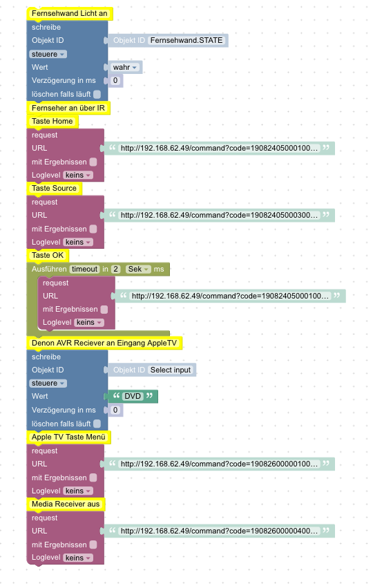

        1. Apple TV an
          <variables>
          </variables>
          <block type="comment" id="zEMR]ud?J1hB-+lfMX(H" x="213" y="-212">
            <next>
                <value name="OID">
                  </shadow>
                </value>
                  </shadow>
                </value>
                  </shadow>
                </value>
                <next>
                    <next>
                      <block type="comment" id="o0@Ot6f3{RdJF@n-.~j5">
                        <next>
                            <value name="URL">
                              </shadow>
                            </value>
                            <next>
                              <block type="comment" id=".k1j3!P{W(a3=LfPk^j?">
                                <next>
                                  <block type="request" id=":EKY`#Dw0Z8aTP5wiQPQ">
                                    <value name="URL">
                                      <shadow type="text" id="gTm}-ER^Dc5Zmd_h;NSd">
                                      </shadow>
                                    </value>
                                    <next>
                                      <block type="comment" id="/J1Oo`V;%96L.P/~g0`P">
                                        <field name="COMMENT">Taste OK</field>
                                        <next>
                                          <block type="timeouts_settimeout" id="poBe#Z;y8*.+:ez+V2iz">
                                            <field name="DELAY">2</field>
                                              <block type="request" id=",*50LI#My?6kek0DZ`.f">
                                                <value name="URL">
                                                  <shadow type="text" id=":C-TbFd2fgj#T6?2;3`h">
                                                  </shadow>
                                                </value>
                                              </block>
                                            </statement>
                                            <next>
                                                <field name="COMMENT">Denon AVR Reciever an Eingang AppleTV</field>
                                                <next>
                                                    <value name="OID">
                                                      </shadow>
                                                    </value>
                                                      </shadow>
                                                        <field name="TEXT">DVD</field>
                                                      </block>
                                                    </value>
                                                      </shadow>
                                                    </value>
                                                    <next>
                                                      <block type="comment" id="|y[bBJJH{u:q7KFDvAOh">
                                                        <field name="COMMENT">Apple TV Taste Menü</field>
                                                        <next>
                                                          <block type="request" id="|1AS-?,3ds%{W^jHEb|8">
                                                            <value name="URL">
                                                              <shadow type="text" id="oBp2LH[|4We[OCj$d3YK">

        und 3. Kodi an
          <variables>
          </variables>
          <block type="comment" id="ON7CLtU#Qq:r#}ruRaaG" x="162" y="-162">
            <field name="COMMENT">Schaltet den Kodi an mit folgenden Geräten</field>
          </block>
          <block type="comment" id="zEMR]ud?J1hB-+lfMX(H" x="199" y="-102">
            <next>
                <value name="OID">
                  </shadow>
                </value>
                  </shadow>
                </value>
                  </shadow>
                </value>
                <next>
                    <next>
                      <block type="comment" id="T*kE:+41uc%b~K:P[;?#">
                        <next>
                            <value name="URL">
                              </shadow>
                            </value>
                            <next>
                              <block type="comment" id="j:odd_ySg!rO0_^IU$-`">
                                <next>
                                  <block type="request" id="kugOvb)@pBqSRIf1j=*]">
                                    <value name="URL">
                                      <shadow type="text" id="?9Z5K}pZ7E.BSZic?bo=">
                                      </shadow>
                                    </value>
                                    <next>
                                      <block type="comment" id="=SxhkVU^q@PJ`W!NdyGt">
                                        <next>
                                          <block type="timeouts_settimeout" id="MdQ#t~dV8=c=o{PSf*h$">
                                              <block type="request" id="?c12Uc=@T}8!Vg4wEg-}">
                                                <value name="URL">
                                                  <shadow type="text" id="otQBS8HQGlCsHzr=whPR">
                                                  </shadow>
                                                </value>
                                              </block>
                                            </statement>
                                            <next>
                                                <field name="COMMENT">Denon AVR Reciever an Eingang Kodi</field>
                                                <next>
                                                    <value name="OID">
                                                      </shadow>
                                                    </value>
                                                      </shadow>
                                                        <field name="TEXT">SAT/CBL</field>
                                                      </block>
                                                    </value>
                                                      </shadow>
                                                    </value>
                                                    <next>
                                                      <block type="comment" id="1HK1DiChMY:*r3$D_+t4">
                                                        <field name="COMMENT">Mediareceiver aus</field>
                                                        <next>
                                                          <block type="request" id="1PHNCoZAtX%{P,Q(z8|[">
                                                            <value name="URL">
                                                              <shadow type="text" id="}WRb4KW|7P9R4`QE~e!?">
                                                              </shadow>
                                                            </value>
                                                          </block>
                                                        </next>
                                                      </block>
                                                    </next>
                                                  </block>
                                                </next>
                                              </block>
                                            </next>
                                          </block>
                                        </next>
                                      </block>
                                    </next>
                                  </block>
                                </next>
                              </block>
                            </next>
                          </block>
                        </next>
                      </block>
                    </next>
                  </block>
                </next>
              </block>
            </next>
          </block>
        </xml>

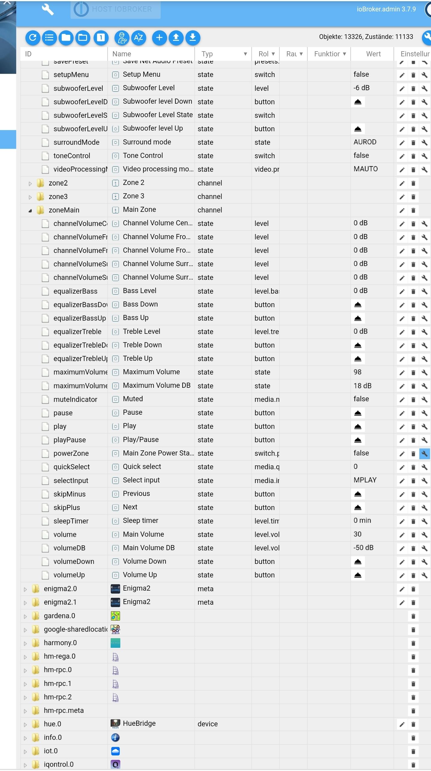

            aber Du hast einen Denon Reciever, oder ? Läuft der immer mit ?
            • K
              kg36304 last edited by
              Ja, der wird bei jeder Aktion mit eingeschaltet.
              dslraser 1 Reply Last reply Reply Quote 0
              • dslraser
                dslraser Forum Testing Most Active @kg36304 last edited by
                @kg36304 sagte in Iobroker Skript und Alexa:
                ist der Denon im LAN oder WLAN bei Dir ?
                Für Denon gibt es einen Adapter. (nutze ich auch)
                • K
                  Der ist im Lan und ich benutze auch den Adapter.
                  • dslraser
                    @kg36304
                    na das ist doch schon mal prima, also kannst Du ja über den prüfen....
                    Ich muss jetzt nochmal weg....
                    • K
                      Ja das geht, mir fehlt jedoch gerade der Zusammenhang.
                      OK, bin für hilfe dankbar, egal wann 😉
                      • dslraser
                        dslraser Forum Testing Most Active @kg36304 last edited by dslraser
                        Na ja, z.B. wenn der AVR an ist wird das ja in den DP vom Denon angezeigt (somit ist Dein Fernseher auch an, so wie Du sagst)
                        Also, z.B. Prüfe ob AVR an, wenn ja, brauchst Du ja nicht den Befehl zum einschalten des TV senden.
                        Beim ausschalten:
                        Den Rest der Geräte brauchst Du ja dann auch erst ausschalten wenn der AVR ausgeschaltet wird....(es sei denn, die sollen aus)
                        Edit: auch die Lautstärke usw. kannst Du dann prima mit Alexa steuern...

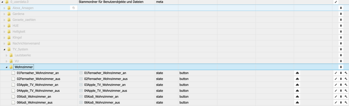

                                          importiere Dir mal dieses Blockly (ist noch nicht fertig und nur der Fernseher bisher)
                                          hier mußt Du jeweils noch rein klicken und das Gerät auswählen.
                                          Das Blockly erstellt 6 Datenpunkte unter 0_userdata.0 als Button und fügt diese automatisch in den iot Adapter ein.
                                          Bitte im iot Adapter nachsehen ob die Smartgeräte da sind.
                                          Deine alten Smartnamen für den Fernseher bitte erstmal im iot und in der Alexa App löschen und auch alle anderen Blocklys die irgendwas mit der Fernsehschalterei zu tun haben anhalten (nur um aus zu schließen das nicht ein anderes Blockly was schaltet)
                                          Danach bitte neue Geräte in der Alexa App suchen. Dann erstellst Du mal zwei Routinen in der Alexa App. Eine Routine sollte z.B. Alexa, Fernseh(er) an heißen und die andere Fernseh(er) aus, oder was Du eben am liebsten zum ein-/ausschalten des Fernsehers sagen möchtest, das ist in Routinen frei wählbar.
                                          Wie man die Routinen erstellt habe ich hier mal beschrieben. (Bissl nach unten scrollen im Beitrag)
                                          Danach geht es dann weiter. Ich will nur mal sehen ob es "grundsätzlich" so geht.

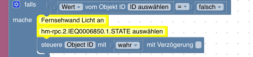

                                          • K
                                            Das was da jetzt steht ist die Fernsehwand, das ist nur eine Lampe die eingeschaltet wird.
                                            Soll ich das jetzt trotzdem übernehmen?
