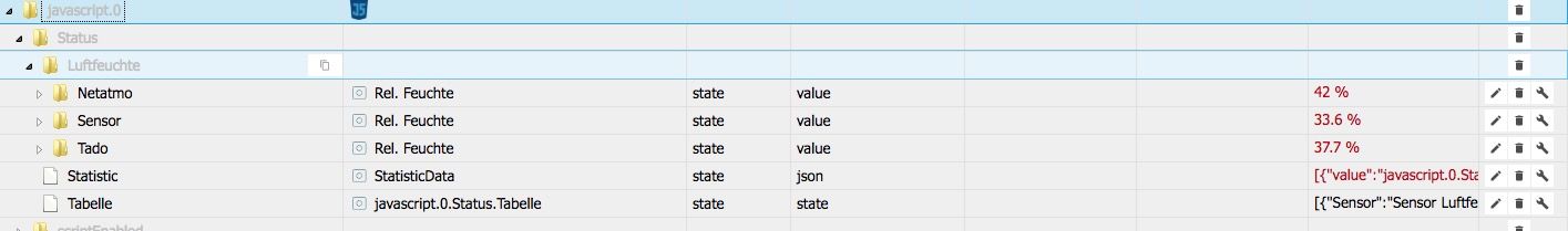

    ich hab im Forum ein Skript gefunden, dass mir Min/Max/24mean/24median ausrechnet und die Daten in einzelne DP ablegt, was auch wunderbar klappt :)
    Zusätzlich wird ein JSON-Objekt angelegt, das wohl zur Visualisierung dient:
    [{"value":"javascript.0.Status.Luftfeuchte.Sensor","max24h":"javascript.0.Status.Luftfeuchte.Sensor.Max_24h","min24h":"javascript.0.Status.Luftfeuchte.Sensor.Min_24h","mean24h":"javascript.0.Status.Luftfeuchte.Sensor.Mean_24h","median24h":"javascript.0.Status.Luftfeuchte.Sensor.Median_24h","max1h":"javascript.0.Status.Luftfeuchte.Sensor.Max_1h","min1h":"javascript.0.Status.Luftfeuchte.Sensor.Min_1h","mean1h":"javascript.0.Status.Luftfeuchte.Sensor.Mean_1h","data":[33.6,33.5,33.5,33.5,33.6,33.4,33.4,33.5,33.4,33.4,33.4,33.3,33.5,33.5,33.5,33.4,33.5,33.3,33.4,33.4,33.6,33.6,33.5,33.5,33.5,33.6,33.5,33.5,33.5,33.5,33.5,33.4,33.4,33.4,33.4,33.5,33.4,33.3,33.4,33.3,33.4,33.2,33.2,33.3,33.2,33.2,33.2,33.3,33.2,33.2,33.3,33.4,33.1,33.1,33.3,33.1,33.3,33.1,33.2,33.2,33.1,33.4,33.1,33,33.1,33,32.9,32.8,32.6,31.6,34.6,35,34.6,34.5,34.3,34.4,34.5,34.4,34.4,34.2,34.1,34.1,34,34.1,34.1,34.3,34.9,34.3,34.3,34.6,34.5,34.6,34.8,34.9,35,35,35.2,35.2,35.2,35.2,35.2,35.2,35.2,35.2,35.2,35.2,35.2,35.2,35.2,35.2,35.2,35.2,35.2,35.2,35.2,35.2,35.2,35.2,35.2,35.2,35.2,35.2,35.2,35.2,35.2,35.2,35.2,35.2,35.2,35.2,35.2,35.2,35.2,35.2,35.2,35.2,35.2,35.2,35.2,35.2,35.2,35.2,35.2,35.2]},{"value":"javascript.0.Status.Luftfeuchte.Netatmo","max24h":"javascript.0.Status.Luftfeuchte.Netatmo.Max_24h","min24h":"javascript.0.Status.Luftfeuchte.Netatmo.Min_24h","mean24h":"javascript.0.Status.Luftfeuchte.Netatmo.Mean_24h","median24h":"javascript.0.Status.Luftfeuchte.Netatmo.Median_24h","max1h":"javascript.0.Status.Luftfeuchte.Netatmo.Max_1h","min1h":"javascript.0.Status.Luftfeuchte.Netatmo.Min_1h","mean1h":"javascript.0.Status.Luftfeuchte.Netatmo.Mean_1h","data":[42,42,42,42,42,42,42,42,42,42,42,42,42,42,42,42,42,42,42,42,42,42,42,42,42,42,42,42,42,42,42,42,42,42,42,42,42,42,42,42,42,42,42,42,42,42,42,42,42,42,42,42,42,42,42,42,42,42,42,42,42,42,42,42,42,42,42,42,42,42,44,44,43,44,43,44,44,43,43,43,43,43,43,44,44,44,44,44,44,44,44,44,44,44,44,44,44,44,44,44,44,44,44,44,44,44,44,44,44,44,44,44,44,44,44,44,44,44,44,44,44,44,44,44,44,44,44,44,44,44,44,44,44,44,44,44,44,44,44,44,44,44,44,44]},{"value":"javascript.0.Status.Luftfeuchte.Tado","max24h":"javascript.0.Status.Luftfeuchte.Tado.Max_24h","min24h":"javascript.0.Status.Luftfeuchte.Tado.Min_24h","mean24h":"javascript.0.Status.Luftfeuchte.Tado.Mean_24h","median24h":"javascript.0.Status.Luftfeuchte.Tado.Median_24h","max1h":"javascript.0.Status.Luftfeuchte.Tado.Max_1h","min1h":"javascript.0.Status.Luftfeuchte.Tado.Min_1h","mean1h":"javascript.0.Status.Luftfeuchte.Tado.Mean_1h","data":[37.7,37.6,37.6,37.4,37.4,37.2,37.1,37.1,37.1,37.1,37.1,37.1,37.1,37.4,37.5,37.7,37.9,37.7,37.3,37,37,36.9,36.9,36.8,36.8,36.7,36.7,36.6,36.5,36.5,36.2,36.2,36.1,36.1,36.1,36,35.8,35.6,35.6,35.4,35.3,35.2,35.1,35,34.9,34.9,34.8,34.8,34.8,34.7,34.6,34.7,34.7,34.8,34.8,34.7,34.8,34.8,34.8,34.8,34.9,34.9,35,35.1,35,35,34.6,34.6,34.6,34.4,31.3,35.9,35.8,36.1,35.9,35.8,35.8,36.1,36.1,35.8,36,36,35.9,36,36.1,36.1,36.3,36.3,36.3,36.4,36.6,36.6,36.8,36.7,36.8,36.9,36.9,37.1,37.1,37.1,37.1,37.1,37.1,37.1,37.1,37.1,37.1,37.1,37.1,37.1,37.1,37.1,37.1,37.1,37.1,37.1,37.1,37.1,37.1,37.1,37.1,37.1,37.1,37.1,37.1,37.1,37.1,37.1,37.1,37.1,37.1,37.1,37.1,37.1,37.1,37.1,37.1,37.1,37.1,37.1,37.1,37.1,37.1,37.1]}]
    Dies habe ich versucht mit dem Standard Basic JSON-Tabellen Widget einzubinden, was aber, egal was ich mache, immer wie Kraut und Rüben aussieht 😬
    Gibt es eine Alternative zur einfachen Darstellung? Hat jemand eine Idee, vielleicht @liv-in-sky als Tabellenfachmann? ;-)
    liv-in-skyL sigi234S 2 Antworten Letzte Antwort
    • ? Ein ehemaliger Benutzer

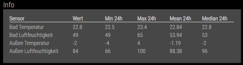

      man kann auch ein json über eine schleife laufen lassen und dann in dem dir bekannten tabellen script integrieren
      welche spalten willst du anzeigen ? also wie soll das dargestellt werden - natürlich gibt es eine limitierung für mein script, was das layout angeht - es gibt einen punkt im json , der data heißt - darin sind maßig temperaturwerte - sollen die in der tabelle sichtbar werden ?
      vielleicht kannst du mit excel oder ähnlichen eine kleine voransicht machen - nur zur übersicht - muss kein kunstwerk sein

        @liv-in-sky Hallo :)
        Danke für die Antwort, aber da lohnt der Aufwand erstmal nicht. Es ist eine kleine statistische Auswertung bei mir zuhause. Wenn das mit Bordmitteln gegangen wäre, super. Aber ansonsten dann doch eher das andere Thema mit den Klimadaten :)

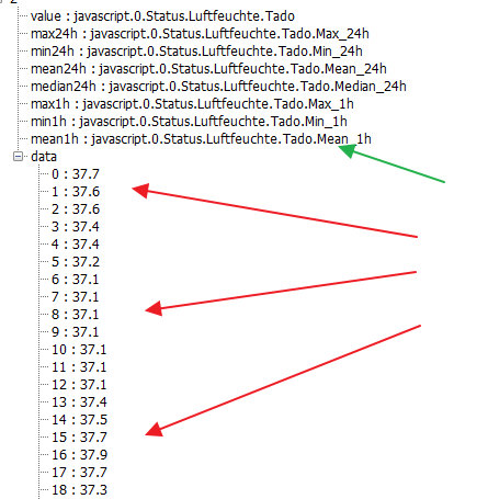

              @HeinrichB
              irgendwie verstehen wir uns nicht - die 8 datenpunkte (grüner pfeil) auslesen ist klar - aber dann gibt es im json einen unterpunkt , in dem sind viele temperatur daten (rote pfeile) - die sollen doch nicht angezeigt werden - die müssen verarbeitet werden bzw sind die in den "grünen" pfeilen" verarbeitet und wir brauchen die nicht in der tabelle ?
              wenn du nur die 8 anderen punkte willst (grün)- die ja als datenpunkte existieren - können wir direct eine schleife darüberlaufen lassen - das wäre dann wie bei den anderen scripten - dann brauchen wir das json garnicht - dann wäre es egal, ob ich batterie oder ping daten auslese - oder eben diese daten - immer der selbe ablauf
              ? 1 Antwort Letzte Antwort
              • liv-in-skyL liv-in-sky
                @HeinrichB
                Tado habe ich zugeklappt gelassen.
                Hier mein Skript, dass die DP erzeugt.NICHT VON MIR, sondern aus dem Forum; ich beanspruche daher keine Urheberschaft ;-)
                  @liv-in-sky
                  Du, ich will dich damit nicht unnötig auslasten, daher nur wenn Du willst.
                  Ich bin nicht scharf auf das JSON als solches, sondern eher auf die Ergebnisse ;-)
                  Ich gebe Dir mal den kompletten Part aus dem DP. Ob Weg A oder B ist da jetzt
                  nicht elementar für mich. Dachte nur, dass das fertige JSON vielleicht die Sache vereinfach :)
                        sigi234S Online
                        sigi234S Online
                        sigi234
                        @HeinrichB
                        Einfaches Widget:
                        [{"tpl":"tplTableBody","data":{"g_fixed":true,"g_visibility":false,"g_css_font_text":true,"g_css_background":true,"g_css_shadow_padding":false,"g_css_border":true,"g_gestures":false,"g_signals":false,"g_last_change":false,"visibility-cond":"==","visibility-val":1,"visibility-groups-action":"hide","static_value":"[{\"Title\": \"first\", \"Value\": 1, \"_Description\": \"Value1\"}, {\"Title\": \"second\", \"Value\": 2, \"_Description\": \"Value2\"}]","signals-cond-0":"==","signals-val-0":true,"signals-icon-0":"/vis/signals/lowbattery.png","signals-icon-size-0":0,"signals-blink-0":false,"signals-horz-0":0,"signals-vert-0":0,"signals-hide-edit-0":false,"signals-cond-1":"==","signals-val-1":true,"signals-icon-1":"/vis/signals/lowbattery.png","signals-icon-size-1":0,"signals-blink-1":false,"signals-horz-1":0,"signals-vert-1":0,"signals-hide-edit-1":false,"signals-cond-2":"==","signals-val-2":true,"signals-icon-2":"/vis/signals/lowbattery.png","signals-icon-size-2":0,"signals-blink-2":false,"signals-horz-2":0,"signals-vert-2":0,"signals-hide-edit-2":false,"lc-type":"last-change","lc-is-interval":true,"lc-is-moment":false,"lc-format":"","lc-position-vert":"top","lc-position-horz":"right","lc-offset-vert":0,"lc-offset-horz":0,"lc-font-size":"12px","lc-font-family":"","lc-font-style":"","lc-bkg-color":"","lc-color":"","lc-border-width":"0","lc-border-style":"","lc-border-color":"","lc-border-radius":10,"lc-zindex":0,"table_oid":"javascript.0.Status.Tabelle","new_on_top":true,"max_rows":"4","colCount":"6","colWidth1":"200px","colWidth2":"100px","colWidth3":"100px","colWidth4":"100px","colWidth5":"100px","colWidth6":"100px","hide_header":false,"class":"vis-style","colName3":"Min 24h","colName4":"Max 24h","colName5":"Mean 24h","colName6":"Median 24h"},"style":{"left":"36px","top":"50px","width":"727px","height":"137px","z-index":"1","color":"#cdcace","background-color":"transparent","text-align":"left","font-size":"large","border-width":"","border-style":"none","border-radius":"","border-color":"","font-family":"RobotoCondensed-Light"},"widgetSet":"basic"},{"tpl":"tplFrame","data":{"g_fixed":false,"g_visibility":false,"g_css_font_text":false,"g_css_background":true,"g_css_shadow_padding":false,"g_css_border":false,"g_gestures":false,"g_signals":false,"g_last_change":false,"visibility-cond":"==","visibility-val":1,"visibility-groups-action":"hide","title":"","title_color":"black","title_top":"-10","title_left":"15","header_height":"0","header_color":"#d60000","signals-cond-0":"==","signals-val-0":true,"signals-icon-0":"/vis/signals/lowbattery.png","signals-icon-size-0":0,"signals-blink-0":false,"signals-horz-0":0,"signals-vert-0":0,"signals-hide-edit-0":false,"signals-cond-1":"==","signals-val-1":true,"signals-icon-1":"/vis/signals/lowbattery.png","signals-icon-size-1":0,"signals-blink-1":false,"signals-horz-1":0,"signals-vert-1":0,"signals-hide-edit-1":false,"signals-cond-2":"==","signals-val-2":true,"signals-icon-2":"/vis/signals/lowbattery.png","signals-icon-size-2":0,"signals-blink-2":false,"signals-horz-2":0,"signals-vert-2":0,"signals-hide-edit-2":false,"lc-type":"last-change","lc-is-interval":true,"lc-is-moment":false,"lc-format":"","lc-position-vert":"top","lc-position-horz":"right","lc-offset-vert":0,"lc-offset-horz":0,"lc-font-size":"12px","lc-font-family":"","lc-font-style":"","lc-bkg-color":"","lc-color":"","lc-border-width":"0","lc-border-style":"","lc-border-color":"","lc-border-radius":10,"lc-zindex":0},"style":{"left":"40px","top":"74px","width":"720px","height":"1px","z-index":"4","background-color":"#afacac","font-family":"RobotoCondensed-Light"},"widgetSet":"basic"},{"tpl":"tplFrame","data":{"visibility-cond":"==","visibility-val":1,"title":"Info","title_color":"#d7cec1","title_top":"-29","title_left":"0","header_height":"0","header_color":"","gestures-offsetX":0,"gestures-offsetY":0,"signals-cond-0":"==","signals-val-0":true,"signals-icon-0":"/icons-mfd-svg/control_ok.svg","signals-icon-size-0":"72","signals-blink-0":false,"signals-horz-0":"90","signals-vert-0":"81","signals-hide-edit-0":false,"signals-cond-1":"==","signals-val-1":"false","signals-icon-1":"/icons-mfd-svg/control_ok.svg","signals-icon-size-1":"72","signals-blink-1":false,"signals-horz-1":"90","signals-vert-1":"81","signals-hide-edit-1":false,"signals-cond-2":"==","signals-val-2":true,"signals-icon-2":"/vis.0/main/lowbattery.png","signals-icon-size-2":0,"signals-blink-2":false,"signals-horz-2":0,"signals-vert-2":0,"signals-hide-edit-2":false,"visibility-groups-action":"hide","lc-type":"last-change","lc-is-interval":true,"lc-is-moment":false,"lc-format":"","lc-position-vert":"top","lc-position-horz":"right","lc-offset-vert":0,"lc-offset-horz":0,"lc-font-size":"12px","lc-font-family":"","lc-font-style":"","lc-bkg-color":"","lc-color":"","lc-border-width":"0","lc-border-style":"","lc-border-color":"","lc-border-radius":10,"lc-zindex":0,"signals-oid-0":"","signals-oid-1":"","signals-icon-style-1":""},"style":{"left":"19px","top":"34px","width":"765px","height":"174px","font-family":"RobotoCondensed-Light","font-style":"normal","font-variant":"normal","font-weight":"","font-size":"x-large","z-index":"0","background":"#474747","border-width":"0px","box-shadow":"2px 2px 3px rgba(20, 20, 20, 50)","color":"#d7cec1 "},"widgetSet":"basic"}]
                        Immer Daten sichern!
                        • sigi234S sigi234
                          @HeinrichB
                          Einfaches Widget:
                          ? Offline
                          ? Offline
                          @sigi234
                          Vielen Dank :)
