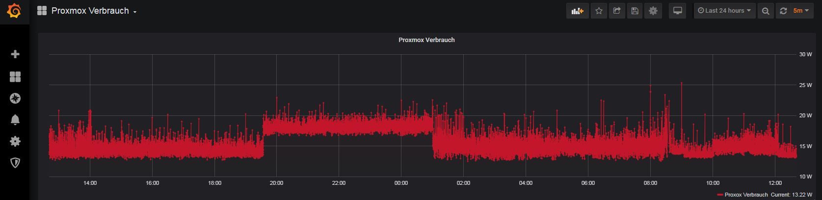

            • K Offline
              K Offline
              Kalle Blomquist
