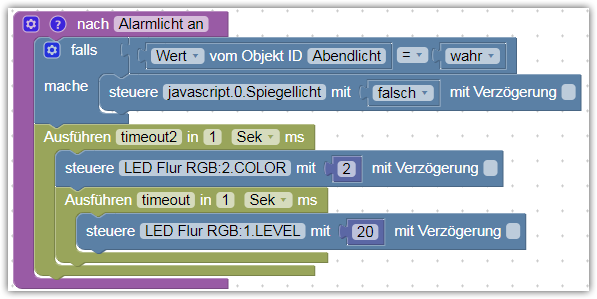

                                  • smile
                                    smile last edited by
                                    Ich muss mich leider nochmal zurückmelden, da nun von ca. 20 Blocklys eines dabei ist, wo der Fehler nachhaltig auftaucht.
                                    Es ist mein geliebtes Alarmanlagen - Blockly 😢
                                    Hier einmal der Export:

                                    Und hier folgt ein mir kryptischer Part des Scripts, der einfach noch hinten dranhängt:
                                    //JTNDeG1sJTIweG1sbnMlM0QlMjJodHRwJTNBJTJGJTJGd3d3LnczLm9yZyUyRjE5OTklMkZ4aHRtbCUyMiUzRSUzQ2Jsb2NrJTIwdHlwZSUzRCUyMnByb2NlZHVyZXNfZGVmbm9yZXR1cm4lMjIlMjBpZCUzRCUyMmFlJTQwVSU1RFUlN0R3NUg3N2clNURXMnBfJTdDJTNCJTIyJTIweCUzRCUyMjIxMyUyMiUyMHklM0QlMjItMjM3JTIyJTNFJTNDZmllbGQlMjBuYW1lJTNEJTIyTkFNRSUyMiUzRUFsYXJtbGljaHQlMjBhbiUzQyUyRmZpZWxkJTNFJTNDY29tbWVudCUyMHBpbm5lZCUzRCUyMmZhbHNlJTIyJTIwaCUzRCUyMjgwJTIyJTIwdyUzRCUyMjE2MCUyMiUzRUJlc2NocmVpYmUlMjBkaWVzZSUyMEZ1bmt0aW9uJTIwJUUyJTgwJUE2JTNDJTJGY29tbWVudCUzRSUzQ3N0YXRlbWVudCUyMG5hbWUlM0QlMjJTVEFDSyUyMiUzRSUzQ2Jsb2NrJTIwdHlwZSUzRCUyMmNvbnRyb2xzX2lmJTIyJTIwaWQlM0QlMjJmKDR4MCU2MFk2JTVEbikoayU3QiU2MDA5MmglMkYlMjIlM0UlM0N2YWx1ZSUyMG5hbWUlM0QlMjJJRjAlMjIlM0UlM0NibG9jayUyMHR5cGUlM0QlMjJsb2dpY19jb21wYXJlJTIyJTIwaWQlM0QlMjIxWFdKfmslM0ElM0Y2djdjMSh5eHkzQVYlMjIlM0UlM0NmaWVsZCUyMG5hbWUlM0QlMjJPUCUyMiUzRUVRJTNDJTJGZmllbGQlM0UlM0N2YWx1ZSUyMG5hbWUlM0QlMjJBJTIyJTNFJTNDYmxvY2slMjB0eXBlJTNEJTIyZ2V0X3ZhbHVlJTIyJTIwaWQlM0QlMjIlNUVhJTQwJTNEUW8zJTVFbn5mTy10aE1tJTJCcjIlMjIlM0UlM0NmaWVsZCUyMG5hbWUlM0QlMjJBVFRSJTIyJTNFdmFsJTNDJTJGZmllbGQlM0UlM0NmaWVsZCUyMG5hbWUlM0QlMjJPSUQlMjIlM0VobS1yZWdhLjAuMTEyNDIlM0MlMkZmaWVsZCUzRSUzQyUyRmJsb2NrJTNFJTNDJTJGdmFsdWUlM0UlM0N2YWx1ZSUyMG5hbWUlM0QlMjJCJTIyJTNFJTNDYmxvY2slMjB0eXBlJTNEJTIybG9naWNfYm9vbGVhbiUyMiUyMGlkJTNEJTIyM2IlNDBhQSUyRjFWJTIzamkhJTJDWiUzQTZfJTNER2slMjIlM0UlM0NmaWVsZCUyMG5hbWUlM0QlMjJCT09MJTIyJTNFVFJVRSUzQyUyRmZpZWxkJTNFJTNDJTJGYmxvY2slM0UlM0MlMkZ2YWx1ZSUzRSUzQyUyRmJsb2NrJTNFJTNDJTJGdmFsdWUlM0UlM0NzdGF0ZW1lbnQlMjBuYW1lJTNEJTIyRE8wJTIyJTNFJTNDYmxvY2slMjB0eXBlJTNEJTIyY29udHJvbCUyMiUyMGlkJTNEJTIyS1dGUSk0b241Q3IlM0IlM0ZfWVNLUGhCJTIyJTNFJTNDbXV0YXRpb24lMjBkZWxheV9pbnB1dCUzRCUyMmZhbHNlJTIyJTNFJTNDJTJGbXV0YXRpb24lM0UlM0NmaWVsZCUyMG5hbWUlM0QlMjJPSUQlMjIlM0VqYXZhc2NyaXB0LjAuU3BpZWdlbGxpY2h0JTNDJTJGZmllbGQlM0UlM0NmaWVsZCUyMG5hbWUlM0QlMjJXSVRIX0RFTEFZJTIyJTNFRkFMU0UlM0MlMkZmaWVsZCUzRSUzQ3ZhbHVlJTIwbmFtZSUzRCUyMlZBTFVFJTIyJTNFJTNDYmxvY2slMjB0eXBlJTNEJTIybG9naWNfYm9vbGVhbiUyMiUyMGlkJTNEJTIyYXhWejUlMkNpJTVENkQhJTI1ayUzRGI4cmxXJTdCJTIyJTNFJTNDZmllbGQlMjBuYW1lJTNEJTIyQk9PTCUyMiUzRUZBTFNFJTNDJTJGZmllbGQlM0UlM0MlMkZibG9jayUzRSUzQyUyRnZhbHVlJTNFJTNDJTJGYmxvY2slM0UlM0MlMkZzdGF0ZW1lbnQlM0UlM0NuZXh0JTNFJTNDYmxvY2slMjB0eXBlJTNEJTIydGltZW91dHNfc2V0dGltZW91dCUyMiUyMGlkJTNEJTIyVUVfVVdUJTNCJTVEJTNEMTlfJTNGSk5BdjAlMjV2JTIyJTNFJTNDZmllbGQlMjBuYW1lJTNEJTIyTkFNRSUyMiUzRXRpbWVvdXQyJTNDJTJGZmllbGQlM0UlM0NmaWVsZCUyMG5hbWUlM0QlMjJERUxBWSUyMiUzRTElM0MlMkZmaWVsZCUzRSUzQ2ZpZWxkJTIwbmFtZSUzRCUyMlVOSVQlMjIlM0VzZWMlM0MlMkZmaWVsZCUzRSUzQ3N0YXRlbWVudCUyMG5hbWUlM0QlMjJTVEFURU1FTlQlMjIlM0UlM0NibG9jayUyMHR5cGUlM0QlMjJjb250cm9sJTIyJTIwaWQlM0QlMjJtaUd0VHJYVyU3RCUyRiklMkNpeWV3Q0VXJTdCJTIyJTNFJTNDbXV0YXRpb24lMjBkZWxheV9pbnB1dCUzRCUyMmZhbHNlJTIyJTNFJTNDJTJGbXV0YXRpb24lM0UlM0NmaWVsZCUyMG5hbWUlM0QlMjJPSUQlMjIlM0VobS1ycGMuMC5PRVEwNjkzMDUwLjIuQ09MT1IlM0MlMkZmaWVsZCUzRSUzQ2ZpZWxkJTIwbmFtZSUzRCUyMldJVEhfREVMQVklMjIlM0VGQUxTRSUzQyUyRmZpZWxkJTNFJTNDdmFsdWUlMjBuYW1lJTNEJTIyVkFMVUUlMjIlM0UlM0NibG9jayUyMHR5cGUlM0QlMjJtYXRoX251bWJlciUyMiUyMGlkJTNEJTIyVW9Mc1glN0J5TDIlNUI0anNNSyU1RF8lM0JMJTJGJTIyJTNFJTNDZmllbGQlMjBuYW1lJTNEJTIyTlVNJTIyJTNFMiUzQyUyRmZpZWxkJTNFJTNDJTJGYmxvY2slM0UlM0MlMkZ2YWx1ZSUzRSUzQ25leHQlM0UlM0NibG9jayUyMHR5cGUlM0QlMjJ0aW1lb3V0c19zZXR0aW1lb3V0JTIyJTIwaWQlM0QlMjJ4V09LZUhrJTNGJTJDJTJDJTVCYkwqJTNGZXpQJTdEMSUyMiUzRSUzQ2ZpZWxkJTIwbmFtZSUzRCUyMk5BTUUlMjIlM0V0aW1lb3V0JTNDJTJGZmllbGQlM0UlM0NmaWVsZCUyMG5hbWUlM0QlMjJERUxBWSUyMiUzRTElM0MlMkZmaWVsZCUzRSUzQ2ZpZWxkJTIwbmFtZSUzRCUyMlVOSVQlMjIlM0VzZWMlM0MlMkZmaWVsZCUzRSUzQ3N0YXRlbWVudCUyMG5hbWUlM0QlMjJTVEFURU1FTlQlMjIlM0UlM0NibG9jayUyMHR5cGUlM0QlMjJjb250cm9sJTIyJTIwaWQlM0QlMjJtVkE3R0MlM0QhbVdvLm9FJTdCKS1IYXYlMjIlM0UlM0NtdXRhdGlvbiUyMGRlbGF5X2lucHV0JTNEJTIyZmFsc2UlMjIlM0UlM0MlMkZtdXRhdGlvbiUzRSUzQ2ZpZWxkJTIwbmFtZSUzRCUyMk9JRCUyMiUzRWhtLXJwYy4wLk9FUTA2OTMwNTAuMS5MRVZFTCUzQyUyRmZpZWxkJTNFJTNDZmllbGQlMjBuYW1lJTNEJTIyV0lUSF9ERUxBWSUyMiUzRUZBTFNFJTNDJTJGZmllbGQlM0UlM0N2YWx1ZSUyMG5hbWUlM0QlMjJWQUxVRSUyMiUzRSUzQ2Jsb2NrJTIwdHlwZSUzRCUyMm1hdGhfbnVtYmVyJTIyJTIwaWQlM0QlMjJlVUFKd0oxNDRlVG1fTSU2MHB+UWdsJTIyJTNFJTNDZmllbGQlMjBuYW1lJTNEJTIyTlVNJTIyJTNFMjAlM0MlMkZmaWVsZCUzRSUzQyUyRmJsb2NrJTNFJTNDJTJGdmFsdWUlM0UlM0MlMkZibG9jayUzRSUzQyUyRnN0YXRlbWVudCUzRSUzQyUyRmJsb2NrJTNFJTNDJTJGbmV4dCUzRSUzQyUyRmJsb2NrJTNFJTNDJTJGc3RhdGVtZW50JTNFJTNDJTJGYmxvY2slM0UlM0MlMkZuZXh0JTNFJTNDJTJGYmxvY2slM0UlM0MlMkZzdGF0ZW1lbnQlM0UlM0MlMkZibG9jayUzRSUzQ2Jsb2NrJTIwdHlwZSUzRCUyMm9uJTIyJTIwaWQlM0QlMjJScSUyM2ElNDBtTCUyQiU1RSU3QmclM0ElNjAqcDZqRSU3QnclMjIlMjB4JTNEJTIyLTQ4NyUyMiUyMHklM0QlMjItMTg3JTIyJTNFJTNDZmllbGQlMjBuYW1lJTNEJTIyT0lEJTIyJTNFaG0tcnBjLjAuQmlkQ29TLVJGLjQ1LlBSRVNTX1NIT1JUJTNDJTJGZmllbGQlM0UlM0NmaWVsZCUyMG5hbWUlM0QlMjJDT05ESVRJT04lMjIlM0VhbnklM0MlMkZmaWVsZCUzRSUzQ2ZpZWxkJTIwbmFtZSUzRCUyMkFDS19DT05ESVRJT04lMjIlM0UlM0MlMkZmaWVsZCUzRSUzQ3N0YXRlbWVudCUyMG5hbWUlM0QlMjJTVEFURU1FTlQlMjIlM0UlM0NibG9jayUyMHR5cGUlM0QlMjJjb250cm9sc19pZiUyMiUyMGlkJTNEJTIya1J2MyUzQTYlMkNQWUUpaiphTyU2MCllcEYlMjIlM0UlM0NtdXRhdGlvbiUyMGVsc2VpZiUzRCUyMjElMjIlM0UlM0MlMkZtdXRhdGlvbiUzRSUzQ3ZhbHVlJTIwbmFtZSUzRCUyMklGMCUyMiUzRSUzQ2Jsb2NrJTIwdHlwZSUzRCUyMmxvZ2ljX2NvbXBhcmUlMjIlMjBpZCUzRCUyMmoxMDJzV3NNNiUyRi0lMkMlNUJsdmx6Y2MlMjMlMjIlM0UlM0NmaWVsZCUyMG5hbWUlM0QlMjJPUCUyMiUzRUVRJTNDJTJGZmllbGQlM0UlM0N2YWx1ZSUyMG5hbWUlM0QlMjJBJTIyJTNFJTNDYmxvY2slMjB0eXBlJTNEJTIyZ2V0X3ZhbHVlJTIyJTIwaWQlM0QlMjI1JTJGV35jVHdsJTdEdGkhSXFXOFgzZl8lMjIlM0UlM0NmaWVsZCUyMG5hbWUlM0QlMjJBVFRSJTIyJTNFdmFsJTNDJTJGZmllbGQlM0UlM0NmaWVsZCUyMG5hbWUlM0QlMjJPSUQlMjIlM0VobS1yZWdhLjAuMTExNjAlM0MlMkZmaWVsZCUzRSUzQyUyRmJsb2NrJTNFJTNDJTJGdmFsdWUlM0UlM0N2YWx1ZSUyMG5hbWUlM0QlMjJCJTIyJTNFJTNDYmxvY2slMjB0eXBlJTNEJTIybG9naWNfYm9vbGVhbiUyMiUyMGlkJTNEJTIyejFLaH4tZHlHJTVESiUzQiUyNVVaJTNBWWV4RSUyMiUzRSUzQ2ZpZWxkJTIwbmFtZSUzRCUyMkJPT0wlMjIlM0VGQUxTRSUzQyUyRmZpZWxkJTNFJTNDJTJGYmxvY2slM0UlM0MlMkZ2YWx1ZSUzRSUzQyUyRmJsb2NrJTNFJTNDJTJGdmFsdWUlM0UlM0NzdGF0ZW1lbnQlMjBuYW1lJTNEJTIyRE8wJTIyJTNFJTNDYmxvY2slMjB0eXBlJTNEJTIyY29udHJvbCUyMiUyMGlkJTNEJTIyRUFKYl9sMSFNYSUyNSppTTYhSVVLNSUyMiUzRSUzQ211dGF0aW9uJTIwZGVsYXlfaW5wdXQlM0QlMjJmYWxzZSUyMiUzRSUzQyUyRm11dGF0aW9uJTNFJTNDZmllbGQlMjBuYW1lJTNEJTIyT0lEJTIyJTNFaG0tcmVnYS4wLjExMTYwJTNDJTJGZmllbGQlM0UlM0NmaWVsZCUyMG5hbWUlM0QlMjJXSVRIX0RFTEFZJTIyJTNFRkFMU0UlM0MlMkZmaWVsZCUzRSUzQ3ZhbHVlJTIwbmFtZSUzRCUyMlZBTFVFJTIyJTNFJTNDYmxvY2slMjB0eXBlJTNEJTIybG9naWNfYm9vbGVhbiUyMiUyMGlkJTNEJTIyJTdEdFprLWZrUElRSSU1QkUlM0F4NnIqbTYlMjIlM0UlM0NmaWVsZCUyMG5hbWUlM0QlMjJCT09MJTIyJTNFVFJVRSUzQyUyRmZpZWxkJTNFJTNDJTJGYmxvY2slM0UlM0MlMkZ2YWx1ZSUzRSUzQ25leHQlM0UlM0NibG9jayUyMHR5cGUlM0QlMjJwcm9jZWR1cmVzX2NhbGxub3JldHVybiUyMiUyMGlkJTNEJTIyT1N0bXApJTNBWihsJTVCVEZZYlQlNURVNnAlMjIlM0UlM0NtdXRhdGlvbiUyMG5hbWUlM0QlMjJBbGFybWxpY2h0JTIwYW4lMjIlM0UlM0MlMkZtdXRhdGlvbiUzRSUzQ25leHQlM0UlM0NibG9jayUyMHR5cGUlM0QlMjJzYXlpdCUyMiUyMGlkJTNEJTIyS2tzQlk4NDlYTy1STUJFTi1OJTQwMSUyMiUyMGRpc2FibGVkJTNEJTIydHJ1ZSUyMiUzRSUzQ2ZpZWxkJTIwbmFtZSUzRCUyMklOU1RBTkNFJTIyJTNFLjIlM0MlMkZmaWVsZCUzRSUzQ2ZpZWxkJTIwbmFtZSUzRCUyMkxBTkdVQUdFJTIyJTNFZGUlM0MlMkZmaWVsZCUzRSUzQ2ZpZWxkJTIwbmFtZSUzRCUyMkxPRyUyMiUzRSUzQyUyRmZpZWxkJTNFJTNDdmFsdWUlMjBuYW1lJTNEJTIyTUVTU0FHRSUyMiUzRSUzQ3NoYWRvdyUyMHR5cGUlM0QlMjJ0ZXh0JTIyJTIwaWQlM0QlMjJZMiUzRHlxd1MxVGIpVlN3ZkUlNUUhdTQlMjIlM0UlM0NmaWVsZCUyMG5hbWUlM0QlMjJURVhUJTIyJTNFQWxhcm1hbmxhZ2UlMjBha3RpdmllcnQlM0MlMkZmaWVsZCUzRSUzQyUyRnNoYWRvdyUzRSUzQyUyRnZhbHVlJTNFJTNDJTJGYmxvY2slM0UlM0MlMkZuZXh0JTNFJTNDJTJGYmxvY2slM0UlM0MlMkZuZXh0JTNFJTNDJTJGYmxvY2slM0UlM0MlMkZzdGF0ZW1lbnQlM0UlM0N2YWx1ZSUyMG5hbWUlM0QlMjJJRjElMjIlM0UlM0NibG9jayUyMHR5cGUlM0QlMjJsb2dpY19jb21wYXJlJTIyJTIwaWQlM0QlMjJJUF8lNjBHRyU1RCUzRm1yLXljUW1KKi5LTiUyMiUzRSUzQ2ZpZWxkJTIwbmFtZSUzRCUyMk9QJTIyJTNFRVElM0MlMkZmaWVsZCUzRSUzQ3ZhbHVlJTIwbmFtZSUzRCUyMkElMjIlM0UlM0NibG9jayUyMHR5cGUlM0QlMjJnZXRfdmFsdWUlMjIlMjBpZCUzRCUyMjFZRSU0MFluIUslM0Q5dVV0JTNENlclNUVoZX4lMjIlM0UlM0NmaWVsZCUyMG5hbWUlM0QlMjJBVFRSJTIyJTNFdmFsJTNDJTJGZmllbGQlM0UlM0NmaWVsZCUyMG5hbWUlM0QlMjJPSUQlMjIlM0VobS1yZWdhLjAuMTExNjAlM0MlMkZmaWVsZCUzRSUzQyUyRmJsb2NrJTNFJTNDJTJGdmFsdWUlM0UlM0N2YWx1ZSUyMG5hbWUlM0QlMjJCJTIyJTNFJTNDYmxvY2slMjB0eXBlJTNEJTIybG9naWNfYm9vbGVhbiUyMiUyMGlkJTNEJTIyJTIzJTdEenNLYyU1RVElM0JFIXpkLmlIV3hmJTVEJTIyJTNFJTNDZmllbGQlMjBuYW1lJTNEJTIyQk9PTCUyMiUzRVRSVUUlM0MlMkZmaWVsZCUzRSUzQyUyRmJsb2NrJTNFJTNDJTJGdmFsdWUlM0UlM0MlMkZibG9jayUzRSUzQyUyRnZhbHVlJTNFJTNDc3RhdGVtZW50JTIwbmFtZSUzRCUyMkRPMSUyMiUzRSUzQ2Jsb2NrJTIwdHlwZSUzRCUyMmNvbnRyb2wlMjIlMjBpZCUzRCUyMiU1QjYlM0IlMkJCMVFncyU3QyU1Qm9EYiU3RG8lN0NHfjklMjIlM0UlM0NtdXRhdGlvbiUyMGRlbGF5X2lucHV0JTNEJTIyZmFsc2UlMjIlM0UlM0MlMkZtdXRhdGlvbiUzRSUzQ2ZpZWxkJTIwbmFtZSUzRCUyMk9JRCUyMiUzRWhtLXJlZ2EuMC4xMTE2MCUzQyUyRmZpZWxkJTNFJTNDZmllbGQlMjBuYW1lJTNEJTIyV0lUSF9ERUxBWSUyMiUzRUZBTFNFJTNDJTJGZmllbGQlM0UlM0N2YWx1ZSUyMG5hbWUlM0QlMjJWQUxVRSUyMiUzRSUzQ2Jsb2NrJTIwdHlwZSUzRCUyMmxvZ2ljX2Jvb2xlYW4lMjIlMjBpZCUzRCUyMjFlTGFBJTdCc01YekQlNDBFfkJuejc2JTVFJTIyJTNFJTNDZmllbGQlMjBuYW1lJTNEJTIyQk9PTCUyMiUzRUZBTFNFJTNDJTJGZmllbGQlM0UlM0MlMkZibG9jayUzRSUzQyUyRnZhbHVlJTNFJTNDbmV4dCUzRSUzQ2Jsb2NrJTIwdHlwZSUzRCUyMnByb2NlZHVyZXNfY2FsbG5vcmV0dXJuJTIyJTIwaWQlM0QlMjJQJTNBfiU0MDJFUHklMkIlMkNvMyUyMyU2MERSIUEzdCUyMiUzRSUzQ211dGF0aW9uJTIwbmFtZSUzRCUyMkFsYXJtbGljaHQlMjBhdXMlMjIlM0UlM0MlMkZtdXRhdGlvbiUzRSUzQyUyRmJsb2NrJTNFJTNDJTJGbmV4dCUzRSUzQyUyRmJsb2NrJTNFJTNDJTJGc3RhdGVtZW50JTNFJTNDJTJGYmxvY2slM0UlM0MlMkZzdGF0ZW1lbnQlM0UlM0NuZXh0JTNFJTNDYmxvY2slMjB0eXBlJTNEJTIyb24lMjIlMjBpZCUzRCUyMkMlMkNqcyhXd28lMkNUX2lPdUhsdGJIaSUyMiUzRSUzQ2ZpZWxkJTIwbmFtZSUzRCUyMk9JRCUyMiUzRWhtLXJlZ2EuMC4xMTE2MCUzQyUyRmZpZWxkJTNFJTNDZmllbGQlMjBuYW1lJTNEJTIyQ09ORElUSU9OJTIyJTNFbmUlM0MlMkZmaWVsZCUzRSUzQ2ZpZWxkJTIwbmFtZSUzRCUyMkFDS19DT05ESVRJT04lMjIlM0UlM0MlMkZmaWVsZCUzRSUzQ3N0YXRlbWVudCUyMG5hbWUlM0QlMjJTVEFURU1FTlQlMjIlM0UlM0NibG9jayUyMHR5cGUlM0QlMjJkZWJ1ZyUyMiUyMGlkJTNEJTIyMHklNjBiKFg5KThtWmMzTm8lN0NRRCUzQlglMjIlM0UlM0NmaWVsZCUyMG5hbWUlM0QlMjJTZXZlcml0eSUyMiUzRWxvZyUzQyUyRmZpZWxkJTNFJTNDdmFsdWUlMjBuYW1lJTNEJTIyVEVYVCUyMiUzRSUzQ3NoYWRvdyUyMHR5cGUlM0QlMjJ0ZXh0JTIyJTIwaWQlM0QlMjJVJTNEZ1RhRXAzZXZTekdDSXB4QXIlN0QlMjIlM0UlM0NmaWVsZCUyMG5hbWUlM0QlMjJURVhUJTIyJTNFKioqVXBkYXRlJTIwZXJrYW5udCUzQyUyRmZpZWxkJTNFJTNDJTJGc2hhZG93JTNFJTNDJTJGdmFsdWUlM0UlM0NuZXh0JTNFJTNDYmxvY2slMjB0eXBlJTNEJTIyY29udHJvbHNfaWYlMjIlMjBpZCUzRCUyMjF1a29ULSlEa0Q2JTQwZm9hRk0xRG0lMjIlM0UlM0N2YWx1ZSUyMG5hbWUlM0QlMjJJRjAlMjIlM0UlM0NibG9jayUyMHR5cGUlM0QlMjJsb2dpY19vcGVyYXRpb24lMjIlMjBpZCUzRCUyMiUzRmNmJTNCVTRfTyUyQiElMkZFRiUzQiU0MHJfcng2JTIyJTIwaW5saW5lJTNEJTIyZmFsc2UlMjIlM0UlM0NmaWVsZCUyMG5hbWUlM0QlMjJPUCUyMiUzRU9SJTNDJTJGZmllbGQlM0UlM0N2YWx1ZSUyMG5hbWUlM0QlMjJBJTIyJTNFJTNDYmxvY2slMjB0eXBlJTNEJTIybG9naWNfY29tcGFyZSUyMiUyMGlkJTNEJTIyRE9xblYlNURCcWR4TiU3RDNiUSUyQzROU2YlMjIlM0UlM0NmaWVsZCUyMG5hbWUlM0QlMjJPUCUyMiUzRUVRJTNDJTJGZmllbGQlM0UlM0N2YWx1ZSUyMG5hbWUlM0QlMjJBJTIyJTNFJTNDYmxvY2slMjB0eXBlJTNEJTIyZ2V0X3ZhbHVlJTIyJTIwaWQlM0QlMjJ4JTJGSkFiKllrZ1IlN0RoT0olM0J4VyUyQzclNDAlMjIlM0UlM0NmaWVsZCUyMG5hbWUlM0QlMjJBVFRSJTIyJTNFZnJvbSUzQyUyRmZpZWxkJTNFJTNDZmllbGQlMjBuYW1lJTNEJTIyT0lEJTIyJTNFaG0tcmVnYS4wLjExMTYwJTNDJTJGZmllbGQlM0UlM0MlMkZibG9jayUzRSUzQyUyRnZhbHVlJTNFJTNDdmFsdWUlMjBuYW1lJTNEJTIyQiUyMiUzRSUzQ2Jsb2NrJTIwdHlwZSUzRCUyMnRleHQlMjIlMjBpZCUzRCUyMmFyRSUyQk54JTNCQXVUZ2clN0NLJTdEdlpxRX4lMjIlM0UlM0NmaWVsZCUyMG5hbWUlM0QlMjJURVhUJTIyJTNFc3lzdGVtLmFkYXB0ZXIuamF2YXNjcmlwdC4wJTNDJTJGZmllbGQlM0UlM0MlMkZibG9jayUzRSUzQyUyRnZhbHVlJTNFJTNDJTJGYmxvY2slM0UlM0MlMkZ2YWx1ZSUzRSUzQ3ZhbHVlJTIwbmFtZSUzRCUyMkIlMjIlM0UlM0NibG9jayUyMHR5cGUlM0QlMjJsb2dpY19jb21wYXJlJTIyJTIwaWQlM0QlMjJ6UG5DJTVEbmttaSU3QyUyNU8lM0ZjM2pFQlZoJTIyJTNFJTNDZmllbGQlMjBuYW1lJTNEJTIyT1AlMjIlM0VFUSUzQyUyRmZpZWxkJTNFJTNDdmFsdWUlMjBuYW1lJTNEJTIyQSUyMiUzRSUzQ2Jsb2NrJTIwdHlwZSUzRCUyMmdldF92YWx1ZSUyMiUyMGlkJTNEJTIyWm0lM0IpJTdDcFAlNUQ4YmNHOVNsQmNuSX4lMjIlM0UlM0NmaWVsZCUyMG5hbWUlM0QlMjJBVFRSJTIyJTNFZnJvbSUzQyUyRmZpZWxkJTNFJTNDZmllbGQlMjBuYW1lJTNEJTIyT0lEJTIyJTNFaG0tcmVnYS4wLjExMTYwJTNDJTJGZmllbGQlM0UlM0MlMkZibG9jayUzRSUzQyUyRnZhbHVlJTNFJTNDdmFsdWUlMjBuYW1lJTNEJTIyQiUyMiUzRSUzQ2Jsb2NrJTIwdHlwZSUzRCUyMnRleHQlMjIlMjBpZCUzRCUyMjYlNUI2RCU2MCUzRCU3QzVUeDEwJTVFJTdCd3NjJTVFRDMlMjIlM0UlM0NmaWVsZCUyMG5hbWUlM0QlMjJURVhUJTIyJTNFc3lzdGVtLmFkYXB0ZXIud2ViLjAlM0MlMkZmaWVsZCUzRSUzQyUyRmJsb2NrJTNFJTNDJTJGdmFsdWUlM0UlM0MlMkZibG9jayUzRSUzQyUyRnZhbHVlJTNFJTNDJTJGYmxvY2slM0UlM0MlMkZ2YWx1ZSUzRSUzQ3N0YXRlbWVudCUyMG5hbWUlM0QlMjJETzAlMjIlM0UlM0NibG9jayUyMHR5cGUlM0QlMjJjb250cm9sJTIyJTIwaWQlM0QlMjIlNUVLSzhzYjMlNjA0JTJGcXQuJTJDJTdDdUpkUzYlMjIlM0UlM0NtdXRhdGlvbiUyMGRlbGF5X2lucHV0JTNEJTIyZmFsc2UlMjIlM0UlM0MlMkZtdXRhdGlvbiUzRSUzQ2ZpZWxkJTIwbmFtZSUzRCUyMk9JRCUyMiUzRWhtLXJlZ2EuMC4xMTE2MCUzQyUyRmZpZWxkJTNFJTNDZmllbGQlMjBuYW1lJTNEJTIyV0lUSF9ERUxBWSUyMiUzRUZBTFNFJTNDJTJGZmllbGQlM0UlM0N2YWx1ZSUyMG5hbWUlM0QlMjJWQUxVRSUyMiUzRSUzQ2Jsb2NrJTIwdHlwZSUzRCUyMmdldF92YWx1ZSUyMiUyMGlkJTNEJTIyKS51cGNVTXY4bFMlM0R5ZEswKjZ6JTJCJTIyJTNFJTNDZmllbGQlMjBuYW1lJTNEJTIyQVRUUiUyMiUzRXZhbCUzQyUyRmZpZWxkJTNFJTNDZmllbGQlMjBuYW1lJTNEJTIyT0lEJTIyJTNFaG0tcmVnYS4wLjExMTYwJTNDJTJGZmllbGQlM0UlM0MlMkZibG9jayUzRSUzQyUyRnZhbHVlJTNFJTNDJTJGYmxvY2slM0UlM0MlMkZzdGF0ZW1lbnQlM0UlM0NuZXh0JTNFJTNDYmxvY2slMjB0eXBlJTNEJTIyY29udHJvbHNfaWYlMjIlMjBpZCUzRCUyMiUzQSk5eC15JTVCJTIzUC0odWpKKnp0LktvJTIyJTNFJTNDbXV0YXRpb24lMjBlbHNlaWYlM0QlMjIxJTIyJTNFJTNDJTJGbXV0YXRpb24lM0UlM0N2YWx1ZSUyMG5hbWUlM0QlMjJJRjAlMjIlM0UlM0NibG9jayUyMHR5cGUlM0QlMjJsb2dpY19jb21wYXJlJTIyJTIwaWQlM0QlMjIlNDBhRzdXVjNEJTI1TiUzRihSKHglMkNHJTNGTDMlMjIlM0UlM0NmaWVsZCUyMG5hbWUlM0QlMjJPUCUyMiUzRUVRJTNDJTJGZmllbGQlM0UlM0N2YWx1ZSUyMG5hbWUlM0QlMjJBJTIyJTNFJTNDYmxvY2slMjB0eXBlJTNEJTIyZ2V0X3ZhbHVlJTIyJTIwaWQlM0QlMjJFbiUyRiUzQm1mMSUzQV9VJTJCWHEwZSUyM2k4JTVEJTdEJTIyJTNFJTNDZmllbGQlMjBuYW1lJTNEJTIyQVRUUiUyMiUzRXZhbCUzQyUyRmZpZWxkJTNFJTNDZmllbGQlMjBuYW1lJTNEJTIyT0lEJTIyJTNFaG0tcmVnYS4wLjExMTYwJTNDJTJGZmllbGQlM0UlM0MlMkZibG9jayUzRSUzQyUyRnZhbHVlJTNFJTNDdmFsdWUlMjBuYW1lJTNEJTIyQiUyMiUzRSUzQ2Jsb2NrJTIwdHlwZSUzRCUyMmxvZ2ljX2Jvb2xlYW4lMjIlMjBpZCUzRCUyMnVIJTIzNDRpNnRGcHJtJTdCcCUzQiUzQU4lMkN2MCUyMiUzRSUzQ2ZpZWxkJTIwbmFtZSUzRCUyMkJPT0wlMjIlM0VUUlVFJTNDJTJGZmllbGQlM0UlM0MlMkZibG9jayUzRSUzQyUyRnZhbHVlJTNFJTNDJTJGYmxvY2slM0UlM0MlMkZ2YWx1ZSUzRSUzQ3N0YXRlbWVudCUyMG5hbWUlM0QlMjJETzAlMjIlM0UlM0NibG9jayUyMHR5cGUlM0QlMjJkZWJ1ZyUyMiUyMGlkJTNEJTIyJTQwMjFHSUZCOVYlMjNGKCUzQkRFJTIzOWwzMSUyMiUzRSUzQ2ZpZWxkJTIwbmFtZSUzRCUyMlNldmVyaXR5JTIyJTNFbG9nJTNDJTJGZmllbGQlM0UlM0N2YWx1ZSUyMG5hbWUlM0QlMjJURVhUJTIyJTNFJTNDc2hhZG93JTIwdHlwZSUzRCUyMnRleHQlMjIlMjBpZCUzRCUyMig0ZjZfRiUyRi4lNUUta0ZReG9nVE10XyUyMiUzRSUzQ2ZpZWxkJTIwbmFtZSUzRCUyMlRFWFQlMjIlM0UqKipBbGFybWFubGFnZSUyMHdhaHIlM0MlMkZmaWVsZCUzRSUzQyUyRnNoYWRvdyUzRSUzQyUyRnZhbHVlJTNFJTNDbmV4dCUzRSUzQ2Jsb2NrJTIwdHlwZSUzRCUyMnByb2NlZHVyZXNfY2FsbG5vcmV0dXJuJTIyJTIwaWQlM0QlMjIlNUQteSU2MFEhJTNCaChoSkdVJTVFaV9PciU3RHolMjIlM0UlM0NtdXRhdGlvbiUyMG5hbWUlM0QlMjJBbGFybWxpY2h0JTIwYW4lMjIlM0UlM0MlMkZtdXRhdGlvbiUzRSUzQ25leHQlM0UlM0NibG9jayUyMHR5cGUlM0QlMjJzYXlpdCUyMiUyMGlkJTNEJTIydSUyQ2k0JTVCcVdBbUJlaEw4Yl9nJTIzJTI1TyUyMiUyMGRpc2FibGVkJTNEJTIydHJ1ZSUyMiUzRSUzQ2ZpZWxkJTIwbmFtZSUzRCUyMklOU1RBTkNFJTIyJTNFLjIlM0MlMkZmaWVsZCUzRSUzQ2ZpZWxkJTIwbmFtZSUzRCUyMkxBTkdVQUdFJTIyJTNFZGUlM0MlMkZmaWVsZCUzRSUzQ2ZpZWxkJTIwbmFtZSUzRCUyMkxPRyUyMiUzRSUzQyUyRmZpZWxkJTNFJTNDdmFsdWUlMjBuYW1lJTNEJTIyTUVTU0FHRSUyMiUzRSUzQ3NoYWRvdyUyMHR5cGUlM0QlMjJ0ZXh0JTIyJTIwaWQlM0QlMjJhaDFnTjlJWSU1RWN4JTNCZzElNUVCcnlqUyUyMiUzRSUzQ2ZpZWxkJTIwbmFtZSUzRCUyMlRFWFQlMjIlM0VBbGFybWFubGFnZSUyMGFrdGl2aWVydCUzQyUyRmZpZWxkJTNFJTNDJTJGc2hhZG93JTNFJTNDJTJGdmFsdWUlM0UlM0MlMkZibG9jayUzRSUzQyUyRm5leHQlM0UlM0MlMkZibG9jayUzRSUzQyUyRm5leHQlM0UlM0MlMkZibG9jayUzRSUzQyUyRnN0YXRlbWVudCUzRSUzQ3ZhbHVlJTIwbmFtZSUzRCUyMklGMSUyMiUzRSUzQ2Jsb2NrJTIwdHlwZSUzRCUyMmxvZ2ljX2NvbXBhcmUlMjIlMjBpZCUzRCUyMjBVUWVRJTdCKEglN0NiJTJGREglM0YlN0MlMjNIJTIzbSU3RCUyMiUzRSUzQ2ZpZWxkJTIwbmFtZSUzRCUyMk9QJTIyJTNFRVElM0MlMkZmaWVsZCUzRSUzQ3ZhbHVlJTIwbmFtZSUzRCUyMkElMjIlM0UlM0NibG9jayUyMHR5cGUlM0QlMjJnZXRfdmFsdWUlMjIlMjBpZCUzRCUyMjBHJTVCJTNBNmEtTS1hb3clN0JLX3QlMjMlNUIlMkZyJTIyJTNFJTNDZmllbGQlMjBuYW1lJTNEJTIyQVRUUiUyMiUzRXZhbCUzQyUyRmZpZWxkJTNFJTNDZmllbGQlMjBuYW1lJTNEJTIyT0lEJTIyJTNFaG0tcmVnYS4wLjExMTYwJTNDJTJGZmllbGQlM0UlM0MlMkZibG9jayUzRSUzQyUyRnZhbHVlJTNFJTNDdmFsdWUlMjBuYW1lJTNEJTIyQiUyMiUzRSUzQ2Jsb2NrJTIwdHlwZSUzRCUyMmxvZ2ljX2Jvb2xlYW4lMjIlMjBpZCUzRCUyMiU1RHklNUQlNjBNNUlyISpZJTI1ZGJTQyUyM2xKdyUyMiUzRSUzQ2ZpZWxkJTIwbmFtZSUzRCUyMkJPT0wlMjIlM0VGQUxTRSUzQyUyRmZpZWxkJTNFJTNDJTJGYmxvY2slM0UlM0MlMkZ2YWx1ZSUzRSUzQyUyRmJsb2NrJTNFJTNDJTJGdmFsdWUlM0UlM0NzdGF0ZW1lbnQlMjBuYW1lJTNEJTIyRE8xJTIyJTNFJTNDYmxvY2slMjB0eXBlJTNEJTIyZGVidWclMjIlMjBpZCUzRCUyMkNoYlZieiU2MCU1RHVKQ0xpJTVESGRHJTdEN2ElMjIlM0UlM0NmaWVsZCUyMG5hbWUlM0QlMjJTZXZlcml0eSUyMiUzRWxvZyUzQyUyRmZpZWxkJTNFJTNDdmFsdWUlMjBuYW1lJTNEJTIyVEVYVCUyMiUzRSUzQ3NoYWRvdyUyMHR5cGUlM0QlMjJ0ZXh0JTIyJTIwaWQlM0QlMjIqJTNCfkk5JTVCZSUyM1M4VCpIJTQwJTNEdzc2WlglMjIlM0UlM0NmaWVsZCUyMG5hbWUlM0QlMjJURVhUJTIyJTNFKioqQWxhcm1hbmxhZ2UlMjB1bndhaHIlM0MlMkZmaWVsZCUzRSUzQyUyRnNoYWRvdyUzRSUzQyUyRnZhbHVlJTNFJTNDbmV4dCUzRSUzQ2Jsb2NrJTIwdHlwZSUzRCUyMnByb2NlZHVyZXNfY2FsbG5vcmV0dXJuJTIyJTIwaWQlM0QlMjJ2UmNUS3ElM0ZXJTJGcTElNDBnJTI1VUtKQkElM0QlMjIlM0UlM0NtdXRhdGlvbiUyMG5hbWUlM0QlMjJBbGFybWxpY2h0JTIwYXVzJTIyJTNFJTNDJTJGbXV0YXRpb24lM0UlM0MlMkZibG9jayUzRSUzQyUyRm5leHQlM0UlM0MlMkZibG9jayUzRSUzQyUyRnN0YXRlbWVudCUzRSUzQyUyRmJsb2NrJTNFJTNDJTJGbmV4dCUzRSUzQyUyRmJsb2NrJTNFJTNDJTJGbmV4dCUzRSUzQyUyRmJsb2NrJTNFJTNDJTJGc3RhdGVtZW50JTNFJTNDJTJGYmxvY2slM0UlM0MlMkZuZXh0JTNFJTNDJTJGYmxvY2slM0UlM0NibG9jayUyMHR5cGUlM0QlMjJwcm9jZWR1cmVzX2RlZm5vcmV0dXJuJTIyJTIwaWQlM0QlMjI3NHMlMkNBLXcpUXliaUolM0QlN0IlM0ZIVCU3QyUyMyUyMiUyMHglM0QlMjIyMjklMjIlMjB5JTNEJTIyNTUlMjIlM0UlM0NmaWVsZCUyMG5hbWUlM0QlMjJOQU1FJTIyJTNFQWxhcm1saWNodCUyMGF1cyUzQyUyRmZpZWxkJTNFJTNDY29tbWVudCUyMHBpbm5lZCUzRCUyMmZhbHNlJTIyJTIwaCUzRCUyMjgwJTIyJTIwdyUzRCUyMjE2MCUyMiUzRUJlc2NocmVpYmUlMjBkaWVzZSUyMEZ1bmt0aW9uJTIwJUUyJTgwJUE2JTNDJTJGY29tbWVudCUzRSUzQ3N0YXRlbWVudCUyMG5hbWUlM0QlMjJTVEFDSyUyMiUzRSUzQ2Jsb2NrJTIwdHlwZSUzRCUyMmNvbnRyb2xzX2lmJTIyJTIwaWQlM0QlMjI2aCU0MCU3QiUyMzRNZ2slNjBObDIlNjA2JTJDJTdCfiklMkMlMjIlM0UlM0NtdXRhdGlvbiUyMGVsc2VpZiUzRCUyMjElMjIlM0UlM0MlMkZtdXRhdGlvbiUzRSUzQ3ZhbHVlJTIwbmFtZSUzRCUyMklGMCUyMiUzRSUzQ2Jsb2NrJTIwdHlwZSUzRCUyMmxvZ2ljX2NvbXBhcmUlMjIlMjBpZCUzRCUyMnElNUVEYXdPRmpDTSU0ME9JJTJDSGw2JTNBWSglMjIlM0UlM0NmaWVsZCUyMG5hbWUlM0QlMjJPUCUyMiUzRUVRJTNDJTJGZmllbGQlM0UlM0N2YWx1ZSUyMG5hbWUlM0QlMjJBJTIyJTNFJTNDYmxvY2slMjB0eXBlJTNEJTIyZ2V0X3ZhbHVlJTIyJTIwaWQlM0QlMjJmYWYtJTI1JTI1eTVRSSUyMy5nKjBydmZ3JTYwJTIyJTNFJTNDZmllbGQlMjBuYW1lJTNEJTIyQVRUUiUyMiUzRXZhbCUzQyUyRmZpZWxkJTNFJTNDZmllbGQlMjBuYW1lJTNEJTIyT0lEJTIyJTNFaG0tcmVnYS4wLjExMjQyJTNDJTJGZmllbGQlM0UlM0MlMkZibG9jayUzRSUzQyUyRnZhbHVlJTNFJTNDdmFsdWUlMjBuYW1lJTNEJTIyQiUyMiUzRSUzQ2Jsb2NrJTIwdHlwZSUzRCUyMmxvZ2ljX2Jvb2xlYW4lMjIlMjBpZCUzRCUyMkpRU0JqMmF0JTJCMXAuWVNVLjQlM0YpJTJDJTIyJTNFJTNDZmllbGQlMjBuYW1lJTNEJTIyQk9PTCUyMiUzRUZBTFNFJTNDJTJGZmllbGQlM0UlM0MlMkZibG9jayUzRSUzQyUyRnZhbHVlJTNFJTNDJTJGYmxvY2slM0UlM0MlMkZ2YWx1ZSUzRSUzQ3N0YXRlbWVudCUyMG5hbWUlM0QlMjJETzAlMjIlM0UlM0NibG9jayUyMHR5cGUlM0QlMjJkZWJ1ZyUyMiUyMGlkJTNEJTIyY2llTiUzQlFBJTYwbzYwViUzQkIlN0IlNjA4cGtCJTIyJTNFJTNDZmllbGQlMjBuYW1lJTNEJTIyU2V2ZXJpdHklMjIlM0Vsb2clM0MlMkZmaWVsZCUzRSUzQ3ZhbHVlJTIwbmFtZSUzRCUyMlRFWFQlMjIlM0UlM0NzaGFkb3clMjB0eXBlJTNEJTIydGV4dCUyMiUyMGlkJTNEJTIyRCUyRlJ4T2xnJTJGbGUhbFlZJTI1MSU0MCUyRiF5JTIyJTNFJTNDZmllbGQlMjBuYW1lJTNEJTIyVEVYVCUyMiUzRSoqKiUyMEFiZW5kbGljaHQlMjBmYWxzY2glMkMlMjBhbHNvJTIwYXVzJTNDJTJGZmllbGQlM0UlM0MlMkZzaGFkb3clM0UlM0MlMkZ2YWx1ZSUzRSUzQ25leHQlM0UlM0NibG9jayUyMHR5cGUlM0QlMjJjb250cm9sJTIyJTIwaWQlM0QlMjIlM0EqfmclMjUlNUVQJTNEJTVCLkJ5cE94bDdZJTJCViUyMiUzRSUzQ211dGF0aW9uJTIwZGVsYXlfaW5wdXQlM0QlMjJmYWxzZSUyMiUzRSUzQyUyRm11dGF0aW9uJTNFJTNDZmllbGQlMjBuYW1lJTNEJTIyT0lEJTIyJTNFaG0tcnBjLjAuT0VRMDY5MzA1MC4yLkNPTE9SJTNDJTJGZmllbGQlM0UlM0NmaWVsZCUyMG5hbWUlM0QlMjJXSVRIX0RFTEFZJTIyJTNFRkFMU0UlM0MlMkZmaWVsZCUzRSUzQ3ZhbHVlJTIwbmFtZSUzRCUyMlZBTFVFJTIyJTNFJTNDYmxvY2slMjB0eXBlJTNEJTIybWF0aF9udW1iZXIlMjIlMjBpZCUzRCUyMkwlMkIlN0N2X2glM0ZmJTNGV2dPV2YlN0JvTlZmcCUyMiUzRSUzQ2ZpZWxkJTIwbmFtZSUzRCUyMk5VTSUyMiUzRTU4JTNDJTJGZmllbGQlM0UlM0MlMkZibG9jayUzRSUzQyUyRnZhbHVlJTNFJTNDbmV4dCUzRSUzQ2Jsb2NrJTIwdHlwZSUzRCUyMmNvbnRyb2wlMjIlMjBpZCUzRCUyMmRibyUzRC0lNDAlNjA3bnQwSmVvam4haE0lN0MlMjIlM0UlM0NtdXRhdGlvbiUyMGRlbGF5X2lucHV0JTNEJTIydHJ1ZSUyMiUzRSUzQyUyRm11dGF0aW9uJTNFJTNDZmllbGQlMjBuYW1lJTNEJTIyT0lEJTIyJTNFaG0tcnBjLjAuT0VRMDY5MzA1MC4xLkxFVkVMJTNDJTJGZmllbGQlM0UlM0NmaWVsZCUyMG5hbWUlM0QlMjJXSVRIX0RFTEFZJTIyJTNFVFJVRSUzQyUyRmZpZWxkJTNFJTNDZmllbGQlMjBuYW1lJTNEJTIyREVMQVlfTVMlMjIlM0U1MDAlM0MlMkZmaWVsZCUzRSUzQ2ZpZWxkJTIwbmFtZSUzRCUyMlVOSVQlMjIlM0VtcyUzQyUyRmZpZWxkJTNFJTNDZmllbGQlMjBuYW1lJTNEJTIyQ0xFQVJfUlVOTklORyUyMiUzRUZBTFNFJTNDJTJGZmllbGQlM0UlM0N2YWx1ZSUyMG5hbWUlM0QlMjJWQUxVRSUyMiUzRSUzQ2Jsb2NrJTIwdHlwZSUzRCUyMm1hdGhfbnVtYmVyJTIyJTIwaWQlM0QlMjJwaUQ0JTVFJTdCIVJOc1BlVSUyQyU3RHQ4JTYwKWolMjIlM0UlM0NmaWVsZCUyMG5hbWUlM0QlMjJOVU0lMjIlM0U1MCUzQyUyRmZpZWxkJTNFJTNDJTJGYmxvY2slM0UlM0MlMkZ2YWx1ZSUzRSUzQ25leHQlM0UlM0NibG9jayUyMHR5cGUlM0QlMjJjb250cm9sJTIyJTIwaWQlM0QlMjIlNDBjalh4ZVc2eCU1RVFYMiUzRCUyQyU1REdiVCUyMyUyMiUzRSUzQ211dGF0aW9uJTIwZGVsYXlfaW5wdXQlM0QlMjJ0cnVlJTIyJTNFJTNDJTJGbXV0YXRpb24lM0UlM0NmaWVsZCUyMG5hbWUlM0QlMjJPSUQlMjIlM0VobS1ycGMuMC5PRVEwNjkzMDUwLjEuTEVWRUwlM0MlMkZmaWVsZCUzRSUzQ2ZpZWxkJTIwbmFtZSUzRCUyMldJVEhfREVMQVklMjIlM0VUUlVFJTNDJTJGZmllbGQlM0UlM0NmaWVsZCUyMG5hbWUlM0QlMjJERUxBWV9NUyUyMiUzRTEzMDAlM0MlMkZmaWVsZCUzRSUzQ2ZpZWxkJTIwbmFtZSUzRCUyMlVOSVQlMjIlM0VtcyUzQyUyRmZpZWxkJTNFJTNDZmllbGQlMjBuYW1lJTNEJTIyQ0xFQVJfUlVOTklORyUyMiUzRUZBTFNFJTNDJTJGZmllbGQlM0UlM0N2YWx1ZSUyMG5hbWUlM0QlMjJWQUxVRSUyMiUzRSUzQ2Jsb2NrJTIwdHlwZSUzRCUyMm1hdGhfbnVtYmVyJTIyJTIwaWQlM0QlMjJIMiUyRiUzQUUlMkY0JTdEJTJCJTVCclBUJTYwQk13YnUlMjMlMjIlM0UlM0NmaWVsZCUyMG5hbWUlM0QlMjJOVU0lMjIlM0UwJTNDJTJGZmllbGQlM0UlM0MlMkZibG9jayUzRSUzQyUyRnZhbHVlJTNFJTNDJTJGYmxvY2slM0UlM0MlMkZuZXh0JTNFJTNDJTJGYmxvY2slM0UlM0MlMkZuZXh0JTNFJTNDJTJGYmxvY2slM0UlM0MlMkZuZXh0JTNFJTNDJTJGYmxvY2slM0UlM0MlMkZzdGF0ZW1lbnQlM0UlM0N2YWx1ZSUyMG5hbWUlM0QlMjJJRjElMjIlM0UlM0NibG9jayUyMHR5cGUlM0QlMjJsb2dpY19jb21wYXJlJTIyJTIwaWQlM0QlMjIlMkJaZFYlMkNjbEkxJTVEYUklM0RsaCU0MHhuRGklMjIlM0UlM0NmaWVsZCUyMG5hbWUlM0QlMjJPUCUyMiUzRUVRJTNDJTJGZmllbGQlM0UlM0N2YWx1ZSUyMG5hbWUlM0QlMjJBJTIyJTNFJTNDYmxvY2slMjB0eXBlJTNEJTIyZ2V0X3ZhbHVlJTIyJTIwaWQlM0QlMjJMJTYwWiUyRkJja3FycFIlNDA3QyglM0Q0fmNQJTIyJTNFJTNDZmllbGQlMjBuYW1lJTNEJTIyQVRUUiUyMiUzRXZhbCUzQyUyRmZpZWxkJTNFJTNDZmllbGQlMjBuYW1lJTNEJTIyT0lEJTIyJTNFaG0tcmVnYS4wLjExMjQyJTNDJTJGZmllbGQlM0UlM0MlMkZibG9jayUzRSUzQyUyRnZhbHVlJTNFJTNDdmFsdWUlMjBuYW1lJTNEJTIyQiUyMiUzRSUzQ2Jsb2NrJTIwdHlwZSUzRCUyMmxvZ2ljX2Jvb2xlYW4lMjIlMjBpZCUzRCUyMmkxTlouWG9kTiUyM0tFJTVCVUhGJTVEckxEJTIyJTNFJTNDZmllbGQlMjBuYW1lJTNEJTIyQk9PTCUyMiUzRVRSVUUlM0MlMkZmaWVsZCUzRSUzQyUyRmJsb2NrJTNFJTNDJTJGdmFsdWUlM0UlM0MlMkZibG9jayUzRSUzQyUyRnZhbHVlJTNFJTNDc3RhdGVtZW50JTIwbmFtZSUzRCUyMkRPMSUyMiUzRSUzQ2Jsb2NrJTIwdHlwZSUzRCUyMmRlYnVnJTIyJTIwaWQlM0QlMjJBaiU1QiUzRm00c25aemVrWmIlMjVsd0JJYiUyMiUzRSUzQ2ZpZWxkJTIwbmFtZSUzRCUyMlNldmVyaXR5JTIyJTNFbG9nJTNDJTJGZmllbGQlM0UlM0N2YWx1ZSUyMG5hbWUlM0QlMjJURVhUJTIyJTNFJTNDc2hhZG93JTIwdHlwZSUzRCUyMnRleHQlMjIlMjBpZCUzRCUyMi5+JTVERGE1T3J6VyUzRHlna1FYOHMlMkY0JTIyJTNFJTNDZmllbGQlMjBuYW1lJTNEJTIyVEVYVCUyMiUzRSoqKiUyMEFiZW5kbGljaHQlMjBhbiUzQyUyRmZpZWxkJTNFJTNDJTJGc2hhZG93JTNFJTNDJTJGdmFsdWUlM0UlM0NuZXh0JTNFJTNDYmxvY2slMjB0eXBlJTNEJTIyY29udHJvbCUyMiUyMGlkJTNEJTIybVVXVUhra2J3UFdNdCU3RHQySDdhTSUyMiUzRSUzQ211dGF0aW9uJTIwZGVsYXlfaW5wdXQlM0QlMjJmYWxzZSUyMiUzRSUzQyUyRm11dGF0aW9uJTNFJTNDZmllbGQlMjBuYW1lJTNEJTIyT0lEJTIyJTNFamF2YXNjcmlwdC4wLlNwaWVnZWxsaWNodCUzQyUyRmZpZWxkJTNFJTNDZmllbGQlMjBuYW1lJTNEJTIyV0lUSF9ERUxBWSUyMiUzRUZBTFNFJTNDJTJGZmllbGQlM0UlM0N2YWx1ZSUyMG5hbWUlM0QlMjJWQUxVRSUyMiUzRSUzQ2Jsb2NrJTIwdHlwZSUzRCUyMmxvZ2ljX2Jvb2xlYW4lMjIlMjBpZCUzRCUyMktOZyUzQUlBJTI1VyU1Qm4lN0NCJTdEcSU1RWdaUmtIJTIyJTNFJTNDZmllbGQlMjBuYW1lJTNEJTIyQk9PTCUyMiUzRVRSVUUlM0MlMkZmaWVsZCUzRSUzQyUyRmJsb2NrJTNFJTNDJTJGdmFsdWUlM0UlM0MlMkZibG9jayUzRSUzQyUyRm5leHQlM0UlM0MlMkZibG9jayUzRSUzQyUyRnN0YXRlbWVudCUzRSUzQyUyRmJsb2NrJTNFJTNDJTJGc3RhdGVtZW50JTNFJTNDJTJGYmxvY2slM0UlM0MlMkZ4bWwlM0U=
                                    Ein ganz kleiner Teil des Blocklys wird korrekt angezegt, nämlich die Funktion "Alarmlicht an":
                                    Hättest du da noch eine Idee Homoran?
                                    Bluefox 1 Reply Last reply Reply Quote 0
                                    • Bluefox
                                      Bluefox @smile last edited by
                                      @smile Ich konnte alles exportieren:
                                      Bist du sicher, dass du auch sayit installiert hast?
                                      • smile
                                        Danke Bluefox daran hat es gelegen. War mir nicht bewusst dass das fehlen eines Adapters aus dem Script das Blocky importieren verhindert.
