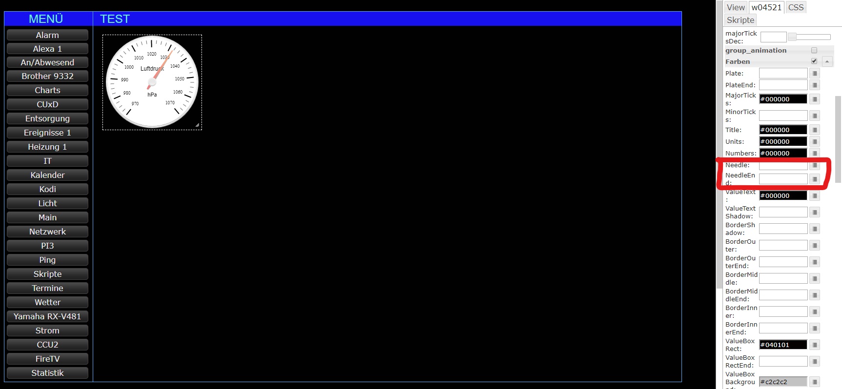

                                  Ursache gefunden (mehr log-Einstellungen im Browser gesetzt), verstehen tu ich es nicht
                                  Error: Error: can't create states object for javascript.0.wiffi.w_barometer(TypeError: this.animation is null): "set@http://192.168.1.55:8082/vis/widgets/canvas-gauges/js/gauge.min.js:26:30596\nupdateGauge@http://192.168.1.55:8082/vis/index.html?tablet#uebersicht:3616:39\nt.dispatch@http://192.168.1.55:8082/vis/lib/js/can.custom.min.js:18:1239\nstop@http://192.168.1.55:8082/vis/lib/js/can.custom.min.js:44:440\n_setAttrs@http://192.168.1.55:8082/vis/lib/js/can.custom.min.js:48:4013\nattr@http://192.168.1.55:8082/vis/lib/js/can.custom.min.js:48:1566\nupdateState@http://192.168.1.55:8082/vis/js/vis.js:2609:17\nonUpdate/<@http://192.168.1.55:8082/vis/js/vis.js:3149:17\n_setTimeout/<@http://192.168.1.55:8082/vis/js/vis.js:3361:9\n"
                                  das betreffende widget wäre:
                                  [{"tpl":"tplCGradialGauge","data":{"g_fixed":false,"g_visibility":false,"g_css_font_text":false,"g_css_background":false,"g_css_shadow_padding":false,"g_css_border":false,"g_gestures":false,"g_signals":false,"g_last_change":false,"visibility-cond":"==","visibility-val":1,"visibility-groups-action":"hide","factor":"1","valueOffset":"0","hCount":"1","minorTicks":"4","needle":"true","needleShadow":false,"needleType":"arrow","borders":"true","borderOuterWidth":"2","borderMiddleWidth":"2","borderInnerWidth":"2","borderShadowWidth":"2","valueBox":false,"ticksAngle":"282","startAngle":"38","lc-type":"last-change","lc-is-interval":true,"lc-is-moment":false,"lc-format":"","lc-position-vert":"top","lc-position-horz":"right","lc-offset-vert":0,"lc-offset-horz":0,"lc-font-size":"12px","lc-font-family":"","lc-font-style":"","lc-bkg-color":"","lc-color":"","lc-border-width":"0","lc-border-style":"","lc-border-color":"","lc-border-radius":10,"lc-zindex":0,"oid":"javascript.0.wiffi.w_barometer","title":"Luftdruck","minValue":"970","maxValue":"1070","valueBoxStroke":"0","valueBoxBorderRadius":"0","units":"hPa","g_animation":false,"animation":"true","majorTicks":"11","majorTicksInt":"0","valueTextShadow":false,"valueInt":"","valueDec":"0","needleCircleSize":"","signals-cond-0":"==","signals-val-0":true,"signals-icon-0":"/vis/signals/lowbattery.png","signals-icon-size-0":0,"signals-blink-0":false,"signals-horz-0":0,"signals-vert-0":0,"signals-hide-edit-0":false,"signals-cond-1":"==","signals-val-1":true,"signals-icon-1":"/vis/signals/lowbattery.png","signals-icon-size-1":0,"signals-blink-1":false,"signals-horz-1":0,"signals-vert-1":0,"signals-hide-edit-1":false,"signals-cond-2":"==","signals-val-2":true,"signals-icon-2":"/vis/signals/lowbattery.png","signals-icon-size-2":0,"signals-blink-2":false,"signals-horz-2":0,"signals-vert-2":0,"signals-hide-edit-2":false,"valueText":"","colorNumbers":"#000000","colorMajorTicks":"#000000","fontValueSize":"41","fontValueWeight":"bold","colorNeedleEnd":"{h:javascript.0.wiffi.w_barometer; h > \"1030\" ? \"#006400\" : h < \"1010\" ? \"#FF0000\" : \"#000000\"}","colorBorderInner":"","colorValueBoxBackground":"#c2c2c2","colorBorderOuter":"","colorValueBoxRect":"#040101","colorValueText":"#000000","colorNeedle":"{h:javascript.0.wiffi.w_barometer; h > \"1030\" ? \"#006400\" : h < \"1010\" ? \"#FF0000\" : \"#000000\"}","colorValueBoxShadow":"","colorPlate":"","colorTitle":"#000000","colorUnits":"#000000"},"style":{"left":"824px","top":"164px","width":"202px","height":"194px","z-index":15},"widgetSet":"canvas-gauges"}]

                                        • sigi234S Online
                                          sigi234S Online
                                          sigi234
                                          Du hattest bei den Markierungen falsche Werte drinnen….......diese habe ich entfernt und es geht.
