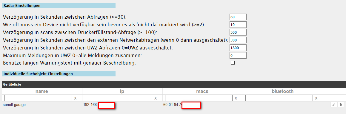

            so ..
            1 Reply Last reply

              Bleibt grün .. schaut aber weiterhin nicht so gut aus …
              host.ioBroker	2018-10-28 18:55:40.425	error	instance system.adapter.radar.0 terminated with code null ()
              host.ioBroker	2018-10-28 18:55:40.425	warn	instance system.adapter.radar.0 terminated due to SIGABRT
              Caught	2018-10-28 18:55:40.425	error	by controller[0]: 0: ../deps/uv/src/unix/core.c:883: uv__io_stop: Assertion `w->fd >= 0' failed.
              radar.0	2018-10-28 18:55:40.412	info	radar adapter initialized 1 devices, ExternalNetwork = 300.
              radar.0	2018-10-28 18:55:39.618	info	New IP address 5.147.2.178
              radar.0	2018-10-28 18:55:39.227	info	MyIP Error { Error: connect ETIMEDOUT 198.27.74.146:80 at TCPConnectWrap.afterConnect [as oncomplete] (net.js:1191:14) errno: 'ETIMEDOUT', code: 'ETIMEDOUT', syscall: 'connect', address:
              radar.0	2018-10-28 18:49:07.120	info	Init item sonoff-garage with { name: 'sonoff-garage', ip: '192.168.xx.6xx2', macs: '60:01:94:A3:xx:xx', bluetooth: '', id: 'sonoff-garage', hasMAC: [ '60:01:94:A3:61:81' ], hasBT: false,
              radar.0	2018-10-28 18:49:04.836	info	BT Bin Dir = '/opt/iobroker/node_modules/iobroker.radar\bin\bluetoothview\'
              radar.0	2018-10-28 18:49:04.836	info	radar set to scan every 60 sec and printers every 500 scans.
              radar.0	2018-10-28 18:49:04.816	info	starting. Version 1.1.3 in /opt/iobroker/node_modules/iobroker.radar, node: v8.12.0
              host.ioBroker	2018-10-28 18:49:04.411	info	instance system.adapter.radar.0 started with pid 9712
              host.ioBroker	2018-10-28 18:48:34.405	info	Restart adapter system.adapter.radar.0 because enabled
              host.ioBroker	2018-10-28 18:48:34.404	error	instance system.adapter.radar.0 terminated with code null ()
              1 Reply Last reply
