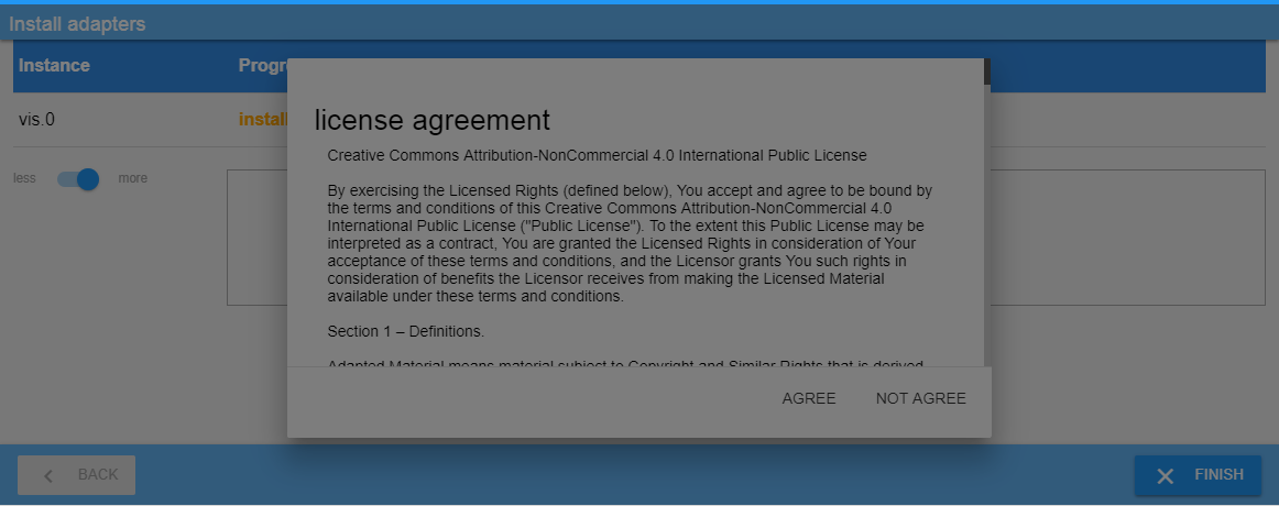

    Good evening.
    When I try to install Vis.0, I need to accept a "Creative Commons Attribution-NonCommercial 4.0 International Public licence" agreement. Problem is the screen grays out, and I can't press Agree.
    Can I somehow do this through terminal instead?

      You speak about licenses, but I can guess, that you mean 2 different licenses.
      Have you solved this problem? Do you have screenshot?

        Hi
        Thanks for your reply.
        I figured out the Vis licence part, and got the licence at https://iobroker.net.
        As far as I can see, this licence is entered after Vis is installed.
        The problem is the EULA I need to accept when installing Vis. It is not possible to press "Agree" because the screen is greyed out.
        Can I install Vis in the terminal instead?
        If this is possible, I can enter the licence key in iobroker.
        Regards Henrik

          Hi
          It looks like Vis is installed already as I see Vis.0.
          Are you sure the license pops up at the installation or after Vis has been installed ?
          Can you please run this command at the console and share the output ?
          cd /opt/ iobroker/
          sudo iobroker update
          This will give us an overview of all available adapters and shows which are installed.
          What browser are u using?
          Did you:
          • try a different browser
          • scroll down to the bottom of the license to check if the accept is not greyed out ?
          ~ cheers
          Dutch

            I tried following browsers:
            Chrome
            Chromium (both from a pc, and localy on the PI)
            MS Explorer.
            Same result.
            The EULA pops up before installation. It is not possible to scroll down passed the grey area.

              ok thank you, clear vis is not installed.
              Pleasr try to install vis by using the command line and not the webinterface, lets see if this wil fix your specific issue.
              cd /opt/iobroker/
              sudo iobroker add vis
              please share your results and outcome of this command

                Tried this, and it installs the object Vis and is shown as installed in the list from your command earlier, but the instance is not installed. The object has no icon in the Name column, and seems not to work. Properly because I can't apply the licence.
                If I try to run the device discover, Vis.0 appears as not installed. Try to install it, and same problem over again.
                Is there another way to install the instance?
