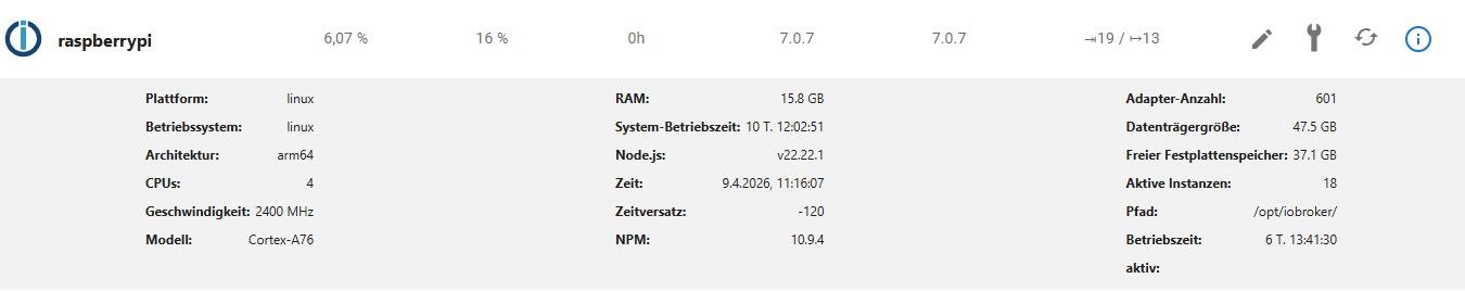

      Hab ich aber doch.

        @Thomas-Braun sagte:
        Dringend auf node_22.x setzen.
        Hab ich aber doch.
        @fuzzy1955 sagte:
        Hab ich aber doch.
        GUIs lügen anscheinend
        @fuzzy1955 sagte:
        Hit:5 https://deb.nodesource.com/node_20.x nodistro InRelease
        Oder deine Quellen sind nicht ok!
        iob nodejs-update 22 sollte das fixen
        Vorher mit node -v prüfen und hinterher nochmal
        fuzzy1955F 1 Antwort Letzte Antwort
                iob diag
                Danke, Thomas! Kannst du mal drüberschauen? Die Fehler unter DANGER betreffen offenbar CVE's, für die es noch keinen Patch gibt.

                  The current Node.js version (v22.22.1) is vulnerable to the following CVEs:
                  CVE-2026-21637(high): A flaw in Node.js TLS error handling leaves `SNICallback` invocations unprotected against synchronous exceptions, while the equivalent ALPN and PSK callbacks were already addressed in CVE-2026-21637. This represents an incomplete fix of that prior vulnerability.
                  When an `SNICallback` throws synchronously on unexpected input the exception bypasses TLS error handlers and propagates as an uncaught exception, crashing the Node.js process.
                  * This vulnerability affects all Node.js versions that received the CVE-2026-21637 fix, including **20.x, 22.x, 24.x, and 25.x**, on any TLS server where `SNICallback` may throw on unexpected `servername` input.
                  Patched versions: ^20.20.2 || ^22.22.2 || ^24.14.1 || ^25.8.2
                  CVE-2026-21710(high): A flaw in Node.js HTTP request handling causes an uncaught `TypeError` when a request is received with a header named `__proto__` and the application accesses `req.headersDistinct`.
                  When this occurs, `dest["__proto__"]` resolves to `Object.prototype` rather than `undefined`, causing `.push()` to be called on a non-array. This exception is thrown synchronously inside a property getter and cannot be intercepted by `error` event listeners, meaning it cannot be handled without wrapping every `req.headersDistinct` access in a `try/catch`.
                  * This vulnerability affects all Node.js HTTP servers on **20.x, 22.x, 24.x, and v25.x**
                  CVE-2026-21713(medium): A flaw in Node.js HMAC verification uses a non-constant-time comparison when validating user-provided signatures, potentially leaking timing information proportional to the number of matching bytes. Under certain threat models where high-resolution timing measurements are possible, this behavior could be exploited as a timing oracle to infer HMAC values.
                  Node.js already provides timing-safe comparison primitives used elsewhere in the codebase, indicating this is an oversight rather than an intentional design decision.
                  This vulnerability affects **20.x, 22.x, 24.x, and 25.x**.
                  CVE-2026-21714(medium): A memory leak occurs in Node.js HTTP/2 servers when a client sends WINDOW_UPDATE frames on stream 0 (connection-level) that cause the flow control window to exceed the maximum value of 2³¹-1. The server correctly sends a GOAWAY frame, but the Http2Session object is never cleaned up.
                  This vulnerability affects HTTP2 users on Node.js 20, 22, 24 and 25.
                  CVE-2026-21715(low): A flaw in Node.js Permission Model filesystem enforcement leaves `fs.realpathSync.native()` without the required read permission checks, while all comparable filesystem functions correctly enforce them.
                  As a result, code running under `--permission` with restricted `--allow-fs-read` can still use `fs.realpathSync.native()` to check file existence, resolve symlink targets, and enumerate filesystem paths outside of permitted directories.
                  This vulnerability affects **20.x, 22.x, 24.x, and 25.x** processes using the Permission Model where `--allow-fs-read` is intentionally restricted.
                  CVE-2026-21716(low): An incomplete fix for CVE-2024-36137 leaves `FileHandle.chmod()` and `FileHandle.chown()` in the promises API without the required permission checks, while their callback-based equivalents (`fs.fchmod()`, `fs.fchown()`) were correctly patched.
                  As a result, code running under `--permission` with restricted `--allow-fs-write` can still use promise-based `FileHandle` methods to modify file permissions and ownership on already-open file descriptors, bypassing the intended write restrictions.
                  This vulnerability affects **20.x, 22.x, 24.x, and 25.x** processes using the Permission Model where `--allow-fs-write` is intentionally restricted.
                  CVE-2026-21717(medium): A flaw in V8's string hashing mechanism causes integer-like strings to be hashed to their numeric value, making hash collisions trivially predictable. By crafting a request that causes many such collisions in V8's internal string table, an attacker can significantly degrade performance of the Node.js process.
                  The most common trigger is any endpoint that calls `JSON.parse()` on attacker-controlled input, as JSON parsing automatically internalizes short strings into the affected hash table.

                  @fuzzy1955 sagte:
                  Doch es gibt patches
                  @fuzzy1955 sagte:
                    @fuzzy1955 sagte:
                    @fuzzy1955 sagte:
                    fuzzy1955F Offline
                    fuzzy1955F Offline
                    fuzzy1955
                    @Homoran sagte:
                    22.22.2
                    Pardon ... wie spiele ich den Patch ein?
                    Smart-Home-Automation unter IOB auf RASPI5, 16GB RAM, 50GB SSD, MariaSQL, VIS-2.
                    Anfang 2025 war ich Newbie in Sachen RaspBerry, Linux und IOB.
                    Jetzt läuft alles konstant gut und ich gebe gern meine Erfahrungen und mein Wissen an die Forums-User/Innen weiter.
                    Großes Danke an alle tatkräftigen Helfer im Forum!
                    • fuzzy1955F fuzzy1955
                      iob diag
                      ```bash
                        fuzzy1955 sagte:
                        @Homoran Ich hab's schon gefunden.
                        hat das Problem behoben. Danke für die Unterstützung!

                        @fuzzy1955 sagte:
                        Und jetzt sieh dir mal die Liste an.
                        Vorher war nur die 22.22.1 aus dem 22er Zweig!
                        Wie hast du denn auf node22 gewechselt??
                        Das ist wohl nie vollständig im System angekommen.
                        @fuzzy1955 sagte:
                        Hattest du das noch nicht gemacht?
                        Homoran sagte:

                          @fuzzy1955 sagte:
                          @fuzzy1955 sagte:
                          Homoran sagte:

                          @Homoran sagte:
                          Das hab ich ja vorhin gestartet und darauf iob diag gefahren !?

                            @Homoran sagte:
                            @fuzzy1955 sagte:
                            Homoran sagte:
                            Das hab ich dir doch direkt zu Beginn geraten.
                            Wir gehen immer davon aus, dass so etwas auch gemacht wird.
                            fuzzy1955F 2 Antworten Letzte Antwort

                              @Homoran sagte:
                              Pardon, aber ich blicke noch nicht ganz durch. Wenn ich
                              iob stop
                              iob fix
                              iob update
                              iob upgrade self
                              iob upgrade
                              sudo apt update
                              sudo apt full-upgrade -y
                              sudo apt autoremove -y
                              iob fix
                              regelmäßig starte, wann muss ich dann
                              auch noch starten?

                                @Homoran sagte:
                                Und warum zeigt es die Version verschieden an?

                                  @fuzzy1955 sagte:
                                  wann muss ich dann
                                  auch noch starten?
                                  Wenn
                                  Homoran sagte:
                                  sind!
                                  Dazu muss man aber u.a. wissen
                                  Homoran sagte:
                                  Das scheint nicht sauber gemacht worden zu sein.
                                  Spätestens beim darauffolgenden sudo apt update && sudo apt upgrade muss ein entsprechender Error/warn aufgetreten sein, dass der Key nicht passt

                                    @fuzzy1955
                                    Nein, wenn du dir die Quelle für nodejs@22 nicht wieder löschst.
                                    Hier sieht man nämlich ganz genau, das du zwar mal irgendwann irgendwie 22.22.1-1nodesource1 eingespielt hast, es aber keine ordentliche Quellel gibt. Die ist nämlich auf nodejs@20 eingestellt:
                                    nodejs:
                                      Installed: 22.22.1-1nodesource1
                                      Candidate: 22.22.1-1nodesource1
                                      Version table:
                                     *** 22.22.1-1nodesource1 100
                                            100 /var/lib/dpkg/status
                                         20.20.2-1nodesource1 600
                                            500 https://deb.nodesource.com/node_20.x nodistro/main arm64 Packages
                                         20.20.1-1nodesource1 600

                                      @fuzzy1955 sagte:
                                      Weil du die 22.22.1 da ohne Anbindung an die Quelle freischwebend im System hast. Dein Paketmanager sieht aber nur nodejs@20 Versionen, daher kann es da kein Update geben. Woher auch?
                                      Der Admin schaut aber direkt bei nodejs.org nach der letzten Veröffentlichung aus dem 22er-Zweig und zeigt die natürlich an.

                                        @Homoran sagte:
                                        Nein, das nicht. Der key ist der gleiche für alle nodesource-Repos.
