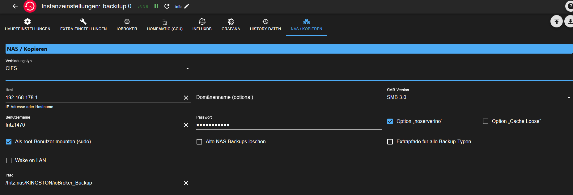

      Hallo zusammen!
      Nach Updates zuletzt im iobroker, will mein Backitup nicht mehr, der sonst problemlos immer durchgelaufen ist.
      Backitup gibt folgendes aus:
      21:40:13.860
      INFO
      gui
      Backup gestartet ...
      21:40:23.940
      DEBUG
      mount

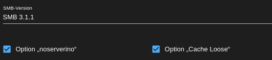

      cifs-mount command: "sudo mount -t cifs -o username=iobroker,password=****,noserverino,rw,forceuid,uid=iobroker,forcegid,gid=iobroker,file_mode=0777,dir_mode=0777,vers=3.0 //192.168.178.1/fritz.nas/KINGSTON/ioBroker_Backup /opt/iobroker/backups"
      21:40:23.990
      DEBUG
      mount
      mount successfully completed
      21:40:23.999
      DEBUG
      mount
      done
      21:40:27.580
      DEBUG
      iobroker
      host.iobroker 16346 objects saved
      21:40:28.215
      DEBUG
      iobroker
      host.iobroker Validating backup ...
      21:40:28.257
      DEBUG
      iobroker
      host.iobroker "config.json" is valid
      21:40:28.264
      DEBUG
      iobroker
      host.iobroker "objects.jsonl" exists
      host.iobroker "states.jsonl" exists
      21:40:28.559
      DEBUG
      iobroker
      host.iobroker JSONL lines are valid
      21:40:28.599
      DEBUG
      iobroker
      host.iobroker The backup is valid!
      21:40:28.911
      ERROR
      iobroker
      host.iobroker Cannot pack directory /opt/iobroker/node_modules/iobroker.js-controller/tmp/backup: EACCES: permission denied, open '/opt/iobroker/backups/iobroker_2025_09_12-21_40_25_backupiobroker.tar.gz'
      21:40:28.939
      DEBUG
      iobroker
      Cannot create backup: EACCES: permission denied, open '/opt/iobroker/backups/iobroker_2025_09_12-21_40_25_backupiobroker.tar.gz'
      21:40:29.981
      DEBUG
      iobroker
      done
      21:40:30.139
      DEBUG
      influxDB
      InfluxDB-Backup started ...
      21:40:30.142
      DEBUG
      influxDB
      Start InfluxDB Backup ...
      21:40:30.208
      WARN
      influxDB
      InfluxDB Backup tmp directory cannot created
      21:40:30.239
      DEBUG
      influxDB
      InfluxDB Backup tmp directory created
      21:40:30.348
      DEBUG
      influxDB
      done
      21:40:31.078
      DEBUG
      historyDB
      compress from historyDB started ...
      21:40:31.156
      ERROR
      historyDB
      Error: EACCES: permission denied, open '/opt/iobroker/backups/historyDB_2025_09_12-21_40_32_backupiobroker.tar.gz'

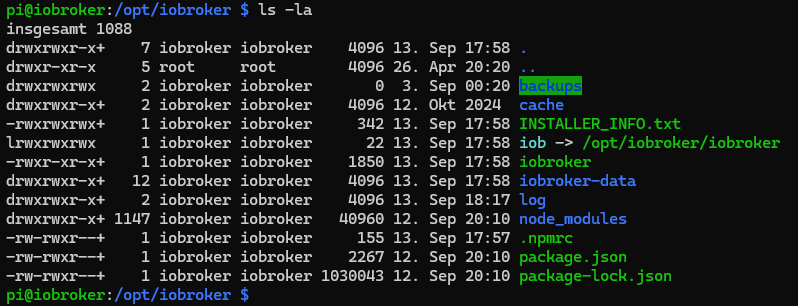

      //192.168.178.1/fritz.nas/KINGSTON/ioBroker_Backup cifs       58G   19G   39G  33% /opt/iobroker/backups
      [Tue Aug 19 15:50:15 2025] Kernel command line: reboot=w coherent_pool=1M 8250.nr_uarts=1 pci=pcie_bus_safe cgroup_disable=memory numa_policy=interleave nvme.max_host_mem_size_mb=0  numa=fake=8 system_heap.max_order=0 smsc95xx.macaddr=2C:CF:67:32:3A:99 vc_mem.mem_base=0x3fc00000 vc_mem.mem_size=0x40000000  console=ttyAMA10,115200 console=tty1 root=PARTUUID=c4e97527-02 rootfstype=ext4 fsck.repair=yes rootwait
      [Tue Aug 19 15:50:18 2025] EXT4-fs (mmcblk0p2): mounted filesystem 56f80fa2-e005-4cca-86e6-19da1069914d ro with ordered data mode. Quota mode: none.
      [Tue Aug 19 15:50:21 2025] EXT4-fs (mmcblk0p2): re-mounted 56f80fa2-e005-4cca-86e6-19da1069914d r/w.
      Show mounted filesystems:
      TARGET                  SOURCE                                             FSTYPE OPTIONS
      /                       /dev/mmcblk0p2                                     ext4   rw,noatime
      |-/boot/firmware        /dev/mmcblk0p1                                     vfat   rw,relatime,fmask=0022,dmask=0022,codepage=437,iocharset=ascii,shortname=mixed,errors=remount-ro
      `-/opt/iobroker/backups //192.168.178.1/fritz.nas/KINGSTON/ioBroker_Backup cifs   rw,relatime,vers=3.0,cache=strict,upcall_target=app,username=iobroker,uid=1001,forceuid,gid=1001,forcegid,addr=192.168.178.1,file_mode=0777,dir_mode=0777,soft,nounix,mapposix,reparse=nfs,rsize=65536,wsize=65536,bsize=1048576,retrans=1,echo_interval=60,actimeo=1,closetimeo=1

        Dann zeig mal die Einstellungen im Adapter zum cifs-mount. Sollte so aussehen:
        Cyberraph 1 Reply Last reply Reply Quote 0
        • Cyberraph
          Cyberraph @Thomas Braun last edited by
          @thomas-braun
          Einstellungen waren zuvor bei mir so:
          Nach Änderung auf deine Einstellungen leider noch Fehler beim Backup Erstellen:

          Jetzt habe ich es nochmal gegengecheckt, ob auch wirklich Benutzer und Passwort stimmen für das "NAS" = USB-Stick an der Fritzbox.
          Das stimmt bzw. Passwort nochmal neu angelegt damit ich sicher bin und neu / korrekt hinterlegt.
          Weiterhin fehler beim Backup Erstellen:

          Hab auch nochmal auf dem Host geschaut bzgl. Rechte...
          In dem Verzeichnis, wo der Fehler sagt da gebe es Probleme mit den Zugriffsrecheten
          hat überall der Benutzer und die Gruppe "iobroker" alle Rechte.
          Sehr komisch, da es ja vor ein paar Wochen / vor ein paar Updates im iobroker und über apt normal lief.
          Das letzte Backup war vom 03.09.2025, das regulär durchlief.
