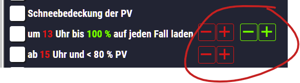

    Gibt es eine Möglichkeit einen Datenpunkt per cklick auf zwei VIS Button die Volume +1 und -1 zu steuern !? die Volume läuft in dB.
    Ich weiß nicht, wie man das realisieren kann

      ja mit dem widget jqui button state un ein bisschen binding
      hier für den datenpunkt wert, der mit typ nummer angelegt wurde
      [{"tpl":"tplJquiButtonState","data":{"oid":"0_userdata.0.wert","g_fixed":true,"g_visibility":false,"g_css_font_text":true,"g_css_background":true,"g_css_shadow_padding":true,"g_css_border":true,"g_gestures":false,"g_signals":false,"g_last_change":false,"buttontext":"+1 db","signals-cond-0":"==","signals-val-0":true,"signals-icon-0":"/vis/signals/lowbattery.png","signals-icon-size-0":0,"signals-blink-0":false,"signals-horz-0":0,"signals-vert-0":0,"signals-hide-edit-0":false,"signals-cond-1":"==","signals-val-1":true,"signals-icon-1":"/vis/signals/lowbattery.png","signals-icon-size-1":0,"signals-blink-1":false,"signals-horz-1":0,"signals-vert-1":0,"signals-hide-edit-1":false,"signals-cond-2":"==","signals-val-2":true,"signals-icon-2":"/vis/signals/lowbattery.png","signals-icon-size-2":0,"signals-blink-2":false,"signals-horz-2":0,"signals-vert-2":0,"signals-hide-edit-2":false,"lc-type":"last-change","lc-is-interval":true,"lc-is-moment":false,"lc-format":"","lc-position-vert":"top","lc-position-horz":"right","lc-offset-vert":0,"lc-offset-horz":0,"lc-font-size":"12px","lc-font-family":"","lc-font-style":"","lc-bkg-color":"","lc-color":"","lc-border-width":"0","lc-border-style":"","lc-border-color":"","lc-border-radius":10,"lc-zindex":0,"value":"{0_userdata.0.wert;+(1)}","visibility-cond":"==","visibility-val":1,"visibility-groups-action":"hide","class":"mytime","html_append":""},"style":{"left":"491px","top":"138px","color":"white","font-weight":"lighter","font-size":"x-small","background":"","border-width":"2px","border-style":"solid","border-color":"white","border-radius":"10px","background-color":"#303030 !important","box-shadow":"2px 2px 3px rgba(20, 20, 20, 50)","width":"55px","height":"23px"},"widgetSet":"jqui"}]

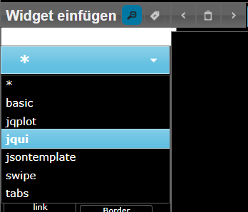

        @oliverio sagte in Volume up/down:
        jqui button state
        schon mal cool aber welcher ist jqui
        P OliverIOO 2 Antworten Letzte Antwort

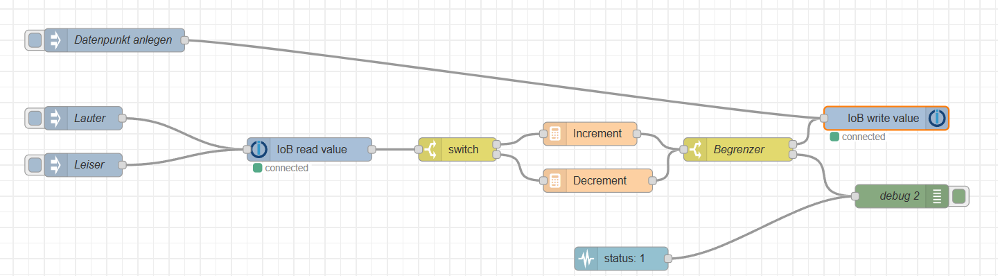

          @aphofis Passend zum Thema Node-Red:

            [{"tpl":"tplVis-materialdesign-Button-Adition","data":{"oid":"0_userdata.0.strom.tibber.extra.tibberNutzenManuellHH","g_fixed":false,"g_visibility":true,"g_css_font_text":false,"g_css_background":false,"g_css_shadow_padding":false,"g_css_border":false,"g_gestures":false,"g_signals":false,"g_last_change":false,"visibility-cond":"==","visibility-val":"","visibility-groups-action":"hide","buttonStyle":"outlined","vibrateOnMobilDevices":"50","buttontext":" ","textFontFamily":"#mdwTheme:vis-materialdesign.0.fonts.button.default.text","textFontSize":"#mdwTheme:vis-materialdesign.0.fontSizes.button.default.text","mdwButtonPrimaryColor":"red","mdwButtonSecondaryColor":"#mdwTheme:vis-materialdesign.0.colors.button.default.secondary","image":"minus","iconPosition":"left","signals-cond-0":"==","signals-val-0":true,"signals-icon-0":"/vis/signals/lowbattery.png","signals-icon-size-0":0,"signals-blink-0":false,"signals-horz-0":0,"signals-vert-0":0,"signals-hide-edit-0":false,"signals-cond-1":"==","signals-val-1":true,"signals-icon-1":"/vis/signals/lowbattery.png","signals-icon-size-1":0,"signals-blink-1":false,"signals-horz-1":0,"signals-vert-1":0,"signals-hide-edit-1":false,"signals-cond-2":"==","signals-val-2":true,"signals-icon-2":"/vis/signals/lowbattery.png","signals-icon-size-2":0,"signals-blink-2":false,"signals-horz-2":0,"signals-vert-2":0,"signals-hide-edit-2":false,"lc-type":"last-change","lc-is-interval":true,"lc-is-moment":false,"lc-format":"","lc-position-vert":"top","lc-position-horz":"right","lc-offset-vert":0,"lc-offset-horz":0,"lc-font-size":"12px","lc-font-family":"","lc-font-style":"","lc-bkg-color":"","lc-color":"","lc-border-width":"0","lc-border-style":"","lc-border-color":"","lc-border-radius":10,"lc-zindex":0,"value":"-1","iconHeight":"35","labelWidth":"7","minmax":"0","visibility-oid":""},"style":{"left":"379px","top":"252px","width":"34px","height":"34px","z-index":"5"},"widgetSet":"materialdesign"}]

              OliverIOO Offline
              OliverIOO Offline
              OliverIO
              @aphofis
              ist in vis im standard schon mit dabei
              Meine Adapter und Widgets
              Links im Profil
              AphofisA 1 Antwort Letzte Antwort

                AphofisA Offline
                AphofisA Offline
                Aphofis
                @oliverio
                Na da hab ich nicht gesucht ! Dann teste ich das mal

                  AphofisA Offline
                  AphofisA Offline
                  Aphofis
                  schrieb am zuletzt editiert von Aphofis
                  @peterfido
                  Hammer ! Es funktioniert perfekt!!
                  Ich danke dir vielmals

                          "name": "Lauter",
                          "props": [
                                  "p": "wert",
                                  "v": "1",
                                  "vt": "num"
                                  "p": "topic",
                                  "vt": "str"
                          "repeat": "",
                          "crontab": "",
                          "once": false,
                          "onceDelay": 0.1,
                          "topic": "denon.0.zoneMain.volumeUp",
                          "x": 210,
                          "y": 200,
                          "wires": [
                                  "49fc06f0f5138508"
                          "id": "49fc06f0f5138508",
                          "type": "ioBroker get",
                          "z": "bb2b547896584a3c",
                          "name": "volume",
                          "topic": "denon.0.zoneMain.volume",
                          "attrname": "payload",
                          "payloadType": "value",
                          "errOnInvalidState": "nothing",
                          "x": 400,
                          "y": 220,
                          "wires": [
                                  "e06b7ab92a45e279"
                          "id": "f9d19bccd86e141b",
                          "type": "calculator",
                          "name": "",
                          "inputMsgField": "payload",
                          "outputMsgField": "payload",
                          "operation": "inc",
                          "constant": "1",
                          "round": false,
                          "truncate": false,
                          "decimals": 0,
                          "decimals2": 0,
                          "x": 680,
                          "y": 200,
                          "wires": [
                                  "89dfde5ee258875f"
                          "id": "e06b7ab92a45e279",
                          "type": "switch",
                          "name": "",
                          "property": "wert",
                          "propertyType": "msg",
                          "rules": [
                                  "t": "eq",
                                  "v": "1",
                                  "vt": "num"
                                  "t": "eq",
                                  "v": "-1",
                                  "vt": "num"
                          "checkall": "true",
                          "repair": false,
                          "outputs": 2,
                          "x": 530,
                          "y": 220,
                          "wires": [
                                  "f9d19bccd86e141b"
                                  "b455921bd96e4fec"
                          "id": "b455921bd96e4fec",
                          "name": "",
                          "operation": "dec",
                          "constant": "1",
                          "round": false,
                          "truncate": false,
                          "decimals": 0,
                          "decimals2": 0,
                          "x": 670,
                          "y": 240,
                          "wires": [
                                  "89dfde5ee258875f"
                          "id": "89dfde5ee258875f",
                          "type": "switch",
                          "name": "Begrenzer",
                          "property": "payload",
                          "rules": [
                                  "t": "btwn",
                                  "v": "0",
                                  "vt": "num",
                                  "v2": "100",
                                  "v2t": "num"
                                  "t": "else"
                          "checkall": "true",
                          "repair": false,
                          "outputs": 2,
                          "x": 850,
                          "y": 220,
                          "wires": [
                                  "aa1e6386ec92a4c9"
                                  "a0e716b22b03e8ed"
                          "id": "a0e716b22b03e8ed",
                          "type": "debug",
                          "name": "Denon Volume",
                          "active": true,
                          "tosidebar": true,
                          "console": false,
                          "tostatus": false,
                          "complete": "payload",
                          "targetType": "msg",
                          "statusVal": "",
                          "statusType": "auto",
                          "x": 1040,
                          "y": 240,
                          "wires": []
                          "id": "9aad546bed69dd79",
                          "type": "status",
                          "name": "",
                          "scope": [
                              "89dfde5ee258875f"
                          "x": 860,
                          "y": 280,
                          "wires": [
                                  "a0e716b22b03e8ed"
                          "id": "cb6e8fedb1ea0d1c",
                          "type": "ioBroker in",
                          "name": "Volume",
                          "attrname": "wert",
                          "topic": "0_userdata.0.GordonX-Home.Multimedia.Denon_Volume",
                          "onlyack": "",
                          "func": "all",
                          "gap": "",
                          "fireOnStart": "false",
                          "outFormat": "MQTT",
                          "x": 210,
                          "y": 140,
                          "wires": [
                                  "49fc06f0f5138508"
                          "id": "26b003aebac0a118",
                          "type": "inject",
                          "name": "Datenpunkt anlegen",
                          "props": [
                                  "p": "payload"
                                  "p": "topic",
                                  "vt": "str"
                          "repeat": "",
                          "crontab": "",
                          "once": false,
                          "onceDelay": 0.1,
                          "payload": "50",
                          "payloadType": "num",
                          "x": 830,
                          "y": 160,
                          "wires": [
                                  "aa1e6386ec92a4c9"
