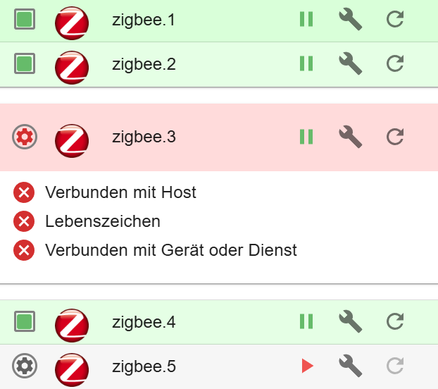

        Andreas.S @Andreas.S last edited by
        @andreas-s
        Hier nun mein Bericht nach Ausfall der Instanz Zigbee3
        Dieses mal sind alle 3 rot - meistens ist es nur Verbunden mit Gerät oder Dienst und die anderen sind noch grün
        Der CC26X2R1ist ja direkt per LAN-Kabel angebunden und erreichbar
        Das Protokoll für die Instanz Zigbee3 an diesem Tag sieht so aus ...

        	Zeile  596: 2025-05-07 11:28:45.376 - warn: zigbee.3 (156602) Could not perform strict object check of state zigbee.3.00158d00040aa64d.link_quality: DB closed
        	Zeile  597: 2025-05-07 11:28:45.376 - warn: zigbee.3 (156602) Could not perform strict object check of state zigbee.3.00158d0003d2dfaf.available: DB closed
        	Zeile  598: 2025-05-07 11:28:45.376 - warn: zigbee.3 (156602) Could not perform strict object check of state zigbee.3.00158d0003d2dfaf.available: DB closed
        	Zeile  599: 2025-05-07 11:28:45.377 - warn: zigbee.3 (156602) Could not perform strict object check of state zigbee.3.00158d0003d2dfaf.link_quality: DB closed
        	Zeile  600: 2025-05-07 11:28:45.377 - warn: zigbee.3 (156602) Could not perform strict object check of state zigbee.3.00158d0003d2dfaf.link_quality: DB closed
        	Zeile  601: 2025-05-07 11:28:45.378 - warn: zigbee.3 (156602) Could not perform strict object check of state zigbee.3.00158d0006795c22.available: DB closed
        	Zeile  602: 2025-05-07 11:28:45.378 - warn: zigbee.3 (156602) Could not perform strict object check of state zigbee.3.00158d0006795c22.available: DB closed
        	Zeile  603: 2025-05-07 11:28:45.378 - warn: zigbee.3 (156602) Could not perform strict object check of state zigbee.3.00158d0006795c22.link_quality: DB closed
        	Zeile  604: 2025-05-07 11:28:45.379 - warn: zigbee.3 (156602) Could not perform strict object check of state zigbee.3.00158d0006795c22.link_quality: DB closed
        	Zeile  605: 2025-05-07 11:28:45.379 - warn: zigbee.3 (156602) Could not perform strict object check of state zigbee.3.00158d000407fd80.available: DB closed
        	Zeile  606: 2025-05-07 11:28:45.380 - warn: zigbee.3 (156602) Could not perform strict object check of state zigbee.3.00158d000407fd80.available: DB closed
        	Zeile  607: 2025-05-07 11:28:45.380 - warn: zigbee.3 (156602) Could not perform strict object check of state zigbee.3.00158d000407fd80.link_quality: DB closed
        	Zeile  611: 2025-05-07 11:28:45.585 - error: host.iob2022 instance system.adapter.zigbee.3 terminated with code 6 (UNCAUGHT_EXCEPTION)
        	Zeile  612: 2025-05-07 11:28:45.586 - info: host.iob2022 Restart adapter system.adapter.zigbee.3 because enabled
        	Zeile  615: 2025-05-07 11:29:16.473 - info: host.iob2022 instance system.adapter.zigbee.3 in version "2.0.5" started with pid 156618
        	Zeile  616: 2025-05-07 11:29:19.860 - info: zigbee.3 (156618) starting. Version 2.0.5 in /opt/iobroker/node_modules/iobroker.zigbee, node: v20.19.0, js-controller: 7.0.6
        	Zeile  617: 2025-05-07 11:29:19.886 - info: zigbee.3 (156618) init localConfig
        	Zeile  618: 2025-05-07 11:29:19.895 - info: zigbee.3 (156618) --> transmitPower : normal
        	Zeile  619: 2025-05-07 11:29:19.908 - info: zigbee.3 (156618) delete old Backup files. keep only last 10
        	Zeile  620: 2025-05-07 11:29:19.912 - info: zigbee.3 (156618) --- creating device debug ---
        	Zeile  621: 2025-05-07 11:29:19.914 - info: zigbee.3 (156618) Starting Adapter npm ...
        	Zeile  622: 2025-05-07 11:29:19.962 - info: zigbee.3 (156618) Installed Version: iobroker.zigbee@2.0.5 (Converters 23.6.0 Herdsman 3.5.1)
        	Zeile  623: 2025-05-07 11:29:19.964 - info: zigbee.3 (156618) Starting Zigbee-Herdsman
        	Zeile  628: 2025-05-07 11:30:03.054 - info: zigbee.3 (156618) Unable to obtain herdsman settings
        	Zeile  629: 2025-05-07 11:30:03.284 - error: zigbee.3 (156618) Starting zigbee-herdsman problem : SRSP - SAPI - readConfiguration after 6000ms
        	Zeile  630: 2025-05-07 11:30:03.286 - error: zigbee.3 (156618) Unhandled promise rejection. This error originated either by throwing inside of an async function without a catch block, or by rejecting a promise which was not handled with .catch().
        	Zeile  631: 2025-05-07 11:30:03.287 - error: zigbee.3 (156618) unhandled promise rejection: undefined
        	Zeile  632: 2025-05-07 11:30:03.288 - error: zigbee.3 (156618) undefined
        	Zeile  633: 2025-05-07 11:30:03.356 - info: zigbee.3 (156618) cleaned everything up...
        	Zeile  634: 2025-05-07 11:30:03.363 - info: zigbee.3 (156618) local config saved
        	Zeile  635: 2025-05-07 11:30:03.366 - info: zigbee.3 (156618) Saved local configuration data
        	Zeile  636: 2025-05-07 11:30:03.367 - info: zigbee.3 (156618) terminating
        	Zeile  637: 2025-05-07 11:30:03.370 - warn: zigbee.3 (156618) Terminated (UNCAUGHT_EXCEPTION): Without reason
        	Zeile  638: 2025-05-07 11:30:03.687 - error: zigbee.3 (156618) Failed to open the network: TypeError: Cannot read properties of undefined (reading 'permitJoin')
        	Zeile  644: 2025-05-07 11:30:03.700 - info: zigbee.3 (156618) terminating
        	Zeile  645: 2025-05-07 11:30:03.703 - warn: zigbee.3 (156618) Device 0x00158d000444ad85 "MCCGQ11LM" not found.
        	Zeile  646: 2025-05-07 11:30:03.704 - warn: zigbee.3 (156618) Device 0x0017880102b31fc2 "8718696449691" not found.
        	Zeile  647: 2025-05-07 11:30:03.705 - warn: zigbee.3 (156618) Device 0x00178801030dc382 "8718696449691" not found.
        	Zeile  648: 2025-05-07 11:30:03.706 - warn: zigbee.3 (156618) Device 0x00158d00028ecca8 "MCCGQ01LM" not found.
        	Zeile  649: 2025-05-07 11:30:03.707 - warn: zigbee.3 (156618) Device 0x00158d0003f29d41 "RTCGQ11LM" not found.
        	Zeile  650: 2025-05-07 11:30:03.707 - warn: zigbee.3 (156618) Device 0x00158d00040aa64d "MCCGQ11LM" not found.
        	Zeile  651: 2025-05-07 11:30:03.708 - warn: zigbee.3 (156618) Device 0x00158d0003d2dfaf "WSDCGQ11LM" not found.
        	Zeile  652: 2025-05-07 11:30:03.709 - warn: zigbee.3 (156618) Device 0x00158d0006795c22 "WSDCGQ11LM" not found.
        	Zeile  653: 2025-05-07 11:30:03.709 - warn: zigbee.3 (156618) Device 0x00158d000407fd80 "WSDCGQ11LM" not found.
        	Zeile  654: 2025-05-07 11:30:03.710 - warn: zigbee.3 (156618) Device 0x00158d0002f7bfb9 "WSDCGQ11LM" not found.
        	Zeile  655: 2025-05-07 11:30:03.712 - warn: zigbee.3 (156618) Device 0x7cb03eaa0a002eb9 "AB3257001NJ" not found.
        	Zeile  656: 2025-05-07 11:30:03.712 - warn: zigbee.3 (156618) Device 0x00158d0002ca12d8 "MCCGQ11LM" not found.
        	Zeile  657: 2025-05-07 11:30:03.713 - warn: zigbee.3 (156618) Device 0x00158d000444ac77 "MCCGQ11LM" not found.
        	Zeile  658: 2025-05-07 11:30:03.713 - warn: zigbee.3 (156618) Device 0x7cb03eaa00b22528 "AB3257001NJ" not found.
        	Zeile  659: 2025-05-07 11:30:03.714 - warn: zigbee.3 (156618) Device 0x00158d0009d0df86 "WSDCGQ11LM" not found.
        	Zeile  660: 2025-05-07 11:30:03.827 - info: zigbee.3 (156618) debug devices set to []
        	Zeile  663: 2025-05-07 11:30:04.166 - info: zigbee.3 (156618) terminating
        	Zeile  666: 2025-05-07 11:30:04.504 - error: host.iob2022 instance system.adapter.zigbee.3 terminated with code 6 (UNCAUGHT_EXCEPTION)
        	Zeile  667: 2025-05-07 11:30:04.505 - info: host.iob2022 Restart adapter system.adapter.zigbee.3 because enabled
        	Zeile  668: 2025-05-07 11:30:04.505 - warn: host.iob2022 Do not restart adapter system.adapter.zigbee.3 because restart loop detected
        In diesem Fall hat ein manueller Stopp und Start funktioniert. Der Workaround über Zigbee5 ist nur in Ausnahmefällen nötig. Danach läuft wieder alles.
        Asgothian 1 Reply Last reply Reply Quote 0
        • Asgothian
          Asgothian Developer @Andreas.S last edited by
          @andreas-s Es ist erkennbar das du ein Problem mit dem Netzwerk hast (LAN, nicht Zigbee):
          Zeile  471: 2025-05-07 11:26:16.751 - error: zigbee.3 (148527) Adapter disconnected, stopping
          Dieses tritt auf wenn der Zigbee-Herdsman nicht mit der Firmware auf dem Koordinator kommunizieren kann. Wann genau das passiert und welche Bedingungen da genau Auslöser sind kann ich nicht sagen, aber:
          Das was bei Dir genutzt wird ist 'Simulierte Serielle Kommunikation via TCP/IP' Das ist in sofern kritisch, als das bei der seriellen Kommunikation keinerlei Verzögerungen innerhalb der Kommunikation erlaubt sind. Die Kommunikation ist nicht in "Pakete" zerteilt die in sich asynchron kommen dürfen, sondern setzt einen kontinuierlichen Datenstrom zwischen Sender und Empfänger voraus.
          Ein einziges verlorenes oder zu lange Verzögertes Paket kann bei der Emulation über TCP/IP den Informationsfluss so stören das es zu Problemen kommt.
          Auf Seiten des ZH ist denkbar das entsprechende Vorkehrungen getroffen sind damit umzugehen - auf Seiten der Zigbee-Firmware gehe ich davon aus das das eher nicht der Fall ist.
          Damit ist denkbar das auch kleine Störungen im Netz dazu führen das der Koordinator in einen ungünstigen Zustand fällt. Was mich interessiert ist ob du nach dem Ausfall der Instanz diese wiederbeleben kannst wenn du statt einem Neustart der Instanz einfach nur den Koordinator vom Strom nimmst und dadurch zurück setzt.

                              2025-05-13 06:21:09.555 - info: zigbee.3 (244244) local config saved
                              2025-05-13 06:21:09.557 - info: zigbee.3 (244244) Saved local configuration data
                              2025-05-13 06:21:09.559 - info: zigbee.3 (244244) terminating
                              2025-05-13 06:21:09.561 - warn: zigbee.3 (244244) Terminated (UNCAUGHT_EXCEPTION): Without reason
                              2025-05-13 06:21:09.848 - error: zigbee.3 (244244) Failed to open the network: TypeError: Cannot read properties of undefined (reading 'permitJoin')
                              at Controller.permitJoin (/opt/iobroker/node_modules/zigbee-herdsman/src/controller/controller.ts:315:35)
                              at ZigbeeController.permitJoin (/opt/iobroker/node_modules/iobroker.zigbee/lib/zigbeecontroller.js:659:33)
                              at ZigbeeController.stop (/opt/iobroker/node_modules/iobroker.zigbee/lib/zigbeecontroller.js:634:24)
                              at processTicksAndRejections (node:internal/process/task_queues:95:5)
                              at Zigbee.onUnload (/opt/iobroker/node_modules/iobroker.zigbee/main.js:1037:17)
                              2025-05-13 06:21:09.861 - info: zigbee.3 (244244) terminating
                              2025-05-13 06:21:09.863 - warn: zigbee.3 (244244) Device 0x00158d000444ad85 "MCCGQ11LM" not found.
                              2025-05-13 06:21:09.864 - warn: zigbee.3 (244244) Device 0x0017880102b31fc2 "8718696449691" not found.
                              2025-05-13 06:21:09.865 - warn: zigbee.3 (244244) Device 0x00178801030dc382 "8718696449691" not found.
                              2025-05-13 06:21:09.866 - warn: zigbee.3 (244244) Device 0x00158d00028ecca8 "MCCGQ01LM" not found.
                              2025-05-13 06:21:09.866 - warn: zigbee.3 (244244) Device 0x00158d0003f29d41 "RTCGQ11LM" not found.
                              2025-05-13 06:21:09.867 - warn: zigbee.3 (244244) Device 0x00158d00040aa64d "MCCGQ11LM" not found.
                              2025-05-13 06:21:09.868 - warn: zigbee.3 (244244) Device 0x00158d0003d2dfaf "WSDCGQ11LM" not found.
                              2025-05-13 06:21:09.868 - warn: zigbee.3 (244244) Device 0x00158d0006795c22 "WSDCGQ11LM" not found.
                              2025-05-13 06:21:09.869 - warn: zigbee.3 (244244) Device 0x00158d000407fd80 "WSDCGQ11LM" not found.
                              2025-05-13 06:21:09.870 - warn: zigbee.3 (244244) Device 0x00158d0002f7bfb9 "WSDCGQ11LM" not found.
                              2025-05-13 06:21:09.871 - warn: zigbee.3 (244244) Device 0x7cb03eaa0a002eb9 "AB3257001NJ" not found.
                              2025-05-13 06:21:09.872 - warn: zigbee.3 (244244) Device 0x00158d0002ca12d8 "MCCGQ11LM" not found.
                              2025-05-13 06:21:09.872 - warn: zigbee.3 (244244) Device 0x00158d000444ac77 "MCCGQ11LM" not found.
                              2025-05-13 06:21:09.873 - warn: zigbee.3 (244244) Device 0x7cb03eaa00b22528 "AB3257001NJ" not found.
                              2025-05-13 06:21:09.873 - warn: zigbee.3 (244244) Device 0x00158d0009d0df86 "WSDCGQ11LM" not found.
                              2025-05-13 06:21:09.922 - info: zigbee.3 (244244) debug devices set to []
                              2025-05-13 06:21:10.189 - info: zigbee.3 (244244) terminating
                              2025-05-13 06:21:10.265 - warn: zigbee.3 (244244) Could not perform strict object check of state zigbee.3.00158d000444ad85.available: DB closed
                              2025-05-13 06:21:10.265 - warn: zigbee.3 (244244) Could not perform strict object check of state zigbee.3.00158d000444ad85.link_quality: DB closed
                              2025-05-13 06:21:10.266 - warn: zigbee.3 (244244) Could not perform strict object check of state zigbee.3.00158d000444ad85.link_quality: DB closed
                              2025-05-13 06:21:10.266 - warn: zigbee.3 (244244) Could not perform strict object check of state zigbee.3.0017880102b31fc2.available: DB closed
                              2025-05-13 06:21:10.267 - warn: zigbee.3 (244244) Could not perform strict object check of state zigbee.3.0017880102b31fc2.available: DB closed
                              2025-05-13 06:21:10.268 - warn: zigbee.3 (244244) Could not perform strict object check of state zigbee.3.0017880102b31fc2.link_quality: DB closed
                              2025-05-13 06:21:10.269 - warn: zigbee.3 (244244) Could not perform strict object check of state zigbee.3.0017880102b31fc2.link_quality: DB closed
                              2025-05-13 06:21:10.269 - warn: zigbee.3 (244244) Could not perform strict object check of state zigbee.3.00178801030dc382.available: DB closed
                              2025-05-13 06:21:10.270 - warn: zigbee.3 (244244) Could not perform strict object check of state zigbee.3.00178801030dc382.available: DB closed
                              2025-05-13 06:21:10.270 - warn: zigbee.3 (244244) Could not perform strict object check of state zigbee.3.00178801030dc382.link_quality: DB closed
                              2025-05-13 06:21:10.271 - warn: zigbee.3 (244244) Could not perform strict object check of state zigbee.3.00178801030dc382.link_quality: DB closed
                              2025-05-13 06:21:10.272 - warn: zigbee.3 (244244) Could not perform strict object check of state zigbee.3.00158d00028ecca8.available: DB closed
                              2025-05-13 06:21:10.273 - warn: zigbee.3 (244244) Could not perform strict object check of state zigbee.3.00158d00028ecca8.link_quality: DB closed
                              2025-05-13 06:21:10.274 - warn: zigbee.3 (244244) Could not perform strict object check of state zigbee.3.00158d0003f29d41.available: DB closed
                              2025-05-13 06:21:10.275 - warn: zigbee.3 (244244) Could not perform strict object check of state zigbee.3.00158d0003f29d41.available: DB closed
                              2025-05-13 06:21:10.275 - warn: zigbee.3 (244244) Could not perform strict object check of state zigbee.3.00158d0003f29d41.link_quality: DB closed
                              2025-05-13 06:21:10.276 - warn: zigbee.3 (244244) Could not perform strict object check of state zigbee.3.00158d0003f29d41.link_quality: DB closed
                              2025-05-13 06:21:10.277 - warn: zigbee.3 (244244) Could not perform strict object check of state zigbee.3.00158d00040aa64d.available: DB closed
                              2025-05-13 06:21:10.278 - warn: zigbee.3 (244244) Could not perform strict object check of state zigbee.3.00158d00040aa64d.link_quality: DB closed
                              2025-05-13 06:21:10.279 - warn: zigbee.3 (244244) Could not perform strict object check of state zigbee.3.00158d00040aa64d.link_quality: DB closed
                              2025-05-13 06:21:10.280 - warn: zigbee.3 (244244) Could not perform strict object check of state zigbee.3.00158d0003d2dfaf.available: DB closed
                              2025-05-13 06:21:10.281 - warn: zigbee.3 (244244) Could not perform strict object check of state zigbee.3.00158d0003d2dfaf.available: DB closed
                              2025-05-13 06:21:10.281 - warn: zigbee.3 (244244) Could not perform strict object check of state zigbee.3.00158d0003d2dfaf.link_quality: DB closed
                              2025-05-13 06:21:10.282 - warn: zigbee.3 (244244) Could not perform strict object check of state zigbee.3.00158d0003d2dfaf.link_quality: DB closed
                              2025-05-13 06:21:10.284 - warn: zigbee.3 (244244) Could not perform strict object check of state zigbee.3.00158d0006795c22.available: DB closed
                              2025-05-13 06:21:10.285 - warn: zigbee.3 (244244) Could not perform strict object check of state zigbee.3.00158d0006795c22.available: DB closed
                              2025-05-13 06:21:10.286 - warn: zigbee.3 (244244) Could not perform strict object check of state zigbee.3.00158d0006795c22.link_quality: DB closed
                              2025-05-13 06:21:10.287 - warn: zigbee.3 (244244) Could not perform strict object check of state zigbee.3.00158d0006795c22.link_quality: DB closed
                              2025-05-13 06:21:10.288 - warn: zigbee.3 (244244) Could not perform strict object check of state zigbee.3.00158d000407fd80.available: DB closed
                              2025-05-13 06:21:10.289 - warn: zigbee.3 (244244) Could not perform strict object check of state zigbee.3.00158d000407fd80.link_quality: DB closed
                              2025-05-13 06:21:10.290 - warn: zigbee.3 (244244) Could not perform strict object check of state zigbee.3.00158d000407fd80.link_quality: DB closed
                              2025-05-13 06:21:10.290 - warn: zigbee.3 (244244) Could not perform strict object check of state zigbee.3.00158d0002f7bfb9.available: DB closed
                              2025-05-13 06:21:10.291 - warn: zigbee.3 (244244) Could not perform strict object check of state zigbee.3.00158d0002f7bfb9.available: DB closed
                              2025-05-13 06:21:10.292 - warn: zigbee.3 (244244) Could not perform strict object check of state zigbee.3.00158d0002f7bfb9.link_quality: DB closed
                              2025-05-13 06:21:10.293 - warn: zigbee.3 (244244) Could not perform strict object check of state zigbee.3.00158d0002f7bfb9.link_quality: DB closed
                              2025-05-13 06:21:10.294 - warn: zigbee.3 (244244) Could not perform strict object check of state zigbee.3.7cb03eaa0a002eb9.available: DB closed
                              2025-05-13 06:21:10.295 - warn: zigbee.3 (244244) Could not perform strict object check of state zigbee.3.7cb03eaa0a002eb9.link_quality: DB closed
                              2025-05-13 06:21:10.296 - warn: zigbee.3 (244244) Could not perform strict object check of state zigbee.3.7cb03eaa0a002eb9.link_quality: DB closed
                              2025-05-13 06:21:10.296 - warn: zigbee.3 (244244) Could not perform strict object check of state zigbee.3.00158d0002ca12d8.available: DB closed
                              2025-05-13 06:21:10.297 - warn: zigbee.3 (244244) Could not perform strict object check of state zigbee.3.00158d0002ca12d8.available: DB closed
                              2025-05-13 06:21:10.298 - warn: zigbee.3 (244244) Could not perform strict object check of state zigbee.3.00158d0002ca12d8.link_quality: DB closed
                              2025-05-13 06:21:10.299 - warn: zigbee.3 (244244) Could not perform strict object check of state zigbee.3.00158d0002ca12d8.link_quality: DB closed
                              2025-05-13 06:21:10.299 - warn: zigbee.3 (244244) Could not perform strict object check of state zigbee.3.00158d000444ac77.available: DB closed
                              2025-05-13 06:21:10.300 - warn: zigbee.3 (244244) Could not perform strict object check of state zigbee.3.00158d000444ac77.available: DB closed
                              2025-05-13 06:21:10.300 - warn: zigbee.3 (244244) Could not perform strict object check of state zigbee.3.00158d000444ac77.link_quality: DB closed
                              2025-05-13 06:21:10.301 - warn: zigbee.3 (244244) Could not perform strict object check of state zigbee.3.7cb03eaa00b22528.available: DB closed
                              2025-05-13 06:21:10.302 - warn: zigbee.3 (244244) Could not perform strict object check of state zigbee.3.7cb03eaa00b22528.available: DB closed
                              2025-05-13 06:21:10.302 - warn: zigbee.3 (244244) Could not perform strict object check of state zigbee.3.7cb03eaa00b22528.link_quality: DB closed
                              2025-05-13 06:21:10.303 - warn: zigbee.3 (244244) Could not perform strict object check of state zigbee.3.7cb03eaa00b22528.link_quality: DB closed
                              2025-05-13 06:21:10.304 - warn: zigbee.3 (244244) Could not perform strict object check of state zigbee.3.00158d0009d0df86.available: DB closed
                              2025-05-13 06:21:10.305 - warn: zigbee.3 (244244) Could not perform strict object check of state zigbee.3.00158d0009d0df86.link_quality: DB closed
                              2025-05-13 06:21:10.306 - warn: zigbee.3 (244244) Could not perform strict object check of state zigbee.3.00158d0009d0df86.link_quality: DB closed
                              2025-05-13 06:21:10.432 - error: host.iob2022 Caught by controller[0]: [2025-05-13T04:21:09.417Z] zh:zstack:znp: Socket error Error: connect EHOSTUNREACH 192.168.178.130:20108
                              2025-05-13 06:21:10.433 - error: host.iob2022 Caught by controller[1]: This error originated either by throwing inside of an async function without a catch block, or by rejecting a promise which was not handled with .catch(). The promise rejected with the reason:
                              2025-05-13 06:21:10.433 - error: host.iob2022 Caught by controller[2]: Error herdsman start
                              2025-05-13 06:21:10.433 - error: host.iob2022 Caught by controller[3]: [ioredis] Unhandled error event: Error: write EPIPE
                              2025-05-13 06:21:10.433 - error: host.iob2022 Caught by controller[3]: at afterWriteDispatched (node:internal/stream_base_commons:161:15)
                              2025-05-13 06:21:10.433 - error: host.iob2022 Caught by controller[3]: at writeGeneric (node:internal/stream_base_commons:152:3)
                              2025-05-13 06:21:10.433 - error: host.iob2022 Caught by controller[3]: at Socket._writeGeneric (node:net:958:11)
                              2025-05-13 06:21:10.434 - error: host.iob2022 Caught by controller[3]: at Socket._write (node:net:970:8)
                              2025-05-13 06:21:10.434 - error: host.iob2022 Caught by controller[3]: at writeOrBuffer (node:internal/streams/writable:572:12)
                              2025-05-13 06:21:10.434 - error: host.iob2022 Caught by controller[3]: at _write (node:internal/streams/writable:501:10)
                              2025-05-13 06:21:10.434 - error: host.iob2022 Caught by controller[3]: at Socket.Writable.write (node:internal/streams/writable:510:10)
                              2025-05-13 06:21:10.434 - error: host.iob2022 Caught by controller[3]: at Redis.sendCommand (/opt/iobroker/node_modules/ioredis/built/redis/index.js:679:33)
                              2025-05-13 06:21:10.434 - error: host.iob2022 Caught by controller[3]: at Redis.publish (/opt/iobroker/node_modules/ioredis/built/commander.js:122:25)
                              2025-05-13 06:21:10.434 - error: host.iob2022 Caught by controller[3]: at StateRedisClient.setState (file:///opt/iobroker/node_modules/@iobroker/db-states-redis/src/lib/states/statesInRedisClient.ts:813:35)
                              2025-05-13 06:21:10.434 - error: host.iob2022 instance system.adapter.zigbee.3 terminated with code 6 (UNCAUGHT_EXCEPTION)
                              2025-05-13 06:21:10.435 - info: host.iob2022 Restart adapter system.adapter.zigbee.3 because enabled
                              2025-05-13 06:21:10.435 - warn: host.iob2022 Do not restart adapter system.adapter.zigbee.3 because restart loop detected

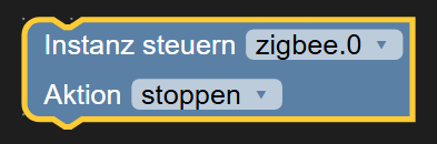

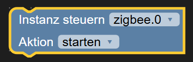

                                    Shadowhunter23 @Asgothian last edited by Shadowhunter23
                                    @asgothian sagte in Zigbee Instanzen stürzen alle paar Tage ab:
                                    Wobei ich Dir nicht sagen kann wie das starten / anhalten via Skript geht.
                                    Mit Blockly ganz einfach:
                                    await restartInstanceAsync('zigbee.0');
                                    await stopInstanceAsync('zigbee.0');
                                    await startInstanceAsync('zigbee.0');
                                    389
