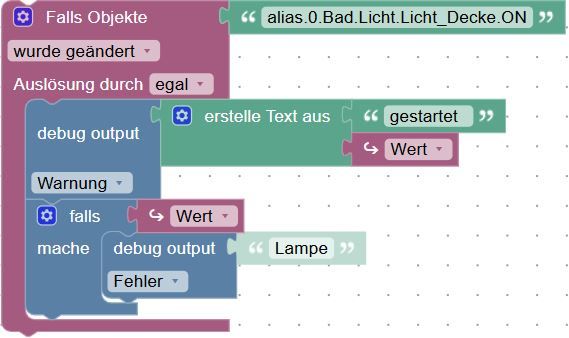

    meine einfache Abfrage bekomme ich nicht zum Laufen und verstehe nicht warum, es wird nur ein Boolean abgefragt und die . Meldung kommt nicht.

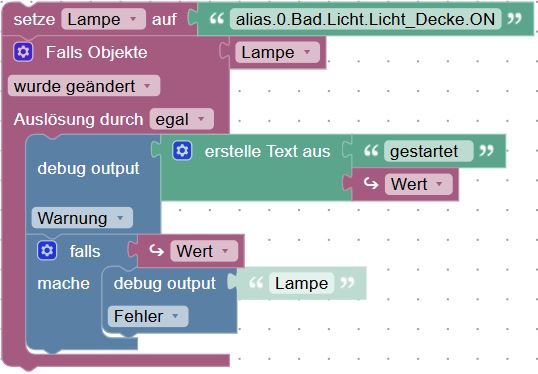

    Fehlermeldung::
    javascript.0
    	2025-03-19 15:13:22.498	error	at process.processImmediate (node:internal/timers:483:21)
    javascript.0
    	2025-03-19 15:13:22.498	error	at Immediate.<anonymous> (file:///opt/iobroker/node_modules/@iobroker/db-states-redis/build/esm/lib/states/statesInRedisClient.js:291:37)
    javascript.0
    	2025-03-19 15:13:22.498	error	at change (/opt/iobroker/node_modules/@iobroker/js-controller-adapter/build/cjs/lib/adapter/adapter.js:7312:31)
    javascript.0
    	2025-03-19 15:13:22.498	error	at Object.stateChange (/opt/iobroker/node_modules/iobroker.javascript/main.js:645:29)
    javascript.0
    	2025-03-19 15:13:22.498	error	at Object.callback (/opt/iobroker/node_modules/iobroker.javascript/lib/sandbox.js:1452:38)
    javascript.0
    	2025-03-19 15:13:22.498	error	at Object.<anonymous> (script.js.Licht.Bad.V2_04:11:32)
    javascript.0
    	2025-03-19 15:13:22.498	error	script.js.Licht.Bad.V2_04: TypeError: Cannot read properties of undefined (reading 'val')
    javascript.0
    	2025-03-19 15:13:22.496	error	script.js.Licht.Bad.V2_04: getState has been called with id of type "boolean" but expects a string
    javascript.0
    	2025-03-19 15:13:22.496	warn	script.js.Licht.Bad.V2_04: gestartet true
    javascript.0
    	2025-03-19 15:13:15.148	info	script.js.Licht.Bad.V2_04: registered 1 subscription, 0 schedules, 0 messages, 0 logs and 0 file subscriptions
    javascript.0
    	2025-03-19 15:13:15.145	info	Start JavaScript script.js.Licht.Bad.V2_04 (Blockly)
    javascript.0
    	2025-03-19 15:13:15.057	info	Stopping script script.js.Licht.Bad.V2_04

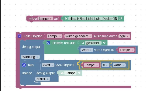

    Dann habe ich es so probiert::

    Fehlermeldung:
    avascript.0
    	2025-03-19 15:24:08.033	warn	script.js.Licht.Bad.V2_04: gestartet true
    Obwohl true angezeigt wird, wird es nicht ausgeführt.
    VG
    Krodon

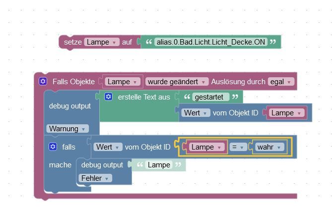

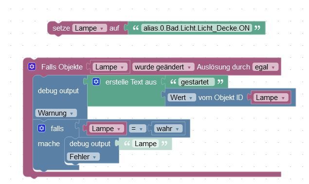

      Fehlermeldung::
      javascript.0
      javascript.0
      javascript.0
      javascript.0
      javascript.0
      javascript.0
      javascript.0
      javascript.0
      javascript.0
      javascript.0
      javascript.0
      javascript.0

      Fehlermeldung:
      avascript.0
      VG
      Krodon
      @krodon sagte: wird es nicht ausgeführt.
      Du vergleichst die ID (String) mit wahr. Dabei ist es ganz einfach:

          AsgothianA Offline
          AsgothianA Offline
          Asgothian
          @krodon Du hast einen Systematischen Fehler in deinem ersten Versuch:
          Da passt im falls die Reihenfolge der Blöcke nicht:
          muss so aussehen:
          Dann macht das ganze mehr Sinn.
          Allerdings ist die Optimierung die @paul53 geschrieben hat Sinnvoll. Auch da musst du die ID des DP nur einmal angeben. Du kannst natürlich an der mit X bezeichneten Stelle einfach die Variable Lampe andocken.Screenshot 2025-03-19 at 16.54.35.png

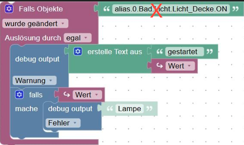

            @krodon sagte: ich wollte es aber mit der Variablen machen
            Variablen verwendet man dann, wenn ein Wert / String mehr als einmal verwendet wird.

              K Offline
              K Offline
              krodon
              @asgothian herzlichen Dank, ich kannte den Baustein Wert nicht, mit ihm ist vieles einfacher :-)
              VG
              Krodon
