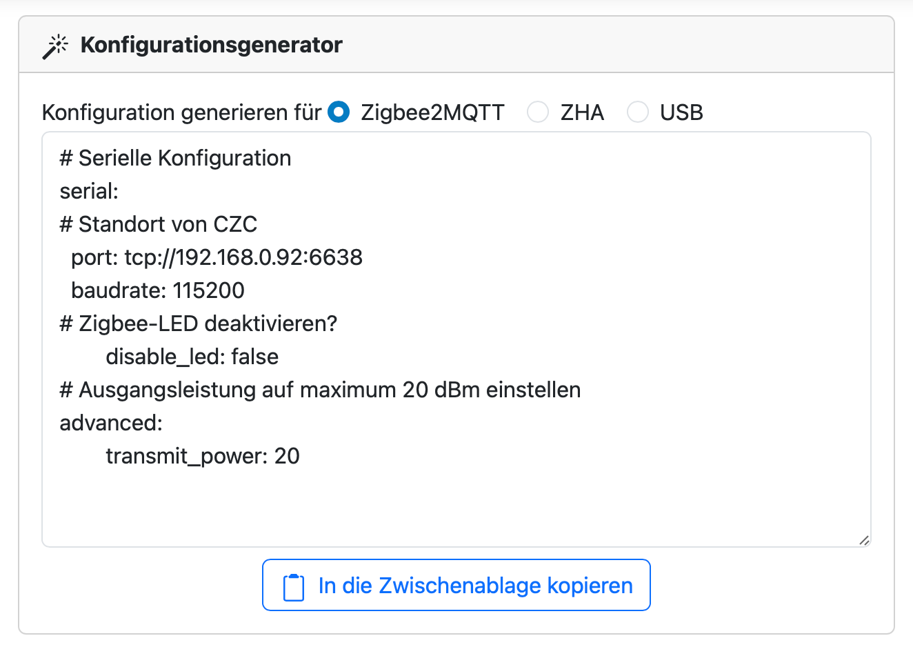

                                @pmayer sagte in cod.m ZigBee Coordinator (PoE/non-PoE) - made in Germany:
                                @schmakus Ja! Eventuell musst du das NVRAM leeren, wenn du ihn vorher mal Testweise am laufen hattest.
                                https://docs.codm.de/zigbee/faq/#firmware-v20-und-hoher
                                Hi, wenn ich in z2m die Adapter Adresse ändere, startet z2m nicht.
                                root@zigbee2mqtt:~# sudo systemctl start zigbee2mqtt
                                root@zigbee2mqtt:~# sudo journalctl -u zigbee2mqtt.service -f
                                Mar 14 10:59:27 zigbee2mqtt systemd[1]: zigbee2mqtt.service: Main process exited, code=exited, status=1/FAILURE
                                Mar 14 10:59:27 zigbee2mqtt systemd[1]: zigbee2mqtt.service: Failed with result 'exit-code'.
                                Mar 14 10:59:27 zigbee2mqtt systemd[1]: zigbee2mqtt.service: Consumed 1.896s CPU time.
                                Mar 14 10:59:28 zigbee2mqtt systemd[1]: zigbee2mqtt.service: Scheduled restart job, restart counter is at 3.
                                Mar 14 10:59:28 zigbee2mqtt systemd[1]: Stopped zigbee2mqtt.service - zigbee2mqtt.
                                Mar 14 10:59:28 zigbee2mqtt systemd[1]: zigbee2mqtt.service: Consumed 1.896s CPU time.
                                Mar 14 10:59:28 zigbee2mqtt systemd[1]: Started zigbee2mqtt.service - zigbee2mqtt.
                                Mar 14 10:59:28 zigbee2mqtt npm[2235]: > zigbee2mqtt@2.1.3 start
                                Mar 14 10:59:28 zigbee2mqtt npm[2235]: > node index.js
                                Mar 14 10:59:28 zigbee2mqtt npm[2247]: Starting Zigbee2MQTT without watchdog.
                                Mar 14 10:59:29 zigbee2mqtt npm[2247]: [2025-03-14 10:59:29] info:         z2m: Logging to console, file (filename: log.log)
                                Mar 14 10:59:29 zigbee2mqtt npm[2247]: [2025-03-14 10:59:29] info:         z2m: Starting Zigbee2MQTT version 2.1.3 (commit #ba337bd3)
                                Mar 14 10:59:29 zigbee2mqtt npm[2247]: [2025-03-14 10:59:29] info:         z2m: Starting zigbee-herdsman (3.2.7)
                                Mar 14 10:59:29 zigbee2mqtt npm[2247]: [2025-03-14 10:59:29] error:         z2m: Error while starting zigbee-herdsman
                                Mar 14 10:59:29 zigbee2mqtt npm[2247]: [2025-03-14 10:59:29] error:         z2m: Failed to start zigbee-herdsman
                                Mar 14 10:59:29 zigbee2mqtt npm[2247]: [2025-03-14 10:59:29] error:         z2m: Check https://www.zigbee2mqtt.io/guide/installation/20_zigbee2mqtt-fails-to-start_crashes-runtime.html for possible solutions
                                Mar 14 10:59:29 zigbee2mqtt npm[2247]: [2025-03-14 10:59:29] error:         z2m: Exiting...
                                Mar 14 10:59:29 zigbee2mqtt npm[2247]: [2025-03-14 10:59:29] error:         z2m: Error: Cannot discover TCP adapters at this time. Specify valid 'adapter' and 'port' in your configuration.
                                Mar 14 10:59:29 zigbee2mqtt npm[2247]:     at findTCPAdapter (/opt/zigbee2mqtt/node_modules/.pnpm/zigbee-herdsman@3.2.7/node_modules/zigbee-herdsman/src/adapter/adapterDiscovery.ts:470:15)
                                Mar 14 10:59:29 zigbee2mqtt npm[2247]:     at discoverAdapter (/opt/zigbee2mqtt/node_modules/.pnpm/zigbee-herdsman@3.2.7/node_modules/zigbee-herdsman/src/adapter/adapterDiscovery.ts:496:26)
                                Mar 14 10:59:29 zigbee2mqtt npm[2247]:     at Function.create (/opt/zigbee2mqtt/node_modules/.pnpm/zigbee-herdsman@3.2.7/node_modules/zigbee-herdsman/src/adapter/adapter.ts:68:54)
                                Mar 14 10:59:29 zigbee2mqtt npm[2247]:     at Controller.start (/opt/zigbee2mqtt/node_modules/.pnpm/zigbee-herdsman@3.2.7/node_modules/zigbee-herdsman/src/controller/controller.ts:132:38)
                                Mar 14 10:59:29 zigbee2mqtt npm[2247]:     at Zigbee.start (/opt/zigbee2mqtt/lib/zigbee.ts:69:47)
                                Mar 14 10:59:29 zigbee2mqtt npm[2247]:     at processTicksAndRejections (node:internal/process/task_queues:95:5)
                                Mar 14 10:59:29 zigbee2mqtt npm[2247]:     at Controller.start (/opt/zigbee2mqtt/lib/controller.ts:142:13)
                                Mar 14 10:59:29 zigbee2mqtt npm[2247]:     at start (/opt/zigbee2mqtt/index.js:161:5)
                                Mar 14 10:59:29 zigbee2mqtt systemd[1]: zigbee2mqtt.service: Main process exited, code=exited, status=1/FAILURE
                                Mar 14 10:59:29 zigbee2mqtt systemd[1]: zigbee2mqtt.service: Failed with result 'exit-code'.
                                Mar 14 10:59:29 zigbee2mqtt systemd[1]: zigbee2mqtt.service: Consumed 1.992s CPU time.
                                Mar 14 10:59:29 zigbee2mqtt systemd[1]: zigbee2mqtt.service: Scheduled restart job, restart counter is at 4.
                                Mar 14 10:59:29 zigbee2mqtt systemd[1]: Stopped zigbee2mqtt.service - zigbee2mqtt.
                                Mar 14 10:59:29 zigbee2mqtt systemd[1]: Started zigbee2mqtt.service - zigbee2mqtt.
                                Mar 14 10:59:29 zigbee2mqtt npm[2269]: > zigbee2mqtt@2.1.3 start
                                Mar 14 10:59:29 zigbee2mqtt npm[2269]: > node index.js
                                Mar 14 10:59:30 zigbee2mqtt npm[2281]: Starting Zigbee2MQTT without watchdog.
                                Mar 14 10:59:31 zigbee2mqtt npm[2281]: [2025-03-14 10:59:31] info:         z2m: Logging to console, file (filename: log.log)
                                Mar 14 10:59:31 zigbee2mqtt npm[2281]: [2025-03-14 10:59:31] info:         z2m: Starting Zigbee2MQTT version 2.1.3 (commit #ba337bd3)
                                Mar 14 10:59:31 zigbee2mqtt npm[2281]: [2025-03-14 10:59:31] info:         z2m: Starting zigbee-herdsman (3.2.7)
                                Mar 14 10:59:31 zigbee2mqtt npm[2281]: [2025-03-14 10:59:31] error:         z2m: Error while starting zigbee-herdsman
                                Mar 14 10:59:31 zigbee2mqtt npm[2281]: [2025-03-14 10:59:31] error:         z2m: Failed to start zigbee-herdsman
                                Mar 14 10:59:31 zigbee2mqtt npm[2281]: [2025-03-14 10:59:31] error:         z2m: Check https://www.zigbee2mqtt.io/guide/installation/20_zigbee2mqtt-fails-to-start_crashes-runtime.html for possible solutions
                                Mar 14 10:59:31 zigbee2mqtt npm[2281]: [2025-03-14 10:59:31] error:         z2m: Exiting...
                                Mar 14 10:59:31 zigbee2mqtt npm[2281]: [2025-03-14 10:59:31] error:         z2m: Error: Cannot discover TCP adapters at this time. Specify valid 'adapter' and 'port' in your configuration.
                                Mar 14 10:59:31 zigbee2mqtt npm[2281]:     at findTCPAdapter (/opt/zigbee2mqtt/node_modules/.pnpm/zigbee-herdsman@3.2.7/node_modules/zigbee-herdsman/src/adapter/adapterDiscovery.ts:470:15)
                                Mar 14 10:59:31 zigbee2mqtt npm[2281]:     at discoverAdapter (/opt/zigbee2mqtt/node_modules/.pnpm/zigbee-herdsman@3.2.7/node_modules/zigbee-herdsman/src/adapter/adapterDiscovery.ts:496:26)
                                Mar 14 10:59:31 zigbee2mqtt npm[2281]:     at Function.create (/opt/zigbee2mqtt/node_modules/.pnpm/zigbee-herdsman@3.2.7/node_modules/zigbee-herdsman/src/adapter/adapter.ts:68:54)
                                Mar 14 10:59:31 zigbee2mqtt npm[2281]:     at Controller.start (/opt/zigbee2mqtt/node_modules/.pnpm/zigbee-herdsman@3.2.7/node_modules/zigbee-herdsman/src/controller/controller.ts:132:38)
                                Mar 14 10:59:31 zigbee2mqtt npm[2281]:     at Zigbee.start (/opt/zigbee2mqtt/lib/zigbee.ts:69:47)
                                Mar 14 10:59:31 zigbee2mqtt npm[2281]:     at processTicksAndRejections (node:internal/process/task_queues:95:5)
                                Mar 14 10:59:31 zigbee2mqtt npm[2281]:     at Controller.start (/opt/zigbee2mqtt/lib/controller.ts:142:13)
                                Mar 14 10:59:31 zigbee2mqtt npm[2281]:     at start (/opt/zigbee2mqtt/index.js:161:5)
                                Mar 14 10:59:31 zigbee2mqtt systemd[1]: zigbee2mqtt.service: Main process exited, code=exited, status=1/FAILURE
                                Mar 14 10:59:31 zigbee2mqtt systemd[1]: zigbee2mqtt.service: Failed with result 'exit-code'.
                                Mar 14 10:59:31 zigbee2mqtt systemd[1]: zigbee2mqtt.service: Consumed 1.966s CPU time.
                                Mar 14 10:59:31 zigbee2mqtt systemd[1]: zigbee2mqtt.service: Scheduled restart job, restart counter is at 5.
                                Mar 14 10:59:31 zigbee2mqtt systemd[1]: Stopped zigbee2mqtt.service - zigbee2mqtt.
                                Mar 14 10:59:31 zigbee2mqtt systemd[1]: zigbee2mqtt.service: Start request repeated too quickly.
                                Mar 14 10:59:31 zigbee2mqtt systemd[1]: Failed to start zigbee2mqtt.service - zigbee2mqtt.
                                hier meine Konfiguration:
                                   frontend:
                                    enabled: true
                                    port: 8080
                                    host: 0.0.0.0
                                  homeassistant:
                                    enabled: false
                                  mqtt:
                                    base_topic: zigbee2mqtt
                                    server: mqtt://192.168.0.23:1883
                                    user: schmakus
                                    password: MkHar$m0518
                                  serial:
                                    port: tcp://192.168.0.92:6638
                                  advanced:
                                    pan_id: 14166
                                    ext_pan_id:
                                      - 197
                                      - 210
                                      - 238
                                      - 1
                                      - 77
                                      - 179
                                      - 182
                                      - 24
                                    channel: 11
                                    network_key:
                                      - 79
                                      - 75
                                      - 127
                                      - 63
                                      - 234
                                      - 195
                                      - 23
                                      - 236
                                      - 251
                                      - 114
                                      - 156
                                      - 148
                                      - 61
                                      - 34
                                      - 189
                                      - 39
                                    last_seen: ISO_8601_local
                                    cache_state: false
                                    output: json
                                    transmit_power: 20
                                    log_level: info
                                    adapter_concurrent: 16
                                  device_options: {}
                                  availability:
                                    enabled: true
                                  devices:
                                  pmayerP Online
                                  pmayerP Online
                                  pmayer
                                  wrote on last edited by pmayer
                                  @schmakus
                                  Das sieht danach aus also ob z2m die IP nicht erreichen kann.
                                  Kannst du sicherstellen, dass dein z2m an die 192.168.0.92 kommt? Thema Docker-Netzwerk, etc?
                                  Kann auch sein, dass nur adapter fehlt, siehe dazu https://docs.codm.de/zigbee/tutorials/setup-zigbee2mqtt/ und speziell https://docs.codm.de/zigbee/tutorials/setup-zigbee2mqtt/#ipv4
                                  Seit zigbee2mqtt Version 2.0 ist die Angabe von adapter zwingend, da zstack nicht mehr der Standardwert ist.
                                  Ist im nächsten Update der CZC-FW drin, damit im Webinterface das richtige Config-Beispiel gezeigt wird.
                                  Die aktuelle FW ist noch von vor z2m-2.0-Zeiten.
