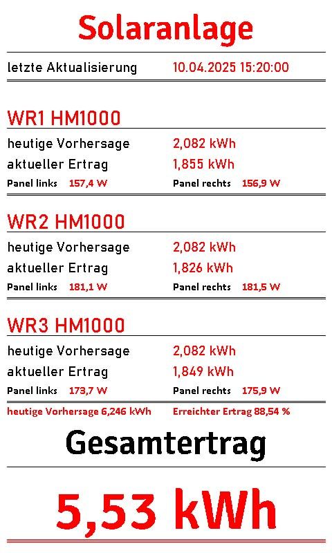

                Hier mal mein Blockly für die Anzeige von drei Wechselrichtern die ich hier in meiner kleinen Solaranlage habe.
                Anzeige auf einem 800 x 480 TAG-Display.

                Das Display sieht so aus:

                                                  <value name="THEN">
                                                    <block type="text" id=",QVHW_uAE@r0f!{)JmYr">
                                                      <field name="TEXT">Ausgeschaltet</field>
                                                    </block>
                                                  </value>
                                                  <value name="ELSE">
                                                    <block type="time_get" id="WDX6z]|S@u;_22cBnV?4">
                                                      <mutation xmlns="http://www.w3.org/1999/xhtml" format="true" language="false"></mutation>
                                                      <field name="OPTION">custom</field>
                                                      <field name="FORMAT">TT.MM.JJJJ SS:mm:ss</field>
                                                    </block>
                                                  </value>
                                                </block>
                                              </value>
                                              <value name="ADD2">
                                                <block type="text_replace" id="9suDhywmn0|S@k%B4tL}">
                                                  <value name="FROM">
                                                    <shadow type="text" id="R@w?w+H}pK1M|yk.4Q,7">
                                                      <field name="TEXT">.</field>
                                                    </shadow>
                                                  </value>
                                                  <value name="TO">
                                                    <shadow type="text" id="PO}quB08Odk-!i13EyAx">
                                                      <field name="TEXT">,</field>
                                                    </shadow>
                                                  </value>
                                                  <value name="TEXT">
                                                    <shadow type="text" id="Q$Af]Md*qL+5@VZ!5E+j">
                                                    </shadow>
                                                    <block type="text_join" id="%7M,-4ru#q{/k6KDWMHm">
                                                      <mutation items="33"></mutation>
                                                      <value name="ADD0">
                                                        <block type="logic_ternary" id="e(0#cb7J0QP//t$A.Sqj">
                                                          <value name="IF">
                                                            <block type="logic_compare" id="/.uFC;4v~QrFr[e~l^4u">
                                                              <field name="OP">EQ</field>
                                                              <value name="A">
                                                                <block type="get_value" id="z^RY8`{4;W+pqvKwa/7U">
                                                                  <field name="OID">opendtu.0.114190930771.producing</field>
                                                                </block>
                                                              </value>
                                                              <value name="B">
                                                                <block type="logic_boolean" id="*wF4;WgwPbX]0kM|aRv.">
                                                                </block>
                                                              </value>
                                                            </block>
                                                          </value>
                                                          <value name="THEN">
                                                            <block type="text" id="KG:U*zHU9}`ZAfY=W0tK">
                                                              <field name="TEXT">","fonts/bahnschrift20",2]}, {"line": [10,115,470,115,1]},  {"line": [10,117,470,117,1]},  {"text": [10,160,"WR1 HM1000","fonts/bahnschrift30",2]}, {"line": [10,185,470,185,1]}, {"text": [10,200,"heutige Vorhersage","fonts/bahnschrift20",1]},     {"text": [250,200,"</field>
                                                            </block>
                                                          </value>
                                                          <value name="ELSE">
                                                            <block type="text" id="^sCuT(s]f}YnsUhyc@b4">
                                                              <field name="TEXT">","fonts/bahnschrift20",2]}, {"line": [10,115,470,115,1]},  {"line": [10,117,470,117,1]},  {"text": [10,160,"WR1 HM1000  -  Ausgeschaltet","fonts/bahnschrift30",2]}, {"line": [10,185,470,185,1]}, {"text": [10,200,"heutige Vorhersage","fonts/bahnschrift20",1]},     {"text": [250,200,"</field>
                                                            </block>
                                                          </value>
                                                        </block>
                                                      </value>
                                                      <value name="ADD1">
                                                        <block type="get_value" id="Ivop[TTx6k8izC(a}Lh$">
                                                          <field name="OID">pvforecast.0.plants.wr1Hm1000.energy.today</field>
                                                        </block>
                                                      </value>
                                                      <value name="ADD2">
                                                        <block type="text" id="-TrP7)yat_@i@EoM![@s">
                                                          <field name="TEXT"> kWh","fonts/bahnschrift20",2]},     {"text": [10,230,"aktueller Ertrag","fonts/bahnschrift20",1]},   {"text": [250,230,"</field>
                                                        </block>
                                                      </value>
                                                      <value name="ADD3">
                                                        <block type="math_rndfixed" id="QAk.pcIY[:Hq@@iafttG">
                                                          <field name="n">3</field>
                                                          <value name="x">
                                                            <shadow type="math_number" id="mG[a]Hx%os@-@[KTCB6+">
                                                              <field name="NUM">3.1234</field>
                                                            </shadow>
                                                            <block type="math_arithmetic" id="Y4hw6Z6`8P]HU=kQv7.E">
                                                              <field name="OP">DIVIDE</field>
                                                              <value name="A">
                                                                <shadow type="math_number" id=")F~PE4ejNz6-[9SlDD^r">
                                                                  <field name="NUM">1</field>
                                                                </shadow>
                                                                <block type="get_value" id=",q|-s|A[N!n.HVB![149">
                                                                  <field name="OID">opendtu.0.114190930771.yieldday</field>
                                                                </block>
                                                              </value>
                                                              <value name="B">
                                                                <shadow type="math_number" id="lEzFBL(5bFQIyhjrtXT2">
                                                                  <field name="NUM">1000</field>
                                                                </shadow>
                                                              </value>
                                                            </block>
                                                          </value>
                                                        </block>
                                                      </value>
                                                      <value name="ADD4">
                                                        <block type="text" id="8Mjb{3)XGWhzToz{:.]t">
                                                          <field name="TEXT"> kWh","fonts/bahnschrift20",2]}, {"text": [10,270,"Panel links","t0_14b_tf",1]},  {"text": [100,270,"</field>
                                                        </block>
                                                      </value>
                                                      <value name="ADD5">
                                                        <block type="get_value" id="phgTU_Bh-tvt7%,t24y|">
                                                          <field name="OID">opendtu.0.114190930771.dc.input_2.power</field>
                                                        </block>
                                                      </value>
                                                      <value name="ADD6">
                                                        <block type="text" id="7nXKqp!cOTMvIDJNbSW5">
                                                          <field name="TEXT"> W","t0_14b_tf",2]}, {"text": [250,270,"Panel rechts","t0_14b_tf",1]},  {"text": [350,270,"</field>
                                                        </block>
                                                      </value>
                                                      <value name="ADD7">
                                                        <block type="get_value" id="yKa;IXm+q5ASEgf#O+F[">
                                                          <field name="OID">opendtu.0.114190930771.dc.input_1.power</field>
                                                        </block>
                                                      </value>
                                                      <value name="ADD8">
                                                        <block type="text" id="xGp/ybNh#GE3P])v]Inw">
                                                          <field name="TEXT"> W","t0_14b_tf",2]},  {"line": [10,280,470,280,1]}, {"line": [10,282,470,282,1]},</field>
                                                        </block>
                                                      </value>
                                                      <value name="ADD9">
                                                        <block type="logic_ternary" id="@HjbASKU(HaOD^mQ,oWY">
                                                          <value name="IF">
                                                            <block type="logic_compare" id="9{#(Ck6zGJJhZ7F^p==E">
                                                              <value name="A">
                                                                <block type="get_value" id="OSF}iUQ~rSU~5YYAin#F">
                                                                  <field name="OID">opendtu.0.114190653534.producing</field>
                                                                </block>
                                                              </value>
                                                              <value name="B">
                                                                <block type="logic_boolean" id="V*Uq#xUHylKzFg-G(Q5l">
                                                                </block>
                                                              </value>
                                                            </block>
                                                          </value>
                                                          <value name="THEN">
                                                            <block type="text" id="NJ83/zw??wV}EXLpM@L-">
                                                              <field name="TEXT">{"text": [10,310,"WR2 HM1000","fonts/bahnschrift30",2]}, {"line": [10,335,470,335,1]},  {"text": [10,350,"heutige Vorhersage","fonts/bahnschrift20",1]},     {"text": [250,350,"</field>
                                                            </block>
                                                          </value>
                                                          <value name="ELSE">
                                                            <block type="text" id="(,8mlBH*0JejMqRkxu^Z">
                                                              <field name="TEXT">{"text": [10,310,"WR2 HM1000  -  Ausgeschaltet","fonts/bahnschrift30",2]}, {"line": [10,335,470,335,1]},  {"text": [10,350,"heutige Vorhersage","fonts/bahnschrift20",1]},     {"text": [250,350,"</field>
                                                            </block>
                                                          </value>
                                                        </block>
                                                      </value>
                                                      <value name="ADD10">
                                                        <block type="get_value" id="EeT5/2{=1Pjj98$#_)6X">
                                                          <field name="OID">pvforecast.0.plants.wr2Hm1000.energy.today</field>
                                                        </block>
                                                      </value>
                                                      <value name="ADD11">
                                                        <block type="text" id="Lq9N4bVbA.B3?#0zbNa!">
                                                          <field name="TEXT"> kWh","fonts/bahnschrift20",2]},     {"text": [10,380,"aktueller Ertrag","fonts/bahnschrift20",1]},   {"text": [250,380,"</field>
                                                        </block>
                                                      </value>
                                                      <value name="ADD12">
                                                        <block type="math_rndfixed" id="Zc4Wo*jkd5VH{#}%sePK">
                                                          <value name="x">
                                                            </shadow>
                                                            <block type="math_arithmetic" id="TTu0Sbuj6d=$A/pZEp5i">
                                                              <value name="A">
                                                                </shadow>
                                                                <block type="get_value" id="9aBLuy!78*lXpotau-h8">
                                                                  <field name="OID">opendtu.0.114190653534.yieldday</field>
                                                                </block>
                                                              </value>
                                                              <value name="B">
                                                                <shadow type="math_number" id="RuMYw9r(VN]+:RQ3X0R`">
                                                                </shadow>
                                                              </value>
                                                            </block>
                                                          </value>
                                                        </block>
                                                      </value>
                                                      <value name="ADD13">
                                                        <block type="text" id="]Y?pE{T:w[,/]BWN)Xq+">
                                                          <field name="TEXT"> kWh","fonts/bahnschrift20",2]}, {"text": [10,420,"Panel links","t0_14b_tf",1]},  {"text": [100,420,"</field>
                                                        </block>
                                                      </value>
                                                      <value name="ADD14">
                                                        <block type="get_value" id="wU(`{rgH%Te%1K!gLE_.">
                                                          <field name="OID">opendtu.0.114190653534.dc.input_2.power</field>
                                                        </block>
                                                      </value>
                                                      <value name="ADD15">
                                                        <block type="text" id="^^K-W;pWK,9o#[dPW~cd">
                                                          <field name="TEXT"> W","t0_14b_tf",2]}, {"text": [250,420,"Panel rechts","t0_14b_tf",1]},  {"text": [350,420,"</field>
                                                        </block>
                                                      </value>
                                                      <value name="ADD16">
                                                        <block type="get_value" id="U$_nYTB5?0FU){HAJE(B">
                                                          <field name="OID">opendtu.0.114190653534.dc.input_1.power</field>
                                                        </block>
                                                      </value>
                                                      <value name="ADD17">
                                                        <block type="text" id="$EisYqD8XD(hY)GBpDD7">
                                                          <field name="TEXT"> W","t0_14b_tf",2]}, {"line": [10,430,470,430,1]}, {"line": [10,432,470,432,1]},</field>
                                                        </block>
                                                      </value>
                                                      <value name="ADD18">
                                                        <block type="logic_ternary" id="x~0?ARW%*1R.pa^/hko?">
                                                          <value name="IF">
                                                            <block type="logic_compare" id="o|5F4IL8N^5UDxsAGFxg">
                                                              <value name="A">
                                                                <block type="get_value" id="GSedObh37`:,W+yov-zG">
                                                                  <field name="OID">opendtu.0.114172609137.producing</field>
                                                                </block>
                                                              </value>
                                                              <value name="B">
                                                                <block type="logic_boolean" id="Y:BJ.M;?tn#S!)7%mN[;">
                                                                </block>
                                                              </value>
                                                            </block>
                                                          </value>
                                                          <value name="THEN">
                                                            <block type="text" id="KcxMy19JI6~%OX[7y7za">
                                                              <field name="TEXT">{"text": [10,460,"WR3 HM1000","fonts/bahnschrift30",2]}, {"line": [10,485,470,485,1]},  {"text": [10,500,"heutige Vorhersage","fonts/bahnschrift20",1]},     {"text": [250,500,"</field>
                                                            </block>
                                                          </value>
                                                          <value name="ELSE">
                                                            <block type="text" id="*~KvPLC*POD+g[g1].)U">
                                                              <field name="TEXT">{"text": [10,460,"WR3 HM1000  -  Ausgeschaltet","fonts/bahnschrift30",2]}, {"line": [10,485,470,485,1]},  {"text": [10,500,"heutige Vorhersage","fonts/bahnschrift20",1]},     {"text": [250,500,"</field>
                                                            </block>
                                                          </value>
                                                        </block>
                                                      </value>
                                                      <value name="ADD19">
                                                        <block type="get_value" id="?=L[IdwDuBQX=-l#f#B/">
                                                          <field name="OID">pvforecast.0.plants.wr3Hm1000.energy.today</field>
                                                        </block>
                                                      </value>
                                                      <value name="ADD20">
                                                        <block type="text" id="@-*Ngc*K=Sp]P,1*M;CY">
                                                          <field name="TEXT"> kWh","fonts/bahnschrift20",2]},     {"text": [10,530,"aktueller Ertrag","fonts/bahnschrift20",1]},   {"text": [250,530,"</field>
                                                        </block>
                                                      </value>
                                                      <value name="ADD21">
                                                        <block type="math_rndfixed" id="T0-z;{D5wgX0LrH#9R[Z">
                                                          <value name="x">
                                                            </shadow>
                                                            <block type="math_arithmetic" id="vs^5Rb_sD8bohnEKn-fv">
                                                              <value name="A">
                                                                </shadow>
                                                                <block type="get_value" id="Ob(W-,Pe~q~jy%7r^XW7">
                                                                  <field name="OID">opendtu.0.114172609137.yieldday</field>
                                                                </block>
                                                              </value>
                                                              <value name="B">
                                                                <shadow type="math_number" id="t0I3hJZuLIHM^|RLd|iv">
                                                                </shadow>
                                                              </value>
                                                            </block>
                                                          </value>
                                                        </block>
                                                      </value>
                                                      <value name="ADD22">
                                                        <block type="text" id="@A+vp)63G)$k(=[[*?-F">
                                                          <field name="TEXT"> kWh","fonts/bahnschrift20",2]}, {"text": [10,570,"Panel links","t0_14b_tf",1]},  {"text": [100,570,"</field>
                                                        </block>
                                                      </value>
                                                      <value name="ADD23">
                                                        <block type="get_value" id="2yCXTF1Qb84nEUUhMx8$">
                                                          <field name="OID">opendtu.0.114172609137.dc.input_2.power</field>
                                                        </block>
                                                      </value>
                                                      <value name="ADD24">
                                                        <block type="text" id="rlvNe?,x+HP[Rx$%DDjb">
                                                          <field name="TEXT"> W","t0_14b_tf",2]}, {"text": [250,570,"Panel rechts","t0_14b_tf",1]},  {"text": [350,570,"</field>
                                                        </block>
                                                      </value>
                                                      <value name="ADD25">
                                                        <block type="get_value" id="bf%+QR[inZJC#AAQ@u0R">
                                                          <field name="OID">opendtu.0.114172609137.dc.input_1.power</field>
                                                        </block>
                                                      </value>
                                                      <value name="ADD26">
                                                        <block type="text" id="qghl?RN!Na`7!*@Rh%]!">
                                                          <field name="TEXT"> W","t0_14b_tf",2]}, {"line": [10,580,470,580,1]}, {"line": [10,582,470,582,1]},{"text": [10,600,"heutige Vorhersage </field>
                                                        </block>
                                                      </value>
                                                      <value name="ADD27">
                                                        <block type="get_value" id="3]*vljaL09ew4$FO9xPb">
                                                          <field name="OID">pvforecast.0.summary.energy.today</field>
                                                        </block>
                                                      </value>
                                                      <value name="ADD28">
                                                        <block type="text" id="IUGBm6dx/gIlfNP}Yt%y">
                                                          <field name="TEXT"> kWh","t0_14b_tf",2]},{"text": [250,600,"Erreichter Ertrag </field>
                                                        </block>
                                                      </value>
                                                      <value name="ADD29">
                                                        <block type="math_rndfixed" id="sZUvOOMh,ha=vZpir=t[">
                                                          <field name="n">2</field>
                                                          <value name="x">
                                                            <shadow type="math_number" id="3BOwPA}*ySU8ZK0Gnl1n">
                                                            </shadow>
                                                            <block type="math_arithmetic" id="wmJ/[`BFPDO7D`A0RgBd">
                                                              <field name="OP">MULTIPLY</field>
                                                              <value name="A">
                                                                <shadow type="math_number" id="l1C4`dT0?s#j@S`rk4f4">
                                                                  <field name="NUM">100</field>
                                                                </shadow>
                                                              </value>
                                                              <value name="B">
                                                                <shadow type="math_number" id=":Xkz~uu=qr_GYw$jsfL{">
                                                                </shadow>
                                                                <block type="math_arithmetic" id="!JGoF:`qR,7:r6HfEUkL">
                                                                  <value name="A">
                                                                    <shadow type="math_number" id="V+z*Pkx6V]nVqtm[{CvF">
                                                                    </shadow>
                                                                    <block type="math_arithmetic" id="uBAX:!#=6J0*[j%6)-?y">
                                                                      <value name="A">
                                                                        <shadow type="math_number" id="zZh-~A!wYv#8/P.AW6x9">
                                                                        </shadow>
                                                                        <block type="get_value" id=":V1;P-tCQ/Su;UfRcDj[">
                                                                          <field name="OID">opendtu.0.total.yieldday</field>
                                                                        </block>
                                                                      </value>
                                                                      <value name="B">
                                                                        <shadow type="math_number" id="J$vn}Z+z=TXkY#,6)O%I">
                                                                        </shadow>
                                                                      </value>
                                                                    </block>
                                                                  </value>
                                                                  <value name="B">
                                                                    <shadow type="math_number" id="Gd_TU(AoI5gK;vD9`wR:">
                                                                    </shadow>
                                                                    <block type="get_value" id="=[RKv}#j--V|7Tien#0#">
                                                                    </block>
                                                                  </value>
                                                                </block>
                                                              </value>
                                                            </block>
                                                          </value>
                                                        </block>
                                                      </value>
                                                      <value name="ADD30">
                                                        <block type="text" id="t4tfAp2p2KSKGOdksFV*">
                                                          <field name="TEXT"> %","t0_14b_tf",2]},{"text": [240,610,"Gesamtertrag","fonts/calibrib50",1,1]}, {"line": [10,675,470,675,1]}, {"text": [240,690,"</field>
                                                        </block>
                                                      </value>
                                                      <value name="ADD31">
                                                        <block type="math_rndfixed" id="HKNDXa}YT2y6W}:;g}*x">
                                                          <value name="x">
                                                            </shadow>
                                                            <block type="math_arithmetic" id="$a(kOL-]3r)4dehKOE6#">
                                                              <value name="A">
                                                                </shadow>
                                                                <block type="get_value" id="vA3:H]EHDmDCIp+bk3;h">
                                                                </block>
                                                              </value>
                                                              <value name="B">
                                                                <shadow type="math_number" id="OY{OD3uwCS2W3/+FYOOz">
                                                                </shadow>
                                                              </value>
                                                            </block>
                                                          </value>
                                                        </block>
                                                      </value>
                                                      <value name="ADD32">
                                                        <block type="text" id="L[@Q+Cu-y!dxWzKzMZlL">
                                                          <field name="TEXT"> kWh","fonts/calibrib80",2,1]}, {"line": [10,780,470,780,2]}, {"line": [10,782,470,782,2]}, {"line": [10,784,470,784,2]}]</field>
                                                        </block>
                                                      </value>
                                                    </block>
                                                  </value>
                                                </block>
                                              </value>
                                            </block>
                                          </value>
                                        </block>
                                      </value>
                                      <next>
                                        <block type="http_post" id="AoQ+~mSdktWzhHgxGz#C">
                                          <field name="TIMEOUT">15</field>
                                          <field name="TYPE">text</field>
                                          <value name="URL">
                                            <shadow type="text" id="qh|GfefbC0op9nMhC4nk">

                  Sieht dann so aus.
                  Das ist ganz einfach mit dem Blockly-Baustein aus "Text" ersetze-durch-in gemacht.
                  Also ersetze "Punkt" durch "komma" und dann in das letzte Feld eben den kompletten Baustein "erstelle Text aus".
                  Die obere Datumsanzeige muß natürlich auserhalb des "ersetzen" Blocks.
                  In den Haupteinstellungen von ioBroker gibt es zwar eine Auswahl zwischen Komma und Punkt.
                  Auf Zahlenwerte in den Datenpunkten wenn sie in einem Blockly verarbeitet werden hat es leider keinen Einfluss.
                  Grüße

                      <block type="comment" id=":1{5ta`)D%sSjgoE=Fi!" x="738" y="413">
                        <field name="COMMENT">Solarertrag grosses Display EG</field>
                        <next>
                          <block type="schedule" id="|O{CP~h._+!v#c9*!LVm">
                            <field name="SCHEDULE">*/10 * * * *</field>
                            <statement name="STATEMENT">
                              <block type="controls_if" id="+eTrP@@x*{)ZhjN2H4Jf">
                                <value name="IF0">
                                  <block type="time_compare_ex" id="$t$it-V6B2hU;#k~^cP4">
                                    <mutation xmlns="http://www.w3.org/1999/xhtml" end_time="true" actual_time="true"></mutation>
                                    <field name="USE_ACTUAL_TIME">TRUE</field>
                                    <field name="OPTION">between</field>
                                    <value name="START_TIME">
                                      <shadow type="text" id="hBM#f+Gd22:2k,$_+t+,">
                                        <field name="TEXT">12:00</field>
                                      </shadow>
                                      <block type="time_astro" id="((+60!hJ,hptfT?5VH.U">
                                        <field name="TYPE">nauticalDawn</field>
                                        <field name="OFFSET">0</field>
                                      </block>
                                    </value>
                                    <value name="END_TIME">
                                      <shadow type="text" id="Dh8jih_mk2:;yR{u2H+n">
                                        <field name="TEXT">18:00</field>
                                      </shadow>
                                      <block type="time_astro" id="LwAhrvt~a790ggE*PiZf">
                                        <field name="TYPE">nauticalDusk</field>
                                      </block>
                                    </value>
                                  </block>
                                </value>
                                <statement name="DO0">
                                  <block type="variables_set" id="}kvQ}B#.rViPjfKc-HTi">
                                    <field name="VAR" id="eMqV!m8?ZCdqN2].w`xb">TagMini1</field>
                                    <value name="VALUE">
                                      <block type="text" id="AS0{YNAIOlM%S|LO,c(?">
                                        <field name="TEXT">000005EDCEAABC9A</field>
                                      </block>
                                    </value>
                                    <next>
                                      <block type="variables_set" id="k02GjbFfyHgTN`gcO-Da">
                                        <field name="VAR" id="*)}|9mHpKcV3YN}|a_t5">jsonMini1</field>
                                          <block type="procedures_callcustomreturn" id="m+$OB%}5|)Pwa;Sp_8Xz">
                                            <mutation name="encodeURL">
                                              <arg name="url"></arg>
                                            </mutation>
                                            <value name="ARG0">
                                              <block type="text_join" id="(xI]C(qn!er+Dx3Kqd{e">
                                                <value name="ADD0">
                                                  <block type="text" id="G2fL:Xxh_e)*]VxFnorb">
                                                    <field name="TEXT">[ { "rotate": 1 },  {"text": [240,10,"Solaranlage","fonts/calibrib50",2,1]}, {"line": [10,75,470,75,1]}, {"text": [10,90,"letzte Aktualisierung","fonts/bahnschrift20",1]},     {"text": [250,90,"</field>
                                                  </block>
                                                </value>
                                                <value name="ADD1">
                                                  <block type="logic_ternary" id="8{w1#^^5;dvTPL+e;YJ~">
                                                    <value name="IF">
                                                      <block type="logic_multi_and" id="}T,NvzNn/+Lg^0WvBwC]">
                                                        <mutation xmlns="http://www.w3.org/1999/xhtml" items="3"></mutation>
                                                        <value name="AND0">
                                                          <block type="logic_compare" id="2=erH{%MgL5/:iIl`8T5">
                                                            <value name="A">
                                                              <block type="get_value" id="Tpf)^`BWUL|!xG9o@^+5">
                                                              </block>
                                                            </value>
                                                            <value name="B">
                                                              <block type="logic_boolean" id="*$av63$R-M9D`!g~ZeWf">
                                                              </block>
                                                            </value>
                                                          </block>
                                                        </value>
                                                        <value name="AND1">
                                                          <block type="logic_compare" id="M02=NZJg8/TZ;bG=^~EK">
                                                            <value name="A">
                                                              <block type="get_value" id="tEI3p@a`|h1#gD5ekrKU">
                                                              </block>
                                                            </value>
                                                            <value name="B">
                                                              <block type="logic_boolean" id="|53x*YF8cIMZ]=cN/qp3">
                                                              </block>
                                                            </value>
                                                          </block>
                                                        </value>
                                                        <value name="AND2">
                                                          <block type="logic_compare" id="Q#[Ufu%Pm9=GzdE@pFPH">
                                                            <value name="A">
                                                              <block type="get_value" id="RdD=%=,z`:diSVyOP/!w">
                                                              </block>
                                                            </value>
                                                            <value name="B">
                                                              <block type="logic_boolean" id="(Eqk-Ym(20Q+_,iTt@|w">
                                                              </block>
                                                            </value>
                                                          </block>
                                                        </value>
                                                      </block>
                                                    </value>
                                                    <value name="THEN">
                                                      </block>
                                                    </value>
                                                    <value name="ELSE">
                                                      </block>
                                                    </value>
                                                  </block>
                                                </value>
                                                <value name="ADD2">
                                                    <value name="FROM">
                                                      </shadow>
                                                    </value>
                                                    <value name="TO">
                                                      </shadow>
                                                    </value>
                                                    <value name="TEXT">
                                                      </shadow>
                                                        <value name="ADD0">
                                                            <value name="IF">
                                                                <value name="A">
                                                                  </block>
                                                                </value>
                                                                <value name="B">
                                                                  </block>
                                                                </value>
                                                              </block>
                                                            </value>
                                                            <value name="THEN">
                                                              </block>
                                                            </value>
                                                            <value name="ELSE">
                                                              </block>
                                                            </value>
                                                          </block>
                                                        </value>
                                                        <value name="ADD1">
                                                          </block>
                                                        </value>
                                                        <value name="ADD2">
                                                          </block>
                                                        </value>
                                                        <value name="ADD3">
                                                            <value name="x">
                                                              </shadow>
                                                                <value name="A">
                                                                  </shadow>
                                                                  </block>
                                                                </value>
                                                                <value name="B">
                                                                  </shadow>
                                                                </value>
                                                              </block>
                                                            </value>
                                                          </block>
                                                        </value>
                                                        <value name="ADD4">
                                                          </block>
                                                        </value>
                                                        <value name="ADD5">
                                                          </block>
                                                        </value>
                                                        <value name="ADD6">
                                                          </block>
                                                        </value>
                                                        <value name="ADD7">
                                                          </block>
                                                        </value>
                                                        <value name="ADD8">
                                                          </block>
                                                        </value>
                                                        <value name="ADD9">
                                                            <value name="IF">
                                                                <value name="A">
                                                                  </block>
                                                                </value>
                                                                <value name="B">
                                                                  </block>
                                                                </value>
                                                              </block>
                                                            </value>
                                                            <value name="THEN">
                                                              </block>
                                                            </value>
                                                            <value name="ELSE">
                                                              </block>
                                                            </value>
                                                          </block>
                                                        </value>
                                                          </block>
                                                        </value>
                                                          </block>
                                                        </value>
                                                            <value name="x">
                                                              </shadow>
                                                                <value name="A">
                                                                  </shadow>
                                                                  </block>
                                                                </value>
                                                                <value name="B">
                                                                  </shadow>
                                                                </value>
                                                              </block>
                                                            </value>
                                                          </block>
                                                        </value>
                                                          </block>
                                                        </value>
                                                          </block>
                                                        </value>
                                                          </block>
                                                        </value>
                                                          </block>
                                                        </value>
                                                          </block>
                                                        </value>
                                                            <value name="IF">
                                                                <value name="A">
                                                                  </block>
                                                                </value>
                                                                <value name="B">
                                                                  </block>
                                                                </value>
                                                              </block>
                                                            </value>
                                                            <value name="THEN">
                                                              </block>
                                                            </value>

                    Sieht dann so aus.
                    Grüße
