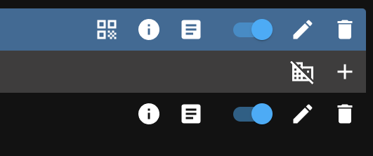

                                          denjo
                                          #60
