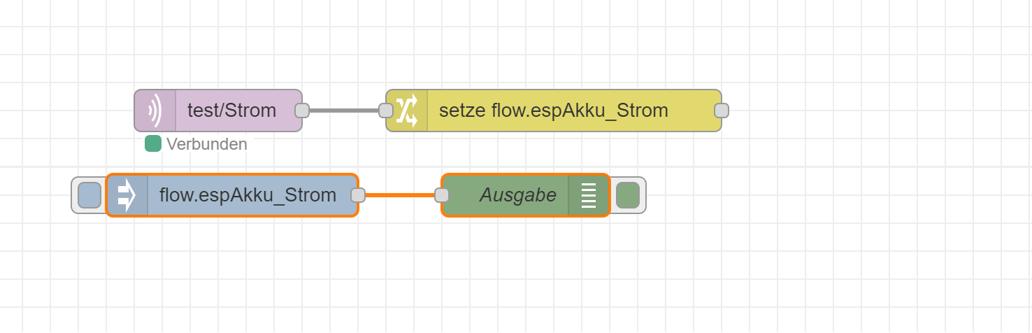

            @schnuller Du speicherst das einfach im Flow Kontext und gut ist.
            Hier zum Import:
            [{"id":"46c3393b9d18ef3c","type":"mqtt in","z":"289f539dcc33814e","name":"","topic":"test/Strom","qos":"2","datatype":"auto-detect","broker":"","nl":false,"rap":true,"rh":0,"inputs":0,"x":160,"y":5420,"wires":[["dcd1403d5362104e"]]},{"id":"dcd1403d5362104e","type":"change","z":"289f539dcc33814e","name":"","rules":[{"t":"set","p":"espAkku_Strom","pt":"flow","to":"payload","tot":"msg"}],"action":"","property":"","from":"","to":"","reg":false,"x":400,"y":5420,"wires":[[]]},{"id":"fbcd69194e79539a","type":"inject","z":"289f539dcc33814e","name":"","props":[{"p":"payload"}],"repeat":"","crontab":"","once":false,"onceDelay":0.1,"topic":"","payload":"espAkku_Strom","payloadType":"flow","x":170,"y":5480,"wires":[["17aeae816eec0f8e"]]},{"id":"17aeae816eec0f8e","type":"debug","z":"289f539dcc33814e","name":"Ausgabe","active":true,"tosidebar":true,"console":false,"tostatus":false,"complete":"payload","targetType":"msg","statusVal":"","statusType":"auto","x":380,"y":5480,"wires":[]}]
