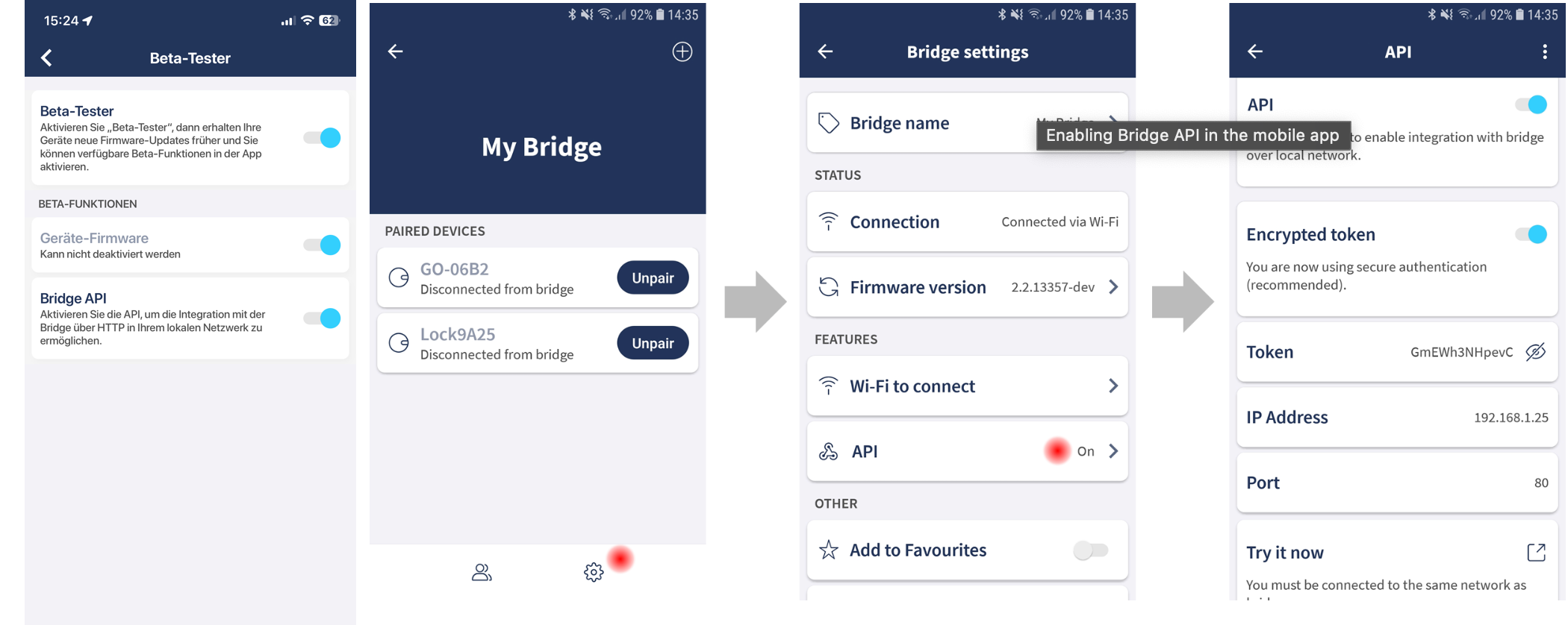

    Loginablauf:
    1. Activate Beta Testing in your user profile
    2. Enable API in the bridge settings
    3. Copy the IP and the token in the instance settings
