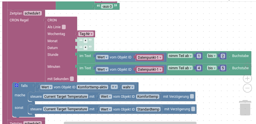

    Hier das in Javascript gewandelte Blockly-Script (das exportierte Blockly-Script war zu lang):
    var Tag_Nr, Tag_heute, Tagk_C3_BCrzel, Datenpunkt_1, Datenpunkt_2, Datenpunkt_3, Datenpunkt_4, Datenpunkt_5, Datenpunkt_6, schedule1, schedule2, schedule3, schedule4, schedule5, schedule6;
    // Toggle Standard- o. Komforttemp
    on({ id: [].concat(['0_userdata.0.Heating.Bad.Komforttemp-aktiv']), val: true }, async (obj) => {
      let value = obj.state.val;
      let oldValue = obj.oldState.val;
      setState('0_userdata.0.Heating.Bad.Standardtemp-aktiv' /* Standardtemp-aktiv */, false, true);
    on({ id: [].concat(['0_userdata.0.Heating.Bad.Standardtemp-aktiv']), val: true }, async (obj) => {
      setState('0_userdata.0.Heating.Bad.Komforttemp-aktiv' /* Komforttemp-aktiv */, false, true);

      schedule1 = schedule((getState(Datenpunkt_1).val.slice(3, 5)).toString().trim() + ' ' + (getState(Datenpunkt_1).val.slice(0, 2)).toString().trim() + ' ' + '*'.toString().trim() + ' ' + '*'.toString().trim() + ' ' + Tag_Nr.toString().trim(), async () => {
        if (getState('0_userdata.0.Heating.Bad.Komforttemp-aktiv').val == true) {
          setState('zigbee.0.cc86ecfffec3ab52.target_temperature' /* Current Target Temperature */, getState('0_userdata.0.Heating.Bad.Komforttemp').val);
        } else {
          setState('zigbee.0.cc86ecfffec3ab52.target_temperature' /* Current Target Temperature */, getState('0_userdata.0.Heating.Bad.Standardtemp').val);
      schedule2 = schedule((getState(Datenpunkt_2).val.slice(3, 5)).toString().trim() + ' ' + (getState(Datenpunkt_2).val.slice(0, 2)).toString().trim() + ' ' + '*'.toString().trim() + ' ' + '*'.toString().trim() + ' ' + Tag_Nr.toString().trim(), async () => {
        setState('zigbee.0.cc86ecfffec3ab52.target_temperature' /* Current Target Temperature */, getState('0_userdata.0.Heating.Bad.Absenktemp').val);
      schedule3 = schedule((getState(Datenpunkt_3).val.slice(3, 5)).toString().trim() + ' ' + (getState(Datenpunkt_3).val.slice(0, 2)).toString().trim() + ' ' + '*'.toString().trim() + ' ' + '*'.toString().trim() + ' ' + Tag_Nr.toString().trim(), async () => {
        } else {
      schedule4 = schedule((getState(Datenpunkt_4).val.slice(3, 5)).toString().trim() + ' ' + (getState(Datenpunkt_4).val.slice(0, 2)).toString().trim() + ' ' + '*'.toString().trim() + ' ' + '*'.toString().trim() + ' ' + Tag_Nr.toString().trim(), async () => {
      schedule5 = schedule((getState(Datenpunkt_5).val.slice(3, 5)).toString().trim() + ' ' + (getState(Datenpunkt_5).val.slice(0, 2)).toString().trim() + ' ' + '*'.toString().trim() + ' ' + '*'.toString().trim() + ' ' + Tag_Nr.toString().trim(), async () => {
        } else {
      schedule6 = schedule((getState(Datenpunkt_6).val.slice(3, 5)).toString().trim() + ' ' + (getState(Datenpunkt_6).val.slice(0, 2)).toString().trim() + ' ' + '*'.toString().trim() + ' ' + '*'.toString().trim() + ' ' + Tag_Nr.toString().trim(), async () => {
    //JTNDeG1sJTIweG1sbnMlM0QlMjJodHRwcyUzQSUyRiUyRmRldmVsb3BlcnMuZ29vZ2xlLmNvbSUyRmJsb2NrbHklMkZ4bWwlMjIlM0UlM0N2YXJpYWJsZXMlM0UlM0N2YXJpYWJsZSUyMGlkJTNEJTIyMSU1Qm4lMjV0a3dmTW10WHQlM0QlNUJEU0VnJTVEJTIyJTNFVGFnLU5yJTNDJTJGdmFyaWFibGUlM0UlM0N2YXJpYWJsZSUyMGlkJTNEJTIyejklNUIlNUUtJTdELlolN0JPdiU2MCUzQWEyISUzRGZEUyUyMiUzRVRhZy1oZXV0ZSUzQyUyRnZhcmlhYmxlJTNFJTNDdmFyaWFibGUlMjBpZCUzRCUyMlc1WjFXVmxET0ExM3JPUyUzQTdaNmslMjIlM0VUYWdrJUMzJUJDcnplbCUzQyUyRnZhcmlhYmxlJTNFJTNDdmFyaWFibGUlMjBpZCUzRCUyMkklM0FGUzdOeFlfQX5NU2EpazFROHUlMjIlM0VEYXRlbnB1bmt0LTElM0MlMkZ2YXJpYWJsZSUzRSUzQ3ZhcmlhYmxlJTIwaWQlM0QlMjJSKUklNjBXLU0xMWwqSSUyQik3bUZYJTI1RSUyMiUzRURhdGVucHVua3QtMiUzQyUyRnZhcmlhYmxlJTNFJTNDdmFyaWFibGUlMjBpZCUzRCUyMiUyNHFhTDkzUSh5eV9HTXc5a2VZSyUyNSUyMiUzRURhdGVucHVua3QtMyUzQyUyRnZhcmlhYmxlJTNFJTNDdmFyaWFibGUlMjBpZCUzRCUyMlZhaUJXLmVsLiU3Qlh2OXFmJTJCaUdqWCUyMiUzRURhdGVucHVua3QtNCUzQyUyRnZhcmlhYmxlJTNFJTNDdmFyaWFibGUlMjBpZCUzRCUyMkVKcEYqUUJDdmQlMjVlOGolNURJUCU3RC15JTIyJTNFRGF0ZW5wdW5rdC01JTNDJTJGdmFyaWFibGUlM0UlM0N2YXJpYWJsZSUyMGlkJTNEJTIyZ2coKCUzRjclMkIxSW9NJTVFaUN5YUZneEklMjIlM0VEYXRlbnB1bmt0LTYlM0MlMkZ2YXJpYWJsZSUzRSUzQ3ZhcmlhYmxlJTIwdHlwZSUzRCUyMmNyb24lMjIlMjBpZCUzRCUyMnNjaGVkdWxlMSUyMiUzRXNjaGVkdWxlMSUzQyUyRnZhcmlhYmxlJTNFJTNDdmFyaWFibGUlMjB0eXBlJTNEJTIyY3JvbiUyMiUyMGlkJTNEJTIyc2NoZWR1bGUyJTIyJTNFc2NoZWR1bGUyJTNDJTJGdmFyaWFibGUlM0UlM0N2YXJpYWJsZSUyMHR5cGUlM0QlMjJjcm9uJTIyJTIwaWQlM0QlMjJzY2hlZHVsZTMlMjIlM0VzY2hlZHVsZTMlM0MlMkZ2YXJpYWJsZSUzRSUzQ3ZhcmlhYmxlJTIwdHlwZSUzRCUyMmNyb24lMjIlMjBpZCUzRCUyMnNjaGVkdWxlNCUyMiUzRXNjaGVkdWxlNCUzQyUyRnZhcmlhYmxlJTNFJTNDdmFyaWFibGUlMjB0eXBlJTNEJTIyY3JvbiUyMiUyMGlkJTNEJTIyc2NoZWR1bGU1JTIyJTNFc2NoZWR1bGU1JTNDJTJGdmFyaWFibGUlM0UlM0N2YXJpYWJsZSUyMHR5cGUlM0QlMjJjcm9uJTIyJTIwaWQlM0QlMjJzY2hlZHVsZTYlMjIlM0VzY2hlZHVsZTYlM0MlMkZ2YXJpYWJsZSUzRSUzQyUyRnZhcmlhYmxlcyUzRSUzQ2Jsb2NrJTIwdHlwZSUzRCUyMmNvbW1lbnQlMjIlMjBpZCUzRCUyMkJoflpuJTNEJTVFMGE3JTNBeldjVypkWiU1RCUzRCUyMiUyMHglM0QlMjI0MyUyMiUyMHklM0QlMjItNjAxJTIyJTNFJTNDZmllbGQlMjBuYW1lJTNEJTIyQ09NTUVOVCUyMiUzRVRvZ2dsZSUyMFN0YW5kYXJkLSUyMG8uJTIwS29tZm9ydHRlbXAlM0MlMkZmaWVsZCUzRSUzQ25leHQlM0UlM0NibG9jayUyMHR5cGUlM0QlMjJvbl9leHQlMjIlMjBpZCUzRCUyMiU0MCU0MCU3QyUzQUZaQiU3RHolM0ZEamslM0YzUXFRKCU3QiUyMiUzRSUzQ211dGF0aW9uJTIweG1sbnMlM0QlMjJodHRwJTNBJTJGJTJGd3d3LnczLm9yZyUyRjE5OTklMkZ4aHRtbCUyMiUyMGl0ZW1zJTNEJTIyMSUyMiUzRSUzQyUyRm11dGF0aW9uJTNFJTNDZmllbGQlMjBuYW1lJTNEJTIyQ09ORElUSU9OJTIyJTNFdHJ1ZSUzQyUyRmZpZWxkJTNFJTNDZmllbGQlMjBuYW1lJTNEJTIyQUNLX0NPTkRJVElPTiUyMiUzRSUzQyUyRmZpZWxkJTNFJTNDdmFsdWUlMjBuYW1lJTNEJTIyT0lEMCUyMiUzRSUzQ3NoYWRvdyUyMHR5cGUlM0QlMjJmaWVsZF9vaWQlMjIlMjBpZCUzRCUyMm1GTSU2MG9DV3MoVC0yQjMlNjBXa0dIJTVCJTIyJTNFJTNDZmllbGQlMjBuYW1lJTNEJTIyb2lkJTIyJTNFZGVmYXVsdCUzQyUyRmZpZWxkJTNFJTNDJTJGc2hhZG93JTNFJTNDYmxvY2slMjB0eXBlJTNEJTIyZmllbGRfb2lkJTIyJTIwaWQlM0QlMjIlN0RPZSUyRiUyM2FzJTdEWWklM0RBNVRJU3NicXElMjIlM0UlM0NmaWVsZCUyMG5hbWUlM0QlMjJvaWQlMjIlM0UwX3VzZXJkYXRhLjAuSGVhdGluZy5CYWQuS29tZm9ydHRlbXAtYWt0aXYlM0MlMkZmaWVsZCUzRSUzQyUyRmJsb2NrJTNFJTNDJTJGdmFsdWUlM0UlM0NzdGF0ZW1lbnQlMjBuYW1lJTNEJTIyU1RBVEVNRU5UJTIyJTNFJTNDYmxvY2slMjB0eXBlJTNEJTIydXBkYXRlJTIyJTIwaWQlM0QlMjJQZXMlMjMlNUVqJTdEJTJCWVgtJTNGSXAlNURXJTJGSEMlNUUlMjIlM0UlM0NtdXRhdGlvbiUyMHhtbG5zJTNEJTIyaHR0cCUzQSUyRiUyRnd3dy53My5vcmclMkYxOTk5JTJGeGh0bWwlMjIlMjBkZWxheV9pbnB1dCUzRCUyMmZhbHNlJTIyJTNFJTNDJTJGbXV0YXRpb24lM0UlM0NmaWVsZCUyMG5hbWUlM0QlMjJPSUQlMjIlM0UwX3VzZXJkYXRhLjAuSGVhdGluZy5CYWQuU3RhbmRhcmR0ZW1wLWFrdGl2JTNDJTJGZmllbGQlM0UlM0NmaWVsZCUyMG5hbWUlM0QlMjJXSVRIX0RFTEFZJTIyJTNFRkFMU0UlM0MlMkZmaWVsZCUzRSUzQ3ZhbHVlJTIwbmFtZSUzRCUyMlZBTFVFJTIyJTNFJTNDYmxvY2slMjB0eXBlJTNEJTIybG9naWNfYm9vbGVhbiUyMiUyMGlkJTNEJTIyOU9LJTNGayUyQldlV29mYSU1RDBMV0FEJTdCJTVCJTIyJTNFJTNDZmllbGQlMjBuYW1lJTNEJTIyQk9PTCUyMiUzRUZBTFNFJTNDJTJGZmllbGQlM0UlM0MlMkZibG9jayUzRSUzQyUyRnZhbHVlJTNFJTNDJTJGYmxvY2slM0UlM0MlMkZzdGF0ZW1lbnQlM0UlM0NuZXh0JTNFJTNDYmxvY2slMjB0eXBlJTNEJTIyb25fZXh0JTIyJTIwaWQlM0QlMjIqJTYwQX5ZJTNGZm1YSXEuMiUyRkkzRSUzQnM3JTIyJTNFJTNDbXV0YXRpb24lMjB4bWxucyUzRCUyMmh0dHAlM0ElMkYlMkZ3d3cudzMub3JnJTJGMTk5OSUyRnhodG1sJTIyJTIwaXRlbXMlM0QlMjIxJTIyJTNFJTNDJTJGbXV0YXRpb24lM0UlM0NmaWVsZCUyMG5hbWUlM0QlMjJDT05ESVRJT04lMjIlM0V0cnVlJTNDJTJGZmllbGQlM0UlM0NmaWVsZCUyMG5hbWUlM0QlMjJBQ0tfQ09ORElUSU9OJTIyJTNFJTNDJTJGZmllbGQlM0UlM0N2YWx1ZSUyMG5hbWUlM0QlMjJPSUQwJTIyJTNFJTNDc2hhZG93JTIwdHlwZSUzRCUyMmZpZWxkX29pZCUyMiUyMGlkJTNEJTIyJTVFdkRaM1NFciU1RHB2S04tZ2hPSkgoJTIyJTNFJTNDZmllbGQlMjBuYW1lJTNEJTIyb2lkJTIyJTNFZGVmYXVsdCUzQyUyRmZpZWxkJTNFJTNDJTJGc2hhZG93JTNFJTNDYmxvY2slMjB0eXBlJTNEJTIyZmllbGRfb2lkJTIyJTIwaWQlM0QlMjJTVVlFczZoN3QlNUQlNDA3JTdEJTI0UCUyM0MlNUQlNjBEJTIyJTNFJTNDZmllbGQlMjBuYW1lJTNEJTIyb2lkJTIyJTNFMF91c2VyZGF0YS4wLkhlYXRpbmcuQmFkLlN0YW5kYXJkdGVtcC1ha3RpdiUzQyUyRmZpZWxkJTNFJTNDJTJGYmxvY2slM0UlM0MlMkZ2YWx1ZSUzRSUzQ3N0YXRlbWVudCUyMG5hbWUlM0QlMjJTVEFURU1FTlQlMjIlM0UlM0NibG9jayUyMHR5cGUlM0QlMjJ1cGRhdGUlMjIlMjBpZCUzRCUyMm4lMjQoeCUyQyUzQi5neSpJOSU3RCUzRExEJTI1NSU2MEQlMjIlM0UlM0NtdXRhdGlvbiUyMHhtbG5zJTNEJTIyaHR0cCUzQSUyRiUyRnd3dy53My5vcmclMkYxOTk5JTJGeGh0bWwlMjIlMjBkZWxheV9pbnB1dCUzRCUyMmZhbHNlJTIyJTNFJTNDJTJGbXV0YXRpb24lM0UlM0NmaWVsZCUyMG5hbWUlM0QlMjJPSUQlMjIlM0UwX3VzZXJkYXRhLjAuSGVhdGluZy5CYWQuS29tZm9ydHRlbXAtYWt0aXYlM0MlMkZmaWVsZCUzRSUzQ2ZpZWxkJTIwbmFtZSUzRCUyMldJVEhfREVMQVklMjIlM0VGQUxTRSUzQyUyRmZpZWxkJTNFJTNDdmFsdWUlMjBuYW1lJTNEJTIyVkFMVUUlMjIlM0UlM0NibG9jayUyMHR5cGUlM0QlMjJsb2dpY19ib29sZWFuJTIyJTIwaWQlM0QlMjJUJTNEJTdCTyU3RCUzQiU3QjAlNjBkKSglMjVPVksofiUzQkolMjIlM0UlM0NmaWVsZCUyMG5hbWUlM0QlMjJCT09MJTIyJTNFRkFMU0UlM0MlMkZmaWVsZCUzRSUzQyUyRmJsb2NrJTNFJTNDJTJGdmFsdWUlM0UlM0MlMkZibG9jayUzRSUzQyUyRnN0YXRlbWVudCUzRSUzQ25leHQlM0UlM0NibG9jayUyMHR5cGUlM0QlMjJjb21tZW50JTIyJTIwaWQlM0QlMjJrQzJmJTJDOTV3YURMJTJCJTVEZEQlMjR0c2szJTIyJTNFJTNDZmllbGQlMjBuYW1lJTNEJTIyQ09NTUVOVCUyMiUzRXQlQzMlQTRnbGljaCUyMHVtJTIwMDAlM0EwNSUyMGglM0MlMkZmaWVsZCUzRSUzQ25leHQlM0UlM0NibG9jayUyMHR5cGUlM0QlMjJzY2hlZHVsZSUyMiUyMGlkJTNEJTIyQVVqRCUyQl8lM0RKWlN4Xy0lMkNGT3ZUeSU1RSUyMiUzRSUzQ2ZpZWxkJTIwbmFtZSUzRCUyMlNDSEVEVUxFJTIyJTNFNSUyMDAlMjAqJTIwKiUyMColM0MlMkZmaWVsZCUzRSUzQ3N0YXRlbWVudCUyMG5hbWUlM0QlMjJTVEFURU1FTlQlMjIlM0UlM0NibG9jayUyMHR5cGUlM0QlMjJjb250cm9sJTIyJTIwaWQlM0QlMjJnJTVCNEhLJTNGYiU2MGElMkZXRFNQUjUhSy5DJTIyJTNFJTNDbXV0YXRpb24lMjB4bWxucyUzRCUyMmh0dHAlM0ElMkYlMkZ3d3cudzMub3JnJTJGMTk5OSUyRnhodG1sJTIyJTIwZGVsYXlfaW5wdXQlM0QlMjJmYWxzZSUyMiUzRSUzQyUyRm11dGF0aW9uJTNFJTNDZmllbGQlMjBuYW1lJTNEJTIyT0lEJTIyJTNFemlnYmVlLjAuY2M4NmVjZmZmZWMzYWI1Mi5tb2RlJTNDJTJGZmllbGQlM0UlM0NmaWVsZCUyMG5hbWUlM0QlMjJXSVRIX0RFTEFZJTIyJTNFRkFMU0UlM0MlMkZmaWVsZCUzRSUzQ3ZhbHVlJTIwbmFtZSUzRCUyMlZBTFVFJTIyJTNFJTNDYmxvY2slMjB0eXBlJTNEJTIydGV4dCUyMiUyMGlkJTNEJTIyZU1JY2F4dHlBSXdpKFg2RGFfUmolMjIlM0UlM0NmaWVsZCUyMG5hbWUlM0QlMjJURVhUJTIyJTNFaGVhdCUzQyUyRmZpZWxkJTNFJTNDJTJGYmxvY2slM0UlM0MlMkZ2YWx1ZSUzRSUzQ25leHQlM0UlM0NibG9jayUyMHR5cGUlM0QlMjJjb21tZW50JTIyJTIwaWQlM0QlMjIlMjMlM0RscF9SOXZ5X0otd19MbWt5REYlMjIlM0UlM0NmaWVsZCUyMG5hbWUlM0QlMjJDT01NRU5UJTIyJTNFU2NoYWx0emVpdGVuJTIwZiVDMyVCQ3IlMjBkaWVzZW4lMjBUYWclMjBiZXN0aW1tZW4lM0MlMkZmaWVsZCUzRSUzQ25leHQlM0UlM0NibG9jayUyMHR5cGUlM0QlMjJ2YXJpYWJsZXNfc2V0JTIyJTIwaWQlM0QlMjJUSDkpJTdETE40JTJCdylxcmhpcyUzREoySCUyMiUzRSUzQ2ZpZWxkJTIwbmFtZSUzRCUyMlZBUiUyMiUyMGlkJTNEJTIyMSU1Qm4lMjV0a3dmTW10WHQlM0QlNUJEU0VnJTVEJTIyJTNFVGFnLU5yJTNDJTJGZmllbGQlM0UlM0N2YWx1ZSUyMG5hbWUlM0QlMjJWQUxVRSUyMiUzRSUzQ2Jsb2NrJTIwdHlwZSUzRCUyMnRpbWVfZ2V0JTIyJTIwaWQlM0QlMjJqd3MlMjNzayhqTHN0RDVwIUJtJTJCelAlMjIlM0UlM0NtdXRhdGlvbiUyMHhtbG5zJTNEJTIyaHR0cCUzQSUyRiUyRnd3dy53My5vcmclMkYxOTk5JTJGeGh0bWwlMjIlMjBmb3JtYXQlM0QlMjJmYWxzZSUyMiUyMGxhbmd1YWdlJTNEJTIyZmFsc2UlMjIlM0UlM0MlMkZtdXRhdGlvbiUzRSUzQ2ZpZWxkJTIwbmFtZSUzRCUyMk9QVElPTiUyMiUzRXdkJTNDJTJGZmllbGQlM0UlM0MlMkZibG9jayUzRSUzQyUyRnZhbHVlJTNFJTNDbmV4dCUzRSUzQ2Jsb2NrJTIwdHlwZSUzRCUyMnZhcmlhYmxlc19zZXQlMjIlMjBpZCUzRCUyMipzayl1JTI0JTdDJTIzd1kzJTNEX1MlN0RoVk4lNjAxJTIyJTNFJTNDZmllbGQlMjBuYW1lJTNEJTIyVkFSJTIyJTIwaWQlM0QlMjJ6OSU1QiU1RS0lN0QuWiU3Qk92JTYwJTNBYTIhJTNEZkRTJTIyJTNFVGFnLWhldXRlJTNDJTJGZmllbGQlM0UlM0N2YWx1ZSUyMG5hbWUlM0QlMjJWQUxVRSUyMiUzRSUzQ2Jsb2NrJTIwdHlwZSUzRCUyMnRpbWVfZ2V0JTIyJTIwaWQlM0QlMjJWaENfayU1QiUyNXVqMCU3RFUweHUtcjFTXyUyMiUzRSUzQ211dGF0aW9uJTIweG1sbnMlM0QlMjJodHRwJTNBJTJGJTJGd3d3LnczLm9yZyUyRjE5OTklMkZ4aHRtbCUyMiUyMGZvcm1hdCUzRCUyMmZhbHNlJTIyJTIwbGFuZ3VhZ2UlM0QlMjJ0cnVlJTIyJTNFJTNDJTJGbXV0YXRpb24lM0UlM0NmaWVsZCUyMG5hbWUlM0QlMjJPUFRJT04lMjIlM0V3ZHQlM0MlMkZmaWVsZCUzRSUzQ2ZpZWxkJTIwbmFtZSUzRCUyMkxBTkdVQUdFJTIyJTNFZGUlM0MlMkZmaWVsZCUzRSUzQyUyRmJsb2NrJTNFJTNDJTJGdmFsdWUlM0UlM0NuZXh0JTNFJTNDYmxvY2slMjB0eXBlJTNEJTIydmFyaWFibGVzX3NldCUyMiUyMGlkJTNEJTIyMzYlN0JsLkFzTVFiTHM1RlZfQUFhVCUyMiUzRSUzQ2ZpZWxkJTIwbmFtZSUzRCUyMlZBUiUyMiUyMGlkJTNEJTIyVzVaMVdWbERPQTEzck9TJTNBN1o2ayUyMiUzRVRhZ2slQzMlQkNyemVsJTNDJTJGZmllbGQlM0UlM0N2YWx1ZSUyMG5hbWUlM0QlMjJWQUxVRSUyMiUzRSUzQ2Jsb2NrJTIwdHlwZSUzRCUyMnRpbWVfZ2V0JTIyJTIwaWQlM0QlMjJfdi0lN0IqMFM5eXFjbCU3Qy4zR3d0YiU1QiUyMiUzRSUzQ211dGF0aW9uJTIweG1sbnMlM0QlMjJodHRwJTNBJTJGJTJGd3d3LnczLm9yZyUyRjE5OTklMkZ4aHRtbCUyMiUyMGZvcm1hdCUzRCUyMmZhbHNlJTIyJTIwbGFuZ3VhZ2UlM0QlMjJ0cnVlJTIyJTNFJTNDJTJGbXV0YXRpb24lM0UlM0NmaWVsZCUyMG5hbWUlM0QlMjJPUFRJT04lMjIlM0V3ZHRzJTNDJTJGZmllbGQlM0UlM0NmaWVsZCUyMG5hbWUlM0QlMjJMQU5HVUFHRSUyMiUzRWRlJTNDJTJGZmllbGQlM0UlM0MlMkZibG9jayUzRSUzQyUyRnZhbHVlJTNFJTNDbmV4dCUzRSUzQ2Jsb2NrJTIwdHlwZSUzRCUyMnZhcmlhYmxlc19zZXQlMjIlMjBpZCUzRCUyMklHJTdDel9NZyU1QiU3QzklMjRYSCU2MGghayU2MFBwJTIyJTNFJTNDZmllbGQlMjBuYW1lJTNEJTIyVkFSJTIyJTIwaWQlM0QlMjJJJTNBRlM3TnhZX0F+TVNhKWsxUTh1JTIyJTNFRGF0ZW5wdW5rdC0xJTNDJTJGZmllbGQlM0UlM0N2YWx1ZSUyMG5hbWUlM0QlMjJWQUxVRSUyMiUzRSUzQ2Jsb2NrJTIwdHlwZSUzRCUyMnRleHRfam9pbiUyMiUyMGlkJTNEJTIyblpwJTVFZkZKaTlqQldEQXkwN1MyayUyMiUzRSUzQ211dGF0aW9uJTIwaXRlbXMlM0QlMjI1JTIyJTNFJTNDJTJGbXV0YXRpb24lM0UlM0N2YWx1ZSUyMG5hbWUlM0QlMjJBREQwJTIyJTNFJTNDYmxvY2slMjB0eXBlJTNEJTIydGV4dCUyMiUyMGlkJTNEJTIyaClLWDhCKW1OQSprN2glM0ZpTElmdyUyMiUzRSUzQ2ZpZWxkJTIwbmFtZSUzRCUyMlRFWFQlMjIlM0UwX3VzZXJkYXRhLjAuSGVhdGluZy5CYWQuU2NoYWx0emVpdGVuLiUzQyUyRmZpZWxkJTNFJTNDJTJGYmxvY2slM0UlM0MlMkZ2YWx1ZSUzRSUzQ3ZhbHVlJTIwbmFtZSUzRCUyMkFERDElMjIlM0UlM0NibG9jayUyMHR5cGUlM0QlMjJ2YXJpYWJsZXNfZ2V0JTIyJTIwaWQlM0QlMjIyYUYlM0QtUm1FczNEU1NZNiUyQjEhcEwlMjIlM0UlM0NmaWVsZCUyMG5hbWUlM0QlMjJWQVIlMjIlMjBpZCUzRCUyMno5JTVCJTVFLSU3RC5aJTdCT3YlNjAlM0FhMiElM0RmRFMlMjIlM0VUYWctaGV1dGUlM0MlMkZmaWVsZCUzRSUzQyUyRmJsb2NrJTNFJTNDJTJGdmFsdWUlM0UlM0N2YWx1ZSUyMG5hbWUlM0QlMjJBREQyJTIyJTNFJTNDYmxvY2slMjB0eXBlJTNEJTIydGV4dCUyMiUyMGlkJTNEJTIyemxkIWxKJTNGJTIzYldDfmIlMkJ3JTNGOEopJTdCJTIyJTNFJTNDZmllbGQlMjBuYW1lJTNEJTIyVEVYVCUyMiUzRS4lM0MlMkZmaWVsZCUzRSUzQyUyRmJsb2NrJTNFJTNDJTJGdmFsdWUlM0UlM0N2YWx1ZSUyMG5hbWUlM0QlMjJBREQzJTIyJTNFJTNDYmxvY2slMjB0eXBlJTNEJTIydmFyaWFibGVzX2dldCUyMiUyMGlkJTNEJTIydmglMjUpJTJGeEQlNUJ3MF9oJTI1JTNBOUMoRCUzRFAlMjIlM0UlM0NmaWVsZCUyMG5hbWUlM0QlMjJWQVIlMjIlMjBpZCUzRCUyMlc1WjFXVmxET0ExM3JPUyUzQTdaNmslMjIlM0VUYWdrJUMzJUJDcnplbCUzQyUyRmZpZWxkJTNFJTNDJTJGYmxvY2slM0UlM0MlMkZ2YWx1ZSUzRSUzQ3ZhbHVlJTIwbmFtZSUzRCUyMkFERDQlMjIlM0UlM0NibG9jayUyMHR5cGUlM0QlMjJ0ZXh0JTIyJTIwaWQlM0QlMjI5VjJLMkQlMjNDRTElMkYhUS1KRVkhYUQlMjIlM0UlM0NmaWVsZCUyMG5hbWUlM0QlMjJURVhUJTIyJTNFLWFuLTElM0MlMkZmaWVsZCUzRSUzQyUyRmJsb2NrJTNFJTNDJTJGdmFsdWUlM0UlM0MlMkZibG9jayUzRSUzQyUyRnZhbHVlJTNFJTNDbmV4dCUzRSUzQ2Jsb2NrJTIwdHlwZSUzRCUyMnZhcmlhYmxlc19zZXQlMjIlMjBpZCUzRCUyMmRtJTdETDNkSkZzczAoJTdDNkIhUXJFMSUyMiUzRSUzQ2ZpZWxkJTIwbmFtZSUzRCUyMlZBUiUyMiUyMGlkJTNEJTIyUilJJTYwVy1NMTFsKkklMkIpN21GWCUyNUUlMjIlM0VEYXRlbnB1bmt0LTIlM0MlMkZmaWVsZCUzRSUzQ3ZhbHVlJTIwbmFtZSUzRCUyMlZBTFVFJTIyJTNFJTNDYmxvY2slMjB0eXBlJTNEJTIydGV4dF9qb2luJTIyJTIwaWQlM0QlMjJJUiUyRmJOUEZUIWdDZ3hscEIlMjNFd1olMjIlM0UlM0NtdXRhdGlvbiUyMGl0ZW1zJTNEJTIyNSUyMiUzRSUzQyUyRm11dGF0aW9uJTNFJTNDdmFsdWUlMjBuYW1lJTNEJTIyQUREMCUyMiUzRSUzQ2Jsb2NrJTIwdHlwZSUzRCUyMnRleHQlMjIlMjBpZCUzRCUyMkltJTdDSSF3JTdEVGtDSmN0JTIzaVclMkMlM0J2UyUyMiUzRSUzQ2ZpZWxkJTIwbmFtZSUzRCUyMlRFWFQlMjIlM0UwX3VzZXJkYXRhLjAuSGVhdGluZy5CYWQuU2NoYWx0emVpdGVuLiUzQyUyRmZpZWxkJTNFJTNDJTJGYmxvY2slM0UlM0MlMkZ2YWx1ZSUzRSUzQ3ZhbHVlJTIwbmFtZSUzRCUyMkFERDElMjIlM0UlM0NibG9jayUyMHR5cGUlM0QlMjJ2YXJpYWJsZXNfZ2V0JTIyJTIwaWQlM0QlMjJTWCU1RUJpdzlsJTJCcyU1RTRuVSU3RH40THRaJTIyJTNFJTNDZmllbGQlMjBuYW1lJTNEJTIyVkFSJTIyJTIwaWQlM0QlMjJ6OSU1QiU1RS0lN0QuWiU3Qk92JTYwJTNBYTIhJTNEZkRTJTIyJTNFVGFnLWhldXRlJTNDJTJGZmllbGQlM0UlM0MlMkZibG9jayUzRSUzQyUyRnZhbHVlJTNFJTNDdmFsdWUlMjBuYW1lJTNEJTIyQUREMiUyMiUzRSUzQ2Jsb2NrJTIwdHlwZSUzRCUyMnRleHQlMjIlMjBpZCUzRCUyMmh2RS1GJTdDYTBWcDlHdCElNUQzc3goJTYwJTIyJTNFJTNDZmllbGQlMjBuYW1lJTNEJTIyVEVYVCUyMiUzRS4lM0MlMkZmaWVsZCUzRSUzQyUyRmJsb2NrJTNFJTNDJTJGdmFsdWUlM0UlM0N2YWx1ZSUyMG5hbWUlM0QlMjJBREQzJTIyJTNFJTNDYmxvY2slMjB0eXBlJTNEJTIydmFyaWFibGVzX2dldCUyMiUyMGlkJTNEJTIyJTIzMS4lNUIlNUQlM0ZrNko5YiU3REppJTQwJTJCJTI0VCElM0IlMjIlM0UlM0NmaWVsZCUyMG5hbWUlM0QlMjJWQVIlMjIlMjBpZCUzRCUyMlc1WjFXVmxET0ExM3JPUyUzQTdaNmslMjIlM0VUYWdrJUMzJUJDcnplbCUzQyUyRmZpZWxkJTNFJTNDJTJGYmxvY2slM0UlM0MlMkZ2YWx1ZSUzRSUzQ3ZhbHVlJTIwbmFtZSUzRCUyMkFERDQlMjIlM0UlM0NibG9jayUyMHR5cGUlM0QlMjJ0ZXh0JTIyJTIwaWQlM0QlMjJmZHMxaCU1QmZLeVZDJTI0MGVqTE4zSDUlMjIlM0UlM0NmaWVsZCUyMG5hbWUlM0QlMjJURVhUJTIyJTNFLWF1cy0xJTNDJTJGZmllbGQlM0UlM0MlMkZibG9jayUzRSUzQyUyRnZhbHVlJTNFJTNDJTJGYmxvY2slM0UlM0MlMkZ2YWx1ZSUzRSUzQ25leHQlM0UlM0NibG9jayUyMHR5cGUlM0QlMjJ2YXJpYWJsZXNfc2V0JTIyJTIwaWQlM0QlMjJsSXglMkMwR2V0JTVFSzhkLVZWcVglNDA0YyUyMiUzRSUzQ2ZpZWxkJTIwbmFtZSUzRCUyMlZBUiUyMiUyMGlkJTNEJTIyJTI0cWFMOTNRKHl5X0dNdzlrZVlLJTI1JTIyJTNFRGF0ZW5wdW5rdC0zJTNDJTJGZmllbGQlM0UlM0N2YWx1ZSUyMG5hbWUlM0QlMjJWQUxVRSUyMiUzRSUzQ2Jsb2NrJTIwdHlwZSUzRCUyMnRleHRfam9pbiUyMiUyMGlkJTNEJTIyTyU3Qi1KLkZSTChLc2V3diUyM1EqMCUyRiU3RCUyMiUzRSUzQ211dGF0aW9uJTIwaXRlbXMlM0QlMjI1JTIyJTNFJTNDJTJGbXV0YXRpb24lM0UlM0N2YWx1ZSUyMG5hbWUlM0QlMjJBREQwJTIyJTNFJTNDYmxvY2slMjB0eXBlJTNEJTIydGV4dCUyMiUyMGlkJTNEJTIydVFXJTdCJTNEbnMlM0F6RzklM0QwdURQdU5zTSUyMiUzRSUzQ2ZpZWxkJTIwbmFtZSUzRCUyMlRFWFQlMjIlM0UwX3VzZXJkYXRhLjAuSGVhdGluZy5CYWQuU2NoYWx0emVpdGVuLiUzQyUyRmZpZWxkJTNFJTNDJTJGYmxvY2slM0UlM0MlMkZ2YWx1ZSUzRSUzQ3ZhbHVlJTIwbmFtZSUzRCUyMkFERDElMjIlM0UlM0NibG9jayUyMHR5cGUlM0QlMjJ2YXJpYWJsZXNfZ2V0JTIyJTIwaWQlM0QlMjIlMkZ1NjJMS3B6KDBQbSUyNSFIYWclN0RCJTVEJTIyJTNFJTNDZmllbGQlMjBuYW1lJTNEJTIyVkFSJTIyJTIwaWQlM0QlMjJ6OSU1QiU1RS0lN0QuWiU3Qk92JTYwJTNBYTIhJTNEZkRTJTIyJTNFVGFnLWhldXRlJTNDJTJGZmllbGQlM0UlM0MlMkZibG9jayUzRSUzQyUyRnZhbHVlJTNFJTNDdmFsdWUlMjBuYW1lJTNEJTIyQUREMiUyMiUzRSUzQ2Jsb2NrJTIwdHlwZSUzRCUyMnRleHQlMjIlMjBpZCUzRCUyMlBzJTdDVSUzQUYlMkJFYTRja3FwVmtUNnlNJTIyJTNFJTNDZmllbGQlMjBuYW1lJTNEJTIyVEVYVCUyMiUzRS4lM0MlMkZmaWVsZCUzRSUzQyUyRmJsb2NrJTNFJTNDJTJGdmFsdWUlM0UlM0N2YWx1ZSUyMG5hbWUlM0QlMjJBREQzJTIyJTNFJTNDYmxvY2slMjB0eXBlJTNEJTIydmFyaWFibGVzX2dldCUyMiUyMGlkJTNEJTIyT1RVNENueXUlM0YlM0RMbUshQikzflA1JTIyJTNFJTNDZmllbGQlMjBuYW1lJTNEJTIyVkFSJTIyJTIwaWQlM0QlMjJXNVoxV1ZsRE9BMTNyT1MlM0E3WjZrJTIyJTNFVGFnayVDMyVCQ3J6ZWwlM0MlMkZmaWVsZCUzRSUzQyUyRmJsb2NrJTNFJTNDJTJGdmFsdWUlM0UlM0N2YWx1ZSUyMG5hbWUlM0QlMjJBREQ0JTIyJTNFJTNDYmxvY2slMjB0eXBlJTNEJTIydGV4dCUyMiUyMGlkJTNEJTIyZ3ElN0RJTVRuZkNIMiU3QiU0MHlyYkNaUXUlMjIlM0UlM0NmaWVsZCUyMG5hbWUlM0QlMjJURVhUJTIyJTNFLWFuLTIlM0MlMkZmaWVsZCUzRSUzQyUyRmJsb2NrJTNFJTNDJTJGdmFsdWUlM0UlM0MlMkZibG9jayUzRSUzQyUyRnZhbHVlJTNFJTNDbmV4dCUzRSUzQ2Jsb2NrJTIwdHlwZSUzRCUyMnZhcmlhYmxlc19zZXQlMjIlMjBpZCUzRCUyMiUyQkwtJTIzV1MlNjAheCUyRjdoOERVJTQwJTdEJTVFbiUyQiUyMiUzRSUzQ2ZpZWxkJTIwbmFtZSUzRCUyMlZBUiUyMiUyMGlkJTNEJTIyVmFpQlcuZWwuJTdCWHY5cWYlMkJpR2pYJTIyJTNFRGF0ZW5wdW5rdC00JTNDJTJGZmllbGQlM0UlM0N2YWx1ZSUyMG5hbWUlM0QlMjJWQUxVRSUyMiUzRSUzQ2Jsb2NrJTIwdHlwZSUzRCUyMnRleHRfam9pbiUyMiUyMGlkJTNEJTIybyU3Q09PayUyQ2VsWHUzNnNvYnZaM3RCJTIyJTNFJTNDbXV0YXRpb24lMjBpdGVtcyUzRCUyMjUlMjIlM0UlM0MlMkZtdXRhdGlvbiUzRSUzQ3ZhbHVlJTIwbmFtZSUzRCUyMkFERDAlMjIlM0UlM0NibG9jayUyMHR5cGUlM0QlMjJ0ZXh0JTIyJTIwaWQlM0QlMjJ+MjFINVYlM0JfenRyajJ2Nk8pRiUyQm0lMjIlM0UlM0NmaWVsZCUyMG5hbWUlM0QlMjJURVhUJTIyJTNFMF91c2VyZGF0YS4wLkhlYXRpbmcuQmFkLlNjaGFsdHplaXRlbi4lM0MlMkZmaWVsZCUzRSUzQyUyRmJsb2NrJTNFJTNDJTJGdmFsdWUlM0UlM0N2YWx1ZSUyMG5hbWUlM0QlMjJBREQxJTIyJTNFJTNDYmxvY2slMjB0eXBlJTNEJTIydmFyaWFibGVzX2dldCUyMiUyMGlkJTNEJTIyOTdyZUdUVUwxWiU3QzZYcFJlJTQwM0lFJTIyJTNFJTNDZmllbGQlMjBuYW1lJTNEJTIyVkFSJTIyJTIwaWQlM0QlMjJ6OSU1QiU1RS0lN0QuWiU3Qk92JTYwJTNBYTIhJTNEZkRTJTIyJTNFVGFnLWhldXRlJTNDJTJGZmllbGQlM0UlM0MlMkZibG9jayUzRSUzQyUyRnZhbHVlJTNFJTNDdmFsdWUlMjBuYW1lJTNEJTIyQUREMiUyMiUzRSUzQ2Jsb2NrJTIwdHlwZSUzRCUyMnRleHQlMjIlMjBpZCUzRCUyMiolMkI2MC03MjM2U2RZQyUzQiUzRml5TzAlN0IlMjIlM0UlM0NmaWVsZCUyMG5hbWUlM0QlMjJURVhUJTIyJTNFLiUzQyUyRmZpZWxkJTNFJTNDJTJGYmxvY2slM0UlM0MlMkZ2YWx1ZSUzRSUzQ3ZhbHVlJTIwbmFtZSUzRCUyMkFERDMlMjIlM0UlM0NibG9jayUyMHR5cGUlM0QlMjJ2YXJpYWJsZXNfZ2V0JTIyJTIwaWQlM0QlMjJseDZlJTdDJTI1ZnZOYiU3Ql8yRiUyNG5GcnV+JTIyJTNFJTNDZmllbGQlMjBuYW1lJTNEJTIyVkFSJTIyJTIwaWQlM0QlMjJXNVoxV1ZsRE9BMTNyT1MlM0E3WjZrJTIyJTNFVGFnayVDMyVCQ3J6ZWwlM0MlMkZmaWVsZCUzRSUzQyUyRmJsb2NrJTNFJTNDJTJGdmFsdWUlM0UlM0N2YWx1ZSUyMG5hbWUlM0QlMjJBREQ0JTIyJTNFJTNDYmxvY2slMjB0eXBlJTNEJTIydGV4dCUyMiUyMGlkJTNEJTIycG42YiUyNFhZWmN6MDglMjUlMkNuSWJ0JTVFaSUyMiUzRSUzQ2ZpZWxkJTIwbmFtZSUzRCUyMlRFWFQlMjIlM0UtYXVzLTIlM0MlMkZmaWVsZCUzRSUzQyUyRmJsb2NrJTNFJTNDJTJGdmFsdWUlM0UlM0MlMkZibG9jayUzRSUzQyUyRnZhbHVlJTNFJTNDbmV4dCUzRSUzQ2Jsb2NrJTIwdHlwZSUzRCUyMnZhcmlhYmxlc19zZXQlMjIlMjBpZCUzRCUyMktoY35yJTNBT2Q2enAwR3drZ08oNiU0MCUyMiUzRSUzQ2ZpZWxkJTIwbmFtZSUzRCUyMlZBUiUyMiUyMGlkJTNEJTIyRUpwRipRQkN2ZCUyNWU4aiU1RElQJTdELXklMjIlM0VEYXRlbnB1bmt0LTUlM0MlMkZmaWVsZCUzRSUzQ3ZhbHVlJTIwbmFtZSUzRCUyMlZBTFVFJTIyJTNFJTNDYmxvY2slMjB0eXBlJTNEJTIydGV4dF9qb2luJTIyJTIwaWQlM0QlMjIlMjVqT09tejNlWUNRJTVCdSUzQTdLM0xXJTVCJTIyJTNFJTNDbXV0YXRpb24lMjBpdGVtcyUzRCUyMjUlMjIlM0UlM0MlMkZtdXRhdGlvbiUzRSUzQ3ZhbHVlJTIwbmFtZSUzRCUyMkFERDAlMjIlM0UlM0NibG9jayUyMHR5cGUlM0QlMjJ0ZXh0JTIyJTIwaWQlM0QlMjJNSmJnYmEodDNncC5USSUyQ0QwVClWJTIyJTNFJTNDZmllbGQlMjBuYW1lJTNEJTIyVEVYVCUyMiUzRTBfdXNlcmRhdGEuMC5IZWF0aW5nLkJhZC5TY2hhbHR6ZWl0ZW4uJTNDJTJGZmllbGQlM0UlM0MlMkZibG9jayUzRSUzQyUyRnZhbHVlJTNFJTNDdmFsdWUlMjBuYW1lJTNEJTIyQUREMSUyMiUzRSUzQ2Jsb2NrJTIwdHlwZSUzRCUyMnZhcmlhYmxlc19nZXQlMjIlMjBpZCUzRCUyMmRCKkNRJTJGb3YlMjNtMS1jJTI1KVFhfiUzRGYlMjIlM0UlM0NmaWVsZCUyMG5hbWUlM0QlMjJWQVIlMjIlMjBpZCUzRCUyMno5JTVCJTVFLSU3RC5aJTdCT3YlNjAlM0FhMiElM0RmRFMlMjIlM0VUYWctaGV1dGUlM0MlMkZmaWVsZCUzRSUzQyUyRmJsb2NrJTNFJTNDJTJGdmFsdWUlM0UlM0N2YWx1ZSUyMG5hbWUlM0QlMjJBREQyJTIyJTNFJTNDYmxvY2slMjB0eXBlJTNEJTIydGV4dCUyMiUyMGlkJTNEJTIyRiUzQnkqQyU1RSUyMzIlM0JWJTVFSkF0JTJDJTJCbXY1USUyMiUzRSUzQ2ZpZWxkJTIwbmFtZSUzRCUyMlRFWFQlMjIlM0UuJTNDJTJGZmllbGQlM0UlM0MlMkZibG9jayUzRSUzQyUyRnZhbHVlJTNFJTNDdmFsdWUlMjBuYW1lJTNEJTIyQUREMyUyMiUzRSUzQ2Jsb2NrJTIwdHlwZSUzRCUyMnZhcmlhYmxlc19nZXQlMjIlMjBpZCUzRCUyMlNwQmFUdjVlY0wlNUIxbiUzRktDV0ptRiUyMiUzRSUzQ2ZpZWxkJTIwbmFtZSUzRCUyMlZBUiUyMiUyMGlkJTNEJTIyVzVaMVdWbERPQTEzck9TJTNBN1o2ayUyMiUzRVRhZ2slQzMlQkNyemVsJTNDJTJGZmllbGQlM0UlM0MlMkZibG9jayUzRSUzQyUyRnZhbHVlJTNFJTNDdmFsdWUlMjBuYW1lJTNEJTIyQURENCUyMiUzRSUzQ2Jsb2NrJTIwdHlwZSUzRCUyMnRleHQlMjIlMjBpZCUzRCUyMl8oJTdDcVdDclMxNExPdGFqYzAlNjBRdyUyMiUzRSUzQ2ZpZWxkJTIwbmFtZSUzRCUyMlRFWFQlMjIlM0UtYW4tMyUzQyUyRmZpZWxkJTNFJTNDJTJGYmxvY2slM0UlM0MlMkZ2YWx1ZSUzRSUzQyUyRmJsb2NrJTNFJTNDJTJGdmFsdWUlM0UlM0NuZXh0JTNFJTNDYmxvY2slMjB0eXBlJTNEJTIydmFyaWFibGVzX3NldCUyMiUyMGlkJTNEJTIyaGZ6MnElMjUtV0MlN0JNVkNSaSU3RChwWEslMjIlM0UlM0NmaWVsZCUyMG5hbWUlM0QlMjJWQVIlMjIlMjBpZCUzRCUyMmdnKCglM0Y3JTJCMUlvTSU1RWlDeWFGZ3hJJTIyJTNFRGF0ZW5wdW5rdC02JTNDJTJGZmllbGQlM0UlM0N2YWx1ZSUyMG5hbWUlM0QlMjJWQUxVRSUyMiUzRSUzQ2Jsb2NrJTIwdHlwZSUzRCUyMnRleHRfam9pbiUyMiUyMGlkJTNEJTIyNU4lMjRPYShNcSUyQzItJTYwJTJDYjFSJTQwNnRZJTIyJTNFJTNDbXV0YXRpb24lMjBpdGVtcyUzRCUyMjUlMjIlM0UlM0MlMkZtdXRhdGlvbiUzRSUzQ3ZhbHVlJTIwbmFtZSUzRCUyMkFERDAlMjIlM0UlM0NibG9jayUyMHR5cGUlM0QlMjJ0ZXh0JTIyJTIwaWQlM0QlMjJ1JTNBN2RIcmdJUFJGJTVCTCU1QiU1RFJjU1VXJTIyJTNFJTNDZmllbGQlMjBuYW1lJTNEJTIyVEVYVCUyMiUzRTBfdXNlcmRhdGEuMC5IZWF0aW5nLkJhZC5TY2hhbHR6ZWl0ZW4uJTNDJTJGZmllbGQlM0UlM0MlMkZibG9jayUzRSUzQyUyRnZhbHVlJTNFJTNDdmFsdWUlMjBuYW1lJTNEJTIyQUREMSUyMiUzRSUzQ2Jsb2NrJTIwdHlwZSUzRCUyMnZhcmlhYmxlc19nZXQlMjIlMjBpZCUzRCUyMkolMjUwejUlNjBUckt1TWRmR3lKJTNEJTNGJTIzMSUyMiUzRSUzQ2ZpZWxkJTIwbmFtZSUzRCUyMlZBUiUyMiUyMGlkJTNEJTIyejklNUIlNUUtJTdELlolN0JPdiU2MCUzQWEyISUzRGZEUyUyMiUzRVRhZy1oZXV0ZSUzQyUyRmZpZWxkJTNFJTNDJTJGYmxvY2slM0UlM0MlMkZ2YWx1ZSUzRSUzQ3ZhbHVlJTIwbmFtZSUzRCUyMkFERDIlMjIlM0UlM0NibG9jayUyMHR5cGUlM0QlMjJ0ZXh0JTIyJTIwaWQlM0QlMjJISSU3QmUlNUQlNDB2bipSJTVCdDh6VXRqZ0JMJTIyJTNFJTNDZmllbGQlMjBuYW1lJTNEJTIyVEVYVCUyMiUzRS4lM0MlMkZmaWVsZCUzRSUzQyUyRmJsb2NrJTNFJTNDJTJGdmFsdWUlM0UlM0N2YWx1ZSUyMG5hbWUlM0QlMjJBREQzJTIyJTNFJTNDYmxvY2slMjB0eXBlJTNEJTIydmFyaWFibGVzX2dldCUyMiUyMGlkJTNEJTIySUooVUt3JTVCJTI1QyUyNGdmJTNGNG9NJTNEJTVCcmklMjIlM0UlM0NmaWVsZCUyMG5hbWUlM0QlMjJWQVIlMjIlMjBpZCUzRCUyMlc1WjFXVmxET0ExM3JPUyUzQTdaNmslMjIlM0VUYWdrJUMzJUJDcnplbCUzQyUyRmZpZWxkJTNFJTNDJTJGYmxvY2slM0UlM0MlMkZ2YWx1ZSUzRSUzQ3ZhbHVlJTIwbmFtZSUzRCUyMkFERDQlMjIlM0UlM0NibG9jayUyMHR5cGUlM0QlMjJ0ZXh0JTIyJTIwaWQlM0QlMjIlMkJnWXVuLXJMMlg0WlNYS1F0NSU3QmclMjIlM0UlM0NmaWVsZCUyMG5hbWUlM0QlMjJURVhUJTIyJTNFLWF1cy0zJTNDJTJGZmllbGQlM0UlM0MlMkZibG9jayUzRSUzQyUyRnZhbHVlJTNFJTNDJTJGYmxvY2slM0UlM0MlMkZ2YWx1ZSUzRSUzQ25leHQlM0UlM0NibG9jayUyMHR5cGUlM0QlMjJzY2hlZHVsZV9jcmVhdGUlMjIlMjBpZCUzRCUyMncpLXAtKSUyNCUzQVRsJTJCZ34lNUI0N0NfUy0lMjIlM0UlM0NmaWVsZCUyMG5hbWUlM0QlMjJOQU1FJTIyJTNFc2NoZWR1bGUxJTNDJTJGZmllbGQlM0UlM0N2YWx1ZSUyMG5hbWUlM0QlMjJTQ0hFRFVMRSUyMiUzRSUzQ3NoYWRvdyUyMHR5cGUlM0QlMjJmaWVsZF9jcm9uJTIyJTIwaWQlM0QlMjJkJTVEUmVaTyUyNWZ5T2xMMkZ3JTJDJTVFX1JQJTIyJTNFJTNDZmllbGQlMjBuYW1lJTNEJTIyQ1JPTiUyMiUzRSolMjAqJTIwKiUyMColMjAqJTNDJTJGZmllbGQlM0UlM0MlMkZzaGFkb3clM0UlM0NibG9jayUyMHR5cGUlM0QlMjJjcm9uX2J1aWxkZXIlMjIlMjBpZCUzRCUyMjklMjUlNUVnVk9RQiUyQ2p3cyU2MC5rbVBRJTNCTSUyMiUzRSUzQ211dGF0aW9uJTIweG1sbnMlM0QlMjJodHRwJTNBJTJGJTJGd3d3LnczLm9yZyUyRjE5OTklMkZ4aHRtbCUyMiUyMHNlY29uZHMlM0QlMjJmYWxzZSUyMiUyMGFzX2xpbmUlM0QlMjJmYWxzZSUyMiUzRSUzQyUyRm11dGF0aW9uJTNFJTNDZmllbGQlMjBuYW1lJTNEJTIyTElORSUyMiUzRUZBTFNFJTNDJTJGZmllbGQlM0UlM0NmaWVsZCUyMG5hbWUlM0QlMjJXSVRIX1NFQ09ORFMlMjIlM0VGQUxTRSUzQyUyRmZpZWxkJTNFJTNDdmFsdWUlMjBuYW1lJTNEJTIyRE9XJTIyJTNFJTNDc2hhZG93JTIwdHlwZSUzRCUyMnRleHQlMjIlMjBpZCUzRCUyMjVrNSUyNSUzQkslMkJZX25aOX4hZktaVyUyM1MlMjIlM0UlM0NmaWVsZCUyMG5hbWUlM0QlMjJURVhUJTIyJTNFKiUzQyUyRmZpZWxkJTNFJTNDJTJGc2hhZG93JTNFJTNDYmxvY2slMjB0eXBlJTNEJTIydmFyaWFibGVzX2dldCUyMiUyMGlkJTNEJTIyNEtqJTYwR00lM0YlMkJlQiUyQzhaRC0lNUVDNm8lMjUlMjIlM0UlM0NmaWVsZCUyMG5hbWUlM0QlMjJWQVIlMjIlMjBpZCUzRCUyMjElNUJuJTI1dGt3Zk1tdFh0JTNEJTVCRFNFZyU1RCUyMiUzRVRhZy1OciUzQyUyRmZpZWxkJTNFJTNDJTJGYmxvY2slM0UlM0MlMkZ2YWx1ZSUzRSUzQ3ZhbHVlJTIwbmFtZSUzRCUyMk1PTlRIUyUyMiUzRSUzQ3NoYWRvdyUyMHR5cGUlM0QlMjJ0ZXh0JTIyJTIwaWQlM0QlMjJkJTdCJTdCZzdIRCk2NlklM0JKaCU2MCUyNVIlMjVRbiUyMiUzRSUzQ2ZpZWxkJTIwbmFtZSUzRCUyMlRFWFQlMjIlM0UqJTNDJTJGZmllbGQlM0UlM0MlMkZzaGFkb3clM0UlM0MlMkZ2YWx1ZSUzRSUzQ3ZhbHVlJTIwbmFtZSUzRCUyMkRBWVMlMjIlM0UlM0NzaGFkb3clMjB0eXBlJTNEJTIydGV4dCUyMiUyMGlkJTNEJTIyKCUyMyUyNGVhRW1BZyU2MDMlNUVXWSU3RENwZyUzQnYlMjIlM0UlM0NmaWVsZCUyMG5hbWUlM0QlMjJURVhUJTIyJTNFKiUzQyUyRmZpZWxkJTNFJTNDJTJGc2hhZG93JTNFJTNDJTJGdmFsdWUlM0UlM0N2YWx1ZSUyMG5hbWUlM0QlMjJIT1VSUyUyMiUzRSUzQ3NoYWRvdyUyMHR5cGUlM0QlMjJ0ZXh0JTIyJTIwaWQlM0QlMjJIRnAlN0JRKVJmQ0xELXp1JTVFaVhvVUQlMjIlM0UlM0NmaWVsZCUyMG5hbWUlM0QlMjJURVhUJTIyJTNFKiUzQyUyRmZpZWxkJTNFJTNDJTJGc2hhZG93JTNFJTNDYmxvY2slMjB0eXBlJTNEJTIydGV4dF9nZXRTdWJzdHJpbmclMjIlMjBpZCUzRCUyMkFCT1ViSyUzRllTaW1wRiUzQVg1JTI1RzJYJTIyJTNFJTNDbXV0YXRpb24lMjBhdDElM0QlMjJ0cnVlJTIyJTIwYXQyJTNEJTIydHJ1ZSUyMiUzRSUzQyUyRm11dGF0aW9uJTNFJTNDZmllbGQlMjBuYW1lJTNEJTIyV0hFUkUxJTIyJTNFRlJPTV9TVEFSVCUzQyUyRmZpZWxkJTNFJTNDZmllbGQlMjBuYW1lJTNEJTIyV0hFUkUyJTIyJTNFRlJPTV9TVEFSVCUzQyUyRmZpZWxkJTNFJTNDdmFsdWUlMjBuYW1lJTNEJTIyU1RSSU5HJTIyJTNFJTNDYmxvY2slMjB0eXBlJTNEJTIyZ2V0X3ZhbHVlX3ZhciUyMiUyMGlkJTNEJTIyJTQwJTNCITNCcCUzQSU2MCUyQnohdG5XJTJGZFgtbTIlMjIlM0UlM0NmaWVsZCUyMG5hbWUlM0QlMjJBVFRSJTIyJTNFdmFsJTNDJTJGZmllbGQlM0UlM0N2YWx1ZSUyMG5hbWUlM0QlMjJPSUQlMjIlM0UlM0NzaGFkb3clMjB0eXBlJTNEJTIydGV4dCUyMiUyMGlkJTNEJTIyc3I0biUyQjVNQ1lfOSU1RHclNUJEdVVtMjMlMjIlM0UlM0NmaWVsZCUyMG5hbWUlM0QlMjJURVhUJTIyJTNFJTNDJTJGZmllbGQlM0UlM0MlMkZzaGFkb3clM0UlM0NibG9jayUyMHR5cGUlM0QlMjJ2YXJpYWJsZXNfZ2V0JTIyJTIwaWQlM0QlMjJWcCU1Qi5zIUYlM0FNNHROMHlnamNULlklMjIlM0UlM0NmaWVsZCUyMG5hbWUlM0QlMjJWQVIlMjIlMjBpZCUzRCUyMkklM0FGUzdOeFlfQX5NU2EpazFROHUlMjIlM0VEYXRlbnB1bmt0LTElM0MlMkZmaWVsZCUzRSUzQyUyRmJsb2NrJTNFJTNDJTJGdmFsdWUlM0UlM0MlMkZibG9jayUzRSUzQyUyRnZhbHVlJTNFJTNDdmFsdWUlMjBuYW1lJTNEJTIyQVQxJTIyJTNFJTNDYmxvY2slMjB0eXBlJTNEJTIybWF0aF9udW1iZXIlMjIlMjBpZCUzRCUyMmVHeWYtUDlqeVIlN0R+JTdEU2o5JTYwU0luJTIyJTNFJTNDZmllbGQlMjBuYW1lJTNEJTIyTlVNJTIyJTNFMSUzQyUyRmZpZWxkJTNFJTNDJTJGYmxvY2slM0UlM0MlMkZ2YWx1ZSUzRSUzQ3ZhbHVlJTIwbmFtZSUzRCUyMkFUMiUyMiUzRSUzQ2Jsb2NrJTIwdHlwZSUzRCUyMm1hdGhfbnVtYmVyJTIyJTIwaWQlM0QlMjIwJTNCJTYwN2tERXp6JTNESTRwNHdoJTJGTk4lM0YlMjIlM0UlM0NmaWVsZCUyMG5hbWUlM0QlMjJOVU0lMjIlM0UyJTNDJTJGZmllbGQlM0UlM0MlMkZibG9jayUzRSUzQyUyRnZhbHVlJTNFJTNDJTJGYmxvY2slM0UlM0MlMkZ2YWx1ZSUzRSUzQ3ZhbHVlJTIwbmFtZSUzRCUyMk1JTlVURVMlMjIlM0UlM0NzaGFkb3clMjB0eXBlJTNEJTIydGV4dCUyMiUyMGlkJTNEJTIyWiU0MGxvJTVEJTVCJTNGeHAhbHMlNUJiSSE5JTJGWmclMjIlM0UlM0NmaWVsZCUyMG5hbWUlM0QlMjJURVhUJTIyJTNFKiUzQyUyRmZpZWxkJTNFJTNDJTJGc2hhZG93JTNFJTNDYmxvY2slMjB0eXBlJTNEJTIydGV4dF9nZXRTdWJzdHJpbmclMjIlMjBpZCUzRCUyMlRiJTI1VWJVZUtVJTNGKHo4UCU0MEYxc2l3JTIyJTNFJTNDbXV0YXRpb24lMjBhdDElM0QlMjJ0cnVlJTIyJTIwYXQyJTNEJTIydHJ1ZSUyMiUzRSUzQyUyRm11dGF0aW9uJTNFJTNDZmllbGQlMjBuYW1lJTNEJTIyV0hFUkUxJTIyJTNFRlJPTV9TVEFSVCUzQyUyRmZpZWxkJTNFJTNDZmllbGQlMjBuYW1lJTNEJTIyV0hFUkUyJTIyJTNFRlJPTV9TVEFSVCUzQyUyRmZpZWxkJTNFJTNDdmFsdWUlMjBuYW1lJTNEJTIyU1RSSU5HJTIyJTNFJTNDYmxvY2slMjB0eXBlJTNEJTIyZ2V0X3ZhbHVlX3ZhciUyMiUyMGlkJTNEJTIyJTVEbEZDNU56YVUpam5teCpnJTdEUW53JTIyJTNFJTNDZmllbGQlMjBuYW1lJTNEJTIyQVRUUiUyMiUzRXZhbCUzQyUyRmZpZWxkJTNFJTNDdmFsdWUlMjBuYW1lJTNEJTIyT0lEJTIyJTNFJTNDc2hhZG93JTIwdHlwZSUzRCUyMnRleHQlMjIlMjBpZCUzRCUyMm9fZDl1WCUzQW8lNUVvJTVEYlRMZ3l5JTQwLUslMjIlM0UlM0NmaWVsZCUyMG5hbWUlM0QlMjJURVhUJTIyJTNFJTNDJTJGZmllbGQlM0UlM0MlMkZzaGFkb3clM0UlM0NibG9jayUyMHR5cGUlM0QlMjJ2YXJpYWJsZXNfZ2V0JTIyJTIwaWQlM0QlMjJjUFd4d2J6byUzREZfWlIlNUVaT2slN0JoNyUyMiUzRSUzQ2ZpZWxkJTIwbmFtZSUzRCUyMlZBUiUyMiUyMGlkJTNEJTIySSUzQUZTN054WV9Bfk1TYSlrMVE4dSUyMiUzRURhdGVucHVua3QtMSUzQyUyRmZpZWxkJTNFJTNDJTJGYmxvY2slM0UlM0MlMkZ2YWx1ZSUzRSUzQyUyRmJsb2NrJTNFJTNDJTJGdmFsdWUlM0UlM0N2YWx1ZSUyMG5hbWUlM0QlMjJBVDElMjIlM0UlM0NibG9jayUyMHR5cGUlM0QlMjJtYXRoX251bWJlciUyMiUyMGlkJTNEJTIyYSUyM3glNUJ+cSUzRFpNJTYwQS5tJTQwYSUzRkUlNUVzdSUyMiUzRSUzQ2ZpZWxkJTIwbmFtZSUzRCUyMk5VTSUyMiUzRTQlM0MlMkZmaWVsZCUzRSUzQyUyRmJsb2NrJTNFJTNDJTJGdmFsdWUlM0UlM0N2YWx1ZSUyMG5hbWUlM0QlMjJBVDIlMjIlM0UlM0NibG9jayUyMHR5cGUlM0QlMjJtYXRoX251bWJlciUyMiUyMGlkJTNEJTIyYkRHJTQwWmkpeDF1bCUzQkNTRUVoZUElMkIlMjIlM0UlM0NmaWVsZCUyMG5hbWUlM0QlMjJOVU0lMjIlM0U1JTNDJTJGZmllbGQlM0UlM0MlMkZibG9jayUzRSUzQyUyRnZhbHVlJTNFJTNDJTJGYmxvY2slM0UlM0MlMkZ2YWx1ZSUzRSUzQyUyRmJsb2NrJTNFJTNDJTJGdmFsdWUlM0UlM0NzdGF0ZW1lbnQlMjBuYW1lJTNEJTIyU1RBVEVNRU5UJTIyJTNFJTNDYmxvY2slMjB0eXBlJTNEJTIyY29udHJvbHNfaWYlMjIlMjBpZCUzRCUyMiU3RHQuU1ljJTYwZ29YJTYwcHolMkYhcHpzOXglMjIlM0UlM0NtdXRhdGlvbiUyMGVsc2UlM0QlMjIxJTIyJTNFJTNDJTJGbXV0YXRpb24lM0UlM0N2YWx1ZSUyMG5hbWUlM0QlMjJJRjAlMjIlM0UlM0NibG9jayUyMHR5cGUlM0QlMjJsb2dpY19jb21wYXJlJTIyJTIwaWQlM0QlMjIlM0ZXJTI1ajMlM0JnJTYwYyUyQ0NOLSltJTNCLSUyQl8lNUUlMjIlM0UlM0NmaWVsZCUyMG5hbWUlM0QlMjJPUCUyMiUzRUVRJTNDJTJGZmllbGQlM0UlM0N2YWx1ZSUyMG5hbWUlM0QlMjJBJTIyJTNFJTNDYmxvY2slMjB0eXBlJTNEJTIyZ2V0X3ZhbHVlJTIyJTIwaWQlM0QlMjIhKTI1JTYwQUElMkYxSlFKSkdMNkZsU18lMjIlM0UlM0NmaWVsZCUyMG5hbWUlM0QlMjJBVFRSJTIyJTNFdmFsJTNDJTJGZmllbGQlM0UlM0NmaWVsZCUyMG5hbWUlM0QlMjJPSUQlMjIlM0UwX3VzZXJkYXRhLjAuSGVhdGluZy5CYWQuS29tZm9ydHRlbXAtYWt0aXYlM0MlMkZmaWVsZCUzRSUzQyUyRmJsb2NrJTNFJTNDJTJGdmFsdWUlM0UlM0N2YWx1ZSUyMG5hbWUlM0QlMjJCJTIyJTNFJTNDYmxvY2slMjB0eXBlJTNEJTIybG9naWNfYm9vbGVhbiUyMiUyMGlkJTNEJTIydDQofjcpJTNBWiFsJTJCJTNGcCU1QjZYJTVCUjY4JTIyJTNFJTNDZmllbGQlMjBuYW1lJTNEJTIyQk9PTCUyMiUzRVRSVUUlM0MlMkZmaWVsZCUzRSUzQyUyRmJsb2NrJTNFJTNDJTJGdmFsdWUlM0UlM0MlMkZibG9jayUzRSUzQyUyRnZhbHVlJTNFJTNDc3RhdGVtZW50JTIwbmFtZSUzRCUyMkRPMCUyMiUzRSUzQ2Jsb2NrJTIwdHlwZSUzRCUyMmNvbnRyb2wlMjIlMjBpZCUzRCUyMmZyOHRqLig4WEZ3YUlFNXFqUkZOJTIyJTNFJTNDbXV0YXRpb24lMjB4bWxucyUzRCUyMmh0dHAlM0ElMkYlMkZ3d3cudzMub3JnJTJGMTk5OSUyRnhodG1sJTIyJTIwZGVsYXlfaW5wdXQlM0QlMjJmYWxzZSUyMiUzRSUzQyUyRm11dGF0aW9uJTNFJTNDZmllbGQlMjBuYW1lJTNEJTIyT0lEJTIyJTNFemlnYmVlLjAuY2M4NmVjZmZmZWMzYWI1Mi50YXJnZXRfdGVtcGVyYXR1cmUlM0MlMkZmaWVsZCUzRSUzQ2ZpZWxkJTIwbmFtZSUzRCUyMldJVEhfREVMQVklMjIlM0VGQUxTRSUzQyUyRmZpZWxkJTNFJTNDdmFsdWUlMjBuYW1lJTNEJTIyVkFMVUUlMjIlM0UlM0NibG9jayUyMHR5cGUlM0QlMjJnZXRfdmFsdWUlMjIlMjBpZCUzRCUyMlolNjAlMjVQbyU2MCU3Q3oyQXglN0JDMiU3QmslNUJwZSUyQyUyMiUzRSUzQ2ZpZWxkJTIwbmFtZSUzRCUyMkFUVFIlMjIlM0V2YWwlM0MlMkZmaWVsZCUzRSUzQ2ZpZWxkJTIwbmFtZSUzRCUyMk9JRCUyMiUzRTBfdXNlcmRhdGEuMC5IZWF0aW5nLkJhZC5Lb21mb3J0dGVtcCUzQyUyRmZpZWxkJTNFJTNDJTJGYmxvY2slM0UlM0MlMkZ2YWx1ZSUzRSUzQyUyRmJsb2NrJTNFJTNDJTJGc3RhdGVtZW50JTNFJTNDc3RhdGVtZW50JTIwbmFtZSUzRCUyMkVMU0UlMjIlM0UlM0NibG9jayUyMHR5cGUlM0QlMjJjb250cm9sJTIyJTIwaWQlM0QlMjJJIWclNUVFaCU1RX5zUSUyQjQhQW5PJTNBLlNTJTIyJTNFJTNDbXV0YXRpb24lMjB4bWxucyUzRCUyMmh0dHAlM0ElMkYlMkZ3d3cudzMub3JnJTJGMTk5OSUyRnhodG1sJTIyJTIwZGVsYXlfaW5wdXQlM0QlMjJmYWxzZSUyMiUzRSUzQyUyRm11dGF0aW9uJTNFJTNDZmllbGQlMjBuYW1lJTNEJTIyT0lEJTIyJTNFemlnYmVlLjAuY2M4NmVjZmZmZWMzYWI1Mi50YXJnZXRfdGVtcGVyYXR1cmUlM0MlMkZmaWVsZCUzRSUzQ2ZpZWxkJTIwbmFtZSUzRCUyMldJVEhfREVMQVklMjIlM0VGQUxTRSUzQyUyRmZpZWxkJTNFJTNDdmFsdWUlMjBuYW1lJTNEJTIyVkFMVUUlMjIlM0UlM0NibG9jayUyMHR5cGUlM0QlMjJnZXRfdmFsdWUlMjIlMjBpZCUzRCUyMk02X2hlb0ItKE5QSyUzRCUyNSUzRiUyNXAlMjVDTyUyMiUzRSUzQ2ZpZWxkJTIwbmFtZSUzRCUyMkFUVFIlMjIlM0V2YWwlM0MlMkZmaWVsZCUzRSUzQ2ZpZWxkJTIwbmFtZSUzRCUyMk9JRCUyMiUzRTBfdXNlcmRhdGEuMC5IZWF0aW5nLkJhZC5TdGFuZGFyZHRlbXAlM0MlMkZmaWVsZCUzRSUzQyUyRmJsb2NrJTNFJTNDJTJGdmFsdWUlM0UlM0MlMkZibG9jayUzRSUzQyUyRnN0YXRlbWVudCUzRSUzQyUyRmJsb2NrJTNFJTNDJTJGc3RhdGVtZW50JTNFJTNDbmV4dCUzRSUzQ2Jsb2NrJTIwdHlwZSUzRCUyMnNjaGVkdWxlX2NyZWF0ZSUyMiUyMGlkJTNEJTIyWSFYaHoqU0FrTDVvKC5Lb0otIVAlMjIlM0UlM0NmaWVsZCUyMG5hbWUlM0QlMjJOQU1FJTIyJTNFc2NoZWR1bGUyJTNDJTJGZmllbGQlM0UlM0N2YWx1ZSUyMG5hbWUlM0QlMjJTQ0hFRFVMRSUyMiUzRSUzQ3NoYWRvdyUyMHR5cGUlM0QlMjJmaWVsZF9jcm9uJTIyJTIwaWQlM0QlMjIwJTdEdCUyQjZ1Uk1PX2MlMjVCJTIzJTQwVSU1RWdEOCUyMiUzRSUzQ2ZpZWxkJTIwbmFtZSUzRCUyMkNST04lMjIlM0UqJTIwKiUyMColMjAqJTIwKiUzQyUyRmZpZWxkJTNFJTNDJTJGc2hhZG93JTNFJTNDYmxvY2slMjB0eXBlJTNEJTIyY3Jvbl9idWlsZGVyJTIyJTIwaWQlM0QlMjI0JTVCJTVCYSUyRnJJbEZvZUUtNSUyQnAlNDBHNEglMjIlM0UlM0NtdXRhdGlvbiUyMHhtbG5zJTNEJTIyaHR0cCUzQSUyRiUyRnd3dy53My5vcmclMkYxOTk5JTJGeGh0bWwlMjIlMjBzZWNvbmRzJTNEJTIyZmFsc2UlMjIlMjBhc19saW5lJTNEJTIyZmFsc2UlMjIlM0UlM0MlMkZtdXRhdGlvbiUzRSUzQ2ZpZWxkJTIwbmFtZSUzRCUyMkxJTkUlMjIlM0VGQUxTRSUzQyUyRmZpZWxkJTNFJTNDZmllbGQlMjBuYW1lJTNEJTIyV0lUSF9TRUNPTkRTJTIyJTNFRkFMU0UlM0MlMkZmaWVsZCUzRSUzQ3ZhbHVlJTIwbmFtZSUzRCUyMkRPVyUyMiUzRSUzQ3NoYWRvdyUyMHR5cGUlM0QlMjJ0ZXh0JTIyJTIwaWQlM0QlMjJrUHopTU0lNUI0XyUyQkxRZThXKCUzQk9tRSUyMiUzRSUzQ2ZpZWxkJTIwbmFtZSUzRCUyMlRFWFQlMjIlM0UqJTNDJTJGZmllbGQlM0UlM0MlMkZzaGFkb3clM0UlM0NibG9jayUyMHR5cGUlM0QlMjJ2YXJpYWJsZXNfZ2V0JTIyJTIwaWQlM0QlMjIlNDAhJTdEJTVCMCU1QjklN0MlNUUxJTVFMn4lNUUlN0I4UUElM0REJTIyJTNFJTNDZmllbGQlMjBuYW1lJTNEJTIyVkFSJTIyJTIwaWQlM0QlMjIxJTVCbiUyNXRrd2ZNbXRYdCUzRCU1QkRTRWclNUQlMjIlM0VUYWctTnIlM0MlMkZmaWVsZCUzRSUzQyUyRmJsb2NrJTNFJTNDJTJGdmFsdWUlM0UlM0N2YWx1ZSUyMG5hbWUlM0QlMjJNT05USFMlMjIlM0UlM0NzaGFkb3clMjB0eXBlJTNEJTIydGV4dCUyMiUyMGlkJTNEJTIyeGFhJTNGcFQwekUlMkZRMXNLOSUyRkhBR34lMjIlM0UlM0NmaWVsZCUyMG5hbWUlM0QlMjJURVhUJTIyJTNFKiUzQyUyRmZpZWxkJTNFJTNDJTJGc2hhZG93JTNFJTNDJTJGdmFsdWUlM0UlM0N2YWx1ZSUyMG5hbWUlM0QlMjJEQVlTJTIyJTNFJTNDc2hhZG93JTIwdHlwZSUzRCUyMnRleHQlMjIlMjBpZCUzRCUyMmo0JTNBbW1FejU5SkJFTWYlMjU5ekMpYyUyMiUzRSUzQ2ZpZWxkJTIwbmFtZSUzRCUyMlRFWFQlMjIlM0UqJTNDJTJGZmllbGQlM0UlM0MlMkZzaGFkb3clM0UlM0MlMkZ2YWx1ZSUzRSUzQ3ZhbHVlJTIwbmFtZSUzRCUyMkhPVVJTJTIyJTNFJTNDc2hhZG93JTIwdHlwZSUzRCUyMnRleHQlMjIlMjBpZCUzRCUyMmIlNUVpcFg5USU1REFKOCU2MDA1aHIlMkZlJTdEJTJGJTIyJTNFJTNDZmllbGQlMjBuYW1lJTNEJTIyVEVYVCUyMiUzRSolM0MlMkZmaWVsZCUzRSUzQyUyRnNoYWRvdyUzRSUzQ2Jsb2NrJTIwdHlwZSUzRCUyMnRleHRfZ2V0U3Vic3RyaW5nJTIyJTIwaWQlM0QlMjJqfm8lMkZQd3QlNUQlNDB6dTRKckolN0R0VHpkJTIyJTNFJTNDbXV0YXRpb24lMjBhdDElM0QlMjJ0cnVlJTIyJTIwYXQyJTNEJTIydHJ1ZSUyMiUzRSUzQyUyRm11dGF0aW9uJTNFJTNDZmllbGQlMjBuYW1lJTNEJTIyV0hFUkUxJTIyJTNFRlJPTV9TVEFSVCUzQyUyRmZpZWxkJTNFJTNDZmllbGQlMjBuYW1lJTNEJTIyV0hFUkUyJTIyJTNFRlJPTV9TVEFSVCUzQyUyRmZpZWxkJTNFJTNDdmFsdWUlMjBuYW1lJTNEJTIyU1RSSU5HJTIyJTNFJTNDYmxvY2slMjB0eXBlJTNEJTIyZ2V0X3ZhbHVlX3ZhciUyMiUyMGlkJTNEJTIydSUyQlMlMkZKWiUyQiplTGJ4JTVCSHMlNUJia3klM0IlMjIlM0UlM0NmaWVsZCUyMG5hbWUlM0QlMjJBVFRSJTIyJTNFdmFsJTNDJTJGZmllbGQlM0UlM0N2YWx1ZSUyMG5hbWUlM0QlMjJPSUQlMjIlM0UlM0NzaGFkb3clMjB0eXBlJTNEJTIydGV4dCUyMiUyMGlkJTNEJTIyUjczZDljXzZDJTI1JTdCRjQoJTNEcDhuUiElMjIlM0UlM0NmaWVsZCUyMG5hbWUlM0QlMjJURVhUJTIyJTNFJTNDJTJGZmllbGQlM0UlM0MlMkZzaGFkb3clM0UlM0NibG9jayUyMHR5cGUlM0QlMjJ2YXJpYWJsZXNfZ2V0JTIyJTIwaWQlM0QlMjJjWFElN0NtUWttVGMlNDBQaCUyNTZQKCUyMzklM0YlMjIlM0UlM0NmaWVsZCUyMG5hbWUlM0QlMjJWQVIlMjIlMjBpZCUzRCUyMlIpSSU2MFctTTExbCpJJTJCKTdtRlglMjVFJTIyJTNFRGF0ZW5wdW5rdC0yJTNDJTJGZmllbGQlM0UlM0MlMkZibG9jayUzRSUzQyUyRnZhbHVlJTNFJTNDJTJGYmxvY2slM0UlM0MlMkZ2YWx1ZSUzRSUzQ3ZhbHVlJTIwbmFtZSUzRCUyMkFUMSUyMiUzRSUzQ2Jsb2NrJTIwdHlwZSUzRCUyMm1hdGhfbnVtYmVyJTIyJTIwaWQlM0QlMjJ1fiUyRlYtaVElN0RCbDUlMjRUKUhXJTVCSGw1JTIyJTNFJTNDZmllbGQlMjBuYW1lJTNEJTIyTlVNJTIyJTNFMSUzQyUyRmZpZWxkJTNFJTNDJTJGYmxvY2slM0UlM0MlMkZ2YWx1ZSUzRSUzQ3ZhbHVlJTIwbmFtZSUzRCUyMkFUMiUyMiUzRSUzQ2Jsb2NrJTIwdHlwZSUzRCUyMm1hdGhfbnVtYmVyJTIyJTIwaWQlM0QlMjIhQ1AlMjR4akJxUTUlMjVqflVyN1J6JTJDTCUyMiUzRSUzQ2ZpZWxkJTIwbmFtZSUzRCUyMk5VTSUyMiUzRTIlM0MlMkZmaWVsZCUzRSUzQyUyRmJsb2NrJTNFJTNDJTJGdmFsdWUlM0UlM0MlMkZibG9jayUzRSUzQyUyRnZhbHVlJTNFJTNDdmFsdWUlMjBuYW1lJTNEJTIyTUlOVVRFUyUyMiUzRSUzQ3NoYWRvdyUyMHR5cGUlM0QlMjJ0ZXh0JTIyJTIwaWQlM0QlMjIyb25KRFlTNVM5RWZDLkVROVJVJTJCJTIyJTNFJTNDZmllbGQlMjBuYW1lJTNEJTIyVEVYVCUyMiUzRSolM0MlMkZmaWVsZCUzRSUzQyUyRnNoYWRvdyUzRSUzQ2Jsb2NrJTIwdHlwZSUzRCUyMnRleHRfZ2V0U3Vic3RyaW5nJTIyJTIwaWQlM0QlMjJKUVMlM0EzSzBlJTNGdCEyaiU3Q1BSVSUyQiUyM0QlMjIlM0UlM0NtdXRhdGlvbiUyMGF0MSUzRCUyMnRydWUlMjIlMjBhdDIlM0QlMjJ0cnVlJTIyJTNFJTNDJTJGbXV0YXRpb24lM0UlM0NmaWVsZCUyMG5hbWUlM0QlMjJXSEVSRTElMjIlM0VGUk9NX1NUQVJUJTNDJTJGZmllbGQlM0UlM0NmaWVsZCUyMG5hbWUlM0QlMjJXSEVSRTIlMjIlM0VGUk9NX1NUQVJUJTNDJTJGZmllbGQlM0UlM0N2YWx1ZSUyMG5hbWUlM0QlMjJTVFJJTkclMjIlM0UlM0NibG9jayUyMHR5cGUlM0QlMjJnZXRfdmFsdWVfdmFyJTIyJTIwaWQlM0QlMjJLVlFlJTI0QmsheSU0MEpibjl4KjglNDAlNDBJJTIyJTNFJTNDZmllbGQlMjBuYW1lJTNEJTIyQVRUUiUyMiUzRXZhbCUzQyUyRmZpZWxkJTNFJTNDdmFsdWUlMjBuYW1lJTNEJTIyT0lEJTIyJTNFJTNDc2hhZG93JTIwdHlwZSUzRCUyMnRleHQlMjIlMjBpZCUzRCUyMiU3QiUzRkg3JTNEUE44aCUyQjJ3SiU1RTglMkIzJTYwVVMlMjIlM0UlM0NmaWVsZCUyMG5hbWUlM0QlMjJURVhUJTIyJTNFJTNDJTJGZmllbGQlM0UlM0MlMkZzaGFkb3clM0UlM0NibG9jayUyMHR5cGUlM0QlMjJ2YXJpYWJsZXNfZ2V0JTIyJTIwaWQlM0QlMjJubnllMyUyNFpMJTVEKHQqJTJGUiUyQyU3Q1djJTIzLiUyMiUzRSUzQ2ZpZWxkJTIwbmFtZSUzRCUyMlZBUiUyMiUyMGlkJTNEJTIyUilJJTYwVy1NMTFsKkklMkIpN21GWCUyNUUlMjIlM0VEYXRlbnB1bmt0LTIlM0MlMkZmaWVsZCUzRSUzQyUyRmJsb2NrJTNFJTNDJTJGdmFsdWUlM0UlM0MlMkZibG9jayUzRSUzQyUyRnZhbHVlJTNFJTNDdmFsdWUlMjBuYW1lJTNEJTIyQVQxJTIyJTNFJTNDYmxvY2slMjB0eXBlJTNEJTIybWF0aF9udW1iZXIlMjIlMjBpZCUzRCUyMk1aMEZJYyUzQjRPTiUyNVFGMkUqITRwciUyMiUzRSUzQ2ZpZWxkJTIwbmFtZSUzRCUyMk5VTSUyMiUzRTQlM0MlMkZmaWVsZCUzRSUzQyUyRmJsb2NrJTNFJTNDJTJGdmFsdWUlM0UlM0N2YWx1ZSUyMG5hbWUlM0QlMjJBVDIlMjIlM0UlM0NibG9jayUyMHR5cGUlM0QlMjJtYXRoX251bWJlciUyMiUyMGlkJTNEJTIyWjJKTzklM0YlMjVBVHVlQlJaN1JHdXEzJTIyJTNFJTNDZmllbGQlMjBuYW1lJTNEJTIyTlVNJTIyJTNFNSUzQyUyRmZpZWxkJTNFJTNDJTJGYmxvY2slM0UlM0MlMkZ2YWx1ZSUzRSUzQyUyRmJsb2NrJTNFJTNDJTJGdmFsdWUlM0UlM0MlMkZibG9jayUzRSUzQyUyRnZhbHVlJTNFJTNDc3RhdGVtZW50JTIwbmFtZSUzRCUyMlNUQVRFTUVOVCUyMiUzRSUzQ2Jsb2NrJTIwdHlwZSUzRCUyMmNvbnRyb2wlMjIlMjBpZCUzRCUyMnZJWEQ4Um81JTdCY24lMkJOeGNnJTJGZSFfJTIyJTNFJTNDbXV0YXRpb24lMjB4bWxucyUzRCUyMmh0dHAlM0ElMkYlMkZ3d3cudzMub3JnJTJGMTk5OSUyRnhodG1sJTIyJTIwZGVsYXlfaW5wdXQlM0QlMjJmYWxzZSUyMiUzRSUzQyUyRm11dGF0aW9uJTNFJTNDZmllbGQlMjBuYW1lJTNEJTIyT0lEJTIyJTNFemlnYmVlLjAuY2M4NmVjZmZmZWMzYWI1Mi50YXJnZXRfdGVtcGVyYXR1cmUlM0MlMkZmaWVsZCUzRSUzQ2ZpZWxkJTIwbmFtZSUzRCUyMldJVEhfREVMQVklMjIlM0VGQUxTRSUzQyUyRmZpZWxkJTNFJTNDdmFsdWUlMjBuYW1lJTNEJTIyVkFMVUUlMjIlM0UlM0NibG9jayUyMHR5cGUlM0QlMjJnZXRfdmFsdWUlMjIlMjBpZCUzRCUyMiU3QjIlMjUlNUJXT3lpd1ElN0RoSm9ONyUzRH5zUCUyMiUzRSUzQ2ZpZWxkJTIwbmFtZSUzRCUyMkFUVFIlMjIlM0V2YWwlM0MlMkZmaWVsZCUzRSUzQ2ZpZWxkJTIwbmFtZSUzRCUyMk9JRCUyMiUzRTBfdXNlcmRhdGEuMC5IZWF0aW5nLkJhZC5BYnNlbmt0ZW1wJTNDJTJGZmllbGQlM0UlM0MlMkZibG9jayUzRSUzQyUyRnZhbHVlJTNFJTNDJTJGYmxvY2slM0UlM0MlMkZzdGF0ZW1lbnQlM0UlM0NuZXh0JTNFJTNDYmxvY2slMjB0eXBlJTNEJTIyc2NoZWR1bGVfY3JlYXRlJTIyJTIwaWQlM0QlMjIlMjUlMjNMNWlSUyU2MC5HaTgqOSUyQjNjRlRpJTIyJTNFJTNDZmllbGQlMjBuYW1lJTNEJTIyTkFNRSUyMiUzRXNjaGVkdWxlMyUzQyUyRmZpZWxkJTNFJTNDdmFsdWUlMjBuYW1lJTNEJTIyU0NIRURVTEUlMjIlM0UlM0NzaGFkb3clMjB0eXBlJTNEJTIyZmllbGRfY3JvbiUyMiUyMGlkJTNEJTIyYTJfRSU1QnQlNDA2WiUzRiElNjBiJTIzJTYwOG5XNDklMjIlM0UlM0NmaWVsZCUyMG5hbWUlM0QlMjJDUk9OJTIyJTNFKiUyMColMjAqJTIwKiUyMColM0MlMkZmaWVsZCUzRSUzQyUyRnNoYWRvdyUzRSUzQ2Jsb2NrJTIwdHlwZSUzRCUyMmNyb25fYnVpbGRlciUyMiUyMGlkJTNEJTIyTXBXJTI1WiUyQ21sMl8lMkNEJTI1TnRzOS5IcyUyMiUzRSUzQ211dGF0aW9uJTIweG1sbnMlM0QlMjJodHRwJTNBJTJGJTJGd3d3LnczLm9yZyUyRjE5OTklMkZ4aHRtbCUyMiUyMHNlY29uZHMlM0QlMjJmYWxzZSUyMiUyMGFzX2xpbmUlM0QlMjJmYWxzZSUyMiUzRSUzQyUyRm11dGF0aW9uJTNFJTNDZmllbGQlMjBuYW1lJTNEJTIyTElORSUyMiUzRUZBTFNFJTNDJTJGZmllbGQlM0UlM0NmaWVsZCUyMG5hbWUlM0QlMjJXSVRIX1NFQ09ORFMlMjIlM0VGQUxTRSUzQyUyRmZpZWxkJTNFJTNDdmFsdWUlMjBuYW1lJTNEJTIyRE9XJTIyJTNFJTNDc2hhZG93JTIwdHlwZSUzRCUyMnRleHQlMjIlMjBpZCUzRCUyMlJzX0Q3LXpFZU9UZENIVyUyQ0tFdlglMjIlM0UlM0NmaWVsZCUyMG5hbWUlM0QlMjJURVhUJTIyJTNFKiUzQyUyRmZpZWxkJTNFJTNDJTJGc2hhZG93JTNFJTNDYmxvY2slMjB0eXBlJTNEJTIydmFyaWFibGVzX2dldCUyMiUyMGlkJTNEJTIyS00uSkhTJTI0ZCE0JTNBRGQlNDAlMkNJJTI0bXFCJTIyJTNFJTNDZmllbGQlMjBuYW1lJTNEJTIyVkFSJTIyJTIwaWQlM0QlMjIxJTVCbiUyNXRrd2ZNbXRYdCUzRCU1QkRTRWclNUQlMjIlM0VUYWctTnIlM0MlMkZmaWVsZCUzRSUzQyUyRmJsb2NrJTNFJTNDJTJGdmFsdWUlM0UlM0N2YWx1ZSUyMG5hbWUlM0QlMjJNT05USFMlMjIlM0UlM0NzaGFkb3clMjB0eXBlJTNEJTIydGV4dCUyMiUyMGlkJTNEJTIyZ1hRMWtIeVUwcUZ0cyU3Q21aJTQwWnVYJTIyJTNFJTNDZmllbGQlMjBuYW1lJTNEJTIyVEVYVCUyMiUzRSolM0MlMkZmaWVsZCUzRSUzQyUyRnNoYWRvdyUzRSUzQyUyRnZhbHVlJTNFJTNDdmFsdWUlMjBuYW1lJTNEJTIyREFZUyUyMiUzRSUzQ3NoYWRvdyUyMHR5cGUlM0QlMjJ0ZXh0JTIyJTIwaWQlM0QlMjIlNUJhZGYlM0IlMjN4KWtHJTIzVEQ4JTNEJTI1bTV+KCUyMiUzRSUzQ2ZpZWxkJTIwbmFtZSUzRCUyMlRFWFQlMjIlM0UqJTNDJTJGZmllbGQlM0UlM0MlMkZzaGFkb3clM0UlM0MlMkZ2YWx1ZSUzRSUzQ3ZhbHVlJTIwbmFtZSUzRCUyMkhPVVJTJTIyJTNFJTNDc2hhZG93JTIwdHlwZSUzRCUyMnRleHQlMjIlMjBpZCUzRCUyMiglNDBKTXElMkNWJTJGTXBiOWg0TDRkeGU4JTIyJTNFJTNDZmllbGQlMjBuYW1lJTNEJTIyVEVYVCUyMiUzRSolM0MlMkZmaWVsZCUzRSUzQyUyRnNoYWRvdyUzRSUzQ2Jsb2NrJTIwdHlwZSUzRCUyMnRleHRfZ2V0U3Vic3RyaW5nJTIyJTIwaWQlM0QlMjJ1S0dpTXBHLlglNDB5RWRndWlUbnRJJTIyJTNFJTNDbXV0YXRpb24lMjBhdDElM0QlMjJ0cnVlJTIyJTIwYXQyJTNEJTIydHJ1ZSUyMiUzRSUzQyUyRm11dGF0aW9uJTNFJTNDZmllbGQlMjBuYW1lJTNEJTIyV0hFUkUxJTIyJTNFRlJPTV9TVEFSVCUzQyUyRmZpZWxkJTNFJTNDZmllbGQlMjBuYW1lJTNEJTIyV0hFUkUyJTIyJTNFRlJPTV9TVEFSVCUzQyUyRmZpZWxkJTNFJTNDdmFsdWUlMjBuYW1lJTNEJTIyU1RSSU5HJTIyJTNFJTNDYmxvY2slMjB0eXBlJTNEJTIyZ2V0X3ZhbHVlX3ZhciUyMiUyMGlkJTNEJTIyfiUzQk82dzcoJTIzUiElMjN2WDRHS2VjS3ElMjIlM0UlM0NmaWVsZCUyMG5hbWUlM0QlMjJBVFRSJTIyJTNFdmFsJTNDJTJGZmllbGQlM0UlM0N2YWx1ZSUyMG5hbWUlM0QlMjJPSUQlMjIlM0UlM0NzaGFkb3clMjB0eXBlJTNEJTIydGV4dCUyMiUyMGlkJTNEJTIyJTdEbiU0MEIzLkttWHglMjRYSGIlM0ElMjUlM0RCJTdEJTdCJTIyJTNFJTNDZmllbGQlMjBuYW1lJTNEJTIyVEVYVCUyMiUzRSUzQyUyRmZpZWxkJTNFJTNDJTJGc2hhZG93JTNFJTNDYmxvY2slMjB0eXBlJTNEJTIydmFyaWFibGVzX2dldCUyMiUyMGlkJTNEJTIyLXl5aSU1RSU1RE5nZkRtZyUyQ0s5czkpWVMlMjIlM0UlM0NmaWVsZCUyMG5hbWUlM0QlMjJWQVIlMjIlMjBpZCUzRCUyMiUyNHFhTDkzUSh5eV9HTXc5a2VZSyUyNSUyMiUzRURhdGVucHVua3QtMyUzQyUyRmZpZWxkJTNFJTNDJTJGYmxvY2slM0UlM0MlMkZ2YWx1ZSUzRSUzQyUyRmJsb2NrJTNFJTNDJTJGdmFsdWUlM0UlM0N2YWx1ZSUyMG5hbWUlM0QlMjJBVDElMjIlM0UlM0NibG9jayUyMHR5cGUlM0QlMjJtYXRoX251bWJlciUyMiUyMGlkJTNEJTIyVkRqcFkxJTI0WiU1RSUyRlklM0ElNUJ1YVktcn5zJTIyJTNFJTNDZmllbGQlMjBuYW1lJTNEJTIyTlVNJTIyJTNFMSUzQyUyRmZpZWxkJTNFJTNDJTJGYmxvY2slM0UlM0MlMkZ2YWx1ZSUzRSUzQ3ZhbHVlJTIwbmFtZSUzRCUyMkFUMiUyMiUzRSUzQ2Jsb2NrJTIwdHlwZSUzRCUyMm1hdGhfbnVtYmVyJTIyJTIwaWQlM0QlMjJ6dG0lMjM1WFZmLW0lMkNyaUYyJTJDRXhqbiUyMiUzRSUzQ2ZpZWxkJTIwbmFtZSUzRCUyMk5VTSUyMiUzRTIlM0MlMkZmaWVsZCUzRSUzQyUyRmJsb2NrJTNFJTNDJTJGdmFsdWUlM0UlM0MlMkZibG9jayUzRSUzQyUyRnZhbHVlJTNFJTNDdmFsdWUlMjBuYW1lJTNEJTIyTUlOVVRFUyUyMiUzRSUzQ3NoYWRvdyUyMHR5cGUlM0QlMjJ0ZXh0JTIyJTIwaWQlM0QlMjJoR2JzWE1YJTdEeW12X0lfbCUzRG8lMjMlNUV0JTIyJTNFJTNDZmllbGQlMjBuYW1lJTNEJTIyVEVYVCUyMiUzRSolM0MlMkZmaWVsZCUzRSUzQyUyRnNoYWRvdyUzRSUzQ2Jsb2NrJTIwdHlwZSUzRCUyMnRleHRfZ2V0U3Vic3RyaW5nJTIyJTIwaWQlM0QlMjJ3QyUyRmdQYzh+JTNGa2d5TVEtJTNELiU1QiUyQnYlMjIlM0UlM0NtdXRhdGlvbiUyMGF0MSUzRCUyMnRydWUlMjIlMjBhdDIlM0QlMjJ0cnVlJTIyJTNFJTNDJTJGbXV0YXRpb24lM0UlM0NmaWVsZCUyMG5hbWUlM0QlMjJXSEVSRTElMjIlM0VGUk9NX1NUQVJUJTNDJTJGZmllbGQlM0UlM0NmaWVsZCUyMG5hbWUlM0QlMjJXSEVSRTIlMjIlM0VGUk9NX1NUQVJUJTNDJTJGZmllbGQlM0UlM0N2YWx1ZSUyMG5hbWUlM0QlMjJTVFJJTkclMjIlM0UlM0NibG9jayUyMHR5cGUlM0QlMjJnZXRfdmFsdWVfdmFyJTIyJTIwaWQlM0QlMjIlMjMlM0F1MnolNjBPVXhmJTdEdl9WSXklN0Q3Q3ElMjIlM0UlM0NmaWVsZCUyMG5hbWUlM0QlMjJBVFRSJTIyJTNFdmFsJTNDJTJGZmllbGQlM0UlM0N2YWx1ZSUyMG5hbWUlM0QlMjJPSUQlMjIlM0UlM0NzaGFkb3clMjB0eXBlJTNEJTIydGV4dCUyMiUyMGlkJTNEJTIyUHVmJTNGVVRMKWIlMjNIZiUyRiU1RSUyMylYJTJCM2IlMjIlM0UlM0NmaWVsZCUyMG5hbWUlM0QlMjJURVhUJTIyJTNFJTNDJTJGZmllbGQlM0UlM0MlMkZzaGFkb3clM0UlM0NibG9jayUyMHR5cGUlM0QlMjJ2YXJpYWJsZXNfZ2V0JTIyJTIwaWQlM0QlMjIlN0QyMHhFJTNESzJDNVJKJTdCZ2ZHZHU1TSUyMiUzRSUzQ2ZpZWxkJTIwbmFtZSUzRCUyMlZBUiUyMiUyMGlkJTNEJTIyJTI0cWFMOTNRKHl5X0dNdzlrZVlLJTI1JTIyJTNFRGF0ZW5wdW5rdC0zJTNDJTJGZmllbGQlM0UlM0MlMkZibG9jayUzRSUzQyUyRnZhbHVlJTNFJTNDJTJGYmxvY2slM0UlM0MlMkZ2YWx1ZSUzRSUzQ3ZhbHVlJTIwbmFtZSUzRCUyMkFUMSUyMiUzRSUzQ2Jsb2NrJTIwdHlwZSUzRCUyMm1hdGhfbnVtYmVyJTIyJTIwaWQlM0QlMjIpYl9qYTl2WW9YckJMNHlYaVMoSCUyMiUzRSUzQ2ZpZWxkJTIwbmFtZSUzRCUyMk5VTSUyMiUzRTQlM0MlMkZmaWVsZCUzRSUzQyUyRmJsb2NrJTNFJTNDJTJGdmFsdWUlM0UlM0N2YWx1ZSUyMG5hbWUlM0QlMjJBVDIlMjIlM0UlM0NibG9jayUyMHR5cGUlM0QlMjJtYXRoX251bWJlciUyMiUyMGlkJTNEJTIyOXF4Li1tdXlCWGMlNUJwTUclNUR2ZmZXJTIyJTNFJTNDZmllbGQlMjBuYW1lJTNEJTIyTlVNJTIyJTNFNSUzQyUyRmZpZWxkJTNFJTNDJTJGYmxvY2slM0UlM0MlMkZ2YWx1ZSUzRSUzQyUyRmJsb2NrJTNFJTNDJTJGdmFsdWUlM0UlM0MlMkZibG9jayUzRSUzQyUyRnZhbHVlJTNFJTNDc3RhdGVtZW50JTIwbmFtZSUzRCUyMlNUQVRFTUVOVCUyMiUzRSUzQ2Jsb2NrJTIwdHlwZSUzRCUyMmNvbnRyb2xzX2lmJTIyJTIwaWQlM0QlMjI3UGo4QXlkajhrOCl0JTJDSGJkZEtQJTIyJTNFJTNDbXV0YXRpb24lMjBlbHNlJTNEJTIyMSUyMiUzRSUzQyUyRm11dGF0aW9uJTNFJTNDdmFsdWUlMjBuYW1lJTNEJTIySUYwJTIyJTNFJTNDYmxvY2slMjB0eXBlJTNEJTIybG9naWNfY29tcGFyZSUyMiUyMGlkJTNEJTIyMmx4T2tZbGlkNzBEJTYwS3lkRkslN0Q0JTIyJTNFJTNDZmllbGQlMjBuYW1lJTNEJTIyT1AlMjIlM0VFUSUzQyUyRmZpZWxkJTNFJTNDdmFsdWUlMjBuYW1lJTNEJTIyQSUyMiUzRSUzQ2Jsb2NrJTIwdHlwZSUzRCUyMmdldF92YWx1ZSUyMiUyMGlkJTNEJTIyISUyQmMoTHNsT1BVbCUzRnolMjMtUSU1QklyJTNGJTIyJTNFJTNDZmllbGQlMjBuYW1lJTNEJTIyQVRUUiUyMiUzRXZhbCUzQyUyRmZpZWxkJTNFJTNDZmllbGQlMjBuYW1lJTNEJTIyT0lEJTIyJTNFMF91c2VyZGF0YS4wLkhlYXRpbmcuQmFkLktvbWZvcnR0ZW1wLWFrdGl2JTNDJTJGZmllbGQlM0UlM0MlMkZibG9jayUzRSUzQyUyRnZhbHVlJTNFJTNDdmFsdWUlMjBuYW1lJTNEJTIyQiUyMiUzRSUzQ2Jsb2NrJTIwdHlwZSUzRCUyMmxvZ2ljX2Jvb2xlYW4lMjIlMjBpZCUzRCUyMm5nZVBydSU3RGklN0JMZnEtWW1LMWclN0MlNUQlMjIlM0UlM0NmaWVsZCUyMG5hbWUlM0QlMjJCT09MJTIyJTNFVFJVRSUzQyUyRmZpZWxkJTNFJTNDJTJGYmxvY2slM0UlM0MlMkZ2YWx1ZSUzRSUzQyUyRmJsb2NrJTNFJTNDJTJGdmFsdWUlM0UlM0NzdGF0ZW1lbnQlMjBuYW1lJTNEJTIyRE8wJTIyJTNFJTNDYmxvY2slMjB0eXBlJTNEJTIyY29udHJvbCUyMiUyMGlkJTNEJTIyN0clN0RXajQlMkIlNUIlNDBLb29FUCgzcG0lMkZ3JTIyJTNFJTNDbXV0YXRpb24lMjB4bWxucyUzRCUyMmh0dHAlM0ElMkYlMkZ3d3cudzMub3JnJTJGMTk5OSUyRnhodG1sJTIyJTIwZGVsYXlfaW5wdXQlM0QlMjJmYWxzZSUyMiUzRSUzQyUyRm11dGF0aW9uJTNFJTNDZmllbGQlMjBuYW1lJTNEJTIyT0lEJTIyJTNFemlnYmVlLjAuY2M4NmVjZmZmZWMzYWI1Mi50YXJnZXRfdGVtcGVyYXR1cmUlM0MlMkZmaWVsZCUzRSUzQ2ZpZWxkJTIwbmFtZSUzRCUyMldJVEhfREVMQVklMjIlM0VGQUxTRSUzQyUyRmZpZWxkJTNFJTNDdmFsdWUlMjBuYW1lJTNEJTIyVkFMVUUlMjIlM0UlM0NibG9jayUyMHR5cGUlM0QlMjJnZXRfdmFsdWUlMjIlMjBpZCUzRCUyMiUyQy0ueVJMNzBUTjdIUkQlN0QtJTVFck9BJTIyJTNFJTNDZmllbGQlMjBuYW1lJTNEJTIyQVRUUiUyMiUzRXZhbCUzQyUyRmZpZWxkJTNFJTNDZmllbGQlMjBuYW1lJTNEJTIyT0lEJTIyJTNFMF91c2VyZGF0YS4wLkhlYXRpbmcuQmFkLktvbWZvcnR0ZW1wJTNDJTJGZmllbGQlM0UlM0MlMkZibG9jayUzRSUzQyUyRnZhbHVlJTNFJTNDJTJGYmxvY2slM0UlM0MlMkZzdGF0ZW1lbnQlM0UlM0NzdGF0ZW1lbnQlMjBuYW1lJTNEJTIyRUxTRSUyMiUzRSUzQ2Jsb2NrJTIwdHlwZSUzRCUyMmNvbnRyb2wlMjIlMjBpZCUzRCUyMkZvJTVCUyUzRH42ailnVHYtMiUyM0klNUR6LVMlMjIlM0UlM0NtdXRhdGlvbiUyMHhtbG5zJTNEJTIyaHR0cCUzQSUyRiUyRnd3dy53My5vcmclMkYxOTk5JTJGeGh0bWwlMjIlMjBkZWxheV9pbnB1dCUzRCUyMmZhbHNlJTIyJTNFJTNDJTJGbXV0YXRpb24lM0UlM0NmaWVsZCUyMG5hbWUlM0QlMjJPSUQlMjIlM0V6aWdiZWUuMC5jYzg2ZWNmZmZlYzNhYjUyLnRhcmdldF90ZW1wZXJhdHVyZSUzQyUyRmZpZWxkJTNFJTNDZmllbGQlMjBuYW1lJTNEJTIyV0lUSF9ERUxBWSUyMiUzRUZBTFNFJTNDJTJGZmllbGQlM0UlM0N2YWx1ZSUyMG5hbWUlM0QlMjJWQUxVRSUyMiUzRSUzQ2Jsb2NrJTIwdHlwZSUzRCUyMmdldF92YWx1ZSUyMiUyMGlkJTNEJTIyX1dFLiU3Q3Jqck1Oa1klMjMlN0R1bC1tOU0lMjIlM0UlM0NmaWVsZCUyMG5hbWUlM0QlMjJBVFRSJTIyJTNFdmFsJTNDJTJGZmllbGQlM0UlM0NmaWVsZCUyMG5hbWUlM0QlMjJPSUQlMjIlM0UwX3VzZXJkYXRhLjAuSGVhdGluZy5CYWQuU3RhbmRhcmR0ZW1wJTNDJTJGZmllbGQlM0UlM0MlMkZibG9jayUzRSUzQyUyRnZhbHVlJTNFJTNDJTJGYmxvY2slM0UlM0MlMkZzdGF0ZW1lbnQlM0UlM0MlMkZibG9jayUzRSUzQyUyRnN0YXRlbWVudCUzRSUzQ25leHQlM0UlM0NibG9jayUyMHR5cGUlM0QlMjJzY2hlZHVsZV9jcmVhdGUlMjIlMjBpZCUzRCUyMiUyNSU3QilBfmFXQ1lqJTdCLkdrJTJCTCU1RFY2KiUyMiUzRSUzQ2ZpZWxkJTIwbmFtZSUzRCUyMk5BTUUlMjIlM0VzY2hlZHVsZTQlM0MlMkZmaWVsZCUzRSUzQ3ZhbHVlJTIwbmFtZSUzRCUyMlNDSEVEVUxFJTIyJTNFJTNDc2hhZG93JTIwdHlwZSUzRCUyMmZpZWxkX2Nyb24lMjIlMjBpZCUzRCUyMnclMjNGekJUNX5rTVclMjR1cnNreCUzQmQlMkYlMjIlM0UlM0NmaWVsZCUyMG5hbWUlM0QlMjJDUk9OJTIyJTNFKiUyMColMjAqJTIwKiUyMColM0MlMkZmaWVsZCUzRSUzQyUyRnNoYWRvdyUzRSUzQ2Jsb2NrJTIwdHlwZSUzRCUyMmNyb25fYnVpbGRlciUyMiUyMGlkJTNEJTIybFJ2KU1oaVVFJTQwVEklM0YuQyUzQiU1RUNLUiUyMiUzRSUzQ211dGF0aW9uJTIweG1sbnMlM0QlMjJodHRwJTNBJTJGJTJGd3d3LnczLm9yZyUyRjE5OTklMkZ4aHRtbCUyMiUyMHNlY29uZHMlM0QlMjJmYWxzZSUyMiUyMGFzX2xpbmUlM0QlMjJmYWxzZSUyMiUzRSUzQyUyRm11dGF0aW9uJTNFJTNDZmllbGQlMjBuYW1lJTNEJTIyTElORSUyMiUzRUZBTFNFJTNDJTJGZmllbGQlM0UlM0NmaWVsZCUyMG5hbWUlM0QlMjJXSVRIX1NFQ09ORFMlMjIlM0VGQUxTRSUzQyUyRmZpZWxkJTNFJTNDdmFsdWUlMjBuYW1lJTNEJTIyRE9XJTIyJTNFJTNDc2hhZG93JTIwdHlwZSUzRCUyMnRleHQlMjIlMjBpZCUzRCUyMiU1QlglM0QuQiFKNXRPZiUyNWJ5Sl9mMCUyQiU2MCUyMiUzRSUzQ2ZpZWxkJTIwbmFtZSUzRCUyMlRFWFQlMjIlM0UqJTNDJTJGZmllbGQlM0UlM0MlMkZzaGFkb3clM0UlM0NibG9jayUyMHR5cGUlM0QlMjJ2YXJpYWJsZXNfZ2V0JTIyJTIwaWQlM0QlMjJIJTQwSGdBaVklN0RYJTNCNkdEKFBYenlDdSUyMiUzRSUzQ2ZpZWxkJTIwbmFtZSUzRCUyMlZBUiUyMiUyMGlkJTNEJTIyMSU1Qm4lMjV0a3dmTW10WHQlM0QlNUJEU0VnJTVEJTIyJTNFVGFnLU5yJTNDJTJGZmllbGQlM0UlM0MlMkZibG9jayUzRSUzQyUyRnZhbHVlJTNFJTNDdmFsdWUlMjBuYW1lJTNEJTIyTU9OVEhTJTIyJTNFJTNDc2hhZG93JTIwdHlwZSUzRCUyMnRleHQlMjIlMjBpZCUzRCUyMmY3KTQ3JTNCbCUyQ0dWZHA4R2hZWVIlMkMlN0MlMjIlM0UlM0NmaWVsZCUyMG5hbWUlM0QlMjJURVhUJTIyJTNFKiUzQyUyRmZpZWxkJTNFJTNDJTJGc2hhZG93JTNFJTNDJTJGdmFsdWUlM0UlM0N2YWx1ZSUyMG5hbWUlM0QlMjJEQVlTJTIyJTNFJTNDc2hhZG93JTIwdHlwZSUzRCUyMnRleHQlMjIlMjBpZCUzRCUyMjNWejRWQTk2eEtSY1B3b2lyJTI1JTNGcSUyMiUzRSUzQ2ZpZWxkJTIwbmFtZSUzRCUyMlRFWFQlMjIlM0UqJTNDJTJGZmllbGQlM0UlM0MlMkZzaGFkb3clM0UlM0MlMkZ2YWx1ZSUzRSUzQ3ZhbHVlJTIwbmFtZSUzRCUyMkhPVVJTJTIyJTNFJTNDc2hhZG93JTIwdHlwZSUzRCUyMnRleHQlMjIlMjBpZCUzRCUyMjYlNUQyJTJDbjFWTEI5KV8lM0ZhVUdzeXklM0QlMjIlM0UlM0NmaWVsZCUyMG5hbWUlM0QlMjJURVhUJTIyJTNFKiUzQyUyRmZpZWxkJTNFJTNDJTJGc2hhZG93JTNFJTNDYmxvY2slMjB0eXBlJTNEJTIydGV4dF9nZXRTdWJzdHJpbmclMjIlMjBpZCUzRCUyMnJjMyU0MCpzJTVEJTJCYzNxZ1BGc0xXNTMlN0IlMjIlM0UlM0NtdXRhdGlvbiUyMGF0MSUzRCUyMnRydWUlMjIlMjBhdDIlM0QlMjJ0cnVlJTIyJTNFJTNDJTJGbXV0YXRpb24lM0UlM0NmaWVsZCUyMG5hbWUlM0QlMjJXSEVSRTElMjIlM0VGUk9NX1NUQVJUJTNDJTJGZmllbGQlM0UlM0NmaWVsZCUyMG5hbWUlM0QlMjJXSEVSRTIlMjIlM0VGUk9NX1NUQVJUJTNDJTJGZmllbGQlM0UlM0N2YWx1ZSUyMG5hbWUlM0QlMjJTVFJJTkclMjIlM0UlM0NibG9jayUyMHR5cGUlM0QlMjJnZXRfdmFsdWVfdmFyJTIyJTIwaWQlM0QlMjI3X2dxZnU3RCU1RSU1RCUzRk0lM0F6ZSklMjN3VVklMjIlM0UlM0NmaWVsZCUyMG5hbWUlM0QlMjJBVFRSJTIyJTNFdmFsJTNDJTJGZmllbGQlM0UlM0N2YWx1ZSUyMG5hbWUlM0QlMjJPSUQlMjIlM0UlM0NzaGFkb3clMjB0eXBlJTNEJTIydGV4dCUyMiUyMGlkJTNEJTIyRmg5JTNBYnVjb0ItQTR0RHklM0RsME9EJTIyJTNFJTNDZmllbGQlMjBuYW1lJTNEJTIyVEVYVCUyMiUzRSUzQyUyRmZpZWxkJTNFJTNDJTJGc2hhZG93JTNFJTNDYmxvY2slMjB0eXBlJTNEJTIydmFyaWFibGVzX2dldCUyMiUyMGlkJTNEJTIyRnElNURCIXRTbCU1RCU3QzdJdUgyTEoqVjYlMjIlM0UlM0NmaWVsZCUyMG5hbWUlM0QlMjJWQVIlMjIlMjBpZCUzRCUyMlZhaUJXLmVsLiU3Qlh2OXFmJTJCaUdqWCUyMiUzRURhdGVucHVua3QtNCUzQyUyRmZpZWxkJTNFJTNDJTJGYmxvY2slM0UlM0MlMkZ2YWx1ZSUzRSUzQyUyRmJsb2NrJTNFJTNDJTJGdmFsdWUlM0UlM0N2YWx1ZSUyMG5hbWUlM0QlMjJBVDElMjIlM0UlM0NibG9jayUyMHR5cGUlM0QlMjJtYXRoX251bWJlciUyMiUyMGlkJTNEJTIyTUpHZzUlMjRqcGUlNUQpeWUlNUUqQTRsSzQlMjIlM0UlM0NmaWVsZCUyMG5hbWUlM0QlMjJOVU0lMjIlM0UxJTNDJTJGZmllbGQlM0UlM0MlMkZibG9jayUzRSUzQyUyRnZhbHVlJTNFJTNDdmFsdWUlMjBuYW1lJTNEJTIyQVQyJTIyJTNFJTNDYmxvY2slMjB0eXBlJTNEJTIybWF0aF9udW1iZXIlMjIlMjBpZCUzRCUyMmpfRyU1RFg4WnVGIS4lM0FYJTdEJTIzfnMlNURYZyUyMiUzRSUzQ2ZpZWxkJTIwbmFtZSUzRCUyMk5VTSUyMiUzRTIlM0MlMkZmaWVsZCUzRSUzQyUyRmJsb2NrJTNFJTNDJTJGdmFsdWUlM0UlM0MlMkZibG9jayUzRSUzQyUyRnZhbHVlJTNFJTNDdmFsdWUlMjBuYW1lJTNEJTIyTUlOVVRFUyUyMiUzRSUzQ3NoYWRvdyUyMHR5cGUlM0QlMjJ0ZXh0JTIyJTIwaWQlM0QlMjJ2JTI0JTNBUyUzQkhZJTI1JTIzJTNEcSElM0ZaZ08lNUU3Wm8lMjIlM0UlM0NmaWVsZCUyMG5hbWUlM0QlMjJURVhUJTIyJTNFKiUzQyUyRmZpZWxkJTNFJTNDJTJGc2hhZG93JTNFJTNDYmxvY2slMjB0eXBlJTNEJTIydGV4dF9nZXRTdWJzdHJpbmclMjIlMjBpZCUzRCUyMnZ1bHYpWW1GLW8lMkI5JTQwZSU1QmE5c3NhJTIyJTNFJTNDbXV0YXRpb24lMjBhdDElM0QlMjJ0cnVlJTIyJTIwYXQyJTNEJTIydHJ1ZSUyMiUzRSUzQyUyRm11dGF0aW9uJTNFJTNDZmllbGQlMjBuYW1lJTNEJTIyV0hFUkUxJTIyJTNFRlJPTV9TVEFSVCUzQyUyRmZpZWxkJTNFJTNDZmllbGQlMjBuYW1lJTNEJTIyV0hFUkUyJTIyJTNFRlJPTV9TVEFSVCUzQyUyRmZpZWxkJTNFJTNDdmFsdWUlMjBuYW1lJTNEJTIyU1RSSU5HJTIyJTNFJTNDYmxvY2slMjB0eXBlJTNEJTIyZ2V0X3ZhbHVlX3ZhciUyMiUyMGlkJTNEJTIyVng4QnFXJTNET2cpJTJDRTVPMl8lMkYwTCUzRCUyMiUzRSUzQ2ZpZWxkJTIwbmFtZSUzRCUyMkFUVFIlMjIlM0V2YWwlM0MlMkZmaWVsZCUzRSUzQ3ZhbHVlJTIwbmFtZSUzRCUyMk9JRCUyMiUzRSUzQ3NoYWRvdyUyMHR5cGUlM0QlMjJ0ZXh0JTIyJTIwaWQlM0QlMjJvJTJGR0slMjQqLSU2MCUyNHRiX1ZTJTVCViU3QktiTyUyMiUzRSUzQ2ZpZWxkJTIwbmFtZSUzRCUyMlRFWFQlMjIlM0UlM0MlMkZmaWVsZCUzRSUzQyUyRnNoYWRvdyUzRSUzQ2Jsb2NrJTIwdHlwZSUzRCUyMnZhcmlhYmxlc19nZXQlMjIlMjBpZCUzRCUyMi4lN0RXRUN1WSpLcUIlMjUlNUQlNUJkJTIzcUljayUyMiUzRSUzQ2ZpZWxkJTIwbmFtZSUzRCUyMlZBUiUyMiUyMGlkJTNEJTIyVmFpQlcuZWwuJTdCWHY5cWYlMkJpR2pYJTIyJTNFRGF0ZW5wdW5rdC00JTNDJTJGZmllbGQlM0UlM0MlMkZibG9jayUzRSUzQyUyRnZhbHVlJTNFJTNDJTJGYmxvY2slM0UlM0MlMkZ2YWx1ZSUzRSUzQ3ZhbHVlJTIwbmFtZSUzRCUyMkFUMSUyMiUzRSUzQ2Jsb2NrJTIwdHlwZSUzRCUyMm1hdGhfbnVtYmVyJTIyJTIwaWQlM0QlMjJ5WE83OTg0cilZSHNxQSU1RUJjJTYwcHIlMjIlM0UlM0NmaWVsZCUyMG5hbWUlM0QlMjJOVU0lMjIlM0U0JTNDJTJGZmllbGQlM0UlM0MlMkZibG9jayUzRSUzQyUyRnZhbHVlJTNFJTNDdmFsdWUlMjBuYW1lJTNEJTIyQVQyJTIyJTNFJTNDYmxvY2slMjB0eXBlJTNEJTIybWF0aF9udW1iZXIlMjIlMjBpZCUzRCUyMn5OY0dTJTNCSSU3Q35nJTI1cSU3REwpb1klMkJDdSUyMiUzRSUzQ2ZpZWxkJTIwbmFtZSUzRCUyMk5VTSUyMiUzRTUlM0MlMkZmaWVsZCUzRSUzQyUyRmJsb2NrJTNFJTNDJTJGdmFsdWUlM0UlM0MlMkZibG9jayUzRSUzQyUyRnZhbHVlJTNFJTNDJTJGYmxvY2slM0UlM0MlMkZ2YWx1ZSUzRSUzQ3N0YXRlbWVudCUyMG5hbWUlM0QlMjJTVEFURU1FTlQlMjIlM0UlM0NibG9jayUyMHR5cGUlM0QlMjJjb250cm9sJTIyJTIwaWQlM0QlMjJ4JTJCd2RDciU2MGxTeSUyQ1YlN0Q3YTlDaDIhJTIyJTNFJTNDbXV0YXRpb24lMjB4bWxucyUzRCUyMmh0dHAlM0ElMkYlMkZ3d3cudzMub3JnJTJGMTk5OSUyRnhodG1sJTIyJTIwZGVsYXlfaW5wdXQlM0QlMjJmYWxzZSUyMiUzRSUzQyUyRm11dGF0aW9uJTNFJTNDZmllbGQlMjBuYW1lJTNEJTIyT0lEJTIyJTNFemlnYmVlLjAuY2M4NmVjZmZmZWMzYWI1Mi50YXJnZXRfdGVtcGVyYXR1cmUlM0MlMkZmaWVsZCUzRSUzQ2ZpZWxkJTIwbmFtZSUzRCUyMldJVEhfREVMQVklMjIlM0VGQUxTRSUzQyUyRmZpZWxkJTNFJTNDdmFsdWUlMjBuYW1lJTNEJTIyVkFMVUUlMjIlM0UlM0NibG9jayUyMHR5cGUlM0QlMjJnZXRfdmFsdWUlMjIlMjBpZCUzRCUyMiprZWhsJTJDX1hOdiU1RCg3RzF6Ki0lNDByJTIyJTNFJTNDZmllbGQlMjBuYW1lJTNEJTIyQVRUUiUyMiUzRXZhbCUzQyUyRmZpZWxkJTNFJTNDZmllbGQlMjBuYW1lJTNEJTIyT0lEJTIyJTNFMF91c2VyZGF0YS4wLkhlYXRpbmcuQmFkLkFic2Vua3RlbXAlM0MlMkZmaWVsZCUzRSUzQyUyRmJsb2NrJTNFJTNDJTJGdmFsdWUlM0UlM0MlMkZibG9jayUzRSUzQyUyRnN0YXRlbWVudCUzRSUzQ25leHQlM0UlM0NibG9jayUyMHR5cGUlM0QlMjJzY2hlZHVsZV9jcmVhdGUlMjIlMjBpZCUzRCUyMmdYJTJCWmslM0ElMkN0ZnNPT1FTMyU1QiUzRnNTQyUyMiUzRSUzQ2ZpZWxkJTIwbmFtZSUzRCUyMk5BTUUlMjIlM0VzY2hlZHVsZTUlM0MlMkZmaWVsZCUzRSUzQ3ZhbHVlJTIwbmFtZSUzRCUyMlNDSEVEVUxFJTIyJTNFJTNDc2hhZG93JTIwdHlwZSUzRCUyMmZpZWxkX2Nyb24lMjIlMjBpZCUzRCUyMilRWi1MdSU3Qip0ZCUzQUd3TzglMkMlMjUuRCUyMyUyMiUzRSUzQ2ZpZWxkJTIwbmFtZSUzRCUyMkNST04lMjIlM0UqJTIwKiUyMColMjAqJTIwKiUzQyUyRmZpZWxkJTNFJTNDJTJGc2hhZG93JTNFJTNDYmxvY2slMjB0eXBlJTNEJTIyY3Jvbl9idWlsZGVyJTIyJTIwaWQlM0QlMjIhOWJmMiUyNFIlNjBjIXFzJTJCKThyYUlzSiUyMiUzRSUzQ211dGF0aW9uJTIweG1sbnMlM0QlMjJodHRwJTNBJTJGJTJGd3d3LnczLm9yZyUyRjE5OTklMkZ4aHRtbCUyMiUyMHNlY29uZHMlM0QlMjJmYWxzZSUyMiUyMGFzX2xpbmUlM0QlMjJmYWxzZSUyMiUzRSUzQyUyRm11dGF0aW9uJTNFJTNDZmllbGQlMjBuYW1lJTNEJTIyTElORSUyMiUzRUZBTFNFJTNDJTJGZmllbGQlM0UlM0NmaWVsZCUyMG5hbWUlM0QlMjJXSVRIX1NFQ09ORFMlMjIlM0VGQUxTRSUzQyUyRmZpZWxkJTNFJTNDdmFsdWUlMjBuYW1lJTNEJTIyRE9XJTIyJTNFJTNDc2hhZG93JTIwdHlwZSUzRCUyMnRleHQlMjIlMjBpZCUzRCUyMiU2MCElMkJXckRyVyUyQy5aUF8xJTVCbWQqJTQwZSUyMiUzRSUzQ2ZpZWxkJTIwbmFtZSUzRCUyMlRFWFQlMjIlM0UqJTNDJTJGZmllbGQlM0UlM0MlMkZzaGFkb3clM0UlM0NibG9jayUyMHR5cGUlM0QlMjJ2YXJpYWJsZXNfZ2V0JTIyJTIwaWQlM0QlMjI1UiU3RCUyRiUzQjglNUJuJTYweTM3JTVEUyUyRmYlNUQlMjV2YyUyMiUzRSUzQ2ZpZWxkJTIwbmFtZSUzRCUyMlZBUiUyMiUyMGlkJTNEJTIyMSU1Qm4lMjV0a3dmTW10WHQlM0QlNUJEU0VnJTVEJTIyJTNFVGFnLU5yJTNDJTJGZmllbGQlM0UlM0MlMkZibG9jayUzRSUzQyUyRnZhbHVlJTNFJTNDdmFsdWUlMjBuYW1lJTNEJTIyTU9OVEhTJTIyJTNFJTNDc2hhZG93JTIwdHlwZSUzRCUyMnRleHQlMjIlMjBpZCUzRCUyMjUtLWZvRk1hJTJDZyhhLms2JTdDTmRveCUyMiUzRSUzQ2ZpZWxkJTIwbmFtZSUzRCUyMlRFWFQlMjIlM0UqJTNDJTJGZmllbGQlM0UlM0MlMkZzaGFkb3clM0UlM0MlMkZ2YWx1ZSUzRSUzQ3ZhbHVlJTIwbmFtZSUzRCUyMkRBWVMlMjIlM0UlM0NzaGFkb3clMjB0eXBlJTNEJTIydGV4dCUyMiUyMGlkJTNEJTIyZyU2MHYlNUVEJTVCeHZKcUlDJTI0JTVCaTZlTXY1JTIyJTNFJTNDZmllbGQlMjBuYW1lJTNEJTIyVEVYVCUyMiUzRSolM0MlMkZmaWVsZCUzRSUzQyUyRnNoYWRvdyUzRSUzQyUyRnZhbHVlJTNFJTNDdmFsdWUlMjBuYW1lJTNEJTIySE9VUlMlMjIlM0UlM0NzaGFkb3clMjB0eXBlJTNEJTIydGV4dCUyMiUyMGlkJTNEJTIyKiUzQXlvVUxXTyolM0I1JTIzSCUzQk8qJTdCJTJDJTI1biUyMiUzRSUzQ2ZpZWxkJTIwbmFtZSUzRCUyMlRFWFQlMjIlM0UqJTNDJTJGZmllbGQlM0UlM0MlMkZzaGFkb3clM0UlM0NibG9jayUyMHR5cGUlM0QlMjJ0ZXh0X2dldFN1YnN0cmluZyUyMiUyMGlkJTNEJTIyZGUqbiU1RF9sbUslNUIzU1dyQ2R6R0t3JTIyJTNFJTNDbXV0YXRpb24lMjBhdDElM0QlMjJ0cnVlJTIyJTIwYXQyJTNEJTIydHJ1ZSUyMiUzRSUzQyUyRm11dGF0aW9uJTNFJTNDZmllbGQlMjBuYW1lJTNEJTIyV0hFUkUxJTIyJTNFRlJPTV9TVEFSVCUzQyUyRmZpZWxkJTNFJTNDZmllbGQlMjBuYW1lJTNEJTIyV0hFUkUyJTIyJTNFRlJPTV9TVEFSVCUzQyUyRmZpZWxkJTNFJTNDdmFsdWUlMjBuYW1lJTNEJTIyU1RSSU5HJTIyJTNFJTNDYmxvY2slMjB0eXBlJTNEJTIyZ2V0X3ZhbHVlX3ZhciUyMiUyMGlkJTNEJTIyUiphUSUyQlQycWRwRThBbjklMkZVJTdEZXclMjIlM0UlM0NmaWVsZCUyMG5hbWUlM0QlMjJBVFRSJTIyJTNFdmFsJTNDJTJGZmllbGQlM0UlM0N2YWx1ZSUyMG5hbWUlM0QlMjJPSUQlMjIlM0UlM0NzaGFkb3clMjB0eXBlJTNEJTIydGV4dCUyMiUyMGlkJTNEJTIyJTNCWTJtMm5PTUlUQnhyaS40M2klNDBfJTIyJTNFJTNDZmllbGQlMjBuYW1lJTNEJTIyVEVYVCUyMiUzRSUzQyUyRmZpZWxkJTNFJTNDJTJGc2hhZG93JTNFJTNDYmxvY2slMjB0eXBlJTNEJTIydmFyaWFibGVzX2dldCUyMiUyMGlkJTNEJTIyOCUyQktJc2VYUiU3RCUzRkRyKmo0Um9FJTdCdSUyMiUzRSUzQ2ZpZWxkJTIwbmFtZSUzRCUyMlZBUiUyMiUyMGlkJTNEJTIyRUpwRipRQkN2ZCUyNWU4aiU1RElQJTdELXklMjIlM0VEYXRlbnB1bmt0LTUlM0MlMkZmaWVsZCUzRSUzQyUyRmJsb2NrJTNFJTNDJTJGdmFsdWUlM0UlM0MlMkZibG9jayUzRSUzQyUyRnZhbHVlJTNFJTNDdmFsdWUlMjBuYW1lJTNEJTIyQVQxJTIyJTNFJTNDYmxvY2slMjB0eXBlJTNEJTIybWF0aF9udW1iZXIlMjIlMjBpZCUzRCUyMnh0ZXBIJTI1JTdDJTNCNGxzJTdEVGZld2pfVmUlMjIlM0UlM0NmaWVsZCUyMG5hbWUlM0QlMjJOVU0lMjIlM0UxJTNDJTJGZmllbGQlM0UlM0MlMkZibG9jayUzRSUzQyUyRnZhbHVlJTNFJTNDdmFsdWUlMjBuYW1lJTNEJTIyQVQyJTIyJTNFJTNDYmxvY2slMjB0eXBlJTNEJTIybWF0aF9udW1iZXIlMjIlMjBpZCUzRCUyMiUyQmcycDIlMkJtdCUyQ3Q3LjhFaiUyQ2Eyfm4lMjIlM0UlM0NmaWVsZCUyMG5hbWUlM0QlMjJOVU0lMjIlM0UyJTNDJTJGZmllbGQlM0UlM0MlMkZibG9jayUzRSUzQyUyRnZhbHVlJTNFJTNDJTJGYmxvY2slM0UlM0MlMkZ2YWx1ZSUzRSUzQ3ZhbHVlJTIwbmFtZSUzRCUyMk1JTlVURVMlMjIlM0UlM0NzaGFkb3clMjB0eXBlJTNEJTIydGV4dCUyMiUyMGlkJTNEJTIyTkV5cTFCaE5BJTNGdnZPQyU3Qm5BNCUyMyklMjIlM0UlM0NmaWVsZCUyMG5hbWUlM0QlMjJURVhUJTIyJTNFKiUzQyUyRmZpZWxkJTNFJTNDJTJGc2hhZG93JTNFJTNDYmxvY2slMjB0eXBlJTNEJTIydGV4dF9nZXRTdWJzdHJpbmclMjIlMjBpZCUzRCUyMkRxZnZGVC5lRmduWDhFaDhHJTQwJTYwaCUyMiUzRSUzQ211dGF0aW9uJTIwYXQxJTNEJTIydHJ1ZSUyMiUyMGF0MiUzRCUyMnRydWUlMjIlM0UlM0MlMkZtdXRhdGlvbiUzRSUzQ2ZpZWxkJTIwbmFtZSUzRCUyMldIRVJFMSUyMiUzRUZST01fU1RBUlQlM0MlMkZmaWVsZCUzRSUzQ2ZpZWxkJTIwbmFtZSUzRCUyMldIRVJFMiUyMiUzRUZST01fU1RBUlQlM0MlMkZmaWVsZCUzRSUzQ3ZhbHVlJTIwbmFtZSUzRCUyMlNUUklORyUyMiUzRSUzQ2Jsb2NrJTIwdHlwZSUzRCUyMmdldF92YWx1ZV92YXIlMjIlMjBpZCUzRCUyMjUuJTJCbC5nSVFpfkN1TG9IM0h3UUElMjIlM0UlM0NmaWVsZCUyMG5hbWUlM0QlMjJBVFRSJTIyJTNFdmFsJTNDJTJGZmllbGQlM0UlM0N2YWx1ZSUyMG5hbWUlM0QlMjJPSUQlMjIlM0UlM0NzaGFkb3clMjB0eXBlJTNEJTIydGV4dCUyMiUyMGlkJTNEJTIyUEVxdiUzQU0lNUIlMjNrTmIlNURyKSU3QndlLWxUJTIyJTNFJTNDZmllbGQlMjBuYW1lJTNEJTIyVEVYVCUyMiUzRSUzQyUyRmZpZWxkJTNFJTNDJTJGc2hhZG93JTNFJTNDYmxvY2slMjB0eXBlJTNEJTIydmFyaWFibGVzX2dldCUyMiUyMGlkJTNEJTIyJTJGbyU3Q3YlNUV+IWdQfiU1RWlXYWxSViUyNWtZJTIyJTNFJTNDZmllbGQlMjBuYW1lJTNEJTIyVkFSJTIyJTIwaWQlM0QlMjJFSnBGKlFCQ3ZkJTI1ZThqJTVESVAlN0QteSUyMiUzRURhdGVucHVua3QtNSUzQyUyRmZpZWxkJTNFJTNDJTJGYmxvY2slM0UlM0MlMkZ2YWx1ZSUzRSUzQyUyRmJsb2NrJTNFJTNDJTJGdmFsdWUlM0UlM0N2YWx1ZSUyMG5hbWUlM0QlMjJBVDElMjIlM0UlM0NibG9jayUyMHR5cGUlM0QlMjJtYXRoX251bWJlciUyMiUyMGlkJTNEJTIyWlR3cFEzWkslMkMlN0I5NGdyMkglMjMlMjVjQiUyMiUzRSUzQ2ZpZWxkJTIwbmFtZSUzRCUyMk5VTSUyMiUzRTQlM0MlMkZmaWVsZCUzRSUzQyUyRmJsb2NrJTNFJTNDJTJGdmFsdWUlM0UlM0N2YWx1ZSUyMG5hbWUlM0QlMjJBVDIlMjIlM0UlM0NibG9jayUyMHR5cGUlM0QlMjJtYXRoX251bWJlciUyMiUyMGlkJTNEJTIybjlES0olMkJOZy5fOEZNcmolMkNsbjVGJTIyJTNFJTNDZmllbGQlMjBuYW1lJTNEJTIyTlVNJTIyJTNFNSUzQyUyRmZpZWxkJTNFJTNDJTJGYmxvY2slM0UlM0MlMkZ2YWx1ZSUzRSUzQyUyRmJsb2NrJTNFJTNDJTJGdmFsdWUlM0UlM0MlMkZibG9jayUzRSUzQyUyRnZhbHVlJTNFJTNDc3RhdGVtZW50JTIwbmFtZSUzRCUyMlNUQVRFTUVOVCUyMiUzRSUzQ2Jsb2NrJTIwdHlwZSUzRCUyMmNvbnRyb2xzX2lmJTIyJTIwaWQlM0QlMjJwNzlfM2Jaby4lN0N3VyUyM0t+JTIzTG90NSUyMiUzRSUzQ211dGF0aW9uJTIwZWxzZSUzRCUyMjElMjIlM0UlM0MlMkZtdXRhdGlvbiUzRSUzQ3ZhbHVlJTIwbmFtZSUzRCUyMklGMCUyMiUzRSUzQ2Jsb2NrJTIwdHlwZSUzRCUyMmxvZ2ljX2NvbXBhcmUlMjIlMjBpZCUzRCUyMiUzQnQlNjB3YiU2MFZhJTNBeiUzQXBLMTF4bEVXJTNGJTIyJTNFJTNDZmllbGQlMjBuYW1lJTNEJTIyT1AlMjIlM0VFUSUzQyUyRmZpZWxkJTNFJTNDdmFsdWUlMjBuYW1lJTNEJTIyQSUyMiUzRSUzQ2Jsb2NrJTIwdHlwZSUzRCUyMmdldF92YWx1ZSUyMiUyMGlkJTNEJTIyJTQwZyUzQWQlMkYlMjVmZG9TdiUyNCUzQmslMjVIKEclNUIlNDAlMjIlM0UlM0NmaWVsZCUyMG5hbWUlM0QlMjJBVFRSJTIyJTNFdmFsJTNDJTJGZmllbGQlM0UlM0NmaWVsZCUyMG5hbWUlM0QlMjJPSUQlMjIlM0UwX3VzZXJkYXRhLjAuSGVhdGluZy5CYWQuS29tZm9ydHRlbXAtYWt0aXYlM0MlMkZmaWVsZCUzRSUzQyUyRmJsb2NrJTNFJTNDJTJGdmFsdWUlM0UlM0N2YWx1ZSUyMG5hbWUlM0QlMjJCJTIyJTNFJTNDYmxvY2slMjB0eXBlJTNEJTIybG9naWNfYm9vbGVhbiUyMiUyMGlkJTNEJTIyckElMkNSTEM4JTI1JTYwJTdDSjBfUlJUbS1hfiUyMiUzRSUzQ2ZpZWxkJTIwbmFtZSUzRCUyMkJPT0wlMjIlM0VUUlVFJTNDJTJGZmllbGQlM0UlM0MlMkZibG9jayUzRSUzQyUyRnZhbHVlJTNFJTNDJTJGYmxvY2slM0UlM0MlMkZ2YWx1ZSUzRSUzQ3N0YXRlbWVudCUyMG5hbWUlM0QlMjJETzAlMjIlM0UlM0NibG9jayUyMHR5cGUlM0QlMjJjb250cm9sJTIyJTIwaWQlM0QlMjIlMkNUMkZOVmJwLnlIVUNnb1ZtR25TJTIyJTNFJTNDbXV0YXRpb24lMjB4bWxucyUzRCUyMmh0dHAlM0ElMkYlMkZ3d3cudzMub3JnJTJGMTk5OSUyRnhodG1sJTIyJTIwZGVsYXlfaW5wdXQlM0QlMjJmYWxzZSUyMiUzRSUzQyUyRm11dGF0aW9uJTNFJTNDZmllbGQlMjBuYW1lJTNEJTIyT0lEJTIyJTNFemlnYmVlLjAuY2M4NmVjZmZmZWMzYWI1Mi50YXJnZXRfdGVtcGVyYXR1cmUlM0MlMkZmaWVsZCUzRSUzQ2ZpZWxkJTIwbmFtZSUzRCUyMldJVEhfREVMQVklMjIlM0VGQUxTRSUzQyUyRmZpZWxkJTNFJTNDdmFsdWUlMjBuYW1lJTNEJTIyVkFMVUUlMjIlM0UlM0NibG9jayUyMHR5cGUlM0QlMjJnZXRfdmFsdWUlMjIlMjBpZCUzRCUyMk0lMjVUJTNGQ1RYak9jV1MlM0F6USUyQ1EzVy4lMjIlM0UlM0NmaWVsZCUyMG5hbWUlM0QlMjJBVFRSJTIyJTNFdmFsJTNDJTJGZmllbGQlM0UlM0NmaWVsZCUyMG5hbWUlM0QlMjJPSUQlMjIlM0UwX3VzZXJkYXRhLjAuSGVhdGluZy5CYWQuS29tZm9ydHRlbXAlM0MlMkZmaWVsZCUzRSUzQyUyRmJsb2NrJTNFJTNDJTJGdmFsdWUlM0UlM0MlMkZibG9jayUzRSUzQyUyRnN0YXRlbWVudCUzRSUzQ3N0YXRlbWVudCUyMG5hbWUlM0QlMjJFTFNFJTIyJTNFJTNDYmxvY2slMjB0eXBlJTNEJTIyY29udHJvbCUyMiUyMGlkJTNEJTIyVzElN0NYS1JjUiU3QzVsZUMlMkJ6JTI1KlZtbSUyMiUzRSUzQ211dGF0aW9uJTIweG1sbnMlM0QlMjJodHRwJTNBJTJGJTJGd3d3LnczLm9yZyUyRjE5OTklMkZ4aHRtbCUyMiUyMGRlbGF5X2lucHV0JTNEJTIyZmFsc2UlMjIlM0UlM0MlMkZtdXRhdGlvbiUzRSUzQ2ZpZWxkJTIwbmFtZSUzRCUyMk9JRCUyMiUzRXppZ2JlZS4wLmNjODZlY2ZmZmVjM2FiNTIudGFyZ2V0X3RlbXBlcmF0dXJlJTNDJTJGZmllbGQlM0UlM0NmaWVsZCUyMG5hbWUlM0QlMjJXSVRIX0RFTEFZJTIyJTNFRkFMU0UlM0MlMkZmaWVsZCUzRSUzQ3ZhbHVlJTIwbmFtZSUzRCUyMlZBTFVFJTIyJTNFJTNDYmxvY2slMjB0eXBlJTNEJTIyZ2V0X3ZhbHVlJTIyJTIwaWQlM0QlMjIxQ2NMJTdCdyUyRlNqM3hjLn5UMTNWJTJCXyUyMiUzRSUzQ2ZpZWxkJTIwbmFtZSUzRCUyMkFUVFIlMjIlM0V2YWwlM0MlMkZmaWVsZCUzRSUzQ2ZpZWxkJTIwbmFtZSUzRCUyMk9JRCUyMiUzRTBfdXNlcmRhdGEuMC5IZWF0aW5nLkJhZC5TdGFuZGFyZHRlbXAlM0MlMkZmaWVsZCUzRSUzQyUyRmJsb2NrJTNFJTNDJTJGdmFsdWUlM0UlM0MlMkZibG9jayUzRSUzQyUyRnN0YXRlbWVudCUzRSUzQyUyRmJsb2NrJTNFJTNDJTJGc3RhdGVtZW50JTNFJTNDbmV4dCUzRSUzQ2Jsb2NrJTIwdHlwZSUzRCUyMnNjaGVkdWxlX2NyZWF0ZSUyMiUyMGlkJTNEJTIyUjdVJTIzKSU0MDhWNSUzRDhqVzJwfnZBUSU3RCUyMiUzRSUzQ2ZpZWxkJTIwbmFtZSUzRCUyMk5BTUUlMjIlM0VzY2hlZHVsZTYlM0MlMkZmaWVsZCUzRSUzQ3ZhbHVlJTIwbmFtZSUzRCUyMlNDSEVEVUxFJTIyJTNFJTNDc2hhZG93JTIwdHlwZSUzRCUyMmZpZWxkX2Nyb24lMjIlMjBpZCUzRCUyMmMlNDA4QXglMjR6SmhNcjB6R0QlMkYwQyUyNGMlMjIlM0UlM0NmaWVsZCUyMG5hbWUlM0QlMjJDUk9OJTIyJTNFKiUyMColMjAqJTIwKiUyMColM0MlMkZmaWVsZCUzRSUzQyUyRnNoYWRvdyUzRSUzQ2Jsb2NrJTIwdHlwZSUzRCUyMmNyb25fYnVpbGRlciUyMiUyMGlkJTNEJTIyJTdCM1YyTVBzX2pmcDhTbEs5QzRMJTNBJTIyJTNFJTNDbXV0YXRpb24lMjB4bWxucyUzRCUyMmh0dHAlM0ElMkYlMkZ3d3cudzMub3JnJTJGMTk5OSUyRnhodG1sJTIyJTIwc2Vjb25kcyUzRCUyMmZhbHNlJTIyJTIwYXNfbGluZSUzRCUyMmZhbHNlJTIyJTNFJTNDJTJGbXV0YXRpb24lM0UlM0NmaWVsZCUyMG5hbWUlM0QlMjJMSU5FJTIyJTNFRkFMU0UlM0MlMkZmaWVsZCUzRSUzQ2ZpZWxkJTIwbmFtZSUzRCUyMldJVEhfU0VDT05EUyUyMiUzRUZBTFNFJTNDJTJGZmllbGQlM0UlM0N2YWx1ZSUyMG5hbWUlM0QlMjJET1clMjIlM0UlM0NzaGFkb3clMjB0eXBlJTNEJTIydGV4dCUyMiUyMGlkJTNEJTIyIXgtWi5DNmFqNkNETk16a0FCJTdDJTNEJTIyJTNFJTNDZmllbGQlMjBuYW1lJTNEJTIyVEVYVCUyMiUzRSolM0MlMkZmaWVsZCUzRSUzQyUyRnNoYWRvdyUzRSUzQ2Jsb2NrJTIwdHlwZSUzRCUyMnZhcmlhYmxlc19nZXQlMjIlMjBpZCUzRCUyMilBWiU1QldRbyUzQW4wU0dldiU3RCUyQyUzQXglN0JGJTIyJTNFJTNDZmllbGQlMjBuYW1lJTNEJTIyVkFSJTIyJTIwaWQlM0QlMjIxJTVCbiUyNXRrd2ZNbXRYdCUzRCU1QkRTRWclNUQlMjIlM0VUYWctTnIlM0MlMkZmaWVsZCUzRSUzQyUyRmJsb2NrJTNFJTNDJTJGdmFsdWUlM0UlM0N2YWx1ZSUyMG5hbWUlM0QlMjJNT05USFMlMjIlM0UlM0NzaGFkb3clMjB0eXBlJTNEJTIydGV4dCUyMiUyMGlkJTNEJTIyIV8lM0FIZ2pRJTdDKSU3QzY3WGR2Yy5ubSUyQyUyMiUzRSUzQ2ZpZWxkJTIwbmFtZSUzRCUyMlRFWFQlMjIlM0UqJTNDJTJGZmllbGQlM0UlM0MlMkZzaGFkb3clM0UlM0MlMkZ2YWx1ZSUzRSUzQ3ZhbHVlJTIwbmFtZSUzRCUyMkRBWVMlMjIlM0UlM0NzaGFkb3clMjB0eXBlJTNEJTIydGV4dCUyMiUyMGlkJTNEJTIySzViaihIRDRnV2lkJTI0QWwlNUI2dVM1JTIyJTNFJTNDZmllbGQlMjBuYW1lJTNEJTIyVEVYVCUyMiUzRSolM0MlMkZmaWVsZCUzRSUzQyUyRnNoYWRvdyUzRSUzQyUyRnZhbHVlJTNFJTNDdmFsdWUlMjBuYW1lJTNEJTIySE9VUlMlMjIlM0UlM0NzaGFkb3clMjB0eXBlJTNEJTIydGV4dCUyMiUyMGlkJTNEJTIyWiU3QzAlM0RWMy0lM0IlM0QxdDltX2o4OUdTUiUyMiUzRSUzQ2ZpZWxkJTIwbmFtZSUzRCUyMlRFWFQlMjIlM0UqJTNDJTJGZmllbGQlM0UlM0MlMkZzaGFkb3clM0UlM0NibG9jayUyMHR5cGUlM0QlMjJ0ZXh0X2dldFN1YnN0cmluZyUyMiUyMGlkJTNEJTIySGd3bXFYbn5OJTNBWnAlMkJjIVklNURLTnUlMjIlM0UlM0NtdXRhdGlvbiUyMGF0MSUzRCUyMnRydWUlMjIlMjBhdDIlM0QlMjJ0cnVlJTIyJTNFJTNDJTJGbXV0YXRpb24lM0UlM0NmaWVsZCUyMG5hbWUlM0QlMjJXSEVSRTElMjIlM0VGUk9NX1NUQVJUJTNDJTJGZmllbGQlM0UlM0NmaWVsZCUyMG5hbWUlM0QlMjJXSEVSRTIlMjIlM0VGUk9NX1NUQVJUJTNDJTJGZmllbGQlM0UlM0N2YWx1ZSUyMG5hbWUlM0QlMjJTVFJJTkclMjIlM0UlM0NibG9jayUyMHR5cGUlM0QlMjJnZXRfdmFsdWVfdmFyJTIyJTIwaWQlM0QlMjJGISUzRCUzRkwlN0JVMHpTcDAyUzJrNFg0cyUyMiUzRSUzQ2ZpZWxkJTIwbmFtZSUzRCUyMkFUVFIlMjIlM0V2YWwlM0MlMkZmaWVsZCUzRSUzQ3ZhbHVlJTIwbmFtZSUzRCUyMk9JRCUyMiUzRSUzQ3NoYWRvdyUyMHR5cGUlM0QlMjJ0ZXh0JTIyJTIwaWQlM0QlMjJzN0NhbkFnOUNibUFVdmJBSEclMkMuJTIyJTNFJTNDZmllbGQlMjBuYW1lJTNEJTIyVEVYVCUyMiUzRSUzQyUyRmZpZWxkJTNFJTNDJTJGc2hhZG93JTNFJTNDYmxvY2slMjB0eXBlJTNEJTIydmFyaWFibGVzX2dldCUyMiUyMGlkJTNEJTIyWkVfJTNBZmoqJTdCbyhvJTQwZDBoMHBQJTIzLiUyMiUzRSUzQ2ZpZWxkJTIwbmFtZSUzRCUyMlZBUiUyMiUyMGlkJTNEJTIyZ2coKCUzRjclMkIxSW9NJTVFaUN5YUZneEklMjIlM0VEYXRlbnB1bmt0LTYlM0MlMkZmaWVsZCUzRSUzQyUyRmJsb2NrJTNFJTNDJTJGdmFsdWUlM0UlM0MlMkZibG9jayUzRSUzQyUyRnZhbHVlJTNFJTNDdmFsdWUlMjBuYW1lJTNEJTIyQVQxJTIyJTNFJTNDYmxvY2slMjB0eXBlJTNEJTIybWF0aF9udW1iZXIlMjIlMjBpZCUzRCUyMmdNJTYwdmR6RkwhJTJCXyU1RXRmR3NFJTdCYSUyNCUyMiUzRSUzQ2ZpZWxkJTIwbmFtZSUzRCUyMk5VTSUyMiUzRTElM0MlMkZmaWVsZCUzRSUzQyUyRmJsb2NrJTNFJTNDJTJGdmFsdWUlM0UlM0N2YWx1ZSUyMG5hbWUlM0QlMjJBVDIlMjIlM0UlM0NibG9jayUyMHR5cGUlM0QlMjJtYXRoX251bWJlciUyMiUyMGlkJTNEJTIycGs4JTYwdCUzQnlKaS4zU1QqaE8wTyU1QkklMjIlM0UlM0NmaWVsZCUyMG5hbWUlM0QlMjJOVU0lMjIlM0UyJTNDJTJGZmllbGQlM0UlM0MlMkZibG9jayUzRSUzQyUyRnZhbHVlJTNFJTNDJTJGYmxvY2slM0UlM0MlMkZ2YWx1ZSUzRSUzQ3ZhbHVlJTIwbmFtZSUzRCUyMk1JTlVURVMlMjIlM0UlM0NzaGFkb3clMjB0eXBlJTNEJTIydGV4dCUyMiUyMGlkJTNEJTIyY0wlN0NBKjFkOSU1RWclM0ZldiowWERqR1MlMjIlM0UlM0NmaWVsZCUyMG5hbWUlM0QlMjJURVhUJTIyJTNFKiUzQyUyRmZpZWxkJTNFJTNDJTJGc2hhZG93JTNFJTNDYmxvY2slMjB0eXBlJTNEJTIydGV4dF9nZXRTdWJzdHJpbmclMjIlMjBpZCUzRCUyMjNRLlRTVkM5X3IlMkZRJTNGJTJGaXAheiUyNCU1RCUyMiUzRSUzQ211dGF0aW9uJTIwYXQxJTNEJTIydHJ1ZSUyMiUyMGF0MiUzRCUyMnRydWUlMjIlM0UlM0MlMkZtdXRhdGlvbiUzRSUzQ2ZpZWxkJTIwbmFtZSUzRCUyMldIRVJFMSUyMiUzRUZST01fU1RBUlQlM0MlMkZmaWVsZCUzRSUzQ2ZpZWxkJTIwbmFtZSUzRCUyMldIRVJFMiUyMiUzRUZST01fU1RBUlQlM0MlMkZmaWVsZCUzRSUzQ3ZhbHVlJTIwbmFtZSUzRCUyMlNUUklORyUyMiUzRSUzQ2Jsb2NrJTIwdHlwZSUzRCUyMmdldF92YWx1ZV92YXIlMjIlMjBpZCUzRCUyMnR3JTNBRiUyRiglN0RNY2ElNjBpam01JTIzKDRudiUyMiUzRSUzQ2ZpZWxkJTIwbmFtZSUzRCUyMkFUVFIlMjIlM0V2YWwlM0MlMkZmaWVsZCUzRSUzQ3ZhbHVlJTIwbmFtZSUzRCUyMk9JRCUyMiUzRSUzQ3NoYWRvdyUyMHR5cGUlM0QlMjJ0ZXh0JTIyJTIwaWQlM0QlMjJfMEglNURyJTVEMyF4ZVRVJTVEd3BpbGElNUU2JTIyJTNFJTNDZmllbGQlMjBuYW1lJTNEJTIyVEVYVCUyMiUzRSUzQyUyRmZpZWxkJTNFJTNDJTJGc2hhZG93JTNFJTNDYmxvY2slMjB0eXBlJTNEJTIydmFyaWFibGVzX2dldCUyMiUyMGlkJTNEJTIyalZYKTBNKmVaR09NQiU3Q0xnMU9ZRiUyMiUzRSUzQ2ZpZWxkJTIwbmFtZSUzRCUyMlZBUiUyMiUyMGlkJTNEJTIyZ2coKCUzRjclMkIxSW9NJTVFaUN5YUZneEklMjIlM0VEYXRlbnB1bmt0LTYlM0MlMkZmaWVsZCUzRSUzQyUyRmJsb2NrJTNFJTNDJTJGdmFsdWUlM0UlM0MlMkZibG9jayUzRSUzQyUyRnZhbHVlJTNFJTNDdmFsdWUlMjBuYW1lJTNEJTIyQVQxJTIyJTNFJTNDYmxvY2slMjB0eXBlJTNEJTIybWF0aF9udW1iZXIlMjIlMjBpZCUzRCUyMnpjUyUzQiU1QktEJTJGLWQlMjR6JTNBd3k1NHZKJTNGJTIyJTNFJTNDZmllbGQlMjBuYW1lJTNEJTIyTlVNJTIyJTNFNCUzQyUyRmZpZWxkJTNFJTNDJTJGYmxvY2slM0UlM0MlMkZ2YWx1ZSUzRSUzQ3ZhbHVlJTIwbmFtZSUzRCUyMkFUMiUyMiUzRSUzQ2Jsb2NrJTIwdHlwZSUzRCUyMm1hdGhfbnVtYmVyJTIyJTIwaWQlM0QlMjJycmFqQSUyRiU1QlYlNUIyYnglM0RiOU9WT08yJTIyJTNFJTNDZmllbGQlMjBuYW1lJTNEJTIyTlVNJTIyJTNFNSUzQyUyRmZpZWxkJTNFJTNDJTJGYmxvY2slM0UlM0MlMkZ2YWx1ZSUzRSUzQyUyRmJsb2NrJTNFJTNDJTJGdmFsdWUlM0UlM0MlMkZibG9jayUzRSUzQyUyRnZhbHVlJTNFJTNDc3RhdGVtZW50JTIwbmFtZSUzRCUyMlNUQVRFTUVOVCUyMiUzRSUzQ2Jsb2NrJTIwdHlwZSUzRCUyMmNvbnRyb2wlMjIlMjBpZCUzRCUyMiU1RWNFM3BTT01+KWZ0S2dNNVFEdkklMjIlM0UlM0NtdXRhdGlvbiUyMHhtbG5zJTNEJTIyaHR0cCUzQSUyRiUyRnd3dy53My5vcmclMkYxOTk5JTJGeGh0bWwlMjIlMjBkZWxheV9pbnB1dCUzRCUyMmZhbHNlJTIyJTNFJTNDJTJGbXV0YXRpb24lM0UlM0NmaWVsZCUyMG5hbWUlM0QlMjJPSUQlMjIlM0V6aWdiZWUuMC5jYzg2ZWNmZmZlYzNhYjUyLnRhcmdldF90ZW1wZXJhdHVyZSUzQyUyRmZpZWxkJTNFJTNDZmllbGQlMjBuYW1lJTNEJTIyV0lUSF9ERUxBWSUyMiUzRUZBTFNFJTNDJTJGZmllbGQlM0UlM0N2YWx1ZSUyMG5hbWUlM0QlMjJWQUxVRSUyMiUzRSUzQ2Jsb2NrJTIwdHlwZSUzRCUyMmdldF92YWx1ZSUyMiUyMGlkJTNEJTIyckkuWTUlNUU4TDkhJTdDSC1qUTkqcEROJTIyJTNFJTNDZmllbGQlMjBuYW1lJTNEJTIyQVRUUiUyMiUzRXZhbCUzQyUyRmZpZWxkJTNFJTNDZmllbGQlMjBuYW1lJTNEJTIyT0lEJTIyJTNFMF91c2VyZGF0YS4wLkhlYXRpbmcuQmFkLkFic2Vua3RlbXAlM0MlMkZmaWVsZCUzRSUzQyUyRmJsb2NrJTNFJTNDJTJGdmFsdWUlM0UlM0MlMkZibG9jayUzRSUzQyUyRnN0YXRlbWVudCUzRSUzQyUyRmJsb2NrJTNFJTNDJTJGbmV4dCUzRSUzQyUyRmJsb2NrJTNFJTNDJTJGbmV4dCUzRSUzQyUyRmJsb2NrJTNFJTNDJTJGbmV4dCUzRSUzQyUyRmJsb2NrJTNFJTNDJTJGbmV4dCUzRSUzQyUyRmJsb2NrJTNFJTNDJTJGbmV4dCUzRSUzQyUyRmJsb2NrJTNFJTNDJTJGbmV4dCUzRSUzQyUyRmJsb2NrJTNFJTNDJTJGbmV4dCUzRSUzQyUyRmJsb2NrJTNFJTNDJTJGbmV4dCUzRSUzQyUyRmJsb2NrJTNFJTNDJTJGbmV4dCUzRSUzQyUyRmJsb2NrJTNFJTNDJTJGbmV4dCUzRSUzQyUyRmJsb2NrJTNFJTNDJTJGbmV4dCUzRSUzQyUyRmJsb2NrJTNFJTNDJTJGbmV4dCUzRSUzQyUyRmJsb2NrJTNFJTNDJTJGbmV4dCUzRSUzQyUyRmJsb2NrJTNFJTNDJTJGbmV4dCUzRSUzQyUyRmJsb2NrJTNFJTNDJTJGbmV4dCUzRSUzQyUyRmJsb2NrJTNFJTNDJTJGbmV4dCUzRSUzQyUyRmJsb2NrJTNFJTNDJTJGc3RhdGVtZW50JTNFJTNDJTJGYmxvY2slM0UlM0MlMkZuZXh0JTNFJTNDJTJGYmxvY2slM0UlM0MlMkZuZXh0JTNFJTNDJTJGYmxvY2slM0UlM0MlMkZuZXh0JTNFJTNDJTJGYmxvY2slM0UlM0MlMkZuZXh0JTNFJTNDJTJGYmxvY2slM0UlM0MlMkZ4bWwlM0U=
    Die hier betroffenen Variablen sind m. M. n. alle Integer-Variablen - keine Strings.
    Kann mir jemand einen Tipp geben?

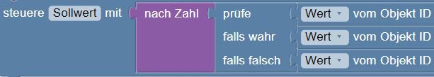

      @mipl sagte: einen Tipp geben?
      Der Datenpunkt '0_userdata.0.Heating.Bad.Komforttemp' ist nicht vom Typ "Zahl"("number"), denn bei Zahlen (22) wird keine 0 hinter dem Punkt angezeigt.

                  MiPl
                  Der Wert kann in einer VIS-Seite eingegeben werden:
                  Ein Screenshot des Blockly ist nicht möglich - viel zu lang. Ausschnitte wären machbar:
                  • M MiPl

                            @mipl sagte: keine Lösung gibt?
                            Es gibt zumindest einen Workaround: Wandle in Blockly die Datenpunktwerte nach Zahl.
                            • V Offline
                              V Offline
                              Verblizz
                              schrieb am zuletzt editiert von Verblizz
                              War Blödsinn... Paul hatte dasselbe bereits geschrieben
                                MiPl
                                ok, danke - werde ich umsetzen.
