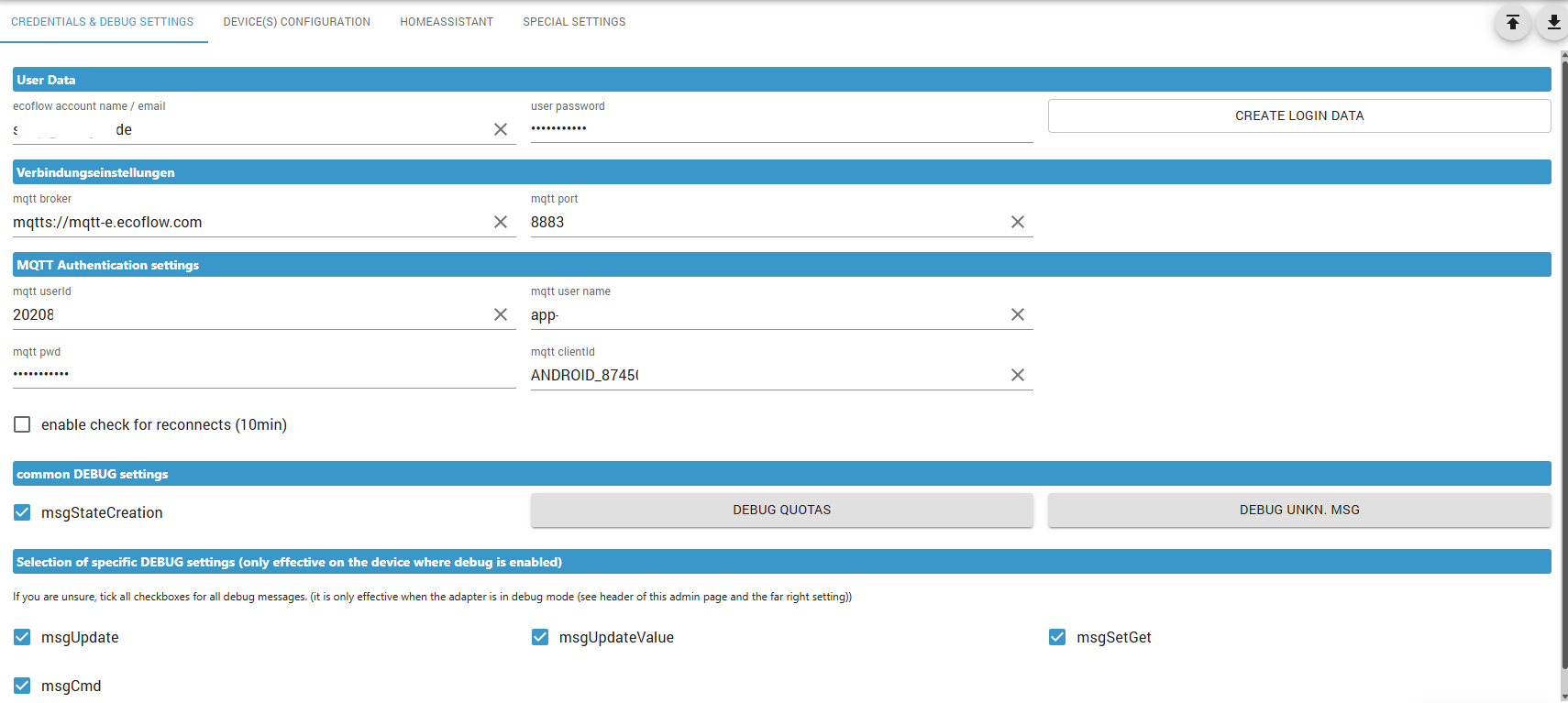

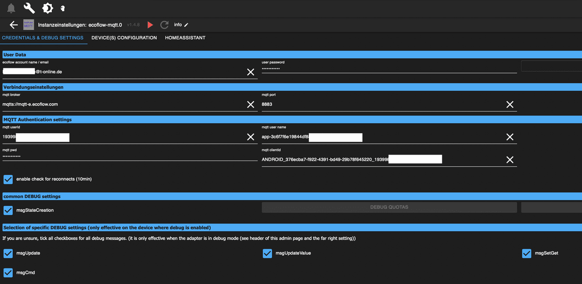

    Bei solchen Problemen mal bitte den Adapter in debug Modus versetzen.
    Die Häckchen für msgSetGet, msgUpdate und debug in der Gerätedefinition setzen.
    Dann das log vom Neustart mit einigen …[get]… und …[update]… posten.
    Dann schau ich es mir an.

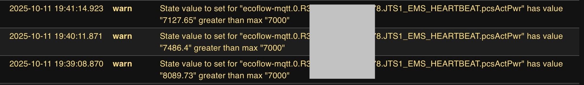

    2026-07-01 22:43:06.075 - debug: ecoflow-mqtt.0 (6901) HJ35xxxxx powerocean -> latestQuotas request
    2026-07-01 22:43:06.100 - info: ecoflow-mqtt.0 (6901) state ecoflow-mqtt.0.HJ35xxxxx.action.latestQuotas changed: true (ack = false)
    2026-07-01 22:43:06.100 - info: ecoflow-mqtt.0 (6901) (ack=false) ->cmd : channel action state latestQuotas
    2026-07-01 22:44:39.042 - warn: ecoflow-mqtt.0 (6901) State value to set for "ecoflow-mqtt.0.HJ35xxxxxxx.JTS1_ENERGY_STREAM_DETAIL.mpptPwr" has value "5001.32" greater than max "5000"
    2026-07-01 22:45:06.139 - error: ecoflow-mqtt.0 (6901) Unhandled promise rejection. This error originated either by throwing inside of an async function without a catch block, or by rejecting a promise which was not handled with .catch().
    2026-07-01 22:45:06.140 - error: ecoflow-mqtt.0 (6901) unhandled promise rejection: Cannot read properties of undefined (reading '0')
    2026-07-01 22:45:06.143 - error: ecoflow-mqtt.0 (6901) TypeError: Cannot read properties of undefined (reading '0')
    at Object.storeProtoPayload [as powerocean] (/opt/iobroker/node_modules/iobroker.ecoflow-mqtt/lib/dict_data/ef_powerocean_data.js:5667:90)
    at async MqttClient. (/opt/iobroker/node_modules/iobroker.ecoflow-mqtt/main.js:790:58)
    2026-07-01 22:45:06.143 - error: ecoflow-mqtt.0 (6901) Cannot read properties of undefined (reading '0')
    2026-07-01 22:45:06.156 - debug: ecoflow-mqtt.0 (6901) lastQuotInterval interval stopped
    2026-07-01 22:45:06.157 - debug: ecoflow-mqtt.0 (6901) msgCalc interval stopped
    2026-07-01 22:45:06.159 - info: ecoflow-mqtt.0 (6901) cleaned everything up...
    2026-07-01 22:45:06.160 - info: ecoflow-mqtt.0 (6901) terminating
    2026-07-01 22:45:06.162 - warn: ecoflow-mqtt.0 (6901) Terminated (UNCAUGHT_EXCEPTION): Without reason
    2026-07-01 22:45:06.178 - debug: ecoflow-mqtt.0 (6901) HJ35xxxxxxxxxx is offline
    2026-07-01 22:45:06.180 - info: ecoflow-mqtt.0 (6901) ecoflow connection closed
    2026-07-01 22:45:06.663 - info: ecoflow-mqtt.0 (6901) terminating
    2026-07-01 22:45:06.849 - error: host.iobroker instance system.adapter.ecoflow-mqtt.0 terminated with code 6 (UNCAUGHT_EXCEPTION)

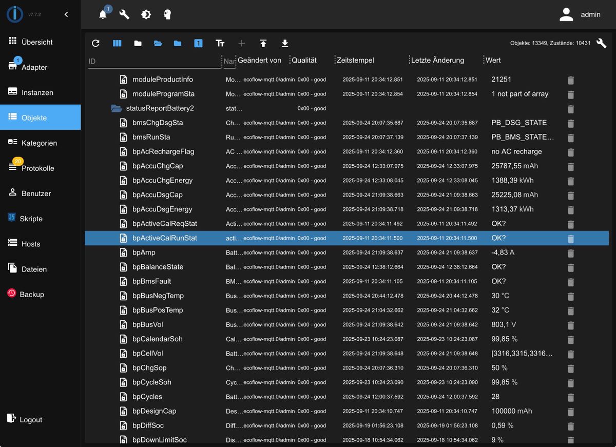

    2026-07-01 22:45:42.174 - info: ecoflow-mqtt.0 (13731) ==========================
    2026-07-01 22:45:42.174 - info: ecoflow-mqtt.0 (13731) start device state creation ->powerocean for Id HJ35xxxxxxx
    2026-07-01 22:45:42.175 - debug: ecoflow-mqtt.0 (13731) ____________________________________________
    2026-07-01 22:45:42.175 - debug: ecoflow-mqtt.0 (13731) create device HJ35xxxxxxxxx
    2026-07-01 22:45:42.217 - debug: ecoflow-mqtt.0 (13731) ____________________________________________
    2026-07-01 22:45:42.218 - debug: ecoflow-mqtt.0 (13731) create channel statusReportBattery1
    2026-07-01 22:45:42.223 - debug: ecoflow-mqtt.0 (13731) state creation bpPwr
    2026-07-01 22:45:42.230 - debug: ecoflow-mqtt.0 (13731) state creation bpSoc
    2026-07-01 22:45:42.233 - debug: ecoflow-mqtt.0 (13731) state creation bpSoh
    2026-07-01 22:45:42.236 - debug: ecoflow-mqtt.0 (13731) state creation bpSop
    2026-07-01 22:45:42.238 - debug: ecoflow-mqtt.0 (13731) state creation bpTemp
    2026-07-01 22:45:42.241 - debug: ecoflow-mqtt.0 (13731) state creation bpMaxCellVol
    2026-07-01 22:45:42.244 - debug: ecoflow-mqtt.0 (13731) state creation bpMinCellVol
    2026-07-01 22:45:42.247 - debug: ecoflow-mqtt.0 (13731) state creation bpRunSta
    2026-07-01 22:45:42.250 - debug: ecoflow-mqtt.0 (13731) state creation bpVol
    2026-07-01 22:45:42.253 - debug: ecoflow-mqtt.0 (13731) state creation bpAmp
    2026-07-01 22:45:42.256 - debug: ecoflow-mqtt.0 (13731) state creation bpBusVol
    2026-07-01 22:45:42.258 - debug: ecoflow-mqtt.0 (13731) state creation bpErrCode
    2026-07-01 22:45:42.292 - debug: ecoflow-mqtt.0 (13731) state creation bpCellVol
    2026-07-01 22:45:42.296 - debug: ecoflow-mqtt.0 (13731) state creation bpDsrc
    2026-07-01 22:45:42.301 - debug: ecoflow-mqtt.0 (13731) state creation bpSn
    2026-07-01 22:45:42.305 - debug: ecoflow-mqtt.0 (13731) state creation bpCycles
    2026-07-01 22:45:42.309 - debug: ecoflow-mqtt.0 (13731) state creation bpBalanceState
    2026-07-01 22:45:42.319 - debug: ecoflow-mqtt.0 (13731) state creation bpHvMosTemp
    2026-07-01 22:45:42.324 - debug: ecoflow-mqtt.0 (13731) state creation bpLvMosTemp
    2026-07-01 22:45:42.328 - debug: ecoflow-mqtt.0 (13731) state creation bpPtcTemp
    2026-07-01 22:45:42.330 - debug: ecoflow-mqtt.0 (13731) state creation bpHtsTemp
    2026-07-01 22:45:42.334 - debug: ecoflow-mqtt.0 (13731) state creation bpBusNegTemp
    2026-07-01 22:45:42.337 - debug: ecoflow-mqtt.0 (13731) state creation bpBusPosTemp
    2026-07-01 22:45:42.339 - debug: ecoflow-mqtt.0 (13731) state creation bpEnvTemp
    2026-07-01 22:45:42.342 - debug: ecoflow-mqtt.0 (13731) state creation bpAccuChgCap
    2026-07-01 22:45:42.344 - debug: ecoflow-mqtt.0 (13731) state creation bpAccuDsgCap
    2026-07-01 22:45:42.347 - debug: ecoflow-mqtt.0 (13731) state creation bpDesignCap
    2026-07-01 22:45:42.349 - debug: ecoflow-mqtt.0 (13731) state creation bpFullCap
    2026-07-01 22:45:42.352 - debug: ecoflow-mqtt.0 (13731) state creation bpMaxCellTemp
    2026-07-01 22:45:42.354 - debug: ecoflow-mqtt.0 (13731) state creation bpMinCellTemp
    2026-07-01 22:45:42.356 - debug: ecoflow-mqtt.0 (13731) state creation bpMaxMosTemp
    2026-07-01 22:45:42.359 - debug: ecoflow-mqtt.0 (13731) state creation bpMinMosTemp
    2026-07-01 22:45:42.361 - debug: ecoflow-mqtt.0 (13731) state creation bpBmsFault
    2026-07-01 22:45:42.392 - debug: ecoflow-mqtt.0 (13731) state creation bpEcloundSoc
    2026-07-01 22:45:42.395 - debug: ecoflow-mqtt.0 (13731) state creation bpHeartbeatVer
    2026-07-01 22:45:42.400 - debug: ecoflow-mqtt.0 (13731) state creation bpTimestamp
    2026-07-01 22:45:42.403 - debug: ecoflow-mqtt.0 (13731) state creation bpRealSoc
    2026-07-01 22:45:42.407 - debug: ecoflow-mqtt.0 (13731) state creation bpRealSoh
    2026-07-01 22:45:42.411 - debug: ecoflow-mqtt.0 (13731) state creation bpGlobalProtect
    2026-07-01 22:45:42.415 - debug: ecoflow-mqtt.0 (13731) state creation bpDownLimitSoc
    2026-07-01 22:45:42.420 - debug: ecoflow-mqtt.0 (13731) state creation bpUpLimitSoc
    2026-07-01 22:45:42.424 - debug: ecoflow-mqtt.0 (13731) state creation bpActiveCalReqStat
    2026-07-01 22:45:42.429 - debug: ecoflow-mqtt.0 (13731) state creation bpActiveCalRunStat
    2026-07-01 22:45:42.433 - debug: ecoflow-mqtt.0 (13731) state creation moduleProductInfo
    2026-07-01 22:45:42.437 - debug: ecoflow-mqtt.0 (13731) state creation moduleProgramSta
    2026-07-01 22:45:42.441 - debug: ecoflow-mqtt.0 (13731) state creation moduleAplSwVer
    2026-07-01 22:45:42.445 - debug: ecoflow-mqtt.0 (13731) state creation moduleLoaderSwVer
    2026-07-01 22:45:42.448 - debug: ecoflow-mqtt.0 (13731) state creation bmsRunSta
    2026-07-01 22:45:42.451 - debug: ecoflow-mqtt.0 (13731) state creation bmsChgDsgSta
    2026-07-01 22:45:42.455 - debug: ecoflow-mqtt.0 (13731) state creation dabModSta
    2026-07-01 22:45:42.458 - debug: ecoflow-mqtt.0 (13731) state creation bpChgSop
    2026-07-01 22:45:42.461 - debug: ecoflow-mqtt.0 (13731) state creation bpDsgSop
    2026-07-01 22:45:42.464 - debug: ecoflow-mqtt.0 (13731) state creation bpRemainWatth
    2026-07-01 22:45:42.467 - debug: ecoflow-mqtt.0 (13731) state creation bpTargetSoc
    2026-07-01 22:45:42.470 - debug: ecoflow-mqtt.0 (13731) state creation bpDiffSoc
    2026-07-01 22:45:42.474 - debug: ecoflow-mqtt.0 (13731) state creation bpMaxSoc
    2026-07-01 22:45:42.495 - debug: ecoflow-mqtt.0 (13731) state creation bpMinSoc
    2026-07-01 22:45:42.498 - debug: ecoflow-mqtt.0 (13731) state creation bpLimitSoc
    2026-07-01 22:45:42.500 - debug: ecoflow-mqtt.0 (13731) state creation bpCalendarSoh
    2026-07-01 22:45:42.503 - debug: ecoflow-mqtt.0 (13731) state creation bpCycleSoh
    2026-07-01 22:45:42.505 - debug: ecoflow-mqtt.0 (13731) state creation bpAcRechargeFlag
    2026-07-01 22:45:42.508 - debug: ecoflow-mqtt.0 (13731) state creation bpPtcHeatFlag
    2026-07-01 22:45:42.510 - debug: ecoflow-mqtt.0 (13731) state creation bpPtcExitEvent
    2026-07-01 22:45:42.513 - debug: ecoflow-mqtt.0 (13731) state creation bpAccuChgEnergy
    2026-07-01 22:45:42.515 - debug: ecoflow-mqtt.0 (13731) state creation bpAccuDsgEnergy
    2026-07-01 22:45:42.518 - debug: ecoflow-mqtt.0 (13731) state creation bpPtcTemp2
    2026-07-01 22:45:42.520 - debug: ecoflow-mqtt.0 (13731) state creation bpSysState
    2026-07-01 22:45:42.523 - debug: ecoflow-mqtt.0 (13731) ____________________________________________
    2026-07-01 22:45:42.523 - debug: ecoflow-mqtt.0 (13731) create channel statusReportBattery2
    2026-07-01 22:45:42.527 - debug: ecoflow-mqtt.0 (13731) state creation bpPwr
