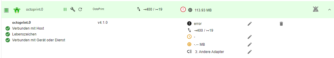

    immer wenn ich etwas mit Octoprint Drucke habe ich das im Log:
    	2023-05-12 13:00:13.773	error	(printer/printhead) status 409: {"error":"Printer is not operational or currently printing"}
    octoprint.0
    2023-05-12 13:00:11.095	error	(printer/printhead) status 409: {"error":"Printer is not operational or currently printing"}
    octoprint.0
    2023-05-12 13:00:11.015	error	(printer/printhead) status 409: {"error":"Printer is not operational or currently printing"}
    octoprint.0
    2023-05-12 13:00:10.956	error	(printer/printhead) status 409: {"error":"Printer is not operational or currently printing"}
    octoprint.0
    2023-05-12 12:47:36.783	error	(printer/printhead) status 409: {"error":"Printer is not operational or currently printing"}
    octoprint.0
    2023-05-12 12:47:34.045	error	(printer/printhead) status 409: {"error":"Printer is not operational or currently printing"}
    octoprint.0
    2023-05-12 12:47:34.025	error	(printer/printhead) status 409: {"error":"Printer is not operational or currently printing"}
    octoprint.0
    2023-05-12 12:47:33.990	error	(printer/printhead) status 409: {"error":"Printer is not operational or currently printing"}
    octoprint.0
    2023-05-12 12:35:15.855	error	(printer/printhead) status 409: {"error":"Printer is not operational or currently printing"}
    octoprint.0
    2023-05-12 12:35:13.069	error	(printer/printhead) status 409: {"error":"Printer is not operational or currently printing"}
    octoprint.0
    2023-05-12 12:35:13.034	error	(printer/printhead) status 409: {"error":"Printer is not operational or currently printing"}
    octoprint.0
    2023-05-12 12:35:12.970	error	(printer/printhead) status 409: {"error":"Printer is not operational or currently printing"}
    octoprint.0
    2023-05-12 12:22:54.805	error	(printer/printhead) status 409: {"error":"Printer is not operational or currently printing"}
    octoprint.0
    2023-05-12 12:22:52.078	error	(printer/printhead) status 409: {"error":"Printer is not operational or currently printing"}
    octoprint.0
    2023-05-12 12:22:52.040	error	(printer/printhead) status 409: {"error":"Printer is not operational or currently printing"}
    octoprint.0
    2023-05-12 12:22:51.984	error	(printer/printhead) status 409: {"error":"Printer is not operational or currently printing"}
    octoprint.0
    2023-05-12 12:10:17.986	error	(printer/printhead) status 409: {"error":"Printer is not operational or currently printing"}
    octoprint.0
    2023-05-12 12:10:15.069	error	(printer/printhead) status 409: {"error":"Printer is not operational or currently printing"}
    octoprint.0
    2023-05-12 12:10:15.026	error	(printer/printhead) status 409: {"error":"Printer is not operational or currently printing"}
    octoprint.0
    2023-05-12 12:10:14.981	error	(printer/printhead) status 409: {"error":"Printer is not operational or currently printing"}
    octoprint.0
    2023-05-12 11:45:15.785	error	(printer/printhead) status 409: {"error":"Printer is not operational or currently printing"}
    octoprint.0
    2023-05-12 11:45:13.109	error	(printer/printhead) status 409: {"error":"Printer is not operational or currently printing"}
    octoprint.0
    2023-05-12 11:45:12.991	error	(printer/printhead) status 409: {"error":"Printer is not operational or currently printing"}
    octoprint.0
    2023-05-12 11:45:12.967	error	(printer/printhead) status 409: {"error":"Printer is not operational or currently printing"}
    octoprint.0
    2023-05-12 11:32:39.756	error	(printer/printhead) status 409: {"error":"Printer is not operational or currently printing"}
    octoprint.0
    2023-05-12 11:32:37.038	error	(printer/printhead) status 409: {"error":"Printer is not operational or currently printing"}
    octoprint.0
    2023-05-12 11:32:36.994	error	(printer/printhead) status 409: {"error":"Printer is not operational or currently printing"}
    octoprint.0
    2023-05-12 11:32:36.947	error	(printer/printhead) status 409: {"error":"Printer is not operational or currently printing"}
    octoprint.0
    2023-05-12 11:20:27.774	error	(printer/printhead) status 409: {"error":"Printer is not operational or currently printing"}
    octoprint.0
    2023-05-12 11:20:25.059	error	(printer/printhead) status 409: {"error":"Printer is not operational or currently printing"}
    octoprint.0
    2023-05-12 11:20:24.979	error	(printer/printhead) status 409: {"error":"Printer is not operational or currently printing"}
    Was könnte die Ursache sein? Was der Text sagt ist mir klar. Octoprint selbst ist aber wunderbar erreichbar.

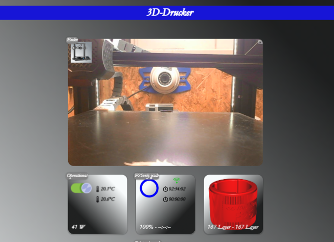

                        @djmarc75 ich denk mal, da hast du was verwechselt...
                        normal hängt ein PI vor dem drucker im netzwerk mit octoprint.
                        z.b.
                        dann gibts im ioB den octoprint adapter. der siht bei mir in iQontrol so aus:
                        woher der fehler kommt ist mir allerdings noch immer ein rätsel...
                        mein ender ist im moment aufgedreht, druckt nicht, aber keine meldungen.
                        gruß vom Woody
