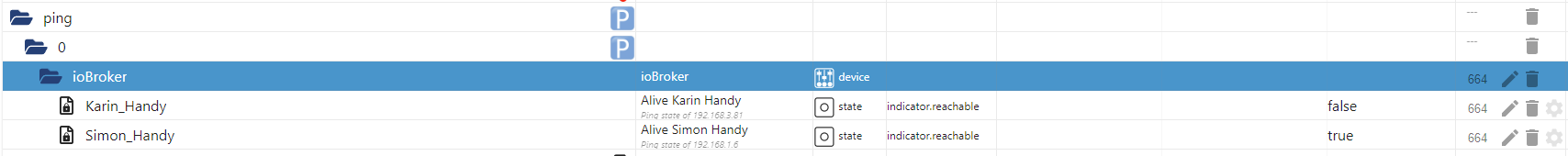

            auch mini itx, proxmox, ioB, ping adapter. keine probleme...
            b9facb5d-fa11-4dd4-808e-962de2ac188f-grafik.png 124d5d17-727b-42d6-8e1c-66e280caeb2a-grafik.png

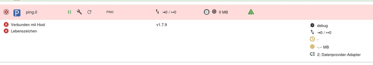

                                Ich greife den Thread noch mal auf. da mein ping-Adapter ebenfalls nicht funktioniert.
                                Thomas BraunT mcm1957M 2 Antworten Letzte Antwort

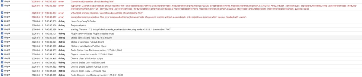

                                    @thomas-braun sorry
                                    /opt/iobroker$ iob logs ping
                                    2026-04-18 16:53:46.064  - info: ping.0 (2432846) starting. Version 1.7.9 in /opt/iobroker/node_modules/iobroker.ping, node: v22.22.1, js-controller: 7.0.7
                                    2026-04-18 16:53:46.146  - error: ping.0 (2432846) Unhandled promise rejection. This error originated either by throwing inside of an async function without a catch block, or by rejecting a promise which was not handled with .catch().
                                    2026-04-18 16:53:46.146  - error: ping.0 (2432846) unhandled promise rejection: Cannot read properties of null (reading 'trim')
                                    2026-04-18 16:53:46.148  - error: ping.0 (2432846) TypeError: Cannot read properties of null (reading 'trim')
                                    2026-04-18 16:53:46.148  - error: ping.0 (2432846) Cannot read properties of null (reading 'trim')
                                    2026-04-18 16:53:46.656  - info: ping.0 (2432846) terminating
                                    2026-04-18 16:53:46.657  - warn: ping.0 (2432846) Terminated (UNCAUGHT_EXCEPTION): Without reason
                                    2026-04-18 16:53:55.292  - debug: admin.0 (211045) Subscribes: ping.admin####jsonConfig.json
                                    2026-04-18 16:53:55.342  - debug: admin.0 (211045) Subscribes: ping.admin####jsonConfig.json, ping.admin####i18n/de/translations.json
                                    2026-04-18 16:54:18.501  - info: ping.0 (2432918) starting. Version 1.7.9 in /opt/iobroker/node_modules/iobroker.ping, node: v22.22.1, js-controller: 7.0.7
                                    2026-04-18 16:54:18.587  - error: ping.0 (2432918) Unhandled promise rejection. This error originated either by throwing inside of an async function without a catch block, or by rejecting a promise which was not handled with .catch().
                                    2026-04-18 16:54:18.587  - error: ping.0 (2432918) unhandled promise rejection: Cannot read properties of null (reading 'trim')
                                    2026-04-18 16:54:18.589  - error: ping.0 (2432918) TypeError: Cannot read properties of null (reading 'trim')
                                    2026-04-18 16:54:18.589  - error: ping.0 (2432918) Cannot read properties of null (reading 'trim')
                                    2026-04-18 16:54:19.101  - info: ping.0 (2432918) terminating
                                    2026-04-18 16:54:19.102  - warn: ping.0 (2432918) Terminated (UNCAUGHT_EXCEPTION): Without reason
                                    2026-04-18 16:54:34.838  - info: ping.0 (2432947) starting. Version 1.7.9 in /opt/iobroker/node_modules/iobroker.ping, node: v22.22.1, js-controller: 7.0.7
                                    2026-04-18 16:54:34.922  - error: ping.0 (2432947) Unhandled promise rejection. This error originated either by throwing inside of an async function without a catch block, or by rejecting a promise which was not handled with .catch().
                                    2026-04-18 16:54:34.923  - error: ping.0 (2432947) unhandled promise rejection: Cannot read properties of null (reading 'trim')
                                    2026-04-18 16:54:34.924  - error: ping.0 (2432947) TypeError: Cannot read properties of null (reading 'trim')
                                    2026-04-18 16:54:34.925  - error: ping.0 (2432947) Cannot read properties of null (reading 'trim')
                                    2026-04-18 16:54:35.433  - info: ping.0 (2432947) terminating
                                    2026-04-18 16:54:35.434  - warn: ping.0 (2432947) Terminated (UNCAUGHT_EXCEPTION): Without reason
                                    2026-04-18 16:54:36.929  - debug: admin.0 (211045) Subscribes: ping.admin####i18n/de/translations.json
                                    2026-04-18 16:55:59.862  - debug: ping.0 (2433079) Redis Objects: Use Redis connection: 127.0.0.1:9001
                                    2026-04-18 16:55:59.891  - debug: ping.0 (2433079) Objects client ready ... initialize now
                                    2026-04-18 16:55:59.892  - debug: ping.0 (2433079) Objects create System PubSub Client
                                    2026-04-18 16:55:59.892  - debug: ping.0 (2433079) Objects create User PubSub Client
                                    2026-04-18 16:55:59.944  - debug: ping.0 (2433079) Objects client initialize lua scripts
                                    2026-04-18 16:55:59.947  - debug: ping.0 (2433079) Objects connected to redis: 127.0.0.1:9001
                                    2026-04-18 16:55:59.977  - debug: ping.0 (2433079) Redis States: Use Redis connection: 127.0.0.1:9000
                                    2026-04-18 16:55:59.992  - debug: ping.0 (2433079) States create System PubSub Client
                                    2026-04-18 16:55:59.993  - debug: ping.0 (2433079) States create User PubSub Client
                                    2026-04-18 16:56:00.077  - debug: ping.0 (2433079) States connected to redis: 127.0.0.1:9000
                                    2026-04-18 16:56:00.104  - debug: ping.0 (2433079) Plugin sentry Initialize Plugin (enabled=true)
                                    2026-04-18 16:56:00.272  - info: ping.0 (2433079) starting. Version 1.7.9 in /opt/iobroker/node_modules/iobroker.ping, node: v22.22.1, js-controller: 7.0.7
                                    2026-04-18 16:56:00.357  - debug: ping.0 (2433079) Prepare objects
                                    2026-04-18 16:56:00.357  - debug: ping.0 (2433079) Host=RaspBerry5ioBroker
                                    2026-04-18 16:56:00.358  - error: ping.0 (2433079) Unhandled promise rejection. This error originated either by throwing inside of an async function without a catch block, or by rejecting a promise which was not handled with .catch().
                                    2026-04-18 16:56:00.358  - error: ping.0 (2433079) unhandled promise rejection: Cannot read properties of null (reading 'trim')
                                    2026-04-18 16:56:00.360  - error: ping.0 (2433079) TypeError: Cannot read properties of null (reading 'trim')
                                    2026-04-18 16:56:00.360  - error: ping.0 (2433079) Cannot read properties of null (reading 'trim')
                                    2026-04-18 16:56:00.522  - debug: ping.0 (2433079) System command: /bin/ping -n -w 2 -c 1 192.168.2.1
                                    2026-04-18 16:56:00.611  - debug: ping.0 (2433079) System command: /bin/ping -n -w 2 -c 1 192.168.2.2
                                    2026-04-18 16:56:00.670  - debug: ping.0 (2433079) System command: /bin/ping -n -w 2 -c 1 192.168.2.3
                                    2026-04-18 16:56:00.726  - debug: ping.0 (2433079) System command: /bin/ping -n -w 2 -c 1 192.168.2.4
                                    2026-04-18 16:56:00.868  - info: ping.0 (2433079) terminating
                                    2026-04-18 16:56:00.869  - debug: ping.0 (2433079) Plugin sentry destroyed
                                    2026-04-18 16:56:00.869  - warn: ping.0 (2433079) Terminated (UNCAUGHT_EXCEPTION): Without reason
                                    2026-04-18 16:56:01.261  - info: ping.0 (2433079) Got terminate signal TERMINATE_YOURSELF
                                    2026-04-18 16:56:04.074  - debug: ping.0 (2433108) Redis Objects: Use Redis connection: 127.0.0.1:9001
                                    2026-04-18 16:56:04.100  - debug: ping.0 (2433108) Objects client ready ... initialize now
                                    2026-04-18 16:56:04.101  - debug: ping.0 (2433108) Objects create System PubSub Client
                                    2026-04-18 16:56:04.102  - debug: ping.0 (2433108) Objects create User PubSub Client
                                    2026-04-18 16:56:04.155  - debug: ping.0 (2433108) Objects client initialize lua scripts
                                    2026-04-18 16:56:04.158  - debug: ping.0 (2433108) Objects connected to redis: 127.0.0.1:9001
                                    2026-04-18 16:56:04.189  - debug: ping.0 (2433108) Redis States: Use Redis connection: 127.0.0.1:9000
                                    2026-04-18 16:56:04.251  - debug: ping.0 (2433108) States create System PubSub Client
                                    2026-04-18 16:56:04.252  - debug: ping.0 (2433108) States create User PubSub Client
                                    2026-04-18 16:56:04.317  - debug: ping.0 (2433108) States connected to redis: 127.0.0.1:9000
                                    2026-04-18 16:56:04.341  - debug: ping.0 (2433108) Plugin sentry Initialize Plugin (enabled=true)
                                    2026-04-18 16:56:04.505  - info: ping.0 (2433108) starting. Version 1.7.9 in /opt/iobroker/node_modules/iobroker.ping, node: v22.22.1, js-controller: 7.0.7
                                    2026-04-18 16:56:04.590  - debug: ping.0 (2433108) Prepare objects
                                    2026-04-18 16:56:04.590  - debug: ping.0 (2433108) Host=RaspBerry5ioBroker
                                    2026-04-18 16:56:04.591  - error: ping.0 (2433108) Unhandled promise rejection. This error originated either by throwing inside of an async function without a catch block, or by rejecting a promise which was not handled with .catch().
                                    2026-04-18 16:56:04.591  - error: ping.0 (2433108) unhandled promise rejection: Cannot read properties of null (reading 'trim')
                                    2026-04-18 16:56:04.593  - error: ping.0 (2433108) TypeError: Cannot read properties of null (reading 'trim')
                                    2026-04-18 16:56:04.593  - error: ping.0 (2433108) Cannot read properties of null (reading 'trim')
                                    2026-04-18 16:56:04.744  - debug: ping.0 (2433108) System command: /bin/ping -n -w 2 -c 1 192.168.2.1
                                    2026-04-18 16:56:04.831  - debug: ping.0 (2433108) System command: /bin/ping -n -w 2 -c 1 192.168.2.2
                                    2026-04-18 16:56:04.890  - debug: ping.0 (2433108) System command: /bin/ping -n -w 2 -c 1 192.168.2.3
                                    2026-04-18 16:56:04.946  - debug: ping.0 (2433108) System command: /bin/ping -n -w 2 -c 1 192.168.2.4
                                    2026-04-18 16:56:05.101  - info: ping.0 (2433108) terminating
                                    2026-04-18 16:56:05.102  - debug: ping.0 (2433108) Plugin sentry destroyed
                                    2026-04-18 16:56:05.102  - warn: ping.0 (2433108) Terminated (UNCAUGHT_EXCEPTION): Without reason
                                    2026-04-18 16:56:36.594  - debug: ping.0 (2433137) Redis Objects: Use Redis connection: 127.0.0.1:9001
                                    2026-04-18 16:56:36.620  - debug: ping.0 (2433137) Objects client ready ... initialize now
                                    2026-04-18 16:56:36.620  - debug: ping.0 (2433137) Objects create System PubSub Client
                                    2026-04-18 16:56:36.621  - debug: ping.0 (2433137) Objects create User PubSub Client
                                    2026-04-18 16:56:36.671  - debug: ping.0 (2433137) Objects client initialize lua scripts
                                    2026-04-18 16:56:36.673  - debug: ping.0 (2433137) Objects connected to redis: 127.0.0.1:9001
                                    2026-04-18 16:56:36.703  - debug: ping.0 (2433137) Redis States: Use Redis connection: 127.0.0.1:9000
                                    2026-04-18 16:56:36.763  - debug: ping.0 (2433137) States create System PubSub Client
                                    2026-04-18 16:56:36.764  - debug: ping.0 (2433137) States create User PubSub Client
                                    2026-04-18 16:56:36.836  - debug: ping.0 (2433137) States connected to redis: 127.0.0.1:9000
                                    2026-04-18 16:56:36.861  - debug: ping.0 (2433137) Plugin sentry Initialize Plugin (enabled=true)
                                    2026-04-18 16:56:37.002  - info: ping.0 (2433137) starting. Version 1.7.9 in /opt/iobroker/node_modules/iobroker.ping, node: v22.22.1, js-controller: 7.0.7
                                    2026-04-18 16:56:37.081  - debug: ping.0 (2433137) Prepare objects
                                    2026-04-18 16:56:37.081  - debug: ping.0 (2433137) Host=RaspBerry5ioBroker
                                    2026-04-18 16:56:37.082  - error: ping.0 (2433137) Unhandled promise rejection. This error originated either by throwing inside of an async function without a catch block, or by rejecting a promise which was not handled with .catch().
                                    2026-04-18 16:56:37.082  - error: ping.0 (2433137) unhandled promise rejection: Cannot read properties of null (reading 'trim')
                                    2026-04-18 16:56:37.084  - error: ping.0 (2433137) TypeError: Cannot read properties of null (reading 'trim')
                                    2026-04-18 16:56:37.084  - error: ping.0 (2433137) Cannot read properties of null (reading 'trim')
                                    2026-04-18 16:56:37.250  - debug: ping.0 (2433137) System command: /bin/ping -n -w 2 -c 1 192.168.2.1
                                    2026-04-18 16:56:37.343  - debug: ping.0 (2433137) System command: /bin/ping -n -w 2 -c 1 192.168.2.2
                                    2026-04-18 16:56:37.402  - debug: ping.0 (2433137) System command: /bin/ping -n -w 2 -c 1 192.168.2.3
                                    2026-04-18 16:56:37.458  - debug: ping.0 (2433137) System command: /bin/ping -n -w 2 -c 1 192.168.2.4
                                    2026-04-18 16:56:37.593  - info: ping.0 (2433137) terminating
                                    2026-04-18 16:56:37.593  - debug: ping.0 (2433137) Plugin sentry destroyed
                                    2026-04-18 16:56:37.593  - warn: ping.0 (2433137) Terminated (UNCAUGHT_EXCEPTION): Without reason
                                    2026-04-18 16:57:09.067  - debug: ping.0 (2433213) Redis Objects: Use Redis connection: 127.0.0.1:9001
                                    2026-04-18 16:57:09.095  - debug: ping.0 (2433213) Objects client ready ... initialize now
                                    2026-04-18 16:57:09.095  - debug: ping.0 (2433213) Objects create System PubSub Client
                                    2026-04-18 16:57:09.096  - debug: ping.0 (2433213) Objects create User PubSub Client
                                    2026-04-18 16:57:09.146  - debug: ping.0 (2433213) Objects client initialize lua scripts
                                    2026-04-18 16:57:09.148  - debug: ping.0 (2433213) Objects connected to redis: 127.0.0.1:9001
                                    2026-04-18 16:57:09.178  - debug: ping.0 (2433213) Redis States: Use Redis connection: 127.0.0.1:9000
                                    2026-04-18 16:57:09.194  - debug: ping.0 (2433213) States create System PubSub Client
                                    2026-04-18 16:57:09.195  - debug: ping.0 (2433213) States create User PubSub Client
                                    2026-04-18 16:57:09.268  - debug: ping.0 (2433213) States connected to redis: 127.0.0.1:9000
                                    2026-04-18 16:57:09.298  - debug: ping.0 (2433213) Plugin sentry Initialize Plugin (enabled=true)
                                    2026-04-18 16:57:09.466  - info: ping.0 (2433213) starting. Version 1.7.9 in /opt/iobroker/node_modules/iobroker.ping, node: v22.22.1, js-controller: 7.0.7
                                    2026-04-18 16:57:09.558  - debug: ping.0 (2433213) Prepare objects
                                    2026-04-18 16:57:09.558  - debug: ping.0 (2433213) Host=RaspBerry5ioBroker
                                    2026-04-18 16:57:09.559  - error: ping.0 (2433213) Unhandled promise rejection. This error originated either by throwing inside of an async function without a catch block, or by rejecting a promise which was not handled with .catch().
                                    2026-04-18 16:57:09.559  - error: ping.0 (2433213) unhandled promise rejection: Cannot read properties of null (reading 'trim')
                                    2026-04-18 16:57:09.561  - error: ping.0 (2433213) TypeError: Cannot read properties of null (reading 'trim')
                                    2026-04-18 16:57:09.561  - error: ping.0 (2433213) Cannot read properties of null (reading 'trim')
                                    2026-04-18 16:57:09.729  - debug: ping.0 (2433213) System command: /bin/ping -n -w 2 -c 1 192.168.2.1
                                    2026-04-18 16:57:09.827  - debug: ping.0 (2433213) System command: /bin/ping -n -w 2 -c 1 192.168.2.2
                                    2026-04-18 16:57:09.882  - debug: ping.0 (2433213) System command: /bin/ping -n -w 2 -c 1 192.168.2.3
                                    2026-04-18 16:57:09.938  - debug: ping.0 (2433213) System command: /bin/ping -n -w 2 -c 1 192.168.2.4
                                    2026-04-18 16:57:10.070  - info: ping.0 (2433213) terminating
                                    2026-04-18 16:57:10.071  - debug: ping.0 (2433213) Plugin sentry destroyed
                                    2026-04-18 16:57:10.071  - warn: ping.0 (2433213) Terminated (UNCAUGHT_EXCEPTION): Without reason
                                    2026-04-18 17:00:44.829  - debug: ping.0 (2433406) Redis Objects: Use Redis connection: 127.0.0.1:9001
                                    2026-04-18 17:00:44.855  - debug: ping.0 (2433406) Objects client ready ... initialize now
                                    2026-04-18 17:00:44.862  - debug: ping.0 (2433406) Objects create System PubSub Client
                                    2026-04-18 17:00:44.863  - debug: ping.0 (2433406) Objects create User PubSub Client
                                    2026-04-18 17:00:44.915  - debug: ping.0 (2433406) Objects client initialize lua scripts
                                    2026-04-18 17:00:44.933  - debug: ping.0 (2433406) Objects connected to redis: 127.0.0.1:9001
                                    2026-04-18 17:00:44.963  - debug: ping.0 (2433406) Redis States: Use Redis connection: 127.0.0.1:9000
                                    2026-04-18 17:00:45.023  - debug: ping.0 (2433406) States create System PubSub Client
                                    2026-04-18 17:00:45.024  - debug: ping.0 (2433406) States create User PubSub Client
                                    2026-04-18 17:00:45.096  - debug: ping.0 (2433406) States connected to redis: 127.0.0.1:9000
                                    2026-04-18 17:00:45.121  - debug: ping.0 (2433406) Plugin sentry Initialize Plugin (enabled=true)
                                    2026-04-18 17:00:45.278  - info: ping.0 (2433406) starting. Version 1.7.9 in /opt/iobroker/node_modules/iobroker.ping, node: v22.22.1, js-controller: 7.0.7
                                    2026-04-18 17:00:45.366  - debug: ping.0 (2433406) Prepare objects
                                    2026-04-18 17:00:45.366  - debug: ping.0 (2433406) Host=RaspBerry5ioBroker
                                    2026-04-18 17:00:45.367  - error: ping.0 (2433406) Unhandled promise rejection. This error originated either by throwing inside of an async function without a catch block, or by rejecting a promise which was not handled with .catch().
                                    2026-04-18 17:00:45.367  - error: ping.0 (2433406) unhandled promise rejection: Cannot read properties of null (reading 'trim')
                                    2026-04-18 17:00:45.369  - error: ping.0 (2433406) TypeError: Cannot read properties of null (reading 'trim')
                                    2026-04-18 17:00:45.369  - error: ping.0 (2433406) Cannot read properties of null (reading 'trim')
                                    2026-04-18 17:00:45.539  - debug: ping.0 (2433406) System command: /bin/ping -n -w 2 -c 1 192.168.2.1
                                    2026-04-18 17:00:45.643  - debug: ping.0 (2433406) System command: /bin/ping -n -w 2 -c 1 192.168.2.2
                                    2026-04-18 17:00:45.698  - debug: ping.0 (2433406) System command: /bin/ping -n -w 2 -c 1 192.168.2.3
                                    2026-04-18 17:00:45.754  - debug: ping.0 (2433406) System command: /bin/ping -n -w 2 -c 1 192.168.2.4
                                    2026-04-18 17:00:45.880  - info: ping.0 (2433406) terminating
                                    2026-04-18 17:00:45.880  - debug: ping.0 (2433406) Plugin sentry destroyed
                                    2026-04-18 17:00:45.881  - warn: ping.0 (2433406) Terminated (UNCAUGHT_EXCEPTION): Without reason
                                    2026-04-18 17:01:17.457  - debug: ping.0 (2433485) Redis Objects: Use Redis connection: 127.0.0.1:9001
                                    2026-04-18 17:01:17.483  - debug: ping.0 (2433485) Objects client ready ... initialize now
                                    2026-04-18 17:01:17.484  - debug: ping.0 (2433485) Objects create System PubSub Client
                                    2026-04-18 17:01:17.484  - debug: ping.0 (2433485) Objects create User PubSub Client
                                    2026-04-18 17:01:17.541  - debug: ping.0 (2433485) Objects client initialize lua scripts
                                    2026-04-18 17:01:17.544  - debug: ping.0 (2433485) Objects connected to redis: 127.0.0.1:9001
                                    2026-04-18 17:01:17.575  - debug: ping.0 (2433485) Redis States: Use Redis connection: 127.0.0.1:9000
                                    2026-04-18 17:01:17.592  - debug: ping.0 (2433485) States create System PubSub Client
                                    2026-04-18 17:01:17.593  - debug: ping.0 (2433485) States create User PubSub Client
                                    2026-04-18 17:01:17.664  - debug: ping.0 (2433485) States connected to redis: 127.0.0.1:9000
                                    2026-04-18 17:01:17.688  - debug: ping.0 (2433485) Plugin sentry Initialize Plugin (enabled=true)
                                    2026-04-18 17:01:17.841  - info: ping.0 (2433485) starting. Version 1.7.9 in /opt/iobroker/node_modules/iobroker.ping, node: v22.22.1, js-controller: 7.0.7
                                    2026-04-18 17:01:17.921  - debug: ping.0 (2433485) Prepare objects
                                    2026-04-18 17:01:17.921  - debug: ping.0 (2433485) Host=RaspBerry5ioBroker
                                    2026-04-18 17:01:17.922  - error: ping.0 (2433485) Unhandled promise rejection. This error originated either by throwing inside of an async function without a catch block, or by rejecting a promise which was not handled with .catch().
                                    2026-04-18 17:01:17.922  - error: ping.0 (2433485) unhandled promise rejection: Cannot read properties of null (reading 'trim')
                                    2026-04-18 17:01:17.924  - error: ping.0 (2433485) TypeError: Cannot read properties of null (reading 'trim')
                                    2026-04-18 17:01:17.924  - error: ping.0 (2433485) Cannot read properties of null (reading 'trim')
                                    2026-04-18 17:01:18.078  - debug: ping.0 (2433485) System command: /bin/ping -n -w 2 -c 1 192.168.2.1
                                    2026-04-18 17:01:18.165  - debug: ping.0 (2433485) System command: /bin/ping -n -w 2 -c 1 192.168.2.2
                                    2026-04-18 17:01:18.222  - debug: ping.0 (2433485) System command: /bin/ping -n -w 2 -c 1 192.168.2.3
                                    2026-04-18 17:01:18.278  - debug: ping.0 (2433485) System command: /bin/ping -n -w 2 -c 1 192.168.2.4
                                    2026-04-18 17:01:18.432  - info: ping.0 (2433485) terminating
                                    2026-04-18 17:01:18.432  - debug: ping.0 (2433485) Plugin sentry destroyed
                                    2026-04-18 17:01:18.433  - warn: ping.0 (2433485) Terminated (UNCAUGHT_EXCEPTION): Without reason
                                    2026-04-18 17:01:49.953  - debug: ping.0 (2433514) Redis Objects: Use Redis connection: 127.0.0.1:9001
                                    2026-04-18 17:01:49.978  - debug: ping.0 (2433514) Objects client ready ... initialize now
                                    2026-04-18 17:01:49.978  - debug: ping.0 (2433514) Objects create System PubSub Client
                                    2026-04-18 17:01:49.979  - debug: ping.0 (2433514) Objects create User PubSub Client
                                    2026-04-18 17:01:50.030  - debug: ping.0 (2433514) Objects client initialize lua scripts
                                    2026-04-18 17:01:50.032  - debug: ping.0 (2433514) Objects connected to redis: 127.0.0.1:9001
                                    2026-04-18 17:01:50.063  - debug: ping.0 (2433514) Redis States: Use Redis connection: 127.0.0.1:9000
                                    2026-04-18 17:01:50.119  - debug: ping.0 (2433514) States create System PubSub Client
                                    2026-04-18 17:01:50.120  - debug: ping.0 (2433514) States create User PubSub Client
                                    2026-04-18 17:01:50.192  - debug: ping.0 (2433514) States connected to redis: 127.0.0.1:9000
                                    2026-04-18 17:01:50.219  - debug: ping.0 (2433514) Plugin sentry Initialize Plugin (enabled=true)
                                    2026-04-18 17:01:50.357  - info: ping.0 (2433514) starting. Version 1.7.9 in /opt/iobroker/node_modules/iobroker.ping, node: v22.22.1, js-controller: 7.0.7
                                    2026-04-18 17:01:50.437  - debug: ping.0 (2433514) Prepare objects
                                    2026-04-18 17:01:50.437  - debug: ping.0 (2433514) Host=RaspBerry5ioBroker
                                    2026-04-18 17:01:50.438  - error: ping.0 (2433514) Unhandled promise rejection. This error originated either by throwing inside of an async function without a catch block, or by rejecting a promise which was not handled with .catch().
                                    2026-04-18 17:01:50.438  - error: ping.0 (2433514) unhandled promise rejection: Cannot read properties of null (reading 'trim')
                                    2026-04-18 17:01:50.440  - error: ping.0 (2433514) TypeError: Cannot read properties of null (reading 'trim')
                                    2026-04-18 17:01:50.440  - error: ping.0 (2433514) Cannot read properties of null (reading 'trim')
                                    2026-04-18 17:01:50.600  - debug: ping.0 (2433514) System command: /bin/ping -n -w 2 -c 1 192.168.2.1
                                    2026-04-18 17:01:50.691  - debug: ping.0 (2433514) System command: /bin/ping -n -w 2 -c 1 192.168.2.2
                                    2026-04-18 17:01:50.750  - debug: ping.0 (2433514) System command: /bin/ping -n -w 2 -c 1 192.168.2.3
                                    2026-04-18 17:01:50.806  - debug: ping.0 (2433514) System command: /bin/ping -n -w 2 -c 1 192.168.2.4
                                    2026-04-18 17:01:50.947  - info: ping.0 (2433514) terminating
                                    2026-04-18 17:01:50.948  - debug: ping.0 (2433514) Plugin sentry destroyed
                                    2026-04-18 17:01:50.948  - warn: ping.0 (2433514) Terminated (UNCAUGHT_EXCEPTION): Without reason
