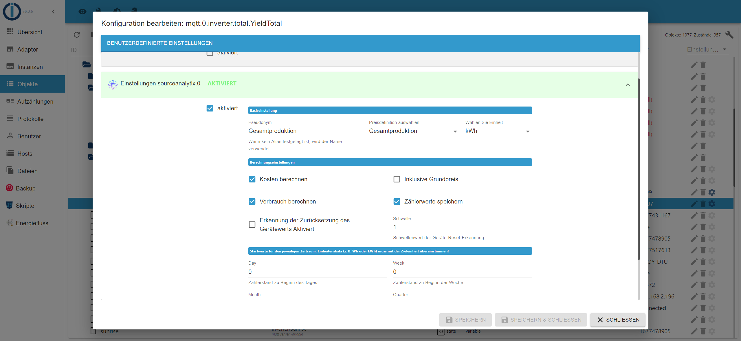

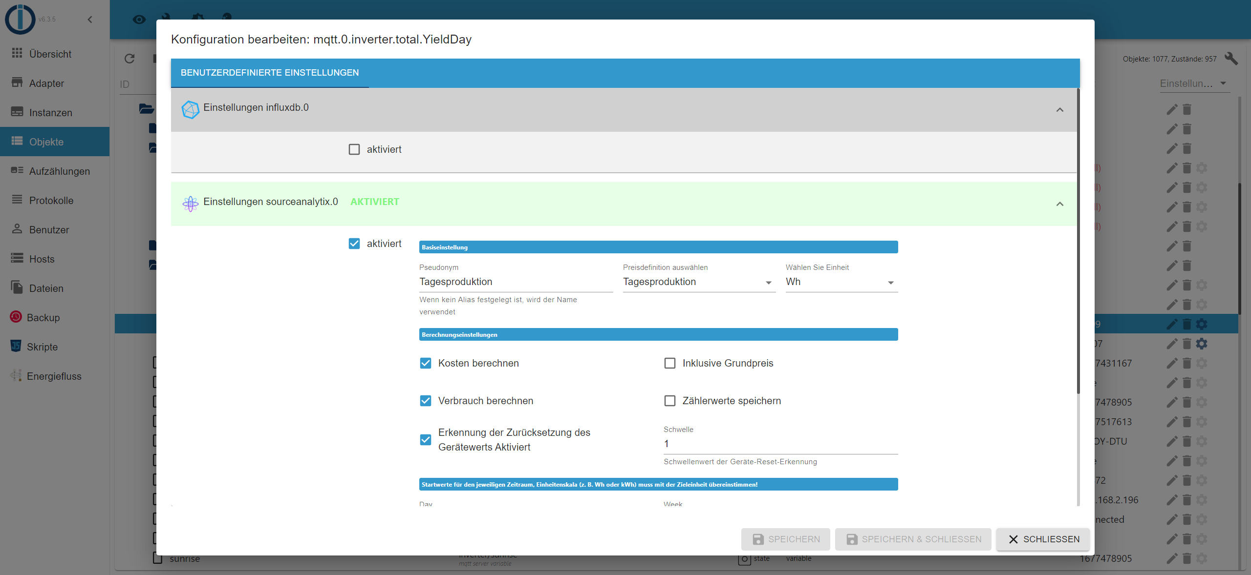

    Hallo Gemeinde.
    Ich bekomme diese Fehler:
    [Cannot enable SourceAnalytix for mqtt.0.inverter.total.YieldTotal, check settings and error messages
    Cannot handle calculations for mqtt.0.inverter.total.YieldTotal, check log messages and adjust settings!
    Troubleshoot Data mqtt.0.inverter.total.YieldTotal custom Data : {"_id":"mqtt.0.inverter.total.YieldTotal","common":{"name":"inverter/total/YieldTotal","write":true,"read":true,"role":"variable","desc":"mqtt server variable","type":"number","color":"#ff0000","custom":{"sourceanalytix.0":{"enabled":true,"selectedUnit":"kWh","deviceResetLogicEnabled":false,"threshold":1,"start_day":0,"start_week":0,"start_month":0,"start_quarter":0,"start_year":0,"alias":"Gesamtproduktion","selectedPrice":"Gesamtproduktion","consumption":true,"valueAtDeviceReset":47.588,"valueAtDeviceInit":0,"cumulativeValue":22.861,"costs":true,"meter_values":true}}},"native":{"topic":"inverter/total/YieldTotal"},"type":"state","acl":{"object":1636,"state":1636,"owner":"system.user.admin","ownerGroup":"system.group.administrator"},"from":"system.adapter.admin.0","user":"system.user.admin","ts":1677429752558}
    und
    Troubleshoot Data mqtt.0.inverter.total.YieldDay custom Data : {"_id":"mqtt.0.inverter.total.YieldDay","common":{"name":"inverter/total/YieldDay","write":true,"read":true,"role":"variable","desc":"mqtt server variable","type":"number","color":"#ff0000","custom":{"sourceanalytix.0":{"enabled":true,"selectedUnit":"Wh","deviceResetLogicEnabled":true,"threshold":1,"start_day":0,"start_week":0,"start_month":0,"start_quarter":0,"start_year":0,"alias":"Tagesproduktion","selectedPrice":"Tagesproduktion","costs":true,"consumption":true,"valueAtDeviceReset":1.824,"valueAtDeviceInit":0.263}}},"native":{"topic":"inverter/total/YieldDay"},"type":"state","acl":{"object":1636,"state":1636,"owner":"system.user.admin","ownerGroup":"system.group.administrator"},"from":"system.adapter.sourceanalytix.0","user":"system.user.admin","ts":1677249489790}

      @werner4321 warum yieldday/Tagesproduktion, das ergibt sich doch automatisch wenn du total loggst.
      hier wurde ein device reset erkannt
      @werner4321 sagte in SourceAnalytic Fehler:
