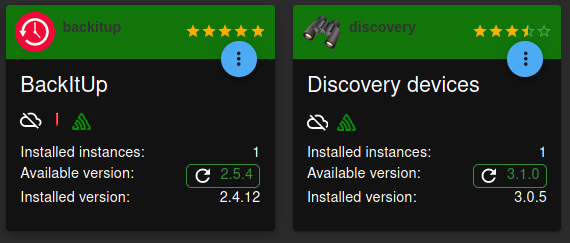

    die beiden Adapter koennen nicht upgegraded werden?
    Wie kann ich das beheben?
    Habe das schon in der Konsole probiert , funktioniert auch nicht.
    vielen Dank fuer Eure Hilfe

                Wenn ich schon versuche aus Deinem Bildchen etwas zu lesen, sehe ich 2x die identische Ausgabe.
                HmIP|ZigBee|Tasmota|Unifi

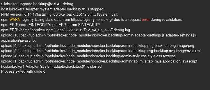

                  @codierknecht
                  $ iobroker upgrade discovery@3.1.0
                  Update discovery from @3.0.5 to @3.1.0
                  NPM version: 6.14.17
                  Installing iobroker.discovery@3.1.0... (System call)
                  upload [6] discovery.admin /opt/iobroker/node_modules/iobroker.discovery/admin/discovery.png discovery.png image/png
                  upload [2] discovery.admin /opt/iobroker/node_modules/iobroker.discovery/admin/settings_m.html settings_m.html text/html
                  upload [0] discovery.admin /opt/iobroker/node_modules/iobroker.discovery/admin/words.js words.js application/javascript
                  Process exited with code 0

                      @homoran Problem :immer wieder sagt er das die alte Version drauf ist und ich upgraden soll.
                      und das bei beiden Adaptern

                                @fred-freund trotz
                                $ iobroker upgrade backitup@2.5.4 --debug
                                host.iobroker1 Adapter "system.adapter.backitup.0" is stopped.
                                NPM version: 8.19.2
                                Installing iobroker.backitup@2.5.4... (System call)
                                npm WARN old lockfile npm WARN old lockfile The package-lock.json file was created with an old version of npm,npm WARN old lockfile so supplemental metadata must be fetched from the registry.npm WARN old lockfile npm WARN old lockfile This is a one-time fix-up, please be patient...npm WARN old lockfile
                                npm WARN old lockfile FetchError: invalid json response body at https://registry.npmjs.org/@types%2fiobroker reason: Invalid response body while trying to fetch https://registry.npmjs.org/@types%2fiobroker: sha512-ZGXiTsAdkwOiVVRyqX4NJ7zNEIUT5h9pBjM96xp+qkyzlBWXZsRGBax17lus28B+rkFLrN0mfqMvlKnVnRVOYQ== integrity checksum failed when using sha512: wanted sha512-ZGXiTsAdkwOiVVRyqX4NJ7zNEIUT5h9pBjM96xp+qkyzlBWXZsRGBax17lus28B+rkFLrN0mfqMvlKnVnRVOYQ== but got sha512-z4PhNX7vuL3xVChQ1m2AB9Yg5AULVxXcg/SpIdNs6c5H0NE8XYXysP+DGNKHfuwvY7kxvUdBeoGlODJ6+SfaPg==. (0 bytes)npm WARN old lockfile at Response.json (/usr/lib/node_modules/npm/node_modules/minipass-fetch/lib/body.js:79:13)npm WARN old lockfile at async RegistryFetcher.packument (/usr/lib/node_modules/npm/node_modules/pacote/lib/registry.js:99:25)npm WARN old lockfile at async RegistryFetcher.manifest (/usr/lib/node_modules/npm/node_modules/pacote/lib/registry.js:124:23)npm WARN old lockfile at async Array.<anonymous> (/usr/lib/node_modules/npm/node_modules/@npmcli/arborist/lib/arborist/build-ideal-tree.js:738:24)npm WARN old lockfile Could not fetch metadata for @types/iobroker@4.0.5 FetchError: invalid json response body at https://registry.npmjs.org/@types%2fiobroker reason: Invalid response body while trying to fetch https://registry.npmjs.org/@types%2fiobroker: sha512-ZGXiTsAdkwOiVVRyqX4NJ7zNEIUT5h9pBjM96xp+qkyzlBWXZsRGBax17lus28B+rkFLrN0mfqMvlKnVnRVOYQ== integrity checksum failed when using sha512: wanted sha512-ZGXiTsAdkwOiVVRyqX4NJ7zNEIUT5h9pBjM96xp+qkyzlBWXZsRGBax17lus28B+rkFLrN0mfqMvlKnVnRVOYQ== but got sha512-z4PhNX7vuL3xVChQ1m2AB9Yg5AULVxXcg/SpIdNs6c5H0NE8XYXysP+DGNKHfuwvY7kxvUdBeoGlODJ6+SfaPg==. (0 bytes)npm WARN old lockfile at Response.json (/usr/lib/node_modules/npm/node_modules/minipass-fetch/lib/body.js:79:13)npm WARN old lockfile at async RegistryFetcher.packument (/usr/lib/node_modules/npm/node_modules/pacote/lib/registry.js:99:25)npm WARN old lockfile at async RegistryFetcher.manifest (/usr/lib/node_modules/npm/node_modules/pacote/lib/registry.js:124:23)npm WARN old lockfile at async Array.<anonymous> (/usr/lib/node_modules/npm/node_modules/@npmcli/arborist/lib/arborist/build-ideal-tree.js:738:24) {npm WARN old lockfile code: 'FETCH_ERROR',npm WARN old lockfile errno: 'FETCH_ERROR',npm WARN old lockfile type: 'invalid-json'npm WARN old lockfile }
                                removed 107 packages, and changed 21 packages in 2m126 packages are looking for funding run `npm fund` for details
                                Update "system.adapter.backitup.0"
                                upload [19] backitup.admin /opt/iobroker/node_modules/iobroker.backitup/admin/adapter-settings.js adapter-settings.js application/javascript
                                upload [18] backitup.admin /opt/iobroker/node_modules/iobroker.backitup/admin/backitup.png backitup.png image/png
                                upload [17] backitup.admin /opt/iobroker/node_modules/iobroker.backitup/admin/backitup.svg backitup.svg image/svg+xml
                                upload [11] backitup.admin /opt/iobroker/node_modules/iobroker.backitup/admin/i18n/nl/translations.json i18n/nl/translations.json application/json
                                host.iobroker1 Adapter "system.adapter.backitup.0" is started
                                Beide Adapter gingen jetzt :...os update/ js update. sorry ...mein Fehler
