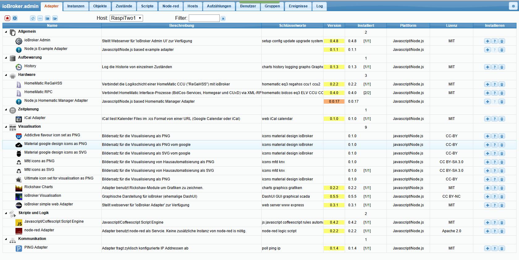

    Stmiko
    ich bekomme beim Starten der Instanz von Node-Red eine Exception
    ` > node-red-0 2015-05-30 09:46:26 info node-red exited with 8
    node-red-0 2015-05-30 09:46:26 warn at Object. (/opt/iobroker/node_modules/iobroker.node-red/node_modules/node-red/node_modules/express/index.js:2:18)
    node-red-0 2015-05-30 09:46:26 warn at require (module.js:380:17)
    node-red-0 2015-05-30 09:46:26 warn at Module.require (module.js:364:17)
    node-red-0 2015-05-30 09:46:26 warn at Function.Module._load (module.js:312:12)
    node-red-0 2015-05-30 09:46:26 warn at Module.load (module.js:356:32)
    node-red-0 2015-05-30 09:46:26 warn at Object.Module._extensions..js (module.js:474:10)
    node-red-0 2015-05-30 09:46:26 warn at Module._compile (module.js:456:26)
    node-red-0 2015-05-30 09:46:26 warn at Object. (/opt/iobroker/node_modules/iobroker.node-red/node_modules/node-red/node_modules/express/lib/express.js:48:1)
    node-red-0 2015-05-30 09:46:26 warn at module.exports (/opt/iobroker/node_modules/iobroker.node-red/node_modules/node-red/node_modules/express/node_modules/merge-descriptors/index.js:2:10)
    node-red-0 2015-05-30 09:46:26 warn at Function.getOwnPropertyNames (native)
    node-red-0 2015-05-30 09:46:26 warn TypeError: Object.getOwnPropertyNames called on non-object
    node-red-0 2015-05-30 09:46:26 warn ^
    node-red-0 2015-05-30 09:46:26 warn Object.getOwnPropertyNames(src).forEach(function (name) {
    node-red-0 2015-05-30 09:46:26 warn /opt/iobroker/node_modules/iobroker.node-red/node_modules/node-red/node_modules/express/node_modules/merge-descriptors/index.js:2
    node-red-0 2015-05-30 09:46:26 info Starting node-red: /opt/iobroker/node_modules/iobroker.node-red/node_modules/node-red/red.js -v –settings /opt/iobroker/node_modules/iobroker.node-red/userdata/settings.js `
    Mehrfaches Installieren/Deinstallieren und Neustart bringen keine Besserung (Raspi2).
    Konfiguration:
    iobroker auf Intel NUC mit Proxmox LXC und Raspi3+
      Stmiko
      Ok,
      hat sich erledigt.
      Habe nach der Deinstallation das node-red Verzeichnis unter node-modules von Hand gelöscht und dann neu installiert.
      Jetzt läufts :)
