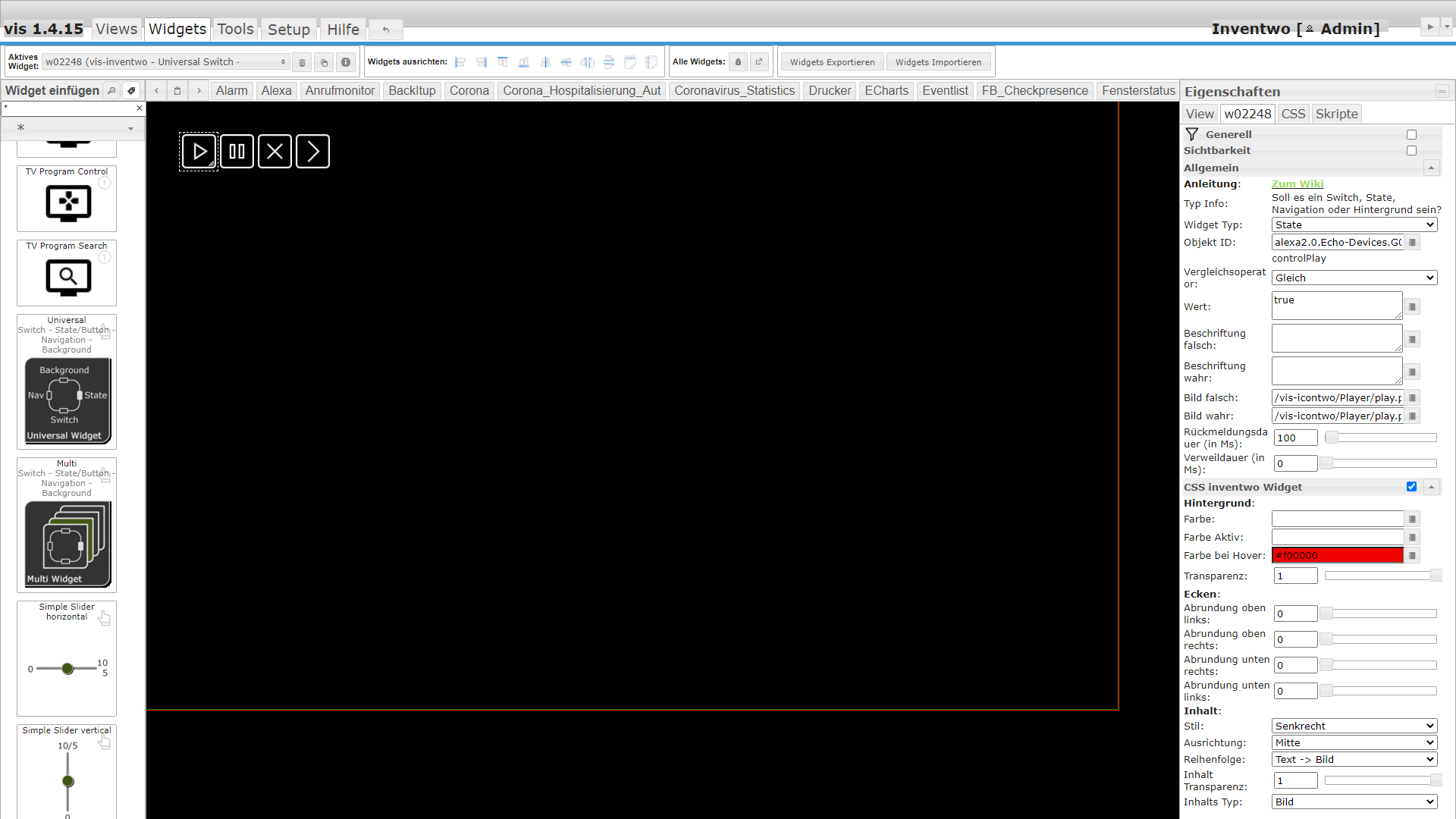

        @rtwl
        Inventwo Widgets:
        [{"tpl":"i-vis-universal","data":{"g_fixed":false,"g_visibility":false,"g_css_font_text":false,"g_css_background":false,"g_css_shadow_padding":false,"g_css_border":false,"g_gestures":false,"g_signals":false,"g_last_change":false,"iUniversalWidgetType":"State","iValueType":"boolean","iValueComparison":"equal","iStateResponseTime":"100","iStateResetValueTime":"0","iNavWait":"100","iPopUpBackground":"#666666","iPopUpPreventClickOutside":"","iPopUpShowTitle":"true","iPopUpTitle":"","iPopUpTitleColor":"#ffffff","iPopUpCloseBtnColor":"#dc2e2e","iPopUpWidth":"800px","iPopUpHeight":"500px","iPopUpHeightTitle":"50","iPopUpTitleSize":"28","iPopUpPosition":"center","iPopUpPositionX":"0","iPopUpPositionY":"0","iPopUpCloseAfterSeconds":"0","iPopUpCornerRadiusUL":"12","iPopUpCornerRadiusUR":"0","iPopUpCornerRadiusLR":"12","iPopUpCornerRadiusLL":"0","iPopUpShadowXOffset":"2","iPopUpShadowYOffset":"2","iPopUpShadowBlur":"2","iPopUpShadowSpread":"1","iPopUpShadowColor":"#111111","iButtonCol":"","iButtonActive":"","iButtonColHover":"#f00000","iOpacityBack":"1","iCornerRadiusUL":"0","iCornerRadiusUR":"0","iCornerRadiusLR":"0","iCornerRadiusLL":"0","iContentFlexDirection":"vertical","iContentVertAlign":"iCenter","iContentOrder":"orderTextImg","iOpacityCtn":"1","iTextColor":"#ffffff","iTextSize":"0","iTextAlign":"iStart","iTextSpaceTop":"0","iTextSpaceBottom":"0","iTextSpaceLeft":"0","iTextSpaceRight":"0","iIconSize":"28","iImgAlign":"iCenter","iImgSpaceTop":"4","iImgSpaceBottom":"0","iImgSpaceLeft":"0","iImgSpaceRight":"0","iImgRotation":"0","iImgBlinkFalse":"0","iImgBlinkTrue":"0","iImgColorFalse":"#ffffff","iImgColorTrue":"","iShadowXOffset":"0","iShadowYOffset":"0","iShadowBlur":"0","iShadowSpread":"0","iShadowColor":"#111111","iShadowColorActive":"#111111","iShadowColorHover":"","iShadowInnerXOffset":"0","iShadowInnerYOffset":"0","iShadowInnerBlur":"0","iShadowInnerSpread":"0","iShadowInnerColor":"#111111","iShadowInnerColorActive":"#111111","iShadowInnerColorHover":"","iBorderSize":"0","iBorderStyle":"none","iBorderColor":"#ffffff","iBorderColorActive":"","iBorderColorHover":"","signals-cond-0":"==","signals-val-0":true,"signals-icon-0":"/vis/signals/lowbattery.png","signals-icon-size-0":0,"signals-blink-0":false,"signals-horz-0":0,"signals-vert-0":0,"signals-hide-edit-0":false,"signals-cond-1":"==","signals-val-1":true,"signals-icon-1":"/vis/signals/lowbattery.png","signals-icon-size-1":0,"signals-blink-1":false,"signals-horz-1":0,"signals-vert-1":0,"signals-hide-edit-1":false,"signals-cond-2":"==","signals-val-2":true,"signals-icon-2":"/vis/signals/lowbattery.png","signals-icon-size-2":0,"signals-blink-2":false,"signals-horz-2":0,"signals-vert-2":0,"signals-hide-edit-2":false,"lc-type":"last-change","lc-is-interval":true,"lc-is-moment":false,"lc-format":"","lc-position-vert":"top","lc-position-horz":"right","lc-offset-vert":0,"lc-offset-horz":0,"lc-font-size":"12px","lc-font-family":"","lc-font-style":"","lc-bkg-color":"","lc-color":"","lc-border-width":"0","lc-border-style":"","lc-border-color":"","lc-border-radius":10,"lc-zindex":0,"iImageFalse":"/vis-icontwo/Player/play.png","iImageTrue":"/vis-icontwo/Player/play.png","iTextTrue":"","oid":"alexa2.0.Echo-Devices.G090LF1182231CD6.Player.controlPlay","visibility-cond":"==","visibility-val":1,"visibility-groups-action":"hide","value":"true","iImgColorInvertFalse":false,"iContentType":"image","iImgClockFace":"01","iImgClockHands":"01","iImgClockShowBorder":"1","iImgColorClockFace":"#ffffff","iImgColorHands":"#ffffff","iImgColorHandSecond":"#ff0000","iClockShowSeconds":"","iClockTimezone":"Europe/Berlin","iHtmlTextFieldFalse":"","iHtmlTextFieldTrue":"","iShadowTextXOffset":"0","iShadowTextYOffset":"0","iShadowTextBlur":"0","iShadowTextColor":"#111111","iShadowTextColorActive":"#111111","iTextColorActive":"#ffffff","iHttpType":"iSend","iTextDecoration":"none"},"style":{"left":"502px","top":"174px","width":"25px","height":"25px","z-index":"5"},"widgetSet":"vis-inventwo"},{"tpl":"i-vis-universal","data":{"g_fixed":false,"g_visibility":false,"g_css_font_text":false,"g_css_background":false,"g_css_shadow_padding":false,"g_css_border":false,"g_gestures":false,"g_signals":false,"g_last_change":false,"iUniversalWidgetType":"State","iValueType":"boolean","iValueComparison":"equal","iStateResponseTime":"100","iStateResetValueTime":"0","iNavWait":"100","iPopUpBackground":"#666666","iPopUpPreventClickOutside":"","iPopUpShowTitle":"true","iPopUpTitle":"","iPopUpTitleColor":"#ffffff","iPopUpCloseBtnColor":"#dc2e2e","iPopUpWidth":"800px","iPopUpHeight":"500px","iPopUpHeightTitle":"50","iPopUpTitleSize":"28","iPopUpPosition":"center","iPopUpPositionX":"0","iPopUpPositionY":"0","iPopUpCloseAfterSeconds":"0","iPopUpCornerRadiusUL":"12","iPopUpCornerRadiusUR":"0","iPopUpCornerRadiusLR":"12","iPopUpCornerRadiusLL":"0","iPopUpShadowXOffset":"2","iPopUpShadowYOffset":"2","iPopUpShadowBlur":"2","iPopUpShadowSpread":"1","iPopUpShadowColor":"#111111","iButtonCol":"","iButtonActive":"","iButtonColHover":"#f00000","iOpacityBack":"1","iCornerRadiusUL":"0","iCornerRadiusUR":"0","iCornerRadiusLR":"0","iCornerRadiusLL":"0","iContentFlexDirection":"vertical","iContentVertAlign":"iCenter","iContentOrder":"orderTextImg","iOpacityCtn":"1","iTextColor":"#ffffff","iTextSize":"0","iTextAlign":"iStart","iTextSpaceTop":"0","iTextSpaceBottom":"0","iTextSpaceLeft":"0","iTextSpaceRight":"0","iIconSize":"28","iImgAlign":"iCenter","iImgSpaceTop":"4","iImgSpaceBottom":"0","iImgSpaceLeft":"0","iImgSpaceRight":"0","iImgRotation":"0","iImgBlinkFalse":"0","iImgBlinkTrue":"0","iImgColorFalse":"#ffffff","iImgColorTrue":"#05f202","iShadowXOffset":"0","iShadowYOffset":"0","iShadowBlur":"0","iShadowSpread":"0","iShadowColor":"#111111","iShadowColorActive":"#111111","iShadowColorHover":"","iShadowInnerXOffset":"0","iShadowInnerYOffset":"0","iShadowInnerBlur":"0","iShadowInnerSpread":"0","iShadowInnerColor":"#111111","iShadowInnerColorActive":"#111111","iShadowInnerColorHover":"","iBorderSize":"0","iBorderStyle":"none","iBorderColor":"#ffffff","iBorderColorActive":"#ffffff","iBorderColorHover":"","signals-cond-0":"==","signals-val-0":true,"signals-icon-0":"/vis/signals/lowbattery.png","signals-icon-size-0":0,"signals-blink-0":false,"signals-horz-0":0,"signals-vert-0":0,"signals-hide-edit-0":false,"signals-cond-1":"==","signals-val-1":true,"signals-icon-1":"/vis/signals/lowbattery.png","signals-icon-size-1":0,"signals-blink-1":false,"signals-horz-1":0,"signals-vert-1":0,"signals-hide-edit-1":false,"signals-cond-2":"==","signals-val-2":true,"signals-icon-2":"/vis/signals/lowbattery.png","signals-icon-size-2":0,"signals-blink-2":false,"signals-horz-2":0,"signals-vert-2":0,"signals-hide-edit-2":false,"lc-type":"last-change","lc-is-interval":true,"lc-is-moment":false,"lc-format":"","lc-position-vert":"top","lc-position-horz":"right","lc-offset-vert":0,"lc-offset-horz":0,"lc-font-size":"12px","lc-font-family":"","lc-font-style":"","lc-bkg-color":"","lc-color":"","lc-border-width":"0","lc-border-style":"","lc-border-color":"","lc-border-radius":10,"lc-zindex":0,"iImageFalse":"/vis-icontwo/Player/break.png","iImageTrue":"/vis-icontwo/Player/break.png","iTextTrue":"","oid":"alexa2.0.Echo-Devices.G090LF1182231CD6.Player.controlPause","visibility-cond":"==","visibility-val":1,"visibility-groups-action":"hide","value":"true","iContentType":"image","iImgClockFace":"01","iImgClockHands":"01","iImgClockShowBorder":"1","iImgColorClockFace":"#ffffff","iImgColorHands":"#ffffff","iImgColorHandSecond":"#ff0000","iClockShowSeconds":"","iClockTimezone":"Europe/Berlin","iHtmlTextFieldFalse":"","iHtmlTextFieldTrue":"","iShadowTextXOffset":"0","iShadowTextYOffset":"0","iShadowTextBlur":"0","iShadowTextColor":"#111111","iShadowTextColorActive":"#111111","iTextColorActive":"#ffffff","iHttpType":"iSend","iTextDecoration":"none"},"style":{"left":"538px","top":"174px","width":"25px","height":"25px","z-index":"5"},"widgetSet":"vis-inventwo"},{"tpl":"i-vis-universal","data":{"g_fixed":false,"g_visibility":false,"g_css_font_text":false,"g_css_background":false,"g_css_shadow_padding":false,"g_css_border":false,"g_gestures":false,"g_signals":false,"g_last_change":false,"iUniversalWidgetType":"State","iValueType":"boolean","iValueComparison":"equal","iStateResponseTime":"100","iStateResetValueTime":"0","iNavWait":"100","iPopUpBackground":"#666666","iPopUpPreventClickOutside":"","iPopUpShowTitle":"true","iPopUpTitle":"","iPopUpTitleColor":"#ffffff","iPopUpCloseBtnColor":"#dc2e2e","iPopUpWidth":"800px","iPopUpHeight":"500px","iPopUpHeightTitle":"50","iPopUpTitleSize":"28","iPopUpPosition":"center","iPopUpPositionX":"0","iPopUpPositionY":"0","iPopUpCloseAfterSeconds":"0","iPopUpCornerRadiusUL":"12","iPopUpCornerRadiusUR":"0","iPopUpCornerRadiusLR":"12","iPopUpCornerRadiusLL":"0","iPopUpShadowXOffset":"2","iPopUpShadowYOffset":"2","iPopUpShadowBlur":"2","iPopUpShadowSpread":"1","iPopUpShadowColor":"#111111","iButtonCol":"","iButtonActive":"","iButtonColHover":"#f00000","iOpacityBack":"1","iCornerRadiusUL":"0","iCornerRadiusUR":"0","iCornerRadiusLR":"0","iCornerRadiusLL":"0","iContentFlexDirection":"vertical","iContentVertAlign":"iCenter","iContentOrder":"orderTextImg","iOpacityCtn":"1","iTextColor":"#ffffff","iTextSize":"0","iTextAlign":"iStart","iTextSpaceTop":"0","iTextSpaceBottom":"0","iTextSpaceLeft":"0","iTextSpaceRight":"0","iIconSize":"28","iImgAlign":"iCenter","iImgSpaceTop":"4","iImgSpaceBottom":"0","iImgSpaceLeft":"0","iImgSpaceRight":"0","iImgRotation":"0","iImgBlinkFalse":"0","iImgBlinkTrue":"0","iImgColorFalse":"#ffffff","iImgColorTrue":"#05f202","iShadowXOffset":"0","iShadowYOffset":"0","iShadowBlur":"0","iShadowSpread":"0","iShadowColor":"#111111","iShadowColorActive":"#111111","iShadowColorHover":"","iShadowInnerXOffset":"0","iShadowInnerYOffset":"0","iShadowInnerBlur":"0","iShadowInnerSpread":"0","iShadowInnerColor":"#111111","iShadowInnerColorActive":"#111111","iShadowInnerColorHover":"","iBorderSize":"0","iBorderStyle":"none","iBorderColor":"#ffffff","iBorderColorActive":"#ffffff","iBorderColorHover":"","signals-cond-0":"==","signals-val-0":true,"signals-icon-0":"/vis/signals/lowbattery.png","signals-icon-size-0":0,"signals-blink-0":false,"signals-horz-0":0,"signals-vert-0":0,"signals-hide-edit-0":false,"signals-cond-1":"==","signals-val-1":true,"signals-icon-1":"/vis/signals/lowbattery.png","signals-icon-size-1":0,"signals-blink-1":false,"signals-horz-1":0,"signals-vert-1":0,"signals-hide-edit-1":false,"signals-cond-2":"==","signals-val-2":true,"signals-icon-2":"/vis/signals/lowbattery.png","signals-icon-size-2":0,"signals-blink-2":false,"signals-horz-2":0,"signals-vert-2":0,"signals-hide-edit-2":false,"lc-type":"last-change","lc-is-interval":true,"lc-is-moment":false,"lc-format":"","lc-position-vert":"top","lc-position-horz":"right","lc-offset-vert":0,"lc-offset-horz":0,"lc-font-size":"12px","lc-font-family":"","lc-font-style":"","lc-bkg-color":"","lc-color":"","lc-border-width":"0","lc-border-style":"","lc-border-color":"","lc-border-radius":10,"lc-zindex":0,"iImageFalse":"/vis-icontwo/Player/stop.png","iImageTrue":"/vis-icontwo/Player/stop.png","iTextTrue":"","oid":"alexa2.0.Echo-Devices.G090LF1182231CD6.Commands.deviceStop","visibility-cond":"==","visibility-val":1,"visibility-groups-action":"hide","value":"true","iContentType":"image","iImgClockFace":"01","iImgClockHands":"01","iImgClockShowBorder":"1","iImgColorClockFace":"#ffffff","iImgColorHands":"#ffffff","iImgColorHandSecond":"#ff0000","iClockShowSeconds":"","iClockTimezone":"Europe/Berlin","iHtmlTextFieldFalse":"","iHtmlTextFieldTrue":"","iShadowTextXOffset":"0","iShadowTextYOffset":"0","iShadowTextBlur":"0","iShadowTextColor":"#111111","iShadowTextColorActive":"#111111","iTextColorActive":"#ffffff","iHttpType":"iSend","iTextDecoration":"none"},"style":{"left":"573px","top":"174px","width":"25px","height":"25px","z-index":"5"},"widgetSet":"vis-inventwo"},{"tpl":"i-vis-universal","data":{"g_fixed":false,"g_visibility":false,"g_css_font_text":false,"g_css_background":false,"g_css_shadow_padding":false,"g_css_border":false,"g_gestures":false,"g_signals":false,"g_last_change":false,"iUniversalWidgetType":"State","iValueType":"boolean","iValueComparison":"equal","iStateResponseTime":"100","iStateResetValueTime":"0","iNavWait":"100","iPopUpBackground":"#666666","iPopUpPreventClickOutside":"","iPopUpShowTitle":"true","iPopUpTitle":"","iPopUpTitleColor":"#ffffff","iPopUpCloseBtnColor":"#dc2e2e","iPopUpWidth":"800px","iPopUpHeight":"500px","iPopUpHeightTitle":"50","iPopUpTitleSize":"28","iPopUpPosition":"center","iPopUpPositionX":"0","iPopUpPositionY":"0","iPopUpCloseAfterSeconds":"0","iPopUpCornerRadiusUL":"12","iPopUpCornerRadiusUR":"0","iPopUpCornerRadiusLR":"12","iPopUpCornerRadiusLL":"0","iPopUpShadowXOffset":"2","iPopUpShadowYOffset":"2","iPopUpShadowBlur":"2","iPopUpShadowSpread":"1","iPopUpShadowColor":"#111111","iButtonCol":"","iButtonActive":"","iButtonColHover":"#f00000","iOpacityBack":"1","iCornerRadiusUL":"0","iCornerRadiusUR":"0","iCornerRadiusLR":"0","iCornerRadiusLL":"0","iContentFlexDirection":"vertical","iContentVertAlign":"iCenter","iContentOrder":"orderTextImg","iOpacityCtn":"1","iTextColor":"#ffffff","iTextSize":"0","iTextAlign":"iStart","iTextSpaceTop":"0","iTextSpaceBottom":"0","iTextSpaceLeft":"0","iTextSpaceRight":"0","iIconSize":"28","iImgAlign":"iCenter","iImgSpaceTop":"4","iImgSpaceBottom":"0","iImgSpaceLeft":"0","iImgSpaceRight":"0","iImgRotation":"0","iImgBlinkFalse":"0","iImgBlinkTrue":"0","iImgColorFalse":"#ffffff","iImgColorTrue":"#05f202","iShadowXOffset":"0","iShadowYOffset":"0","iShadowBlur":"0","iShadowSpread":"0","iShadowColor":"#111111","iShadowColorActive":"#111111","iShadowColorHover":"","iShadowInnerXOffset":"0","iShadowInnerYOffset":"0","iShadowInnerBlur":"0","iShadowInnerSpread":"0","iShadowInnerColor":"#111111","iShadowInnerColorActive":"#111111","iShadowInnerColorHover":"","iBorderSize":"0","iBorderStyle":"none","iBorderColor":"#ffffff","iBorderColorActive":"#ffffff","iBorderColorHover":"","signals-cond-0":"==","signals-val-0":true,"signals-icon-0":"/vis/signals/lowbattery.png","signals-icon-size-0":0,"signals-blink-0":false,"signals-horz-0":0,"signals-vert-0":0,"signals-hide-edit-0":false,"signals-cond-1":"==","signals-val-1":true,"signals-icon-1":"/vis/signals/lowbattery.png","signals-icon-size-1":0,"signals-blink-1":false,"signals-horz-1":0,"signals-vert-1":0,"signals-hide-edit-1":false,"signals-cond-2":"==","signals-val-2":true,"signals-icon-2":"/vis/signals/lowbattery.png","signals-icon-size-2":0,"signals-blink-2":false,"signals-horz-2":0,"signals-vert-2":0,"signals-hide-edit-2":false,"lc-type":"last-change","lc-is-interval":true,"lc-is-moment":false,"lc-format":"","lc-position-vert":"top","lc-position-horz":"right","lc-offset-vert":0,"lc-offset-horz":0,"lc-font-size":"12px","lc-font-family":"","lc-font-style":"","lc-bkg-color":"","lc-color":"","lc-border-width":"0","lc-border-style":"","lc-border-color":"","lc-border-radius":10,"lc-zindex":0,"iImageFalse":"/vis-icontwo/Player/right.png","iImageTrue":"/vis-icontwo/Player/right.png","iTextTrue":"","oid":"alexa2.0.Echo-Devices.G090LF1182231CD6.Player.controlNext","visibility-cond":"==","visibility-val":1,"visibility-groups-action":"hide","value":"true","iContentType":"image","iImgClockFace":"01","iImgClockHands":"01","iImgClockShowBorder":"1","iImgColorClockFace":"#ffffff","iImgColorHands":"#ffffff","iImgColorHandSecond":"#ff0000","iClockShowSeconds":"","iClockTimezone":"Europe/Berlin","iHtmlTextFieldFalse":"","iHtmlTextFieldTrue":"","iShadowTextXOffset":"0","iShadowTextYOffset":"0","iShadowTextBlur":"0","iShadowTextColor":"#111111","iShadowTextColorActive":"#111111","iTextColorActive":"#ffffff","iHttpType":"iSend","iTextDecoration":"none"},"style":{"left":"609px","top":"174px","width":"25px","height":"25px","z-index":"5"},"widgetSet":"vis-inventwo"}]
        An deine DP anpassen, übereinander legen und Sichtbarkeit einstellen, oder Bild war/falsch ändern.
        Bei nur Anzeige auf Widget Typ Background umstellen.
        Nur Anzeige:
        [{"tpl":"i-vis-universal","data":{"g_fixed":false,"g_visibility":false,"g_css_font_text":false,"g_css_background":false,"g_css_shadow_padding":false,"g_css_border":false,"g_gestures":false,"g_signals":false,"g_last_change":false,"iUniversalWidgetType":"Background","iValueType":"boolean","iValueComparison":"equal","iStateResponseTime":"100","iStateResetValueTime":"0","iNavWait":"100","iPopUpBackground":"#666666","iPopUpPreventClickOutside":"","iPopUpShowTitle":"true","iPopUpTitle":"","iPopUpTitleColor":"#ffffff","iPopUpCloseBtnColor":"#dc2e2e","iPopUpWidth":"800px","iPopUpHeight":"500px","iPopUpHeightTitle":"50","iPopUpTitleSize":"28","iPopUpPosition":"center","iPopUpPositionX":"0","iPopUpPositionY":"0","iPopUpCloseAfterSeconds":"0","iPopUpCornerRadiusUL":"12","iPopUpCornerRadiusUR":"0","iPopUpCornerRadiusLR":"12","iPopUpCornerRadiusLL":"0","iPopUpShadowXOffset":"2","iPopUpShadowYOffset":"2","iPopUpShadowBlur":"2","iPopUpShadowSpread":"1","iPopUpShadowColor":"#111111","iButtonCol":"","iButtonActive":"","iButtonColHover":"","iOpacityBack":"1","iCornerRadiusUL":"0","iCornerRadiusUR":"0","iCornerRadiusLR":"0","iCornerRadiusLL":"0","iContentFlexDirection":"vertical","iContentVertAlign":"iCenter","iContentOrder":"orderTextImg","iOpacityCtn":"1","iTextColor":"#ffffff","iTextSize":"0","iTextAlign":"iStart","iTextSpaceTop":"0","iTextSpaceBottom":"0","iTextSpaceLeft":"0","iTextSpaceRight":"0","iIconSize":"28","iImgAlign":"iCenter","iImgSpaceTop":"4","iImgSpaceBottom":"0","iImgSpaceLeft":"0","iImgSpaceRight":"0","iImgRotation":"0","iImgBlinkFalse":"0","iImgBlinkTrue":"0","iImgColorFalse":"#ffffff","iImgColorTrue":"","iShadowXOffset":"0","iShadowYOffset":"0","iShadowBlur":"0","iShadowSpread":"0","iShadowColor":"#111111","iShadowColorActive":"#111111","iShadowColorHover":"","iShadowInnerXOffset":"0","iShadowInnerYOffset":"0","iShadowInnerBlur":"0","iShadowInnerSpread":"0","iShadowInnerColor":"#111111","iShadowInnerColorActive":"#111111","iShadowInnerColorHover":"","iBorderSize":"0","iBorderStyle":"none","iBorderColor":"#ffffff","iBorderColorActive":"","iBorderColorHover":"","signals-cond-0":"==","signals-val-0":true,"signals-icon-0":"/vis/signals/lowbattery.png","signals-icon-size-0":0,"signals-blink-0":false,"signals-horz-0":0,"signals-vert-0":0,"signals-hide-edit-0":false,"signals-cond-1":"==","signals-val-1":true,"signals-icon-1":"/vis/signals/lowbattery.png","signals-icon-size-1":0,"signals-blink-1":false,"signals-horz-1":0,"signals-vert-1":0,"signals-hide-edit-1":false,"signals-cond-2":"==","signals-val-2":true,"signals-icon-2":"/vis/signals/lowbattery.png","signals-icon-size-2":0,"signals-blink-2":false,"signals-horz-2":0,"signals-vert-2":0,"signals-hide-edit-2":false,"lc-type":"last-change","lc-is-interval":true,"lc-is-moment":false,"lc-format":"","lc-position-vert":"top","lc-position-horz":"right","lc-offset-vert":0,"lc-offset-horz":0,"lc-font-size":"12px","lc-font-family":"","lc-font-style":"","lc-bkg-color":"","lc-color":"","lc-border-width":"0","lc-border-style":"","lc-border-color":"","lc-border-radius":10,"lc-zindex":0,"iImageFalse":"/vis-icontwo/Player/break.png","iImageTrue":"/vis-icontwo/Player/play.png","iTextTrue":"","oid":"alexa2.0.Echo-Devices.G090LF1182231CD6.Player.controlPlay","visibility-cond":"==","visibility-val":1,"visibility-groups-action":"hide","value":"true","iImgColorInvertFalse":false,"iContentType":"image","iImgClockFace":"01","iImgClockHands":"01","iImgClockShowBorder":"1","iImgColorClockFace":"#ffffff","iImgColorHands":"#ffffff","iImgColorHandSecond":"#ff0000","iClockShowSeconds":"","iClockTimezone":"Europe/Berlin","iHtmlTextFieldFalse":"","iHtmlTextFieldTrue":"","iShadowTextXOffset":"0","iShadowTextYOffset":"0","iShadowTextBlur":"0","iShadowTextColor":"#111111","iShadowTextColorActive":"#111111","iTextColorActive":"#ffffff","iHttpType":"iSend","iTextDecoration":"none","iValueTrue":""},"style":{"left":"47px","top":"43px","width":"25px","height":"25px","z-index":"5"},"widgetSet":"vis-inventwo"}]

                      • sigi234S sigi234
                        @rtwl
                        Inventwo Widgets:
                        Nur Anzeige:
