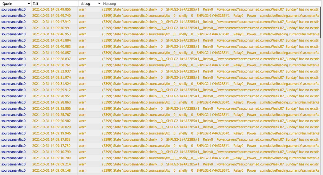

    ich verwende den Adapter um mir im VIS den monatlichen Verbrauch der Waschmaschine und des Trockners anzeigen zu lassen.
    Eigentlich keine große Sache, funktioniert auch, aber mein Log quillt über:
    Er beschwert sich über den heutigen Tag (Sonntag) und "current year".

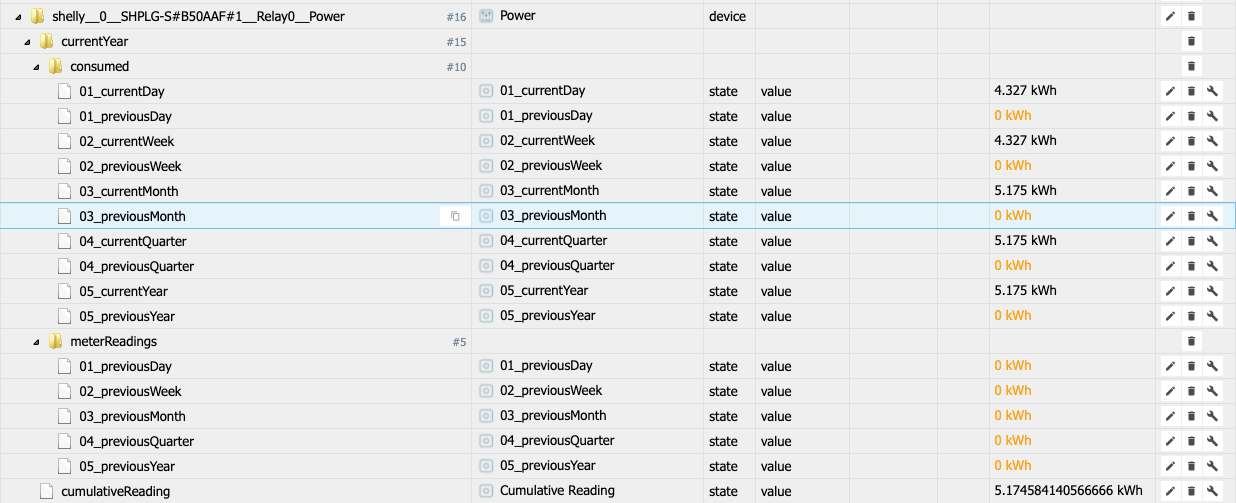

                        Ich muss das hier nochmal aufmachen.
                        sourceanalytix.0	2021-11-24 19:11:56.340	warn	(11662) State "sourceanalytix.0.shelly__0__SHPLG-S#B50AAF#1__Relay0__Power.currentYear.consumed.currentWeek.03_Wednesday" has no existing object, this might lead to an error in future versions
                        sourceanalytix.0	2021-11-24 19:11:41.283	warn	(11662) State "sourceanalytix.0.shelly__0__SHPLG-S#B50AAF#1__Relay0__Power.currentYear.consumed.currentWeek.03_Wednesday" has no existing object, this might lead to an error in future versions
                        sourceanalytix.0	2021-11-24 19:11:26.271	warn	(11662) State "sourceanalytix.0.shelly__0__SHPLG-S#B50AAF#1__Relay0__Power.currentYear.consumed.currentWeek.03_Wednesday" has no existing object, this might lead to an error in future versions
                        sourceanalytix.0	2021-11-24 19:10:56.429	warn	(11662) State "sourceanalytix.0.shelly__0__SHPLG-S#B50AAF#1__Relay0__Power.currentYear.consumed.currentWeek.03_Wednesday" has no existing object, this might lead to an error in future versions
                        sourceanalytix.0	2021-11-24 19:10:43.243	warn	(11662) State "sourceanalytix.0.shelly__0__SHPLG-S#B50AAF#1__Relay0__Power.currentYear.consumed.currentWeek.03_Wednesday" has no existing object, this might lead to an error in future versions
                        sourceanalytix.0	2021-11-24 19:10:28.187	warn	(11662) State "sourceanalytix.0.shelly__0__SHPLG-S#B50AAF#1__Relay0__Power.currentYear.consumed.currentWeek.03_Wednesday" has no existing object, this might lead to an error in future versions
                        sourceanalytix.0	2021-11-24 19:10:13.133	warn	(11662) State "sourceanalytix.0.shelly__0__SHPLG-S#B50AAF#1__Relay0__Power.currentYear.consumed.currentWeek.03_Wednesday" has no existing object, this might lead to an error in future versions
                        sourceanalytix.0	2021-11-24 19:10:00.880	warn	(11662) State "sourceanalytix.0.shelly__0__SHPLG-S#B50AAF#1__Relay0__Power.currentYear.consumed.currentWeek.03_Wednesday" has no existing object, this might lead to an error in future versions
                        sourceanalytix.0	2021-11-24 19:09:46.108	warn	(11662) State "sourceanalytix.0.shelly__0__SHPLG-S#B50AAF#1__Relay0__Power.currentYear.consumed.currentWeek.03_Wednesday" has no existing object, this might lead to an error in future versions
                        sourceanalytix.0	2021-11-24 19:09:31.018	warn	(11662) State "sourceanalytix.0.shelly__0__SHPLG-S#B50AAF#1__Relay0__Power.currentYear.consumed.currentWeek.03_Wednesday" has no existing object, this might lead to an error in future versions
                        sourceanalytix.0	2021-11-24 19:09:02.486	warn	(11662) State "sourceanalytix.0.shelly__0__SHPLG-S#B50AAF#1__Relay0__Power.currentYear.consumed.currentWeek.03_Wednesday" has no existing object, this might lead to an error in future versions
                        sourceanalytix.0	2021-11-24 19:08:47.422	warn	(11662) State "sourceanalytix.0.shelly__0__SHPLG-S#B50AAF#1__Relay0__Power.currentYear.consumed.currentWeek.03_Wednesday" has no existing object, this might lead to an error in future versions
                        sourceanalytix.0	2021-11-24 19:08:40.387	warn	(11662) State "sourceanalytix.0.shelly__0__SHPLG-S#B50AAF#1__Relay0__Power.currentYear.consumed.currentWeek.03_Wednesday" has no existing object, this might lead to an error in future versions
                        sourceanalytix.0	2021-11-24 19:08:25.307	warn	(11662) State "sourceanalytix.0.shelly__0__SHPLG-
                        Datenpunkt sieht so aus:
                        Ideen?
                        Danke!
