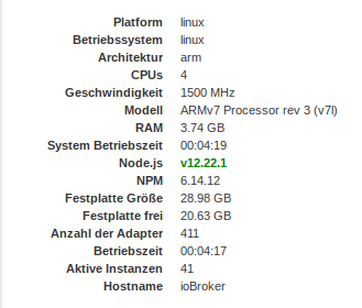

          @arteck
          zigbee.0
          2021-06-02 13:06:38.980	info	Installed Version: iobroker.zigbee@1.5.5
          zigbee.0
          2021-06-02 13:06:38.857	error	Error: Error while opening serialport 'Error: Error: No such file or directory, cannot open /dev/serial/by-id/usb-Texas_Instruments_TI_CC2538_USB_CDC-if00' at Znp.<anonymous> (/opt/iobroker/node_modules/zigbee-herdsman/dist/adapter/z-stack/znp/znp.js:136:32) at Generator.next (<anonymous>) at /opt/iobroker/node_modules/zigbee-herdsman/dist/adapter/z-stack/znp/znp.js:27:71 at new Promise (<anonymous>) at __awaiter (/opt/iobroker/node_modules/zigbee-herdsman/dist/adapter/z-stack/znp/znp.js:23:12) at SerialPort.<anonymous> (/opt/iobroker/node_modules/zigbee-herdsman/dist/adapter/z-stack/znp/znp.js:134:49) at SerialPort._error (/opt/iobroker/node_modules/zigbee-herdsman/node_modules/@serialport/stream/lib/index.js:198:14) at /opt/iobroker/node_modules/zigbee-herdsman/node_modules/@serialport/stream/lib/index.js:242:12
          zigbee.0
          2021-06-02 13:06:38.854	error	Failed to start Zigbee
          zigbee.0
          2021-06-02 13:06:38.581	info	Starting Zigbee npm ...
          zigbee.0
          2021-06-02 13:06:38.409	info	starting. Version 1.5.5 in /opt/iobroker/node_modules/iobroker.zigbee, node: v12.22.1, js-controller: 3.2.16
          host.raspberrypi
          2021-06-02 13:06:34.863	info	instance system.adapter.zigbee.0 started with pid 24718
          host.raspberrypi
          2021-06-02 13:06:34.809	info	"system.adapter.zigbee.0" enabled
          mit der Version hatte es vor dem neu aufsetzen ohne Probleme funktioniert.
