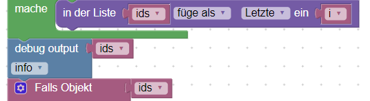

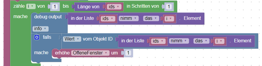

            var i_von_Fenster_offen_K_C3_BCche, i, OffeneFenster, j;
            // Offene Fenster zählen Küche
            i_von_Fenster_offen_K_C3_BCche = [];
            var i_list = Array.prototype.slice.apply($("state[id=*.opened](functions=tür/fenster)(rooms=küche)"));
            for (var i_index in i_list) {
              i = i_list[i_index];
              i_von_Fenster_offen_K_C3_BCche.push(i);
            var i_list2 = Array.prototype.slice.apply($("state[id=*.state](functions=tür/fenster)(rooms=küche)"));
            for (var i_index2 in i_list2) {
              i = i_list2[i_index2];
            on({id: i_von_Fenster_offen_K_C3_BCche, change: "ne"}, function (obj) {
              var value = obj.state.val;
              OffeneFenster = 0;
              var j_end = i_von_Fenster_offen_K_C3_BCche.length;
              var j_inc = 1;
              if (1 > j_end) {
                j_inc = -j_inc;
              for (j = 1; j_inc >= 0 ? j <= j_end : j >= j_end; j += j_inc) {
                if (getState((i_von_Fenster_offen_K_C3_BCche[(i - 1)])).val) {
                  OffeneFenster = (typeof OffeneFenster == 'number' ? OffeneFenster : 0) + 1;
              setState("0_userdata.0.Zähler.Küche"/*Offene Fenster Küche*/, OffeneFenster);
              if (getState("0_userdata.0.Zähler.Küche").val == 0) {
                setState("0_userdata.0.Fenster_offen.Küche"/*Fenster offen Ja/Nein Küche*/, true, true);
              } else {
                setState("0_userdata.0.Fenster_offen.Küche"/*Fenster offen Ja/Nein Küche*/, false, true);
            //JTNDeG1sJTIweG1sbnMlM0QlMjJodHRwcyUzQSUyRiUyRmRldmVsb3BlcnMuZ29vZ2xlLmNvbSUyRmJsb2NrbHklMkZ4bWwlMjIlM0UlM0N2YXJpYWJsZXMlM0UlM0N2YXJpYWJsZSUyMGlkJTNEJTIyQUclNURoLjZXJTVEKnclN0R4JTVCWn5wSkhjRSUyMiUzRWklMjB2b24lMjBGZW5zdGVyJTIwb2ZmZW4lMjBLJUMzJUJDY2hlJTNDJTJGdmFyaWFibGUlM0UlM0N2YXJpYWJsZSUyMGlkJTNEJTIyNVBpKHAlM0Z3MSU2MFMlN0RYUyU2MCU0MCU1RE8xT0IlMjIlM0VpJTNDJTJGdmFyaWFibGUlM0UlM0N2YXJpYWJsZSUyMGlkJTNEJTIyciUyQ2gpcnZlT0pYJTNEbyUyQiUyRllnJTQwMWYlMjMlMjIlM0VPZmZlbmVGZW5zdGVyJTNDJTJGdmFyaWFibGUlM0UlM0N2YXJpYWJsZSUyMGlkJTNEJTIyJTVCJTdEJTdEdUl2akMlM0QlNUVQYkRMcHZnNyU1RCUyQyUyMiUzRWolM0MlMkZ2YXJpYWJsZSUzRSUzQyUyRnZhcmlhYmxlcyUzRSUzQ2Jsb2NrJTIwdHlwZSUzRCUyMmNvbW1lbnQlMjIlMjBpZCUzRCUyMipQOSU2MHVTY2x3SCU3RGFVMGxvJTYwJTNCISUyMyUyMiUyMHglM0QlMjIzOCUyMiUyMHklM0QlMjItMTg4JTIyJTNFJTNDZmllbGQlMjBuYW1lJTNEJTIyQ09NTUVOVCUyMiUzRU9mZmVuZSUyMEZlbnN0ZXIlMjB6JUMzJUE0aGxlbiUyMEslQzMlQkNjaGUlM0MlMkZmaWVsZCUzRSUzQ25leHQlM0UlM0NibG9jayUyMHR5cGUlM0QlMjJ2YXJpYWJsZXNfc2V0JTIyJTIwaWQlM0QlMjJ0ZXElMjVDY1FtMi0lN0IlMjVSJTI0SzhITDZ3JTIyJTNFJTNDZmllbGQlMjBuYW1lJTNEJTIyVkFSJTIyJTIwaWQlM0QlMjJBRyU1RGguNlclNUQqdyU3RHglNUJafnBKSGNFJTIyJTNFaSUyMHZvbiUyMEZlbnN0ZXIlMjBvZmZlbiUyMEslQzMlQkNjaGUlM0MlMkZmaWVsZCUzRSUzQ3ZhbHVlJTIwbmFtZSUzRCUyMlZBTFVFJTIyJTNFJTNDYmxvY2slMjB0eXBlJTNEJTIybGlzdHNfY3JlYXRlX3dpdGglMjIlMjBpZCUzRCUyMjRkaUElN0MtVFFrJTVFdWR0bm04JTdEazM1JTIyJTNFJTNDbXV0YXRpb24lMjBpdGVtcyUzRCUyMjAlMjIlM0UlM0MlMkZtdXRhdGlvbiUzRSUzQyUyRmJsb2NrJTNFJTNDJTJGdmFsdWUlM0UlM0NuZXh0JTNFJTNDYmxvY2slMjB0eXBlJTNEJTIyY29udHJvbHNfZm9yRWFjaCUyMiUyMGlkJTNEJTIySiU3QjdhISU0MHB0YjBWWllZJTdDRHklMjMlM0Z+JTIyJTNFJTNDZmllbGQlMjBuYW1lJTNEJTIyVkFSJTIyJTIwaWQlM0QlMjI1UGkocCUzRncxJTYwUyU3RFhTJTYwJTQwJTVETzFPQiUyMiUzRWklM0MlMkZmaWVsZCUzRSUzQ3ZhbHVlJTIwbmFtZSUzRCUyMkxJU1QlMjIlM0UlM0NibG9jayUyMHR5cGUlM0QlMjJzZWxlY3RvciUyMiUyMGlkJTNEJTIyJTNCaVhMJTJCJTVEKVRYaWMlM0IlNUUlM0JxJTVFUXclNUVfJTIyJTNFJTNDZmllbGQlMjBuYW1lJTNEJTIyVEVYVCUyMiUzRXN0YXRlJTVCaWQlM0QqLm9wZW5lZCU1RChmdW5jdGlvbnMlM0R0JUMzJUJDciUyRmZlbnN0ZXIpKHJvb21zJTNEayVDMyVCQ2NoZSklM0MlMkZmaWVsZCUzRSUzQyUyRmJsb2NrJTNFJTNDJTJGdmFsdWUlM0UlM0NzdGF0ZW1lbnQlMjBuYW1lJTNEJTIyRE8lMjIlM0UlM0NibG9jayUyMHR5cGUlM0QlMjJsaXN0c19zZXRJbmRleCUyMiUyMGlkJTNEJTIyJTNCOWclN0NSaGNuJTYwSEJDJTI1TiU2MGdUNmwxJTIyJTNFJTNDbXV0YXRpb24lMjBhdCUzRCUyMmZhbHNlJTIyJTNFJTNDJTJGbXV0YXRpb24lM0UlM0NmaWVsZCUyMG5hbWUlM0QlMjJNT0RFJTIyJTNFSU5TRVJUJTNDJTJGZmllbGQlM0UlM0NmaWVsZCUyMG5hbWUlM0QlMjJXSEVSRSUyMiUzRUxBU1QlM0MlMkZmaWVsZCUzRSUzQ3ZhbHVlJTIwbmFtZSUzRCUyMkxJU1QlMjIlM0UlM0NibG9jayUyMHR5cGUlM0QlMjJ2YXJpYWJsZXNfZ2V0JTIyJTIwaWQlM0QlMjI0cSFvTmYlM0R3Ny5YUFhoaW9adXAlNUIlMjIlM0UlM0NmaWVsZCUyMG5hbWUlM0QlMjJWQVIlMjIlMjBpZCUzRCUyMkFHJTVEaC42VyU1RCp3JTdEeCU1Qlp+cEpIY0UlMjIlM0VpJTIwdm9uJTIwRmVuc3RlciUyMG9mZmVuJTIwSyVDMyVCQ2NoZSUzQyUyRmZpZWxkJTNFJTNDJTJGYmxvY2slM0UlM0MlMkZ2YWx1ZSUzRSUzQ3ZhbHVlJTIwbmFtZSUzRCUyMlRPJTIyJTNFJTNDYmxvY2slMjB0eXBlJTNEJTIydmFyaWFibGVzX2dldCUyMiUyMGlkJTNEJTIyajklM0E1SDAqaGJ4cSUzQmshWC45b3JmJTIyJTNFJTNDZmllbGQlMjBuYW1lJTNEJTIyVkFSJTIyJTIwaWQlM0QlMjI1UGkocCUzRncxJTYwUyU3RFhTJTYwJTQwJTVETzFPQiUyMiUzRWklM0MlMkZmaWVsZCUzRSUzQyUyRmJsb2NrJTNFJTNDJTJGdmFsdWUlM0UlM0MlMkZibG9jayUzRSUzQyUyRnN0YXRlbWVudCUzRSUzQ25leHQlM0UlM0NibG9jayUyMHR5cGUlM0QlMjJjb250cm9sc19mb3JFYWNoJTIyJTIwaWQlM0QlMjJlV20zQ1Z3MXNudHNmIVA4cU85UCUyMiUzRSUzQ2ZpZWxkJTIwbmFtZSUzRCUyMlZBUiUyMiUyMGlkJTNEJTIyNVBpKHAlM0Z3MSU2MFMlN0RYUyU2MCU0MCU1RE8xT0IlMjIlM0VpJTNDJTJGZmllbGQlM0UlM0N2YWx1ZSUyMG5hbWUlM0QlMjJMSVNUJTIyJTNFJTNDYmxvY2slMjB0eXBlJTNEJTIyc2VsZWN0b3IlMjIlMjBpZCUzRCUyMjglNjBqJTVEJTVCTFcpS1MxM29KIUwlMkN3czYlMjIlM0UlM0NmaWVsZCUyMG5hbWUlM0QlMjJURVhUJTIyJTNFc3RhdGUlNUJpZCUzRCouc3RhdGUlNUQoZnVuY3Rpb25zJTNEdCVDMyVCQ3IlMkZmZW5zdGVyKShyb29tcyUzRGslQzMlQkNjaGUpJTNDJTJGZmllbGQlM0UlM0MlMkZibG9jayUzRSUzQyUyRnZhbHVlJTNFJTNDc3RhdGVtZW50JTIwbmFtZSUzRCUyMkRPJTIyJTNFJTNDYmxvY2slMjB0eXBlJTNEJTIybGlzdHNfc2V0SW5kZXglMjIlMjBpZCUzRCUyMmxVKU8tTE5+VDZoRFUlN0IlNjAlMkIwJTQwQk4lMjIlM0UlM0NtdXRhdGlvbiUyMGF0JTNEJTIyZmFsc2UlMjIlM0UlM0MlMkZtdXRhdGlvbiUzRSUzQ2ZpZWxkJTIwbmFtZSUzRCUyMk1PREUlMjIlM0VJTlNFUlQlM0MlMkZmaWVsZCUzRSUzQ2ZpZWxkJTIwbmFtZSUzRCUyMldIRVJFJTIyJTNFTEFTVCUzQyUyRmZpZWxkJTNFJTNDdmFsdWUlMjBuYW1lJTNEJTIyTElTVCUyMiUzRSUzQ2Jsb2NrJTIwdHlwZSUzRCUyMnZhcmlhYmxlc19nZXQlMjIlMjBpZCUzRCUyMndHKEE0V1UqYjclM0ZJRCU3Q2YlMjRQYX51JTIyJTNFJTNDZmllbGQlMjBuYW1lJTNEJTIyVkFSJTIyJTIwaWQlM0QlMjJBRyU1RGguNlclNUQqdyU3RHglNUJafnBKSGNFJTIyJTNFaSUyMHZvbiUyMEZlbnN0ZXIlMjBvZmZlbiUyMEslQzMlQkNjaGUlM0MlMkZmaWVsZCUzRSUzQyUyRmJsb2NrJTNFJTNDJTJGdmFsdWUlM0UlM0N2YWx1ZSUyMG5hbWUlM0QlMjJUTyUyMiUzRSUzQ2Jsb2NrJTIwdHlwZSUzRCUyMnZhcmlhYmxlc19nZXQlMjIlMjBpZCUzRCUyMm5vcElPMyU0MFclMjQlM0RMci4yUzVnNnYhJTIyJTNFJTNDZmllbGQlMjBuYW1lJTNEJTIyVkFSJTIyJTIwaWQlM0QlMjI1UGkocCUzRncxJTYwUyU3RFhTJTYwJTQwJTVETzFPQiUyMiUzRWklM0MlMkZmaWVsZCUzRSUzQyUyRmJsb2NrJTNFJTNDJTJGdmFsdWUlM0UlM0MlMkZibG9jayUzRSUzQyUyRnN0YXRlbWVudCUzRSUzQ25leHQlM0UlM0NibG9jayUyMHR5cGUlM0QlMjJvbl9leHQlMjIlMjBpZCUzRCUyMiU1RSUzQTNzKDclM0JMcTMlM0JzayU2MCU2MDlRKGYlNjAlMjIlM0UlM0NtdXRhdGlvbiUyMHhtbG5zJTNEJTIyaHR0cCUzQSUyRiUyRnd3dy53My5vcmclMkYxOTk5JTJGeGh0bWwlMjIlMjBpdGVtcyUzRCUyMjElMjIlM0UlM0MlMkZtdXRhdGlvbiUzRSUzQ2ZpZWxkJTIwbmFtZSUzRCUyMkNPTkRJVElPTiUyMiUzRW5lJTNDJTJGZmllbGQlM0UlM0NmaWVsZCUyMG5hbWUlM0QlMjJBQ0tfQ09ORElUSU9OJTIyJTNFJTNDJTJGZmllbGQlM0UlM0N2YWx1ZSUyMG5hbWUlM0QlMjJPSUQwJTIyJTNFJTNDc2hhZG93JTIwdHlwZSUzRCUyMmZpZWxkX29pZCUyMiUyMGlkJTNEJTIydSUyQjlaZ2NzNCU3QmhabFAlNDB1JTNGJTQwc28yJTIyJTNFJTNDZmllbGQlMjBuYW1lJTNEJTIyb2lkJTIyJTNFZGVmYXVsdCUzQyUyRmZpZWxkJTNFJTNDJTJGc2hhZG93JTNFJTNDYmxvY2slMjB0eXBlJTNEJTIydmFyaWFibGVzX2dldCUyMiUyMGlkJTNEJTIyU2liJTYwJTdDTGVnUyUyQ1QlNUJEZ01NYXplSSUyMiUzRSUzQ2ZpZWxkJTIwbmFtZSUzRCUyMlZBUiUyMiUyMGlkJTNEJTIyQUclNURoLjZXJTVEKnclN0R4JTVCWn5wSkhjRSUyMiUzRWklMjB2b24lMjBGZW5zdGVyJTIwb2ZmZW4lMjBLJUMzJUJDY2hlJTNDJTJGZmllbGQlM0UlM0MlMkZibG9jayUzRSUzQyUyRnZhbHVlJTNFJTNDc3RhdGVtZW50JTIwbmFtZSUzRCUyMlNUQVRFTUVOVCUyMiUzRSUzQ2Jsb2NrJTIwdHlwZSUzRCUyMnZhcmlhYmxlc19zZXQlMjIlMjBpZCUzRCUyMlNsNCU0MFN4ZjIlMkJDNFIlMkYlN0JhTnVpJTVCJTVEJTIyJTNFJTNDZmllbGQlMjBuYW1lJTNEJTIyVkFSJTIyJTIwaWQlM0QlMjJyJTJDaClydmVPSlglM0RvJTJCJTJGWWclNDAxZiUyMyUyMiUzRU9mZmVuZUZlbnN0ZXIlM0MlMkZmaWVsZCUzRSUzQ3ZhbHVlJTIwbmFtZSUzRCUyMlZBTFVFJTIyJTNFJTNDYmxvY2slMjB0eXBlJTNEJTIybWF0aF9udW1iZXIlMjIlMjBpZCUzRCUyMiU3QyU3Q3Q0N1oyTyFhemtUYlY3JTVCS35EJTIyJTNFJTNDZmllbGQlMjBuYW1lJTNEJTIyTlVNJTIyJTNFMCUzQyUyRmZpZWxkJTNFJTNDJTJGYmxvY2slM0UlM0MlMkZ2YWx1ZSUzRSUzQ25leHQlM0UlM0NibG9jayUyMHR5cGUlM0QlMjJjb250cm9sc19mb3IlMjIlMjBpZCUzRCUyMjk0JTI1fi5sSn4lMjQ0My1tOUNzRGklNUQlNDAlMjIlM0UlM0NmaWVsZCUyMG5hbWUlM0QlMjJWQVIlMjIlMjBpZCUzRCUyMiU1QiU3RCU3RHVJdmpDJTNEJTVFUGJETHB2ZzclNUQlMkMlMjIlM0VqJTNDJTJGZmllbGQlM0UlM0N2YWx1ZSUyMG5hbWUlM0QlMjJGUk9NJTIyJTNFJTNDc2hhZG93JTIwdHlwZSUzRCUyMm1hdGhfbnVtYmVyJTIyJTIwaWQlM0QlMjIudVdZNVpTOUhILiUyM1pUZFklMjNhX1YlMjIlM0UlM0NmaWVsZCUyMG5hbWUlM0QlMjJOVU0lMjIlM0UxJTNDJTJGZmllbGQlM0UlM0MlMkZzaGFkb3clM0UlM0MlMkZ2YWx1ZSUzRSUzQ3ZhbHVlJTIwbmFtZSUzRCUyMlRPJTIyJTNFJTNDc2hhZG93JTIwdHlwZSUzRCUyMm1hdGhfbnVtYmVyJTIyJTIwaWQlM0QlMjJUdUxVRW0hKFlLIVhGLW9Vc1NEJTNGJTIyJTNFJTNDZmllbGQlMjBuYW1lJTNEJTIyTlVNJTIyJTNFMTAlM0MlMkZmaWVsZCUzRSUzQyUyRnNoYWRvdyUzRSUzQ2Jsb2NrJTIwdHlwZSUzRCUyMmxpc3RzX2xlbmd0aCUyMiUyMGlkJTNEJTIyKCUyNFhYLWdsKkt4anN5JTdDZTRWdDdVJTIyJTNFJTNDdmFsdWUlMjBuYW1lJTNEJTIyVkFMVUUlMjIlM0UlM0NibG9jayUyMHR5cGUlM0QlMjJ2YXJpYWJsZXNfZ2V0JTIyJTIwaWQlM0QlMjJiRFc2aSU1RDF4JTYwQngwVnN+JTNGaTdTaiUyMiUzRSUzQ2ZpZWxkJTIwbmFtZSUzRCUyMlZBUiUyMiUyMGlkJTNEJTIyQUclNURoLjZXJTVEKnclN0R4JTVCWn5wSkhjRSUyMiUzRWklMjB2b24lMjBGZW5zdGVyJTIwb2ZmZW4lMjBLJUMzJUJDY2hlJTNDJTJGZmllbGQlM0UlM0MlMkZibG9jayUzRSUzQyUyRnZhbHVlJTNFJTNDJTJGYmxvY2slM0UlM0MlMkZ2YWx1ZSUzRSUzQ3ZhbHVlJTIwbmFtZSUzRCUyMkJZJTIyJTNFJTNDc2hhZG93JTIwdHlwZSUzRCUyMm1hdGhfbnVtYmVyJTIyJTIwaWQlM0QlMjJZcWpiTFdpT3ouMCF5JTJDNDMlN0QoKSglMjIlM0UlM0NmaWVsZCUyMG5hbWUlM0QlMjJOVU0lMjIlM0UxJTNDJTJGZmllbGQlM0UlM0MlMkZzaGFkb3clM0UlM0MlMkZ2YWx1ZSUzRSUzQ3N0YXRlbWVudCUyMG5hbWUlM0QlMjJETyUyMiUzRSUzQ2Jsb2NrJTIwdHlwZSUzRCUyMmNvbnRyb2xzX2lmJTIyJTIwaWQlM0QlMjIzR2hkJTYwJTJCIWIlM0Ypd29SJTNGcikhJTJDUn4lMjIlM0UlM0N2YWx1ZSUyMG5hbWUlM0QlMjJJRjAlMjIlM0UlM0NibG9jayUyMHR5cGUlM0QlMjJnZXRfdmFsdWVfdmFyJTIyJTIwaWQlM0QlMjJZSHlJciU1RGUlNjAual8oeU96eU9SV1MlMjIlM0UlM0NmaWVsZCUyMG5hbWUlM0QlMjJBVFRSJTIyJTNFdmFsJTNDJTJGZmllbGQlM0UlM0N2YWx1ZSUyMG5hbWUlM0QlMjJPSUQlMjIlM0UlM0NzaGFkb3clMjB0eXBlJTNEJTIydGV4dCUyMiUyMGlkJTNEJTIyUE1MQyU0MHIlM0JlS0tORyolM0EwTmVoJTI0ciUyMiUzRSUzQ2ZpZWxkJTIwbmFtZSUzRCUyMlRFWFQlMjIlM0UlM0MlMkZmaWVsZCUzRSUzQyUyRnNoYWRvdyUzRSUzQ2Jsb2NrJTIwdHlwZSUzRCUyMmxpc3RzX2dldEluZGV4JTIyJTIwaWQlM0QlMjIlNUUwKGY2JTNERkM3JTJGJTI1JTI0TTl+dDIlM0FPaSUyMiUzRSUzQ211dGF0aW9uJTIwc3RhdGVtZW50JTNEJTIyZmFsc2UlMjIlMjBhdCUzRCUyMnRydWUlMjIlM0UlM0MlMkZtdXRhdGlvbiUzRSUzQ2ZpZWxkJTIwbmFtZSUzRCUyMk1PREUlMjIlM0VHRVQlM0MlMkZmaWVsZCUzRSUzQ2ZpZWxkJTIwbmFtZSUzRCUyMldIRVJFJTIyJTNFRlJPTV9TVEFSVCUzQyUyRmZpZWxkJTNFJTNDdmFsdWUlMjBuYW1lJTNEJTIyVkFMVUUlMjIlM0UlM0NibG9jayUyMHR5cGUlM0QlMjJ2YXJpYWJsZXNfZ2V0JTIyJTIwaWQlM0QlMjJJdUM4KW1qJTJGdGMlMjVXVjUlMjRkTiUyQm5KJTIyJTNFJTNDZmllbGQlMjBuYW1lJTNEJTIyVkFSJTIyJTIwaWQlM0QlMjJBRyU1RGguNlclNUQqdyU3RHglNUJafnBKSGNFJTIyJTNFaSUyMHZvbiUyMEZlbnN0ZXIlMjBvZmZlbiUyMEslQzMlQkNjaGUlM0MlMkZmaWVsZCUzRSUzQyUyRmJsb2NrJTNFJTNDJTJGdmFsdWUlM0UlM0N2YWx1ZSUyMG5hbWUlM0QlMjJBVCUyMiUzRSUzQ2Jsb2NrJTIwdHlwZSUzRCUyMnZhcmlhYmxlc19nZXQlMjIlMjBpZCUzRCUyMmolMkJELjMlMkIlMjVCJTIzJTIzJTVEcn5UazglNjAlN0ROUSUyMiUzRSUzQ2ZpZWxkJTIwbmFtZSUzRCUyMlZBUiUyMiUyMGlkJTNEJTIyNVBpKHAlM0Z3MSU2MFMlN0RYUyU2MCU0MCU1RE8xT0IlMjIlM0VpJTNDJTJGZmllbGQlM0UlM0MlMkZibG9jayUzRSUzQyUyRnZhbHVlJTNFJTNDJTJGYmxvY2slM0UlM0MlMkZ2YWx1ZSUzRSUzQyUyRmJsb2NrJTNFJTNDJTJGdmFsdWUlM0UlM0NzdGF0ZW1lbnQlMjBuYW1lJTNEJTIyRE8wJTIyJTNFJTNDYmxvY2slMjB0eXBlJTNEJTIybWF0aF9jaGFuZ2UlMjIlMjBpZCUzRCUyMiUyQ3YwVkluLWlZSFZ6dCU3RC1Cc05HJTNBJTIyJTNFJTNDZmllbGQlMjBuYW1lJTNEJTIyVkFSJTIyJTIwaWQlM0QlMjJyJTJDaClydmVPSlglM0RvJTJCJTJGWWclNDAxZiUyMyUyMiUzRU9mZmVuZUZlbnN0ZXIlM0MlMkZmaWVsZCUzRSUzQ3ZhbHVlJTIwbmFtZSUzRCUyMkRFTFRBJTIyJTNFJTNDc2hhZG93JTIwdHlwZSUzRCUyMm1hdGhfbnVtYmVyJTIyJTIwaWQlM0QlMjJHWSUyRmwlM0Q0Y2FmclUxM2ElNUUlM0RhZnphJTIyJTNFJTNDZmllbGQlMjBuYW1lJTNEJTIyTlVNJTIyJTNFMSUzQyUyRmZpZWxkJTNFJTNDJTJGc2hhZG93JTNFJTNDYmxvY2slMjB0eXBlJTNEJTIybWF0aF9udW1iZXIlMjIlMjBpZCUzRCUyMlJUJTNBaDFoUSglNUVsYiUzQkwlN0MlNjB6YiUyQnZYJTIyJTNFJTNDZmllbGQlMjBuYW1lJTNEJTIyTlVNJTIyJTNFMSUzQyUyRmZpZWxkJTNFJTNDJTJGYmxvY2slM0UlM0MlMkZ2YWx1ZSUzRSUzQyUyRmJsb2NrJTNFJTNDJTJGc3RhdGVtZW50JTNFJTNDJTJGYmxvY2slM0UlM0MlMkZzdGF0ZW1lbnQlM0UlM0NuZXh0JTNFJTNDYmxvY2slMjB0eXBlJTNEJTIyY29udHJvbCUyMiUyMGlkJTNEJTIyJTYwQ3NGdC4pcmpSJTJGLiU3QkE4JTdDWWZoZyUyMiUzRSUzQ211dGF0aW9uJTIweG1sbnMlM0QlMjJodHRwJTNBJTJGJTJGd3d3LnczLm9yZyUyRjE5OTklMkZ4aHRtbCUyMiUyMGRlbGF5X2lucHV0JTNEJTIyZmFsc2UlMjIlM0UlM0MlMkZtdXRhdGlvbiUzRSUzQ2ZpZWxkJTIwbmFtZSUzRCUyMk9JRCUyMiUzRTBfdXNlcmRhdGEuMC5aJUMzJUE0aGxlci5LJUMzJUJDY2hlJTNDJTJGZmllbGQlM0UlM0NmaWVsZCUyMG5hbWUlM0QlMjJXSVRIX0RFTEFZJTIyJTNFRkFMU0UlM0MlMkZmaWVsZCUzRSUzQ3ZhbHVlJTIwbmFtZSUzRCUyMlZBTFVFJTIyJTNFJTNDYmxvY2slMjB0eXBlJTNEJTIydmFyaWFibGVzX2dldCUyMiUyMGlkJTNEJTIyTjJRdjRlJTNGVVExdFZXJTJDbSlralolN0QlMjIlM0UlM0NmaWVsZCUyMG5hbWUlM0QlMjJWQVIlMjIlMjBpZCUzRCUyMnIlMkNoKXJ2ZU9KWCUzRG8lMkIlMkZZZyU0MDFmJTIzJTIyJTNFT2ZmZW5lRmVuc3RlciUzQyUyRmZpZWxkJTNFJTNDJTJGYmxvY2slM0UlM0MlMkZ2YWx1ZSUzRSUzQ25leHQlM0UlM0NibG9jayUyMHR5cGUlM0QlMjJjb250cm9sc19pZiUyMiUyMGlkJTNEJTIyc0ZXejMlN0IlM0JBNkZLeFkzJTVCfiFuTGslMjIlM0UlM0NtdXRhdGlvbiUyMGVsc2UlM0QlMjIxJTIyJTNFJTNDJTJGbXV0YXRpb24lM0UlM0N2YWx1ZSUyMG5hbWUlM0QlMjJJRjAlMjIlM0UlM0NibG9jayUyMHR5cGUlM0QlMjJsb2dpY19jb21wYXJlJTIyJTIwaWQlM0QlMjIlMjVNM2VJJTIzS1klMkNGcGUyJTYwJTVEJTdEMmUlNUUtJTIyJTNFJTNDZmllbGQlMjBuYW1lJTNEJTIyT1AlMjIlM0VFUSUzQyUyRmZpZWxkJTNFJTNDdmFsdWUlMjBuYW1lJTNEJTIyQSUyMiUzRSUzQ2Jsb2NrJTIwdHlwZSUzRCUyMmdldF92YWx1ZSUyMiUyMGlkJTNEJTIyN1hORDk1anclNUIlM0Q2KTlmVSU3QyU3Q1MlMkZ+JTIyJTNFJTNDZmllbGQlMjBuYW1lJTNEJTIyQVRUUiUyMiUzRXZhbCUzQyUyRmZpZWxkJTNFJTNDZmllbGQlMjBuYW1lJTNEJTIyT0lEJTIyJTNFMF91c2VyZGF0YS4wLlolQzMlQTRobGVyLkslQzMlQkNjaGUlM0MlMkZmaWVsZCUzRSUzQyUyRmJsb2NrJTNFJTNDJTJGdmFsdWUlM0UlM0N2YWx1ZSUyMG5hbWUlM0QlMjJCJTIyJTNFJTNDYmxvY2slMjB0eXBlJTNEJTIybWF0aF9udW1iZXIlMjIlMjBpZCUzRCUyMkJYUkg1ZE8yaGxRMGw5VCUyNDAlMkJ6biUyMiUzRSUzQ2ZpZWxkJTIwbmFtZSUzRCUyMk5VTSUyMiUzRTAlM0MlMkZmaWVsZCUzRSUzQyUyRmJsb2NrJTNFJTNDJTJGdmFsdWUlM0UlM0MlMkZibG9jayUzRSUzQyUyRnZhbHVlJTNFJTNDc3RhdGVtZW50JTIwbmFtZSUzRCUyMkRPMCUyMiUzRSUzQ2Jsb2NrJTIwdHlwZSUzRCUyMnVwZGF0ZSUyMiUyMGlkJTNEJTIyUjJHeiU1RXolNDA2JTI1QkhrVSUyRn4lMkZ3aiUyMyU3QiUyMiUzRSUzQ211dGF0aW9uJTIweG1sbnMlM0QlMjJodHRwJTNBJTJGJTJGd3d3LnczLm9yZyUyRjE5OTklMkZ4aHRtbCUyMiUyMGRlbGF5X2lucHV0JTNEJTIyZmFsc2UlMjIlM0UlM0MlMkZtdXRhdGlvbiUzRSUzQ2ZpZWxkJTIwbmFtZSUzRCUyMk9JRCUyMiUzRTBfdXNlcmRhdGEuMC5GZW5zdGVyX29mZmVuLkslQzMlQkNjaGUlM0MlMkZmaWVsZCUzRSUzQ2ZpZWxkJTIwbmFtZSUzRCUyMldJVEhfREVMQVklMjIlM0VGQUxTRSUzQyUyRmZpZWxkJTNFJTNDdmFsdWUlMjBuYW1lJTNEJTIyVkFMVUUlMjIlM0UlM0NibG9jayUyMHR5cGUlM0QlMjJsb2dpY19ib29sZWFuJTIyJTIwaWQlM0QlMjIlN0NSekspfm03JTJGSG91Zi1YU0M3IWolMjIlM0UlM0NmaWVsZCUyMG5hbWUlM0QlMjJCT09MJTIyJTNFVFJVRSUzQyUyRmZpZWxkJTNFJTNDJTJGYmxvY2slM0UlM0MlMkZ2YWx1ZSUzRSUzQyUyRmJsb2NrJTNFJTNDJTJGc3RhdGVtZW50JTNFJTNDc3RhdGVtZW50JTIwbmFtZSUzRCUyMkVMU0UlMjIlM0UlM0NibG9jayUyMHR5cGUlM0QlMjJ1cGRhdGUlMjIlMjBpZCUzRCUyMkk2SzQlMjUlM0QlNUVVJTdCSCUyQil2MFcxJTNGMyU3Q0olMjIlM0UlM0NtdXRhdGlvbiUyMHhtbG5zJTNEJTIyaHR0cCUzQSUyRiUyRnd3dy53My5vcmclMkYxOTk5JTJGeGh0bWwlMjIlMjBkZWxheV9pbnB1dCUzRCUyMmZhbHNlJTIyJTNFJTNDJTJGbXV0YXRpb24lM0UlM0NmaWVsZCUyMG5hbWUlM0QlMjJPSUQlMjIlM0UwX3VzZXJkYXRhLjAuRmVuc3Rlcl9vZmZlbi5LJUMzJUJDY2hlJTNDJTJGZmllbGQlM0UlM0NmaWVsZCUyMG5hbWUlM0QlMjJXSVRIX0RFTEFZJTIyJTNFRkFMU0UlM0MlMkZmaWVsZCUzRSUzQ3ZhbHVlJTIwbmFtZSUzRCUyMlZBTFVFJTIyJTNFJTNDYmxvY2slMjB0eXBlJTNEJTIybG9naWNfYm9vbGVhbiUyMiUyMGlkJTNEJTIyJTdCJTNCRFA1JTNESC5wLVVRcSU2MCUyRjl2LXdvJTIyJTNFJTNDZmllbGQlMjBuYW1lJTNEJTIyQk9PTCUyMiUzRUZBTFNFJTNDJTJGZmllbGQlM0UlM0MlMkZibG9jayUzRSUzQyUyRnZhbHVlJTNFJTNDJTJGYmxvY2slM0UlM0MlMkZzdGF0ZW1lbnQlM0UlM0MlMkZibG9jayUzRSUzQyUyRm5leHQlM0UlM0MlMkZibG9jayUzRSUzQyUyRm5leHQlM0UlM0MlMkZibG9jayUzRSUzQyUyRm5leHQlM0UlM0MlMkZibG9jayUzRSUzQyUyRnN0YXRlbWVudCUzRSUzQyUyRmJsb2NrJTNFJTNDJTJGbmV4dCUzRSUzQyUyRmJsb2NrJTNFJTNDJTJGbmV4dCUzRSUzQyUyRmJsb2NrJTNFJTNDJTJGbmV4dCUzRSUzQyUyRmJsb2NrJTNFJTNDJTJGbmV4dCUzRSUzQyUyRmJsb2NrJTNFJTNDJTJGeG1sJTNF
            Wo ist mein Fehler?

              @nobody28 sagte: was bewirkt bitte das letzte Blocklyelement mit dem doppelten NICHT?
              Das wandelt ein Zahl in einen Logikwert: 0 --> false.
              @nobody28 sagte in Fenster zählen, einmal state und einmal als opened:
              at Object.<anonymous> (script.js.common.Zählen.Offen_Fenster_Küche_neu1:26:9)
              Offenbar wir bei getState(id) in Zeile 26 der Zustand nicht gefunden. Baue mal eine Log-Ausgabe ein, um die IDs zu checken:
              N 1 Antwort Letzte Antwort

                  @nobody28 sagte: Du kannst was erkennen.
                  Offenbar enthält das Array IDs mit dem Wert null. Du solltest mal die Selektoren überprüfen, was auch mit dem Debug-Block geht.
                  Das Array läßt sich auch einfach checken:

                        @nobody28 sagte: in Zeite 1, darf das da überhaupt stehen?
                        Ja, das ist die Deklaration der globalen Variablen und wird von Blockly immer so erzeugt.
                        An den Debug-Block darf in der Schleife nur die Variable i übergeben werden:

                              @nobody28 sagte:
                              Nach dem ersten öffnen, kommt dann das:
                              Du verwendest in der unteren Schleife die Zählvariable j, also muss auch für "Wert von Objekt" als Index in die Liste die Variable j verwendet werden.
                                @nobody28 sagte:

                                @paul53 said in Fenster zählen, einmal state und einmal als opened:
                                @nobody28 sagte:
                                Due verwendest in der unteren Schleife die Zählvariable j, also muss auch für "Wert von Objekt" als Index in die Liste die Variable j verwendet werden.
                                Wow @paul53
                                Das war das Problem...das ist mir auf dem Surface Display bei niedrigem Zoom nicht aufgefallen das dort ein j stand!!!
                                Vielen Dank. Nun klappt alles :)
                                Dann steht dem Scriptumbau nichts mehr im Wege. Und ich kann nach und nach vom Xiaomi Adapter zum ZigBee Adapter wechseln :)
