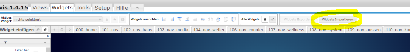

                @andbru01 sagte in Weather Underground - Bild darstellen:
                @sigi234 ok. danke. Ist mir leider zu hoch. Bin noch ganz neu hier und verstehe leider nur Bahnhof.
                Widget-Import geht hier:
                Wenn du das hier reinkopiert, hast das Widget mit den Einstellungen. Ob das bei dir passt, must du mal schauen.
                [{"tpl":"tplValueStringImg","data":{"oid":"weatherunderground.0.current.icon_url","g_fixed":false,"g_visibility":false,"g_css_font_text":false,"g_css_background":false,"g_css_shadow_padding":false,"g_css_border":false,"g_gestures":false,"g_signals":false,"visibility-cond":"==","visibility-val":1,"visibility-groups-action":"hide","refreshInterval":"0","signals-cond-0":"==","signals-val-0":true,"signals-icon-0":"/vis/signals/lowbattery.png","signals-icon-size-0":0,"signals-blink-0":false,"signals-horz-0":0,"signals-vert-0":0,"signals-hide-edit-0":false,"signals-cond-1":"==","signals-val-1":true,"signals-icon-1":"/vis/signals/lowbattery.png","signals-icon-size-1":0,"signals-blink-1":false,"signals-horz-1":0,"signals-vert-1":0,"signals-hide-edit-1":false,"signals-cond-2":"==","signals-val-2":true,"signals-icon-2":"/vis/signals/lowbattery.png","signals-icon-size-2":0,"signals-blink-2":false,"signals-horz-2":0,"signals-vert-2":0,"signals-hide-edit-2":false},"style":{"left":"759px","top":"50px","width":"50px","height":"50px"},"widgetSet":"basic"}]
