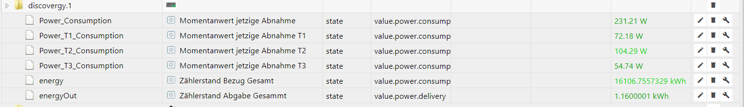

    Hallo ich würde mir gerne den Aktuellen Strom Preis in Vis anzeigen lassen
    und auch den verbrauch von Tag Monat Jahr die frage ist wie bekomme ich das hin
    Was hab ich discovergy mit folgenden daten
    Bild Text
    SourceAnalytix Adapter der nichts speichert
    ioBroker auf Proxmox (Debian) auf LENOVO PC Thinkcentre als Produktivsystem

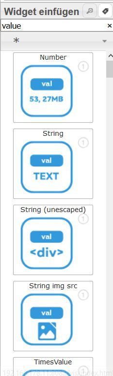

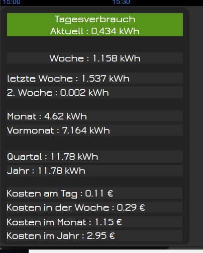

                  @Horst-Böttcher
                  Das sind ganz normale Value Widget´s.
                  [{"tpl":"tplValueFloat","data":{"oid":"sourceanalytix.0.b-control-em__0__Teridian_Total_Kanal__Wirkenergie_Bezug.consumption.01_current_day","g_fixed":false,"g_visibility":false,"g_css_font_text":true,"g_css_background":true,"g_css_shadow_padding":false,"g_css_border":false,"g_gestures":false,"g_signals":false,"g_last_change":false,"visibility-cond":"==","visibility-val":1,"visibility-groups-action":"hide","is_comma":"true","factor":"1","signals-cond-0":"==","signals-val-0":true,"signals-icon-0":"/vis/signals/lowbattery.png","signals-icon-size-0":0,"signals-blink-0":false,"signals-horz-0":0,"signals-vert-0":0,"signals-hide-edit-0":false,"signals-cond-1":"==","signals-val-1":true,"signals-icon-1":"/vis/signals/lowbattery.png","signals-icon-size-1":0,"signals-blink-1":false,"signals-horz-1":0,"signals-vert-1":0,"signals-hide-edit-1":false,"signals-cond-2":"==","signals-val-2":true,"signals-icon-2":"/vis/signals/lowbattery.png","signals-icon-size-2":0,"signals-blink-2":false,"signals-horz-2":0,"signals-vert-2":0,"signals-hide-edit-2":false,"lc-type":"last-change","lc-is-interval":true,"lc-is-moment":false,"lc-format":"","lc-position-vert":"top","lc-position-horz":"right","lc-offset-vert":0,"lc-offset-horz":0,"lc-font-size":"12px","lc-font-family":"","lc-font-style":"","lc-bkg-color":"","lc-color":"","lc-border-width":"0","lc-border-style":"","lc-border-color":"","lc-border-radius":10,"lc-zindex":0,"html_append_singular":"","html_append_plural":"   kWh","html_prepend":"Tagesverbrauch <BR>Aktuell : "},"style":{"left":"9px","top":"367px","width":"280px","height":"37px","background-color":"#57931b","text-align":"center","z-index":"2","font-family":"Jura-DemiBold"},"widgetSet":"basic"},{"tpl":"tplValueFloat","data":{"oid":"javascript.0.BSZ.Counter.Zählerstand.DELTA.EinAus1.2-WEEK.BEFORE","g_fixed":false,"g_visibility":false,"g_css_font_text":true,"g_css_background":true,"g_css_shadow_padding":false,"g_css_border":false,"g_gestures":false,"g_signals":false,"g_last_change":false,"visibility-cond":"==","visibility-val":1,"visibility-groups-action":"hide","is_comma":true,"factor":"1","signals-cond-0":"==","signals-val-0":true,"signals-icon-0":"/vis/signals/lowbattery.png","signals-icon-size-0":0,"signals-blink-0":false,"signals-horz-0":0,"signals-vert-0":0,"signals-hide-edit-0":false,"signals-cond-1":"==","signals-val-1":true,"signals-icon-1":"/vis/signals/lowbattery.png","signals-icon-size-1":0,"signals-blink-1":false,"signals-horz-1":0,"signals-vert-1":0,"signals-hide-edit-1":false,"signals-cond-2":"==","signals-val-2":true,"signals-icon-2":"/vis/signals/lowbattery.png","signals-icon-size-2":0,"signals-blink-2":false,"signals-horz-2":0,"signals-vert-2":0,"signals-hide-edit-2":false,"lc-type":"last-change","lc-is-interval":true,"lc-is-moment":false,"lc-format":"","lc-position-vert":"top","lc-position-horz":"right","lc-offset-vert":0,"lc-offset-horz":0,"lc-font-size":"12px","lc-font-family":"","lc-font-style":"","lc-bkg-color":"","lc-color":"","lc-border-width":"0","lc-border-style":"","lc-border-color":"","lc-border-radius":10,"lc-zindex":0,"html_append_singular":"","html_append_plural":"   kWh","html_prepend":"letzte Woche : ","digits":"2","is_tdp":false},"style":{"left":"9px","top":"461px","width":"280px","height":"18px","background-color":"#2e2e2e","text-align":"left","z-index":"2","font-family":"Jura-DemiBold"},"widgetSet":"basic"},{"tpl":"tplValueFloat","data":{"oid":"sourceanalytix.0.b-control-em__0__Teridian_Total_Kanal__Wirkenergie_Bezug.consumption.02_current_week","g_fixed":false,"g_visibility":false,"g_css_font_text":true,"g_css_background":true,"g_css_shadow_padding":false,"g_css_border":false,"g_gestures":false,"g_signals":false,"g_last_change":false,"visibility-cond":"==","visibility-val":1,"visibility-groups-action":"hide","is_comma":true,"factor":"1","signals-cond-0":"==","signals-val-0":true,"signals-icon-0":"/vis/signals/lowbattery.png","signals-icon-size-0":0,"signals-blink-0":false,"signals-horz-0":0,"signals-vert-0":0,"signals-hide-edit-0":false,"signals-cond-1":"==","signals-val-1":true,"signals-icon-1":"/vis/signals/lowbattery.png","signals-icon-size-1":0,"signals-blink-1":false,"signals-horz-1":0,"signals-vert-1":0,"signals-hide-edit-1":false,"signals-cond-2":"==","signals-val-2":true,"signals-icon-2":"/vis/signals/lowbattery.png","signals-icon-size-2":0,"signals-blink-2":false,"signals-horz-2":0,"signals-vert-2":0,"signals-hide-edit-2":false,"lc-type":"last-change","lc-is-interval":true,"lc-is-moment":false,"lc-format":"","lc-position-vert":"top","lc-position-horz":"right","lc-offset-vert":0,"lc-offset-horz":0,"lc-font-size":"12px","lc-font-family":"","lc-font-style":"","lc-bkg-color":"","lc-color":"","lc-border-width":"0","lc-border-style":"","lc-border-color":"","lc-border-radius":10,"lc-zindex":0,"html_append_singular":"","html_append_plural":"  kWh","html_prepend":"Woche : ","digits":"2","is_tdp":false},"style":{"left":"9px","top":"425px","width":"280px","height":"18px","background-color":"#2e2e2e","text-align":"center","z-index":"2","font-family":"Jura-DemiBold"},"widgetSet":"basic"}]
                  Horst BöttcherH 1 Antwort Letzte Antwort
                  • GlasfaserG Glasfaser
                    @Horst-Böttcher
                    Horst BöttcherH Nicht stören
                    Horst Böttcher
                    @Glasfaser du hast da ein java script drin vo bekomme ich das her und wo muss das rein
                    danke nochmal
                    • Horst BöttcherH Horst Böttcher
                      danke nochmal
                      GlasfaserG Offline
                      GlasfaserG Offline
                      Glasfaser
                      @Horst-Böttcher
                      Fange doch erst mit den beiden Widget an .( Datenpunkte zu sourceanalytix )
                      das Dritte hat nur ein Datenpunkt zum BSZ zur Anzeige des Verbrauchs "letzte Woche "

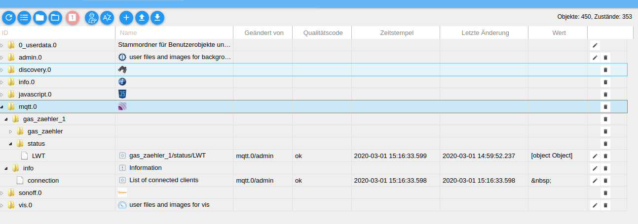

                        @crunchip sagte in Strompreis anzeigen Speichern und ausrechen:
                        @Horst-Böttcher du musst bei deinem Datenpunkt den du auswerten willst, rechts auf den Schraubenschlüssel, da ist die option für source....
                        ich sehe kein Schraubenschlüssel Symbol, muss ich dafür etwas umschalten oder aktivieren ?
                        Grüße!
                        • ? Ein ehemaliger Benutzer
                          Grüße!
                          crunchipC Abwesend
                          crunchipC Abwesend
                          crunchip
                          @ralleb dir fehlt ein Stück rechts, mach mal ein browser refresh. Oder nimm mal nen anderen Browser
                          • ? Offline
                            ? Offline
                            Leider nein. Das dachte ich auch erst aber da ist nichts. Ich habe es mit FF, Chrome und auch in der Mobilversion getestet. Der Schraubenschlüssel ist nicht da.
                            Und mit der Tab-Taste springt der Cursor vom Feld "Wert" zum nächsten Feld "Bearbeiten" / (Stift-Symbol) danach zum Mülleimer und danach zur nächsten Zeile,

                              @ralleb
                              Mache mal das :
                              cd /opt/iobroker
                              iobroker stop admin
                              iobroker upload admin
                              iobroker start admin
                              • ? Offline
                                ? Offline
                                @Glasfaser
                                leider keine Änderung. Las ,ich bitte an deinen Gedanken teilhaben und sag mir kurz was "iobroker upload admin" bewirkt.
                                Zur Info, ich bin als Admin angemeldet.
                                  @Glasfaser
                                  GlasfaserG Offline
                                  GlasfaserG Offline
                                  Glasfaser
                                  @ralleb
                                  Info zu Upload
                                  Hast du mal ein Reboot durchgeführt !?
                                  • ? Offline
                                    ? Offline
                                    die Lösung habe ich hier gefunden:
                                    Docu
                                    Das Schraubenschlüssel-Icon erscheint nur, wenn mindestens eine History-Instanz installiert ist (History, InfluxDB oder SQL).
                                    Ich hatte bisher keinen der Adapter installiert und habe jetzt den History-Adapter installiert. Das Schraubenschlüssel-Icon ist jetzt vorhanden.
