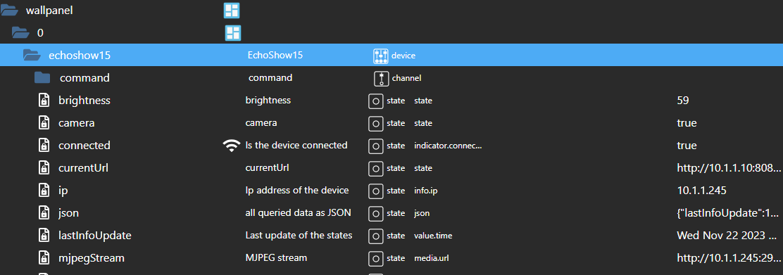

                                crunchip
                                @smarthome2020
                                script
                                <block xmlns="https://developers.google.com/blockly/xml" type="control" id="b|AJo66M8(R`wdl:)_Wb" x="-1712" y="-787">
                                 <field name="OID">0_userdata.0.Kamera.detection-echoshow15</field>
                                 <value name="VALUE">
                                   <block type="logic_boolean" id=":i(RHM+T03x=Peu*PPlU">
                                   </block>
                                 </value>
                                 <next>
                                   <block type="variables_set" id="qaA~[Wzkq@]xLUe#3_4n">
                                     <field name="VAR" id=".EQTdi?R!*!yW^#dD1Gt">zähler</field>
                                       <block type="math_number" id="Wb}[uxfh@;mrByuFwc-S">
                                         <field name="NUM">0</field>
                                       </block>
                                     </value>
                                     <next>
                                       <block type="timeouts_clearinterval" id="9uvu{^[h3~~v_m4riV.j">
                                         <field name="NAME">Intervall3</field>
                                         <next>
                                           <block type="on_ext" id="r32(JAQBE#Bn=_1YhAOo">
                                             <value name="OID0">
                                               <shadow type="field_oid" id="uHzJfDI?cyk`C:bBFG%%">
                                                 <field name="oid">0_userdata.0.Kamera.detection-echoshow15</field>
                                               </shadow>
                                             </value>
                                             <statement name="STATEMENT">
                                               <block type="controls_if" id="8b^Tf,/ff{|N.#g}C:8S">
                                                 <value name="IF0">
                                                   <block type="logic_operation" id="f`v^gv(Nskf[ii(WZ/Z}">
                                                     <field name="OP">AND</field>
                                                     <value name="A">
                                                       <block type="on_source" id="v3?N.R3{%Uzo(_L`XhLx">
                                                       </block>
                                                     </value>
                                                     <value name="B">
                                                       <block type="logic_compare" id="1//*R!lkq8u5$sP,AkPm">
                                                         <field name="OP">EQ</field>
                                                         <value name="A">
                                                           <block type="get_value" id="f_z9S)/.VH1p%|Zjv9IT">
                                                             <field name="OID">unifi.0.default.clients.f4:02:28:b4:d4:47.is_online</field>
                                                           </block>
                                                         </value>
                                                         <value name="B">
                                                           <block type="logic_boolean" id="/NZM4=7#H*D2MtV?5[(f">
                                                           </block>
                                                         </value>
                                                       </block>
                                                     </value>
                                                   </block>
                                                 </value>
                                                 <statement name="DO0">
                                                   <block type="procedures_callnoreturn" id="I0}lVbNY-w~!%!H(8jV2">
                                                     <mutation name="serie senden"></mutation>
                                                   </block>
                                                 </statement>
                                               </block>
                                             </statement>
                                           </block>
                                         </next>
                                       </block>
                                     </next>
                                   </block>
                                 </next>
                                </block>
                                detection....ist ein selbst erstellter DP der durch motioneye gesteuert wird
                                webhook URL in Motioneye
                                //10.1.1.10:8087/set/0_userdata.0.Kamera.detection-echoshow15?value=true
                                ansonsten der Adapter wallpanel und fully-tablet-control
                                https://xxbjxx.github.io/wallpanel/object-tree.html#state-overview
