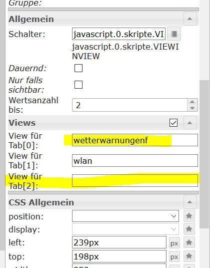

    Guten Abend,
    Ich habe ein Problem mit dem Widget "View in Widget8".
    Mit verschiedenen Werten einer Variabel blende Ich unterschiedliche Views ein.
    Das klappt soweit auch echt super, nur es wird im Hintergrund der Fehler "View wurde nicht gefunden" eingeblendet.
    Zur Visu. benutze Ich ein Samsung 10 TAB mit Fully Kiosk.
    Anbei ein Bild:
    Und das Widget
    [{"tpl":"tplStatefulContainerView8","data":{"oid":"javascript.0.skripte.VIEWINVIEW","g_fixed":true,"g_visibility":true,"g_css_font_text":false,"g_css_background":false,"g_css_shadow_padding":false,"g_css_border":false,"g_gestures":false,"g_signals":false,"g_last_change":false,"visibility-cond":"<","visibility-val":"10","visibility-groups-action":"hide","count":"2","signals-cond-0":"==","signals-val-0":true,"signals-icon-0":"/vis/signals/lowbattery.png","signals-icon-size-0":0,"signals-blink-0":false,"signals-horz-0":0,"signals-vert-0":0,"signals-hide-edit-0":false,"signals-cond-1":"==","signals-val-1":true,"signals-icon-1":"/vis/signals/lowbattery.png","signals-icon-size-1":0,"signals-blink-1":false,"signals-horz-1":0,"signals-vert-1":0,"signals-hide-edit-1":false,"signals-cond-2":"==","signals-val-2":true,"signals-icon-2":"/vis/signals/lowbattery.png","signals-icon-size-2":0,"signals-blink-2":false,"signals-horz-2":0,"signals-vert-2":0,"signals-hide-edit-2":false,"lc-type":"last-change","lc-is-interval":true,"lc-is-moment":false,"lc-format":"","lc-position-vert":"top","lc-position-horz":"right","lc-offset-vert":0,"lc-offset-horz":0,"lc-font-size":"12px","lc-font-family":"","lc-font-style":"","lc-bkg-color":"","lc-color":"","lc-border-width":"0","lc-border-style":"","lc-border-color":"","lc-border-radius":10,"lc-zindex":0,"contains_view_0":"wetterwarnungenf","notIfInvisible":false,"contains_view_1":"wlan","visibility-oid":"javascript.0.skripte.VIEWINVIEW","persistent":false},"style":{"left":"239px","top":"198px","z-index":"70","width":"858px","height":"490px"},"widgetSet":"basic"}]
    Habr Ihr eine Ahnung was Ich falsch mache?

      GlasfaserG Offline
      GlasfaserG Offline
      Glasfaser
      @Oak
      Die Meldung kommt nur , wenn der angewählte View nicht existiert .
      Also entweder ist z.B. bei deinem Wert "2" kein View hinterlegt ,
      oder dein Wert ist höher " 3 " obwohl dein Widget Wertsanzahl bis: 2 nur geht .
      Ist der View in 0 selber reinschrieben , oder ausgewählt "wetterwarnungenf" wegen den f am Ende.
      Nur die Anzahl auswählen die du auch brauchst , nicht unausgefüllt lassen.
      • O Offline
        O Offline
        Oak
        Ja Super, manchmal kann es so einfach sein.👍
