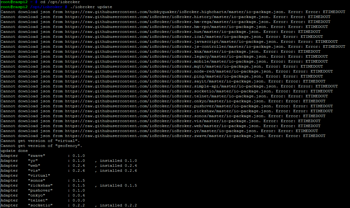

    Habt ihr das auch?

        root@pi2:/opt/iobroker# ./iobroker update
        Cannot get version of "virtual".
        Cannot get version of "geofency".
        update done
        Adapter    "zwave"         : 0.1.0
        Adapter    "yr"            : 0.1.0
        Adapter    "web"           : 0.2.4    , installed 0.2.4
        Adapter    "vis"           : 0.2.6    , installed 0.2.6
        Adapter    "virtual"
        Adapter    "sonos"         : 0.1.5    , installed 0.1.5
        Adapter    "rickshaw"      : 0.1.5
        Adapter    "pushover"      : 0.1.0
        Adapter    "onkyo"         : 0.0.4
        Adapter    "telnet"        : 0.0.0
        Adapter    "socketio"      : 0.2.2
        Adapter    "simple-api"    : 0.0.3
        Adapter    "sayit"         : 0.0.1
        Adapter    "ping"          : 0.1.3    , installed 0.1.3
        Adapter    "node-red"      : 0.1.5
        Adapter    "mqtt"          : 0.1.5
        Adapter    "mobile"        : 0.0.2
        Adapter    "legacy"        : 0.1.12
        Adapter    "knx"           : 0.0.1
        Controller "js-controller" : 0.5.11   , installed 0.5.9 [Updateable]
        Adapter    "javascript"    : 0.2.1
        Adapter    "ical"          : 0.0.2    , installed 0.0.2
        Adapter    "hue"           : 0.1.4
        Adapter    "hm-rpc"        : 0.3.5    , installed 0.3.5
        Adapter    "hm-rega"       : 0.1.17   , installed 0.1.17
        Adapter    "history"       : 0.1.3    , installed 0.1.3
        Adapter    "highcharts"    : 0.0.0
        Adapter    "graphite"      : 0.1.0
        Adapter    "geofency"
        Adapter    "example"       : 0.1.1    , installed 0.1.1
        Adapter    "email"         : 0.1.0
        Adapter    "dwd"           : 0.1.6
        Adapter    "cul"           : 0.0.2
        Adapter    "b-control-em"  : 0.1.1
        Adapter    "artnet"        : 0.0.3
        Adapter    "admin"         : 0.3.18   , installed 0.3.18

          mit Controller 0.5.11 ?
          Bei mir gehts nicht. Ich hab den Eindruck, nach dem Update geht es nicht mehr - kann mich aber teuschen.

            Auf der Maschine, die bereits Controller "js-controller" : 0.5.11 , installed 0.5.11 hat kommt:
            root@ioBroker:~# iobroker update
            Cannot download json from https://raw.githubusercontent.com/ioBroker/ioBroker.telnet/master/io-package.json. Error: Error: ETIMEDOUT
            Cannot download json from https://raw.githubusercontent.com/ioBroker/ioBroker.onkyo/master/io-package.json. Error: Error: ETIMEDOUT
            Cannot download json from https://raw.githubusercontent.com/ioBroker/ioBroker.pushover/master/io-package.json. Error: Error: ETIMEDOUT
            Cannot download json from https://raw.githubusercontent.com/ioBroker/ioBroker.rickshaw/master/io-package.json. Error: Error: ETIMEDOUT
            Cannot download json from https://raw.githubusercontent.com/ioBroker/ioBroker.sonos/master/io-package.json. Error: Error: ETIMEDOUT
            Cannot download json from https://raw.githubusercontent.com/ioBroker/ioBroker.vis/master/io-package.json. Error: Error: ETIMEDOUT
            Cannot download json from https://raw.githubusercontent.com/ioBroker/ioBroker.web/master/io-package.json. Error: Error: ETIMEDOUT
            Cannot download json from https://raw.githubusercontent.com/ioBroker/ioBroker.yr/master/io-package.json. Error: Error: ETIMEDOUT
            Cannot download json from https://raw.githubusercontent.com/ioBroker/ioBroker.zwave/master/io-package.json. Error: Error: ETIMEDOUT
            update done
            Adapter    "virtual"
            Adapter    "geofency"
            root@ioBroker:~#
            • B Offline
              B Offline
              bku
              genau - habs eben auf meinem Win-10 probiert mit controller 0.5.9, da funktioniert es. Muß also am 0.5.11 liegen …..
              • BluefoxB Offline
                BluefoxB Offline
                @bku:
                genau - habs eben auf meinem Win-10 probiert mit controller 0.5.9, da funktioniert es. Muß also am 0.5.11 liegen ….. `
                iobroker/node_modules/iobroker.js-controller/lib/tools.js. Zeile 106 ändern von :
                            request({url: urlOrPath, timeout: 1000}, function (error, response, body) {
                auf
                            request({url: urlOrPath, timeout: 5000}, function (error, response, body) {
                In der nächsten Version wird es besser. Vielleicht Antwortzeit von npm ist schlechter geworden.
