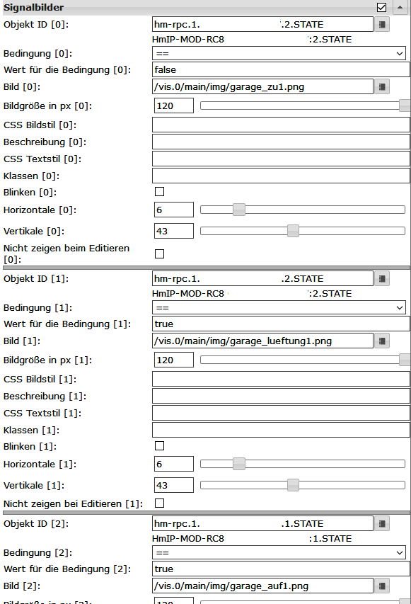

                        Ich habe es auch mal als Homematic Programm mit einer Variable getestet. Dauert aber ewig bis die aktuelle Variable im iobroker ankommt.
                        Ich habe es auch mit Signalbildern geschummelt, aber da kann man ja immer nur einen Teil ersetzen. Signal halt…

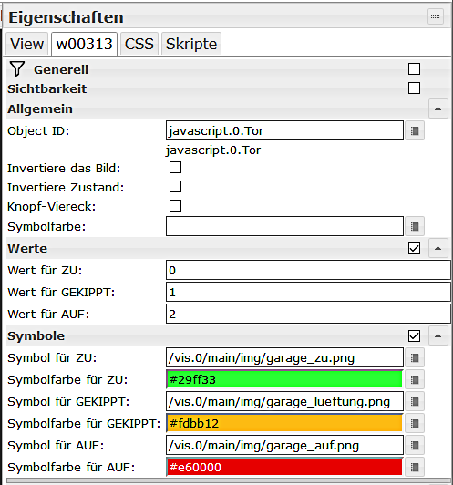

                                    Nun kann man im Vis folgendes Widget importieren:
                                    Hinweis - vorher "vis-jqui-mfd.0" Adapter installieren, sonst sieht man nichts…
                                    [{"tpl":"tplMfdDoor","data":{"oid":"nothing_selected","g_fixed":false,"g_visibility":false,"g_css_font_text":false,"g_css_background":false,"g_css_shadow_padding":false,"g_css_border":false,"g_gestures":false,"g_signals":false,"g_last_change":false,"visibility-cond":"==","visibility-val":1,"visibility-groups-action":"hide","asButton":false,"signals-cond-0":"==","signals-val-0":true,"signals-icon-0":"/vis/signals/lowbattery.png","signals-icon-size-0":0,"signals-blink-0":false,"signals-horz-0":0,"signals-vert-0":0,"signals-hide-edit-0":false,"signals-cond-1":"==","signals-val-1":true,"signals-icon-1":"/vis/signals/lowbattery.png","signals-icon-size-1":0,"signals-blink-1":false,"signals-horz-1":0,"signals-vert-1":0,"signals-hide-edit-1":false,"signals-cond-2":"==","signals-val-2":true,"signals-icon-2":"/vis/signals/lowbattery.png","signals-icon-size-2":0,"signals-blink-2":false,"signals-horz-2":0,"signals-vert-2":0,"signals-hide-edit-2":false,"lc-type":"last-change","lc-is-interval":true,"lc-is-moment":false,"lc-format":"","lc-position-vert":"top","lc-position-horz":"right","lc-offset-vert":0,"lc-offset-horz":0,"lc-font-size":"12px","lc-font-family":"","lc-font-style":"","lc-bkg-color":"","lc-color":"","lc-border-width":"0","lc-border-style":"","lc-border-color":"","lc-border-radius":10,"lc-zindex":0,"closed_icon":"/icons-mfd-svg/fts_sliding_gate_l_closed.svg","closed_iconColor":"#29ff33","tilted_icon":"/icons-mfd-svg/fts_sliding_gate.svg","opened_icon":"/icons-mfd-svg/fts_sliding_gate_open.svg","opened_iconColor":"#e60000","invert_icon":false,"invert_state":false,"tilted_iconColor":"#fdbb12"},"style":{"left":"231px","top":"461px","width":"139px","height":"128px"},"widgetSet":"jqui-mfd"}]
                                    Jetzt die Parameter im widget einstellen:
                                    Danke an paul53 und sigi234 für den Support.
