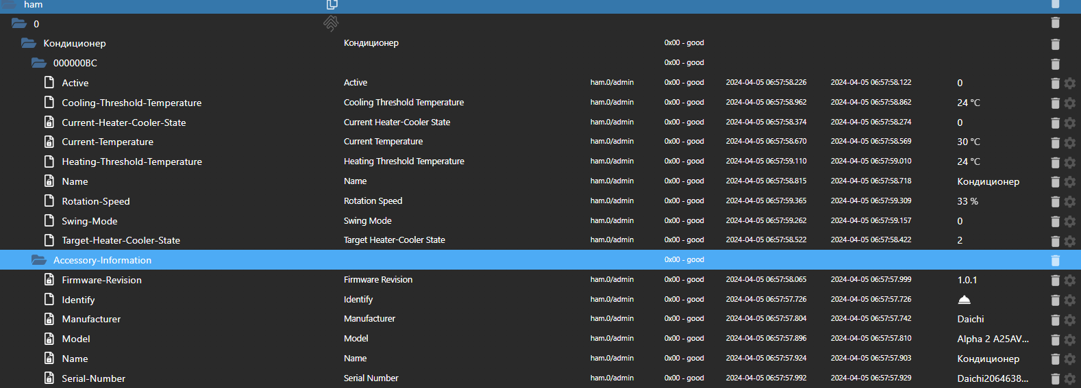

                          @apollon77
                          @alexeimotkoff/homebridge-daichi-comfort-conditioner
                            "bridge": {
                              "name": "Homebridge",
                              "username": "CC:22:3D:E3:CE:30",
                              "port": 51826,
                              "pin": "031-45-154"
                            "platforms": [
                                "name": "Daichi Comfort",
                                "username": "************",
                                "password": "************",
                                "platform": "DaichiComfortConditioner"
                          ![HAM.png](/assets/uploads/files/1712289853797-ham.png) ```
