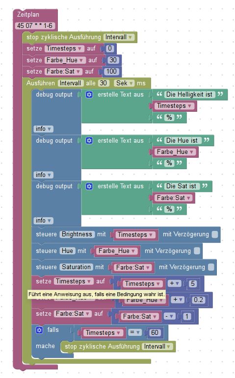

    Ich hoffe, ich habe den Bereich erwischt, wo es am stärksten geblinkt hat:
    2018-02-20 18:07:45.369 - [34mdebug[39m: tradfri.0 redis pmessage io.tradfri.0.* io.tradfri.0.L-65539.lightbulb.brightness {"val":81.1,"ack":true,"ts":1519146465317,"q":0,"from":"system.adapter.tradfri.0","lc":1519146465089} 2018-02-20 18:07:45.370 - [34mdebug[39m: tradfri.0 state with id tradfri.0.L-65539.lightbulb.brightness updated: ack=true; val=81.1 2018-02-20 18:07:45.372 - [34mdebug[39m: tradfri.0 redis pmessage io.tradfri.0.* io.tradfri.0.L-65539.lightbulb.state {"val":true,"ack":true,"ts":1519146465318,"q":0,"from":"system.adapter.tradfri.0","lc":1519146304909} 2018-02-20 18:07:45.373 - [34mdebug[39m: tradfri.0 state with id tradfri.0.L-65539.lightbulb.state updated: ack=true; val=true 2018-02-20 18:07:45.638 - [34mdebug[39m: tradfri.0 redis pmessage io.tradfri.0.* io.tradfri.0.G-169143.color {"val":"ff0000","ack":true,"ts":1519146465617,"q":0,"from":"system.adapter.tradfri.0","lc":1519146303261} 2018-02-20 18:07:45.639 - [34mdebug[39m: tradfri.0 state with id tradfri.0.G-169143.color updated: ack=true; val=ff0000 2018-02-20 18:07:45.639 - [34mdebug[39m: tradfri.0 redis pmessage io.tradfri.0.* io.tradfri.0.VG-00001.color {"val":"ff0000","ack":true,"ts":1519146465620,"q":0,"from":"system.adapter.tradfri.0","lc":1519146303265} 2018-02-20 18:07:45.640 - [34mdebug[39m: tradfri.0 state with id tradfri.0.VG-00001.color updated: ack=true; val=ff0000 2018-02-20 18:07:45.640 - [34mdebug[39m: tradfri.0 redis pmessage io.tradfri.0.* io.tradfri.0.G-169143.hue {"val":36.8,"ack":true,"ts":1519146465628,"q":0,"from":"system.adapter.tradfri.0","lc":1519146439513} 2018-02-20 18:07:45.641 - [34mdebug[39m: tradfri.0 state with id tradfri.0.G-169143.hue updated: ack=true; val=36.8 2018-02-20 18:07:45.641 - [34mdebug[39m: tradfri.0 redis pmessage io.tradfri.0.* io.tradfri.0.VG-00001.hue {"val":36.8,"ack":true,"ts":1519146465631,"q":0,"from":"system.adapter.tradfri.0","lc":1519146439516} 2018-02-20 18:07:45.642 - [34mdebug[39m: tradfri.0 state with id tradfri.0.VG-00001.hue updated: ack=true; val=36.8 2018-02-20 18:07:45.663 - [34mdebug[39m: tradfri.0 redis pmessage io.tradfri.0.* io.tradfri.0.G-169143.saturation {"val":19,"ack":true,"ts":1519146465642,"q":0,"from":"system.adapter.tradfri.0","lc":1519146465642} 2018-02-20 18:07:45.664 - [34mdebug[39m: tradfri.0 state with id tradfri.0.G-169143.saturation updated: ack=true; val=19 2018-02-20 18:07:45.665 - [34mdebug[39m: tradfri.0 redis pmessage io.tradfri.0.* io.tradfri.0.VG-00001.saturation {"val":19,"ack":true,"ts":1519146465646,"q":0,"from":"system.adapter.tradfri.0","lc":1519146465646} 2018-02-20 18:07:45.665 - [34mdebug[39m: tradfri.0 state with id tradfri.0.VG-00001.saturation updated: ack=true; val=19 2018-02-20 18:07:45.666 - [34mdebug[39m: tradfri.0 redis pmessage io.tradfri.0.* io.tradfri.0.G-169143.brightness {"val":81.1,"ack":true,"ts":1519146465649,"q":0,"from":"system.adapter.tradfri.0","lc":1519146465649} 2018-02-20 18:07:45.666 - [34mdebug[39m: tradfri.0 state with id tradfri.0.G-169143.brightness updated: ack=true; val=81.1 2018-02-20 18:07:45.667 - [34mdebug[39m: tradfri.0 redis pmessage io.tradfri.0.* io.tradfri.0.VG-00001.brightness {"val":81.1,"ack":true,"ts":1519146465652,"q":0,"from":"system.adapter.tradfri.0","lc":1519146465652} 2018-02-20 18:07:45.667 - [34mdebug[39m: tradfri.0 state with id tradfri.0.VG-00001.brightness updated: ack=true; val=81.1 2018-02-20 18:07:45.668 - [34mdebug[39m: tradfri.0 redis pmessage io.tradfri.0.* io.tradfri.0.G-169143.state {"val":true,"ack":true,"ts":1519146465655,"q":0,"from":"system.adapter.tradfri.0","lc":1519146305336} 2018-02-20 18:07:45.668 - [34mdebug[39m: tradfri.0 state with id tradfri.0.G-169143.state updated: ack=true; val=true 2018-02-20 18:07:45.669 - [34mdebug[39m: tradfri.0 redis pmessage io.tradfri.0.* io.tradfri.0.VG-00001.state {"val":true,"ack":true,"ts":1519146465658,"q":0,"from":"system.adapter.tradfri.0","lc":1519146305338} 2018-02-20 18:07:45.669 - [34mdebug[39m: tradfri.0 state with id tradfri.0.VG-00001.state updated: ack=true; val=true 2018-02-20 18:07:46.864 - [34mdebug[39m: tradfri.0 redis pmessage io.tradfri.0.* io.tradfri.0.L-65539.lightbulb.transitionDuration {"val":0,"ack":false,"ts":1519146466852,"q":0,"from":"system.adapter.javascript.0","lc":1518693662696} 2018-02-20 18:07:46.866 - [34mdebug[39m: tradfri.0 state with id tradfri.0.L-65539.lightbulb.transitionDuration updated: ack=false; val=0 2018-02-20 18:07:46.867 - [34mdebug[39m: tradfri.0 redis pmessage io.tradfri.0.* io.tradfri.0.L-65539.lightbulb.brightness {"val":82,"ack":false,"ts":1519146466853,"q":0,"from":"system.adapter.javascript.0","lc":1519146466853} 2018-02-20 18:07:46.868 - [34mdebug[39m: tradfri.0 state with id tradfri.0.L-65539.lightbulb.brightness updated: ack=false; val=82 2018-02-20 18:07:46.869 - [34mdebug[39m: tradfri.0 redis pmessage io.tradfri.0.* io.tradfri.0.L-65539.lightbulb.transitionDuration {"val":0,"ack":false,"ts":1519146466854,"q":0,"from":"system.adapter.javascript.0","lc":1518693662696} 2018-02-20 18:07:46.870 - [34mdebug[39m: tradfri.0 state with id tradfri.0.L-65539.lightbulb.transitionDuration updated: ack=false; val=0 2018-02-20 18:07:46.871 - [34mdebug[39m: tradfri.0 redis pmessage io.tradfri.0.* io.tradfri.0.L-65539.lightbulb.hue {"val":38.20000000000012,"ack":false,"ts":1519146466855,"q":0,"from":"system.adapter.javascript.0","lc":1519146466855} 2018-02-20 18:07:46.872 - [34mdebug[39m: tradfri.0 state with id tradfri.0.L-65539.lightbulb.hue updated: ack=false; val=38.20000000000012 2018-02-20 18:07:46.874 - [34mdebug[39m: tradfri.0 redis pmessage io.tradfri.0.* io.tradfri.0.L-65539.lightbulb.transitionDuration {"val":0,"ack":false,"ts":1519146466856,"q":0,"from":"system.adapter.javascript.0","lc":1518693662696} 2018-02-20 18:07:46.875 - [34mdebug[39m: tradfri.0 state with id tradfri.0.L-65539.lightbulb.transitionDuration updated: ack=false; val=0 2018-02-20 18:07:46.877 - [34mdebug[39m: tradfri.0 redis pmessage io.tradfri.0.* io.tradfri.0.L-65539.lightbulb.saturation {"val":18,"ack":false,"ts":1519146466856,"q":0,"from":"system.adapter.javascript.0","lc":1519146466856} 2018-02-20 18:07:46.882 - [34mdebug[39m: tradfri.0 state with id tradfri.0.L-65539.lightbulb.saturation updated: ack=false; val=18 2018-02-20 18:07:46.961 - [34mdebug[39m: tradfri.0 updateResource(15001/65539) > comparing {"isProxy":true,"options":{},"name":"TRADFRI bulb E27 CWS opal 600lm","createdAt":1508329856,"instanceId":65539,"type":2,"deviceInfo":{"isProxy":true,"options":{},"firmwareVersion":"1.3.002","manufacturer":"IKEA of Sweden","modelNumber":"TRADFRI bulb E27 CWS opal 600lm","power":1,"serialNumber":""},"alive":true,"lastSeen":1519137351,"otaUpdateState":0,"lightList":[{"onOff":true,"dimmer":82,"color":"f1e0b5","hue":36.8,"saturation":19,"transitionTime":0}]} with the reference {"isProxy":true,"options":{},"name":"TRADFRI bulb E27 CWS opal 600lm","createdAt":1508329856,"instanceId":65539,"type":2,"deviceInfo":{"isProxy":true,"options":{},"firmwareVersion":"1.3.002","manufacturer":"IKEA of Sweden","modelNumber":"TRADFRI bulb E27 CWS opal 600lm","power":1,"serialNumber":""},"alive":true,"lastSeen":1519137351,"otaUpdateState":0,"lightList":[{"onOff":true,"dimmer":81.1,"color":"f1e0b5","hue":36.8,"saturation":19,"transitionTime":0.5}]} 2018-02-20 18:07:46.980 - [34mdebug[39m: tradfri.0 updateResource(15001/65539) > sending payload: {"3311":[{"5712":0,"5851":208}]} 2018-02-20 18:07:47.008 - [34mdebug[39m: tradfri.0 updateResource(15001/65539) > comparing {"isProxy":true,"options":{},"name":"TRADFRI bulb E27 CWS opal 600lm","createdAt":1508329856,"instanceId":65539,"type":2,"deviceInfo":{"isProxy":true,"options":{},"firmwareVersion":"1.3.002","manufacturer":"IKEA of Sweden","modelNumber":"TRADFRI bulb E27 CWS opal 600lm","power":1,"serialNumber":""},"alive":true,"lastSeen":1519137351,"otaUpdateState":0,"lightList":[{"onOff":true,"dimmer":81.1,"color":"f1e0b5","hue":38.2,"saturation":19,"transitionTime":0}]} with the reference {"isProxy":true,"options":{},"name":"TRADFRI bulb E27 CWS opal 600lm","createdAt":1508329856,"instanceId":65539,"type":2,"deviceInfo":{"isProxy":true,"options":{},"firmwareVersion":"1.3.002","manufacturer":"IKEA of Sweden","modelNumber":"TRADFRI bulb E27 CWS opal 600lm","power":1,"serialNumber":""},"alive":true,"lastSeen":1519137351,"otaUpdateState":0,"lightList":[{"onOff":true,"dimmer":81.1,"color":"f1e0b5","hue":36.8,"saturation":19,"transitionTime":0.5}]} 2018-02-20 18:07:47.019 - [34mdebug[39m: tradfri.0 updateResource(15001/65539) > sending payload: {"3311":[{"5707":6927,"5708":12403,"5712":0,"5851":208}]} 2018-02-20 18:07:47.047 - [34mdebug[39m: tradfri.0 updateResource(15001/65539) > comparing {"isProxy":true,"options":{},"name":"TRADFRI bulb E27 CWS opal 600lm","createdAt":1508329856,"instanceId":65539,"type":2,"deviceInfo":{"isProxy":true,"options":{},"firmwareVersion":"1.3.002","manufacturer":"IKEA of Sweden","modelNumber":"TRADFRI bulb E27 CWS opal 600lm","power":1,"serialNumber":""},"alive":true,"lastSeen":1519137351,"otaUpdateState":0,"lightList":[{"onOff":true,"dimmer":81.1,"color":"f1e0b5","hue":36.8,"saturation":18,"transitionTime":0}]} with the reference {"isProxy":true,"options":{},"name":"TRADFRI bulb E27 CWS opal 600lm","createdAt":1508329856,"instanceId":65539,"type":2,"deviceInfo":{"isProxy":true,"options":{},"firmwareVersion":"1.3.002","manufacturer":"IKEA of Sweden","modelNumber":"TRADFRI bulb E27 CWS opal 600lm","power":1,"serialNumber":""},"alive":true,"lastSeen":1519137351,"otaUpdateState":0,"lightList":[{"onOff":true,"dimmer":81.1,"color":"f1e0b5","hue":36.8,"saturation":19,"transitionTime":0.5}]} 2018-02-20 18:07:47.064 - [34mdebug[39m: tradfri.0 updateResource(15001/65539) > sending payload: {"3311":[{"5707":6673,"5708":11750,"5712":0,"5851":208}]} 2018-02-20 18:07:47.071 - [34mdebug[39m: tradfri.0 redis pmessage io.tradfri.0.* io.tradfri.0.L-65539.lightbulb.transitionDuration {"val":0,"ack":true,"ts":1519146466852,"q":0,"from":"system.adapter.tradfri.0","lc":1518693662696} 2018-02-20 18:07:47.072 - [34mdebug[39m: tradfri.0 state with id tradfri.0.L-65539.lightbulb.transitionDuration updated: ack=true; val=0 2018-02-20 18:07:47.074 - [34mdebug[39m: tradfri.0 redis pmessage io.tradfri.0.* io.tradfri.0.L-65539.lightbulb.transitionDuration {"val":0,"ack":true,"ts":1519146466854,"q":0,"from":"system.adapter.tradfri.0","lc":1518693662696} 2018-02-20 18:07:47.075 - [34mdebug[39m: tradfri.0 state with id tradfri.0.L-65539.lightbulb.transitionDuration updated: ack=true; val=0 2018-02-20 18:07:47.076 - [34mdebug[39m: tradfri.0 redis pmessage io.tradfri.0.* io.tradfri.0.L-65539.lightbulb.transitionDuration {"val":0,"ack":true,"ts":1519146466856,"q":0,"from":"system.adapter.tradfri.0","lc":1518693662696} 2018-02-20 18:07:47.081 - [34mdebug[39m: tradfri.0 state with id tradfri.0.L-65539.lightbulb.transitionDuration updated: ack=true; val=0 2018-02-20 18:07:47.090 - [34mdebug[39m: tradfri.0 observeDevice > {"3":{"0":"IKEA of Sweden","1":"TRADFRI bulb E27 CWS opal 600lm","2":"","3":"1.3.002","6":1},"3311":[{"5706":"0","5707":6674,"5708":12403,"5709":22444,"5710":23378,"5850":1,"5851":208,"9003":0}],"5750":2,"9001":"TRADFRI bulb E27 CWS opal 600lm","9002":1508329856,"9003":65539,"9019":1,"9020":1519137351,"9054":0} 2018-02-20 18:07:47.118 - [34mdebug[39m: tradfri.0 observeDevice > {"3":{"0":"IKEA of Sweden","1":"TRADFRI bulb E27 CWS opal 600lm","2":"","3":"1.3.002","6":1},"3311":[{"5706":"0","5707":6927,"5708":12403,"5709":22432,"5710":23447,"5850":1,"5851":208,"9003":0}],"5750":2,"9001":"TRADFRI bulb E27 CWS opal 600lm","9002":1508329856,"9003":65539,"9019":1,"9020":1519137351,"9054":0} 2018-02-20 18:07:47.142 - [34mdebug[39m: tradfri.0 observeDevice > {"3":{"0":"IKEA of Sweden","1":"TRADFRI bulb E27 CWS opal 600lm","2":"","3":"1.3.002","6":1},"3311":[{"5706":"0","5707":6927,"5708":12403,"5709":22432,"5710":23447,"5850":1,"5851":208,"9003":0}],"5750":2,"9001":"TRADFRI bulb E27 CWS opal 600lm","9002":1508329856,"9003":65539,"9019":1,"9020":1519137351,"9054":0} 2018-02-20 18:07:47.242 - [34mdebug[39m: tradfri.0 observeDevice > {"3":{"0":"IKEA of Sweden","1":"TRADFRI bulb E27 CWS opal 600lm","2":"","3":"1.3.002","6":1},"3311":[{"5706":"0","5707":6673,"5708":11750,"5709":22326,"5710":23273,"5850":1,"5851":208,"9003":0}],"5750":2,"9001":"TRADFRI bulb E27 CWS opal 600lm","9002":1508329856,"9003":65539,"9019":1,"9020":1519137351,"9054":0} 2018-02-20 18:07:47.265 - [34mdebug[39m: tradfri.0 observeDevice > {"3":{"0":"IKEA of Sweden","1":"TRADFRI bulb E27 CWS opal 600lm","2":"","3":"1.3.002","6":1},"3311":[{"5706":"0","5707":6925,"5708":12405,"5709":22432,"5710":23447,"5850":1,"5851":208,"9003":0}],"5750":2,"9001":"TRADFRI bulb E27 CWS opal 600lm","9002":1508329856,"9003":65539,"9019":1,"9020":1519137351,"9054":0} 2018-02-20 18:07:47.282 - [34mdebug[39m: tradfri.0 observeDevice > {"3":{"0":"IKEA of Sweden","1":"TRADFRI bulb E27 CWS opal 600lm","2":"","3":"1.3.002","6":1},"3311":[{"5706":"0","5707":6674,"5708":11751,"5709":22326,"5710":23273,"5850":1,"5851":208,"9003":0}],"5750":2,"9001":"TRADFRI bulb E27 CWS opal 600lm","9002":1508329856,"9003":65539,"9019":1,"9020":1519137351,"9054":0} 2018-02-20 18:07:47.297 - [34mdebug[39m: tradfri.0 redis pmessage io.tradfri.0.* io.tradfri.0.L-65539.alive {"val":true,"ack":true,"ts":1519146467165,"q":0,"from":"system.adapter.tradfri.0","lc":1518764625370} 2018-02-20 18:07:47.298 - [34mdebug[39m: tradfri.0 state with id tradfri.0.L-65539.alive updated: ack=true; val=true 2018-02-20 18:07:47.298 - [34mdebug[39m: tradfri.0 redis pmessage io.tradfri.0.* io.tradfri.0.L-65539.lastSeen {"val":1519137351,"ack":true,"ts":1519146467170,"q":0,"from":"system.adapter.tradfri.0","lc":1519137343687} 2018-02-20 18:07:47.299 - [34mdebug[39m: tradfri.0 state with id tradfri.0.L-65539.lastSeen updated: ack=true; val=1519137351 2018-02-20 18:07:47.300 - [34mdebug[39m: tradfri.0 redis pmessage io.tradfri.0.* io.tradfri.0.L-65539.lightbulb.color {"val":"ff0000","ack":true,"ts":1519146467174,"q":0,"from":"system.adapter.tradfri.0","lc":1519146302865} 2018-02-20 18:07:47.300 - [34mdebug[39m: tradfri.0 state with id tradfri.0.L-65539.lightbulb.color updated: ack=true; val=ff0000 2018-02-20 18:07:47.301 - [34mdebug[39m: tradfri.0 redis pmessage io.tradfri.0.* io.tradfri.0.L-65539.lightbulb.hue {"val":36.8,"ack":true,"ts":1519146467178,"q":0,"from":"system.adapter.tradfri.0","lc":1519146467178} 2018-02-20 18:07:47.302 - [34mdebug[39m: tradfri.0 state with id tradfri.0.L-65539.lightbulb.hue updated: ack=true; val=36.8 2018-02-20 18:07:47.303 - [34mdebug[39m: tradfri.0 redis pmessage io.tradfri.0.* io.tradfri.0.L-65539.lightbulb.saturation {"val":19,"ack":true,"ts":1519146467181,"q":0,"from":"system.adapter.tradfri.0","lc":1519146467181} 2018-02-20 18:07:47.304 - [34mdebug[39m: tradfri.0 state with id tradfri.0.L-65539.lightbulb.saturation updated: ack=true; val=19 2018-02-20 18:07:47.305 - [34mdebug[39m: tradfri.0 redis pmessage io.tradfri.0.* io.tradfri.0.L-65539.lightbulb.brightness {"val":81.9,"ack":true,"ts":1519146467184,"q":0,"from":"system.adapter.tradfri.0","lc":1519146467184} 2018-02-20 18:07:47.305 - [34mdebug[39m: tradfri.0 state with id tradfri.0.L-65539.lightbulb.brightness updated: ack=true; val=81.9 2018-02-20 18:07:47.306 - [34mdebug[39m: tradfri.0 redis pmessage io.tradfri.0.* io.tradfri.0.L-65539.lightbulb.state {"val":true,"ack":true,"ts":1519146467188,"q":0,"from":"system.adapter.tradfri.0","lc":1519146304909} 2018-02-20 18:07:47.307 - [34mdebug[39m: tradfri.0 state with id tradfri.0.L-65539.lightbulb.state updated: ack=true; val=true 2018-02-20 18:07:47.308 - [34mdebug[39m: tradfri.0 redis pmessage io.tradfri.0.* io.tradfri.0.L-65539.alive {"val":true,"ack":true,"ts":1519146467191,"q":0,"from":"system.adapter.tradfri.0","lc":1518764625370} 2018-02-20 18:07:47.309 - [34mdebug[39m: tradfri.0 state with id tradfri.0.L-65539.alive updated: ack=true; val=true 2018-02-20 18:07:47.309 - [34mdebug[39m: tradfri.0 redis pmessage io.tradfri.0.* io.tradfri.0.L-65539.lastSeen {"val":1519137351,"ack":true,"ts":1519146467197,"q":0,"from":"system.adapter.tradfri.0","lc":1519137343687} 2018-02-20 18:07:47.310 - [34mdebug[39m: tradfri.0 state with id tradfri.0.L-65539.lastSeen updated: ack=true; val=1519137351 2018-02-20 18:07:47.310 - [34mdebug[39m: tradfri.0 redis pmessage io.tradfri.0.* io.tradfri.0.L-65539.lightbulb.color {"val":"ff0000","ack":true,"ts":1519146467200,"q":0,"from":"system.adapter.tradfri.0","lc":1519146302865} 2018-02-20 18:07:47.311 - [34mdebug[39m: tradfri.0 state with id tradfri.0.L-65539.lightbulb.color updated: ack=true; val=ff0000 2018-02-20 18:07:47.312 - [34mdebug[39m: tradfri.0 redis pmessage io.tradfri.0.* io.tradfri.0.L-65539.lightbulb.hue {"val":38.2,"ack":true,"ts":1519146467203,"q":0,"from":"system.adapter.tradfri.0","lc":1519146467203} 2018-02-20 18:07:47.312 - [34mdebug[39m: tradfri.0 state with id tradfri.0.L-65539.lightbulb.hue updated: ack=true; val=38.2 2018-02-20 18:07:47.313 - [34mdebug[39m: tradfri.0 redis pmessage io.tradfri.0.* io.tradfri.0.L-65539.lightbulb.saturation {"val":19,"ack":true,"ts":1519146467207,"q":0,"from":"system.adapter.tradfri.0","lc":1519146467207} 2018-02-20 18:07:47.314 - [34mdebug[39m: tradfri.0 state with id tradfri.0.L-65539.lightbulb.saturation updated: ack=true; val=19 2018-02-20 18:07:47.315 - [34mdebug[39m: tradfri.0 redis pmessage io.tradfri.0.* io.tradfri.0.L-65539.lightbulb.brightness {"val":81.9,"ack":true,"ts":1519146467210,"q":0,"from":"system.adapter.tradfri.0","lc":1519146467210} 2018-02-20 18:07:47.316 - [34mdebug[39m: tradfri.0 state with id tradfri.0.L-65539.lightbulb.brightness updated: ack=true; val=81.9 2018-02-20 18:07:47.317 - [34mdebug[39m: tradfri.0 redis pmessage io.tradfri.0.* io.tradfri.0.L-65539.lightbulb.state {"val":true,"ack":true,"ts":1519146467213,"q":0,"from":"system.adapter.tradfri.0","lc":1519146304909} 2018-02-20 18:07:47.317 - [34mdebug[39m: tradfri.0 state with id tradfri.0.L-65539.lightbulb.state updated: ack=true; val=true 2018-02-20 18:07:47.318 - [34mdebug[39m: tradfri.0 redis pmessage io.tradfri.0.* io.tradfri.0.L-65539.alive {"val":true,"ack":true,"ts":1519146467216,"q":0,"from":"system.adapter.tradfri.0","lc":1518764625370} 2018-02-20 18:07:47.319 - [34mdebug[39m: tradfri.0 state with id tradfri.0.L-65539.alive updated: ack=true; val=true 2018-02-20 18:07:47.319 - [34mdebug[39m: tradfri.0 redis pmessage io.tradfri.0.* io.tradfri.0.L-65539.lastSeen {"val":1519137351,"ack":true,"ts":1519146467219,"q":0,"from":"system.adapter.tradfri.0","lc":1519137343687} 2018-02-20 18:07:47.320 - [34mdebug[39m: tradfri.0 state with id tradfri.0.L-65539.lastSeen updated: ack=true; val=1519137351 2018-02-20 18:07:47.320 - [34mdebug[39m: tradfri.0 redis pmessage io.tradfri.0.* io.tradfri.0.L-65539.lightbulb.color {"val":"ff0000","ack":true,"ts":1519146467222,"q":0,"from":"system.adapter.tradfri.0","lc":1519146302865} 2018-02-20 18:07:47.321 - [34mdebug[39m: tradfri.0 state with id tradfri.0.L-65539.lightbulb.color updated: ack=true; val=ff0000 2018-02-20 18:07:47.322 - [34mdebug[39m: tradfri.0 redis pmessage io.tradfri.0.* io.tradfri.0.L-65539.lightbulb.hue {"val":38.2,"ack":true,"ts":1519146467226,"q":0,"from":"system.adapter.tradfri.0","lc":1519146467226} 2018-02-20 18:07:47.323 - [34mdebug[39m: tradfri.0 state with id tradfri.0.L-65539.lightbulb.hue updated: ack=true; val=38.2 2018-02-20 18:07:47.324 - [34mdebug[39m: tradfri.0 redis pmessage io.tradfri.0.* io.tradfri.0.L-65539.lightbulb.saturation {"val":19,"ack":true,"ts":1519146467229,"q":0,"from":"system.adapter.tradfri.0","lc":1519146467229} 2018-02-20 18:07:47.324 - [34mdebug[39m: tradfri.0 state with id tradfri.0.L-65539.lightbulb.saturation updated: ack=true; val=19 2018-02-20 18:07:47.326 - [34mdebug[39m: tradfri.0 redis pmessage io.tradfri.0.* io.tradfri.0.L-65539.lightbulb.brightness {"val":81.9,"ack":true,"ts":1519146467232,"q":0,"from":"system.adapter.tradfri.0","lc":1519146467232} 2018-02-20 18:07:47.326 - [34mdebug[39m: tradfri.0 state with id tradfri.0.L-65539.lightbulb.brightness updated: ack=true; val=81.9 2018-02-20 18:07:47.327 - [34mdebug[39m: tradfri.0 redis pmessage io.tradfri.0.* io.tradfri.0.L-65539.lightbulb.state {"val":true,"ack":true,"ts":1519146467235,"q":0,"from":"system.adapter.tradfri.0","lc":1519146304909} 2018-02-20 18:07:47.328 - [34mdebug[39m: tradfri.0 state with id tradfri.0.L-65539.lightbulb.state updated: ack=true; val=true 2018-02-20 18:07:47.396 - [34mdebug[39m: tradfri.0 redis pmessage io.tradfri.0.* io.tradfri.0.L-65539.alive {"val":true,"ack":true,"ts":1519146467329,"q":0,"from":"system.adapter.tradfri.0","lc":1518764625370} 2018-02-20 18:07:47.397 - [34mdebug[39m: tradfri.0 state with id tradfri.0.L-65539.alive updated: ack=true; val=true 2018-02-20 18:07:47.397 - [34mdebug[39m: tradfri.0 redis pmessage io.tradfri.0.* io.tradfri.0.L-65539.lastSeen {"val":1519137351,"ack":true,"ts":1519146467333,"q":0,"from":"system.adapter.tradfri.0","lc":1519137343687} 2018-02-20 18:07:47.398 - [34mdebug[39m: tradfri.0 state with id tradfri.0.L-65539.lastSeen updated: ack=true; val=1519137351 2018-02-20 18:07:47.398 - [34mdebug[39m: tradfri.0 redis pmessage io.tradfri.0.* io.tradfri.0.L-65539.lightbulb.color {"val":"ff0000","ack":true,"ts":1519146467336,"q":0,"from":"system.adapter.tradfri.0","lc":1519146302865} 2018-02-20 18:07:47.399 - [34mdebug[39m: tradfri.0 state with id tradfri.0.L-65539.lightbulb.color updated: ack=true; val=ff0000 2018-02-20 18:07:47.400 - [34mdebug[39m: tradfri.0 redis pmessage io.tradfri.0.* io.tradfri.0.L-65539.lightbulb.hue {"val":36.8,"ack":true,"ts":1519146467339,"q":0,"from":"system.adapter.tradfri.0","lc":1519146467339} 2018-02-20 18:07:47.401 - [34mdebug[39m: tradfri.0 state with id tradfri.0.L-65539.lightbulb.hue updated: ack=true; val=36.8 2018-02-20 18:07:47.402 - [34mdebug[39m: tradfri.0 redis pmessage io.tradfri.0.* io.tradfri.0.L-65539.lightbulb.saturation {"val":18,"ack":true,"ts":1519146467342,"q":0,"from":"system.adapter.tradfri.0","lc":1519146467342} 2018-02-20 18:07:47.402 - [34mdebug[39m: tradfri.0 state with id tradfri.0.L-65539.lightbulb.saturation updated: ack=true; val=18 2018-02-20 18:07:47.403 - [34mdebug[39m: tradfri.0 redis pmessage io.tradfri.0.* io.tradfri.0.L-65539.lightbulb.brightness {"val":81.9,"ack":true,"ts":1519146467345,"q":0,"from":"system.adapter.tradfri.0","lc":1519146467232} 2018-02-20 18:07:47.404 - [34mdebug[39m: tradfri.0 state with id tradfri.0.L-65539.lightbulb.brightness updated: ack=true; val=81.9 2018-02-20 18:07:47.405 - [34mdebug[39m: tradfri.0 redis pmessage io.tradfri.0.* io.tradfri.0.L-65539.lightbulb.state {"val":true,"ack":true,"ts":1519146467349,"q":0,"from":"system.adapter.tradfri.0","lc":1519146304909} 2018-02-20 18:07:47.405 - [34mdebug[39m: tradfri.0 state with id tradfri.0.L-65539.lightbulb.state updated: ack=true; val=true 2018-02-20 18:07:47.406 - [34mdebug[39m: tradfri.0 redis pmessage io.tradfri.0.* io.tradfri.0.L-65539.alive {"val":true,"ack":true,"ts":1519146467352,"q":0,"from":"system.adapter.tradfri.0","lc":1518764625370} 2018-02-20 18:07:47.407 - [34mdebug[39m: tradfri.0 state with id tradfri.0.L-65539.alive updated: ack=true; val=true 2018-02-20 18:07:47.407 - [34mdebug[39m: tradfri.0 redis pmessage io.tradfri.0.* io.tradfri.0.L-65539.lastSeen {"val":1519137351,"ack":true,"ts":1519146467355,"q":0,"from":"system.adapter.tradfri.0","lc":1519137343687} 2018-02-20 18:07:47.408 - [34mdebug[39m: tradfri.0 state with id tradfri.0.L-65539.lastSeen updated: ack=true; val=1519137351 2018-02-20 18:07:47.408 - [34mdebug[39m: tradfri.0 redis pmessage io.tradfri.0.* io.tradfri.0.L-65539.lightbulb.color {"val":"ff0000","ack":true,"ts":1519146467358,"q":0,"from":"system.adapter.tradfri.0","lc":1519146302865} 2018-02-20 18:07:47.409 - [34mdebug[39m: tradfri.0 state with id tradfri.0.L-65539.lightbulb.color updated: ack=true; val=ff0000 2018-02-20 18:07:47.410 - [34mdebug[39m: tradfri.0 redis pmessage io.tradfri.0.* io.tradfri.0.L-65539.lightbulb.hue {"val":38.2,"ack":true,"ts":1519146467361,"q":0,"from":"system.adapter.tradfri.0","lc":1519146467226} 2018-02-20 18:07:47.410 - [34mdebug[39m: tradfri.0 state with id tradfri.0.L-65539.lightbulb.hue updated: ack=true; val=38.2 2018-02-20 18:07:47.411 - [34mdebug[39m: tradfri.0 redis pmessage io.tradfri.0.* io.tradfri.0.L-65539.lightbulb.saturation {"val":19,"ack":true,"ts":1519146467364,"q":0,"from":"system.adapter.tradfri.0","lc":1519146467229} 2018-02-20 18:07:47.412 - [34mdebug[39m: tradfri.0 state with id tradfri.0.L-65539.lightbulb.saturation updated: ack=true; val=19 2018-02-20 18:07:47.413 - [34mdebug[39m: tradfri.0 redis pmessage io.tradfri.0.* io.tradfri.0.L-65539.lightbulb.brightness {"val":81.9,"ack":true,"ts":1519146467367,"q":0,"from":"system.adapter.tradfri.0","lc":1519146467232} 2018-02-20 18:07:47.413 - [34mdebug[39m: tradfri.0 state with id tradfri.0.L-65539.lightbulb.brightness updated: ack=true; val=81.9 2018-02-20 18:07:47.414 - [34mdebug[39m: tradfri.0 redis pmessage io.tradfri.0.* io.tradfri.0.L-65539.lightbulb.state {"val":true,"ack":true,"ts":1519146467370,"q":0,"from":"system.adapter.tradfri.0","lc":1519146304909} 2018-02-20 18:07:47.415 - [34mdebug[39m: tradfri.0 state with id tradfri.0.L-65539.lightbulb.state updated: ack=true; val=true 2018-02-20 18:07:47.416 - [34mdebug[39m: tradfri.0 redis pmessage io.tradfri.0.* io.tradfri.0.L-65539.alive {"val":true,"ack":true,"ts":1519146467373,"q":0,"from":"system.adapter.tradfri.0","lc":1518764625370} 2018-02-20 18:07:47.417 - [34mdebug[39m: tradfri.0 state with id tradfri.0.L-65539.alive updated: ack=true; val=true 2018-02-20 18:07:47.417 - [34mdebug[39m: tradfri.0 redis pmessage io.tradfri.0.* io.tradfri.0.L-65539.lastSeen {"val":1519137351,"ack":true,"ts":1519146467377,"q":0,"from":"system.adapter.tradfri.0","lc":1519137343687} 2018-02-20 18:07:47.418 - [34mdebug[39m: tradfri.0 state with id tradfri.0.L-65539.lastSeen updated: ack=true; val=1519137351 2018-02-20 18:07:47.418 - [34mdebug[39m: tradfri.0 redis pmessage io.tradfri.0.* io.tradfri.0.L-65539.lightbulb.color {"val":"ff0000","ack":true,"ts":1519146467380,"q":0,"from":"system.adapter.tradfri.0","lc":1519146302865} 2018-02-20 18:07:47.418 - [34mdebug[39m: tradfri.0 state with id tradfri.0.L-65539.lightbulb.color updated: ack=true; val=ff0000 2018-02-20 18:07:47.420 - [34mdebug[39m: tradfri.0 redis pmessage io.tradfri.0.* io.tradfri.0.L-65539.lightbulb.hue {"val":36.8,"ack":true,"ts":1519146467383,"q":0,"from":"system.adapter.tradfri.0","lc":1519146467383} 2018-02-20 18:07:47.420 - [34mdebug[39m: tradfri.0 state with id tradfri.0.L-65539.lightbulb.hue updated: ack=true; val=36.8 2018-02-20 18:07:47.421 - [34mdebug[39m: tradfri.0 redis pmessage io.tradfri.0.* io.tradfri.0.L-65539.lightbulb.saturation {"val":18,"ack":true,"ts":1519146467385,"q":0,"from":"system.adapter.tradfri.0","lc":1519146467385} 2018-02-20 18:07:47.422 - [34mdebug[39m: tradfri.0 state with id tradfri.0.L-65539.lightbulb.saturation updated: ack=true; val=18 2018-02-20 18:07:47.423 - [34mdebug[39m: tradfri.0 redis pmessage io.tradfri.0.* io.tradfri.0.L-65539.lightbulb.brightness {"val":81.9,"ack":true,"ts":1519146467388,"q":0,"from":"system.adapter.tradfri.0","lc":1519146467232} 2018-02-20 18:07:47.423 - [34mdebug[39m: tradfri.0 state with id tradfri.0.L-65539.lightbulb.brightness updated: ack=true; val=81.9 2018-02-20 18:07:47.424 - [34mdebug[39m: tradfri.0 redis pmessage io.tradfri.0.* io.tradfri.0.L-65539.lightbulb.state {"val":true,"ack":true,"ts":1519146467391,"q":0,"from":"system.adapter.tradfri.0","lc":1519146304909} 2018-02-20 18:07:47.425 - [34mdebug[39m: tradfri.0 state with id tradfri.0.L-65539.lightbulb.state updated: ack=true; val=true 2018-02-20 18:07:47.698 - [34mdebug[39m: tradfri.0 redis pmessage io.tradfri.0.* io.tradfri.0.G-169143.color {"val":"ff0000","ack":true,"ts":1519146467674,"q":0,"from":"system.adapter.tradfri.0","lc":1519146303261} 2018-02-20 18:07:47.699 - [34mdebug[39m: tradfri.0 state with id tradfri.0.G-169143.color updated: ack=true; val=ff0000 2018-02-20 18:07:47.700 - [34mdebug[39m: tradfri.0 redis pmessage io.tradfri.0.* io.tradfri.0.VG-00001.color {"val":"ff0000","ack":true,"ts":1519146467677,"q":0,"from":"system.adapter.tradfri.0","lc":1519146303265} 2018-02-20 18:07:47.700 - [34mdebug[39m: tradfri.0 state with id tradfri.0.VG-00001.color updated: ack=true; val=ff0000 2018-02-20 18:07:47.700 - [34mdebug[39m: tradfri.0 redis pmessage io.tradfri.0.* io.tradfri.0.G-169143.hue {"val":36.8,"ack":true,"ts":1519146467684,"q":0,"from":"system.adapter.tradfri.0","lc":1519146439513} 2018-02-20 18:07:47.701 - [34mdebug[39m: tradfri.0 state with id tradfri.0.G-169143.hue updated: ack=true; val=36.8 2018-02-20 18:07:47.701 - [34mdebug[39m: tradfri.0 redis pmessage io.tradfri.0.* io.tradfri.0.VG-00001.hue {"val":36.8,"ack":true,"ts":1519146467687,"q":0,"from":"system.adapter.tradfri.0","lc":1519146439516} 2018-02-20 18:07:47.702 - [34mdebug[39m: tradfri.0 state with id tradfri.0.VG-00001.hue updated: ack=true; val=36.8 2018-02-20 18:07:47.702 - [34mdebug[39m: tradfri.0 redis pmessage io.tradfri.0.* io.tradfri.0.G-169143.saturation {"val":18,"ack":true,"ts":1519146467690,"q":0,"from":"system.adapter.tradfri.0","lc":1519146467690} 2018-02-20 18:07:47.703 - [34mdebug[39m: tradfri.0 state with id tradfri.0.G-169143.saturation updated: ack=true; val=18 2018-02-20 18:07:47.703 - [34mdebug[39m: tradfri.0 redis pmessage io.tradfri.0.* io.tradfri.0.VG-00001.saturation {"val":18,"ack":true,"ts":1519146467693,"q":0,"from":"system.adapter.tradfri.0","lc":1519146467693} 2018-02-20 18:07:47.704 - [34mdebug[39m: tradfri.0 state with id tradfri.0.VG-00001.saturation updated: ack=true; val=18 2018-02-20 18:07:47.717 - [34mdebug[39m: tradfri.0 redis pmessage io.tradfri.0.* io.tradfri.0.G-169143.brightness {"val":81.9,"ack":true,"ts":1519146467704,"q":0,"from":"system.adapter.tradfri.0","lc":1519146467704} 2018-02-20 18:07:47.718 - [34mdebug[39m: tradfri.0 state with id tradfri.0.G-169143.brightness updated: ack=true; val=81.9 2018-02-20 18:07:47.718 - [34mdebug[39m: tradfri.0 redis pmessage io.tradfri.0.* io.tradfri.0.VG-00001.brightness {"val":81.9,"ack":true,"ts":1519146467707,"q":0,"from":"system.adapter.tradfri.0","lc":1519146467707} 2018-02-20 18:07:47.719 - [34mdebug[39m: tradfri.0 state with id tradfri.0.VG-00001.brightness updated: ack=true; val=81.9 2018-02-20 18:07:47.719 - [34mdebug[39m: tradfri.0 redis pmessage io.tradfri.0.* io.tradfri.0.G-169143.state {"val":true,"ack":true,"ts":1519146467710,"q":0,"from":"system.adapter.tradfri.0","lc":1519146305336} 2018-02-20 18:07:47.720 - [34mdebug[39m: tradfri.0 state with id tradfri.0.G-169143.state updated: ack=true; val=true 2018-02-20 18:07:47.720 - [34mdebug[39m: tradfri.0 redis pmessage io.tradfri.0.* io.tradfri.0.VG-00001.state {"val":true,"ack":true,"ts":1519146467713,"q":0,"from":"system.adapter.tradfri.0","lc":1519146305338} 2018-02-20 18:07:47.721 - [34mdebug[39m: tradfri.0 state with id tradfri.0.VG-00001.state updated: ack=true; val=true 2018-02-20 18:07:48.863 - [34mdebug[39m: tradfri.0 redis pmessage io.tradfri.0.* io.tradfri.0.L-65539.lightbulb.transitionDuration {"val":0,"ack":false,"ts":1519146468853,"q":0,"from":"system.adapter.javascript.0","lc":1518693662696} 2018-02-20 18:07:48.864 - [34mdebug[39m: tradfri.0 state with id tradfri.0.L-65539.lightbulb.transitionDuration updated: ack=false; val=0 2018-02-20 18:07:48.865 - [34mdebug[39m: tradfri.0 redis pmessage io.tradfri.0.* io.tradfri.0.L-65539.lightbulb.brightness {"val":83,"ack":false,"ts":1519146468853,"q":0,"from":"system.adapter.javascript.0","lc":1519146468853} 2018-02-20 18:07:48.866 - [34mdebug[39m: tradfri.0 state with id tradfri.0.L-65539.lightbulb.brightness updated: ack=false; val=83 2018-02-20 18:07:48.867 - [34mdebug[39m: tradfri.0 redis pmessage io.tradfri.0.* io.tradfri.0.L-65539.lightbulb.transitionDuration {"val":0,"ack":false,"ts":1519146468854,"q":0,"from":"system.adapter.javascript.0","lc":1518693662696} 2018-02-20 18:07:48.867 - [34mdebug[39m: tradfri.0 state with id tradfri.0.L-65539.lightbulb.transitionDuration updated: ack=false; val=0 2018-02-20 18:07:48.871 - [34mdebug[39m: tradfri.0 redis pmessage io.tradfri.0.* io.tradfri.0.L-65539.lightbulb.hue {"val":38.30000000000012,"ack":false,"ts":1519146468854,"q":0,"from":"system.adapter.javascript.0","lc":1519146468854} 2018-02-20 18:07:48.872 - [34mdebug[39m: tradfri.0 state with id tradfri.0.L-65539.lightbulb.hue updated: ack=false; val=38.30000000000012 2018-02-20 18:07:48.873 - [34mdebug[39m: tradfri.0 redis pmessage io.tradfri.0.* io.tradfri.0.L-65539.lightbulb.transitionDuration {"val":0,"ack":false,"ts":1519146468855,"q":0,"from":"system.adapter.javascript.0","lc":1518693662696} 2018-02-20 18:07:48.873 - [34mdebug[39m: tradfri.0 state with id tradfri.0.L-65539.lightbulb.transitionDuration updated: ack=false; val=0 2018-02-20 18:07:48.874 - [34mdebug[39m: tradfri.0 redis pmessage io.tradfri.0.* io.tradfri.0.L-65539.lightbulb.saturation {"val":17,"ack":false,"ts":1519146468856,"q":0,"from":"system.adapter.javascript.0","lc":1519146468856} 2018-02-20 18:07:48.875 - [34mdebug[39m: tradfri.0 state with id tradfri.0.L-65539.lightbulb.saturation updated: ack=false; val=17 2018-02-20 18:07:48.905 - [34mdebug[39m: tradfri.0 updateResource(15001/65539) > comparing {"isProxy":true,"options":{},"name":"TRADFRI bulb E27 CWS opal 600lm","createdAt":1508329856,"instanceId":65539,"type":2,"deviceInfo":{"isProxy":true,"options":{},"firmwareVersion":"1.3.002","manufacturer":"IKEA of Sweden","modelNumber":"TRADFRI bulb E27 CWS opal 600lm","power":1,"serialNumber":""},"alive":true,"lastSeen":1519137351,"otaUpdateState":0,"lightList":[{"onOff":true,"dimmer":83,"color":"f1e0b5","hue":36.8,"saturation":18,"transitionTime":0}]} with the reference {"isProxy":true,"options":{},"name":"TRADFRI bulb E27 CWS opal 600lm","createdAt":1508329856,"instanceId":65539,"type":2,"deviceInfo":{"isProxy":true,"options":{},"firmwareVersion":"1.3.002","manufacturer":"IKEA of Sweden","modelNumber":"TRADFRI bulb E27 CWS opal 600lm","power":1,"serialNumber":""},"alive":true,"lastSeen":1519137351,"otaUpdateState":0,"lightList":[{"onOff":true,"dimmer":81.9,"color":"f1e0b5","hue":36.8,"saturation":18,"transitionTime":0.5}]} 2018-02-20 18:07:48.912 - [34mdebug[39m: tradfri.0 updateResource(15001/65539) > sending payload: {"3311":[{"5712":0,"5851":211}]} 2018-02-20 18:07:48.931 - [34mdebug[39m: tradfri.0 updateResource(15001/65539) > comparing {"isProxy":true,"options":{},"name":"TRADFRI bulb E27 CWS opal 600lm","createdAt":1508329856,"instanceId":65539,"type":2,"deviceInfo":{"isProxy":true,"options":{},"firmwareVersion":"1.3.002","manufacturer":"IKEA of Sweden","modelNumber":"TRADFRI bulb E27 CWS opal 600lm","power":1,"serialNumber":""},"alive":true,"lastSeen":1519137351,"otaUpdateState":0,"lightList":[{"onOff":true,"dimmer":81.9,"color":"f1e0b5","hue":38.3,"saturation":18,"transitionTime":0}]} with the reference {"isProxy":true,"options":{},"name":"TRADFRI bulb E27 CWS opal 600lm","createdAt":1508329856,"instanceId":65539,"type":2,"deviceInfo":{"isProxy":true,"options":{},"firmwareVersion":"1.3.002","manufacturer":"IKEA of Sweden","modelNumber":"TRADFRI bulb E27 CWS opal 600lm","power":1,"serialNumber":""},"alive":true,"lastSeen":1519137351,"otaUpdateState":0,"lightList":[{"onOff":true,"dimmer":81.9,"color":"f1e0b5","hue":36.8,"saturation":18,"transitionTime":0.5}]} 2018-02-20 18:07:48.938 - [34mdebug[39m: tradfri.0 updateResource(15001/65539) > sending payload: {"3311":[{"5707":6945,"5708":11750,"5712":0,"5851":211}]} 2018-02-20 18:07:48.956 - [34mdebug[39m: tradfri.0 updateResource(15001/65539) > comparing {"isProxy":true,"options":{},"name":"TRADFRI bulb E27 CWS opal 600lm","createdAt":1508329856,"instanceId":65539,"type":2,"deviceInfo":{"isProxy":true,"options":{},"firmwareVersion":"1.3.002","manufacturer":"IKEA of Sweden","modelNumber":"TRADFRI bulb E27 CWS opal 600lm","power":1,"serialNumber":""},"alive":true,"lastSeen":1519137351,"otaUpdateState":0,"lightList":[{"onOff":true,"dimmer":81.9,"color":"f1e0b5","hue":36.8,"saturation":17,"transitionTime":0}]} with the reference {"isProxy":true,"options":{},"name":"TRADFRI bulb E27 CWS opal 600lm","createdAt":1508329856,"instanceId":65539,"type":2,"deviceInfo":{"isProxy":true,"options":{},"firmwareVersion":"1.3.002","manufacturer":"IKEA of Sweden","modelNumber":"TRADFRI bulb E27 CWS opal 600lm","power":1,"serialNumber":""},"alive":true,"lastSeen":1519137351,"otaUpdateState":0,"lightList":[{"onOff":true,"dimmer":81.9,"color":"f1e0b5","hue":36.8,"saturation":18,"transitionTime":0.5}]} 2018-02-20 18:07:48.963 - [34mdebug[39m: tradfri.0 updateResource(15001/65539) > sending payload: {"3311":[{"5707":6673,"5708":11097,"5712":0,"5851":211}]} 2018-02-20 18:07:48.969 - [34mdebug[39m: tradfri.0 redis pmessage io.tradfri.0.* io.tradfri.0.L-65539.lightbulb.transitionDuration {"val":0,"ack":true,"ts":1519146468853,"q":0,"from":"system.adapter.tradfri.0","lc":1518693662696} 2018-02-20 18:07:48.970 - [34mdebug[39m: tradfri.0 state with id tradfri.0.L-65539.lightbulb.transitionDuration updated: ack=true; val=0 2018-02-20 18:07:48.971 - [34mdebug[39m: tradfri.0 redis pmessage io.tradfri.0.* io.tradfri.0.L-65539.lightbulb.transitionDuration {"val":0,"ack":true,"ts":1519146468854,"q":0,"from":"system.adapter.tradfri.0","lc":1518693662696} 2018-02-20 18:07:48.971 - [34mdebug[39m: tradfri.0 state with id tradfri.0.L-65539.lightbulb.transitionDuration updated: ack=true; val=0 2018-02-20 18:07:48.972 - [34mdebug[39m: tradfri.0 redis pmessage io.tradfri.0.* io.tradfri.0.L-65539.lightbulb.transitionDuration {"val":0,"ack":true,"ts":1519146468855,"q":0,"from":"system.adapter.tradfri.0","lc":1518693662696} 2018-02-20 18:07:48.973 - [34mdebug[39m: tradfri.0 state with id tradfri.0.L-65539.lightbulb.transitionDuration updated: ack=true; val=0 2018-02-20 18:07:48.978 - [34mdebug[39m: tradfri.0 observeDevice > {"3":{"0":"IKEA of Sweden","1":"TRADFRI bulb E27 CWS opal 600lm","2":"","3":"1.3.002","6":1},"3311":[{"5706":"0","5707":6674,"5708":11751,"5709":22326,"5710":23273,"5850":1,"5851":211,"9003":0}],"5750":2,"9001":"TRADFRI bulb E27 CWS opal 600lm","9002":1508329856,"9003":65539,"9019":1,"9020":1519137351,"9054":0} 2018-02-20 18:07:48.998 - [34mdebug[39m: tradfri.0 observeDevice > {"3":{"0":"IKEA of Sweden","1":"TRADFRI bulb E27 CWS opal 600lm","2":"","3":"1.3.002","6":1},"3311":[{"5706":"0","5707":6945,"5708":11750,"5709":22314,"5710":23343,"5850":1,"5851":211,"9003":0}],"5750":2,"9001":"TRADFRI bulb E27 CWS opal 600lm","9002":1508329856,"9003":65539,"9019":1,"9020":1519137351,"9054":0} 2018-02-20 18:07:49.062 - [34mdebug[39m: tradfri.0 observeDevice > {"3":{"0":"IKEA of Sweden","1":"TRADFRI bulb E27 CWS opal 600lm","2":"","3":"1.3.002","6":1},"3311":[{"5706":"0","5707":6673,"5708":11097,"5709":22209,"5710":23168,"5850":1,"5851":211,"9003":0}],"5750":2,"9001":"TRADFRI bulb E27 CWS opal 600lm","9002":1508329856,"9003":65539,"9019":1,"9020":1519137351,"9054":0} 2018-02-20 18:07:49.078 - [34mdebug[39m: tradfri.0 redis pmessage io.tradfri.0.* io.tradfri.0.L-65539.alive {"val":true,"ack":true,"ts":1519146469014,"q":0,"from":"system.adapter.tradfri.0","lc":1518764625370} 2018-02-20 18:07:49.079 - [34mdebug[39m: tradfri.0 state with id tradfri.0.L-65539.alive updated: ack=true; val=true 2018-02-20 18:07:49.079 - [34mdebug[39m: tradfri.0 redis pmessage io.tradfri.0.* io.tradfri.0.L-65539.lastSeen {"val":1519137351,"ack":true,"ts":1519146469018,"q":0,"from":"system.adapter.tradfri.0","lc":1519137343687} 2018-02-20 18:07:49.080 - [34mdebug[39m: tradfri.0 state with id tradfri.0.L-65539.lastSeen updated: ack=true; val=1519137351 2018-02-20 18:07:49.080 - [34mdebug[39m: tradfri.0 redis pmessage io.tradfri.0.* io.tradfri.0.L-65539.lightbulb.color {"val":"ff0000","ack":true,"ts":1519146469021,"q":0,"from":"system.adapter.tradfri.0","lc":1519146302865} 2018-02-20 18:07:49.081 - [34mdebug[39m: tradfri.0 state with id tradfri.0.L-65539.lightbulb.color updated: ack=true; val=ff0000 2018-02-20 18:07:49.082 - [34mdebug[39m: tradfri.0 redis pmessage io.tradfri.0.* io.tradfri.0.L-65539.lightbulb.hue {"val":36.8,"ack":true,"ts":1519146469024,"q":0,"from":"system.adapter.tradfri.0","lc":1519146469024} 2018-02-20 18:07:49.083 - [34mdebug[39m: tradfri.0 state with id tradfri.0.L-65539.lightbulb.hue updated: ack=true; val=36.8 2018-02-20 18:07:49.084 - [34mdebug[39m: tradfri.0 redis pmessage io.tradfri.0.* io.tradfri.0.L-65539.lightbulb.saturation {"val":18,"ack":true,"ts":1519146469027,"q":0,"from":"system.adapter.tradfri.0","lc":1519146469027} 2018-02-20 18:07:49.084 - [34mdebug[39m: tradfri.0 state with id tradfri.0.L-65539.lightbulb.saturation updated: ack=true; val=18 2018-02-20 18:07:49.086 - [34mdebug[39m: tradfri.0 redis pmessage io.tradfri.0.* io.tradfri.0.L-65539.lightbulb.brightness {"val":83.1,"ack":true,"ts":1519146469030,"q":0,"from":"system.adapter.tradfri.0","lc":1519146469030} 2018-02-20 18:07:49.086 - [34mdebug[39m: tradfri.0 state with id tradfri.0.L-65539.lightbulb.brightness updated: ack=true; val=83.1 2018-02-20 18:07:49.088 - [34mdebug[39m: tradfri.0 redis pmessage io.tradfri.0.* io.tradfri.0.L-65539.lightbulb.state {"val":true,"ack":true,"ts":1519146469033,"q":0,"from":"system.adapter.tradfri.0","lc":1519146304909} 2018-02-20 18:07:49.088 - [34mdebug[39m: tradfri.0 state with id tradfri.0.L-65539.lightbulb.state updated: ack=true; val=true 2018-02-20 18:07:49.089 - [34mdebug[39m: tradfri.0 redis pmessage io.tradfri.0.* io.tradfri.0.L-65539.alive {"val":true,"ack":true,"ts":1519146469036,"q":0,"from":"system.adapter.tradfri.0","lc":1518764625370} 2018-02-20 18:07:49.090 - [34mdebug[39m: tradfri.0 state with id tradfri.0.L-65539.alive updated: ack=true; val=true 2018-02-20 18:07:49.090 - [34mdebug[39m: tradfri.0 redis pmessage io.tradfri.0.* io.tradfri.0.L-65539.lastSeen {"val":1519137351,"ack":true,"ts":1519146469039,"q":0,"from":"system.adapter.tradfri.0","lc":1519137343687} 2018-02-20 18:07:49.091 - [34mdebug[39m: tradfri.0 state with id tradfri.0.L-65539.lastSeen updated: ack=true; val=1519137351 2018-02-20 18:07:49.091 - [34mdebug[39m: tradfri.0 redis pmessage io.tradfri.0.* io.tradfri.0.L-65539.lightbulb.color {"val":"ff0000","ack":true,"ts":1519146469042,"q":0,"from":"system.adapter.tradfri.0","lc":1519146302865} 2018-02-20 18:07:49.092 - [34mdebug[39m: tradfri.0 state with id tradfri.0.L-65539.lightbulb.color updated: ack=true; val=ff0000 2018-02-20 18:07:49.093 - [34mdebug[39m: tradfri.0 redis pmessage io.tradfri.0.* io.tradfri.0.L-65539.lightbulb.hue {"val":38.3,"ack":true,"ts":1519146469045,"q":0,"from":"system.adapter.tradfri.0","lc":1519146469045} 2018-02-20 18:07:49.094 - [34mdebug[39m: tradfri.0 state with id tradfri.0.L-65539.lightbulb.hue updated: ack=true; val=38.3 2018-02-20 18:07:49.095 - [34mdebug[39m: tradfri.0 redis pmessage io.tradfri.0.* io.tradfri.0.L-65539.lightbulb.saturation {"val":18,"ack":true,"ts":1519146469049,"q":0,"from":"system.adapter.tradfri.0","lc":1519146469049} 2018-02-20 18:07:49.095 - [34mdebug[39m: tradfri.0 state with id tradfri.0.L-65539.lightbulb.saturation updated: ack=true; val=18 2018-02-20 18:07:49.096 - [34mdebug[39m: tradfri.0 redis pmessage io.tradfri.0.* io.tradfri.0.L-65539.lightbulb.brightness {"val":83.1,"ack":true,"ts":1519146469052,"q":0,"from":"system.adapter.tradfri.0","lc":1519146469052} 2018-02-20 18:07:49.097 - [34mdebug[39m: tradfri.0 state with id tradfri.0.L-65539.lightbulb.brightness updated: ack=true; val=83.1 2018-02-20 18:07:49.098 - [34mdebug[39m: tradfri.0 redis pmessage io.tradfri.0.* io.tradfri.0.L-65539.lightbulb.state {"val":true,"ack":true,"ts":1519146469055,"q":0,"from":"system.adapter.tradfri.0","lc":1519146304909} 2018-02-20 18:07:49.099 - [34mdebug[39m: tradfri.0 state with id tradfri.0.L-65539.lightbulb.state updated: ack=true; val=true 2018-02-20 18:07:49.124 - [34mdebug[39m: tradfri.0 redis pmessage io.tradfri.0.* io.tradfri.0.L-65539.alive {"val":true,"ack":true,"ts":1519146469100,"q":0,"from":"system.adapter.tradfri.0","lc":1518764625370} 2018-02-20 18:07:49.125 - [34mdebug[39m: tradfri.0 state with id tradfri.0.L-65539.alive updated: ack=true; val=true 2018-02-20 18:07:49.126 - [34mdebug[39m: tradfri.0 redis pmessage io.tradfri.0.* io.tradfri.0.L-65539.lastSeen {"val":1519137351,"ack":true,"ts":1519146469103,"q":0,"from":"system.adapter.tradfri.0","lc":1519137343687} 2018-02-20 18:07:49.126 - [34mdebug[39m: tradfri.0 state with id tradfri.0.L-65539.lastSeen updated: ack=true; val=1519137351 2018-02-20 18:07:49.127 - [34mdebug[39m: tradfri.0 redis pmessage io.tradfri.0.* io.tradfri.0.L-65539.lightbulb.color {"val":"ff0000","ack":true,"ts":1519146469107,"q":0,"from":"system.adapter.tradfri.0","lc":1519146302865} 2018-02-20 18:07:49.127 - [34mdebug[39m: tradfri.0 state with id tradfri.0.L-65539.lightbulb.color updated: ack=true; val=ff0000 2018-02-20 18:07:49.129 - [34mdebug[39m: tradfri.0 redis pmessage io.tradfri.0.* io.tradfri.0.L-65539.lightbulb.hue {"val":36.8,"ack":true,"ts":1519146469110,"q":0,"from":"system.adapter.tradfri.0","lc":1519146469110} 2018-02-20 18:07:49.129 - [34mdebug[39m: tradfri.0 state with id tradfri.0.L-65539.lightbulb.hue updated: ack=true; val=36.8 2018-02-20 18:07:49.130 - [34mdebug[39m: tradfri.0 redis pmessage io.tradfri.0.* io.tradfri.0.L-65539.lightbulb.saturation {"val":17,"ack":true,"ts":1519146469113,"q":0,"from":"system.adapter.tradfri.0","lc":1519146469113} 2018-02-20 18:07:49.131 - [34mdebug[39m: tradfri.0 state with id tradfri.0.L-65539.lightbulb.saturation updated: ack=true; val=17 2018-02-20 18:07:49.132 - [34mdebug[39m: tradfri.0 redis pmessage io.tradfri.0.* io.tradfri.0.L-65539.lightbulb.brightness {"val":83.1,"ack":true,"ts":1519146469116,"q":0,"from":"system.adapter.tradfri.0","lc":1519146469052} 2018-02-20 18:07:49.132 - [34mdebug[39m: tradfri.0 state with id tradfri.0.L-65539.lightbulb.brightness updated: ack=true; val=83.1 2018-02-20 18:07:49.133 - [34mdebug[39m: tradfri.0 redis pmessage io.tradfri.0.* io.tradfri.0.L-65539.lightbulb.state {"val":true,"ack":true,"ts":1519146469119,"q":0,"from":"system.adapter.tradfri.0","lc":1519146304909} 2018-02-20 18:07:49.134 - [34mdebug[39m: tradfri.0 state with id tradfri.0.L-65539.lightbulb.state updated: ack=true; val=true 2018-02-20 18:07:49.137 - [34mdebug[39m: tradfri.0 observeDevice > {"3":{"0":"IKEA of Sweden","1":"TRADFRI bulb E27 CWS opal 600lm","2":"","3":"1.3.002","6":1},"3311":[{"5706":"0","5707":6944,"5708":11752,"5709":22314,"5710":23343,"5850":1,"5851":211,"9003":0}],"5750":2,"9001":"TRADFRI bulb E27 CWS opal 600lm","9002":1508329856,"9003":65539,"9019":1,"9020":1519137351,"9054":0} 2018-02-20 18:07:49.154 - [34mdebug[39m: tradfri.0 observeDevice > {"3":{"0":"IKEA of Sweden","1":"TRADFRI bulb E27 CWS opal 600lm","2":"","3":"1.3.002","6":1},"3311":[{"5706":"0","5707":6673,"5708":11099,"5709":22209,"5710":23168,"5850":1,"5851":211,"9003":0}],"5750":2,"9001":"TRADFRI bulb E27 CWS opal 600lm","9002":1508329856,"9003":65539,"9019":1,"9020":1519137351,"9054":0} 2018-02-20 18:07:49.239 - [34mdebug[39m: tradfri.0 redis pmessage io.tradfri.0.* io.tradfri.0.L-65539.alive {"val":true,"ack":true,"ts":1519146469172,"q":0,"from":"system.adapter.tradfri.0","lc":1518764625370} 2018-02-20 18:07:49.240 - [34mdebug[39m: tradfri.0 state with id tradfri.0.L-65539.alive updated: ack=true; val=true 2018-02-20 18:07:49.241 - [34mdebug[39m: tradfri.0 redis pmessage io.tradfri.0.* io.tradfri.0.L-65539.lastSeen {"val":1519137351,"ack":true,"ts":1519146469176,"q":0,"from":"system.adapter.tradfri.0","lc":1519137343687} 2018-02-20 18:07:49.242 - [34mdebug[39m: tradfri.0 state with id tradfri.0.L-65539.lastSeen updated: ack=true; val=1519137351 2018-02-20 18:07:49.243 - [34mdebug[39m: tradfri.0 redis pmessage io.tradfri.0.* io.tradfri.0.L-65539.lightbulb.color {"val":"ff0000","ack":true,"ts":1519146469180,"q":0,"from":"system.adapter.tradfri.0","lc":1519146302865} 2018-02-20 18:07:49.244 - [34mdebug[39m: tradfri.0 state with id tradfri.0.L-65539.lightbulb.color updated: ack=true; val=ff0000 2018-02-20 18:07:49.246 - [34mdebug[39m: tradfri.0 redis pmessage io.tradfri.0.* io.tradfri.0.L-65539.lightbulb.hue {"val":38.3,"ack":true,"ts":1519146469184,"q":0,"from":"system.adapter.tradfri.0","lc":1519146469184} 2018-02-20 18:07:49.247 - [34mdebug[39m: tradfri.0 state with id tradfri.0.L-65539.lightbulb.hue updated: ack=true; val=38.3 2018-02-20 18:07:49.248 - [34mdebug[39m: tradfri.0 redis pmessage io.tradfri.0.* io.tradfri.0.L-65539.lightbulb.saturation {"val":18,"ack":true,"ts":1519146469192,"q":0,"from":"system.adapter.tradfri.0","lc":1519146469192} 2018-02-20 18:07:49.249 - [34mdebug[39m: tradfri.0 state with id tradfri.0.L-65539.lightbulb.saturation updated: ack=true; val=18 2018-02-20 18:07:49.251 - [34mdebug[39m: tradfri.0 redis pmessage io.tradfri.0.* io.tradfri.0.L-65539.lightbulb.brightness {"val":83.1,"ack":true,"ts":1519146469197,"q":0,"from":"system.adapter.tradfri.0","lc":1519146469052} 2018-02-20 18:07:49.252 - [34mdebug[39m: tradfri.0 state with id tradfri.0.L-65539.lightbulb.brightness updated: ack=true; val=83.1 2018-02-20 18:07:49.253 - [34mdebug[39m: tradfri.0 redis pmessage io.tradfri.0.* io.tradfri.0.L-65539.lightbulb.state {"val":true,"ack":true,"ts":1519146469201,"q":0,"from":"system.adapter.tradfri.0","lc":1519146304909} 2018-02-20 18:07:49.254 - [34mdebug[39m: tradfri.0 state with id tradfri.0.L-65539.lightbulb.state updated: ack=true; val=true 2018-02-20 18:07:49.256 - [34mdebug[39m: tradfri.0 redis pmessage io.tradfri.0.* io.tradfri.0.L-65539.alive {"val":true,"ack":true,"ts":1519146469205,"q":0,"from":"system.adapter.tradfri.0","lc":1518764625370} 2018-02-20 18:07:49.257 - [34mdebug[39m: tradfri.0 state with id tradfri.0.L-65539.alive updated: ack=true; val=true 2018-02-20 18:07:49.257 - [34mdebug[39m: tradfri.0 redis pmessage io.tradfri.0.* io.tradfri.0.L-65539.lastSeen {"val":1519137351,"ack":true,"ts":1519146469210,"q":0,"from":"system.adapter.tradfri.0","lc":1519137343687} 2018-02-20 18:07:49.258 - [34mdebug[39m: tradfri.0 state with id tradfri.0.L-65539.lastSeen updated: ack=true; val=1519137351 2018-02-20 18:07:49.259 - [34mdebug[39m: tradfri.0 redis pmessage io.tradfri.0.* io.tradfri.0.L-65539.lightbulb.color {"val":"ff0000","ack":true,"ts":1519146469214,"q":0,"from":"system.adapter.tradfri.0","lc":1519146302865} 2018-02-20 18:07:49.260 - [34mdebug[39m: tradfri.0 state with id tradfri.0.L-65539.lightbulb.color updated: ack=true; val=ff0000 2018-02-20 18:07:49.262 - [34mdebug[39m: tradfri.0 redis pmessage io.tradfri.0.* io.tradfri.0.L-65539.lightbulb.hue {"val":36.8,"ack":true,"ts":1519146469219,"q":0,"from":"system.adapter.tradfri.0","lc":1519146469110} 2018-02-20 18:07:49.263 - [34mdebug[39m: tradfri.0 state with id tradfri.0.L-65539.lightbulb.hue updated: ack=true; val=36.8 2018-02-20 18:07:49.264 - [34mdebug[39m: tradfri.0 redis pmessage io.tradfri.0.* io.tradfri.0.L-65539.lightbulb.saturation {"val":17,"ack":true,"ts":1519146469224,"q":0,"from":"system.adapter.tradfri.0","lc":1519146469113} 2018-02-20 18:07:49.265 - [34mdebug[39m: tradfri.0 state with id tradfri.0.L-65539.lightbulb.saturation updated: ack=true; val=17 2018-02-20 18:07:49.267 - [34mdebug[39m: tradfri.0 redis pmessage io.tradfri.0.* io.tradfri.0.L-65539.lightbulb.brightness {"val":83.1,"ack":true,"ts":1519146469228,"q":0,"from":"system.adapter.tradfri.0","lc":1519146469052} 2018-02-20 18:07:49.268 - [34mdebug[39m: tradfri.0 state with id tradfri.0.L-65539.lightbulb.brightness updated: ack=true; val=83.1 2018-02-20 18:07:49.269 - [34mdebug[39m: tradfri.0 redis pmessage io.tradfri.0.* io.tradfri.0.L-65539.lightbulb.state {"val":true,"ack":true,"ts":1519146469233,"q":0,"from":"system.adapter.tradfri.0","lc":1519146304909} 2018-02-20 18:07:49.270 - [34mdebug[39m: tradfri.0 state with id tradfri.0.L-65539.lightbulb.state updated: ack=true; val=true 2018-02-20 18:07:49.559 - [34mdebug[39m: tradfri.0 redis pmessage io.tradfri.0.* io.tradfri.0.G-169143.color {"val":"ff0000","ack":true,"ts":1519146469521,"q":0,"from":"system.adapter.tradfri.0","lc":1519146303261} 2018-02-20 18:07:49.561 - [34mdebug[39m: tradfri.0 state with id tradfri.0.G-169143.color updated: ack=true; val=ff0000 2018-02-20 18:07:49.561 - [34mdebug[39m: tradfri.0 redis pmessage io.tradfri.0.* io.tradfri.0.VG-00001.color {"val":"ff0000","ack":true,"ts":1519146469525,"q":0,"from":"system.adapter.tradfri.0","lc":1519146303265} 2018-02-20 18:07:49.562 - [34mdebug[39m: tradfri.0 state with id tradfri.0.VG-00001.color updated: ack=true; val=ff0000 2018-02-20 18:07:49.563 - [34mdebug[39m: tradfri.0 redis pmessage io.tradfri.0.* io.tradfri.0.G-169143.hue {"val":36.8,"ack":true,"ts":1519146469529,"q":0,"from":"system.adapter.tradfri.0","lc":1519146439513} 2018-02-20 18:07:49.564 - [34mdebug[39m: tradfri.0 state with id tradfri.0.G-169143.hue updated: ack=true; val=36.8 2018-02-20 18:07:49.564 - [34mdebug[39m: tradfri.0 redis pmessage io.tradfri.0.* io.tradfri.0.VG-00001.hue {"val":36.8,"ack":true,"ts":1519146469533,"q":0,"from":"system.adapter.tradfri.0","lc":1519146439516} 2018-02-20 18:07:49.565 - [34mdebug[39m: tradfri.0 state with id tradfri.0.VG-00001.hue updated: ack=true; val=36.8 2018-02-20 18:07:49.566 - [34mdebug[39m: tradfri.0 redis pmessage io.tradfri.0.* io.tradfri.0.G-169143.saturation {"val":17,"ack":true,"ts":1519146469543,"q":0,"from":"system.adapter.tradfri.0","lc":1519146469543} 2018-02-20 18:07:49.566 - [34mdebug[39m: tradfri.0 state with id tradfri.0.G-169143.saturation updated: ack=true; val=17 2018-02-20 18:07:49.567 - [34mdebug[39m: tradfri.0 redis pmessage io.tradfri.0.* io.tradfri.0.VG-00001.saturation {"val":17,"ack":true,"ts":1519146469547,"q":0,"from":"system.adapter.tradfri.0","lc":1519146469547} 2018-02-20 18:07:49.568 - [34mdebug[39m: tradfri.0 state with id tradfri.0.VG-00001.saturation updated: ack=true; val=17 2018-02-20 18:07:49.568 - [34mdebug[39m: tradfri.0 redis pmessage io.tradfri.0.* io.tradfri.0.G-169143.brightness {"val":83.1,"ack":true,"ts":1519146469552,"q":0,"from":"system.adapter.tradfri.0","lc":1519146469552} 2018-02-20 18:07:49.569 - [34mdebug[39m: tradfri.0 state with id tradfri.0.G-169143.brightness updated: ack=true; val=83.1 2018-02-20 18:07:49.585 - [34mdebug[39m: tradfri.0 redis pmessage io.tradfri.0.* io.tradfri.0.VG-00001.brightness {"val":83.1,"ack":true,"ts":1519146469570,"q":0,"from":"system.adapter.tradfri.0","lc":1519146469570} 2018-02-20 18:07:49.587 - [34mdebug[39m: tradfri.0 state with id tradfri.0.VG-00001.brightness updated: ack=true; val=83.1 2018-02-20 18:07:49.587 - [34mdebug[39m: tradfri.0 redis pmessage io.tradfri.0.* io.tradfri.0.G-169143.state {"val":true,"ack":true,"ts":1519146469574,"q":0,"from":"system.adapter.tradfri.0","lc":1519146305336} 2018-02-20 18:07:49.588 - [34mdebug[39m: tradfri.0 state with id tradfri.0.G-169143.state updated: ack=true; val=true 2018-02-20 18:07:49.589 - [34mdebug[39m: tradfri.0 redis pmessage io.tradfri.0.* io.tradfri.0.VG-00001.state {"val":true,"ack":true,"ts":1519146469579,"q":0,"from":"system.adapter.tradfri.0","lc":1519146305338} 2018-02-20 18:07:49.590 - [34mdebug[39m: tradfri.0 state with id tradfri.0.VG-00001.state updated: ack=true; val=true 2018-02-20 18:07:50.188 - [34mdebug[39m: tradfri.0 ping successful... 2018-02-20 18:07:50.896 - [34mdebug[39m: tradfri.0 redis pmessage io.tradfri.0.* io.tradfri.0.L-65539.lightbulb.transitionDuration {"val":0,"ack":false,"ts":1519146470861,"q":0,"from":"system.adapter.javascript.0","lc":1518693662696} 2018-02-20 18:07:50.900 - [34mdebug[39m: tradfri.0 state with id tradfri.0.L-65539.lightbulb.transitionDuration updated: ack=false; val=0 2018-02-20 18:07:50.903 - [34mdebug[39m: tradfri.0 redis pmessage io.tradfri.0.* io.tradfri.0.L-65539.lightbulb.brightness {"val":84,"ack":false,"ts":1519146470864,"q":0,"from":"system.adapter.javascript.0","lc":1519146470864} 2018-02-20 18:07:50.908 - [34mdebug[39m: tradfri.0 state with id tradfri.0.L-65539.lightbulb.brightness updated: ack=false; val=84[/code]

      @Homoran:
      Also wäre IMHO das log zum Ende wohl am hilfreichsten, oder? `
      Am liebsten sogar den Anfang, d.h. die ersten paar Befehle. Dann sehe ich den Ausgangszustand und warum das auseinander läuft.

          @Homoran:
          Dann eben auch noch der Anfang ;-) `
          Okay, ich glaube ich habe verstanden, was die Ursache ist. Meine letzten Versuche haben am falschen Ende angesetzt.

            @Homoran: Bitte mal v1.1.5 probieren - ich konnte noch nicht testen, aber hoffe, dass es jetzt läuft.
            Ich nehme die Kombination von Hue und Sat jetzt direkt im Adapter vor, sodass immer der tatsächliche State-Wert übermittelt werden sollte.

              Sorry :(
              31.3	true		2018-02-22 16:13:28.926
              27.4	true		2018-02-22 16:13:28.569
              31.30000000000002	false		2018-02-22 16:13:28.350
              27.4	true		2018-02-22 16:13:26.989
              31.2	true		2018-02-22 16:13:26.821
              31.200000000000017	false		2018-02-22 16:13:26.334
              27.4	true		2018-02-22 16:13:24.758
              31.1	true		2018-02-22 16:13:24.569
              31.100000000000016	false		2018-02-22 16:13:24.342
              27.4	true		2018-02-22 16:13:23.001
              31	true		2018-02-22 16:13:22.996
              27.4	true		2018-02-22 16:13:22.592
              31.000000000000014	false		2018-02-22 16:13:22.336
              27.4	true		2018-02-22 16:13:20.799
              30.9	true		2018-02-22 16:13:20.637
              27.4	true		2018-02-22 16:13:20.615
              30.900000000000013	false		2018-02-22 16:13:20.326
              27.4	true		2018-02-22 16:13:18.744
              30.8	true		2018-02-22 16:13:18.637
              30.80000000000001	false		2018-02-22 16:13:18.328
              27.4	true		2018-02-22 16:13:16.754
              30.7	true		2018-02-22 16:13:16.573
              30.70000000000001	false		2018-02-22 16:13:1

                :roll: Dann brauch ich wieder nen Debug-Log.
                Edit: Nevermind, ich hab vergessen, das TypeScript in JavaScript zu kompilieren. Sekunde…!
                Edit 2: Nochmal mit 1.1.6 probieren bitte!

                  nochmal 1.1.5:
                  ! 2018-02-22 16:13:01.427 - [33mwarn[39m: javascript.0 script.js.Wiffi: (Error: connect EHOSTUNREACH 192.168.138.57:80) ERROR bei Abfrage von: http://192.168.138.57/?json: 2018-02-22 16:13:01.428 - [33mwarn[39m: javascript.0 script.js.Wiffi: Fehler beim Auslesen des JSON. Keine Daten erhalten. 2018-02-22 16:13:01.430 - [33mwarn[39m: javascript.0 script.js.Wiffi: (Error: connect EHOSTUNREACH 192.168.138.57:80) ERROR bei Abfrage von: http://192.168.138.57/?json: 2018-02-22 16:13:01.430 - [33mwarn[39m: javascript.0 script.js.Wiffi: Fehler beim Auslesen des JSON. Keine Daten erhalten. 2018-02-22 16:13:02.294 - [34mdebug[39m: tradfri.0 redis pmessage io.tradfri.0.* io.tradfri.0.L-65539.lightbulb.transitionDuration {"val":0,"ack":false,"ts":1519312382293,"q":0,"from":"system.adapter.javascript.0","lc":1518693662696} 2018-02-22 16:13:02.295 - [34mdebug[39m: tradfri.0 state with id tradfri.0.L-65539.lightbulb.transitionDuration updated: ack=false; val=0 2018-02-22 16:13:02.299 - [34mdebug[39m: tradfri.0 redis pmessage io.tradfri.0.* io.tradfri.0.L-65539.lightbulb.brightness {"val":0,"ack":false,"ts":1519312382294,"q":0,"from":"system.adapter.javascript.0","lc":1519312382294} 2018-02-22 16:13:02.300 - [34mdebug[39m: tradfri.0 state with id tradfri.0.L-65539.lightbulb.brightness updated: ack=false; val=0 2018-02-22 16:13:02.301 - [34mdebug[39m: tradfri.0 redis pmessage io.tradfri.0.* io.tradfri.0.L-65539.lightbulb.transitionDuration {"val":0,"ack":false,"ts":1519312382295,"q":0,"from":"system.adapter.javascript.0","lc":1518693662696} 2018-02-22 16:13:02.302 - [34mdebug[39m: tradfri.0 state with id tradfri.0.L-65539.lightbulb.transitionDuration updated: ack=false; val=0 2018-02-22 16:13:02.303 - [34mdebug[39m: tradfri.0 redis pmessage io.tradfri.0.* io.tradfri.0.L-65539.lightbulb.hue {"val":30,"ack":false,"ts":1519312382297,"q":0,"from":"system.adapter.javascript.0","lc":1519312382297} 2018-02-22 16:13:02.303 - [34mdebug[39m: tradfri.0 state with id tradfri.0.L-65539.lightbulb.hue updated: ack=false; val=30 2018-02-22 16:13:02.305 - [34mdebug[39m: tradfri.0 redis pmessage io.tradfri.0.* io.tradfri.0.L-65539.lightbulb.transitionDuration {"val":0,"ack":false,"ts":1519312382298,"q":0,"from":"system.adapter.javascript.0","lc":1518693662696} 2018-02-22 16:13:02.305 - [34mdebug[39m: tradfri.0 state with id tradfri.0.L-65539.lightbulb.transitionDuration updated: ack=false; val=0 2018-02-22 16:13:02.306 - [34mdebug[39m: tradfri.0 redis pmessage io.tradfri.0.* io.tradfri.0.L-65539.lightbulb.transitionDuration {"val":0,"ack":true,"ts":1519312382293,"q":0,"from":"system.adapter.tradfri.0","lc":1518693662696} 2018-02-22 16:13:02.307 - [34mdebug[39m: tradfri.0 state with id tradfri.0.L-65539.lightbulb.transitionDuration updated: ack=true; val=0 2018-02-22 16:13:02.308 - [34mdebug[39m: tradfri.0 redis pmessage io.tradfri.0.* io.tradfri.0.L-65539.lightbulb.saturation {"val":100,"ack":false,"ts":1519312382298,"q":0,"from":"system.adapter.javascript.0","lc":1519312382298} 2018-02-22 16:13:02.309 - [34mdebug[39m: tradfri.0 state with id tradfri.0.L-65539.lightbulb.saturation updated: ack=false; val=100 2018-02-22 16:13:02.327 - [34mdebug[39m: tradfri.0 updateResource(15001/65539) > comparing {"isProxy":true,"options":{},"name":"TRADFRI bulb E27 CWS opal 600lm","createdAt":1508329856,"instanceId":65539,"type":2,"deviceInfo":{"isProxy":true,"options":{},"firmwareVersion":"1.3.002","manufacturer":"IKEA of Sweden","modelNumber":"TRADFRI bulb E27 CWS opal 600lm","power":1,"serialNumber":""},"alive":true,"lastSeen":1519312195,"otaUpdateState":0,"lightList":[{"onOff":false,"dimmer":0,"color":"f1e0b5","hue":27.5,"saturation":96.5,"transitionTime":0}]} with the reference {"isProxy":true,"options":{},"name":"TRADFRI bulb E27 CWS opal 600lm","createdAt":1508329856,"instanceId":65539,"type":2,"deviceInfo":{"isProxy":true,"options":{},"firmwareVersion":"1.3.002","manufacturer":"IKEA of Sweden","modelNumber":"TRADFRI bulb E27 CWS opal 600lm","power":1,"serialNumber":""},"alive":true,"lastSeen":1519312195,"otaUpdateState":0,"lightList":[{"onOff":false,"dimmer":98,"color":"f1e0b5","hue":27.5,"saturation":96.5,"transitionTime":0.5}]} 2018-02-22 16:13:02.332 - [34mdebug[39m: tradfri.0 updateResource(15001/65539) > sending payload: {"3311":[{"5712":0,"5851":0}]} 2018-02-22 16:13:02.349 - [34mdebug[39m: tradfri.0 updateResource(15001/65539) > comparing {"isProxy":true,"options":{},"name":"TRADFRI bulb E27 CWS opal 600lm","createdAt":1508329856,"instanceId":65539,"type":2,"deviceInfo":{"isProxy":true,"options":{},"firmwareVersion":"1.3.002","manufacturer":"IKEA of Sweden","modelNumber":"TRADFRI bulb E27 CWS opal 600lm","power":1,"serialNumber":""},"alive":true,"lastSeen":1519312195,"otaUpdateState":0,"lightList":[{"onOff":false,"dimmer":98,"color":"f1e0b5","hue":30,"saturation":96.5,"transitionTime":0}]} with the reference {"isProxy":true,"options":{},"name":"TRADFRI bulb E27 CWS opal 600lm","createdAt":1508329856,"instanceId":65539,"type":2,"deviceInfo":{"isProxy":true,"options":{},"firmwareVersion":"1.3.002","manufacturer":"IKEA of Sweden","modelNumber":"TRADFRI bulb E27 CWS opal 600lm","power":1,"serialNumber":""},"alive":true,"lastSeen":1519312195,"otaUpdateState":0,"lightList":[{"onOff":false,"dimmer":98,"color":"f1e0b5","hue":27.5,"saturation":96.5,"transitionTime":0.5}]} 2018-02-22 16:13:02.354 - [34mdebug[39m: tradfri.0 updateResource(15001/65539) > sending payload: {"3311":[{"5707":5440,"5708":62994,"5712":0,"5851":0}]} 2018-02-22 16:13:02.368 - [34mdebug[39m: tradfri.0 updateResource(15001/65539) > comparing {"isProxy":true,"options":{},"name":"TRADFRI bulb E27 CWS opal 600lm","createdAt":1508329856,"instanceId":65539,"type":2,"deviceInfo":{"isProxy":true,"options":{},"firmwareVersion":"1.3.002","manufacturer":"IKEA of Sweden","modelNumber":"TRADFRI bulb E27 CWS opal 600lm","power":1,"serialNumber":""},"alive":true,"lastSeen":1519312195,"otaUpdateState":0,"lightList":[{"onOff":false,"dimmer":98,"color":"f1e0b5","hue":27.5,"saturation":100,"transitionTime":0}]} with the reference {"isProxy":true,"options":{},"name":"TRADFRI bulb E27 CWS opal 600lm","createdAt":1508329856,"instanceId":65539,"type":2,"deviceInfo":{"isProxy":true,"options":{},"firmwareVersion":"1.3.002","manufacturer":"IKEA of Sweden","modelNumber":"TRADFRI bulb E27 CWS opal 600lm","power":1,"serialNumber":""},"alive":true,"lastSeen":1519312195,"otaUpdateState":0,"lightList":[{"onOff":false,"dimmer":98,"color":"f1e0b5","hue":27.5,"saturation":96.5,"transitionTime":0.5}]} 2018-02-22 16:13:02.374 - [34mdebug[39m: tradfri.0 updateResource(15001/65539) > sending payload: {"3311":[{"5707":4987,"5708":65279,"5712":0,"5851":0}]} 2018-02-22 16:13:02.378 - [34mdebug[39m: tradfri.0 redis pmessage io.tradfri.0.* io.tradfri.0.L-65539.lightbulb.transitionDuration {"val":0,"ack":true,"ts":1519312382295,"q":0,"from":"system.adapter.tradfri.0","lc":1518693662696} 2018-02-22 16:13:02.378 - [34mdebug[39m: tradfri.0 state with id tradfri.0.L-65539.lightbulb.transitionDuration updated: ack=true; val=0 2018-02-22 16:13:02.379 - [34mdebug[39m: tradfri.0 redis pmessage io.tradfri.0.* io.tradfri.0.L-65539.lightbulb.transitionDuration {"val":0,"ack":true,"ts":1519312382298,"q":0,"from":"system.adapter.tradfri.0","lc":1518693662696} 2018-02-22 16:13:02.379 - [34mdebug[39m: tradfri.0 state with id tradfri.0.L-65539.lightbulb.transitionDuration updated: ack=true; val=0 2018-02-22 16:13:02.384 - [34mdebug[39m: tradfri.0 observeDevice > {"3":{"0":"IKEA of Sweden","1":"TRADFRI bulb E27 CWS opal 600lm","2":"","3":"1.3.002","6":1},"3311":[{"5706":"ebb63e","5707":4980,"5708":62974,"5709":35848,"5710":26214,"5850":0,"5851":0,"9003":0}],"5750":2,"9001":"TRADFRI bulb E27 CWS opal 600lm","9002":1508329856,"9003":65539,"9019":1,"9020":1519312198,"9054":0} 2018-02-22 16:13:02.403 - [34mdebug[39m: tradfri.0 observeDevice > {"3":{"0":"IKEA of Sweden","1":"TRADFRI bulb E27 CWS opal 600lm","2":"","3":"1.3.002","6":1},"3311":[{"5706":"0","5707":5440,"5708":62994,"5709":35038,"5710":26860,"5850":0,"5851":0,"9003":0}],"5750":2,"9001":"TRADFRI bulb E27 CWS opal 600lm","9002":1508329856,"9003":65539,"9019":1,"9020":1519312198,"9054":0} 2018-02-22 16:13:02.416 - [34mdebug[39m: tradfri.0 redis pmessage io.tradfri.0.* io.tradfri.0.L-65539.alive {"val":true,"ack":true,"ts":1519312382397,"q":0,"from":"system.adapter.tradfri.0","lc":1519312187666} 2018-02-22 16:13:02.417 - [34mdebug[39m: tradfri.0 state with id tradfri.0.L-65539.alive updated: ack=true; val=true 2018-02-22 16:13:02.417 - [34mdebug[39m: tradfri.0 redis pmessage io.tradfri.0.* io.tradfri.0.L-65539.lastSeen {"val":1519312198,"ack":true,"ts":1519312382397,"q":0,"from":"system.adapter.tradfri.0","lc":1519312382397} 2018-02-22 16:13:02.418 - [34mdebug[39m: tradfri.0 state with id tradfri.0.L-65539.lastSeen updated: ack=true; val=1519312198 2018-02-22 16:13:02.418 - [34mdebug[39m: tradfri.0 redis pmessage io.tradfri.0.* io.tradfri.0.L-65539.lightbulb.color {"val":"ebb63e","ack":true,"ts":1519312382398,"q":0,"from":"system.adapter.tradfri.0","lc":1519312188368} 2018-02-22 16:13:02.418 - [34mdebug[39m: tradfri.0 state with id tradfri.0.L-65539.lightbulb.color updated: ack=true; val=ebb63e 2018-02-22 16:13:02.419 - [34mdebug[39m: tradfri.0 redis pmessage io.tradfri.0.* io.tradfri.0.L-65539.lightbulb.hue {"val":27.5,"ack":true,"ts":1519312382399,"q":0,"from":"system.adapter.tradfri.0","lc":1519312382399} 2018-02-22 16:13:02.420 - [34mdebug[39m: tradfri.0 state with id tradfri.0.L-65539.lightbulb.hue updated: ack=true; val=27.5 2018-02-22 16:13:02.421 - [34mdebug[39m: tradfri.0 redis pmessage io.tradfri.0.* io.tradfri.0.L-65539.lightbulb.saturation {"val":96.5,"ack":true,"ts":1519312382399,"q":0,"from":"system.adapter.tradfri.0","lc":1519312382399} 2018-02-22 16:13:02.421 - [34mdebug[39m: tradfri.0 state with id tradfri.0.L-65539.lightbulb.saturation updated: ack=true; val=96.5 2018-02-22 16:13:02.422 - [34mdebug[39m: tradfri.0 redis pmessage io.tradfri.0.* io.tradfri.0.L-65539.lightbulb.brightness {"val":0,"ack":true,"ts":1519312382399,"q":0,"from":"system.adapter.tradfri.0","lc":1519312382294} 2018-02-22 16:13:02.422 - [34mdebug[39m: tradfri.0 state with id tradfri.0.L-65539.lightbulb.brightness updated: ack=true; val=0 2018-02-22 16:13:02.423 - [34mdebug[39m: tradfri.0 redis pmessage io.tradfri.0.* io.tradfri.0.L-65539.lightbulb.state {"val":false,"ack":true,"ts":1519312382400,"q":0,"from":"system.adapter.tradfri.0","lc":1519312188373} 2018-02-22 16:13:02.424 - [34mdebug[39m: tradfri.0 state with id tradfri.0.L-65539.lightbulb.state updated: ack=true; val=false 2018-02-22 16:13:02.429 - [34mdebug[39m: tradfri.0 redis pmessage io.tradfri.0.* io.tradfri.0.L-65539.alive {"val":true,"ack":true,"ts":1519312382424,"q":0,"from":"system.adapter.tradfri.0","lc":1519312187666} 2018-02-22 16:13:02.429 - [34mdebug[39m: tradfri.0 state with id tradfri.0.L-65539.alive updated: ack=true; val=true 2018-02-22 16:13:02.430 - [34mdebug[39m: tradfri.0 redis pmessage io.tradfri.0.* io.tradfri.0.L-65539.lastSeen {"val":1519312198,"ack":true,"ts":1519312382425,"q":0,"from":"system.adapter.tradfri.0","lc":1519312382397} 2018-02-22 16:13:02.430 - [34mdebug[39m: tradfri.0 state with id tradfri.0.L-65539.lastSeen updated: ack=true; val=1519312198 2018-02-22 16:13:02.431 - [34mdebug[39m: tradfri.0 redis pmessage io.tradfri.0.* io.tradfri.0.L-65539.lightbulb.color {"val":"ff0000","ack":true,"ts":1519312382425,"q":0,"from":"system.adapter.tradfri.0","lc":1519312382425} 2018-02-22 16:13:02.431 - [34mdebug[39m: tradfri.0 state with id tradfri.0.L-65539.lightbulb.color updated: ack=true; val=ff0000 2018-02-22 16:13:02.433 - [34mdebug[39m: tradfri.0 redis pmessage io.tradfri.0.* io.tradfri.0.L-65539.lightbulb.hue {"val":30,"ack":true,"ts":1519312382426,"q":0,"from":"system.adapter.tradfri.0","lc":1519312382426} 2018-02-22 16:13:02.433 - [34mdebug[39m: tradfri.0 state with id tradfri.0.L-65539.lightbulb.hue updated: ack=true; val=30 2018-02-22 16:13:02.434 - [34mdebug[39m: tradfri.0 redis pmessage io.tradfri.0.* io.tradfri.0.L-65539.lightbulb.saturation {"val":96.5,"ack":true,"ts":1519312382426,"q":0,"from":"system.adapter.tradfri.0","lc":1519312382399} 2018-02-22 16:13:02.435 - [34mdebug[39m: tradfri.0 state with id tradfri.0.L-65539.lightbulb.saturation updated: ack=true; val=96.5 2018-02-22 16:13:02.436 - [34mdebug[39m: tradfri.0 redis pmessage io.tradfri.0.* io.tradfri.0.L-65539.lightbulb.brightness {"val":0,"ack":true,"ts":1519312382427,"q":0,"from":"system.adapter.tradfri.0","lc":1519312382294} 2018-02-22 16:13:02.437 - [34mdebug[39m: tradfri.0 state with id tradfri.0.L-65539.lightbulb.brightness updated: ack=true; val=0 2018-02-22 16:13:02.438 - [34mdebug[39m: tradfri.0 redis pmessage io.tradfri.0.* io.tradfri.0.L-65539.lightbulb.state {"val":false,"ack":true,"ts":1519312382427,"q":0,"from":"system.adapter.tradfri.0","lc":1519312188373} 2018-02-22 16:13:02.441 - [34mdebug[39m: tradfri.0 state with id tradfri.0.L-65539.lightbulb.state updated: ack=true; val=false 2018-02-22 16:13:02.445 - [34mdebug[39m: tradfri.0 observeDevice > {"3":{"0":"IKEA of Sweden","1":"TRADFRI bulb E27 CWS opal 600lm","2":"","3":"1.3.002","6":1},"3311":[{"5706":"0","5707":4987,"5708":65279,"5709":36240,"5710":25940,"5850":0,"5851":0,"9003":0}],"5750":2,"9001":"TRADFRI bulb E27 CWS opal 600lm","9002":1508329856,"9003":65539,"9019":1,"9020":1519312198,"9054":0} 2018-02-22 16:13:02.460 - [34mdebug[39m: tradfri.0 redis pmessage io.tradfri.0.* io.tradfri.0.L-65539.alive {"val":true,"ack":true,"ts":1519312382456,"q":0,"from":"system.adapter.tradfri.0","lc":1519312187666} 2018-02-22 16:13:02.460 - [34mdebug[39m: tradfri.0 state with id tradfri.0.L-65539.alive updated: ack=true; val=true 2018-02-22 16:13:02.461 - [34mdebug[39m: tradfri.0 redis pmessage io.tradfri.0.* io.tradfri.0.L-65539.lastSeen {"val":1519312198,"ack":true,"ts":1519312382457,"q":0,"from":"system.adapter.tradfri.0","lc":1519312382397} 2018-02-22 16:13:02.462 - [34mdebug[39m: tradfri.0 state with id tradfri.0.L-65539.lastSeen updated: ack=true; val=1519312198 2018-02-22 16:13:02.462 - [34mdebug[39m: tradfri.0 redis pmessage io.tradfri.0.* io.tradfri.0.L-65539.lightbulb.color {"val":"ff0000","ack":true,"ts":1519312382457,"q":0,"from":"system.adapter.tradfri.0","lc":1519312382425} 2018-02-22 16:13:02.463 - [34mdebug[39m: tradfri.0 state with id tradfri.0.L-65539.lightbulb.color updated: ack=true; val=ff0000 2018-02-22 16:13:02.464 - [34mdebug[39m: tradfri.0 redis pmessage io.tradfri.0.* io.tradfri.0.L-65539.lightbulb.hue {"val":27.5,"ack":true,"ts":1519312382457,"q":0,"from":"system.adapter.tradfri.0","lc":1519312382457} 2018-02-22 16:13:02.464 - [34mdebug[39m: tradfri.0 state with id tradfri.0.L-65539.lightbulb.hue updated: ack=true; val=27.5 2018-02-22 16:13:02.465 - [34mdebug[39m: tradfri.0 redis pmessage io.tradfri.0.* io.tradfri.0.L-65539.lightbulb.saturation {"val":100,"ack":true,"ts":1519312382458,"q":0,"from":"system.adapter.tradfri.0","lc":1519312382458} 2018-02-22 16:13:02.466 - [34mdebug[39m: tradfri.0 state with id tradfri.0.L-65539.lightbulb.saturation updated: ack=true; val=100 2018-02-22 16:13:02.467 - [34mdebug[39m: tradfri.0 redis pmessage io.tradfri.0.* io.tradfri.0.L-65539.lightbulb.brightness {"val":0,"ack":true,"ts":1519312382458,"q":0,"from":"system.adapter.tradfri.0","lc":1519312382294} 2018-02-22 16:13:02.468 - [34mdebug[39m: tradfri.0 state with id tradfri.0.L-65539.lightbulb.brightness updated: ack=true; val=0 2018-02-22 16:13:02.469 - [34mdebug[39m: tradfri.0 redis pmessage io.tradfri.0.* io.tradfri.0.L-65539.lightbulb.state {"val":false,"ack":true,"ts":1519312382459,"q":0,"from":"system.adapter.tradfri.0","lc":1519312188373} 2018-02-22 16:13:02.470 - [34mdebug[39m: tradfri.0 state with id tradfri.0.L-65539.lightbulb.state updated: ack=true; val=false 2018-02-22 16:13:02.497 - [34mdebug[39m: tradfri.0 observeDevice > {"3":{"0":"IKEA of Sweden","1":"TRADFRI bulb E27 CWS opal 600lm","2":"","3":"1.3.002","6":1},"3311":[{"5706":"0","5707":5441,"5708":63000,"5709":35038,"5710":26860,"5850":0,"5851":0,"9003":0}],"5750":2,"9001":"TRADFRI bulb E27 CWS opal 600lm","9002":1508329856,"9003":65539,"9019":1,"9020":1519312198,"9054":0} 2018-02-22 16:13:02.512 - [34mdebug[39m: tradfri.0 redis pmessage io.tradfri.0.* io.tradfri.0.L-65539.alive {"val":true,"ack":true,"ts":1519312382508,"q":0,"from":"system.adapter.tradfri.0","lc":1519312187666} 2018-02-22 16:13:02.513 - [34mdebug[39m: tradfri.0 state with id tradfri.0.L-65539.alive updated: ack=true; val=true 2018-02-22 16:13:02.513 - [34mdebug[39m: tradfri.0 redis pmessage io.tradfri.0.* io.tradfri.0.L-65539.lastSeen {"val":1519312198,"ack":true,"ts":1519312382508,"q":0,"from":"system.adapter.tradfri.0","lc":1519312382397} 2018-02-22 16:13:02.514 - [34mdebug[39m: tradfri.0 state with id tradfri.0.L-65539.lastSeen updated: ack=true; val=1519312198 2018-02-22 16:13:02.514 - [34mdebug[39m: tradfri.0 redis pmessage io.tradfri.0.* io.tradfri.0.L-65539.lightbulb.color {"val":"ff0000","ack":true,"ts":1519312382509,"q":0,"from":"system.adapter.tradfri.0","lc":1519312382425} 2018-02-22 16:13:02.515 - [34mdebug[39m: tradfri.0 state with id tradfri.0.L-65539.lightbulb.color updated: ack=true; val=ff0000 2018-02-22 16:13:02.516 - [34mdebug[39m: tradfri.0 redis pmessage io.tradfri.0.* io.tradfri.0.L-65539.lightbulb.hue {"val":30,"ack":true,"ts":1519312382509,"q":0,"from":"system.adapter.tradfri.0","lc":1519312382509} 2018-02-22 16:13:02.517 - [34mdebug[39m: tradfri.0 state with id tradfri.0.L-65539.lightbulb.hue updated: ack=true; val=30 2018-02-22 16:13:02.518 - [34mdebug[39m: tradfri.0 redis pmessage io.tradfri.0.* io.tradfri.0.L-65539.lightbulb.saturation {"val":96.5,"ack":true,"ts":1519312382510,"q":0,"from":"system.adapter.tradfri.0","lc":1519312382510} 2018-02-22 16:13:02.518 - [34mdebug[39m: tradfri.0 state with id tradfri.0.L-65539.lightbulb.saturation updated: ack=true; val=96.5 2018-02-22 16:13:02.520 - [34mdebug[39m: tradfri.0 redis pmessage io.tradfri.0.* io.tradfri.0.L-65539.lightbulb.brightness {"val":0,"ack":true,"ts":1519312382510,"q":0,"from":"system.adapter.tradfri.0","lc":1519312382294} 2018-02-22 16:13:02.520 - [34mdebug[39m: tradfri.0 state with id tradfri.0.L-65539.lightbulb.brightness updated: ack=true; val=0 2018-02-22 16:13:02.521 - [34mdebug[39m: tradfri.0 redis pmessage io.tradfri.0.* io.tradfri.0.L-65539.lightbulb.state {"val":false,"ack":true,"ts":1519312382511,"q":0,"from":"system.adapter.tradfri.0","lc":1519312188373} 2018-02-22 16:13:02.522 - [34mdebug[39m: tradfri.0 state with id tradfri.0.L-65539.lightbulb.state updated: ack=true; val=false 2018-02-22 16:13:02.533 - [34mdebug[39m: tradfri.0 observeDevice > {"3":{"0":"IKEA of Sweden","1":"TRADFRI bulb E27 CWS opal 600lm","2":"","3":"1.3.002","6":1},"3311":[{"5706":"0","5707":4963,"5708":65012,"5709":36240,"5710":25940,"5850":0,"5851":0,"9003":0}],"5750":2,"9001":"TRADFRI bulb E27 CWS opal 600lm","9002":1508329856,"9003":65539,"9019":1,"9020":1519312198,"9054":0} 2018-02-22 16:13:02.548 - [34mdebug[39m: tradfri.0 redis pmessage io.tradfri.0.* io.tradfri.0.L-65539.alive {"val":true,"ack":true,"ts":1519312382544,"q":0,"from":"system.adapter.tradfri.0","lc":1519312187666} 2018-02-22 16:13:02.549 - [34mdebug[39m: tradfri.0 state with id tradfri.0.L-65539.alive updated: ack=true; val=true 2018-02-22 16:13:02.549 - [34mdebug[39m: tradfri.0 redis pmessage io.tradfri.0.* io.tradfri.0.L-65539.lastSeen {"val":1519312198,"ack":true,"ts":1519312382545,"q":0,"from":"system.adapter.tradfri.0","lc":1519312382397} 2018-02-22 16:13:02.550 - [34mdebug[39m: tradfri.0 state with id tradfri.0.L-65539.lastSeen updated: ack=true; val=1519312198 2018-02-22 16:13:02.550 - [34mdebug[39m: tradfri.0 redis pmessage io.tradfri.0.* io.tradfri.0.L-65539.lightbulb.color {"val":"ff0000","ack":true,"ts":1519312382545,"q":0,"from":"system.adapter.tradfri.0","lc":1519312382425} 2018-02-22 16:13:02.551 - [34mdebug[39m: tradfri.0 state with id tradfri.0.L-65539.lightbulb.color updated: ack=true; val=ff0000 2018-02-22 16:13:02.552 - [34mdebug[39m: tradfri.0 redis pmessage io.tradfri.0.* io.tradfri.0.L-65539.lightbulb.hue {"val":27.4,"ack":true,"ts":1519312382546,"q":0,"from":"system.adapter.tradfri.0","lc":1519312382546} 2018-02-22 16:13:02.553 - [34mdebug[39m: tradfri.0 state with id tradfri.0.L-65539.lightbulb.hue updated: ack=true; val=27.4 2018-02-22 16:13:02.554 - [34mdebug[39m: tradfri.0 redis pmessage io.tradfri.0.* io.tradfri.0.L-65539.lightbulb.saturation {"val":99.6,"ack":true,"ts":1519312382546,"q":0,"from":"system.adapter.tradfri.0","lc":1519312382546} 2018-02-22 16:13:02.554 - [34mdebug[39m: tradfri.0 state with id tradfri.0.L-65539.lightbulb.saturation updated: ack=true; val=99.6 2018-02-22 16:13:02.555 - [34mdebug[39m: tradfri.0 redis pmessage io.tradfri.0.* io.tradfri.0.L-65539.lightbulb.brightness {"val":0,"ack":true,"ts":1519312382547,"q":0,"from":"system.adapter.tradfri.0","lc":1519312382294} 2018-02-22 16:13:02.556 - [34mdebug[39m: tradfri.0 state with id tradfri.0.L-65539.lightbulb.brightness updated: ack=true; val=0 2018-02-22 16:13:02.557 - [34mdebug[39m: tradfri.0 redis pmessage io.tradfri.0.* io.tradfri.0.L-65539.lightbulb.state {"val":false,"ack":true,"ts":1519312382547,"q":0,"from":"system.adapter.tradfri.0","lc":1519312188373} 2018-02-22 16:13:02.558 - [34mdebug[39m: tradfri.0 state with id tradfri.0.L-65539.lightbulb.state updated: ack=true; val=false 2018-02-22 16:13:02.809 - [34mdebug[39m: tradfri.0 redis pmessage io.tradfri.0.* io.tradfri.0.G-169143.color {"val":"ff0000","ack":true,"ts":1519312382804,"q":0,"from":"system.adapter.tradfri.0","lc":1519312382804} 2018-02-22 16:13:02.810 - [34mdebug[39m: tradfri.0 state with id tradfri.0.G-169143.color updated: ack=true; val=ff0000 2018-02-22 16:13:02.810 - [34mdebug[39m: tradfri.0 redis pmessage io.tradfri.0.* io.tradfri.0.VG-00001.color {"val":"ff0000","ack":true,"ts":1519312382805,"q":0,"from":"system.adapter.tradfri.0","lc":1519312382805} 2018-02-22 16:13:02.811 - [34mdebug[39m: tradfri.0 state with id tradfri.0.VG-00001.color updated: ack=true; val=ff0000 2018-02-22 16:13:02.814 - [34mdebug[39m: tradfri.0 redis pmessage io.tradfri.0.* io.tradfri.0.G-169143.hue {"val":27.4,"ack":true,"ts":1519312382807,"q":0,"from":"system.adapter.tradfri.0","lc":1519312382807} 2018-02-22 16:13:02.815 - [34mdebug[39m: tradfri.0 state with id tradfri.0.G-169143.hue updated: ack=true; val=27.4 2018-02-22 16:13:02.815 - [34mdebug[39m: tradfri.0 redis pmessage io.tradfri.0.* io.tradfri.0.VG-00001.hue {"val":27.4,"ack":true,"ts":1519312382808,"q":0,"from":"system.adapter.tradfri.0","lc":1519312382808} 2018-02-22 16:13:02.816 - [34mdebug[39m: tradfri.0 state with id tradfri.0.VG-00001.hue updated: ack=true; val=27.4 2018-02-22 16:13:02.820 - [34mdebug[39m: tradfri.0 redis pmessage io.tradfri.0.* io.tradfri.0.G-169143.saturation {"val":99.6,"ack":true,"ts":1519312382813,"q":0,"from":"system.adapter.tradfri.0","lc":1519312382813} 2018-02-22 16:13:02.821 - [34mdebug[39m: tradfri.0 state with id tradfri.0.G-169143.saturation updated: ack=true; val=99.6 2018-02-22 16:13:02.821 - [34mdebug[39m: tradfri.0 redis pmessage io.tradfri.0.* io.tradfri.0.VG-00001.saturation {"val":99.6,"ack":true,"ts":1519312382813,"q":0,"from":"system.adapter.tradfri.0","lc":1519312382813} 2018-02-22 16:13:02.824 - [34mdebug[39m: tradfri.0 state with id tradfri.0.VG-00001.saturation updated: ack=true; val=99.6 2018-02-22 16:13:02.827 - [34mdebug[39m: tradfri.0 redis pmessage io.tradfri.0.* io.tradfri.0.G-169143.brightness {"val":0,"ack":true,"ts":1519312382817,"q":0,"from":"system.adapter.tradfri.0","lc":1519312382817} 2018-02-22 16:13:02.828 - [34mdebug[39m: tradfri.0 state with id tradfri.0.G-169143.brightness updated: ack=true; val=0 2018-02-22 16:13:02.829 - [34mdebug[39m: tradfri.0 redis pmessage io.tradfri.0.* io.tradfri.0.VG-00001.brightness {"val":0,"ack":true,"ts":1519312382825,"q":0,"from":"system.adapter.tradfri.0","lc":1519312382825} 2018-02-22 16:13:02.829 - [34mdebug[39m: tradfri.0 state with id tradfri.0.VG-00001.brightness updated: ack=true; val=0 2018-02-22 16:13:02.830 - [34mdebug[39m: tradfri.0 redis pmessage io.tradfri.0.* io.tradfri.0.G-169143.state {"val":false,"ack":true,"ts":1519312382826,"q":0,"from":"system.adapter.tradfri.0","lc":1519312188810} 2018-02-22 16:13:02.831 - [34mdebug[39m: tradfri.0 state with id tradfri.0.G-169143.state updated: ack=true; val=false 2018-02-22 16:13:02.832 - [34mdebug[39m: tradfri.0 redis pmessage io.tradfri.0.* io.tradfri.0.VG-00001.state {"val":false,"ack":true,"ts":1519312382826,"q":0,"from":"system.adapter.tradfri.0","lc":1519312188813} 2018-02-22 16:13:02.833 - [34mdebug[39m: tradfri.0 state with id tradfri.0.VG-00001.state updated: ack=true; val=false 2018-02-22 16:13:04.297 - [34mdebug[39m: tradfri.0 redis pmessage io.tradfri.0.* io.tradfri.0.L-65539.lightbulb.transitionDuration {"val":0,"ack":false,"ts":1519312384295,"q":0,"from":"system.adapter.javascript.0","lc":1518693662696} 2018-02-22 16:13:04.298 - [34mdebug[39m: tradfri.0 state with id tradfri.0.L-65539.lightbulb.transitionDuration updated: ack=false; val=0 2018-02-22 16:13:04.317 - [34mdebug[39m: tradfri.0 redis pmessage io.tradfri.0.* io.tradfri.0.L-65539.lightbulb.brightness {"val":1,"ack":false,"ts":1519312384295,"q":0,"from":"system.adapter.javascript.0","lc":1519312384295} 2018-02-22 16:13:04.318 - [34mdebug[39m: tradfri.0 state with id tradfri.0.L-65539.lightbulb.brightness updated: ack=false; val=1 2018-02-22 16:13:04.319 - [34mdebug[39m: tradfri.0 redis pmessage io.tradfri.0.* io.tradfri.0.L-65539.lightbulb.transitionDuration {"val":0,"ack":false,"ts":1519312384296,"q":0,"from":"system.adapter.javascript.0","lc":1518693662696} 2018-02-22 16:13:04.319 - [34mdebug[39m: tradfri.0 state with id tradfri.0.L-65539.lightbulb.transitionDuration updated: ack=false; val=0 2018-02-22 16:13:04.320 - [34mdebug[39m: tradfri.0 redis pmessage io.tradfri.0.* io.tradfri.0.L-65539.lightbulb.hue {"val":30.1,"ack":false,"ts":1519312384296,"q":0,"from":"system.adapter.javascript.0","lc":1519312384296} 2018-02-22 16:13:04.321 - [34mdebug[39m: tradfri.0 state with id tradfri.0.L-65539.lightbulb.hue updated: ack=false; val=30.1 2018-02-22 16:13:04.322 - [34mdebug[39m: tradfri.0 redis pmessage io.tradfri.0.* io.tradfri.0.L-65539.lightbulb.transitionDuration {"val":0,"ack":false,"ts":1519312384297,"q":0,"from":"system.adapter.javascript.0","lc":1518693662696} 2018-02-22 16:13:04.323 - [34mdebug[39m: tradfri.0 state with id tradfri.0.L-65539.lightbulb.transitionDuration updated: ack=false; val=0 2018-02-22 16:13:04.323 - [34mdebug[39m: tradfri.0 redis pmessage io.tradfri.0.* io.tradfri.0.L-65539.lightbulb.saturation {"val":99,"ack":false,"ts":1519312384298,"q":0,"from":"system.adapter.javascript.0","lc":1519312384298} 2018-02-22 16:13:04.324 - [34mdebug[39m: tradfri.0 state with id tradfri.0.L-65539.lightbulb.saturation updated: ack=false; val=99 2018-02-22 16:13:04.325 - [34mdebug[39m: tradfri.0 redis pmessage io.tradfri.0.* io.tradfri.0.L-65539.lightbulb.transitionDuration {"val":0,"ack":true,"ts":1519312384295,"q":0,"from":"system.adapter.tradfri.0","lc":1518693662696} 2018-02-22 16:13:04.326 - [34mdebug[39m: tradfri.0 state with id tradfri.0.L-65539.lightbulb.transitionDuration updated: ack=true; val=0 2018-02-22 16:13:04.345 - [34mdebug[39m: tradfri.0 updateResource(15001/65539) > comparing {"isProxy":true,"options":{},"name":"TRADFRI bulb E27 CWS opal 600lm","createdAt":1508329856,"instanceId":65539,"type":2,"deviceInfo":{"isProxy":true,"options":{},"firmwareVersion":"1.3.002","manufacturer":"IKEA of Sweden","modelNumber":"TRADFRI bulb E27 CWS opal 600lm","power":1,"serialNumber":""},"alive":true,"lastSeen":1519312198,"otaUpdateState":0,"lightList":[{"onOff":false,"dimmer":1,"color":"f1e0b5","hue":27.4,"saturation":99.6,"transitionTime":0}]} with the reference {"isProxy":true,"options":{},"name":"TRADFRI bulb E27 CWS opal 600lm","createdAt":1508329856,"instanceId":65539,"type":2,"deviceInfo":{"isProxy":true,"options":{},"firmwareVersion":"1.3.002","manufacturer":"IKEA of Sweden","modelNumber":"TRADFRI bulb E27 CWS opal 600lm","power":1,"serialNumber":""},"alive":true,"lastSeen":1519312198,"otaUpdateState":0,"lightList":[{"onOff":false,"dimmer":0,"color":"f1e0b5","hue":27.4,"saturation":99.6,"transitionTime":0.5}]} 2018-02-22 16:13:04.351 - [34mdebug[39m: tradfri.0 updateResource(15001/65539) > sending payload: {"3311":[{"5712":0,"5851":3}]} 2018-02-22 16:13:04.369 - [34mdebug[39m: tradfri.0 updateResource(15001/65539) > comparing {"isProxy":true,"options":{},"name":"TRADFRI bulb E27 CWS opal 600lm","createdAt":1508329856,"instanceId":65539,"type":2,"deviceInfo":{"isProxy":true,"options":{},"firmwareVersion":"1.3.002","manufacturer":"IKEA of Sweden","modelNumber":"TRADFRI bulb E27 CWS opal 600lm","power":1,"serialNumber":""},"alive":true,"lastSeen":1519312198,"otaUpdateState":0,"lightList":[{"onOff":false,"dimmer":0,"color":"f1e0b5","hue":30.1,"saturation":99.6,"transitionTime":0}]} with the reference {"isProxy":true,"options":{},"name":"TRADFRI bulb E27 CWS opal 600lm","createdAt":1508329856,"instanceId":65539,"type":2,"deviceInfo":{"isProxy":true,"options":{},"firmwareVersion":"1.3.002","manufacturer":"IKEA of Sweden","modelNumber":"TRADFRI bulb E27 CWS opal 600lm","power":1,"serialNumber":""},"alive":true,"lastSeen":1519312198,"otaUpdateState":0,"lightList":[{"onOff":false,"dimmer":0,"color":"f1e0b5","hue":27.4,"saturation":99.6,"transitionTime":0.5}]} 2018-02-22 16:13:04.375 - [34mdebug[39m: tradfri.0 updateResource(15001/65539) > sending payload: {"3311":[{"5707":5458,"5708":65018,"5712":0,"5851":3}]} 2018-02-22 16:13:04.396 - [34mdebug[39m: tradfri.0 updateResource(15001/65539) > comparing {"isProxy":true,"options":{},"name":"TRADFRI bulb E27 CWS opal 600lm","createdAt":1508329856,"instanceId":65539,"type":2,"deviceInfo":{"isProxy":true,"options":{},"firmwareVersion":"1.3.002","manufacturer":"IKEA of Sweden","modelNumber":"TRADFRI bulb E27 CWS opal 600lm","power":1,"serialNumber":""},"alive":true,"lastSeen":1519312198,"otaUpdateState":0,"lightList":[{"onOff":false,"dimmer":0,"color":"f1e0b5","hue":27.4,"saturation":99,"transitionTime":0}]} with the reference {"isProxy":true,"options":{},"name":"TRADFRI bulb E27 CWS opal 600lm","createdAt":1508329856,"instanceId":65539,"type":2,"deviceInfo":{"isProxy":true,"options":{},"firmwareVersion":"1.3.002","manufacturer":"IKEA of Sweden","modelNumber":"TRADFRI bulb E27 CWS opal 600lm","power":1,"serialNumber":""},"alive":true,"lastSeen":1519312198,"otaUpdateState":0,"lightList":[{"onOff":false,"dimmer":0,"color":"f1e0b5","hue":27.4,"saturation":99.6,"transitionTime":0.5}]} 2018-02-22 16:13:04.404 - [34mdebug[39m: tradfri.0 updateResource(15001/65539) > sending payload: {"3311":[{"5707":4968,"5708":64626,"5712":0,"5851":3}]} 2018-02-22 16:13:04.408 - [34mdebug[39m: tradfri.0 redis pmessage io.tradfri.0.* io.tradfri.0.L-65539.lightbulb.transitionDuration {"val":0,"ack":true,"ts":1519312384296,"q":0,"from":"system.adapter.tradfri.0","lc":1518693662696} 2018-02-22 16:13:04.409 - [34mdebug[39m: tradfri.0 state with id tradfri.0.L-65539.lightbulb.transitionDuration updated: ack=true; val=0 2018-02-22 16:13:04.410 - [34mdebug[39m: tradfri.0 redis pmessage io.tradfri.0.* io.tradfri.0.L-65539.lightbulb.transitionDuration {"val":0,"ack":true,"ts":1519312384297,"q":0,"from":"system.adapter.tradfri.0","lc":1518693662696} 2018-02-22 16:13:04.410 - [34mdebug[39m: tradfri.0 state with id tradfri.0.L-65539.lightbulb.transitionDuration updated: ack=true; val=0 2018-02-22 16:13:04.418 - [34mdebug[39m: tradfri.0 observeDevice > {"3":{"0":"IKEA of Sweden","1":"TRADFRI bulb E27 CWS opal 600lm","2":"","3":"1.3.002","6":1},"3311":[{"5706":"0","5707":4963,"5708":65012,"5709":36240,"5710":25940,"5850":0,"5851":3,"9003":0}],"5750":2,"9001":"TRADFRI bulb E27 CWS opal 600lm","9002":1508329856,"9003":65539,"9019":1,"9020":1519312198,"9054":0} 2018-02-22 16:13:04.433 - [34mdebug[39m: tradfri.0 observeDevice > {"3":{"0":"IKEA of Sweden","1":"TRADFRI bulb E27 CWS opal 600lm","2":"","3":"1.3.002","6":1},"3311":[{"5706":"0","5707":5458,"5708":65018,"5709":35335,"5710":26659,"5850":0,"5851":3,"9003":0}],"5750":2,"9001":"TRADFRI bulb E27 CWS opal 600lm","9002":1508329856,"9003":65539,"9019":1,"9020":1519312198,"9054":0} 2018-02-22 16:13:04.453 - [34mdebug[39m: tradfri.0 redis pmessage io.tradfri.0.* io.tradfri.0.L-65539.alive {"val":true,"ack":true,"ts":1519312384445,"q":0,"from":"system.adapter.tradfri.0","lc":1519312187666} 2018-02-22 16:13:04.454 - [34mdebug[39m: tradfri.0 state with id tradfri.0.L-65539.alive updated: ack=true; val=true 2018-02-22 16:13:04.455 - [34mdebug[39m: tradfri.0 redis pmessage io.tradfri.0.* io.tradfri.0.L-65539.lastSeen {"val":1519312198,"ack":true,"ts":1519312384446,"q":0,"from":"system.adapter.tradfri.0","lc":1519312382397} 2018-02-22 16:13:04.455 - [34mdebug[39m: tradfri.0 state with id tradfri.0.L-65539.lastSeen updated: ack=true; val=1519312198 2018-02-22 16:13:04.456 - [34mdebug[39m: tradfri.0 redis pmessage io.tradfri.0.* io.tradfri.0.L-65539.lightbulb.color {"val":"ff0000","ack":true,"ts":1519312384446,"q":0,"from":"system.adapter.tradfri.0","lc":1519312382425} 2018-02-22 16:13:04.456 - [34mdebug[39m: tradfri.0 state with id tradfri.0.L-65539.lightbulb.color updated: ack=true; val=ff0000 2018-02-22 16:13:04.458 - [34mdebug[39m: tradfri.0 redis pmessage io.tradfri.0.* io.tradfri.0.L-65539.lightbulb.hue {"val":27.4,"ack":true,"ts":1519312384447,"q":0,"from":"system.adapter.tradfri.0","lc":1519312384447} 2018-02-22 16:13:04.459 - [34mdebug[39m: tradfri.0 state with id tradfri.0.L-65539.lightbulb.hue updated: ack=true; val=27.4 2018-02-22 16:13:04.460 - [34mdebug[39m: tradfri.0 redis pmessage io.tradfri.0.* io.tradfri.0.L-65539.lightbulb.saturation {"val":99.6,"ack":true,"ts":1519312384447,"q":0,"from":"system.adapter.tradfri.0","lc":1519312384447} 2018-02-22 16:13:04.461 - [34mdebug[39m: tradfri.0 state with id tradfri.0.L-65539.lightbulb.saturation updated: ack=true; val=99.6 2018-02-22 16:13:04.462 - [34mdebug[39m: tradfri.0 redis pmessage io.tradfri.0.* io.tradfri.0.L-65539.lightbulb.brightness {"val":1.2,"ack":true,"ts":1519312384448,"q":0,"from":"system.adapter.tradfri.0","lc":1519312384448} 2018-02-22 16:13:04.463 - [34mdebug[39m: tradfri.0 state with id tradfri.0.L-65539.lightbulb.brightness updated: ack=true; val=1.2 2018-02-22 16:13:04.464 - [34mdebug[39m: tradfri.0 redis pmessage io.tradfri.0.* io.tradfri.0.L-65539.lightbulb.state {"val":false,"ack":true,"ts":1519312384448,"q":0,"from":"system.adapter.tradfri.0","lc":1519312188373} 2018-02-22 16:13:04.464 - [34mdebug[39m: tradfri.0 state with id tradfri.0.L-65539.lightbulb.state updated: ack=true; val=false 2018-02-22 16:13:04.466 - [34mdebug[39m: tradfri.0 redis pmessage io.tradfri.0.* io.tradfri.0.L-65539.alive {"val":true,"ack":true,"ts":1519312384448,"q":0,"from":"system.adapter.tradfri.0","lc":1519312187666} 2018-02-22 16:13:04.466 - [34mdebug[39m: tradfri.0 state with id tradfri.0.L-65539.alive updated: ack=true; val=true 2018-02-22 16:13:04.467 - [34mdebug[39m: tradfri.0 redis pmessage io.tradfri.0.* io.tradfri.0.L-65539.lastSeen {"val":1519312198,"ack":true,"ts":1519312384449,"q":0,"from":"system.adapter.tradfri.0","lc":1519312382397} 2018-02-22 16:13:04.468 - [34mdebug[39m: tradfri.0 state with id tradfri.0.L-65539.lastSeen updated: ack=true; val=1519312198 2018-02-22 16:13:04.468 - [34mdebug[39m: tradfri.0 redis pmessage io.tradfri.0.* io.tradfri.0.L-65539.lightbulb.color {"val":"ff0000","ack":true,"ts":1519312384449,"q":0,"from":"system.adapter.tradfri.0","lc":1519312382425} 2018-02-22 16:13:04.469 - [34mdebug[39m: tradfri.0 state with id tradfri.0.L-65539.lightbulb.color updated: ack=true; val=ff0000 2018-02-22 16:13:04.471 - [34mdebug[39m: tradfri.0 redis pmessage io.tradfri.0.* io.tradfri.0.L-65539.lightbulb.hue {"val":30.1,"ack":true,"ts":1519312384450,"q":0,"from":"system.adapter.tradfri.0","lc":1519312384296} 2018-02-22 16:13:04.472 - [34mdebug[39m: tradfri.0 state with id tradfri.0.L-65539.lightbulb.hue updated: ack=true; val=30.1 2018-02-22 16:13:04.473 - [34mdebug[39m: tradfri.0 redis pmessage io.tradfri.0.* io.tradfri.0.L-65539.lightbulb.saturation {"val":99.6,"ack":true,"ts":1519312384450,"q":0,"from":"system.adapter.tradfri.0","lc":1519312384450} 2018-02-22 16:13:04.473 - [34mdebug[39m: tradfri.0 state with id tradfri.0.L-65539.lightbulb.saturation updated: ack=true; val=99.6 2018-02-22 16:13:04.474 - [34mdebug[39m: tradfri.0 redis pmessage io.tradfri.0.* io.tradfri.0.L-65539.lightbulb.brightness {"val":1.2,"ack":true,"ts":1519312384450,"q":0,"from":"system.adapter.tradfri.0","lc":1519312384450} 2018-02-22 16:13:04.475 - [34mdebug[39m: tradfri.0 state with id tradfri.0.L-65539.lightbulb.brightness updated: ack=true; val=1.2 2018-02-22 16:13:04.476 - [34mdebug[39m: tradfri.0 redis pmessage io.tradfri.0.* io.tradfri.0.L-65539.lightbulb.state {"val":false,"ack":true,"ts":1519312384451,"q":0,"from":"system.adapter.tradfri.0","lc":1519312188373} 2018-02-22 16:13:04.476 - [34mdebug[39m: tradfri.0 state with id tradfri.0.L-65539.lightbulb.state updated: ack=true; val=false 2018-02-22 16:13:04.479 - [34mdebug[39m: tradfri.0 observeDevice > {"3":{"0":"IKEA of Sweden","1":"TRADFRI bulb E27 CWS opal 600lm","2":"","3":"1.3.002","6":1},"3311":[{"5706":"0","5707":4968,"5708":64626,"5709":36165,"5710":25997,"5850":1,"5851":3,"9003":0}],"5750":2,"9001":"TRADFRI bulb E27 CWS opal 600lm","9002":1508329856,"9003":65539,"9019":1,"9020":1519312198,"9054":0} 2018-02-22 16:13:04.496 - [34mdebug[39m: tradfri.0 redis pmessage io.tradfri.0.* io.tradfri.0.L-65539.alive {"val":true,"ack":true,"ts":1519312384492,"q":0,"from":"system.adapter.tradfri.0","lc":1519312187666} 2018-02-22 16:13:04.497 - [34mdebug[39m: tradfri.0 state with id tradfri.0.L-65539.alive updated: ack=true; val=true 2018-02-22 16:13:04.498 - [34mdebug[39m: tradfri.0 redis pmessage io.tradfri.0.* io.tradfri.0.L-65539.lastSeen {"val":1519312198,"ack":true,"ts":1519312384492,"q":0,"from":"system.adapter.tradfri.0","lc":1519312382397} 2018-02-22 16:13:04.498 - [34mdebug[39m: tradfri.0 state with id tradfri.0.L-65539.lastSeen updated: ack=true; val=1519312198 2018-02-22 16:13:04.499 - [34mdebug[39m: tradfri.0 redis pmessage io.tradfri.0.* io.tradfri.0.L-65539.lightbulb.color {"val":"ff0000","ack":true,"ts":1519312384493,"q":0,"from":"system.adapter.tradfri.0","lc":1519312382425} 2018-02-22 16:13:04.500 - [34mdebug[39m: tradfri.0 state with id tradfri.0.L-65539.lightbulb.color updated: ack=true; val=ff0000 2018-02-22 16:13:04.501 - [34mdebug[39m: tradfri.0 redis pmessage io.tradfri.0.* io.tradfri.0.L-65539.lightbulb.hue {"val":27.4,"ack":true,"ts":1519312384493,"q":0,"from":"system.adapter.tradfri.0","lc":1519312384493} 2018-02-22 16:13:04.502 - [34mdebug[39m: tradfri.0 state with id tradfri.0.L-65539.lightbulb.hue updated: ack=true; val=27.4 2018-02-22 16:13:04.503 - [34mdebug[39m: tradfri.0 redis pmessage io.tradfri.0.* io.tradfri.0.L-65539.lightbulb.saturation {"val":99,"ack":true,"ts":1519312384494,"q":0,"from":"system.adapter.tradfri.0","lc":1519312384494} 2018-02-22 16:13:04.504 - [34mdebug[39m: tradfri.0 state with id tradfri.0.L-65539.lightbulb.saturation updated: ack=true; val=99 2018-02-22 16:13:04.505 - [34mdebug[39m: tradfri.0 redis pmessage io.tradfri.0.* io.tradfri.0.L-65539.lightbulb.brightness {"val":1.2,"ack":true,"ts":1519312384494,"q":0,"from":"system.adapter.tradfri.0","lc":1519312384450} 2018-02-22 16:13:04.506 - [34mdebug[39m: tradfri.0 state with id tradfri.0.L-65539.lightbulb.brightness updated: ack=true; val=1.2 2018-02-22 16:13:04.507 - [34mdebug[39m: tradfri.0 redis pmessage io.tradfri.0.* io.tradfri.0.L-65539.lightbulb.state {"val":true,"ack":true,"ts":1519312384494,"q":0,"from":"system.adapter.tradfri.0","lc":1519312384494} 2018-02-22 16:13:04.508 - [34mdebug[39m: tradfri.0 state with id tradfri.0.L-65539.lightbulb.state updated: ack=true; val=true 2018-02-22 16:13:04.564 - [34mdebug[39m: tradfri.0 observeDevice > {"3":{"0":"IKEA of Sweden","1":"TRADFRI bulb E27 CWS opal 600lm","2":"","3":"1.3.002","6":1},"3311":[{"5706":"0","5707":4968,"5708":64626,"5709":36165,"5710":25997,"5850":1,"5851":3,"9003":0}],"5750":2,"9001":"TRADFRI bulb E27 CWS opal 600lm","9002":1508329856,"9003":65539,"9019":1,"9020":1519312198,"9054":0} 2018-02-22 16:13:04.579 - [34mdebug[39m: tradfri.0 observeDevice > {"3":{"0":"IKEA of Sweden","1":"TRADFRI bulb E27 CWS opal 600lm","2":"","3":"1.3.002","6":1},"3311":[{"5706":"0","5707":5474,"5708":65214,"5709":35335,"5710":26659,"5850":1,"5851":3,"9003":0}],"5750":2,"9001":"TRADFRI bulb E27 CWS opal 600lm","9002":1508329856,"9003":65539,"9019":1,"9020":1519312198,"9054":0} 2018-02-22 16:13:04.597 - [34mdebug[39m: tradfri.0 redis pmessage io.tradfri.0.* io.tradfri.0.L-65539.alive {"val":true,"ack":true,"ts":1519312384590,"q":0,"from":"system.adapter.tradfri.0","lc":1519312187666} 2018-02-22 16:13:04.598 - [34mdebug[39m: tradfri.0 state with id tradfri.0.L-65539.alive updated: ack=true; val=true 2018-02-22 16:13:04.598 - [34mdebug[39m: tradfri.0 redis pmessage io.tradfri.0.* io.tradfri.0.L-65539.lastSeen {"val":1519312198,"ack":true,"ts":1519312384590,"q":0,"from":"system.adapter.tradfri.0","lc":1519312382397} 2018-02-22 16:13:04.599 - [34mdebug[39m: tradfri.0 state with id tradfri.0.L-65539.lastSeen updated: ack=true; val=1519312198 2018-02-22 16:13:04.599 - [34mdebug[39m: tradfri.0 redis pmessage io.tradfri.0.* io.tradfri.0.L-65539.lightbulb.color {"val":"ff0000","ack":true,"ts":1519312384591,"q":0,"from":"system.adapter.tradfri.0","lc":1519312382425} 2018-02-22 16:13:04.600 - [34mdebug[39m: tradfri.0 state with id tradfri.0.L-65539.lightbulb.color updated: ack=true; val=ff0000 2018-02-22 16:13:04.601 - [34mdebug[39m: tradfri.0 redis pmessage io.tradfri.0.* io.tradfri.0.L-65539.lightbulb.hue {"val":27.4,"ack":true,"ts":1519312384591,"q":0,"from":"system.adapter.tradfri.0","lc":1519312384493} 2018-02-22 16:13:04.602 - [34mdebug[39m: tradfri.0 state with id tradfri.0.L-65539.lightbulb.hue updated: ack=true; val=27.4 2018-02-22 16:13:04.603 - [34mdebug[39m: tradfri.0 redis pmessage io.tradfri.0.* io.tradfri.0.L-65539.lightbulb.saturation {"val":99,"ack":true,"ts":1519312384592,"q":0,"from":"system.adapter.tradfri.0","lc":1519312384494} 2018-02-22 16:13:04.604 - [34mdebug[39m: tradfri.0 state with id tradfri.0.L-65539.lightbulb.saturation updated: ack=true; val=99 2018-02-22 16:13:04.605 - [34mdebug[39m: tradfri.0 redis pmessage io.tradfri.0.* io.tradfri.0.L-65539.lightbulb.brightness {"val":1.2,"ack":true,"ts":1519312384592,"q":0,"from":"system.adapter.tradfri.0","lc":1519312384450} 2018-02-22 16:13:04.605 - [34mdebug[39m: tradfri.0 state with id tradfri.0.L-65539.lightbulb.brightness updated: ack=true; val=1.2 2018-02-22 16:13:04.607 - [34mdebug[39m: tradfri.0 redis pmessage io.tradfri.0.* io.tradfri.0.L-65539.lightbulb.state {"val":true,"ack":true,"ts":1519312384593,"q":0,"from":"system.adapter.tradfri.0","lc":1519312384494} 2018-02-22 16:13:04.607 - [34mdebug[39m: tradfri.0 state with id tradfri.0.L-65539.lightbulb.state updated: ack=true; val=true 2018-02-22 16:13:04.609 - [34mdebug[39m: tradfri.0 redis pmessage io.tradfri.0.* io.tradfri.0.L-65539.alive {"val":true,"ack":true,"ts":1519312384593,"q":0,"from":"system.adapter.tradfri.0","lc":1519312187666} 2018-02-22 16:13:04.610 - [34mdebug[39m: tradfri.0 state with id tradfri.0.L-65539.alive updated: ack=true; val=true 2018-02-22 16:13:04.610 - [34mdebug[39m: tradfri.0 redis pmessage io.tradfri.0.* io.tradfri.0.L-65539.lastSeen {"val":1519312198,"ack":true,"ts":1519312384593,"q":0,"from":"system.adapter.tradfri.0","lc":1519312382397} 2018-02-22 16:13:04.611 - [34mdebug[39m: tradfri.0 state with id tradfri.0.L-65539.lastSeen updated: ack=true; val=1519312198 2018-02-22 16:13:04.611 - [34mdebug[39m: tradfri.0 redis pmessage io.tradfri.0.* io.tradfri.0.L-65539.lightbulb.color {"val":"ff0000","ack":true,"ts":1519312384594,"q":0,"from":"system.adapter.tradfri.0","lc":1519312382425} 2018-02-22 16:13:04.612 - [34mdebug[39m: tradfri.0 state with id tradfri.0.L-65539.lightbulb.color updated: ack=true; val=ff0000 2018-02-22 16:13:04.614 - [34mdebug[39m: tradfri.0 redis pmessage io.tradfri.0.* io.tradfri.0.L-65539.lightbulb.hue {"val":30.2,"ack":true,"ts":1519312384594,"q":0,"from":"system.adapter.tradfri.0","lc":1519312384594} 2018-02-22 16:13:04.614 - [34mdebug[39m: tradfri.0 state with id tradfri.0.L-65539.lightbulb.hue updated: ack=true; val=30.2 2018-02-22 16:13:04.615 - [34mdebug[39m: tradfri.0 redis pmessage io.tradfri.0.* io.tradfri.0.L-65539.lightbulb.saturation {"val":99.9,"ack":true,"ts":1519312384595,"q":0,"from":"system.adapter.tradfri.0","lc":1519312384595} 2018-02-22 16:13:04.616 - [34mdebug[39m: tradfri.0 state with id tradfri.0.L-65539.lightbulb.saturation updated: ack=true; val=99.9 2018-02-22 16:13:04.617 - [34mdebug[39m: tradfri.0 redis pmessage io.tradfri.0.* io.tradfri.0.L-65539.lightbulb.brightness {"val":1.2,"ack":true,"ts":1519312384595,"q":0,"from":"system.adapter.tradfri.0","lc":1519312384450} 2018-02-22 16:13:04.617 - [34mdebug[39m: tradfri.0 state with id tradfri.0.L-65539.lightbulb.brightness updated: ack=true; val=1.2 2018-02-22 16:13:04.618 - [34mdebug[39m: tradfri.0 redis pmessage io.tradfri.0.* io.tradfri.0.L-65539.lightbulb.state {"val":true,"ack":true,"ts":1519312384596,"q":0,"from":"system.adapter.tradfri.0","lc":1519312384494} 2018-02-22 16:13:04.619 - [34mdebug[39m: tradfri.0 state with id tradfri.0.L-65539.lightbulb.state updated: ack=true; val=true 2018-02-22 16:13:04.621 - [34mdebug[39m: tradfri.0 observeDevice > {"3":{"0":"IKEA of Sweden","1":"TRADFRI bulb E27 CWS opal 600lm","2":"","3":"1.3.002","6":1},"3311":[{"5706":"0","5707":4962,"5708":64567,"5709":36165,"5710":25997,"5850":1,"5851":3,"9003":0}],"5750":2,"9001":"TRADFRI bulb E27 CWS opal 600lm","9002":1508329856,"9003":65539,"9019":1,"9020":1519312198,"9054":0} 2018-02-22 16:13:04.637 - [34mdebug[39m: tradfri.0 redis pmessage io.tradfri.0.* io.tradfri.0.L-65539.alive {"val":true,"ack":true,"ts":1519312384632,"q":0,"from":"system.adapter.tradfri.0","lc":1519312187666} 2018-02-22 16:13:04.637 - [34mdebug[39m: tradfri.0 state with id tradfri.0.L-65539.alive updated: ack=true; val=true 2018-02-22 16:13:04.638 - [34mdebug[39m: tradfri.0 redis pmessage io.tradfri.0.* io.tradfri.0.L-65539.lastSeen {"val":1519312198,"ack":true,"ts":1519312384633,"q":0,"from":"system.adapter.tradfri.0","lc":1519312382397} 2018-02-22 16:13:04.638 - [34mdebug[39m: tradfri.0 state with id tradfri.0.L-65539.lastSeen updated: ack=true; val=1519312198 2018-02-22 16:13:04.639 - [34mdebug[39m: tradfri.0 redis pmessage io.tradfri.0.* io.tradfri.0.L-65539.lightbulb.color {"val":"ff0000","ack":true,"ts":1519312384633,"q":0,"from":"system.adapter.tradfri.0","lc":1519312382425} 2018-02-22 16:13:04.640 - [34mdebug[39m: tradfri.0 state with id tradfri.0.L-65539.lightbulb.color updated: ack=true; val=ff0000 2018-02-22 16:13:04.641 - [34mdebug[39m: tradfri.0 redis pmessage io.tradfri.0.* io.tradfri.0.L-65539.lightbulb.hue {"val":27.4,"ack":true,"ts":1519312384634,"q":0,"from":"system.adapter.tradfri.0","lc":1519312384634} 2018-02-22 16:13:04.641 - [34mdebug[39m: tradfri.0 state with id tradfri.0.L-65539.lightbulb.hue updated: ack=true; val=27.4 2018-02-22 16:13:04.642 - [34mdebug[39m: tradfri.0 redis pmessage io.tradfri.0.* io.tradfri.0.L-65539.lightbulb.saturation {"val":98.9,"ack":true,"ts":1519312384634,"q":0,"from":"system.adapter.tradfri.0","lc":1519312384634} 2018-02-22 16:13:04.643 - [34mdebug[39m: tradfri.0 state with id tradfri.0.L-65539.lightbulb.saturation updated: ack=true; val=98.9 2018-02-22 16:13:04.644 - [34mdebug[39m: tradfri.0 redis pmessage io.tradfri.0.* io.tradfri.0.L-65539.lightbulb.brightness {"val":1.2,"ack":true,"ts":1519312384634,"q":0,"from":"system.adapter.tradfri.0","lc":1519312384450} 2018-02-22 16:13:04.645 - [34mdebug[39m: tradfri.0 state with id tradfri.0.L-65539.lightbulb.brightness updated: ack=true; val=1.2 2018-02-22 16:13:04.646 - [34mdebug[39m: tradfri.0 redis pmessage io.tradfri.0.* io.tradfri.0.L-65539.lightbulb.state {"val":true,"ack":true,"ts":1519312384635,"q":0,"from":"system.adapter.tradfri.0","lc":1519312384494} 2018-02-22 16:13:04.647 - [34mdebug[39m: tradfri.0 state with id tradfri.0.L-65539.lightbulb.state updated: ack=true; val=true 2018-02-22 16:13:04.690 - [34mdebug[39m: tradfri.0 ping successful... 2018-02-22 16:13:04.902 - [34mdebug[39m: tradfri.0 redis pmessage io.tradfri.0.* io.tradfri.0.G-169143.color {"val":"ff0000","ack":true,"ts":1519312384894,"q":0,"from":"system.adapter.tradfri.0","lc":1519312382804} 2018-02-22 16:13:04.902 - [34mdebug[39m: tradfri.0 state with id tradfri.0.G-169143.color updated: ack=true; val=ff0000 2018-02-22 16:13:04.903 - [34mdebug[39m: tradfri.0 redis pmessage io.tradfri.0.* io.tradfri.0.VG-00001.color {"val":"ff0000","ack":true,"ts":1519312384894,"q":0,"from":"system.adapter.tradfri.0","lc":1519312382805} 2018-02-22 16:13:04.903 - [34mdebug[39m: tradfri.0 state with id tradfri.0.VG-00001.color updated: ack=true; val=ff0000 2018-02-22 16:13:04.904 - [34mdebug[39m: tradfri.0 redis pmessage io.tradfri.0.* io.tradfri.0.G-169143.hue {"val":27.4,"ack":true,"ts":1519312384898,"q":0,"from":"system.adapter.tradfri.0","lc":1519312382807} 2018-02-22 16:13:04.905 - [34mdebug[39m: tradfri.0 state with id tradfri.0.G-169143.hue updated: ack=true; val=27.4 2018-02-22 16:13:04.905 - [34mdebug[39m: tradfri.0 redis pmessage io.tradfri.0.* io.tradfri.0.VG-00001.hue {"val":27.4,"ack":true,"ts":1519312384898,"q":0,"from":"system.adapter.tradfri.0","lc":1519312382808} 2018-02-22 16:13:04.906 - [34mdebug[39m: tradfri.0 state with id tradfri.0.VG-00001.hue updated: ack=true; val=27.4 2018-02-22 16:13:04.906 - [34mdebug[39m: tradfri.0 redis pmessage io.tradfri.0.* io.tradfri.0.G-169143.saturation {"val":98.9,"ack":true,"ts":1519312384899,"q":0,"from":"system.adapter.tradfri.0","lc":1519312384899} 2018-02-22 16:13:04.907 - [34mdebug[39m: tradfri.0 state with id tradfri.0.G-169143.saturation updated: ack=true; val=98.9 2018-02-22 16:13:04.907 - [34mdebug[39m: tradfri.0 redis pmessage io.tradfri.0.* io.tradfri.0.VG-00001.saturation {"val":98.9,"ack":true,"ts":1519312384899,"q":0,"from":"system.adapter.tradfri.0","lc":1519312384899} 2018-02-22 16:13:04.908 - [34mdebug[39m: tradfri.0 state with id tradfri.0.VG-00001.saturation updated: ack=true; val=98.9 2018-02-22 16:13:04.911 - [34mdebug[39m: tradfri.0 redis pmessage io.tradfri.0.* io.tradfri.0.G-169143.brightness {"val":1.2,"ack":true,"ts":1519312384908,"q":0,"from":"system.adapter.tradfri.0","lc":1519312384908} 2018-02-22 16:13:04.912 - [34mdebug[39m: tradfri.0 state with id tradfri.0.G-169143.brightness updated: ack=true; val=1.2 2018-02-22 16:13:04.912 - [34mdebug[39m: tradfri.0 redis pmessage io.tradfri.0.* io.tradfri.0.VG-00001.brightness {"val":1.2,"ack":true,"ts":1519312384909,"q":0,"from":"system.adapter.tradfri.0","lc":1519312384909} 2018-02-22 16:13:04.913 - [34mdebug[39m: tradfri.0 state with id tradfri.0.VG-00001.brightness updated: ack=true; val=1.2 2018-02-22 16:13:04.913 - [34mdebug[39m: tradfri.0 redis pmessage io.tradfri.0.* io.tradfri.0.G-169143.state {"val":true,"ack":true,"ts":1519312384909,"q":0,"from":"system.adapter.tradfri.0","lc":1519312384909} 2018-02-22 16:13:04.914 - [34mdebug[39m: tradfri.0 state with id tradfri.0.G-169143.state updated: ack=true; val=true 2018-02-22 16:13:04.914 - [34mdebug[39m: tradfri.0 redis pmessage io.tradfri.0.* io.tradfri.0.VG-00001.state {"val":true,"ack":true,"ts":1519312384910,"q":0,"from":"system.adapter.tradfri.0","lc":1519312384910} 2018-02-22 16:13:04.915 - [34mdebug[39m: tradfri.0 state with id tradfri.0.VG-00001.state updated: ack=true; val=true 2018-02-22 16:13:06.299 - [34mdebug[39m: tradfri.0 redis pmessage io.tradfri.0.* io.tradfri.0.L-65539.lightbulb.transitionDuration {"val":0,"ack":false,"ts":1519312386297,"q":0,"from":"system.adapter.javascript.0","lc":1518693662696} 2018-02-22 16:13:06.300 - [34mdebug[39m: tradfri.0 state with id tradfri.0.L-65539.lightbulb.transitionDuration updated: ack=false; val=0 2018-02-22 16:13:06.306 - [34mdebug[39m: tradfri.0 redis pmessage io.tradfri.0.* io.tradfri.0.L-65539.lightbulb.brightness {"val":2,"ack":false,"ts":1519312386297,"q":0,"from":"system.adapter.javascript.0","lc":1519312386297} 2018-02-22 16:13:06.309 - [34mdebug[39m: tradfri.0 state with id tradfri.0.L-65539.lightbulb.brightness updated: ack=false; val=2 2018-02-22 16:13:06.311 - [34mdebug[39m: tradfri.0 redis pmessage io.tradfri.0.* io.tradfri.0.L-65539.lightbulb.transitionDuration {"val":0,"ack":false,"ts":1519312386298,"q":0,"from":"system.adapter.javascript.0","lc":1518693662696} 2018-02-22 16:13:06.312 - [34mdebug[39m: tradfri.0 state with id tradfri.0.L-65539.lightbulb.transitionDuration updated: ack=false; val=0 2018-02-22 16:13:06.313 - [34mdebug[39m: tradfri.0 redis pmessage io.tradfri.0.* io.tradfri.0.L-65539.lightbulb.hue {"val":30.200000000000003,"ack":false,"ts":1519312386300,"q":0,"from":"system.adapter.javascript.0","lc":1519312386300} 2018-02-22 16:13:06.314 - [34mdebug[39m: tradfri.0 state with id tradfri.0.L-65539.lightbulb.hue updated: ack=false; val=30.200000000000003 2018-02-22 16:13:06.315 - [34mdebug[39m: tradfri.0 redis pmessage io.tradfri.0.* io.tradfri.0.L-65539.lightbulb.transitionDuration {"val":0,"ack":false,"ts":1519312386300,"q":0,"from":"system.adapter.javascript.0","lc":1518693662696} 2018-02-22 16:13:06.316 - [34mdebug[39m: tradfri.0 state with id tradfri.0.L-65539.lightbulb.transitionDuration updated: ack=false; val=0 2018-02-22 16:13:06.317 - [34mdebug[39m: tradfri.0 redis pmessage io.tradfri.0.* io.tradfri.0.L-65539.lightbulb.saturation {"val":98,"ack":false,"ts":1519312386301,"q":0,"from":"system.adapter.javascript.0","lc":1519312386301} 2018-02-22 16:13:06.318 - [34mdebug[39m: tradfri.0 state with id tradfri.0.L-65539.lightbulb.saturation updated: ack=false; val=98 2018-02-22 16:13:06.319 - [34mdebug[39m: tradfri.0 redis pmessage io.tradfri.0.* io.tradfri.0.L-65539.lightbulb.transitionDuration {"val":0,"ack":true,"ts":1519312386297,"q":0,"from":"system.adapter.tradfri.0","lc":1518693662696} 2018-02-22 16:13:06.320 - [34mdebug[39m: tradfri.0 state with id tradfri.0.L-65539.lightbulb.transitionDuration updated: ack=true; val=0 2018-02-22 16:13:06.343 - [34mdebug[39m: tradfri.0 updateResource(15001/65539) > comparing {"isProxy":true,"options":{},"name":"TRADFRI bulb E27 CWS opal 600lm","createdAt":1508329856,"instanceId":65539,"type":2,"deviceInfo":{"isProxy":true,"options":{},"firmwareVersion":"1.3.002","manufacturer":"IKEA of Sweden","modelNumber":"TRADFRI bulb E27 CWS opal 600lm","power":1,"serialNumber":""},"alive":true,"lastSeen":1519312198,"otaUpdateState":0,"lightList":[{"onOff":true,"dimmer":2,"color":"f1e0b5","hue":27.4,"saturation":98.9,"transitionTime":0}]} with the reference {"isProxy":true,"options":{},"name":"TRADFRI bulb E27 CWS opal 600lm","createdAt":1508329856,"instanceId":65539,"type":2,"deviceInfo":{"isProxy":true,"options":{},"firmwareVersion":"1.3.002","manufacturer":"IKEA of Sweden","modelNumber":"TRADFRI bulb E27 CWS opal 600lm","power":1,"serialNumber":""},"alive":true,"lastSeen":1519312198,"otaUpdateState":0,"lightList":[{"onOff":true,"dimmer":1.2,"color":"f1e0b5","hue":27.4,"saturation":98.9,"transitionTime":0.5}]} 2018-02-22 16:13:06.350 - [34mdebug[39m: tradfri.0 updateResource(15001/65539) > sending payload: {"3311":[{"5712":0,"5851":5}]} 2018-02-22 16:13:06.371 - [34mdebug[39m: tradfri.0 updateResource(15001/65539) > comparing {"isProxy":true,"options":{},"name":"TRADFRI bulb E27 CWS opal 600lm","createdAt":1508329856,"instanceId":65539,"type":2,"deviceInfo":{"isProxy":true,"options":{},"firmwareVersion":"1.3.002","manufacturer":"IKEA of Sweden","modelNumber":"TRADFRI bulb E27 CWS opal 600lm","power":1,"serialNumber":""},"alive":true,"lastSeen":1519312198,"otaUpdateState":0,"lightList":[{"onOff":true,"dimmer":1.2,"color":"f1e0b5","hue":30.2,"saturation":98.9,"transitionTime":0}]} with the reference {"isProxy":true,"options":{},"name":"TRADFRI bulb E27 CWS opal 600lm","createdAt":1508329856,"instanceId":65539,"type":2,"deviceInfo":{"isProxy":true,"options":{},"firmwareVersion":"1.3.002","manufacturer":"IKEA of Sweden","modelNumber":"TRADFRI bulb E27 CWS opal 600lm","power":1,"serialNumber":""},"alive":true,"lastSeen":1519312198,"otaUpdateState":0,"lightList":[{"onOff":true,"dimmer":1.2,"color":"f1e0b5","hue":27.4,"saturation":98.9,"transitionTime":0.5}]} 2018-02-22 16:13:06.379 - [34mdebug[39m: tradfri.0 updateResource(15001/65539) > sending payload: {"3311":[{"5707":5476,"5708":64561,"5712":0,"5851":5}]} 2018-02-22 16:13:06.398 - [34mdebug[39m: tradfri.0 updateResource(15001/65539) > comparing {"isProxy":true,"options":{},"name":"TRADFRI bulb E27 CWS opal 600lm","createdAt":1508329856,"instanceId":65539,"type":2,"deviceInfo":{"isProxy":true,"options":{},"firmwareVersion":"1.3.002","manufacturer":"IKEA of Sweden","modelNumber":"TRADFRI bulb E27 CWS opal 600lm","power":1,"serialNumber":""},"alive":true,"lastSeen":1519312198,"otaUpdateState":0,"lightList":[{"onOff":true,"dimmer":1.2,"color":"f1e0b5","hue":27.4,"saturation":98,"transitionTime":0}]} with the reference {"isProxy":true,"options":{},"name":"TRADFRI bulb E27 CWS opal 600lm","createdAt":1508329856,"instanceId":65539,"type":2,"deviceInfo":{"isProxy":true,"options":{},"firmwareVersion":"1.3.002","manufacturer":"IKEA of Sweden","modelNumber":"TRADFRI bulb E27 CWS opal 600lm","power":1,"serialNumber":""},"alive":true,"lastSeen":1519312198,"otaUpdateState":0,"lightList":[{"onOff":true,"dimmer":1.2,"color":"f1e0b5","hue":27.4,"saturation":98.9,"transitionTime":0.5}]} 2018-02-22 16:13:06.406 - [34mdebug[39m: tradfri.0 updateResource(15001/65539) > sending payload: {"3311":[{"5707":4968,"5708":63973,"5712":0,"5851":5}]} 2018-02-22 16:13:06.410 - [34mdebug[39m: tradfri.0 redis pmessage io.tradfri.0.* io.tradfri.0.L-65539.lightbulb.transitionDuration {"val":0,"ack":true,"ts":1519312386298,"q":0,"from":"system.adapter.tradfri.0","lc":1518693662696} 2018-02-22 16:13:06.411 - [34mdebug[39m: tradfri.0 state with id tradfri.0.L-65539.lightbulb.transitionDuration updated: ack=true; val=0 2018-02-22 16:13:06.412 - [34mdebug[39m: tradfri.0 redis pmessage io.tradfri.0.* io.tradfri.0.L-65539.lightbulb.transitionDuration {"val":0,"ack":true,"ts":1519312386300,"q":0,"from":"system.adapter.tradfri.0","lc":1518693662696} 2018-02-22 16:13:06.413 - [34mdebug[39m: tradfri.0 state with id tradfri.0.L-65539.lightbulb.transitionDuration updated: ack=true; val=0 2018-02-22 16:13:06.418 - [34mdebug[39m: tradfri.0 observeDevice > {"3":{"0":"IKEA of Sweden","1":"TRADFRI bulb E27 CWS opal 600lm","2":"","3":"1.3.002","6":1},"3311":[{"5706":"0","5707":4962,"5708":64567,"5709":36165,"5710":25997,"5850":1,"5851":5,"9003":0}],"5750":2,"9001":"TRADFRI bulb E27 CWS opal 600lm","9002":1508329856,"9003":65539,"9019":1,"9020":1519312198,"9054":0} 2018-02-22 16:13:06.441 - [34mdebug[39m: tradfri.0 observeDevice > {"3":{"0":"IKEA of Sweden","1":"TRADFRI bulb E27 CWS opal 600lm","2":"","3":"1.3.002","6":1},"3311":[{"5706":"0","5707":5476,"5708":64561,"5709":35231,"5710":26739,"5850":1,"5851":5,"9003":0}],"5750":2,"9001":"TRADFRI bulb E27 CWS opal 600lm","9002":1508329856,"9003":65539,"9019":1,"9020":1519312198,"9054":0} 2018-02-22 16:13:06.466 - [34mdebug[39m: tradfri.0 redis pmessage io.tradfri.0.* io.tradfri.0.L-65539.alive {"val":true,"ack":true,"ts":1519312386456,"q":0,"from":"system.adapter.tradfri.0","lc":1519312187666} 2018-02-22 16:13:06.467 - [34mdebug[39m: tradfri.0 state with id tradfri.0.L-65539.alive updated: ack=true; val=true 2018-02-22 16:13:06.468 - [34mdebug[39m: tradfri.0 redis pmessage io.tradfri.0.* io.tradfri.0.L-65539.lastSeen {"val":1519312198,"ack":true,"ts":1519312386457,"q":0,"from":"system.adapter.tradfri.0","lc":1519312382397} 2018-02-22 16:13:06.469 - [34mdebug[39m: tradfri.0 state with id tradfri.0.L-65539.lastSeen updated: ack=true; val=1519312198 2018-02-22 16:13:06.469 - [34mdebug[39m: tradfri.0 redis pmessage io.tradfri.0.* io.tradfri.0.L-65539.lightbulb.color {"val":"ff0000","ack":true,"ts":1519312386457,"q":0,"from":"system.adapter.tradfri.0","lc":1519312382425} 2018-02-22 16:13:06.470 - [34mdebug[39m: tradfri.0 state with id tradfri.0.L-65539.lightbulb.color updated: ack=true; val=ff0000 2018-02-22 16:13:06.472 - [34mdebug[39m: tradfri.0 redis pmessage io.tradfri.0.* io.tradfri.0.L-65539.lightbulb.hue {"val":27.4,"ack":true,"ts":1519312386458,"q":0,"from":"system.adapter.tradfri.0","lc":1519312386458} 2018-02-22 16:13:06.473 - [34mdebug[39m: tradfri.0 state with id tradfri.0.L-65539.lightbulb.hue updated: ack=true; val=27.4 2018-02-22 16:13:06.474 - [34mdebug[39m: tradfri.0 redis pmessage io.tradfri.0.* io.tradfri.0.L-65539.lightbulb.saturation {"val":98.9,"ack":true,"ts":1519312386458,"q":0,"from":"system.adapter.tradfri.0","lc":1519312386458} 2018-02-22 16:13:06.475 - [34mdebug[39m: tradfri.0 state with id tradfri.0.L-65539.lightbulb.saturation updated: ack=true; val=98.9 2018-02-22 16:13:06.478 - [34mdebug[39m: tradfri.0 observeDevice > {"3":{"0":"IKEA of Sweden","1":"TRADFRI bulb E27 CWS opal 600lm","2":"","3":"1.3.002","6":1},"3311":[{"5706":"0","5707":4968,"5708":63973,"5709":36051,"5710":26079,"5850":1,"5851":5,"9003":0}],"5750":2,"9001":"TRADFRI bulb E27 CWS opal 600lm","9002":1508329856,"9003":65539,"9019":1,"9020":1519312198,"9054":0} 2018-02-22 16:13:06.500 - [34mdebug[39m: tradfri.0 redis pmessage io.tradfri.0.* io.tradfri.0.L-65539.lightbulb.brightness {"val":2,"ack":true,"ts":1519312386459,"q":0,"from":"system.adapter.tradfri.0","lc":1519312386297} 2018-02-22 16:13:06.501 - [34mdebug[39m: tradfri.0 state with id tradfri.0.L-65539.lightbulb.brightness updated: ack=true; val=2 2018-02-22 16:13:06.502 - [34mdebug[39m: tradfri.0 redis pmessage io.tradfri.0.* io.tradfri.0.L-65539.lightbulb.state {"val":true,"ack":true,"ts":1519312386459,"q":0,"from":"system.adapter.tradfri.0","lc":1519312384494} 2018-02-22 16:13:06.503 - [34mdebug[39m: tradfri.0 state with id tradfri.0.L-65539.lightbulb.state updated: ack=true; val=true 2018-02-22 16:13:06.504 - [34mdebug[39m: tradfri.0 redis pmessage io.tradfri.0.* io.tradfri.0.L-65539.alive {"val":true,"ack":true,"ts":1519312386460,"q":0,"from":"system.adapter.tradfri.0","lc":1519312187666} 2018-02-22 16:13:06.505 - [34mdebug[39m: tradfri.0 state with id tradfri.0.L-65539.alive updated: ack=true; val=true 2018-02-22 16:13:06.505 - [34mdebug[39m: tradfri.0 redis pmessage io.tradfri.0.* io.tradfri.0.L-65539.lastSeen {"val":1519312198,"ack":true,"ts":1519312386460,"q":0,"from":"system.adapter.tradfri.0","lc":1519312382397} 2018-02-22 16:13:06.506 - [34mdebug[39m: tradfri.0 state with id tradfri.0.L-65539.lastSeen updated: ack=true; val=1519312198 2018-02-22 16:13:06.507 - [34mdebug[39m: tradfri.0 redis pmessage io.tradfri.0.* io.tradfri.0.L-65539.lightbulb.color {"val":"ff0000","ack":true,"ts":1519312386461,"q":0,"from":"system.adapter.tradfri.0","lc":1519312382425} 2018-02-22 16:13:06.507 - [34mdebug[39m: tradfri.0 state with id tradfri.0.L-65539.lightbulb.color updated: ack=true; val=ff0000 2018-02-22 16:13:06.509 - [34mdebug[39m: tradfri.0 redis pmessage io.tradfri.0.* io.tradfri.0.L-65539.lightbulb.hue {"val":30.2,"ack":true,"ts":1519312386461,"q":0,"from":"system.adapter.tradfri.0","lc":1519312386461} 2018-02-22 16:13:06.510 - [34mdebug[39m: tradfri.0 state with id tradfri.0.L-65539.lightbulb.hue updated: ack=true; val=30.2 2018-02-22 16:13:06.511 - [34mdebug[39m: tradfri.0 redis pmessage io.tradfri.0.* io.tradfri.0.L-65539.lightbulb.saturation {"val":98.9,"ack":true,"ts":1519312386462,"q":0,"from":"system.adapter.tradfri.0","lc":1519312386462} 2018-02-22 16:13:06.512 - [34mdebug[39m: tradfri.0 state with id tradfri.0.L-65539.lightbulb.saturation updated: ack=true; val=98.9 !

                    @Homoran:
                    nochmal 1.1.5: `
                    Falls das gerade unterging, weil mein Edit und dein Post sich überkreuzt haben. 1.1.5 war nicht kompiliert (hab ich verpennt :lol: ), bitte 1.1.6 probieren.

                      Es ging nicht unter, die Sonne aber auch nicht auf :(
                      Diesmal direkt das log:
                      2018-02-22 16:23:00.151 - [32minfo[39m: host.linaro-alip instance system.adapter.tankerkoenig.0 started with pid 8725 2018-02-22 16:23:02.435 - [34mdebug[39m: tradfri.0 redis pmessage io.tradfri.0.* io.tradfri.0.L-65539.lightbulb.transitionDuration {"val":0,"ack":false,"ts":1519312982431,"q":0,"from":"system.adapter.javascript.0","lc":1518693662696} 2018-02-22 16:23:02.436 - [34mdebug[39m: tradfri.0 state with id tradfri.0.L-65539.lightbulb.transitionDuration updated: ack=false; val=0 2018-02-22 16:23:02.437 - [34mdebug[39m: tradfri.0 redis pmessage io.tradfri.0.* io.tradfri.0.L-65539.lightbulb.brightness {"val":0,"ack":false,"ts":1519312982432,"q":0,"from":"system.adapter.javascript.0","lc":1519312982432} 2018-02-22 16:23:02.438 - [34mdebug[39m: tradfri.0 state with id tradfri.0.L-65539.lightbulb.brightness updated: ack=false; val=0 2018-02-22 16:23:02.439 - [34mdebug[39m: tradfri.0 redis pmessage io.tradfri.0.* io.tradfri.0.L-65539.lightbulb.transitionDuration {"val":0,"ack":false,"ts":1519312982432,"q":0,"from":"system.adapter.javascript.0","lc":1518693662696} 2018-02-22 16:23:02.440 - [34mdebug[39m: tradfri.0 state with id tradfri.0.L-65539.lightbulb.transitionDuration updated: ack=false; val=0 2018-02-22 16:23:02.440 - [34mdebug[39m: tradfri.0 redis pmessage io.tradfri.0.* io.tradfri.0.L-65539.lightbulb.hue {"val":30,"ack":false,"ts":1519312982432,"q":0,"from":"system.adapter.javascript.0","lc":1519312982432} 2018-02-22 16:23:02.441 - [34mdebug[39m: tradfri.0 state with id tradfri.0.L-65539.lightbulb.hue updated: ack=false; val=30 2018-02-22 16:23:02.442 - [34mdebug[39m: tradfri.0 redis pmessage io.tradfri.0.* io.tradfri.0.L-65539.lightbulb.transitionDuration {"val":0,"ack":false,"ts":1519312982433,"q":0,"from":"system.adapter.javascript.0","lc":1518693662696} 2018-02-22 16:23:02.443 - [34mdebug[39m: tradfri.0 state with id tradfri.0.L-65539.lightbulb.transitionDuration updated: ack=false; val=0 2018-02-22 16:23:02.460 - [34mdebug[39m: tradfri.0 updateResource(15001/65539) > comparing {"isProxy":true,"options":{},"name":"TRADFRI bulb E27 CWS opal 600lm","createdAt":1508329856,"instanceId":65539,"type":2,"deviceInfo":{"isProxy":true,"options":{},"firmwareVersion":"1.3.002","manufacturer":"IKEA of Sweden","modelNumber":"TRADFRI bulb E27 CWS opal 600lm","power":1,"serialNumber":""},"alive":true,"lastSeen":1519312198,"otaUpdateState":0,"lightList":[{"onOff":false,"dimmer":0,"color":"f1e0b5","hue":27.5,"saturation":2,"transitionTime":0}]} with the reference {"isProxy":true,"options":{},"name":"TRADFRI bulb E27 CWS opal 600lm","createdAt":1508329856,"instanceId":65539,"type":2,"deviceInfo":{"isProxy":true,"options":{},"firmwareVersion":"1.3.002","manufacturer":"IKEA of Sweden","modelNumber":"TRADFRI bulb E27 CWS opal 600lm","power":1,"serialNumber":""},"alive":true,"lastSeen":1519312198,"otaUpdateState":0,"lightList":[{"onOff":false,"dimmer":98,"color":"f1e0b5","hue":27.5,"saturation":2,"transitionTime":0.5}]} 2018-02-22 16:23:02.466 - [34mdebug[39m: tradfri.0 updateResource(15001/65539) > sending payload: {"3311":[{"5712":0,"5851":0}]} 2018-02-22 16:23:02.482 - [34mdebug[39m: tradfri.0 updateResource(15001/65539) > comparing {"isProxy":true,"options":{},"name":"TRADFRI bulb E27 CWS opal 600lm","createdAt":1508329856,"instanceId":65539,"type":2,"deviceInfo":{"isProxy":true,"options":{},"firmwareVersion":"1.3.002","manufacturer":"IKEA of Sweden","modelNumber":"TRADFRI bulb E27 CWS opal 600lm","power":1,"serialNumber":""},"alive":true,"lastSeen":1519312198,"otaUpdateState":0,"lightList":[{"onOff":false,"dimmer":98,"color":"f1e0b5","hue":30,"saturation":2,"transitionTime":0}]} with the reference {"isProxy":true,"options":{},"name":"TRADFRI bulb E27 CWS opal 600lm","createdAt":1508329856,"instanceId":65539,"type":2,"deviceInfo":{"isProxy":true,"options":{},"firmwareVersion":"1.3.002","manufacturer":"IKEA of Sweden","modelNumber":"TRADFRI bulb E27 CWS opal 600lm","power":1,"serialNumber":""},"alive":true,"lastSeen":1519312198,"otaUpdateState":0,"lightList":[{"onOff":false,"dimmer":98,"color":"f1e0b5","hue":27.5,"saturation":2,"transitionTime":0.5}]} 2018-02-22 16:23:02.487 - [34mdebug[39m: tradfri.0 updateResource(15001/65539) > sending payload: {"3311":[{"5707":5440,"5708":1306,"5712":0,"5851":0}]} 2018-02-22 16:23:02.488 - [34mdebug[39m: tradfri.0 redis pmessage io.tradfri.0.* io.tradfri.0.L-65539.lightbulb.saturation {"val":100,"ack":false,"ts":1519312982441,"q":0,"from":"system.adapter.javascript.0","lc":1519312982441} 2018-02-22 16:23:02.489 - [34mdebug[39m: tradfri.0 state with id tradfri.0.L-65539.lightbulb.saturation updated: ack=false; val=100 2018-02-22 16:23:02.490 - [34mdebug[39m: tradfri.0 redis pmessage io.tradfri.0.* io.tradfri.0.L-65539.lightbulb.transitionDuration {"val":0,"ack":true,"ts":1519312982431,"q":0,"from":"system.adapter.tradfri.0","lc":1518693662696} 2018-02-22 16:23:02.491 - [34mdebug[39m: tradfri.0 state with id tradfri.0.L-65539.lightbulb.transitionDuration updated: ack=true; val=0 2018-02-22 16:23:02.492 - [34mdebug[39m: tradfri.0 redis pmessage io.tradfri.0.* io.tradfri.0.L-65539.lightbulb.transitionDuration {"val":0,"ack":true,"ts":1519312982432,"q":0,"from":"system.adapter.tradfri.0","lc":1518693662696} 2018-02-22 16:23:02.493 - [34mdebug[39m: tradfri.0 state with id tradfri.0.L-65539.lightbulb.transitionDuration updated: ack=true; val=0 2018-02-22 16:23:02.493 - [34mdebug[39m: tradfri.0 redis pmessage io.tradfri.0.* io.tradfri.0.L-65539.lightbulb.transitionDuration {"val":0,"ack":true,"ts":1519312982433,"q":0,"from":"system.adapter.tradfri.0","lc":1518693662696} 2018-02-22 16:23:02.494 - [34mdebug[39m: tradfri.0 state with id tradfri.0.L-65539.lightbulb.transitionDuration updated: ack=true; val=0 2018-02-22 16:23:02.508 - [34mdebug[39m: tradfri.0 updateResource(15001/65539) > comparing {"isProxy":true,"options":{},"name":"TRADFRI bulb E27 CWS opal 600lm","createdAt":1508329856,"instanceId":65539,"type":2,"deviceInfo":{"isProxy":true,"options":{},"firmwareVersion":"1.3.002","manufacturer":"IKEA of Sweden","modelNumber":"TRADFRI bulb E27 CWS opal 600lm","power":1,"serialNumber":""},"alive":true,"lastSeen":1519312198,"otaUpdateState":0,"lightList":[{"onOff":false,"dimmer":98,"color":"f1e0b5","hue":27.5,"saturation":100,"transitionTime":0}]} with the reference {"isProxy":true,"options":{},"name":"TRADFRI bulb E27 CWS opal 600lm","createdAt":1508329856,"instanceId":65539,"type":2,"deviceInfo":{"isProxy":true,"options":{},"firmwareVersion":"1.3.002","manufacturer":"IKEA of Sweden","modelNumber":"TRADFRI bulb E27 CWS opal 600lm","power":1,"serialNumber":""},"alive":true,"lastSeen":1519312198,"otaUpdateState":0,"lightList":[{"onOff":false,"dimmer":98,"color":"f1e0b5","hue":27.5,"saturation":2,"transitionTime":0.5}]} 2018-02-22 16:23:02.512 - [34mdebug[39m: tradfri.0 updateResource(15001/65539) > sending payload: {"3311":[{"5707":4987,"5708":65279,"5712":0,"5851":0}]} 2018-02-22 16:23:02.517 - [34mdebug[39m: tradfri.0 observeDevice > {"3":{"0":"IKEA of Sweden","1":"TRADFRI bulb E27 CWS opal 600lm","2":"","3":"1.3.002","6":1},"3311":[{"5706":"0","5707":4980,"5708":1303,"5709":20608,"5710":21618,"5850":0,"5851":0,"9003":0}],"5750":2,"9001":"TRADFRI bulb E27 CWS opal 600lm","9002":1508329856,"9003":65539,"9019":1,"9020":1519312198,"9054":0} 2018-02-22 16:23:02.530 - [34mdebug[39m: tradfri.0 observeDevice > {"3":{"0":"IKEA of Sweden","1":"TRADFRI bulb E27 CWS opal 600lm","2":"","3":"1.3.002","6":1},"3311":[{"5706":"0","5707":5440,"5708":1306,"5709":20608,"5710":21631,"5850":0,"5851":0,"9003":0}],"5750":2,"9001":"TRADFRI bulb E27 CWS opal 600lm","9002":1508329856,"9003":65539,"9019":1,"9020":1519312198,"9054":0} 2018-02-22 16:23:02.549 - [34mdebug[39m: tradfri.0 redis pmessage io.tradfri.0.* io.tradfri.0.L-65539.alive {"val":true,"ack":true,"ts":1519312982539,"q":0,"from":"system.adapter.tradfri.0","lc":1519312187666} 2018-02-22 16:23:02.550 - [34mdebug[39m: tradfri.0 state with id tradfri.0.L-65539.alive updated: ack=true; val=true 2018-02-22 16:23:02.551 - [34mdebug[39m: tradfri.0 redis pmessage io.tradfri.0.* io.tradfri.0.L-65539.lastSeen {"val":1519312198,"ack":true,"ts":1519312982539,"q":0,"from":"system.adapter.tradfri.0","lc":1519312382397} 2018-02-22 16:23:02.551 - [34mdebug[39m: tradfri.0 state with id tradfri.0.L-65539.lastSeen updated: ack=true; val=1519312198 2018-02-22 16:23:02.552 - [34mdebug[39m: tradfri.0 redis pmessage io.tradfri.0.* io.tradfri.0.L-65539.lightbulb.color {"val":"ff0000","ack":true,"ts":1519312982540,"q":0,"from":"system.adapter.tradfri.0","lc":1519312382425} 2018-02-22 16:23:02.552 - [34mdebug[39m: tradfri.0 state with id tradfri.0.L-65539.lightbulb.color updated: ack=true; val=ff0000 2018-02-22 16:23:02.553 - [34mdebug[39m: tradfri.0 redis pmessage io.tradfri.0.* io.tradfri.0.L-65539.lightbulb.hue {"val":27.5,"ack":true,"ts":1519312982540,"q":0,"from":"system.adapter.tradfri.0","lc":1519312982540} 2018-02-22 16:23:02.554 - [34mdebug[39m: tradfri.0 state with id tradfri.0.L-65539.lightbulb.hue updated: ack=true; val=27.5 2018-02-22 16:23:02.556 - [34mdebug[39m: tradfri.0 redis pmessage io.tradfri.0.* io.tradfri.0.L-65539.lightbulb.saturation {"val":2,"ack":true,"ts":1519312982541,"q":0,"from":"system.adapter.tradfri.0","lc":1519312982541} 2018-02-22 16:23:02.557 - [34mdebug[39m: tradfri.0 state with id tradfri.0.L-65539.lightbulb.saturation updated: ack=true; val=2 2018-02-22 16:23:02.558 - [34mdebug[39m: tradfri.0 redis pmessage io.tradfri.0.* io.tradfri.0.L-65539.lightbulb.brightness {"val":0,"ack":true,"ts":1519312982541,"q":0,"from":"system.adapter.tradfri.0","lc":1519312982432} 2018-02-22 16:23:02.558 - [34mdebug[39m: tradfri.0 state with id tradfri.0.L-65539.lightbulb.brightness updated: ack=true; val=0 2018-02-22 16:23:02.559 - [34mdebug[39m: tradfri.0 redis pmessage io.tradfri.0.* io.tradfri.0.L-65539.lightbulb.state {"val":false,"ack":true,"ts":1519312982541,"q":0,"from":"system.adapter.tradfri.0","lc":1519312940243} 2018-02-22 16:23:02.560 - [34mdebug[39m: tradfri.0 state with id tradfri.0.L-65539.lightbulb.state updated: ack=true; val=false 2018-02-22 16:23:02.561 - [34mdebug[39m: tradfri.0 redis pmessage io.tradfri.0.* io.tradfri.0.L-65539.alive {"val":true,"ack":true,"ts":1519312982542,"q":0,"from":"system.adapter.tradfri.0","lc":1519312187666} 2018-02-22 16:23:02.561 - [34mdebug[39m: tradfri.0 state with id tradfri.0.L-65539.alive updated: ack=true; val=true 2018-02-22 16:23:02.562 - [34mdebug[39m: tradfri.0 redis pmessage io.tradfri.0.* io.tradfri.0.L-65539.lastSeen {"val":1519312198,"ack":true,"ts":1519312982544,"q":0,"from":"system.adapter.tradfri.0","lc":1519312382397} 2018-02-22 16:23:02.562 - [34mdebug[39m: tradfri.0 state with id tradfri.0.L-65539.lastSeen updated: ack=true; val=1519312198 2018-02-22 16:23:02.563 - [34mdebug[39m: tradfri.0 redis pmessage io.tradfri.0.* io.tradfri.0.L-65539.lightbulb.color {"val":"ff0000","ack":true,"ts":1519312982545,"q":0,"from":"system.adapter.tradfri.0","lc":1519312382425} 2018-02-22 16:23:02.563 - [34mdebug[39m: tradfri.0 state with id tradfri.0.L-65539.lightbulb.color updated: ack=true; val=ff0000 2018-02-22 16:23:02.565 - [34mdebug[39m: tradfri.0 redis pmessage io.tradfri.0.* io.tradfri.0.L-65539.lightbulb.hue {"val":30,"ack":true,"ts":1519312982545,"q":0,"from":"system.adapter.tradfri.0","lc":1519312982432} 2018-02-22 16:23:02.565 - [34mdebug[39m: tradfri.0 state with id tradfri.0.L-65539.lightbulb.hue updated: ack=true; val=30 2018-02-22 16:23:02.566 - [34mdebug[39m: tradfri.0 redis pmessage io.tradfri.0.* io.tradfri.0.L-65539.lightbulb.saturation {"val":2,"ack":true,"ts":1519312982546,"q":0,"from":"system.adapter.tradfri.0","lc":1519312982546} 2018-02-22 16:23:02.566 - [34mdebug[39m: tradfri.0 state with id tradfri.0.L-65539.lightbulb.saturation updated: ack=true; val=2 2018-02-22 16:23:02.567 - [34mdebug[39m: tradfri.0 redis pmessage io.tradfri.0.* io.tradfri.0.L-65539.lightbulb.brightness {"val":0,"ack":true,"ts":1519312982546,"q":0,"from":"system.adapter.tradfri.0","lc":1519312982432} 2018-02-22 16:23:02.568 - [34mdebug[39m: tradfri.0 state with id tradfri.0.L-65539.lightbulb.brightness updated: ack=true; val=0 2018-02-22 16:23:02.568 - [34mdebug[39m: tradfri.0 redis pmessage io.tradfri.0.* io.tradfri.0.L-65539.lightbulb.state {"val":false,"ack":true,"ts":1519312982547,"q":0,"from":"system.adapter.tradfri.0","lc":1519312940243} 2018-02-22 16:23:02.569 - [34mdebug[39m: tradfri.0 state with id tradfri.0.L-65539.lightbulb.state updated: ack=true; val=false 2018-02-22 16:23:02.571 - [34mdebug[39m: tradfri.0 observeDevice > {"3":{"0":"IKEA of Sweden","1":"TRADFRI bulb E27 CWS opal 600lm","2":"","3":"1.3.002","6":1},"3311":[{"5706":"0","5707":4987,"5708":65279,"5709":36240,"5710":25940,"5850":0,"5851":0,"9003":0}],"5750":2,"9001":"TRADFRI bulb E27 CWS opal 600lm","9002":1508329856,"9003":65539,"9019":1,"9020":1519312198,"9054":0} 2018-02-22 16:23:02.584 - [34mdebug[39m: tradfri.0 redis pmessage io.tradfri.0.* io.tradfri.0.L-65539.alive {"val":true,"ack":true,"ts":1519312982581,"q":0,"from":"system.adapter.tradfri.0","lc":1519312187666} 2018-02-22 16:23:02.585 - [34mdebug[39m: tradfri.0 state with id tradfri.0.L-65539.alive updated: ack=true; val=true 2018-02-22 16:23:02.585 - [34mdebug[39m: tradfri.0 redis pmessage io.tradfri.0.* io.tradfri.0.L-65539.lastSeen {"val":1519312198,"ack":true,"ts":1519312982581,"q":0,"from":"system.adapter.tradfri.0","lc":1519312382397} 2018-02-22 16:23:02.586 - [34mdebug[39m: tradfri.0 state with id tradfri.0.L-65539.lastSeen updated: ack=true; val=1519312198 2018-02-22 16:23:02.586 - [34mdebug[39m: tradfri.0 redis pmessage io.tradfri.0.* io.tradfri.0.L-65539.lightbulb.color {"val":"ff0000","ack":true,"ts":1519312982581,"q":0,"from":"system.adapter.tradfri.0","lc":1519312382425} 2018-02-22 16:23:02.587 - [34mdebug[39m: tradfri.0 state with id tradfri.0.L-65539.lightbulb.color updated: ack=true; val=ff0000 2018-02-22 16:23:02.588 - [34mdebug[39m: tradfri.0 redis pmessage io.tradfri.0.* io.tradfri.0.L-65539.lightbulb.hue {"val":27.5,"ack":true,"ts":1519312982582,"q":0,"from":"system.adapter.tradfri.0","lc":1519312982582} 2018-02-22 16:23:02.589 - [34mdebug[39m: tradfri.0 state with id tradfri.0.L-65539.lightbulb.hue updated: ack=true; val=27.5 2018-02-22 16:23:02.590 - [34mdebug[39m: tradfri.0 redis pmessage io.tradfri.0.* io.tradfri.0.L-65539.lightbulb.saturation {"val":100,"ack":true,"ts":1519312982582,"q":0,"from":"system.adapter.tradfri.0","lc":1519312982582} 2018-02-22 16:23:02.592 - [34mdebug[39m: tradfri.0 state with id tradfri.0.L-65539.lightbulb.saturation updated: ack=true; val=100 2018-02-22 16:23:02.593 - [34mdebug[39m: tradfri.0 redis pmessage io.tradfri.0.* io.tradfri.0.L-65539.lightbulb.brightness {"val":0,"ack":true,"ts":1519312982583,"q":0,"from":"system.adapter.tradfri.0","lc":1519312982432} 2018-02-22 16:23:02.593 - [34mdebug[39m: tradfri.0 state with id tradfri.0.L-65539.lightbulb.brightness updated: ack=true; val=0 2018-02-22 16:23:02.594 - [34mdebug[39m: tradfri.0 redis pmessage io.tradfri.0.* io.tradfri.0.L-65539.lightbulb.state {"val":false,"ack":true,"ts":1519312982583,"q":0,"from":"system.adapter.tradfri.0","lc":1519312940243} 2018-02-22 16:23:02.595 - [34mdebug[39m: tradfri.0 state with id tradfri.0.L-65539.lightbulb.state updated: ack=true; val=false 2018-02-22 16:23:02.612 - [34mdebug[39m: tradfri.0 observeDevice > {"3":{"0":"IKEA of Sweden","1":"TRADFRI bulb E27 CWS opal 600lm","2":"","3":"1.3.002","6":1},"3311":[{"5706":"0","5707":4987,"5708":65279,"5709":36240,"5710":25940,"5850":0,"5851":0,"9003":0}],"5750":2,"9001":"TRADFRI bulb E27 CWS opal 600lm","9002":1508329856,"9003":65539,"9019":1,"9020":1519312198,"9054":0} 2018-02-22 16:23:02.625 - [34mdebug[39m: tradfri.0 redis pmessage io.tradfri.0.* io.tradfri.0.L-65539.alive {"val":true,"ack":true,"ts":1519312982622,"q":0,"from":"system.adapter.tradfri.0","lc":1519312187666} 2018-02-22 16:23:02.626 - [34mdebug[39m: tradfri.0 state with id tradfri.0.L-65539.alive updated: ack=true; val=true 2018-02-22 16:23:02.626 - [34mdebug[39m: tradfri.0 redis pmessage io.tradfri.0.* io.tradfri.0.L-65539.lastSeen {"val":1519312198,"ack":true,"ts":1519312982622,"q":0,"from":"system.adapter.tradfri.0","lc":1519312382397} 2018-02-22 16:23:02.627 - [34mdebug[39m: tradfri.0 state with id tradfri.0.L-65539.lastSeen updated: ack=true; val=1519312198 2018-02-22 16:23:02.627 - [34mdebug[39m: tradfri.0 redis pmessage io.tradfri.0.* io.tradfri.0.L-65539.lightbulb.color {"val":"ff0000","ack":true,"ts":1519312982623,"q":0,"from":"system.adapter.tradfri.0","lc":1519312382425} 2018-02-22 16:23:02.628 - [34mdebug[39m: tradfri.0 state with id tradfri.0.L-65539.lightbulb.color updated: ack=true; val=ff0000 2018-02-22 16:23:02.629 - [34mdebug[39m: tradfri.0 redis pmessage io.tradfri.0.* io.tradfri.0.L-65539.lightbulb.hue {"val":27.5,"ack":true,"ts":1519312982623,"q":0,"from":"system.adapter.tradfri.0","lc":1519312982582} 2018-02-22 16:23:02.629 - [34mdebug[39m: tradfri.0 state with id tradfri.0.L-65539.lightbulb.hue updated: ack=true; val=27.5 2018-02-22 16:23:02.630 - [34mdebug[39m: tradfri.0 redis pmessage io.tradfri.0.* io.tradfri.0.L-65539.lightbulb.saturation {"val":100,"ack":true,"ts":1519312982623,"q":0,"from":"system.adapter.tradfri.0","lc":1519312982582} 2018-02-22 16:23:02.631 - [34mdebug[39m: tradfri.0 state with id tradfri.0.L-65539.lightbulb.saturation updated: ack=true; val=100 2018-02-22 16:23:02.631 - [34mdebug[39m: tradfri.0 redis pmessage io.tradfri.0.* io.tradfri.0.L-65539.lightbulb.brightness {"val":0,"ack":true,"ts":1519312982624,"q":0,"from":"system.adapter.tradfri.0","lc":1519312982432} 2018-02-22 16:23:02.632 - [34mdebug[39m: tradfri.0 state with id tradfri.0.L-65539.lightbulb.brightness updated: ack=true; val=0 2018-02-22 16:23:02.634 - [34mdebug[39m: tradfri.0 redis pmessage io.tradfri.0.* io.tradfri.0.L-65539.lightbulb.state {"val":false,"ack":true,"ts":1519312982624,"q":0,"from":"system.adapter.tradfri.0","lc":1519312940243} 2018-02-22 16:23:02.634 - [34mdebug[39m: tradfri.0 state with id tradfri.0.L-65539.lightbulb.state updated: ack=true; val=false 2018-02-22 16:23:02.884 - [34mdebug[39m: tradfri.0 redis pmessage io.tradfri.0.* io.tradfri.0.G-169143.color {"val":"ff0000","ack":true,"ts":1519312982881,"q":0,"from":"system.adapter.tradfri.0","lc":1519312382804} 2018-02-22 16:23:02.885 - [34mdebug[39m: tradfri.0 state with id tradfri.0.G-169143.color updated: ack=true; val=ff0000 2018-02-22 16:23:02.885 - [34mdebug[39m: tradfri.0 redis pmessage io.tradfri.0.* io.tradfri.0.VG-00001.color {"val":"ff0000","ack":true,"ts":1519312982881,"q":0,"from":"system.adapter.tradfri.0","lc":1519312382805} 2018-02-22 16:23:02.886 - [34mdebug[39m: tradfri.0 state with id tradfri.0.VG-00001.color updated: ack=true; val=ff0000 2018-02-22 16:23:02.886 - [34mdebug[39m: tradfri.0 redis pmessage io.tradfri.0.* io.tradfri.0.G-169143.hue {"val":27.5,"ack":true,"ts":1519312982881,"q":0,"from":"system.adapter.tradfri.0","lc":1519312579226} 2018-02-22 16:23:02.887 - [34mdebug[39m: tradfri.0 state with id tradfri.0.G-169143.hue updated: ack=true; val=27.5 2018-02-22 16:23:02.887 - [34mdebug[39m: tradfri.0 redis pmessage io.tradfri.0.* io.tradfri.0.VG-00001.hue {"val":27.5,"ack":true,"ts":1519312982882,"q":0,"from":"system.adapter.tradfri.0","lc":1519312579226} 2018-02-22 16:23:02.887 - [34mdebug[39m: tradfri.0 state with id tradfri.0.VG-00001.hue updated: ack=true; val=27.5 2018-02-22 16:23:02.895 - [34mdebug[39m: tradfri.0 redis pmessage io.tradfri.0.* io.tradfri.0.G-169143.saturation {"val":100,"ack":true,"ts":1519312982892,"q":0,"from":"system.adapter.tradfri.0","lc":1519312982892} 2018-02-22 16:23:02.898 - [34mdebug[39m: tradfri.0 state with id tradfri.0.G-169143.saturation updated: ack=true; val=100 2018-02-22 16:23:02.898 - [34mdebug[39m: tradfri.0 redis pmessage io.tradfri.0.* io.tradfri.0.VG-00001.saturation {"val":100,"ack":true,"ts":1519312982893,"q":0,"from":"system.adapter.tradfri.0","lc":1519312982893} 2018-02-22 16:23:02.899 - [34mdebug[39m: tradfri.0 state with id tradfri.0.VG-00001.saturation updated: ack=true; val=100 2018-02-22 16:23:02.899 - [34mdebug[39m: tradfri.0 redis pmessage io.tradfri.0.* io.tradfri.0.G-169143.brightness {"val":0,"ack":true,"ts":1519312982893,"q":0,"from":"system.adapter.tradfri.0","lc":1519312982893} 2018-02-22 16:23:02.899 - [34mdebug[39m: tradfri.0 state with id tradfri.0.G-169143.brightness updated: ack=true; val=0 2018-02-22 16:23:02.900 - [34mdebug[39m: tradfri.0 redis pmessage io.tradfri.0.* io.tradfri.0.VG-00001.brightness {"val":0,"ack":true,"ts":1519312982893,"q":0,"from":"system.adapter.tradfri.0","lc":1519312982893} 2018-02-22 16:23:02.900 - [34mdebug[39m: tradfri.0 state with id tradfri.0.VG-00001.brightness updated: ack=true; val=0 2018-02-22 16:23:02.901 - [34mdebug[39m: tradfri.0 redis pmessage io.tradfri.0.* io.tradfri.0.G-169143.state {"val":false,"ack":true,"ts":1519312982894,"q":0,"from":"system.adapter.tradfri.0","lc":1519312940552} 2018-02-22 16:23:02.901 - [34mdebug[39m: tradfri.0 state with id tradfri.0.G-169143.state updated: ack=true; val=false 2018-02-22 16:23:02.902 - [34mdebug[39m: tradfri.0 redis pmessage io.tradfri.0.* io.tradfri.0.VG-00001.state {"val":false,"ack":true,"ts":1519312982894,"q":0,"from":"system.adapter.tradfri.0","lc":1519312940553} 2018-02-22 16:23:02.902 - [34mdebug[39m: tradfri.0 state with id tradfri.0.VG-00001.state updated: ack=true; val=false 2018-02-22 16:23:02.909 - [32minfo[39m: tankerkoenig.0 States connected to redis: 127.0.0.1:6379 2018-02-22 16:23:02.957 - [32minfo[39m: tankerkoenig.0 starting. Version 1.0.4 in /opt/iobroker/node_modules/iobroker.tankerkoenig, node: v6.13.0 2018-02-22 16:23:03.208 - [32minfo[39m: tankerkoenig.0 objects written 2018-02-22 16:23:03.499 - [32minfo[39m: host.linaro-alip instance system.adapter.tankerkoenig.0 terminated with code 0 (OK) 2018-02-22 16:23:04.435 - [34mdebug[39m: tradfri.0 redis pmessage io.tradfri.0.* io.tradfri.0.L-65539.lightbulb.transitionDuration {"val":0,"ack":false,"ts":1519312984432,"q":0,"from":"system.adapter.javascript.0","lc":1518693662696} 2018-02-22 16:23:04.435 - [34mdebug[39m: tradfri.0 state with id tradfri.0.L-65539.lightbulb.transitionDuration updated: ack=false; val=0 2018-02-22 16:23:04.436 - [34mdebug[39m: tradfri.0 redis pmessage io.tradfri.0.* io.tradfri.0.L-65539.lightbulb.brightness {"val":1,"ack":false,"ts":1519312984433,"q":0,"from":"system.adapter.javascript.0","lc":1519312984433} 2018-02-22 16:23:04.437 - [34mdebug[39m: tradfri.0 state with id tradfri.0.L-65539.lightbulb.brightness updated: ack=false; val=1 2018-02-22 16:23:04.438 - [34mdebug[39m: tradfri.0 redis pmessage io.tradfri.0.* io.tradfri.0.L-65539.lightbulb.transitionDuration {"val":0,"ack":false,"ts":1519312984433,"q":0,"from":"system.adapter.javascript.0","lc":1518693662696} 2018-02-22 16:23:04.438 - [34mdebug[39m: tradfri.0 state with id tradfri.0.L-65539.lightbulb.transitionDuration updated: ack=false; val=0 2018-02-22 16:23:04.439 - [34mdebug[39m: tradfri.0 redis pmessage io.tradfri.0.* io.tradfri.0.L-65539.lightbulb.hue {"val":30.1,"ack":false,"ts":1519312984433,"q":0,"from":"system.adapter.javascript.0","lc":1519312984433} 2018-02-22 16:23:04.439 - [34mdebug[39m: tradfri.0 state with id tradfri.0.L-65539.lightbulb.hue updated: ack=false; val=30.1 2018-02-22 16:23:04.441 - [34mdebug[39m: tradfri.0 redis pmessage io.tradfri.0.* io.tradfri.0.L-65539.lightbulb.transitionDuration {"val":0,"ack":false,"ts":1519312984433,"q":0,"from":"system.adapter.javascript.0","lc":1518693662696} 2018-02-22 16:23:04.441 - [34mdebug[39m: tradfri.0 state with id tradfri.0.L-65539.lightbulb.transitionDuration updated: ack=false; val=0 2018-02-22 16:23:04.442 - [34mdebug[39m: tradfri.0 redis pmessage io.tradfri.0.* io.tradfri.0.L-65539.lightbulb.saturation {"val":99,"ack":false,"ts":1519312984433,"q":0,"from":"system.adapter.javascript.0","lc":1519312984433} 2018-02-22 16:23:04.442 - [34mdebug[39m: tradfri.0 state with id tradfri.0.L-65539.lightbulb.saturation updated: ack=false; val=99 2018-02-22 16:23:04.453 - [34mdebug[39m: tradfri.0 updateResource(15001/65539) > comparing {"isProxy":true,"options":{},"name":"TRADFRI bulb E27 CWS opal 600lm","createdAt":1508329856,"instanceId":65539,"type":2,"deviceInfo":{"isProxy":true,"options":{},"firmwareVersion":"1.3.002","manufacturer":"IKEA of Sweden","modelNumber":"TRADFRI bulb E27 CWS opal 600lm","power":1,"serialNumber":""},"alive":true,"lastSeen":1519312198,"otaUpdateState":0,"lightList":[{"onOff":false,"dimmer":1,"color":"f1e0b5","hue":27.5,"saturation":100,"transitionTime":0}]} with the reference {"isProxy":true,"options":{},"name":"TRADFRI bulb E27 CWS opal 600lm","createdAt":1508329856,"instanceId":65539,"type":2,"deviceInfo":{"isProxy":true,"options":{},"firmwareVersion":"1.3.002","manufacturer":"IKEA of Sweden","modelNumber":"TRADFRI bulb E27 CWS opal 600lm","power":1,"serialNumber":""},"alive":true,"lastSeen":1519312198,"otaUpdateState":0,"lightList":[{"onOff":false,"dimmer":0,"color":"f1e0b5","hue":27.5,"saturation":100,"transitionTime":0.5}]} 2018-02-22 16:23:04.464 - [34mdebug[39m: tradfri.0 updateResource(15001/65539) > sending payload: {"3311":[{"5712":0,"5851":3}]} 2018-02-22 16:23:04.473 - [34mdebug[39m: tradfri.0 updateResource(15001/65539) > comparing {"isProxy":true,"options":{},"name":"TRADFRI bulb E27 CWS opal 600lm","createdAt":1508329856,"instanceId":65539,"type":2,"deviceInfo":{"isProxy":true,"options":{},"firmwareVersion":"1.3.002","manufacturer":"IKEA of Sweden","modelNumber":"TRADFRI bulb E27 CWS opal 600lm","power":1,"serialNumber":""},"alive":true,"lastSeen":1519312198,"otaUpdateState":0,"lightList":[{"onOff":false,"dimmer":0,"color":"f1e0b5","hue":30.1,"saturation":100,"transitionTime":0}]} with the reference {"isProxy":true,"options":{},"name":"TRADFRI bulb E27 CWS opal 600lm","createdAt":1508329856,"instanceId":65539,"type":2,"deviceInfo":{"isProxy":true,"options":{},"firmwareVersion":"1.3.002","manufacturer":"IKEA of Sweden","modelNumber":"TRADFRI bulb E27 CWS opal 600lm","power":1,"serialNumber":""},"alive":true,"lastSeen":1519312198,"otaUpdateState":0,"lightList":[{"onOff":false,"dimmer":0,"color":"f1e0b5","hue":27.5,"saturation":100,"transitionTime":0.5}]} 2018-02-22 16:23:04.476 - [34mdebug[39m: tradfri.0 updateResource(15001/65539) > sending payload: {"3311":[{"5707":5458,"5708":65279,"5712":0,"5851":3}]} 2018-02-22 16:23:04.485 - [34mdebug[39m: tradfri.0 updateResource(15001/65539) > comparing {"isProxy":true,"options":{},"name":"TRADFRI bulb E27 CWS opal 600lm","createdAt":1508329856,"instanceId":65539,"type":2,"deviceInfo":{"isProxy":true,"options":{},"firmwareVersion":"1.3.002","manufacturer":"IKEA of Sweden","modelNumber":"TRADFRI bulb E27 CWS opal 600lm","power":1,"serialNumber":""},"alive":true,"lastSeen":1519312198,"otaUpdateState":0,"lightList":[{"onOff":false,"dimmer":0,"color":"f1e0b5","hue":27.5,"saturation":99,"transitionTime":0}]} with the reference {"isProxy":true,"options":{},"name":"TRADFRI bulb E27 CWS opal 600lm","createdAt":1508329856,"instanceId":65539,"type":2,"deviceInfo":{"isProxy":true,"options":{},"firmwareVersion":"1.3.002","manufacturer":"IKEA of Sweden","modelNumber":"TRADFRI bulb E27 CWS opal 600lm","power":1,"serialNumber":""},"alive":true,"lastSeen":1519312198,"otaUpdateState":0,"lightList":[{"onOff":false,"dimmer":0,"color":"f1e0b5","hue":27.5,"saturation":100,"transitionTime":0.5}]} 2018-02-22 16:23:04.488 - [34mdebug[39m: tradfri.0 updateResource(15001/65539) > sending payload: {"3311":[{"5707":4987,"5708":64626,"5712":0,"5851":3}]} 2018-02-22 16:23:04.492 - [34mdebug[39m: tradfri.0 redis pmessage io.tradfri.0.* io.tradfri.0.L-65539.lightbulb.transitionDuration {"val":0,"ack":true,"ts":1519312984432,"q":0,"from":"system.adapter.tradfri.0","lc":1518693662696} 2018-02-22 16:23:04.493 - [34mdebug[39m: tradfri.0 state with id tradfri.0.L-65539.lightbulb.transitionDuration updated: ack=true; val=0 2018-02-22 16:23:04.493 - [34mdebug[39m: tradfri.0 redis pmessage io.tradfri.0.* io.tradfri.0.L-65539.lightbulb.transitionDuration {"val":0,"ack":true,"ts":1519312984433,"q":0,"from":"system.adapter.tradfri.0","lc":1518693662696} 2018-02-22 16:23:04.493 - [34mdebug[39m: tradfri.0 state with id tradfri.0.L-65539.lightbulb.transitionDuration updated: ack=true; val=0 2018-02-22 16:23:04.494 - [34mdebug[39m: tradfri.0 redis pmessage io.tradfri.0.* io.tradfri.0.L-65539.lightbulb.transitionDuration {"val":0,"ack":true,"ts":1519312984433,"q":0,"from":"system.adapter.tradfri.0","lc":1518693662696} 2018-02-22 16:23:04.494 - [34mdebug[39m: tradfri.0 state with id tradfri.0.L-65539.lightbulb.transitionDuration updated: ack=true; val=0 2018-02-22 16:23:04.499 - [34mdebug[39m: tradfri.0 observeDevice > {"3":{"0":"IKEA of Sweden","1":"TRADFRI bulb E27 CWS opal 600lm","2":"","3":"1.3.002","6":1},"3311":[{"5706":"0","5707":4987,"5708":65279,"5709":36240,"5710":25940,"5850":0,"5851":3,"9003":0}],"5750":2,"9001":"TRADFRI bulb E27 CWS opal 600lm","9002":1508329856,"9003":65539,"9019":1,"9020":1519312198,"9054":0} 2018-02-22 16:23:04.512 - [34mdebug[39m: tradfri.0 redis pmessage io.tradfri.0.* io.tradfri.0.L-65539.alive {"val":true,"ack":true,"ts":1519312984509,"q":0,"from":"system.adapter.tradfri.0","lc":1519312187666} 2018-02-22 16:23:04.513 - [34mdebug[39m: tradfri.0 state with id tradfri.0.L-65539.alive updated: ack=true; val=true 2018-02-22 16:23:04.514 - [34mdebug[39m: tradfri.0 redis pmessage io.tradfri.0.* io.tradfri.0.L-65539.lastSeen {"val":1519312198,"ack":true,"ts":1519312984510,"q":0,"from":"system.adapter.tradfri.0","lc":1519312382397} 2018-02-22 16:23:04.514 - [34mdebug[39m: tradfri.0 state with id tradfri.0.L-65539.lastSeen updated: ack=true; val=1519312198 2018-02-22 16:23:04.515 - [34mdebug[39m: tradfri.0 redis pmessage io.tradfri.0.* io.tradfri.0.L-65539.lightbulb.color {"val":"ff0000","ack":true,"ts":1519312984510,"q":0,"from":"system.adapter.tradfri.0","lc":1519312382425} 2018-02-22 16:23:04.515 - [34mdebug[39m: tradfri.0 state with id tradfri.0.L-65539.lightbulb.color updated: ack=true; val=ff0000 2018-02-22 16:23:04.516 - [34mdebug[39m: tradfri.0 redis pmessage io.tradfri.0.* io.tradfri.0.L-65539.lightbulb.hue {"val":27.5,"ack":true,"ts":1519312984510,"q":0,"from":"system.adapter.tradfri.0","lc":1519312984510} 2018-02-22 16:23:04.517 - [34mdebug[39m: tradfri.0 state with id tradfri.0.L-65539.lightbulb.hue updated: ack=true; val=27.5 2018-02-22 16:23:04.517 - [34mdebug[39m: tradfri.0 redis pmessage io.tradfri.0.* io.tradfri.0.L-65539.lightbulb.saturation {"val":100,"ack":true,"ts":1519312984511,"q":0,"from":"system.adapter.tradfri.0","lc":1519312984511} 2018-02-22 16:23:04.518 - [34mdebug[39m: tradfri.0 state with id tradfri.0.L-65539.lightbulb.saturation updated: ack=true; val=100 2018-02-22 16:23:04.519 - [34mdebug[39m: tradfri.0 redis pmessage io.tradfri.0.* io.tradfri.0.L-65539.lightbulb.brightness {"val":1.2,"ack":true,"ts":1519312984511,"q":0,"from":"system.adapter.tradfri.0","lc":1519312984511} 2018-02-22 16:23:04.519 - [34mdebug[39m: tradfri.0 state with id tradfri.0.L-65539.lightbulb.brightness updated: ack=true; val=1.2 2018-02-22 16:23:04.520 - [34mdebug[39m: tradfri.0 redis pmessage io.tradfri.0.* io.tradfri.0.L-65539.lightbulb.state {"val":false,"ack":true,"ts":1519312984511,"q":0,"from":"system.adapter.tradfri.0","lc":1519312940243} 2018-02-22 16:23:04.520 - [34mdebug[39m: tradfri.0 state with id tradfri.0.L-65539.lightbulb.state updated: ack=true; val=false 2018-02-22 16:23:04.521 - [34mdebug[39m: tradfri.0 observeDevice > {"3":{"0":"IKEA of Sweden","1":"TRADFRI bulb E27 CWS opal 600lm","2":"","3":"1.3.002","6":1},"3311":[{"5706":"0","5707":5458,"5708":65279,"5709":35375,"5710":26627,"5850":0,"5851":3,"9003":0}],"5750":2,"9001":"TRADFRI bulb E27 CWS opal 600lm","9002":1508329856,"9003":65539,"9019":1,"9020":1519312198,"9054":0} 2018-02-22 16:23:04.532 - [34mdebug[39m: tradfri.0 redis pmessage io.tradfri.0.* io.tradfri.0.L-65539.alive {"val":true,"ack":true,"ts":1519312984529,"q":0,"from":"system.adapter.tradfri.0","lc":1519312187666} 2018-02-22 16:23:04.533 - [34mdebug[39m: tradfri.0 state with id tradfri.0.L-65539.alive updated: ack=true; val=true 2018-02-22 16:23:04.533 - [34mdebug[39m: tradfri.0 redis pmessage io.tradfri.0.* io.tradfri.0.L-65539.lastSeen {"val":1519312198,"ack":true,"ts":1519312984529,"q":0,"from":"system.adapter.tradfri.0","lc":1519312382397} 2018-02-22 16:23:04.534 - [34mdebug[39m: tradfri.0 state with id tradfri.0.L-65539.lastSeen updated: ack=true; val=1519312198 2018-02-22 16:23:04.534 - [34mdebug[39m: tradfri.0 redis pmessage io.tradfri.0.* io.tradfri.0.L-65539.lightbulb.color {"val":"ff0000","ack":true,"ts":1519312984530,"q":0,"from":"system.adapter.tradfri.0","lc":1519312382425} 2018-02-22 16:23:04.534 - [34mdebug[39m: tradfri.0 state with id tradfri.0.L-65539.lightbulb.color updated: ack=true; val=ff0000 2018-02-22 16:23:04.536 - [34mdebug[39m: tradfri.0 redis pmessage io.tradfri.0.* io.tradfri.0.L-65539.lightbulb.hue {"val":30.1,"ack":true,"ts":1519312984530,"q":0,"from":"system.adapter.tradfri.0","lc":1519312984530} 2018-02-22 16:23:04.537 - [34mdebug[39m: tradfri.0 state with id tradfri.0.L-65539.lightbulb.hue updated: ack=true; val=30.1 2018-02-22 16:23:04.538 - [34mdebug[39m: tradfri.0 redis pmessage io.tradfri.0.* io.tradfri.0.L-65539.lightbulb.saturation {"val":100,"ack":true,"ts":1519312984530,"q":0,"from":"system.adapter.tradfri.0","lc":1519312984511} 2018-02-22 16:23:04.538 - [34mdebug[39m: tradfri.0 state with id tradfri.0.L-65539.lightbulb.saturation updated: ack=true; val=100 2018-02-22 16:23:04.539 - [34mdebug[39m: tradfri.0 redis pmessage io.tradfri.0.* io.tradfri.0.L-65539.lightbulb.brightness {"val":1.2,"ack":true,"ts":1519312984530,"q":0,"from":"system.adapter.tradfri.0","lc":1519312984511} 2018-02-22 16:23:04.539 - [34mdebug[39m: tradfri.0 state with id tradfri.0.L-65539.lightbulb.brightness updated: ack=true; val=1.2 2018-02-22 16:23:04.540 - [34mdebug[39m: tradfri.0 redis pmessage io.tradfri.0.* io.tradfri.0.L-65539.lightbulb.state {"val":false,"ack":true,"ts":1519312984531,"q":0,"from":"system.adapter.tradfri.0","lc":1519312940243} 2018-02-22 16:23:04.540 - [34mdebug[39m: tradfri.0 state with id tradfri.0.L-65539.lightbulb.state updated: ack=true; val=false 2018-02-22 16:23:04.554 - [34mdebug[39m: tradfri.0 observeDevice > {"3":{"0":"IKEA of Sweden","1":"TRADFRI bulb E27 CWS opal 600lm","2":"","3":"1.3.002","6":1},"3311":[{"5706":"0","5707":4987,"5708":64626,"5709":36131,"5710":26025,"5850":1,"5851":3,"9003":0}],"5750":2,"9001":"TRADFRI bulb E27 CWS opal 600lm","9002":1508329856,"9003":65539,"9019":1,"9020":1519312198,"9054":0} 2018-02-22 16:23:04.564 - [34mdebug[39m: tradfri.0 redis pmessage io.tradfri.0.* io.tradfri.0.L-65539.alive {"val":true,"ack":true,"ts":1519312984562,"q":0,"from":"system.adapter.tradfri.0","lc":1519312187666} 2018-02-22 16:23:04.565 - [34mdebug[39m: tradfri.0 state with id tradfri.0.L-65539.alive updated: ack=true; val=true 2018-02-22 16:23:04.566 - [34mdebug[39m: tradfri.0 redis pmessage io.tradfri.0.* io.tradfri.0.L-65539.lastSeen {"val":1519312198,"ack":true,"ts":1519312984563,"q":0,"from":"system.adapter.tradfri.0","lc":1519312382397} 2018-02-22 16:23:04.566 - [34mdebug[39m: tradfri.0 state with id tradfri.0.L-65539.lastSeen updated: ack=true; val=1519312198 2018-02-22 16:23:04.566 - [34mdebug[39m: tradfri.0 redis pmessage io.tradfri.0.* io.tradfri.0.L-65539.lightbulb.color {"val":"ff0000","ack":true,"ts":1519312984563,"q":0,"from":"system.adapter.tradfri.0","lc":1519312382425} 2018-02-22 16:23:04.567 - [34mdebug[39m: tradfri.0 state with id tradfri.0.L-65539.lightbulb.color updated: ack=true; val=ff0000 2018-02-22 16:23:04.568 - [34mdebug[39m: tradfri.0 redis pmessage io.tradfri.0.* io.tradfri.0.L-65539.lightbulb.hue {"val":27.5,"ack":true,"ts":1519312984563,"q":0,"from":"system.adapter.tradfri.0","lc":1519312984563} 2018-02-22 16:23:04.568 - [34mdebug[39m: tradfri.0 state with id tradfri.0.L-65539.lightbulb.hue updated: ack=true; val=27.5 2018-02-22 16:23:04.569 - [34mdebug[39m: tradfri.0 redis pmessage io.tradfri.0.* io.tradfri.0.L-65539.lightbulb.saturation {"val":99,"ack":true,"ts":1519312984563,"q":0,"from":"system.adapter.tradfri.0","lc":1519312984563} 2018-02-22 16:23:04.570 - [34mdebug[39m: tradfri.0 state with id tradfri.0.L-65539.lightbulb.saturation updated: ack=true; val=99 2018-02-22 16:23:04.572 - [34mdebug[39m: tradfri.0 redis pmessage io.tradfri.0.* io.tradfri.0.L-65539.lightbulb.brightness {"val":1.2,"ack":true,"ts":1519312984564,"q":0,"from":"system.adapter.tradfri.0","lc":1519312984511} 2018-02-22 16:23:04.573 - [34mdebug[39m: tradfri.0 state with id tradfri.0.L-65539.lightbulb.brightness updated: ack=true; val=1.2 2018-02-22 16:23:04.574 - [34mdebug[39m: tradfri.0 redis pmessage io.tradfri.0.* io.tradfri.0.L-65539.lightbulb.state {"val":true,"ack":true,"ts":1519312984564,"q":0,"from":"system.adapter.tradfri.0","lc":1519312984564} 2018-02-22 16:23:04.574 - [34mdebug[39m: tradfri.0 state with id tradfri.0.L-65539.lightbulb.state updated: ack=true; val=true 2018-02-22 16:23:04.648 - [34mdebug[39m: tradfri.0 observeDevice > {"3":{"0":"IKEA of Sweden","1":"TRADFRI bulb E27 CWS opal 600lm","2":"","3":"1.3.002","6":1},"3311":[{"5706":"0","5707":5438,"5708":65040,"5709":35375,"5710":26627,"5850":1,"5851":3,"9003":0}],"5750":2,"9001":"TRADFRI bulb E27 CWS opal 600lm","9002":1508329856,"9003":65539,"9019":1,"9020":1519312198,"9054":0} 2018-02-22 16:23:04.659 - [34mdebug[39m: tradfri.0 redis pmessage io.tradfri.0.* io.tradfri.0.L-65539.alive {"val":true,"ack":true,"ts":1519312984657,"q":0,"from":"system.adapter.tradfri.0","lc":1519312187666} 2018-02-22 16:23:04.660 - [34mdebug[39m: tradfri.0 state with id tradfri.0.L-65539.alive updated: ack=true; val=true 2018-02-22 16:23:04.660 - [34mdebug[39m: tradfri.0 redis pmessage io.tradfri.0.* io.tradfri.0.L-65539.lastSeen {"val":1519312198,"ack":true,"ts":1519312984657,"q":0,"from":"system.adapter.tradfri.0","lc":1519312382397} 2018-02-22 16:23:04.661 - [34mdebug[39m: tradfri.0 state with id tradfri.0.L-65539.lastSeen updated: ack=true; val=1519312198 2018-02-22 16:23:04.661 - [34mdebug[39m: tradfri.0 redis pmessage io.tradfri.0.* io.tradfri.0.L-65539.lightbulb.color {"val":"ff0000","ack":true,"ts":1519312984658,"q":0,"from":"system.adapter.tradfri.0","lc":1519312382425} 2018-02-22 16:23:04.662 - [34mdebug[39m: tradfri.0 state with id tradfri.0.L-65539.lightbulb.color updated: ack=true; val=ff0000 2018-02-22 16:23:04.663 - [34mdebug[39m: tradfri.0 redis pmessage io.tradfri.0.* io.tradfri.0.L-65539.lightbulb.hue {"val":30,"ack":true,"ts":1519312984658,"q":0,"from":"system.adapter.tradfri.0","lc":1519312984658} 2018-02-22 16:23:04.663 - [34mdebug[39m: tradfri.0 state with id tradfri.0.L-65539.lightbulb.hue updated: ack=true; val=30 2018-02-22 16:23:04.664 - [34mdebug[39m: tradfri.0 redis pmessage io.tradfri.0.* io.tradfri.0.L-65539.lightbulb.saturation {"val":99.6,"ack":true,"ts":1519312984658,"q":0,"from":"system.adapter.tradfri.0","lc":1519312984658} 2018-02-22 16:23:04.664 - [34mdebug[39m: tradfri.0 state with id tradfri.0.L-65539.lightbulb.saturation updated: ack=true; val=99.6 2018-02-22 16:23:04.665 - [34mdebug[39m: tradfri.0 redis pmessage io.tradfri.0.* io.tradfri.0.L-65539.lightbulb.brightness {"val":1.2,"ack":true,"ts":1519312984658,"q":0,"from":"system.adapter.tradfri.0","lc":1519312984511} 2018-02-22 16:23:04.665 - [34mdebug[39m: tradfri.0 state with id tradfri.0.L-65539.lightbulb.brightness updated: ack=true; val=1.2 2018-02-22 16:23:04.666 - [34mdebug[39m: tradfri.0 redis pmessage io.tradfri.0.* io.tradfri.0.L-65539.lightbulb.state {"val":true,"ack":true,"ts":1519312984659,"q":0,"from":"system.adapter.tradfri.0","lc":1519312984564} 2018-02-22 16:23:04.666 - [34mdebug[39m: tradfri.0 state with id tradfri.0.L-65539.lightbulb.state updated: ack=true; val=true 2018-02-22 16:23:04.685 - [34mdebug[39m: tradfri.0 observeDevice > {"3":{"0":"IKEA of Sweden","1":"TRADFRI bulb E27 CWS opal 600lm","2":"","3":"1.3.002","6":1},"3311":[{"5706":"0","5707":4993,"5708":64691,"5709":36131,"5710":26025,"5850":1,"5851":3,"9003":0}],"5750":2,"9001":"TRADFRI bulb E27 CWS opal 600lm","9002":1508329856,"9003":65539,"9019":1,"9020":1519312198,"9054":0} 2018-02-22 16:23:04.695 - [34mdebug[39m: tradfri.0 redis pmessage io.tradfri.0.* io.tradfri.0.L-65539.alive {"val":true,"ack":true,"ts":1519312984692,"q":0,"from":"system.adapter.tradfri.0","lc":1519312187666} 2018-02-22 16:23:04.696 - [34mdebug[39m: tradfri.0 state with id tradfri.0.L-65539.alive updated: ack=true; val=true 2018-02-22 16:23:04.696 - [34mdebug[39m: tradfri.0 redis pmessage io.tradfri.0.* io.tradfri.0.L-65539.lastSeen {"val":1519312198,"ack":true,"ts":1519312984693,"q":0,"from":"system.adapter.tradfri.0","lc":1519312382397} 2018-02-22 16:23:04.697 - [34mdebug[39m: tradfri.0 state with id tradfri.0.L-65539.lastSeen updated: ack=true; val=1519312198 2018-02-22 16:23:04.697 - [34mdebug[39m: tradfri.0 redis pmessage io.tradfri.0.* io.tradfri.0.L-65539.lightbulb.color {"val":"ff0000","ack":true,"ts":1519312984693,"q":0,"from":"system.adapter.tradfri.0","lc":1519312382425} 2018-02-22 16:23:04.697 - [34mdebug[39m: tradfri.0 state with id tradfri.0.L-65539.lightbulb.color updated: ack=true; val=ff0000 2018-02-22 16:23:04.700 - [34mdebug[39m: tradfri.0 redis pmessage io.tradfri.0.* io.tradfri.0.L-65539.lightbulb.hue {"val":27.5,"ack":true,"ts":1519312984693,"q":0,"from":"system.adapter.tradfri.0","lc":1519312984693} 2018-02-22 16:23:04.701 - [34mdebug[39m: tradfri.0 state with id tradfri.0.L-65539.lightbulb.hue updated: ack=true; val=27.5 2018-02-22 16:23:04.702 - [34mdebug[39m: tradfri.0 redis pmessage io.tradfri.0.* io.tradfri.0.L-65539.lightbulb.saturation {"val":99.1,"ack":true,"ts":1519312984693,"q":0,"from":"system.adapter.tradfri.0","lc":1519312984693} 2018-02-22 16:23:04.703 - [34mdebug[39m: tradfri.0 state with id tradfri.0.L-65539.lightbulb.saturation updated: ack=true; val=99.1 2018-02-22 16:23:04.703 - [34mdebug[39m: tradfri.0 redis pmessage io.tradfri.0.* io.tradfri.0.L-65539.lightbulb.brightness {"val":1.2,"ack":true,"ts":1519312984694,"q":0,"from":"system.adapter.tradfri.0","lc":1519312984511} 2018-02-22 16:23:04.704 - [34mdebug[39m: tradfri.0 state with id tradfri.0.L-65539.lightbulb.brightness updated: ack=true; val=1.2 2018-02-22 16:23:04.704 - [34mdebug[39m: tradfri.0 redis pmessage io.tradfri.0.* io.tradfri.0.L-65539.lightbulb.state {"val":true,"ack":true,"ts":1519312984694,"q":0,"from":"system.adapter.tradfri.0","lc":1519312984564} 2018-02-22 16:23:04.705 - [34mdebug[39m: tradfri.0 state with id tradfri.0.L-65539.lightbulb.state updated: ack=true; val=true 2018-02-22 16:23:04.949 - [34mdebug[39m: tradfri.0 redis pmessage io.tradfri.0.* io.tradfri.0.G-169143.color {"val":"ff0000","ack":true,"ts":1519312984948,"q":0,"from":"system.adapter.tradfri.0","lc":1519312382804} 2018-02-22 16:23:04.950 - [34mdebug[39m: tradfri.0 state with id tradfri.0.G-169143.color updated: ack=true; val=ff0000 2018-02-22 16:23:04.954 - [34mdebug[39m: tradfri.0 redis pmessage io.tradfri.0.* io.tradfri.0.VG-00001.color {"val":"ff0000","ack":true,"ts":1519312984952,"q":0,"from":"system.adapter.tradfri.0","lc":1519312382805} 2018-02-22 16:23:04.954 - [34mdebug[39m: tradfri.0 state with id tradfri.0.VG-00001.color updated: ack=true; val=ff0000 2018-02-22 16:23:04.959 - [34mdebug[39m: tradfri.0 redis pmessage io.tradfri.0.* io.tradfri.0.G-169143.hue {"val":27.5,"ack":true,"ts":1519312984953,"q":0,"from":"system.adapter.tradfri.0","lc":1519312579226} 2018-02-22 16:23:04.960 - [34mdebug[39m: tradfri.0 state with id tradfri.0.G-169143.hue updated: ack=true; val=27.5 2018-02-22 16:23:04.960 - [34mdebug[39m: tradfri.0 redis pmessage io.tradfri.0.* io.tradfri.0.VG-00001.hue {"val":27.5,"ack":true,"ts":1519312984957,"q":0,"from":"system.adapter.tradfri.0","lc":1519312579226} 2018-02-22 16:23:04.960 - [34mdebug[39m: tradfri.0 state with id tradfri.0.VG-00001.hue updated: ack=true; val=27.5 2018-02-22 16:23:04.963 - [34mdebug[39m: tradfri.0 redis pmessage io.tradfri.0.* io.tradfri.0.G-169143.saturation {"val":99.1,"ack":true,"ts":1519312984961,"q":0,"from":"system.adapter.tradfri.0","lc":1519312984961} 2018-02-22 16:23:04.964 - [34mdebug[39m: tradfri.0 state with id tradfri.0.G-169143.saturation updated: ack=true; val=99.1 2018-02-22 16:23:04.964 - [34mdebug[39m: tradfri.0 redis pmessage io.tradfri.0.* io.tradfri.0.VG-00001.saturation {"val":99.1,"ack":true,"ts":1519312984961,"q":0,"from":"system.adapter.tradfri.0","lc":1519312984961} 2018-02-22 16:23:04.965 - [34mdebug[39m: tradfri.0 state with id tradfri.0.VG-00001.saturation updated: ack=true; val=99.1 2018-02-22 16:23:04.965 - [34mdebug[39m: tradfri.0 redis pmessage io.tradfri.0.* io.tradfri.0.G-169143.brightness {"val":1.2,"ack":true,"ts":1519312984961,"q":0,"from":"system.adapter.tradfri.0","lc":1519312984961} 2018-02-22 16:23:04.966 - [34mdebug[39m: tradfri.0 state with id tradfri.0.G-169143.brightness updated: ack=true; val=1.2 2018-02-22 16:23:04.966 - [34mdebug[39m: tradfri.0 redis pmessage io.tradfri.0.* io.tradfri.0.VG-00001.brightness {"val":1.2,"ack":true,"ts":1519312984962,"q":0,"from":"system.adapter.tradfri.0","lc":1519312984962} 2018-02-22 16:23:04.967 - [34mdebug[39m: tradfri.0 state with id tradfri.0.VG-00001.brightness updated: ack=true; val=1.2 2018-02-22 16:23:04.967 - [34mdebug[39m: tradfri.0 redis pmessage io.tradfri.0.* io.tradfri.0.G-169143.state {"val":true,"ack":true,"ts":1519312984962,"q":0,"from":"system.adapter.tradfri.0","lc":1519312984962} 2018-02-22 16:23:04.967 - [34mdebug[39m: tradfri.0 state with id tradfri.0.G-169143.state updated: ack=true; val=true 2018-02-22 16:23:04.968 - [34mdebug[39m: tradfri.0 redis pmessage io.tradfri.0.* io.tradfri.0.VG-00001.state {"val":true,"ack":true,"ts":1519312984962,"q":0,"from":"system.adapter.tradfri.0","lc":1519312984962} 2018-02-22 16:23:04.968 - [34mdebug[39m: tradfri.0 state with id tradfri.0.VG-00001.state updated: ack=true; val=true 2018-02-22 16:23:05.641 - [34mdebug[39m: tradfri.0 ping successful... 2018-02-22 16:23:06.437 - [34mdebug[39m: tradfri.0 redis pmessage io.tradfri.0.* io.tradfri.0.L-65539.lightbulb.transitionDuration {"val":0,"ack":false,"ts":1519312986433,"q":0,"from":"system.adapter.javascript.0","lc":1518693662696} 2018-02-22 16:23:06.438 - [34mdebug[39m: tradfri.0 state with id tradfri.0.L-65539.lightbulb.transitionDuration updated: ack=false; val=0 2018-02-22 16:23:06.439 - [34mdebug[39m: tradfri.0 redis pmessage io.tradfri.0.* io.tradfri.0.L-65539.lightbulb.brightness {"val":2,"ack":false,"ts":1519312986433,"q":0,"from":"system.adapter.javascript.0","lc":1519312986433} 2018-02-22 16:23:06.439 - [34mdebug[39m: tradfri.0 state with id tradfri.0.L-65539.lightbulb.brightness updated: ack=false; val=2 2018-02-22 16:23:06.441 - [34mdebug[39m: tradfri.0 redis pmessage io.tradfri.0.* io.tradfri.0.L-65539.lightbulb.transitionDuration {"val":0,"ack":false,"ts":1519312986434,"q":0,"from":"system.adapter.javascript.0","lc":1518693662696} 2018-02-22 16:23:06.441 - [34mdebug[39m: tradfri.0 state with id tradfri.0.L-65539.lightbulb.transitionDuration updated: ack=false; val=0 2018-02-22 16:23:06.442 - [34mdebug[39m: tradfri.0 redis pmessage io.tradfri.0.* io.tradfri.0.L-65539.lightbulb.hue {"val":30.200000000000003,"ack":false,"ts":1519312986434,"q":0,"from":"system.adapter.javascript.0","lc":1519312986434} 2018-02-22 16:23:06.443 - [34mdebug[39m: tradfri.0 state with id tradfri.0.L-65539.lightbulb.hue updated: ack=false; val=30.200000000000003 2018-02-22 16:23:06.444 - [34mdebug[39m: tradfri.0 redis pmessage io.tradfri.0.* io.tradfri.0.L-65539.lightbulb.transitionDuration {"val":0,"ack":false,"ts":1519312986435,"q":0,"from":"system.adapter.javascript.0","lc":1518693662696} 2018-02-22 16:23:06.445 - [34mdebug[39m: tradfri.0 state with id tradfri.0.L-65539.lightbulb.transitionDuration updated: ack=false; val=0 2018-02-22 16:23:06.446 - [34mdebug[39m: tradfri.0 redis pmessage io.tradfri.0.* io.tradfri.0.L-65539.lightbulb.saturation {"val":98,"ack":false,"ts":1519312986435,"q":0,"from":"system.adapter.javascript.0","lc":1519312986435} 2018-02-22 16:23:06.446 - [34mdebug[39m: tradfri.0 state with id tradfri.0.L-65539.lightbulb.saturation updated: ack=false; val=98 2018-02-22 16:23:06.467 - [34mdebug[39m: tradfri.0 updateResource(15001/65539) > comparing {"isProxy":true,"options":{},"name":"TRADFRI bulb E27 CWS opal 600lm","createdAt":1508329856,"instanceId":65539,"type":2,"deviceInfo":{"isProxy":true,"options":{},"firmwareVersion":"1.3.002","manufacturer":"IKEA of Sweden","modelNumber":"TRADFRI bulb E27 CWS opal 600lm","power":1,"serialNumber":""},"alive":true,"lastSeen":1519312198,"otaUpdateState":0,"lightList":[{"onOff":true,"dimmer":2,"color":"f1e0b5","hue":27.5,"saturation":99.1,"transitionTime":0}]} with the reference {"isProxy":true,"options":{},"name":"TRADFRI bulb E27 CWS opal 600lm","createdAt":1508329856,"instanceId":65539,"type":2,"deviceInfo":{"isProxy":true,"options":{},"firmwareVersion":"1.3.002","manufacturer":"IKEA of Sweden","modelNumber":"TRADFRI bulb E27 CWS opal 600lm","power":1,"serialNumber":""},"alive":true,"lastSeen":1519312198,"otaUpdateState":0,"lightList":[{"onOff":true,"dimmer":1.2,"color":"f1e0b5","hue":27.5,"saturation":99.1,"transitionTime":0.5}]} 2018-02-22 16:23:06.473 - [34mdebug[39m: tradfri.0 updateResource(15001/65539) > sending payload: {"3311":[{"5712":0,"5851":5}]} 2018-02-22 16:23:06.489 - [34mdebug[39m: tradfri.0 updateResource(15001/65539) > comparing {"isProxy":true,"options":{},"name":"TRADFRI bulb E27 CWS opal 600lm","createdAt":1508329856,"instanceId":65539,"type":2,"deviceInfo":{"isProxy":true,"options":{},"firmwareVersion":"1.3.002","manufacturer":"IKEA of Sweden","modelNumber":"TRADFRI bulb E27 CWS opal 600lm","power":1,"serialNumber":""},"alive":true,"lastSeen":1519312198,"otaUpdateState":0,"lightList":[{"onOff":true,"dimmer":1.2,"color":"f1e0b5","hue":30.2,"saturation":99.1,"transitionTime":0}]} with the reference {"isProxy":true,"options":{},"name":"TRADFRI bulb E27 CWS opal 600lm","createdAt":1508329856,"instanceId":65539,"type":2,"deviceInfo":{"isProxy":true,"options":{},"firmwareVersion":"1.3.002","manufacturer":"IKEA of Sweden","modelNumber":"TRADFRI bulb E27 CWS opal 600lm","power":1,"serialNumber":""},"alive":true,"lastSeen":1519312198,"otaUpdateState":0,"lightList":[{"onOff":true,"dimmer":1.2,"color":"f1e0b5","hue":27.5,"saturation":99.1,"transitionTime":0.5}]} 2018-02-22 16:23:06.494 - [34mdebug[39m: tradfri.0 updateResource(15001/65539) > sending payload: {"3311":[{"5707":5476,"5708":64691,"5712":0,"5851":5}]} 2018-02-22 16:23:06.510 - [34mdebug[39m: tradfri.0 updateResource(15001/65539) > comparing {"isProxy":true,"options":{},"name":"TRADFRI bulb E27 CWS opal 600lm","createdAt":1508329856,"instanceId":65539,"type":2,"deviceInfo":{"isProxy":true,"options":{},"firmwareVersion":"1.3.002","manufacturer":"IKEA of Sweden","modelNumber":"TRADFRI bulb E27 CWS opal 600lm","power":1,"serialNumber":""},"alive":true,"lastSeen":1519312198,"otaUpdateState":0,"lightList":[{"onOff":true,"dimmer":1.2,"color":"f1e0b5","hue":27.5,"saturation":98,"transitionTime":0}]} with the reference {"isProxy":true,"options":{},"name":"TRADFRI bulb E27 CWS opal 600lm","createdAt":1508329856,"instanceId":65539,"type":2,"deviceInfo":{"isProxy":true,"options":{},"firmwareVersion":"1.3.002","manufacturer":"IKEA of Sweden","modelNumber":"TRADFRI bulb E27 CWS opal 600lm","power":1,"serialNumber":""},"alive":true,"lastSeen":1519312198,"otaUpdateState":0,"lightList":[{"onOff":true,"dimmer":1.2,"color":"f1e0b5","hue":27.5,"saturation":99.1,"transitionTime":0.5}]} 2018-02-22 16:23:06.516 - [34mdebug[39m: tradfri.0 updateResource(15001/65539) > sending payload: {"3311":[{"5707":4987,"5708":63973,"5712":0,"5851":5}]} 2018-02-22 16:23:06.520 - [34mdebug[39m: tradfri.0 redis pmessage io.tradfri.0.* io.tradfri.0.L-65539.lightbulb.transitionDuration {"val":0,"ack":true,"ts":1519312986433,"q":0,"from":"system.adapter.tradfri.0","lc":1518693662696} 2018-02-22 16:23:06.521 - [34mdebug[39m: tradfri.0 state with id tradfri.0.L-65539.lightbulb.transitionDuration updated: ack=true; val=0 2018-02-22 16:23:06.521 - [34mdebug[39m: tradfri.0 redis pmessage io.tradfri.0.* io.tradfri.0.L-65539.lightbulb.transitionDuration {"val":0,"ack":true,"ts":1519312986434,"q":0,"from":"system.adapter.tradfri.0","lc":1518693662696} 2018-02-22 16:23:06.522 - [34mdebug[39m: tradfri.0 state with id tradfri.0.L-65539.lightbulb.transitionDuration updated: ack=true; val=0 2018-02-22 16:23:06.523 - [34mdebug[39m: tradfri.0 redis pmessage io.tradfri.0.* io.tradfri.0.L-65539.lightbulb.transitionDuration {"val":0,"ack":true,"ts":1519312986435,"q":0,"from":"system.adapter.tradfri.0","lc":1518693662696} 2018-02-22 16:23:06.524 - [34mdebug[39m: tradfri.0 state with id tradfri.0.L-65539.lightbulb.transitionDuration updated: ack=true; val=0 2018-02-22 16:23:06.528 - [34mdebug[39m: tradfri.0 observeDevice > {"3":{"0":"IKEA of Sweden","1":"TRADFRI bulb E27 CWS opal 600lm","2":"","3":"1.3.002","6":1},"3311":[{"5706":"0","5707":4993,"5708":64691,"5709":36131,"5710":26025,"5850":1,"5851":5,"9003":0}],"5750":2,"9001":"TRADFRI bulb E27 CWS opal 600lm","9002":1508329856,"9003":65539,"9019":1,"9020":1519312198,"9054":0} 2018-02-22 16:23:06.543 - [34mdebug[39m: tradfri.0 observeDevice > {"3":{"0":"IKEA of Sweden","1":"TRADFRI bulb E27 CWS opal 600lm","2":"","3":"1.3.002","6":1},"3311":[{"5706":"0","5707":5476,"5708":64691,"5709":35251,"5710":26724,"5850":1,"5851":5,"9003":0}],"5750":2,"9001":"TRADFRI bulb E27 CWS opal 600lm","9002":1508329856,"9003":65539,"9019":1,"9020":1519312198,"9054":0} 2018-02-22 16:23:06.566 - [34mdebug[39m: tradfri.0 redis pmessage io.tradfri.0.* io.tradfri.0.L-65539.alive {"val":true,"ack":true,"ts":1519312986558,"q":0,"from":"system.adapter.tradfri.0","lc":1519312187666} 2018-02-22 16:23:06.567 - [34mdebug[39m: tradfri.0 state with id tradfri.0.L-65539.alive updated: ack=true; val=true 2018-02-22 16:23:06.567 - [34mdebug[39m: tradfri.0 redis pmessage io.tradfri.0.* io.tradfri.0.L-65539.lastSeen {"val":1519312198,"ack":true,"ts":1519312986558,"q":0,"from":"system.adapter.tradfri.0","lc":1519312382397} 2018-02-22 16:23:06.568 - [34mdebug[39m: tradfri.0 state with id tradfri.0.L-65539.lastSeen updated: ack=true; val=1519312198 2018-02-22 16:23:06.568 - [34mdebug[39m: tradfri.0 redis pmessage io.tradfri.0.* io.tradfri.0.L-65539.lightbulb.color {"val":"ff0000","ack":true,"ts":1519312986558,"q":0,"from":"system.adapter.tradfri.0","lc":1519312382425} 2018-02-22 16:23:06.569 - [34mdebug[39m: tradfri.0 state with id tradfri.0.L-65539.lightbulb.color updated: ack=true; val=ff0000 2018-02-22 16:23:06.570 - [34mdebug[39m: tradfri.0 redis pmessage io.tradfri.0.* io.tradfri.0.L-65539.lightbulb.hue {"val":27.5,"ack":true,"ts":1519312986559,"q":0,"from":"system.adapter.tradfri.0","lc":1519312986559} 2018-02-22 16:23:06.571 - [34mdebug[39m: tradfri.0 state with id tradfri.0.L-65539.lightbulb.hue updated: ack=true; val=27.5 2018-02-22 16:23:06.572 - [34mdebug[39m: tradfri.0 redis pmessage io.tradfri.0.* io.tradfri.0.L-65539.lightbulb.saturation {"val":99.1,"ack":true,"ts":1519312986559,"q":0,"from":"system.adapter.tradfri.0","lc":1519312986559} 2018-02-22 16:23:06.573 - [34mdebug[39m: tradfri.0 state with id tradfri.0.L-65539.lightbulb.saturation updated: ack=true; val=99.1 2018-02-22 16:23:06.574 - [34mdebug[39m: tradfri.0 redis pmessage io.tradfri.0.* io.tradfri.0.L-65539.lightbulb.brightness {"val":2,"ack":true,"ts":1519312986560,"q":0,"from":"system.adapter.tradfri.0","lc":1519312986433} 2018-02-22 16:23:06.575 - [34mdebug[39m: tradfri.0 state with id tradfri.0.L-65539.lightbulb.brightness updated: ack=true; val=2 2018-02-22 16:23:06.576 - [34mdebug[39m: tradfri.0 redis pmessage io.tradfri.0.* io.tradfri.0.L-65539.lightbulb.state {"val":true,"ack":true,"ts":1519312986560,"q":0,"from":"system.adapter.tradfri.0","lc":1519312984564} 2018-02-22 16:23:06.577 - [34mdebug[39m: tradfri.0 state with id tradfri.0.L-65539.lightbulb.state updated: ack=true; val=true 2018-02-22 16:23:06.578 - [34mdebug[39m: tradfri.0 redis pmessage io.tradfri.0.* io.tradfri.0.L-65539.alive {"val":true,"ack":true,"ts":1519312986561,"q":0,"from":"system.adapter.tradfri.0","lc":1519312187666} 2018-02-22 16:23:06.579 - [34mdebug[39m: tradfri.0 state with id tradfri.0.L-65539.alive updated: ack=true; val=true 2018-02-22 16:23:06.579 - [34mdebug[39m: tradfri.0 redis pmessage io.tradfri.0.* io.tradfri.0.L-65539.lastSeen {"val":1519312198,"ack":true,"ts":1519312986561,"q":0,"from":"system.adapter.tradfri.0","lc":1519312382397} 2018-02-22 16:23:06.580 - [34mdebug[39m: tradfri.0 state with id tradfri.0.L-65539.lastSeen updated: ack=true; val=1519312198 2018-02-22 16:23:06.580 - [34mdebug[39m: tradfri.0 redis pmessage io.tradfri.0.* io.tradfri.0.L-65539.lightbulb.color {"val":"ff0000","ack":true,"ts":1519312986561,"q":0,"from":"system.adapter.tradfri.0","lc":1519312382425} 2018-02-22 16:23:06.580 - [34mdebug[39m: tradfri.0 state with id tradfri.0.L-65539.lightbulb.color updated: ack=true; val=ff0000 2018-02-22 16:23:06.582 - [34mdebug[39m: tradfri.0 redis pmessage io.tradfri.0.* io.tradfri.0.L-65539.lightbulb.hue {"val":30.2,"ack":true,"ts":1519312986562,"q":0,"from":"system.adapter.tradfri.0","lc":1519312986562} 2018-02-22 16:23:06.582 - [34mdebug[39m: tradfri.0 state with id tradfri.0.L-65539.lightbulb.hue updated: ack=true; val=30.2 2018-02-22 16:23:06.583 - [34mdebug[39m: tradfri.0 redis pmessage io.tradfri.0.* io.tradfri.0.L-65539.lightbulb.saturation {"val":99.1,"ack":true,"ts":1519312986562,"q":0,"from":"system.adapter.tradfri.0","lc":1519312986562} 2018-02-22 16:23:06.584 - [34mdebug[39m: tradfri.0 state with id tradfri.0.L-65539.lightbulb.saturation updated: ack=true; val=99.1 2018-02-22 16:23:06.585 - [34mdebug[39m: tradfri.0 redis pmessage io.tradfri.0.* io.tradfri.0.L-65539.lightbulb.brightness {"val":2,"ack":true,"ts":1519312986562,"q":0,"from":"system.adapter.tradfri.0","lc":1519312986433} 2018-02-22 16:23:06.585 - [34mdebug[39m: tradfri.0 state with id tradfri.0.L-65539.lightbulb.brightness updated: ack=true; val=2 2018-02-22 16:23:06.586 - [34mdebug[39m: tradfri.0 redis pmessage io.tradfri.0.* io.tradfri.0.L-65539.lightbulb.state {"val":true,"ack":true,"ts":1519312986563,"q":0,"from":"system.adapter.tradfri.0","lc":1519312984564} 2018-02-22 16:23:06.587 - [34mdebug[39m: tradfri.0 state with id tradfri.0.L-65539.lightbulb.state updated: ack=true; val=true 2018-02-22 16:23:06.589 - [34mdebug[39m: tradfri.0 observeDevice > {"3":{"0":"IKEA of Sweden","1":"TRADFRI bulb E27 CWS opal 600lm","2":"","3":"1.3.002","6":1},"3311":[{"5706":"0","5707":4987,"5708":63973,"5709":36017,"5710":26106,"5850":1,"5851":5,"9003":0}],"5750":2,"9001":"TRADFRI bulb E27 CWS opal 600lm","9002":1508329856,"9003":65539,"9019":1,"9020":1519312198,"9054":0} 2018-02-22 16:23:06.605 - [34mdebug[39m: tradfri.0 redis pmessage io.tradfri.0.* io.tradfri.0.L-65539.alive {"val":true,"ack":true,"ts":1519312986601,"q":0,"from":"system.adapter.tradfri.0","lc":1519312187666} 2018-02-22 16:23:06.606 - [34mdebug[39m: tradfri.0 state with id tradfri.0.L-65539.alive updated: ack=true; val=true 2018-02-22 16:23:06.606 - [34mdebug[39m: tradfri.0 redis pmessage io.tradfri.0.* io.tradfri.0.L-65539.lastSeen {"val":1519312198,"ack":true,"ts":1519312986602,"q":0,"from":"system.adapter.tradfri.0","lc":1519312382397} 2018-02-22 16:23:06.607 - [34mdebug[39m: tradfri.0 state with id tradfri.0.L-65539.lastSeen updated: ack=true; val=1519312198 2018-02-22 16:23:06.607 - [34mdebug[39m: tradfri.0 redis pmessage io.tradfri.0.* io.tradfri.0.L-65539.lightbulb.color {"val":"ff0000","ack":true,"ts":1519312986602,"q":0,"from":"system.adapter.tradfri.0","lc":1519312382425} 2018-02-22 16:23:06.608 - [34mdebug[39m: tradfri.0 state with id tradfri.0.L-65539.lightbulb.color updated: ack=true; val=ff0000 2018-02-22 16:23:06.609 - [34mdebug[39m: tradfri.0 redis pmessage io.tradfri.0.* io.tradfri.0.L-65539.lightbulb.hue {"val":27.5,"ack":true,"ts":1519312986602,"q":0,"from":"system.adapter.tradfri.0","lc":1519312986602} 2018-02-22 16:23:06.610 - [34mdebug[39m: tradfri.0 state with id tradfri.0.L-65539.lightbulb.hue updated: ack=true; val=27.5 2018-02-22 16:23:06.611 - [34mdebug[39m: tradfri.0 redis pmessage io.tradfri.0.* io.tradfri.0.L-65539.lightbulb.saturation {"val":98,"ack":true,"ts":1519312986603,"q":0,"from":"system.adapter.tradfri.0","lc":1519312986603} 2018-02-22 16:23:06.611 - [34mdebug[39m: tradfri.0 state with id tradfri.0.L-65539.lightbulb.saturation updated: ack=true; val=98 2018-02-22 16:23:06.612 - [34mdebug[39m: tradfri.0 redis pmessage io.tradfri.0.* io.tradfri.0.L-65539.lightbulb.brightness {"val":2,"ack":true,"ts":1519312986603,"q":0,"from":"system.adapter.tradfri.0","lc":1519312986433} 2018-02-22 16:23:06.613 - [34mdebug[39m: tradfri.0 state with id tradfri.0.L-65539.lightbulb.brightness updated: ack=true; val=2 2018-02-22 16:23:06.613 - [34mdebug[39m: tradfri.0 redis pmessage io.tradfri.0.* io.tradfri.0.L-65539.lightbulb.state {"val":true,"ack":true,"ts":1519312986603,"q":0,"from":"system.adapter.tradfri.0","lc":1519312984564} 2018-02-22 16:23:06.614 - [34mdebug[39m: tradfri.0 state with id tradfri.0.L-65539.lightbulb.state updated: ack=true; val=true 2018-02-22 16:23:06.641 - [34mdebug[39m: tradfri.0 observeDevice > {"3":{"0":"IKEA of Sweden","1":"TRADFRI bulb E27 CWS opal 600lm","2":"","3":"1.3.002","6":1},"3311":[{"5706":"0","5707":4987,"5708":63973,"5709":36017,"5710":26106,"5850":1,"5851":5,"9003":0}],"5750":2,"9001":"TRADFRI bulb E27 CWS opal 600lm","9002":1508329856,"9003":65539,"9019":1,"9020":1519312198,"9054":0} 2018-02-22 16:23:06.652 - [34mdebug[39m: tradfri.0 observeDevice > {"3":{"0":"IKEA of Sweden","1":"TRADFRI bulb E27 CWS opal 600lm","2":"","3":"1.3.002","6":1},"3311":[/code]

                        Ich habe das Gefühl, da ist was mit dem Update schiefgelaufen. Die Payloads werden immer noch kombiniert (was nicht mehr passieren sollte) und die Werte für Hue und Sat scheinen nicht aus den ioBroker-States zusammen gesetzt zu werden.
                        Prüf das bitte nochmal, lass dir aber ruhig etwas Zeit. Ich bin jetzt erst mal unterwegs.

                          @AlCalzone:
                          lass dir aber ruhig etwas Zeit. Ich bin jetzt erst mal unterwegs. `
                          das widerspricht meinen Terminen - ich "muss" in 45 Minuten zum HM-Treffen nach Neuß
                          EDIT:
                          läuft -sieht gut aus!
                          Was ein Upload alles ausmachen kann ;-)

                            Yippiie!!!
                            ! 39.8 true 2018-02-22 16:50:19.257 39.7 true 2018-02-22 16:50:18.897 39.80000000000014 false 2018-02-22 16:50:18.484 39.7 true 2018-02-22 16:50:16.920 39.7 true 2018-02-22 16:50:16.757 39.6 true 2018-02-22 16:50:16.741 39.70000000000014 false 2018-02-22 16:50:16.463 39.6 true 2018-02-22 16:50:15.261 39.5 true 2018-02-22 16:50:14.875 39.600000000000136 false 2018-02-22 16:50:14.465 39.5 true 2018-02-22 16:50:13.141 39.5 true 2018-02-22 16:50:12.968 39.4 true 2018-02-22 16:50:12.949 39.500000000000135 false 2018-02-22 16:50:12.457 39.4 true 2018-02-22 16:50:10.816 39.4 true 2018-02-22 16:50:10.722 39.400000000000134 false 2018-02-22 16:50:10.451 39.3 true 2018-02-22 16:50:08.630 39.3 true 2018-02-22 16:50:08.568 39.30000000000013 false 2018-02-22 16:50:08.447 39.2 true 2018-02-22 16:50:07.291 39.2 true 2018-02-22 16:50:07.109 39.1 true 2018-02-22 16:50:07.082 39.20000000000013 false 2018-02-22 16:50:06.455 39.1 true 2018-02-22 16:50:04.795 39.1 true 2018-02-22 16:50:04.695 39.10000000000013 false 2018-02-22 16:50:04.441 39 true 2018-02-22 16:50:02.826 39 true 2018-02-22 16:50:02.750 39 true 2018-02-22 16:50:02.750 38.9 true 2018-02-22 16:50:02.742 38.9 true 2018-02-22 16:50:00.832 38.9 true 2018-02-22 16:50:00.712 38.8 true 2018-02-22 16:50:00.698 38.90000000000013 false 2018-02-22 16:50:00.437 38.8 true 2018-02-22 16:49:59.096 38.8 true 2018-02-22 16:49:58.907 38.7 true 2018-02-22 16:49:58.882 38.800000000000125 false 2018-02-22 16:49:58.439 38.7 true 2018-02-22 16:49:56.641 38.7 true 2018-02-22 16:49:56.534 38.700000000000124 false 2018-02-22 16:49:56.430 38.6 true 2018-02-22 16:49:54.586 38.6 true 2018-02-22 16:49:54.534 38.5 true 2018-02-22 16:49:52.560 38.5 true 2018-02-22 16:49:52.515 38.50000000000012 false 2018-02-22 16:49:52.427 38.4 true 2018-02-22 16:49:50.648 38.4 true 2018-02-22 16:49:50.595 38.3 true 2018-02-22 16:49:50.586 !
                            Die Übernahme braucht noch ein paar Millisekunden
                            da es sich aber nur noch um minimale Unterschiede handelt fällt nichts auf.
                            Die Blitzer sind weg.
                            DANKE
                            Rainer

                                  @Homoran:
                                  Die Blitzer sind weg. `
                                  Vor allem springt es nicht mehr hin und her mit ack=true.
                                  Danke dir fürs ausgiebige testen!
