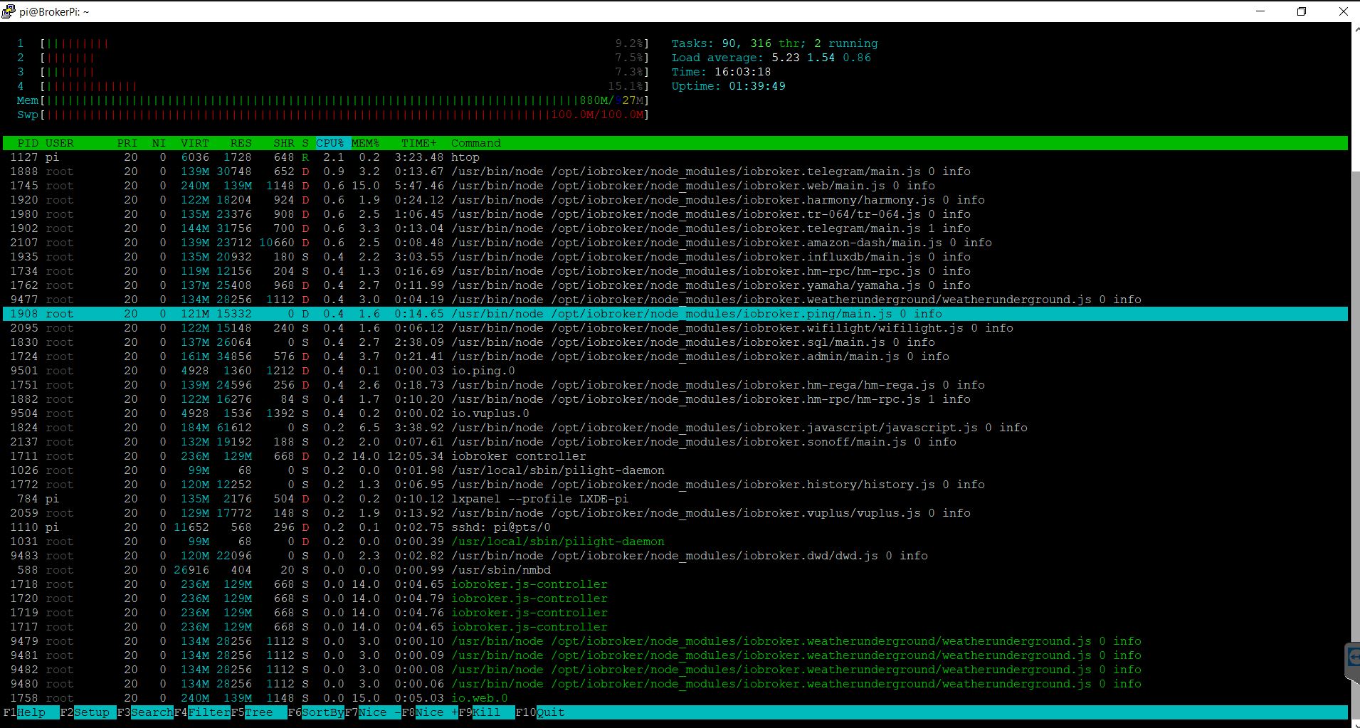

                so bin gerade etwas an der VIS am editieren und wieder der nächste hänger…
                In den Prozessen ist nix zu sehen, nur das der Load 1min bei 5,23 ist.
                der iobroker log zeigt zu der Zeit nur:
                ! 2018-04-03 16:00:07.757 - info: host.BrokerPi instance system.adapter.tankerkoenig.0 terminated with code 0 (OK) 2018-04-03 16:00:08.335 - info: host.BrokerPi instance system.adapter.weatherunderground.0 terminated with code 0 (OK) 2018-04-03 16:00:13.309 - info: host.BrokerPi instance system.adapter.ical.0 terminated with code 0 (OK) 2018-04-03 16:01:00.042 - info: host.BrokerPi instance system.adapter.weatherunderground.0 started with pid 9313 2018-04-03 16:01:02.258 - info: weatherunderground.0 starting. Version 1.1.2 in /opt/iobroker/node_modules/iobroker.weatherunderground, node: v6.12.2 2018-04-03 16:01:03.666 - info: tvspielfilm.0 force terminating adapter after 1 minute 2018-04-03 16:01:05.655 - info: host.BrokerPi instance system.adapter.tvspielfilm.0 terminated with code 0 (OK) 2018-04-03 16:01:06.025 - info: host.BrokerPi instance system.adapter.weatherunderground.0 terminated with code 0 (OK) 2018-04-03 16:01:17.417 - info: hm-rpc.1 xmlrpc <- listDevices ["hm-rpc.1"] 2018-04-03 16:01:17.456 - info: hm-rpc.1 xmlrpc -> 0 devices 2018-04-03 16:01:17.779 - info: hm-rpc.1 xmlrpc <- newDevices 9 2018-04-03 16:01:17.796 - info: hm-rpc.1 new HmIP devices/channels after filter: 0 2018-04-03 16:01:22.564 - warn: sonoff.0 Client "sonoff_LED_01" not connected 2018-04-03 16:01:25.120 - warn: sonoff.0 Client "sonoff_LED_01" not connected 2018-04-03 16:02:00.043 - info: host.BrokerPi instance system.adapter.weatherunderground.0 started with pid 9394 2018-04-03 16:02:02.244 - info: weatherunderground.0 starting. Version 1.1.2 in /opt/iobroker/node_modules/iobroker.weatherunderground, node: v6.12.2 2018-04-03 16:02:06.855 - info: host.BrokerPi instance system.adapter.weatherunderground.0 terminated with code 0 (OK) 2018-04-03 16:02:51.612 - info: web.0 2018-04-03T14:02:51.607Z Connected system.user.admin 2018-04-03 16:02:56.945 - info: web.0 2018-04-03T14:02:56.944Z Connected system.user.admin 2018-04-03 16:03:00.063 - info: host.BrokerPi instance system.adapter.weatherunderground.0 started with pid 9477 2018-04-03 16:03:00.112 - info: host.BrokerPi instance system.adapter.dwd.0 started with pid 9483 2018-04-03 16:03:03.271 - info: weatherunderground.0 starting. Version 1.1.2 in /opt/iobroker/node_modules/iobroker.weatherunderground, node: v6.12.2 !
                Komisch hier das sich um 16:02 zweimal der admin im web angemeldet hat.

                Nach 15min warten hat sich im Htop kurz mal was getan, der Pi lebt noch… Load bei >28
                ! filename="htop2.jpg" index="1">~~
                filename="htop3.jpg" index="0">~~

                • HomoranH Nicht stören
                  Deine Bilder sind leider irgendwo verschollen.
                  Kannst du bitte Top und nicht htop nehmen.
                  Das kannst du auch mit c&p in code-tags setzen.
                  Eins fällt mir sehr negativ auf:
                  Dein Swap ist komplett voll.
                  Ein RasPi mit SD-Karte sollte überhaupt nicht swappen, das bringt die Karte um.
                  und führt uns dahin, was ich vermute.
                  Evtl. ist die Karte zu langsam. daher hätte ich gerne die CPU usage.
                  sollten das die 1-4 oben links sein, siehst du, dass nicht die CPU ein Problem hat sondern die I/O Vorgänge.
                  Rainer

                    @Homoran:
                    Deine Bilder sind leider irgendwo verschollen. `
                    Komisch mit den Bildern… hatte alle 4 auf einmal hochgeladen und über "im Beitrag anzeigen" eingefügt. In der Vorschau war es noch ersichtlich.
                    Nächster Versuch läuft dann mit top
                    @Homoran:
                    Evtl. ist die Karte zu langsam. daher hätte ich gerne die CPU usage. `
                    Es ist eine class 10 Karte drin, also eigentlich nicht zu langsam.
                    Ist es besser den Swap zu deaktivieren?

                            Jetzt ist es mittlerweile so das der Pi sich weg hängt, sobald ich den Vis Editor aufmache.
                            Die Vis allein läuft ohne Probleme, es kommt nur beim Editor.
                            Ich werde es am Wochenende mal mit einer neuen SD Karte versuchen, nicht das die jetzige ne Macke hat.
                            Mfg
                            0018

                                Hier nochmal ein top beim load von 39, nachdem er kurzeit wieder aktiv war während der Absturzzeit.
                                top - 12:02:45 up 15:03,  5 users,  load average: 39,22, 42,72, 44,97
                                Tasks: 191 total,   2 running, 189 sleeping,   0 stopped,   0 zombie
                                %Cpu(s):  5,8 us,  9,5 sy,  0,0 ni,  0,4 id, 84,1 wa,  0,0 hi,  0,2 si,  0,0 st
                                KiB Mem :   949580 total,    27556 free,   894904 used,    27120 buff/cache
                                KiB Swap:        0 total,        0 free,        0 used.     9948 avail Mem
                                  PID USER      PR  NI    VIRT    RES    SHR S  %CPU %MEM     TIME+ COMMAND
                                 1056 root      20   0  291388 175524   2460 D  73,3 18,5  59:22.67 iobroker.js-con
                                27741 root      20   0   87176  18208   1040 D  34,0  1,9   0:02.13 node
                                27747 root      20   0   86768  18060   1216 D  33,1  1,9   0:02.21 node
                                27729 root      20   0   87880  21560   1740 D  30,4  2,3   0:02.50 node
                                27729 root      20   0   84580  30936  17008 R  29,7  3,3   0:01.51 node
                                27723 root      20   0   84400  30108  17568 S  29,4  3,2   0:01.66 node
                                27705 root      20   0   80444  29556  17496 S  29,1  3,1   0:01.58 node
                                27735 root      20   0   83508  28344  16760 D  29,1  3,0   0:01.26 node
                                27741 root      20   0   78264  27344  16784 D  28,8  2,9   0:01.02 node
                                 1436 root      20   0  223180  73260  60988 S   9,2  7,7   1:02.45 io.amazon-dash.
                                27481 root      20   0  143392  36252   9840 S   7,5  3,8   0:12.67 io.tr-064.0
                                27421 root      20   0  128844  34560  10220 R   6,9  3,6   0:07.94 io.hm-rpc.0
                                27363 root      20   0  144492  36744  10596 R   6,2  3,9   0:07.16 io.telegram.0
                                   40 root      20   0       0      0      0 S   5,6  0,0  87:20.90 kswapd0
                                27457 root      20   0  126368  26796  10028 S   5,2  2,8   0:05.15 io.hm-rpc.1
                                27439 root      20   0  123104  23864   9856 S   4,9  2,5   0:04.14 io.history.0
                                27662 root      20   0  164224  66888   9608 S   4,9  7,0   0:05.58 io.javascript.0
                                27364 root      20   0  145180  35848  10080 S   4,6  3,8   0:07.02 io.telegram.1
                                27469 root      20   0  143336  39552   8832 R   4,6  4,2   0:05.36 io.js2fs.0
                                27433 root      20   0  142132  34104  11160 S   4,2  3,6   0:07.16 io.yamaha.0
                                27463 root      20   0  120568  26272   9928 S   3,9  2,8   0:03.70 io.ping.0
                                   91 root      20   0       0      0      0 S   3,6  0,0   1:30.38 mmcqd/0
                                 1251 root      20   0  139328  32344   9800 R   3,6  3,4   3:14.54 io.harmony.0
                                27357 root      20   0  123956  25748   9772 S   3,6  2,7   0:04.20 io.wifilight.0
                                27045 pi        20   0    5956   2668   1556 S   3,3  0,3   0:11.09 htop
                                27595 root      20   0  164484  59304  10196 S   3,3  6,2   0:06.69 io.web.0
                                27487 root      20   0  123836  33672   9596 S   2,9  3,5   0:04.91 io.vuplus.0
                                27499 root      20   0  120944  27820  10080 S   2,9  2,9   0:03.93 io.mihome.0
                                27493 root      20   0  121704  26276   9720 S   2,6  2,8   0:03.84 io.squeezebox.0
                                25425 pi        20   0    8216   2092   1444 R   1,3  0,2   0:28.28 top
                                27592 root      20   0       0      0      0 S   1,0  0,0   0:05.09 kworker/0:0
                                    7 root      20   0       0      0      0 S   0,3  0,0   0:40.50 rcu_sched
                                   14 root      20   0       0      0      0 S   0,3  0,0   0:00.75 ksoftirqd/1
                                25477 pi        20   0   11668   2084   1304 S   0,3  0,2   0:01.00 sshd
                                25557 pi        20   0    3892    420    308 S   0,3  0,0   0:00.06 tail
                                27755 root      20   0    4928    644    532 S   0,3  0,1   0:00.01 ping
                                    1 root      20   0   27080   1360    196 S   0,0  0,1   0:06.23 systemd
                                    2 root      20   0       0      0      0 S   0,0  0,0   0:00.06 kthreadd
                                    3 root      20   0       0      0      0 S   0,0  0,0   0:04.98 ksoftirqd/0
                                    5 root       0 -20       0      0      0 S   0,0  0,0   0:00.00 kworker/0:0H
                                    8 root      20   0       0      0      0 S   0,0  0,0   0:00.00 rcu_bh
                                    9 root      rt   0       0      0      0 S   0,0  0,0   0:02.85 migration/0
                                Mfg
                                0018
                                  jetzt startet er alle Adapter neu,
                                  daher die ganzen "node" prozesse und die hohe CPU-Belastung durch den Controller.
                                  Umgekehrt gesagt: Die Instanzen laufen gerade nicht
                                  Rainer

                                    So neue SD Karte mit neustem Stretch installiert, ioroker nach Anleitung aufgespielt und restore durchgeführt.
                                    Jetzt habe ich ein ähnliches Phänomen wenn im im Vis Edtior bin.
                                    Jetzt ist allerdings der Prozess "kswapd0" der Übeltäter.
                                    Hier mein top:
                                    ! top - 13:01:53 up 1:01, 5 users, load average: 31,12, 11,40, 4,28 Tasks: 166 total, 2 running, 120 sleeping, 0 stopped, 2 zombie %Cpu(s): 0,1 us, 7,5 sy, 0,0 ni, 0,1 id, 92,3 wa, 0,0 hi, 0,1 si, 0,0 st KiB Mem : 949476 total, 35856 free, 882256 used, 31364 buff/cache KiB Swap: 0 total, 0 free, 0 used. 18028 avail Mem ! PID USER PR NI VIRT RES SHR S %CPU %MEM TIME+ COMMAND 44 root 20 0 0 0 0 R 19,1 0,0 0:25.96 kswapd0 68 root 20 0 0 0 0 S 2,8 0,0 0:05.57 mmcqd/0 4446 root 20 0 0 0 0 I 0,8 0,0 0:01.08 kworker/0:2 498 root 20 0 206420 88660 0 D 1,0 9,3 5:00.88 iobroker.js-con 848 root 20 0 140132 26776 2676 D 0,8 2,8 0:16.31 io.hm-rega.0 5337 root 20 0 4928 140 0 D 0,8 0,0 0:00.17 ping 3711 pi 20 0 8248 1520 924 R 0,7 0,2 0:18.66 top 838 root 20 0 223620 103600 0 D 0,7 10,9 1:02.30 io.web.0 1047 root 20 0 146856 30556 1968 D 0,7 3,2 0:10.99 io.telegram.1 1100 root 20 0 139184 23928 3084 D 0,7 2,5 1:42.32 io.influxdb.0 1239 root 20 0 141344 24144 11388 D 0,7 2,5 0:07.56 io.amazon-dash. 5317 root 20 0 84480 14180 464 D 0,7 1,5 0:01.54 node 5318 root 20 0 85756 14852 628 D 0,7 1,6 0:01.61 node 760 root 20 0 181548 70356 2440 D 0,6 7,4 0:19.53 io.admin.0 824 root 20 0 129880 21056 0 D 0,6 2,2 0:14.20 io.hm-rpc.0 1037 root 20 0 146860 31036 2260 D 0,6 3,3 0:11.29 io.telegram.0 1206 root 20 0 122152 16708 3644 D 0,6 1,8 0:05.71 io.mihome.0 5316 root 20 0 85484 15096 1456 D 0,6 1,6 0:01.60 node 854 root 20 0 138836 23692 2984 D 0,6 2,5 0:08.26 io.yamaha.0 1027 root 20 0 124312 16064 0 D 0,6 1,7 0:09.14 io.hm-rpc.1 1068 root 20 0 137404 23456 2708 D 0,6 2,5 0:18.83 io.harmony.0 1256 root 20 0 142516 25804 260 D 0,6 2,7 0:48.92 io.tr-064.0 949 root 20 0 185452 67624 1064 D 0,5 7,1 1:45.92 io.javascript.0 1057 root 20 0 123560 15240 584 D 0,5 1,6 0:12.19 io.ping.0 1217 root 20 0 125628 17456 2316 D 0,5 1,8 0:05.74 io.wifilight.0 997 root 20 0 122944 17840 2812 D 0,5 1,9 0:05.43 io.socketio.0 1119 root 20 0 136376 31084 3544 D 0,5 3,3 0:18.41 io.rpi2.0 1229 root 20 0 137292 21476 2276 D 0,5 2,3 0:06.96 io.sonoff.0 1267 root 20 0 134172 21916 2504 D 0,5 2,3 0:11.84 io.enigma2.0 5336 root 20 0 4928 292 152 D 0,5 0,0 0:00.19 ping !
                                    Kann mir jemand sagen was der Prozess macht und warum das so ist?`
                                    Mfg
                                    0018
                                      Ich vermute mal….
                                      du hast Raspbian full mit grafischer Oberfläche.
                                      der kswapd wird wohl von daher kommen und für das (absolut tödliche) Swappen verantwortlich sein.
                                      (lt. top ist aber keine Swap Partition vorhanden)
                                      Swappen verlangsamt das System erheblich und lässt die Load wegen der I/O Vorgänge ansteigen.
                                      Meine google Suche brachte das zum Vorschein:
                                      ~~@[url=https://askubuntu.com/questions/259739/kswapd0-is-taking-a-lot-of-cpu:~~
                                      ~~Google-Suche"]~~The process kswapd0 is the process than manages virtual memory. Your machine "should" have RAM, SWAP, and the EXT4 on your HDD/SSD. The ext4 is where everything is stored, and it is always slower to access from than RAM. RAM is like a half-way running space for programs to access information quickly. Most computers have at least 4GB of RAM, which under normal conditions is plenty. When playing a game, however, you may run low on RAM space, which is where SWAP comes in.
                                      SWAP is a fake RAM located on your HDD/SSD next to your EXT4. It is quicker to access than the EXT4, but it is much slower than actual RAM. When you run low on memory, kswapd0 moves programs that you are not using/not using as much as other programs to the SWAP, which causes extreme lag on those processes. If your game was needing 5GB RAM, 1GB at LEAST would be in SWAP. That means when it tries to access that information, it has to wait longer to get it. `
                                      Rainer
                                      • 0 Offline
                                        0 Offline
                                        0018
                                        @Homoran:
                                        du hast Raspbian full mit grafischer Oberfläche. `
                                        Jep, hab mit grafischer Oberfläche.
                                        Hast du eine Idee wie ich das Problem lösen kann?
                                        Das Problem müsste doch dann auch bei anderen Usern mit gleicher Konstellation auftauchen oder?
                                        Mfg
                                        0018
                                          @0018:
                                          Hast du eine Idee wie ich das Problem lösen kann? `
                                          nicht auf dem RasPi arbeiten, oder auf Raspbian light umsteigen ;-)
                                          Dein available RAM beträgt nur noch
                                          @0018:
                                          18028 avail Mem `
                                          18MB!!
                                          Rainer
