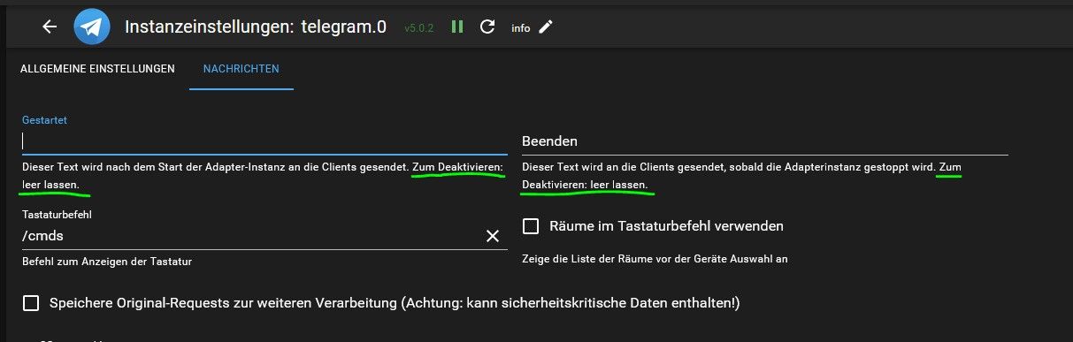

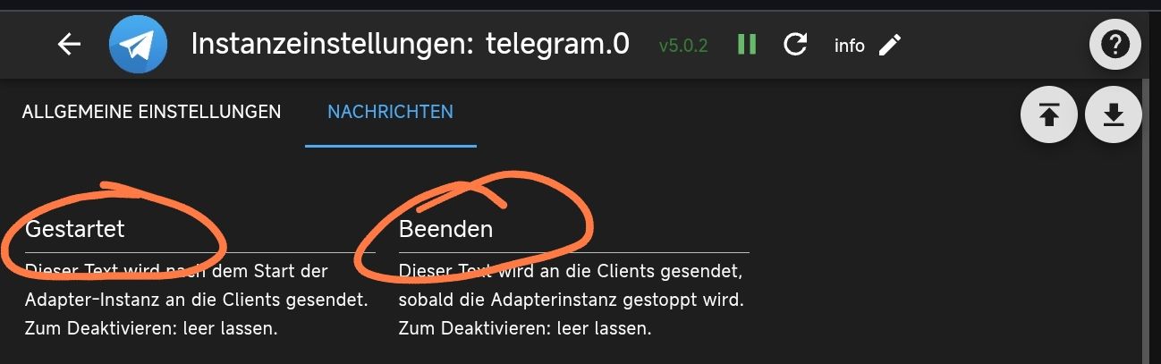

      Shadowhunter23
      Telegram ist das so eingestellt:
      Die Meldung bekommst du weg wenn du den Text in den Einstellungen löscht:

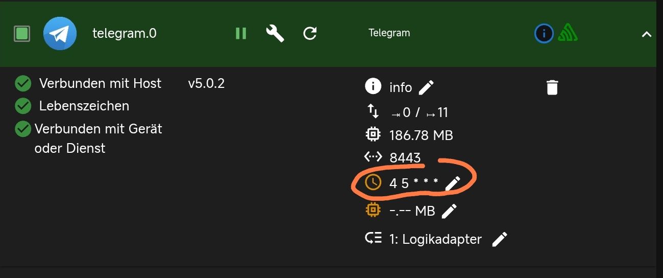

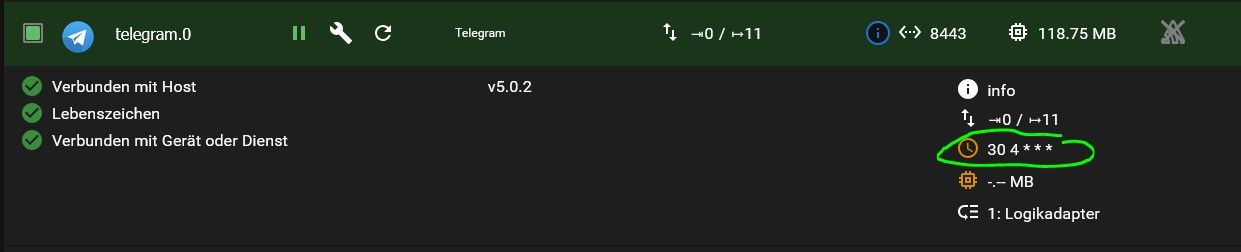

        ich dachte der IObroker wird neu gestartet.
        das heißt aber 5:04 wird nur der Telegram Adapter gestartet .

                  das scheint der normal restart von Telegram zu sein
                  2026-08-05 05:03:50.143  - info: tr-064.0 (129874) forEachConfiguredDevice: in GetSpecificHostEntry 20(MI8-sonoffDiy/D8:CE:3A:91:82:1B) device seems offline but we never saw it since adapter was started:Error: sendSOAPActionRequest Error action=GetSpecificHostEntry serviceType=urn:dslforum-org:service:Hosts:1: 500 - {"code":500}
                  2026-08-05 05:03:50.159  - warn: wled.0 (130368) Unable to initialise 192.168.178.88 will retry in scheduled interval !
                  2026-08-05 05:03:56.962  - debug: iot.0 (130102) [AlexaV3::DeviceManager]: ignoring state change event for sonoff.1.DVES_8D856C.POWER1 due to the same value [false]
                  2026-08-05 05:03:59.133  - warn: mihome-vacuum.0 (129645) State value to set for "mihome-vacuum.0.control.fan_power" has value "90" less than min "101"
                  2026-08-05 05:04:00.038  - info: telegram.0 (129368) Scheduled restart.
                  2026-08-05 05:04:00.562  - info: telegram.0 (129368) terminating
                  2026-08-05 05:04:00.568  - info: tr-064.0 (129874) forEachConfiguredDevice: in GetSpecificHostEntry 4(PC-Markus/2C:41:38:A9:DC:8E) device seems offline but we never saw it since adapter was started:Error: sendSOAPActionRequest Error action=GetSpecificHostEntry serviceType=urn:dslforum-org:service:Hosts:1: 500 - {"code":500}
                  2026-08-05 05:04:00.564  - info: telegram.0 (129368) terminating
                  2026-08-05 05:04:00.566  - info: telegram.0 (129368) Terminated (START_IMMEDIATELY_AFTER_STOP): Without reason
                  2026-08-05 05:04:00.688  - info: tr-064.0 (129874) forEachConfiguredDevice: in GetSpecificHostEntry 8(android-49158e2b037caa4b/A8:7C:01:A2:77:37) device seems offline but we never saw it since adapter was started:Error: sendSOAPActionRequest Error action=GetSpecificHostEntry serviceType=urn:dslforum-org:service:Hosts:1: 500 - {"code":500}
                  2026-08-05 05:04:00.719  - info: tr-064.0 (129874) forEachConfiguredDevice: in GetSpecificHostEntry 9(dlanwireless/F4:06:8D:22:EA:27) device seems offline but we never saw it since adapter was started:Error: sendSOAPActionRequest Error action=GetSpecificHostEntry serviceType=urn:dslforum-org:service:Hosts:1: 500 - {"code":500}
                  2026-08-05 05:04:00.962  - info: tr-064.0 (129874) forEachConfiguredDevice: in GetSpecificHostEntry 15(sonoff-1-5837/68:C6:3A:A3:36:CD) device seems offline but we never saw it since adapter was started:Error: sendSOAPActionRequest Error action=GetSpecificHostEntry serviceType=urn:dslforum-org:service:Hosts:1: 500 - {"code":500}
                  2026-08-05 05:04:01.056  - info: tr-064.0 (129874) forEachConfiguredDevice: in GetSpecificHostEntry 17(dlanwireless/BC:F2:AF:D2:50:77) device seems offline but we never saw it since adapter was started:Error: sendSOAPActionRequest Error action=GetSpecificHostEntry serviceType=urn:dslforum-org:service:Hosts:1: 500 - {"code":500}
                  2026-08-05 05:04:01.149  - info: tr-064.0 (129874) forEachConfiguredDevice: in GetSpecificHostEntry 20(MI8-sonoffDiy/D8:CE:3A:91:82:1B) device seems offline but we never saw it since adapter was started:Error: sendSOAPActionRequest Error action=GetSpecificHostEntry serviceType=urn:dslforum-org:service:Hosts:1: 500 - {"code":500}
                  2026-08-05 05:04:01.344  - info: host.RPI4 instance system.adapter.telegram.0 scheduled normal terminated and will be restarted on schedule.
                  2026-08-05 05:04:01.345  - info: host.RPI4 Restart adapter system.adapter.telegram.0 because enabled
                  2026-08-05 05:04:03.765  - info: host.RPI4 instance system.adapter.telegram.0 in version "4.1.0" started with pid 161193
                  2026-08-05 05:04:03.864  - debug: iot.0 (130102) [AlexaV3::DeviceManager]: ignoring state change event for sonoff.1.DVES_DD84B5.POWER1 due to the same value [false]
                  2026-08-05 05:04:03.867  - debug: iot.0 (130102) [AlexaV3::DeviceManager]: ignoring state change event for sonoff.1.DVES_DD84B5.POWER2 due to the same value [false]
                  2026-08-05 05:04:05.014  - debug: iot.0 (130102) [AlexaV3::DeviceManager]: ignoring state change event for sonoff.1.DVES_9E3476.POWER due to the same value [false]
                  2026-08-05 05:04:10.811  - info: telegram.0 (161193) starting. Version 4.1.0 in /opt/iobroker/node_modules/iobroker.telegram, node: v22.23.1, js-controller: 7.2.2

                      Ich würde den telegram-Neustart ausschalten und hier das Ergebnis von iob diag in </> codetags einstellen.

                                Ich würde den Cron bei Telegram lassen und nur die Meldung ausschalten. Mache ich seit Jahren so.
