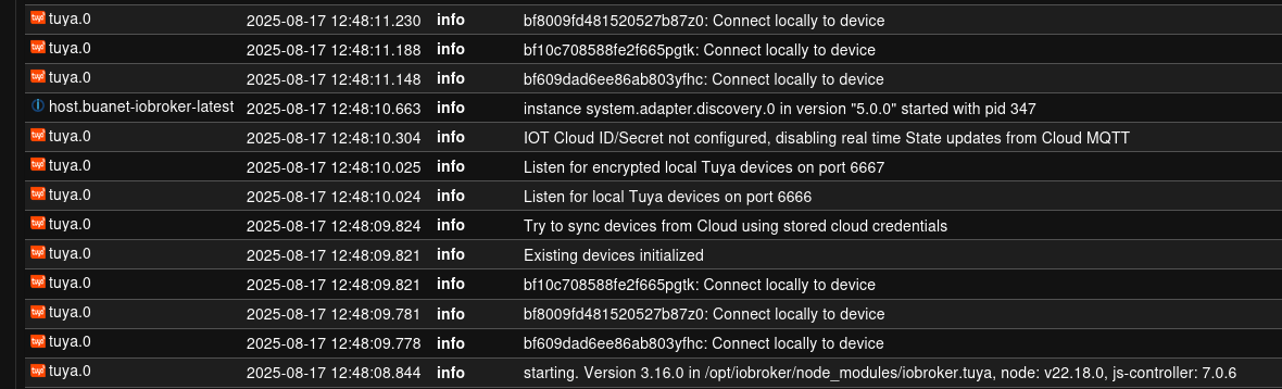

    Der installierte Tuya Adapter zeigt folgendes:
    danach ein Login zum Cloud geht jetzt erstmalig:
    Dbug Log:
    tuya.0
    	2025-08-15 17:47:41.337	info	bf10c708588fe2f665pgtk: Connect locally to device
    tuya.0
    	2025-08-15 17:47:41.294	info	bf8009fd481520527b87z0: Connect locally to device
    tuya.0
    	2025-08-15 17:47:40.384	info	bf609dad6ee86ab803yfhc: Connect locally to device
    tuya.0
    	2025-08-15 17:47:39.965	info	IOT Cloud ID/Secret not configured, disabling real time State updates from Cloud MQTT
    tuya.0
    	2025-08-15 17:47:39.739	info	Listen for encrypted local Tuya devices on port 6667
    tuya.0
    	2025-08-15 17:47:39.738	info	Listen for local Tuya devices on port 6666
    tuya.0
    	2025-08-15 17:47:39.532	info	Try to sync devices from Cloud using stored cloud credentials
    tuya.0
    	2025-08-15 17:47:39.529	info	Existing devices initialized
    tuya.0
    	2025-08-15 17:47:39.528	info	bf609dad6ee86ab803yfhc: Connect locally to device
    tuya.0
    	2025-08-15 17:47:39.527	info	bf10c708588fe2f665pgtk: Connect locally to device
    tuya.0
    	2025-08-15 17:47:39.487	info	bf8009fd481520527b87z0: Connect locally to device
    tuya.0
    	2025-08-15 17:47:38.552	info	starting. Version 3.16.0 in /opt/iobroker/node_modules/iobroker.tuya, node: v22.18.0, js-controller: 7.0.6
    host.buanet-iobroker
    	2025-08-15 17:47:36.414	info	instance system.adapter.tuya.0 in version "3.16.0" started with pid 11037
    	2025-08-15 17:47:28.621	info	instance system.adapter.tuya.0 terminated with code 11 (ADAPTER_REQUESTED_TERMINATION)
    tuya.0
    	2025-08-15 17:47:28.080	info	Terminated (ADAPTER_REQUESTED_TERMINATION): Without reason
    tuya.0
    	2025-08-15 17:47:28.079	info	terminating
    	2025-08-15 17:47:25.114	info	stopInstance system.adapter.tuya.0 send kill signal
    tuya.0
    	2025-08-15 17:47:25.076	info	Got terminate signal TERMINATE_YOURSELF
    	2025-08-15 17:47:25.073	info	stopInstance system.adapter.tuya.0 (force=false, process=true)
    tuya.0
    	2025-08-15 17:47:25.064	info	Set data for tuya.0 to appDeviceId=hwihbsdshylho8a4qt0dtjhfvi555113rux8psesml61 / sid=eu175033N2830543eq4dzkm3ddf409efd1973b2032d1820836b12d0b. Restart adapter now!
    tuya.0
    	2025-08-15 17:47:25.064	info	Cloud login successful. Adapter restarts in 5s
    tuya.0
    	2025-08-15 17:47:22.142	info	Listen for encrypted local Tuya devices on port 6667
    tuya.0
    	2025-08-15 17:47:22.141	info	Listen for local Tuya devices on port 6666
    tuya.0
    	2025-08-15 17:47:21.942	info	Try to sync devices from Cloud using stored cloud credentials
    tuya.0
    	2025-08-15 17:47:21.939	info	Existing devices initialized
    tuya.0
    	2025-08-15 17:47:21.938	info	bf609dad6ee86ab803yfhc: Connect locally to device
    tuya.0
    	2025-08-15 17:47:21.933	info	bf10c708588fe2f665pgtk: Connect locally to device
    tuya.0
    	2025-08-15 17:47:21.888	info	bf8009fd481520527b87z0: Connect locally to device
    tuya.0
    	2025-08-15 17:47:21.013	info	starting. Version 3.16.0 in /opt/iobroker/node_modules/iobroker.tuya, node: v22.18.0, js-controller: 7.0.6

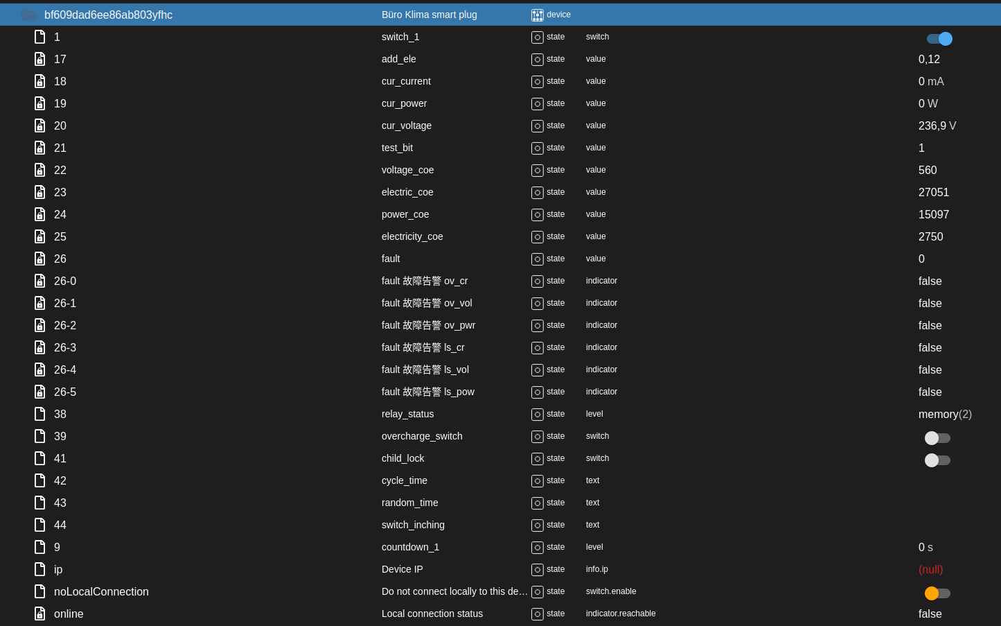

    die Daten werden im Objekt-bereich angezeigt:

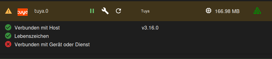

    Frage:
    wie bekomm ich verbunden mit Gerät auf Grün, wenn doch Objekte angezeigt werden und lokal alles Verbunden ist?
    Was mach ich falsch??

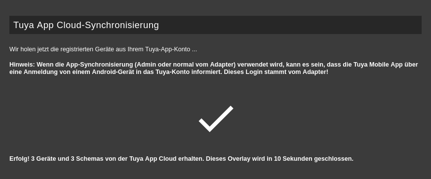

          @catshape
          Danke für die Antwort
          hab ich gemacht, mit Erfolg, aber keine Wirkung auf die Instanz!

            @fs1567
            Dürfte damit zusammen hängen:

            Hallo Thomas, das ist auch meine Befürchtung, aber
            • wo
            • wie
            kann ich den IOT Coud ITSecret "configurieren"
            Die Smart Live App zeigt mir die Geräte an und ich kann sie damit bedienen
            Die Zugangsdaten hab ich im Tya Adapter eingegeben und er ruft die Daten auch von dort ab.
            Also was ist das?
            Habe gestern nochmals den Adapter deinstalliert und neu installiert, gleicher Fehler wieder.
            Bin für jede Hilfe dankbar

                Also ich habe aktuell installiert (zur Probe) bevor ich alles anschließe:
                1. Wi-Fi IR + FR Remote Controller 1 x
                2. Tuya Smart Plug WiFi Steckdose 16A mit Power Messung 1 x
                weitere 6 liegen hier zum Anschließen wenn es denn geht.
                so hier die Objekt-Daten des smartPlugin Netzsteckers:
                Local connect flase ist richtig, da ich die Ports im Docker nicht freigegeben habe. --> hilft das?
                Zeigt er mir dehalb keine IP-Adresse an?
                • F FS1567
