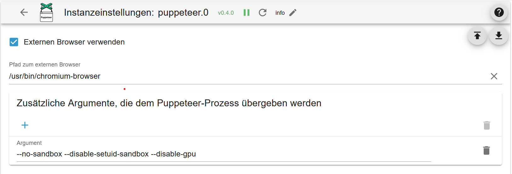

    • Adaptername: Puppeteer
    • Link zu Adapterrepository: www.github.com...
    • Adapterversion: 0.4.0
    • js-controller Version: 7.0.6
    • Admin Version: 7.6.17
    • Hardwaresystem: Pi4
    • Arbeitsspeicher: 8 GB
    • Festplattenart: SD-Karte
    • Betriebssystem: Bullseye
    • Nodejs-Version: 20.19.3
    • NPM-Version: 10.8.2
    • Installationsart: Manuell
    • Image, Docker genutzt: Nein

    Fehler:
    $ iobroker add puppeteer auto --host iobrokerpi4b --debug
    NPM version: 10.8.2
    Installing iobroker.puppeteer@0.4.0... (System call)
    > puppeteer@23.11.1 postinstall> node install.mjs
    **INFO** Skipping Firefox download as instructed.
    Error: ERROR: Failed to set up chrome-headless-shell v131.0.6778.204! Set "PUPPETEER_SKIP_DOWNLOAD" env variable to skip download. at downloadBrowser (file:///opt/iobroker/node_modules/puppeteer/lib/esm/puppeteer/node/install.js:26:15) at process.processTicksAndRejections (node:internal/process/task_queues:95:5) at async Promise.all (index 1)
    at async downloadBrowsers (file:///opt/iobroker/node_modules/puppeteer/lib/esm/puppeteer/node/install.js:84:9) { [cause]: Error: Client network socket disconnected before secure TLS connection was established at TLSSocket.onConnectEnd (node:_tls_wrap:1730:19) at TLSSocket.emit (node:events:536:35) at endReadableNT (node:internal/streams/readable:1698:12) at process.processTicksAndRejections (node:internal/process/task_queues:82:21) { code: 'ECONNRESET', path: null, host: 'storage.googleapis.com', port: 443, localAddress: undefined }}
    npm error code 1npm error path /opt/iobroker/node_modules/puppeteernpm error command failednpm error command sh -c node install.mjs
    npm error A complete log of this run can be found in: /home/iobroker/.npm/_logs/2025-07-14T07_01_00_877Z-debug-0.log
    Error: ERROR: Failed to set up chrome-headless-shell v131.0.6778.204! Set "PUPPETEER_SKIP_DOWNLOAD" env variable to skip download. at downloadBrowser (file:///opt/iobroker/node_modules/puppeteer/lib/esm/puppeteer/node/install.js:26:15) at process.processTicksAndRejections (node:internal/process/task_queues:95:5) at async Promise.all (index 1) at async downloadBrowsers (file:///opt/iobroker/node_modules/puppeteer/lib/esm/puppeteer/node/install.js:84:9) { [cause]: Error: Client network socket disconnected before secure TLS connection was established at TLSSocket.onConnectEnd (node:_tls_wrap:1730:19) at TLSSocket.emit (node:events:536:35) at endReadableNT (node:internal/streams/readable:1698:12) at process.processTicksAndRejections (node:internal/process/task_queues:82:21) { code: 'ECONNRESET', path: null, host: 'storage.googleapis.com', port: 443, localAddress: undefined }}npm error code 1npm error path /opt/iobroker/node_modules/puppeteernpm error command failednpm error command sh -c node install.mjsnpm error A complete log of this run can be found in: /home/iobroker/.npm/_logs/2025-07-14T07_01_00_877Z-debug-0.log
    host.iobrokerpi4b Cannot install iobroker.puppeteer@0.4.0: 1
    ERROR: Process exited with code 25

        So, einen kleinen Schritt bin ich jetzt weiter:
        Die bisherigen Fehler wurden offensichtlich durch lokale DNS Blockregeln verursacht, die lustigerweise nicht verhinderten, dass vorher
        sudo apt install chromium-browser -y
        problemfrei durchlief, aber bei der Adapterinstallation für Probleme sorgen.
        Jetzt habe ich den Adapter erfolgreich installiert.
        Er läuft aber nicht:
        puppeteer.0
        	2025-07-14 09:25:57.534	info	terminating
        puppeteer.0
        	2025-07-14 09:25:57.031	warn	Terminated (UNCAUGHT_EXCEPTION): Without reason
        puppeteer.0
        	2025-07-14 09:25:57.030	info	terminating
        puppeteer.0
        	2025-07-14 09:25:57.015	error	Failed to launch the browser process! undefinedTROUBLESHOOTING: https://pptr.dev/troubleshooting
        puppeteer.0
        	2025-07-14 09:25:57.014	error	Error: Failed to launch the browser process! undefinedTROUBLESHOOTING: https://pptr.dev/troubleshooting at ChildProcess.onClose (/opt/iobroker/node_modules/@puppeteer/browsers/lib/cjs/launch.js:314:24) at ChildProcess.emit (node:events:536:35) at ChildProcess._handle.onexit (node:internal/child_process:293:12)
        puppeteer.0
        	2025-07-14 09:25:57.012	error	unhandled promise rejection: Failed to launch the browser process! undefinedTROUBLESHOOTING: https://pptr.dev/troubleshooting
        puppeteer.0
        	2025-07-14 09:25:57.011	error	Unhandled promise rejection. This error originated either by throwing inside of an async function without a catch block, or by rejecting a promise which was not handled with .catch().
        BertDerKleineB 1 Antwort Letzte Antwort
        • BertDerKleineB BertDerKleine
          puppeteer.0
          puppeteer.0
          puppeteer.0
          puppeteer.0
          puppeteer.0
          puppeteer.0
          puppeteer.0
          BertDerKleineB Offline
          BertDerKleine
          @bertderkleine
          Kleine Doku meiner Tests mit KI Hilfe:
          Ich habe ein Testskript erstellt:
          const puppeteer = require('puppeteer-core');
          (async () => {
              try {
                  const browser = await puppeteer.launch({
                      executablePath: '/usr/bin/chromium-browser',
                      headless: true,
                      args: ['--no-sandbox', '--disable-setuid-sandbox', '--disable-gpu']
                  const page = await browser.newPage();
                  await page.goto('https://example.com');
                  await page.screenshot({ path: 'example.png' });
                  await browser.close();
                  console.log('Erfolg!');
              } catch (error) {
                  console.error('Fehler:', error);
          Auf der Kommandozeile läuft das prima:
          $ sudo -u iobroker node test-puppeteer.js
          Erfolg!
          und
          $ node test-puppeteer.js
          Erfolg!
          Die KI meint dazu:
          Das Testskript lief sowohl als normaler Benutzer als auch als ioBroker-Benutzer erfolgreich, was bestätigt, dass:
              puppeteer-core@23.11.1 funktioniert.
              Chromium 126.0.6478.164 mit den Argumenten --no-sandbox, --disable-setuid-sandbox, --disable-gpu korrekt startet.
              Der ioBroker-Benutzer die notwendigen Berechtigungen hat.
              Alle erforderlichen Abhängigkeiten installiert sind.
          Hm. Zwischenzeitlich hat mich die KI mal eine Datei README löschen lassen
          sudo rm /etc/chromium.d/README
          Ich denke nicht, dass das wichtig war, aber hier zur Doku
          Den Test hier
          $ chromium-browser --headless --no-sandbox --disable-gpu
          [0714/095037.307664:WARNING:bluez_dbus_manager.cc(248)] Floss manager not present, cannot set Floss enable/disable.
          [0714/095037.390598:WARNING:sandbox_linux.cc(430)] InitializeSandbox() called with multiple threads in process gpu-process.
          hat die KI dann als harmlos/ok Reaktion bezeichnet.
          Und Tada (!) jetzt habe ich auch eine Lösung und der Adapter läuft grün, indem in der Adapter-Konfig die folgenden Eintragungen gemacht werden:
          Essentiell war die manuelle Eintragung des Pfads oben.
          431
