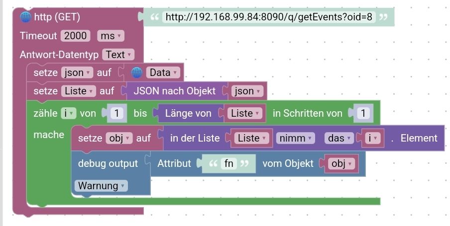

    Irgendwie stolpere ich da immer wieder.
    Wo liegt hier der Fehler?
    Hab ich so aus einem anderen Script übernommen.
    {"events": [{"ot":2,"oid":9,"c":"638778950807040749","ma":100,"d":21,"dd":21,"fn":"9_2025-03-18_12-44-42_389.mkv","sb":10543150,"tl":0,"tg":"detected,zone 1","w":0,"ca":0,"ai":0,"l":0,"ar":0},{"ot":2,"oid":9,"c":"638778950554531788","ma":100,"d":25,"dd":25,"fn":"9_2025-03-18_12-44-17_179.mkv","sb":14280878,"tl":0,"tg":"detected,zone 1","w":0,"ca":0,"ai":0,"l":0,"ar":0},{"ot":2,"oid":9,"c":"638778950175200147","ma":100,"d":25,"dd":25,"fn":"9_2025-03-18_12-43-39_362.mkv","sb":12984240,"tl":0,"tg":"detected,zone 1","w":0,"ca":0,"ai":0,"l":0,"ar":0},{"ot":2,"oid":9,"c":"638778949760923648","ma":100,"d":36,"dd":36,"fn":"9_2025-03-18_12-42-57_944.mkv","sb":19810222,"tl":0,"tg":"detected,zone 1","w":0,"ca":0,"ai":0,"l":0,"ar":0},{"ot":2,"oid":8,"c":"638778936481628701","ma":100,"d":26,"dd":26,"fn":"8_2025-03-18_12-20-49_023.mkv","sb":29034975,"tl":0,"tg":"detected,vehicle","w":0,"ca":0,"ai":0,"l":0,"ar":0},.............

      @david-g sagte: Wo liegt hier der Fehler?
      Die Liste steckt im Attribut "events".

        Danke,
        sowas in der Art hatte ich vermutet. Aber dann mit events.fn bei meinem Debug probiert.
        Vielen Dank
