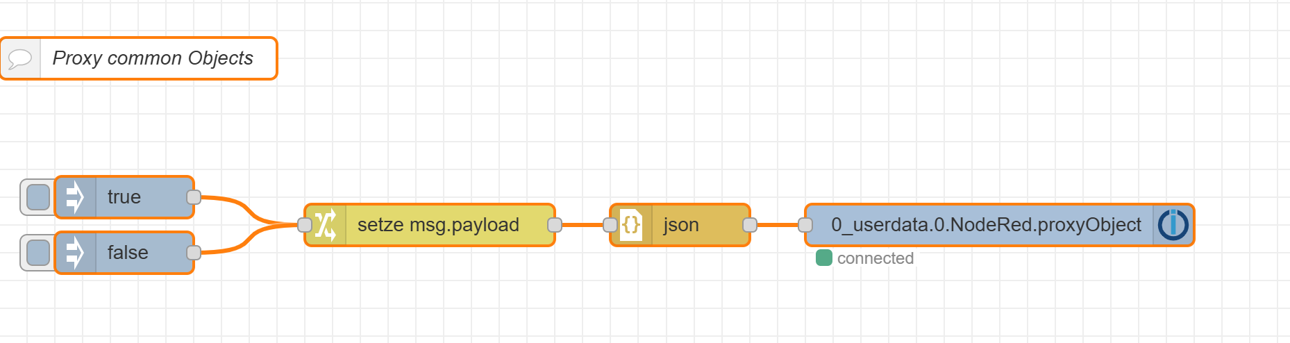

        Mit einer Proxy JS Funktion kannst du es machen.
        Ist zwar nicht sauber - das so zu machen - da das nicht dafür vorgesehen ist, aber generell kann man so die Funktionen, die im NodeRed fehlen - bauen.
        Hier mit dieser JS Funktion - die muss halt immer laufen, kannst Du die common Attribute eines Objektes aus NodeRed setzen:

        Hier der Flow:
               "id": "4da11d17effa7e54",
               "type": "ioBroker out",
               "z": "30f50cdc81f34302",
               "name": "",
               "topic": "0_userdata.0.NodeRed.proxyObject",
               "ack": "false",
               "autoCreate": "false",
               "stateName": "",
               "role": "",
               "payloadType": "",
               "readonly": "",
               "stateUnit": "",
               "stateMin": "",
               "stateMax": "",
               "x": 760,
               "y": 1120,
               "wires": []
               "id": "4e2a780a5a12b469",
               "type": "json",
               "name": "",
               "property": "payload",
               "action": "",
               "pretty": false,
               "x": 530,
               "y": 1120,
               "wires": [
                       "4da11d17effa7e54"
               "id": "0a117e4cad8bcc84",
               "type": "change",
               "name": "",
               "rules": [
                       "t": "set",
                       "p": "payload",
                       "pt": "msg",
                       "to": "{\t   \"id\":\"0_userdata.0.Test.aktiv\",\t   \"common\":\"write\",\t   \"val\":payload\t}",
                       "tot": "jsonata"
               "action": "",
               "property": "",
               "from": "",
               "to": "",
               "reg": false,
               "x": 350,
               "y": 1120,
               "wires": [
                       "4e2a780a5a12b469"
               "id": "d2f01982a440ddd2",
               "type": "inject",
               "name": "",
               "props": [
                       "p": "payload"
               "repeat": "",
               "crontab": "",
               "once": false,
               "onceDelay": 0.1,
               "topic": "",
               "payload": "true",
               "payloadType": "bool",
               "x": 130,
               "y": 1100,
               "wires": [
                       "0a117e4cad8bcc84"
               "id": "5efe0322a667deee",
               "type": "inject",
               "name": "",
               "props": [
                       "p": "payload"
               "repeat": "",
               "crontab": "",
               "once": false,
               "onceDelay": 0.1,
               "topic": "",
               "payload": "false",
               "x": 130,
               "y": 1140,
               "wires": [
                       "0a117e4cad8bcc84"
               "id": "a4ecf857b1fd5dcf",
               "type": "comment",
               "name": "Proxy common Objects",
               "info": "",
               "x": 140,
               "y": 1000,
               "wires": []
        S 1 Antwort Letzte Antwort
