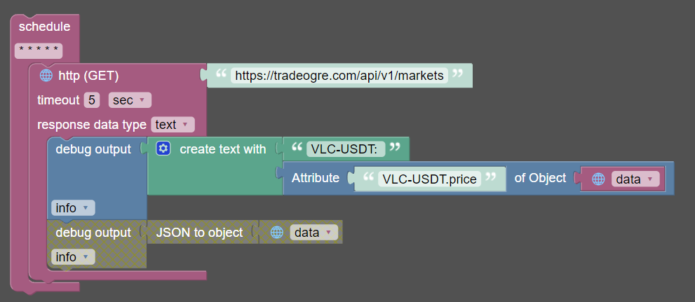

    Servus zusammen,
    ich hab hier nen kleines Problem.
    Versucht wird die API von TradeOgre abzufragen, damit Crypto Werte angezeigt werden können mit folgender URL:
    -> https://tradeogre.com/api/v1/markets
    Mein Blocky Script zeigt mir aber nicht den Wert an, welchen ich suche:
    dabei bekomme ich folgenden output, wenn ich das gesamte ausgeben lassen:
    	javascript.0 (1047) script.js.00-Automation.99-CryptoStats: VLC-USDT: [{"AAVE-USDT":{"initialprice":"99.00000001","price":"99.00000001","high":"99.00000001","low":"99.00000001","volume":"0.00000000","bid":"100.00000002","ask":"166.79999998","basename":"Aave"}},{"ACM-BTC":{"initialprice":"0.00000002","price":"0.00000002","high":"0.00000002","low":"0.00000002","volume":"0.00022074","bid":"0.00000002","ask":"0.00000003","basename":"Actinium"}},{"ADA-BTC":{"initialprice":"0.00000920","price":"0.00000929","high":"0.00000963","low":"0.00000920","volume":"0.04666426","bid":"0.00000929","ask":"0.00000942","basename":"Cardano"}},{"AEON-BTC":{"initialprice":"0.00000177","price":"0.00000177","high":"0.00000179","low":"0.00000177","volume":"0.00000000","bid":"0.00000177","ask":"0.00000180","basename":"Aeon"}},{"AIPG-USDT":{"initialprice":"0.15380000","price":"0.13866242","high":"0.15380000","low":"0.13200000","volume":"10500.49834826","bid":"0.13499000","ask":"0.13866094","basename":"AI Power Grid"}},{"ALPH-BTC":{"initialprice":"0.00003788","price":"0.00003726","high":"0.00003953","low":"0.00003726","volume":"0.04458112","bid":"0.00003725","ask":"0.00003798","basename":"Alephium"}},{"ALPH-USDT":{"initialprice":"2.73212298","price":"2.58000000","high":"2.77999999","low":"2.58000000","volume":"17077.72231254","bid":"2.57071566","ask":"2.59000000","basename":"Alephium"}},{"ANDR-USDT":{"initialprice":"1.07410702","price":"1.17000000","high":"1.17000000","low":"1.07410702","volume":"912.16176942","bid":"1.08000000","ask":"1.17000000","basename":"Andromeda"}},{"APE-USDT":{"initialprice":"2.54999997","price":"2.54999997","high":"2.54999997","low":"2.54999997","volume":"0.00000000","bid":"1.49000001","ask":"2.49999999","basename":"ApeCoin"}},{"ARQ-BTC":{"initialprice":"0.00000010","price":"0.00000011","high":"0.00000011","low":"0.00000010","volume":"0.00060573","bid":"0.00000010","ask":"0.00000011","basename":"ArQmA"}},{"ARRR-BTC":{"initialprice":"0.00000261","price":"0.00000245","high":"0.00000262","low":"0.00000240","volume":"0.08991008","bid":"0.00000241","ask":"0.00000244","basename":"Pirate"}},{"ARRR-USDT":{"initialprice":"0.17926533","price":"0.17396565","high":"0.18355965","low":"0.16981505","volume":"4178.55864563","bid":"0.16981606","ask":"0.17611187","basename":"Pirate"}},{"ATOM-USDT":{"initialprice":"13.09939793","price":"13.08279627","high":"13.09939793","low":"11.80000002","volume":"151.60794345","bid":"11.81000001","ask":"13.07469547","basename":"Cosmos Hub"}},{"AVAX-USDT":{"initialprice":"53.59700056","price":"51.10000279","high":"56.98999993","low":"49.82482730","volume":"1202.48569078","bid":"51.10000385","ask":"56.98999992","basename":"Avalanche"}},{"AVN-BTC":{"initialprice":"0.00000001","price":"0.00000001","high":"0.00000001","low":"0.00000001","volume":"0.00000000","bid":"0.00000000","ask":"0.00000001","basename":"Avian"}},{"AVN-LTC":{"initialprice":"0.00000085","price":"0.00000081","high":"0.00000085","low":"0.00000080","volume":"1.04168398","bid":"0.00000081","ask":"0.00000094","basename":"Avian"}},{"AVN-USDT":{"initialprice":"0.00009300","price":"0.00007124","high":"0.00009964","low":"0.00007124","volume":"653.56869015","bid":"0.00007362","ask":"0.00008401","basename":"Avian"}},{"BBS-BTC":{"initialprice":"0.00000001","price":"0.00000001","high":"0.00000001","low":"0.00000001","volume":"0.00000000","bid":"0.00000000","ask":"0.00000001","basename":"BBSCoin"}},{"BBS-LTC":{"initialprice":"0.00000001","price":"0.00000001","high":"0.00000001","low":"0.00000001","volume":"0.00000000","bid":"0.00000000","ask":"0.00000001","basename":"BBSCoin"}},{"BCH-BTC":{"initialprice":"0.00872995","price":"0.00832997","high":"0.00872998","low":"0.00832997","volume":"0.01667386","bid":"0.00822991","ask":"0.00872982","basename":"Bitcoin Cash"}},{"BCN-BTC":{"initialprice":"0.00000001","price":"0.00000001","high":"0.00000001","low":"0.00000001","volume":"0.00000000","bid":"0.00000000","ask":"0.00000001","basename":"Bytecoin"}},{"BCN-LTC":{"initialprice":"0.00000036","price":"0.00000032","high":"0.00000041","low":"0.00000032","volume":"1.38500259","bid":"0.00000033","ask":"0.00000038","basename":"Bytecoin"}},{"BEAM-BTC":{"initialprice":"0.00000138","price":"0.00000141","high":"0.00000144","low":"0.00000138","volume":"0.00284704","bid":"0.00000141","ask":"0.00000145","basename":"Beam"}},{"BEAM-USDT":{"initialprice":"0.09200004","price":"0.09100020","high":"0.09200004","low":"0.09000001","volume":"28.28728360","bid":"0.09100020","ask":"0.11699800","basename":"Beam"}},{"BGA-USDT":{"initialprice":"0.00010000","price":"0.00010001","high":"0.00024582","low":"0.00008000","volume":"46006.67978690","bid":"0.00010001","ask":"0.00010099","basename":"Bugna"}},{"BITC-BTC":{"initialprice":"0.00000001","price":"0.00000001","high":"0.00000001","low":"0.00000001","volume":"0.00000000","bid":"0.00000001","ask":"0.00000002","basename":"BitCash"}},{"BKC-BTC":{"initialprice":"0.00000001","price":"0.00000001","high":"0.00000001","low":"0.00000001","volume":"0.00000000","bid":"0.00000000","ask":"0.00000001","basename":"Balkancoin"}},{"BKC-LTC":{"initialprice":"0.00000025","price":"0.00000025","high":"0.00000025","low":"0.00000025","volume":"0.00000000","bid":"0.00000018","ask":"0.00000029","basename":"Balkancoin"}},{"BLKC-BTC":{"initialprice":"0.00000056","price":"0.00000052","high":"0.00000059","low":"0.00000052","volume":"0.00230098","bid":"0.00000049","ask":"0.00000054","basename":"BlackHat Coin"}},{"BLOC-BTC":{"initialprice":"0.00000002","price":"0.00000002","high":"0.00000002","low":"0.00000002","volume":"0.00064165","bid":"0.00000002","ask":"0.00000003","basename":"BLOC.money"}},{"BLOCX-USDT":{"initialprice":"0.14212826","price":"0.14636072","high":"0.15638142","low":"0.13634001","volume":"1872.75626839","bid":"0.14214325","ask":"0.14855577","basename":"BLOCX."}},{"BNB-USDT":{"initialprice":"621.01954868","price":"624.79170528","high":"634.05560704","low":"597.00000002","volume":"9731.52852980","bid":"611.49858257","ask":"624.32311149","basename":"BNB"}},{"BSV-BTC":{"initialprice":"0.00141532","price":"0.00147308","high":"0.00147308","low":"0.00127897","volume":"0.01015925","bid":"0.00131672","ask":"0.00143371","basename":"Bitcoin SV"}},{"BTC-USDT":{"initialprice":"69799.99999645","price":"70000.00000000","high":"70659.98999967","low":"69350.00000040","volume":"119886.30596755","bid":"69800.99999999","ask":"70000.00000000","basename":"Bitcoin"}},{"BTCP-BTC":{"initialprice":"0.00001100","price":"0.00001100","high":"0.00001228","low":"0.00001100","volume":"0.00000000","bid":"0.00001200","ask":"0.00001600","basename":"Bitcoin Private"}},{"BTCZ-LTC":{"initialprice":"0.00000101","price":"0.00000095","high":"0.00000104","low":"0.00000095","volume":"1.25328973","bid":"0.00000094","ask":"0.00000095","basename":"BitcoinZ"}},{"BTRM-LTC":{"initialprice":"0.00000016","price":"0.00000015","high":"0.00000016","low":"0.00000015","volume":"0.14673011","bid":"0.00000015","ask":"0.00000016","basename":"Bitoreum"}},{"CAS-USDT":{"initialprice":"0.01000000","price":"0.01800000","high":"0.02394900","low":"0.00760000","volume":"46371.67263608","bid":"0.01800000","ask":"0.01897150","basename":"Kaspa Classic"}},{"CASH-BTC":{"initialprice":"0.00000001","price":"0.00000001","high":"0.00000001","low":"0.00000001","volume":"0.00000000","bid":"0.00000000","ask":"0.00000001","basename":"Litecash"}},{"CASH-LTC":{"initialprice":"0.00000184","price":"0.00000180","high":"0.00000184","low":"0.00000180","volume":"0.37792774","bid":"0.00000180","ask":"0.00000240","basename":"Litecash"}},{"CATE-USDT":{"initialprice":"0.00000052","price":"0.00000057","high":"0.00000057","low":"0.00000052","volume":"44.05116454","bid":"0.00000054","ask":"0.00000057","basename":"CateCoin"}},{"CAU-USDT":{"initialprice":"14.99999999","price":"11.50000000","high":"20.10000000","low":"10.32000000","volume":"405.81675141","bid":"11.50000000","ask":"19.96999980","basename":"Canxium"}},{"CCX-BTC":{"initialprice":"0.00000054","price":"0.00000051","high":"0.00000055","low":"0.00000051","volume":"0.00637120","bid":"0.00000051","ask":"0.00000053","basename":"Conceal"}},{"CCX-USDT":{"initialprice":"0.03851976","price":"0.03845400","high":"0.03851976","low":"0.03645359","volume":"193.64555774","bid":"0.03600001","ask":"0.03845385","basename":"Conceal"}},{"CIV-BTC":{"initialprice":"0.00000004","price":"0.00000004","high":"0.00000004","low":"0.00000004","volume":"0.00000000","bid":"0.00000002","ask":"0.00000004","basename":"Civitas"}},{"CLOAK-BTC":{"initialprice":"0.00000106","price":"0.00000106","high":"0.00000106","low":"0.00000106","volume":"0.00005024","bid":"0.00000098","ask":"0.00000140","basename":"CloakCoin"}},{"CLORE-USDT":{"initialprice":"0.29985000","price":"0.29000000","high":"0.30000000","low":"0.27658422","volume":"6247.81910174","bid":"0.28434706","ask":"0.29000000","basename":"Clore.ai"}},{"COAL-BTC":{"initialprice":"0.00000003","price":"0.00000003","high":"0.00000003","low":"0.00000003","volume":"0.00000000","bid":"0.00000002","ask":"0.00000003","basename":"BitCoal"}},{"COMP-USDT":{"initialprice":"99.85999999","price":"99.85999999","high":"99.85999999","low":"99.85999999","volume":"0.00000000","bid":"56.00000024","ask":"99.85999999","basename":"Compound"}},{"CRO-USDT":{"initialprice":"0.13420090","price":"0.13420080","high":"0.13420090","low":"0.13420080","volume":"14.38913268","bid":"0.13285865","ask":"0.15199999","basename":"Cronos"}},{"CRV-USDT":{"initialprice":"1.47999999","price":"1.47999999","high":"1.47999999","low":"1.47999999","volume":"0.00000000","bid":"0.43000002","ask":"1.48000000","basename":"Curve DAO"}},{"CUT-BTC":{"initialprice":"0.00000017","price":"0.00000017","high":"0.00000017","low":"0.00000017","volume":"0.00000000","bid":"0.00000006","ask":"0.00000017","basename":"CUTcoin"}},{"D-BTC":{"initialprice":"0.00000118","price":"0.00000118","high":"0.00000119","low":"0.00000118","volume":"0.00000000","bid":"0.00000118","ask":"0.00000128","basename":"Denarius"}},{"DAI-USDT":{"initialprice":"1.10000464","price":"1.00000000","high":"1.10000464","low":"1.00000000","volume":"436.99463229","bid":"1.00000001","ask":"1.10000430","basename":"Dai"}},{"DASH-BTC":{"initialprice":"0.00057602","price":"0.00055502","high":"0.00058261","low":"0.00055500","volume":"0.01347340","bid":"0.00055646","ask":"0.00058196","basename":"Dash"}},{"DERO-BTC":{"initialprice":"0.00006725","price":"0.00006500","high":"0.00006745","low":"0.00006468","volume":"0.20420199","bid":"0.00006500","ask":"0.00006522","basename":"Dero"}},{"DERO-USDT":{"initialprice":"4.62884250","price":"4.55000000","high":"4.69000000","low":"4.50000000","volume":"26880.47081348","bid":"4.55000000","ask":"4.57084551","basename":"Dero"}},{"DGB-USDT":{"initialprice":"0.01499999","price":"0.01644460","high":"0.01644460","low":"0.01203573","volume":"135.91047924","bid":"0.01204628","ask":"0.01676333","basename":"DigiByte"}},{"DINGO-USDT":{"initialprice":"0.00003300","price":"0.00003100","high":"0.00003300","low":"0.00002653","volume":"559.39775955","bid":"0.00003000","ask":"0.00003100","basename":"Dingocoin"}},{"DNX-BTC":{"initialprice":"0.00001044","price":"0.00001115","high":"0.00001115","low":"0.00001040","volume":"0.01201436","bid":"0.00001113","ask":"0.00001115","basename":"Dynex"}},{"DNX-USDT":{"initialprice":"0.74500000","price":"0.75249120","high":"0.76999999","low":"0.72445625","volume":"9612.26500071","bid":"0.75249120","ask":"0.75249121","basename":"Dynex"}},{"DOGE-BTC":{"initialprice":"0.00000303","price":"0.00000284","high":"0.00000311","low":"0.00000283","volume":"0.07818250","bid":"0.00000284","ask":"0.00000289","basename":"Dogecoin"}},{"DOGE-USDT":{"initialprice":"0.21999993","price":"0.21999958","high":"0.23999932","low":"0.20000000","volume":"9959.52484823","bid":"0.20000000","ask":"0.21100000","basename":"Dogecoin"}},{"DOT-USDT":{"initialprice":"9.70000000","price":"9.93770201","high":"9.93773388","low":"9.21000949","volume":"86.56502067","bid":"9.61000000","ask":"9.93769510","basename":"Polkadot"}},{"ERG-BTC":{"initialprice":"0.00002788","price":"0.00002819","high":"0.00002826","low":"0.00002641","volume":"0.02533491","bid":"0.00002688","ask":"0.00002803","basename":"Ergo"}},{"ERG-USDT":{"initialprice":"1.91579873","price":"1.90000000","high":"1.99990000","low":"1.88000000","volume":"5624.38472578","bid":"1.88080008","ask":"1.89000000","basename":"Ergo"}},{"ETC-USDT":{"initialprice":"33.12300032","price":"34.62299618","high":"35.00000000","low":"33.12300032","volume":"466.53731825","bid":"33.33000000","ask":"34.60699601","basename":"Ethereum Classic"}},{"ETH-BTC":{"initialprice":"0.05012471","price":"0.05023001","high":"0.05098760","low":"0.04950008","volume":"1.17230985","bid":"0.05018677","ask":"0.05066105","basename":"Ethereum"}},{"ETH-USDT":{"initialprice":"3546.90788204","price":"3522.16000000","high":"3591.71619389","low":"3489.53523388","volume":"180495.83536398","bid":"3502.62500002","ask":"3522.50268256","basename":"Ethereum"}},{"ETN-BTC":{"initialprice":"0.00000010","price":"0.00000011","high":"0.00000012","low":"0.00000009","volume":"0.03690666","bid":"0.00000010","ask":"0.00000011","basename":"Electroneum"}},{"ETNX-BTC":{"initialprice":"0.00000001","price":"0.00000001","high":"0.00000001","low":"0.00000001","volume":"0.00000000","bid":"0.00000000","ask":"0.00000001","basename":"Electronero"}},{"ETNX-LTC":{"initialprice":"0.00000001","price":"0.00000001","high":"0.00000001","low":"0.00000001","volume":"0.00000000","bid":"0.00000000","ask":"0.00000001","basename":"Electronero"}},{"ETNXP-BTC":{"initialprice":"0.00000001","price":"0.00000001","high":"0.00000001","low":"0.00000001","volume":"0.00000000","bid":"0.00000000","ask":"0.00000001","basename":"ElectroneroPulse"}},{"ETNXP-LTC":{"initialprice":"0.00000001","price":"0.00000001","high":"0.00000001","low":"0.00000001","volume":"0.00000000","bid":"0.00000000","ask":"0.00000001","basename":"ElectroneroPulse"}},{"FACT-USDT":{"initialprice":"42.94619987","price":"40.19000000","high":"42.94620002","low":"40.19000000","volume":"914.66568087","bid":"40.51250000","ask":"41.99999825","basename":"Fact0rn"}},{"FBF-BTC":{"initialprice":"0.00000001","price":"0.00000001","high":"0.00000001","low":"0.00000001","volume":"0.00000000","bid":"0.00000000","ask":"0.00000001","basename":"FreelaBit"}},{"FIRO-BTC":{"initialprice":"0.00003084","price":"0.00003134","high":"0.00003150","low":"0.00003083","volume":"0.00019811","bid":"0.00003050","ask":"0.00003210","basename":"Firo"}},{"FIRO-USDT":{"initialprice":"2.21900000","price":"2.22873595","high":"2.22873595","low":"2.12000000","volume":"169.98046898","bid":"2.15000000","ask":"2.22873499","basename":"Firo"}},{"FLUX-BTC":{"initialprice":"0.00001872","price":"0.00001844","high":"0.00001918","low":"0.00001821","volume":"0.02264559","bid":"0.00001854","ask":"0.00001887","basename":"Flux"}},{"FLUX-USDT":{"initialprice":"1.32000000","price":"1.33622989","high":"1.34999959","low":"1.28770016","volume":"2272.23932762","bid":"1.30180690","ask":"1.33723999","basename":"Flux"}},{"FTM-USDT":{"initialprice":"0.98499566","price":"0.98499999","high":"0.98500000","low":"0.80000042","volume":"64.36934409","bid":"0.80000042","ask":"0.98499999","basename":"Fantom"}},{"GHOST-BTC":{"initialprice":"0.00000146","price":"0.00000136","high":"0.00000147","low":"0.00000129","volume":"0.02643872","bid":"0.00000135","ask":"0.00000142","basename":"Ghost"}},{"GLINK-BTC":{"initialprice":"0.00000027","price":"0.00000026","high":"0.00000027","low":"0.00000025","volume":"0.00557177","bid":"0.00000025","ask":"0.00000027","basename":"Gemlink"}},{"GPKR-BTC":{"initialprice":"0.00000002","price":"0.00000002","high":"0.00000002","low":"0.00000002","volume":"0.00000000","bid":"0.00000001","ask":"0.00000002","basename":"Gold Poker"}},{"GPN-USDT":{"initialprice":"0.00047214","price":"0.00041455","high":"0.00058999","low":"0.00041455","volume":"198.56484760","bid":"0.00042501","ask":"0.00049461","basename":"Gamepass Network"}},{"GRFT-BTC":{"initialprice":"0.00000001","price":"0.00000001","high":"0.00000001","low":"0.00000001","volume":"0.00000000","bid":"0.00000000","ask":"0.00000001","basename":"Graft"}},{"GRIMM-BTC":{"initialprice":"0.00000001","price":"0.00000001","high":"0.00000001","low":"0.00000001","volume":"0.00000000","bid":"0.00000000","ask":"0.00000001","basename":"Grimm"}},{"GRIMM-LTC":{"initialprice":"0.00000020","price":"0.00000020","high":"0.00000020","low":"0.00000020","volume":"0.00000000","bid":"0.00000016","ask":"0.00000023","basename":"Grimm"}},{"GRIN-BTC":{"initialprice":"0.00000089","price":"0.00000090","high":"0.00000102","low":"0.00000088","volume":"0.02660079","bid":"0.00000089","ask":"0.00000092","basename":"Grin"}},{"GRIN-USDT":{"initialprice":"0.06333340","price":"0.06011264","high":"0.06890000","low":"0.06000001","volume":"1491.10690207","bid":"0.06200018","ask":"0.06659954","basename":"Grin"}},{"GRLC-BTC":{"initialprice":"0.00000018","price":"0.00000013","high":"0.00000018","low":"0.00000013","volume":"0.00075901","bid":"0.00000013","ask":"0.00000018","basename":"Garlicoin"}},{"HAC-USDT":{"initialprice":"22.22912012","price":"23.99344873","high":"23.99344873","low":"22.10778004","volume":"285.23702196","bid":"22.03207006","ask":"23.46098000","basename":"Hacash"}},{"HEX-BTC":{"initialprice":"0.00000003","price":"0.00000003","high":"0.00000003","low":"0.00000003","volume":"0.00333787","bid":"0.00000003","ask":"0.00000004","basename":"HEX"}},{"HNS-BTC":{"initialprice":"0.00000032","price":"0.00000029","high":"0.00000032","low":"0.00000029","volume":"0.00039399","bid":"0.00000029","ask":"0.00000032","basename":"Handshake"}},{"HTN-USDT":{"initialprice":"0.00390405","price":"0.00320000","high":"0.00420000","low":"0.00310000","volume":"19617.08648624","bid":"0.00320000","ask":"0.00349000","basename":"Hoosat Network"}},{"HUSH-BTC":{"initialprice":"0.00000039","price":"0.00000046","high":"0.00000046","low":"0.00000038","volume":"0.00127373","bid":"0.00000038","ask":"0.00000059","basename":"Hush"}},{"HYP-USDT":{"initialprice":"0.07600000","price":"0.07400001","high":"0.07799988","low":"0.07400000","volume":"533.14236727","bid":"0.07400001","ask":"0.07563484","basename":"Hypra"}},{"INC-BTC":{"initialprice":"0.00000001","price":"0.00000001","high":"0.00000001","low":"0.00000001","volume":"0.00000000","bid":"0.00000000","ask":"0.00000001","basename":"Incognito"}},{"INC-LTC":{"initialprice":"0.00000117","price":"0.00000117","high":"0.00000117","low":"0.00000117","volume":"0.00000000","bid":"0.00000094","ask":"0.00000117","basename":"Incognito"}},{"INTU-BTC":{"initialprice":"0.00000001","price":"0.00000001","high":"0.00000001","low":"0.00000001","volume":"0.00000000","bid":"0.00000000","ask":"0.00000001","basename":"INTUcoin"}},{"INTU-LTC":{"initialprice":"0.00000007","price":"0.00000007","high":"0.00000007","low":"0.00000007","volume":"0.00000000","bid":"0.00000007","ask":"0.00000010","basename":"INTUcoin"}},{"IRD-BTC":{"initialprice":"0.00000006","price":"0.00000006","high":"0.00000006","low":"0.00000006","volume":"0.00030520","bid":"0.00000006","ask":"0.00000007","basename":"Iridium"}},{"IRON-BTC":{"initialprice":"0.00002683","price":"0.00002650","high":"0.00002751","low":"0.00002620","volume":"0.01612019","bid":"0.00002619","ask":"0.00002672","basename":"Iron Fish"}},{"KAS-BTC":{"initialprice":"0.00000200","price":"0.00000200","high":"0.00000200","low":"0.00000200","volume":"0.02639749","bid":"0.00000101","ask":"0.00000200","basename":"Kaspa"}},{"KAS-USDT":{"initialprice":"0.10000000","price":"0.10000000","high":"0.10000000","low":"0.10000000","volume":"280.25460984","bid":"0.09060001","ask":"0.10000000","basename":"Kaspa"}},{"KCN-BTC":{"initialprice":"0.00115294","price":"0.00120008","high":"0.00120009","low":"0.00115294","volume":"0.00942279","bid":"0.00120008","ask":"0.00249973","basename":"Kylacoin"}},{"KDA-BTC":{"initialprice":"0.00002000","price":"0.00002000","high":"0.00002071","low":"0.00001736","volume":"0.04122935","bid":"0.00001836","ask":"0.00002000","basename":"Kadena"}},{"KIIRO-BTC":{"initialprice":"0.00000186","price":"0.00000197","high":"0.00000197","low":"0.00000186","volume":"0.00103223","bid":"0.00000184","ask":"0.00000197","basename":"Kiirocoin"}},{"KIIRO-USDT":{"initialprice":"0.13461929","price":"0.13988888","high":"0.13988888","low":"0.13461929","volume":"56.15022949","bid":"0.13100001","ask":"0.13988888","basename":"Kiirocoin"}},{"KLS-USDT":{"initialprice":"0.01334000","price":"0.01297302","high":"0.01334000","low":"0.01200000","volume":"16787.11504445","bid":"0.01257807","ask":"0.01286500","basename":"Karlsen"}},{"KRB-BTC":{"initialprice":"0.00000083","price":"0.00000083","high":"0.00000083","low":"0.00000083","volume":"0.00000000","bid":"0.00000086","ask":"0.00000105","basename":"Karbo"}},{"KSM-USDT":{"initialprice":"49.00000000","price":"49.00000000","high":"49.00000000","low":"49.00000000","volume":"0.00000000","bid":"47.00000000","ask":"89.99999998","basename":"Kusama"}},{"LINK-USDT":{"initialprice":"18.50000000","price":"19.99999379","high":"19.99999379","low":"17.10001235","volume":"4216.73700557","bid":"17.10000010","ask":"19.99999323","basename":"Chainlink"}},{"LNS-BTC":{"initialprice":"0.00000001","price":"0.00000001","high":"0.00000001","low":"0.00000001","volume":"0.00000000","bid":"0.00000000","ask":"0.00000001","basename":"Lines"}},{"LTC-BTC":{"initialprice":"0.00152969","price":"0.00143980","high":"0.00157797","low":"0.00143337","volume":"0.27699125","bid":"0.00144060","ask":"0.00146368","basename":"Litecoin"}},{"LTC-USDT":{"initialprice":"105.50002562","price":"103.00000000","high":"110.99989987","low":"101.13001051","volume":"121746.64320359","bid":"101.97161745","ask":"104.55801654","basename":"Litecoin"}},{"LTHN-BTC":{"initialprice":"0.00000001","price":"0.00000001","high":"0.00000001","low":"0.00000001","volume":"0.00000000","bid":"0.00000000","ask":"0.00000001","basename":"Lethean"}},{"LTHN-LTC":{"initialprice":"0.00000158","price":"0.00000171","high":"0.00000171","low":"0.00000145","volume":"1.05400089","bid":"0.00000145","ask":"0.00000171","basename":"Lethean"}},{"LUX-BTC":{"initialprice":"0.00000007","price":"0.00000006","high":"0.00000007","low":"0.00000006","volume":"0.00010857","bid":"0.00000006","ask":"0.00000009","basename":"LUXCoin"}},{"MAT-BTC":{"initialprice":"0.00000001","price":"0.00000001","high":"0.00000001","low":"0.00000001","volume":"0.00000000","bid":"0.00000000","ask":"0.00000001","basename":"Matka"}},{"MAT-LTC":{"initialprice":"0.00000003","price":"0.00000003","high":"0.00000003","low":"0.00000003","volume":"0.00000000","bid":"0.00000004","ask":"0.00000005","basename":"Matka"}},{"MATIC-USDT":{"initialprice":"0.99959995","price":"1.02762926","high":"1.03063054","low":"0.97010003","volume":"10076.87210799","bid":"1.00200046","ask":"1.02762926","basename":"Polygon"}},{"MEWC-LTC":{"initialprice":"0.00000236","price":"0.00000241","high":"0.00000249","low":"0.00000215","volume":"14.48462902","bid":"0.00000241","ask":"0.00000247","basename":"Meowcoin"}},{"MEWC-USDT":{"initialprice":"0.00024922","price":"0.00025098","high":"0.00026170","low":"0.00023004","volume":"1935.61146672","bid":"0.00024902","ask":"0.00025000","basename":"Meowcoin"}},{"MKR-USDT":{"initialprice":"4297.00000000","price":"4295.99999999","high":"4297.00000000","low":"1605.00000017","volume":"88.19506926","bid":"1605.00000007","ask":"4295.99999999","basename":"Maker"}},{"MSR-BTC":{"initialprice":"0.00000016","price":"0.00000016","high":"0.00000016","low":"0.00000016","volume":"0.00005600","bid":"0.00000015","ask":"0.00000017","basename":"Masari"}},{"MWC-BTC":{"initialprice":"0.00016516","price":"0.00018913","high":"0.00018913","low":"0.00016500","volume":"0.39623473","bid":"0.00018231","ask":"0.00018800","basename":"MWC"}},{"NAH-BTC":{"initialprice":"0.00000002","price":"0.00000002","high":"0.00000002","low":"0.00000002","volume":"0.00000000","bid":"0.00000002","ask":"0.00000003","basename":"Strayacoin"}},{"NBR-BTC":{"initialprice":"0.00000011","price":"0.00000011","high":"0.00000011","low":"0.00000011","volume":"0.00000000","bid":"0.00000009","ask":"0.00000013","basename":"Niobio"}},{"NCP-LTC":{"initialprice":"0.00000001","price":"0.00000001","high":"0.00000001","low":"0.00000001","volume":"0.00000000","bid":"0.00000000","ask":"0.00000001","basename":"Newton"}},{"NEOX-BTC":{"initialprice":"0.00000004","price":"0.00000004","high":"0.00000005","low":"0.00000003","volume":"0.06120491","bid":"0.00000003","ask":"0.00000005","basename":"Neoxa"}},{"NEOX-LTC":{"initialprice":"0.00002519","price":"0.00002712","high":"0.00002839","low":"0.00002519","volume":"26.53853700","bid":"0.00002712","ask":"0.00002779","basename":"Neoxa"}},{"NEOX-USDT":{"initialprice":"0.00276041","price":"0.00276128","high":"0.00296226","low":"0.00263902","volume":"6635.96799409","bid":"0.00280001","ask":"0.00288298","basename":"Neoxa"}},{"NEXA-USDT":{"initialprice":"0.00000598","price":"0.00000593","high":"0.00000614","low":"0.00000583","volume":"8534.27413362","bid":"0.00000586","ask":"0.00000590","basename":"Nexa"}},{"NIR-USDT":{"initialprice":"0.53580060","price":"0.27200002","high":"0.57949995","low":"0.27200002","volume":"4161.94754002","bid":"0.43320032","ask":"0.54829882","basename":"NiRmata Network"}},{"NOVO-USDT":{"initialprice":"0.00000153","price":"0.00000165","high":"0.00000176","low":"0.00000151","volume":"268.05732200","bid":"0.00000160","ask":"0.00000167","basename":"Novo"}},{"NTL-USDT":{"initialprice":"0.00811000","price":"0.01200000","high":"0.01639990","low":"0.00560000","volume":"3840.11231504","bid":"0.01050000","ask":"0.01269900","basename":"Nautilus"}},{"NXL-USDT":{"initialprice":"0.01065227","price":"0.01148155","high":"0.01158798","low":"0.01012105","volume":"5136.29270469","bid":"0.01120340","ask":"0.01147868","basename":"Nexellia"}},{"NXS-BTC":{"initialprice":"0.00000043","price":"0.00000046","high":"0.00000050","low":"0.00000043","volume":"0.01993703","bid":"0.00000046","ask":"0.00000049","basename":"Nexus"}},{"OBTC-BTC":{"initialprice":"0.00000026","price":"0.00000025","high":"0.00000026","low":"0.00000025","volume":"0.00225363","bid":"0.00000025","ask":"0.00000031","basename":"Optical Bitcoin"}},{"OCTA-USDT":{"initialprice":"1.26000000","price":"1.31000000","high":"1.36000000","low":"1.26000000","volume":"2269.44357083","bid":"1.32776001","ask":"1.35969995","basename":"OctaSpace"}},{"OMB-BTC":{"initialprice":"0.00000001","price":"0.00000001","high":"0.00000001","low":"0.00000001","volume":"0.00000000","bid":"0.00000000","ask":"0.00000001","basename":"Ombre"}},{"OMB-LTC":{"initialprice":"0.00000044","price":"0.00000044","high":"0.00000044","low":"0.00000044","volume":"0.01995999","bid":"0.00000035","ask":"0.00000044","basename":"Ombre"}},{"ONION-BTC":{"initialprice":"0.00000089","price":"0.00000085","high":"0.00000089","low":"0.00000085","volume":"0.00089492","bid":"0.00000086","ask":"0.00000091","basename":"DeepOnion"}},{"OSMO-USDT":{"initialprice":"1.40000000","price":"1.40000000","high":"1.40000000","low":"1.40000000","volume":"0.00000000","bid":"1.35000000","ask":"1.40000000","basename":"Osmosis"}},{"OXEN-BTC":{"initialprice":"0.00000244","price":"0.00000231","high":"0.00000246","low":"0.00000231","volume":"0.01351519","bid":"0.00000231","ask":"0.00000234","basename":"Oxen"}},{"PAPRY-USDT":{"initialprice":"0.00156523","price":"0.00156523","high":"0.00156523","low":"0.00156523","volume":"0.00000000","bid":"0.00150001","ask":"0.00170993","basename":"Paprikacoin"}},{"PCN-BTC":{"initialprice":"0.00000001","price":"0.00000001","high":"0.00000001","low":"0.00000001","volume":"0.00000000","bid":"0.00000000","ask":"0.00000001","basename":"PeepCoin"}},{"PCN-LTC":{"initialprice":"0.00000001","price":"0.00000001","high":"0.00000001","low":"0.00000001","volume":"0.00000000","bid":"0.00000000","ask":"0.00000001","basename":"PeepCoin"}},{"PDN-BTC":{"initialprice":"0.00000004","price":"0.00000004","high":"0.00000005","low":"0.00000004","volume":"0.00000000","bid":"0.00000004","ask":"0.00000007","basename":"Pandanite"}},{"PDN-USDT":{"initialprice":"0.00479290","price":"0.00479290","high":"0.00479290","low":"0.00479290","volume":"3.40037169","bid":"0.00240004","ask":"0.00479290","basename":"Pandanite"}},{"PIVX-BTC":{"initialprice":"0.00000650","price":"0.00000679","high":"0.00000684","low":"0.00000650","volume":"0.00130186","bid":"0.00000651","ask":"0.00000679","basename":"PIVX"}},{"PIVX-USDT":{"initialprice":"0.49999989","price":"0.49999989","high":"0.49999989","low":"0.49999989","volume":"1.75111518","bid":"0.32000037","ask":"0.49999989","basename":"PIVX"}},{"PLURA-BTC":{"initialprice":"0.00000001","price":"0.00000001","high":"0.00000001","low":"0.00000001","volume":"0.00000000","bid":"0.00000000","ask":"0.00000001","basename":"PluraCoin"}},{"PLURA-LTC":{"initialprice":"0.00000058","price":"0.00000058","high":"0.00000058","low":"0.00000058","volume":"0.21247333","bid":"0.00000058","ask":"0.00000090","basename":"PluraCoin"}},{"POT-BTC":{"initialprice":"0.00000001","price":"0.00000001","high":"0.00000001","low":"0.00000001","volume":"0.00000000","bid":"0.00000001","ask":"0.00000003","basename":"Potcoin"}},{"PRCY-BTC":{"initialprice":"0.00000013","price":"0.00000014","high":"0.00000016","low":"0.00000013","volume":"0.01672459","bid":"0.00000014","ask":"0.00000015","basename":"PRivaCY Coin"}},{"PRCY-USDT":{"initialprice":"0.00999479","price":"0.01000000","high":"0.01098623","low":"0.00870000","volume":"1569.49350305","bid":"0.01000001","ask":"0.01083453","basename":"PRivaCY Coin"}},{"PURK-BTC":{"initialprice":"0.00000050","price":"0.00000050","high":"0.00000050","low":"0.00000050","volume":"0.00000000","bid":"0.00000010","ask":"0.00000058","basename":"Purk"}},{"PYI-USDT":{"initialprice":"0.14500000","price":"0.16350000","high":"0.16616389","low":"0.12818523","volume":"72637.83750946","bid":"0.16350000","ask":"0.16400000","basename":"Pyrin"}},{"QTUM-BTC":{"initialprice":"0.00004774","price":"0.00004774","high":"0.00004774","low":"0.00004750","volume":"0.00000000","bid":"0.00004900","ask":"0.00006928","basename":"Qtum"}},{"QUAN-BTC":{"initialprice":"0.00000001","price":"0.00000001","high":"0.00000001","low":"0.00000001","volume":"0.00000000","bid":"0.00000000","ask":"0.00000001","basename":"Quantis"}},{"QUAN-LTC":{"initialprice":"0.00000299","price":"0.00000299","high":"0.00000299","low":"0.00000299","volume":"0.00000000","bid":"0.00000000","ask":"0.00000444","basename":"Quantis"}},{"QUBIC-USDT":{"initialprice":"0.00000719","price":"0.00000727","high":"0.00000750","low":"0.00000710","volume":"738861.25161767","bid":"0.00000727","ask":"0.00000728","basename":"Qubic"}},{"RDD-USDT":{"initialprice":"0.00014225","price":"0.00014225","high":"0.00014225","low":"0.00014225","volume":"3.82978485","bid":"0.00010001","ask":"0.00013000","basename":"ReddCoin"}},{"RTM-BTC":{"initialprice":"0.00000003","price":"0.00000002","high":"0.00000003","low":"0.00000002","volume":"0.00196503","bid":"0.00000002","ask":"0.00000003","basename":"Raptoreum"}},{"RTM-LTC":{"initialprice":"0.00001586","price":"0.00001590","high":"0.00001658","low":"0.00001510","volume":"14.05914976","bid":"0.00001556","ask":"0.00001600","basename":"Raptoreum"}},{"RTM-USDT":{"initialprice":"0.00170460","price":"0.00165888","high":"0.00180000","low":"0.00162361","volume":"1778.93665991","bid":"0.00165899","ask":"0.00168686","basename":"Raptoreum"}},{"RTO-BTC":{"initialprice":"0.00000002","price":"0.00000002","high":"0.00000002","low":"0.00000002","volume":"0.00021060","bid":"0.00000002","ask":"0.00000003","basename":"Arto"}},{"RVN-BTC":{"initialprice":"0.00000069","price":"0.00000080","high":"0.00000085","low":"0.00000060","volume":"0.51538812","bid":"0.00000080","ask":"0.00000085","basename":"Ravencoin"}},{"RXD-BTC":{"initialprice":"0.00000003","price":"0.00000003","high":"0.00000004","low":"0.00000003","volume":"0.22019244","bid":"0.00000003","ask":"0.00000004","basename":"Radiant"}},{"RXD-USDT":{"initialprice":"0.00251458","price":"0.00252000","high":"0.00255498","low":"0.00242500","volume":"13918.32677990","bid":"0.00245375","ask":"0.00250073","basename":"Radiant"}},{"RYO-BTC":{"initialprice":"0.00000015","price":"0.00000015","high":"0.00000017","low":"0.00000014","volume":"0.00288140","bid":"0.00000014","ask":"0.00000015","basename":"Ryo"}},{"SATOX-USDT":{"initialprice":"0.00061722","price":"0.00052563","high":"0.00061722","low":"0.00050000","volume":"1060.48500843","bid":"0.00051167","ask":"0.00054923","basename":"SatoxCoin"}},{"SCP-BTC":{"initialprice":"0.00000254","price":"0.00000273","high":"0.00000284","low":"0.00000223","volume":"0.10317078","bid":"0.00000258","ask":"0.00000274","basename":"ScPrime"}},{"SCP-USDT":{"initialprice":"0.17000000","price":"0.18999998","high":"0.18999998","low":"0.16070004","volume":"2890.91173192","bid":"0.17165253","ask":"0.18999996","basename":"ScPrime"}},{"SDR-LTC":{"initialprice":"0.00000750","price":"0.00000701","high":"0.00000832","low":"0.00000660","volume":"2.39483319","bid":"0.00000623","ask":"0.00000831","basename":"Sedra"}},{"SDR-USDT":{"initialprice":"0.00079001","price":"0.00072239","high":"0.00096000","low":"0.00070947","volume":"30466.25441335","bid":"0.00072880","ask":"0.00073500","basename":"Sedra"}},{"SHB-BTC":{"initialprice":"0.00000031","price":"0.00000031","high":"0.00000031","low":"0.00000031","volume":"0.00005089","bid":"0.00000017","ask":"0.00000110","basename":"SkyHub"}},{"SHIB-USDT":{"initialprice":"0.00003094","price":"0.00002990","high":"0.00003100","low":"0.00002701","volume":"1243.51121344","bid":"0.00002920","ask":"0.00002990","basename":"Shiba Inu"}},{"SIN-BTC":{"initialprice":"0.00000001","price":"0.00000001","high":"0.00000001","low":"0.00000001","volume":"0.00000000","bid":"0.00000000","ask":"0.00000001","basename":"SINOVATE"}},{"SIN-USDT":{"initialprice":"0.00008000","price":"0.00007999","high":"0.00008000","low":"0.00007999","volume":"17.33963699","bid":"0.00010001","ask":"0.00020899","basename":"SINOVATE"}},{"SLD-BTC":{"initialprice":"0.00000114","price":"0.00000114","high":"0.00000114","low":"0.00000114","volume":"0.00000000","bid":"0.00000053","ask":"0.00000114","basename":"Soldo"}},{"SOLACE-BTC":{"initialprice":"0.00000001","price":"0.00000001","high":"0.00000001","low":"0.00000001","volume":"0.00000000","bid":"0.00000000","ask":"0.00000001","basename":"Solacecoin"}},{"SOLACE-LTC":{"initialprice":"0.00000001","price":"0.00000001","high":"0.00000001","low":"0.00000001","volume":"0.00000000","bid":"0.00000000","ask":"0.00000001","basename":"Solacecoin"}},{"SUMO-BTC":{"initialprice":"0.00000014","price":"0.00000014","high":"0.00000014","low":"0.00000014","volume":"0.00011880","bid":"0.00000013","ask":"0.00000014","basename":"Sumokoin"}},{"SYFR-BTC":{"initialprice":"0.00000001","price":"0.00000001","high":"0.00000001","low":"0.00000001","volume":"0.00000000","bid":"0.00000000","ask":"0.00000001","basename":"Syfer"}},{"SYFR-LTC":{"initialprice":"0.00000001","price":"0.00000001","high":"0.00000001","low":"0.00000001","volume":"0.00000000","bid":"0.00000000","ask":"0.00000001","basename":"Syfer"}},{"TAO-USDT":{"initialprice":"510.00000001","price":"484.50000000","high":"535.00000000","low":"482.00000000","volume":"7151.97450982","bid":"484.68168750","ask":"535.00000000","basename":"Bittensor"}},{"TIA-USDT":{"price":"15.98999985","high":"15.98999985","initialprice":"15.98999985","low":"15.98999985","volume":"14.80482058","bid":"13.70000011","ask":"15.98999984","basename":"Celestia"}},{"TRTL-BTC":{"initialprice":"0.00000001","price":"0.00000001","high":"0.00000001","low":"0.00000001","volume":"0.00000000","bid":"0.00000000","ask":"0.00000001","basename":"TurtleCoin"}},{"TRTL-LTC":{"initialprice":"0.00000002","price":"0.00000002","high":"0.00000002","low":"0.00000002","volume":"0.01007980","bid":"0.00000001","ask":"0.00000002","basename":"TurtleCoin"}},{"TRX-BTC":{"initialprice":"0.00000176","price":"0.00000179","high":"0.00000181","low":"0.00000173","volume":"0.06520223","bid":"0.00000175","ask":"0.00000179","basename":"Tron"}},{"TUBE-BTC":{"initialprice":"0.00000001","price":"0.00000001","high":"0.00000001","low":"0.00000001","volume":"0.00031851","bid":"0.00000000","ask":"0.00000001","basename":"BitTube"}},{"UFO-BTC":{"initialprice":"0.00000001","price":"0.00000001","high":"0.00000001","low":"0.00000001","volume":"0.00000000","bid":"0.00000000","ask":"0.00000001","basename":"Uniform Fiscal Object"}},{"UNI-BTC":{"initialprice":"0.00016309","price":"0.00016308","high":"0.00016309","low":"0.00016308","volume":"0.00127618","bid":"0.00016009","ask":"0.00017792","basename":"Uniswap"}},{"UPX-LTC":{"initialprice":"0.00000009","price":"0.00000011","high":"0.00000011","low":"0.00000009","volume":"0.61765713","bid":"0.00000009","ask":"0.00000011","basename":"uPlexa"}},{"USDC-USDT":{"initialprice":"1.00000000","price":"1.00000000","high":"1.01999996","low":"1.00000000","volume":"8908.83892215","bid":"1.00000000","ask":"1.01998615","basename":"USDC"}},{"VDL-USDT":{"initialprice":"0.02800000","price":"0.01700000","high":"0.02800000","low":"0.01600000","volume":"177.06919857","bid":"0.01700000","ask":"0.02700000","basename":"Vidulum"}},{"VEIL-BTC":{"initialprice":"0.00000009","price":"0.00000009","high":"0.00000010","low":"0.00000008","volume":"0.00057025","bid":"0.00000009","ask":"0.00000010","basename":"Veil"}},{"VERI-USDT":{"initialprice":"28.94999999","price":"21.94000396","high":"28.94999999","low":"21.94000396","volume":"417.94500579","bid":"21.94000572","ask":"28.93999999","basename":"Veritaseum"}},{"VLC-USDT":{"initialprice":"0.00367946","price":"0.00330017","high":"0.00399313","low":"0.00300000","volume":"378.76873487","bid":"0.00300038","ask":"0.00389172","basename":"Vultaic"}},{"VRSC-BTC":{"initialprice":"0.00001749","price":"0.00001710","high":"0.00001749","low":"0.00001690","volume":"0.01823598","bid":"0.00001710","ask":"0.00001733","basename":"VerusCoin"}},{"VTC-USDT":{"initialprice":"0.05998998","price":"0.05400001","high":"0.06275001","low":"0.05100000","volume":"149.34943018","bid":"0.05400001","ask":"0.05798999","basename":"Vertcoin"}},{"WAE-BTC":{"initialprice":"0.00000001","price":"0.00000001","high":"0.00000001","low":"0.00000001","volume":"0.00000000","bid":"0.00000000","ask":"0.00000001","basename":"WeyCoin"}},{"WAE-LTC":{"initialprice":"0.00000060","price":"0.00000060","high":"0.00000060","low":"0.00000060","volume":"0.00000000","bid":"0.00000031","ask":"0.00000099","basename":"WeyCoin"}},{"WART-USDT":{"initialprice":"0.66845048","price":"0.84399995","high":"0.84400000","low":"0.55210002","volume":"1106.32311873","bid":"0.84399995","ask":"0.84399999","basename":"Warthog"}},{"WOW-BTC":{"initialprice":"0.00000227","price":"0.00000215","high":"0.00000247","low":"0.00000210","volume":"0.17772909","bid":"0.00000215","ask":"0.00000216","basename":"Wownero"}},{"WOW-USDT":{"initialprice":"0.16149031","price":"0.15570742","high":"0.16149032","low":"0.15000000","volume":"1949.92280538","bid":"0.15000000","ask":"0.15570674","basename":"Wownero"}},{"WTIP-BTC":{"initialprice":"0.00000001","price":"0.00000001","high":"0.00000001","low":"0.00000001","volume":"0.00000000","bid":"0.00000000","ask":"0.00000001","basename":"Worktips"}},{"WTIP-LTC":{"initialprice":"0.00000009","price":"0.00000009","high":"0.00000009","low":"0.00000009","volume":"0.01011688","bid":"0.00000009","ask":"0.00000012","basename":"Worktips"}},{"XAO-BTC":{"initialprice":"0.00000001","price":"0.00000001","high":"0.00000001","low":"0.00000001","volume":"0.00010056","bid":"0.00000001","ask":"0.00000002","basename":"Alloy"}},{"XDC-USDT":{"initialprice":"0.05499999","price":"0.05499999","high":"0.05499999","low":"0.05499999","volume":"0.00000000","bid":"0.04410001","ask":"0.05399431","basename":"XDC Network"}},{"XEQ-BTC":{"initialprice":"0.00000010","price":"0.00000010","high":"0.00000011","low":"0.00000008","volume":"0.17076752","bid":"0.00000009","ask":"0.00000010","basename":"Equilibria"}},{"XEQ-USDT":{"initialprice":"0.00691387","price":"0.00677750","high":"0.00734061","low":"0.00631013","volume":"1339.93729402","bid":"0.00677750","ask":"0.00686640","basename":"Equilibria"}},{"XGM-BTC":{"initialprice":"0.00000001","price":"0.00000001","high":"0.00000001","low":"0.00000001","volume":"0.00000000","bid":"0.00000000","ask":"0.00000001","basename":"Defis"}},{"XGS-BTC":{"initialprice":"0.00000002","price":"0.00000002","high":"0.00000002","low":"0.00000002","volume":"0.00000000","bid":"0.00000002","ask":"0.00000003","basename":"GenesisX"}},{"XHV-BTC":{"initialprice":"0.00000126","price":"0.00000124","high":"0.00000131","low":"0.00000120","volume":"0.05969266","bid":"0.00000125","ask":"0.00000130","basename":"Haven"}},{"XHV-USDT":{"initialprice":"0.09119999","price":"0.08700000","high":"0.09200000","low":"0.07777369","volume":"4099.32955094","bid":"0.08738094","ask":"0.09192080","basename":"Haven"}},{"XLA-BTC":{"initialprice":"0.00000001","price":"0.00000001","high":"0.00000001","low":"0.00000001","volume":"0.00000000","bid":"0.00000000","ask":"0.00000001","basename":"Scala"}},{"XLA-LTC":{"initialprice":"0.00000063","price":"0.00000065","high":"0.00000065","low":"0.00000058","volume":"13.70553043","bid":"0.00000063","ask":"0.00000066","basename":"Scala"}},{"XLA-USDT":{"initialprice":"0.00006600","price":"0.00006624","high":"0.00006700","low":"0.00005559","volume":"845.01884753","bid":"0.00005601","ask":"0.00006624","basename":"Scala"}},{"XMC-BTC":{"initialprice":"0.00000060","price":"0.00000057","high":"0.00000060","low":"0.00000057","volume":"0.00034976","bid":"0.00000057","ask":"0.00000063","basename":"Monero Classic"}},{"XMR-BTC":{"initialprice":"0.00190500","price":"0.00186508","high":"0.00196000","low":"0.00184723","volume":"22.94294912","bid":"0.00184723","ask":"0.00186414","basename":"Monero"}},{"XMR-USDT":{"initialprice":"133.03000000","price":"129.64000000","high":"135.62266357","low":"128.19183779","volume":"82451.46456558","bid":"129.40292805","ask":"130.12957354","basename":"Monero"}},{"XMV-BTC":{"initialprice":"0.00000007","price":"0.00000006","high":"0.00000007","low":"0.00000006","volume":"0.00513533","bid":"0.00000007","ask":"0.00000008","basename":"MoneroV"}},{"XNA-BTC":{"initialprice":"0.00000003","price":"0.00000003","high":"0.00000004","low":"0.00000003","volume":"0.00388670","bid":"0.00000003","ask":"0.00000004","basename":"Neurai"}},{"XNA-USDT":{"initialprice":"0.00272019","price":"0.00271220","high":"0.00279410","low":"0.00265000","volume":"3169.01103012","bid":"0.00271083","ask":"0.00274862","basename":"Neurai"}},{"XNO-BTC":{"initialprice":"0.00002291","price":"0.00002505","high":"0.00002505","low":"0.00002288","volume":"0.00099744","bid":"0.00002289","ask":"0.00002505","basename":"Nano"}},{"XNV-BTC":{"initialprice":"0.00000060","price":"0.00000060","high":"0.00000061","low":"0.00000060","volume":"0.00000000","bid":"0.00000056","ask":"0.00000067","basename":"Nerva"}},{"XNV-USDT":{"initialprice":"0.03808005","price":"0.03808005","high":"0.03808005","low":"0.03808005","volume":"20.94768194","bid":"0.03808008","ask":"0.05199999","basename":"Nerva"}},{"XPP-BTC":{"price":"0.00000001","initialprice":"0.00000002","high":"0.00000002","low":"0.00000001","volume":"0.00022473","bid":"0.00000001","ask":"0.00000002","basename":"PrivatePay"}},{"XRN-BTC":{"initialprice":"0.00000097","price":"0.00000097","high":"0.00000097","low":"0.00000097","volume":"0.00000000","bid":"0.00000020","ask":"0.00000113","basename":"Saronite"}},{"XRP-BTC":{"initialprice":"0.00000904","price":"0.00000905","high":"0.00000921","low":"0.00000890","volume":"0.06901355","bid":"0.00000896","ask":"0.00000907","basename":"Ripple"}},{"XRP-USDT":{"initialprice":"0.62835000","price":"0.63827850","high":"0.64289601","low":"0.62000000","volume":"39214.18538843","bid":"0.62700001","ask":"0.63827851","basename":"Ripple"}},{"XTNC-BTC":{"initialprice":"0.00000001","price":"0.00000001","high":"0.00000001","low":"0.00000001","volume":"0.00000000","bid":"0.00000000","ask":"0.00000001","basename":"XtendCash"}},{"XUN-BTC":{"initialprice":"0.00000001","price":"0.00000001","high":"0.00000001","low":"0.00000001","volume":"0.00000000","bid":"0.00000000","ask":"0.00000001","basename":"UltraNote"}},{"XUN-LTC":{"initialprice":"0.00000001","price":"0.00000001","high":"0.00000001","low":"0.00000001","volume":"0.00000000","bid":"0.00000000","ask":"0.00000001","basename":"UltraNote"}},{"XUSD-BTC":{"initialprice":"0.00000353","price":"0.00000353","high":"0.00000353","low":"0.00000353","volume":"0.00000000","bid":"0.00000354","ask":"0.00000362","basename":"xUSD"}},{"XUSD-USDT":{"initialprice":"0.24900000","price":"0.24900000","high":"0.24900000","low":"0.24900000","volume":"457.37116670","bid":"0.24500007","ask":"0.24900000","basename":"xUSD"}},{"XVG-BTC":{"initialprice":"0.00000010","price":"0.00000009","high":"0.00000010","low":"0.00000009","volume":"0.00674229","bid":"0.00000009","ask":"0.00000010","basename":"Verge"}},{"XWP-BTC":{"initialprice":"0.00000007","price":"0.00000007","high":"0.00000008","low":"0.00000007","volume":"0.00000000","bid":"0.00000007","ask":"0.00000010","basename":"Swap"}},{"YEC-BTC":{"initialprice":"0.00000065","price":"0.00000065","high":"0.00000065","low":"0.00000065","volume":"0.00064058","bid":"0.00000065","ask":"0.00000076","basename":"Ycash"}},{"YEC-USDT":{"initialprice":"0.03800008","price":"0.03800008","high":"0.03800008","low":"0.03800008","volume":"0.00000000","bid":"0.04400001","ask":"0.07499350","basename":"Ycash"}},{"ZANO-BTC":{"initialprice":"0.00005124","price":"0.00004950","high":"0.00005400","low":"0.00004913","volume":"0.06820491","bid":"0.00004955","ask":"0.00005046","basename":"Zano"}},{"ZANO-USDT":{"initialprice":"3.48600071","price":"3.47700000","high":"3.61999998","low":"3.42150176","volume":"2506.65912784","bid":"3.47700000","ask":"3.49419869","basename":"Zano"}},{"ZCL-BTC":{"initialprice":"0.00000095","price":"0.00000090","high":"0.00000095","low":"0.00000090","volume":"0.00022056","bid":"0.00000090","ask":"0.00000095","basename":"Zclassic"}},{"ZCL-USDT":{"initialprice":"0.06301034","price":"0.06301034","high":"0.06301034","low":"0.06301034","volume":"21.03937997","bid":"0.06302101","ask":"0.06800000","basename":"Zclassic"}},{"ZEC-USDT":{"initialprice":"29.56000000","price":"29.56000000","high":"29.56000000","low":"29.56000000","volume":"0.00000000","bid":"29.55000001","ask":"32.98999992","basename":"Zcash"}},{"ZEPH-BTC":{"initialprice":"0.00023084","price":"0.00020968","high":"0.00024523","low":"0.00019902","volume":"0.40058366","bid":"0.00021220","ask":"0.00021387","basename":"Zephyr Protocol"}},{"ZEPH-USDT":{"initialprice":"16.25000000","price":"14.96683700","high":"17.39999999","low":"14.20762961","volume":"11179.71414488","bid":"14.96683701","ask":"15.19523165","basename":"Zephyr Protocol"}},{"ZSD-USDT":{"initialprice":"0.97110001","price":"0.97110001","high":"0.97110001","low":"0.97110001","volume":"0.00000000","bid":"0.98900003","ask":"1.06999991","basename":"Zephyr Stable Dollar"}}]
    inclusive der "[ ]" am Anfang und am Ende.
    Habe auch schon versucht, eine "0." vor das Objekt zu setzen, jedoch ohne Erfolg.
    Bekomme mit dem aktuellen Output:
    20:46:00.174 info javascript.0 (1047) script.js.00-Automation.99-CryptoStats: VLC-USDT: null
    Hat jemand eine Idee?

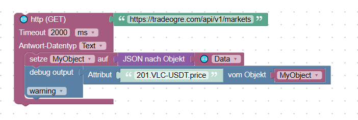

            @dismaster also so klappt es schon mal den gewünschten Preis zu ermitteln:
              <variables>
                <variable id="O};O//3KLE81{YPQ}Xk?">MyObject</variable>
              </variables>
              <block type="http_get" id="EIBv+S;3fW3yqlNt^AFa" x="63" y="64">
                <field name="TIMEOUT">2000</field>
                <field name="UNIT">ms</field>
                <field name="TYPE">text</field>
                <value name="URL">
                  <shadow type="text" id="Szhs8^Agx)xxeeIU9pG~">
                    <field name="TEXT">http://</field>
                  </shadow>
                  <block type="text" id="F@Z6oXd:#;+WkjQV8R{Y">
                    <field name="TEXT">https://tradeogre.com/api/v1/markets</field>
                  </block>
                </value>
                <statement name="STATEMENT">
                  <block type="variables_set" id="j+Tzo={km.FBbBIJrx(9">
                    <field name="VAR" id="O};O//3KLE81{YPQ}Xk?">MyObject</field>
                    <value name="VALUE">
                      <block type="convert_json2object" id="+3igcn}]SBBJ!^e+/Hk3">
                          <block type="http_response" id="JvaXj_}$W#_4%wv=aD{;">
                            <field name="ATTR">response.data</field>
                          </block>
                        </value>
                      </block>
                    </value>
                    <next>
                      <block type="debug" id="D)S1PKvR@J/p:bk2,CEo">
                        <field name="Severity">warn</field>
                        <value name="TEXT">
                          <shadow type="text" id="SNpOjR7|W4p9:t-y^,W*">
                          </shadow>
                          <block type="get_attr" id=";={`B~|G_-WSjNw8Y!,$">
                            <value name="PATH">
                              <shadow type="text" id="u8TVp[6?k#FV;=[9:!9!">
                                <field name="TEXT">201.VLC-USDT.price</field>
                              </shadow>
                            </value>
                            <value name="OBJECT">
                              <shadow type="get_object" id="nW#jb:IQI*t#~#T=?Ek{">
                              </shadow>
                              <block type="variables_get" id="V!iwP;Gtm{lFFIWj]7iz">
                              </block>
                            </value>
                          </block>
                        </value>
                      </block>
                    </next>
                  </block>
                </statement>
              </block>
            </xml>
            Das ist natürlich unelegant die laufenden Nummer mit angeben zu müssen, insbesondere wenn sich die Reihenfolge mal ändert. Aber ein Schritt nach dem anderem
            Ergebnis:
            2024-03-30 22:42:44.160  - warn: javascript.1 (2016356) script.js.Tests.Forum_tradeogre: 0.00300234

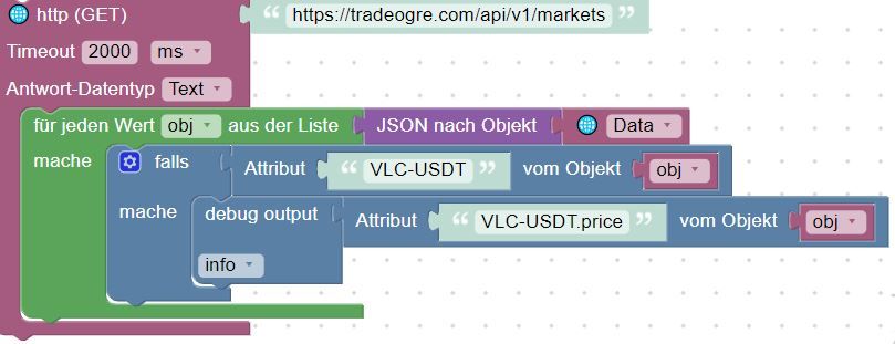

              @bananajoe sagte: so klappt es schon mal den gewünschten Preis zu ermitteln:
              So, ohne die Position im Array zu kennen:
              D 1 Antwort Letzte Antwort

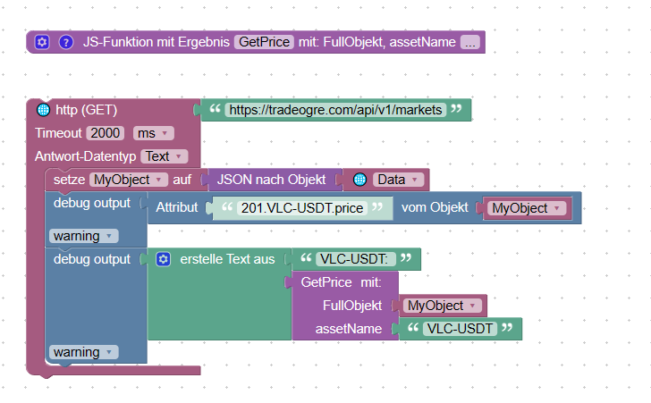

                Verdammt, auch eine Schöne Lösung, ich hatte gerade diese gefunden (die aber nach dem gleichen Prinzip arbeitet):
                  <variables>
                    <variable id="}?*eJ]D;,qM!wQ5Mtf$j">FullObjekt</variable>
                    <variable id="XvhSs!!Zl?Un.Px_+~Ya">assetName</variable>
                  </variables>
                  <block type="procedures_defcustomreturn" id="~!~B]Lb?YaW.sv9`HSyZ" x="63" y="-12">
                    <mutation statements="false">
                      <arg name="FullObjekt" varid="}?*eJ]D;,qM!wQ5Mtf$j"></arg>
                      <arg name="assetName" varid="XvhSs!!Zl?Un.Px_+~Ya"></arg>
                    </mutation>
                    <field name="NAME">GetPrice</field>
                    <field name="SCRIPT">Y29uc3QgYXNzZXREYXRhID0gRnVsbE9iamVrdC5maW5kKGFzc2V0ID0+IGFzc2V0Lmhhc093blByb3BlcnR5KGFzc2V0TmFtZSkpOw0KICAgIGlmIChhc3NldERhdGEpIHsNCiAgICAgICAgY29uc3QgcHJpY2UgPSBhc3NldERhdGFbYXNzZXROYW1lXS5wcmljZTsNCiAgICAgICAgY29uc29sZS53YXJuKGBXYXJuaW5nOiBQcmljZSBvZiAke2Fzc2V0TmFtZX06ICR7cHJpY2V9YCk7DQogICAgICAgIHJldHVybiBwcmljZTsNCiAgICB9IGVsc2Ugew0KICAgICAgICBjb25zb2xlLndhcm4oYFdhcm5pbmc6IEFzc2V0IHdpdGggbmFtZSAke2Fzc2V0TmFtZX0gbm90IGZvdW5kYCk7DQogICAgICAgIHJldHVybiAtMTsNCiAgICB9DQo=</field>
                  </block>
                    <value name="URL">
                      </shadow>
                      </block>
                    </value>
                              </block>
                            </value>
                          </block>
                        </value>
                        <next>
                            <value name="TEXT">
                              </shadow>
                                <value name="PATH">
                                  </shadow>
                                </value>
                                  </shadow>
                                  </block>
                                </value>
                              </block>
                            </value>
                            <next>
                              <block type="debug" id="K58X`w#z,fN{.Z?H,oc!">
                                <value name="TEXT">
                                  <shadow type="text" id=":-tgP18Q@+M~Qg]0)2B,">
                                  </shadow>
                                  <block type="text_join" id="!F?AO-n***%ikk82@)`6">
                                    <value name="ADD0">
                                      <block type="text" id="2lCu9U7RX^}ySFwg[dNs">
                                        <field name="TEXT">VLC-USDT: </field>
                                      </block>
                                    </value>
                                    <value name="ADD1">
                                      <block type="procedures_callcustomreturn" id="G=#NBkIDg5L~q(@?uZ/a">
                                        <mutation name="GetPrice">
                                          <arg name="FullObjekt"></arg>
                                          <arg name="assetName"></arg>
                                        </mutation>
                                        <value name="ARG0">
                                          <block type="variables_get" id="3S9VWnz(dcpmpA=E4!e1">
                                          </block>
                                        </value>
                                        <value name="ARG1">
                                          <block type="text" id="v{@USThxvXgpb`#EzF%z">
                                            <field name="TEXT">VLC-USDT</field>

                Jetzt habe ich es extra zusammengeschrammelt, da will ich es auch posten ...
                Die JavaScript Funktion im Detail:
                const assetData = FullObjekt.find(asset => asset.hasOwnProperty(assetName));
                    if (assetData) {
                        const price = assetData[assetName].price;
                        console.warn(`Warning: Price of ${assetName}: ${price}`);
                        return price;
                    } else {
                        console.warn(`Warning: Asset with name ${assetName} not found`);
                        return -1;
                Hab ich zuerst gegoogelt. Und mir dann vn Chat GPT den Aufbau erklären lassen:
                  dismaster
                  @paul53 Mega!
                  Danke für deine Hilfe, werd das morgen mal rein packen und berichten :)
                  Frohe Ostern 🐰
