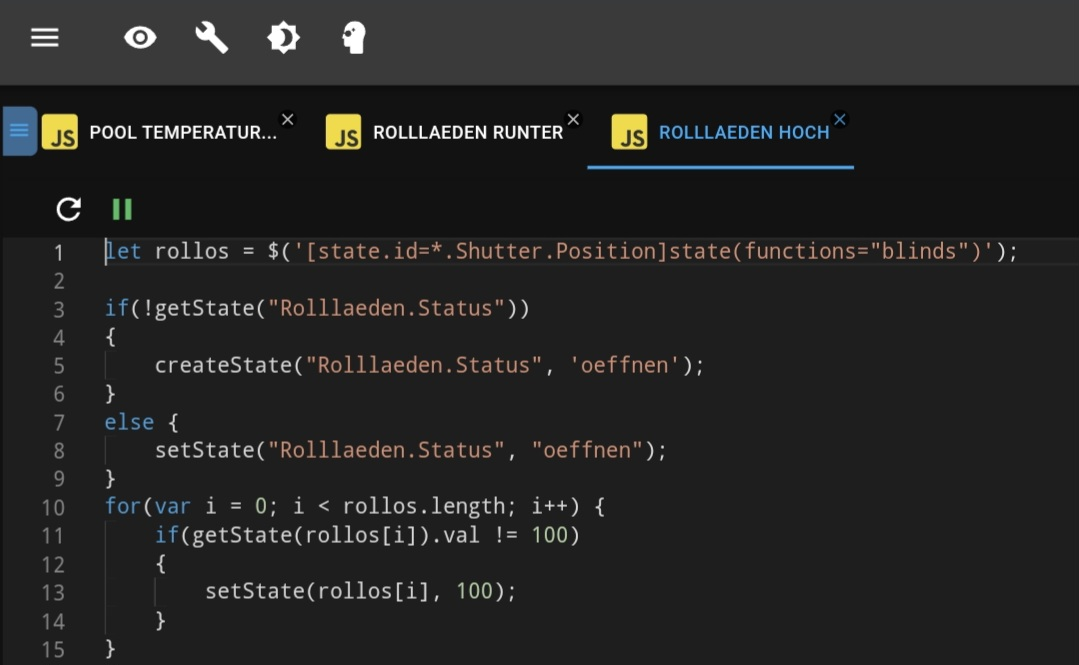

    ich habe folgendes Problem:
    Seit ich ioBroker, den Shelly Adapter & NodeJS auf den jeweils aktuellsten Stand gebracht habe erhalte ich sporadisch folgende Meldung beim setzen der Shutter Position:
    2024-01-25 17:30:33.794 - error: shelly.0 (3733) [http controlFunction] Error in function state.coap.http_cmd of state SHSW-25#E8DB84A98208#1.Shutter.Position for 192.168.3.111 (shellyswitch25 / shellyswitch25-E8DB84A98208 / SHSW-25#E8DB84A98208#1): AxiosError: timeout of 8000ms exceeded
    2024-01-25 17:30:33.801 - error: shelly.0 (3733) [http controlFunction] Error in function state.coap.http_cmd of state SHSW-25#E8DB84AA6A80#1.Shutter.Position for 192.168.3.132 (shellyswitch25 / shellyswitch25-E8DB84AA6A80 / SHSW-25#E8DB84AA6A80#1): AxiosError: timeout of 8000ms exceeded
    2024-01-25 17:30:33.805 - error: shelly.0 (3733) [http controlFunction] Error in function state.coap.http_cmd of state SHSW-25#E8DB84AC6662#1.Shutter.Position for 192.168.3.110 (shellyswitch25 / shellyswitch25-E8DB84AC6662 / SHSW-25#E8DB84AC6662#1): AxiosError: timeout of 8000ms exceeded
    2024-01-25 17:30:33.825 - error: shelly.0 (3733) [http controlFunction] Error in function state.coap.http_cmd of state SHSW-25#E8DB84AC9F4A#1.Shutter.Position for 192.168.3.113 (shellyswitch25 / shellyswitch25-E8DB84AC9F4A / SHSW-25#E8DB84AC9F4A#1): AxiosError: timeout of 8000ms exceeded
    2024-01-25 17:30:33.832 - error: shelly.0 (3733) [http controlFunction] Error in function state.coap.http_cmd of state SHSW-25#E8DB84ACC29C#1.Shutter.Position for 192.168.3.108 (shellyswitch25 / shellyswitch25-E8DB84ACC29C / SHSW-25#E8DB84ACC29C#1): AxiosError: timeout of 8000ms exceeded
    2024-01-25 17:30:33.836 - error: shelly.0 (3733) [http controlFunction] Error in function state.coap.http_cmd of state SHSW-25#E8DB84ACC809#1.Shutter.Position for 192.168.3.114 (shellyswitch25 / shellyswitch25-E8DB84ACC809 / SHSW-25#E8DB84ACC809#1): AxiosError: timeout of 8000ms exceeded
    2024-01-25 17:30:33.872 - error: shelly.0 (3733) [http controlFunction] Error in function state.coap.http_cmd of state SHSW-25#E8DB84ACF3C9#1.Shutter.Position for 192.168.3.115 (shellyswitch25 / shellyswitch25-E8DB84ACF3C9 / SHSW-25#E8DB84ACF3C9#1): AxiosError: timeout of 8000ms exceeded
    Die im Log gelisteten Geräte verändern ihre Shutter Position entsprechend nicht.
    Manchmal funktioniert der Aufruf allerdings auch, hier ist kein Muster zu erkennen.
    Alle Geräte die hier gelistet sind haben guten WIFI Empfang und die Shelly Web GUI ist über deren IP ganz normal erreichbar und es kann auch gesteuert werden.
    Die Firmwareversion der Shellys ist 20230913-112234/v1.14.0-gcb84623.
    Hat jemand eine Idee woran das liegen könnte oder ist das ein Bug denn ich in GitHub melden sollte?
    Vielen Dank für eure Hilfe.

                                  2024-01-27 13:06:08.979  - info: javascript.0 (2788) Start javascript script.js.Rolllaeden_hoch
                                  2024-01-27 13:06:09.043  - info: javascript.0 (2788) script.js.Rolllaeden_hoch: registered 0 subscriptions, 0 schedules, 0 messages, 0 logs and 0 file subscriptions
                                  2024-01-27 13:06:46.518  - info: simple-api.0 (3079) State value to set for "javascript.0.scriptEnabled.Rolllaeden_hoch" has to be type "boolean" but received type "number"
                                  2024-01-27 13:06:46.529  - info: javascript.0 (2788) Stop script script.js.Rolllaeden_hoch
                                  2024-01-27 13:06:46.732  - info: simple-api.0 (3079) State value to set for "javascript.0.scriptEnabled.Rolllaeden_runter" has to be type "boolean" but received type "number"
                                  2024-01-27 13:06:46.749  - info: javascript.0 (2788) Start javascript script.js.Rolllaeden_runter
                                  2024-01-27 13:06:46.827  - info: javascript.0 (2788) script.js.Rolllaeden_runter: registered 0 subscriptions, 0 schedules, 0 messages, 0 logs and 0 file subscriptions2024-01-27 13:06:46.856  - warn: shelly.0 (6095) [http controlFunction] Unable to perform request - device 192.168.3.132 (shellyswitch25 / shellyswitch25-E8DB84AA6A80 / SHSW-25#E8DB84AA6A80#1) is offline
                                  2024-01-27 13:06:46.865  - warn: shelly.0 (6095) [http controlFunction] Unable to perform request - device 192.168.3.131 (shellyswitch25 / shellyswitch25-E8DB84ACB936 / SHSW-25#E8DB84ACB936#1) is offline
                                  2024-01-27 13:06:53.945  - info: simple-api.0 (3079) State value to set for "javascript.0.scriptEnabled.Rolllaeden_runter" has to be type "boolean" but received type "number"
                                  2024-01-27 13:06:53.957  - info: javascript.0 (2788) Stop script script.js.Rolllaeden_runter

                                    @smartguy1994 hast du die shelly mal rebootet und sind die shelly auch ereichbar über die weboberfläche wenn du den Error im ioBroker hast?
                                    SmartGuy1994
                                    wrote on last edited by
                                    @fa-bio ja sind über die Weboberfläche erreichbar und steuerbar. Neugestartet habe ich sie auch schon.
                                    FabioF 1 Reply Last reply
                                    • S SmartGuy1994
                                      FabioF Offline
                                      FabioF Offline
                                      Fabio
                                      @smartguy1994 hm das ist komisch was sind denn die Schutter Daten die du überträgts kannst du das mal zeigen.
                                      Iobroker:
                                      • Für mich persöhnlich, gibt es nichts besseres, ich liebe es.
                                      • Das hat unser Smarthome erst zu Smarthome gemacht.
                                      • Du wächst mit ioBroker und ioBroker wächst mit dir.
                                      • Benutzt das Voting rechts unten im Beitrag wenn er euch geholfen hat.
                                      S 1 Reply Last reply
                                      • FabioF Fabio
                                        SmartGuy1994
                                        • S SmartGuy1994
                                          FabioF Offline
                                          FabioF Offline
                                          Fabio
                                          @smartguy1994 hast du schon mal probiert andere Prozentwerte zu nehmen also zum Beispiel 50% ist das Verhalten dann immer noch so?
                                          Sind die alle über den Shelly Adapter eingebunden, wenn ja, kannst du in den Datenpunkten selber die Prozentzahl ändern und was passiert dann?
                                          Iobroker:
