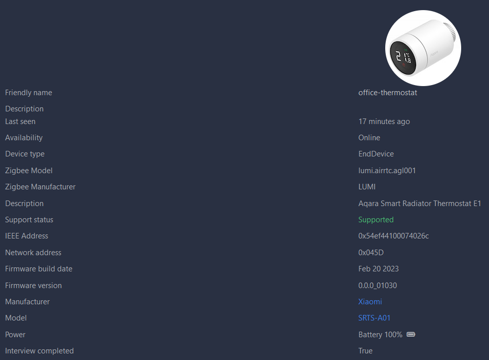

    Aqara E1
    Zigbee2MQTT link
    Zigbee2MQTT State:
       "away_preset_temperature": "5.0",
       "battery": 100,
       "calibrated": false,
       "child_lock": "UNLOCK",
       "device_temperature": 22,
       "internal_heating_setpoint": 18,
       "last_seen": "2023-11-09T06:01:33+01:00",
       "linkquality": 29,
       "local_temperature": 20.1,
       "occupied_heating_setpoint": 18,
       "power_outage_count": 1,
       "preset": "manual",
       "schedule": "OFF",
       "schedule_settings": "mon,sun|0:00,21.0|12:00,17.0|18:00,21.0|23:59,21.0",
       "sensor": "internal",
       "setup": false,
       "system_mode": "heat",
       "update": {
           "installed_version": 2590,
           "latest_version": 2590,
           "state": "idle"
       "valve_alarm": false,
       "valve_detection": "OFF",
       "voltage": 3000,
       "window_detection": "OFF",
       "window_open": false
    Lautstärke: Wenn es sehr leise ist, kann man den Motor hören.
    **Aussehen und Bedienung:**Die Position des Displays ist nicht optimal gerade wenn es in einer Ecke montiert werden muss. Der Taster und das Drehrad haben deutliche Druckpunkte, so dass man es auch blind bedienen kann.
    Auffälligkeiten: Das Thermostat reagiert sehr schnell und auch das Öffnen/Schließen durch den Motor ist schnell.

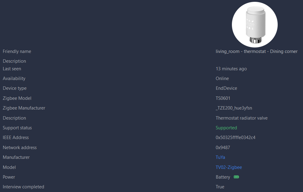

    ZigBee Tuya
    Zigbee2MQTT link
    Zigbee2MQTT State:
       "battery_low": false,
       "boost_timeset_countdown": 0,
       "comfort_temperature": 21,
       "current_heating_setpoint": 18,
       "eco_temperature": 17,
       "error_status": 0,
       "frost_protection": "OFF",
       "heating_stop": "OFF",
       "holiday_start_stop": "2021/01/01 01:01 | 2021/01/01 01:01",
       "holiday_temperature": 17,
       "last_seen": "2023-11-09T06:30:01+01:00",
       "linkquality": 116,
       "local_temperature": 20.7,
       "local_temperature_calibration": 0,
       "online": "ON",
       "open_window": "OFF",
       "open_window_temperature": 21,
       "preset": "manual",
       "schedule_friday": "06:00/17 12:00/21 14:00/17 17:00/21 24:00/17",
       "schedule_monday": "06:00/17 12:00/21 14:00/17 17:00/21 24:00/17",
       "schedule_saturday": "06:00/17 12:00/21 14:00/17 17:00/21 24:00/17",
       "schedule_sunday": "06:00/17 12:00/21 14:00/17 17:00/21 24:00/17",
       "schedule_thursday": "06:00/17 12:00/21 14:00/17 17:00/21 24:00/17",
       "schedule_tuesday": "06:00/17 12:00/21 14:00/17 17:00/21 24:00/17",
       "schedule_wednesday": "06:00/17 12:00/21 14:00/17 17:00/21 24:00/17",
       "working_day": "mon_sun"
    Lautstärke: Von den 3 ist es das leiseste.
    Aussehen und Bedienung: Die Helligkeit ist gut und man kann es auch tagsüber sehr gut ablesen.
    Auffälligkeiten: Das Einrasten des Drehreglers ist nicht so deutlich aber okay.

      @ignis-draco
      du musst die Info Kachel Posten..es gibt ca 100 Zigbee Tuya Thermostate.. und auch wenn du ein Link postest zu dem.. die sehen alles gleich aus und intern ist was anderes...
      deine letzten 2 sind beide Tuya (ist übrigends nur eine Firma die Firmware zur verfügung stellt)
      also machs richtig und Poste die Infokachel..oder noch besser verlinke https://www.zigbee2mqtt.io/supported-devices/#s=thermostat das richtige direkt

        @arteck sagte in Zigbee Thermostat:
        Deswegen habe ich den link zu einem Korktreten Shop gepostet damit man auch genau die Kaufen kann.
        Von der Frimware Ja. Die "Benennung" habe auch aus dem Shop bzw. was auf der verpacken steht und da steht bei dem einen als nicht direkt was von Tuya (nur in der Beschreibung im Webshop).
        Ich habe das angepasst. Wobei ich der Meinung bin das die echten State einfacher zu-überblicken sind als die Zigbee2MQTT Seite.
