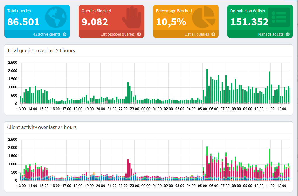

    kennt jemand eine Möglichkeit, wie man die Pi-Hole Statistiken und Graphen in der VIS anzeigen kann?
    Den entsprechenden Adapter habe ich installiert, aber der liefert ja nur Zahlen.

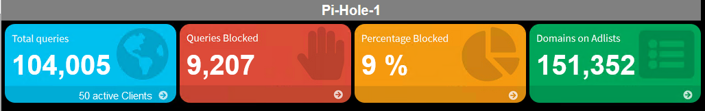

            Habe jetzt angefangen es selber zu basteln:

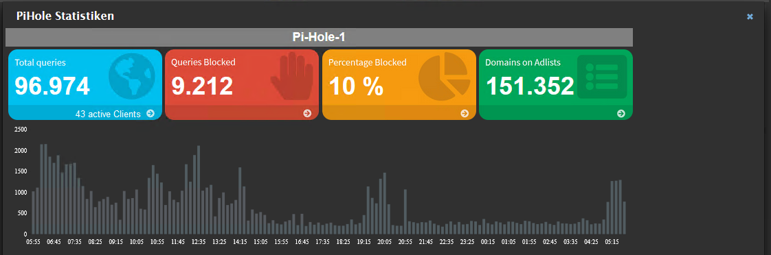

                  Das ist jetzt mein Endergebnis:
                  Widgets
                  [{"tpl":"tplHtml","data":{"g_fixed":true,"g_visibility":false,"g_css_font_text":true,"g_css_background":true,"g_css_shadow_padding":false,"g_css_border":false,"g_gestures":false,"g_signals":false,"g_last_change":false,"visibility-cond":"==","visibility-val":1,"visibility-groups-action":"hide","refreshInterval":"0","signals-cond-0":"==","signals-val-0":true,"signals-icon-0":"/vis/signals/lowbattery.png","signals-icon-size-0":0,"signals-blink-0":false,"signals-horz-0":0,"signals-vert-0":0,"signals-hide-edit-0":false,"signals-cond-1":"==","signals-val-1":true,"signals-icon-1":"/vis/signals/lowbattery.png","signals-icon-size-1":0,"signals-blink-1":false,"signals-horz-1":0,"signals-vert-1":0,"signals-hide-edit-1":false,"signals-cond-2":"==","signals-val-2":true,"signals-icon-2":"/vis/signals/lowbattery.png","signals-icon-size-2":0,"signals-blink-2":false,"signals-horz-2":0,"signals-vert-2":0,"signals-hide-edit-2":false,"lc-type":"last-change","lc-is-interval":true,"lc-is-moment":false,"lc-format":"","lc-position-vert":"top","lc-position-horz":"right","lc-offset-vert":0,"lc-offset-horz":0,"lc-font-size":"12px","lc-font-family":"","lc-font-style":"","lc-bkg-color":"","lc-color":"","lc-border-width":"0","lc-border-style":"","lc-border-color":"","lc-border-radius":10,"lc-zindex":0,"html":"Pi-Hole-1","name":"!_Überschrift_1"},"style":{"left":"0px","top":"0px","height":"30px","width":"1020px","z-index":"10","color":"white","text-align":"center","text-shadow":"","font-family":"Arial, Helvetica, sans-serif","font-style":"","font-variant":"","font-weight":"bolder","font-size":"20px","line-height":"30px","background":"grey"},"widgetSet":"basic"},{"tpl":"tplImage","data":{"g_fixed":true,"g_visibility":false,"g_css_font_text":false,"g_css_background":false,"g_css_shadow_padding":false,"g_css_border":true,"g_gestures":false,"g_signals":false,"g_last_change":false,"visibility-cond":"==","visibility-val":1,"visibility-groups-action":"hide","refreshInterval":"0","signals-cond-0":"==","signals-val-0":true,"signals-icon-0":"/vis/signals/lowbattery.png","signals-icon-size-0":0,"signals-blink-0":false,"signals-horz-0":0,"signals-vert-0":0,"signals-hide-edit-0":false,"signals-cond-1":"==","signals-val-1":true,"signals-icon-1":"/vis/signals/lowbattery.png","signals-icon-size-1":0,"signals-blink-1":false,"signals-horz-1":0,"signals-vert-1":0,"signals-hide-edit-1":false,"signals-cond-2":"==","signals-val-2":true,"signals-icon-2":"/vis/signals/lowbattery.png","signals-icon-size-2":0,"signals-blink-2":false,"signals-horz-2":0,"signals-vert-2":0,"signals-hide-edit-2":false,"lc-type":"last-change","lc-is-interval":true,"lc-is-moment":false,"lc-format":"","lc-position-vert":"top","lc-position-horz":"right","lc-offset-vert":0,"lc-offset-horz":0,"lc-font-size":"12px","lc-font-family":"","lc-font-style":"","lc-bkg-color":"","lc-color":"","lc-border-width":"0","lc-border-style":"","lc-border-color":"","lc-border-radius":10,"lc-zindex":0,"name":"total_queries_bg","src":"/vis.0/VIS_v3/Meine_Icons/Netzwerk/pihole_total_queries.png"},"style":{"left":"5px","top":"35px","z-index":"10","width":"250px","height":"115px","border-radius":"15px"},"widgetSet":"basic"},{"tpl":"tplImage","data":{"g_fixed":true,"g_visibility":false,"g_css_font_text":false,"g_css_background":false,"g_css_shadow_padding":false,"g_css_border":true,"g_gestures":false,"g_signals":false,"g_last_change":false,"visibility-cond":"==","visibility-val":1,"visibility-groups-action":"hide","refreshInterval":"0","signals-cond-0":"==","signals-val-0":true,"signals-icon-0":"/vis/signals/lowbattery.png","signals-icon-size-0":0,"signals-blink-0":false,"signals-horz-0":0,"signals-vert-0":0,"signals-hide-edit-0":false,"signals-cond-1":"==","signals-val-1":true,"signals-icon-1":"/vis/signals/lowbattery.png","signals-icon-size-1":0,"signals-blink-1":false,"signals-horz-1":0,"signals-vert-1":0,"signals-hide-edit-1":false,"signals-cond-2":"==","signals-val-2":true,"signals-icon-2":"/vis/signals/lowbattery.png","signals-icon-size-2":0,"signals-blink-2":false,"signals-horz-2":0,"signals-vert-2":0,"signals-hide-edit-2":false,"lc-type":"last-change","lc-is-interval":true,"lc-is-moment":false,"lc-format":"","lc-position-vert":"top","lc-position-horz":"right","lc-offset-vert":0,"lc-offset-horz":0,"lc-font-size":"12px","lc-font-family":"","lc-font-style":"","lc-bkg-color":"","lc-color":"","lc-border-width":"0","lc-border-style":"","lc-border-color":"","lc-border-radius":10,"lc-zindex":0,"name":"queries_blocked_bg","src":"/vis.0/VIS_v3/Meine_Icons/Netzwerk/pihole_queries_blocked.png"},"style":{"left":"260px","top":"35px","z-index":"10","width":"250px","height":"115px","border-radius":"15px"},"widgetSet":"basic"},{"tpl":"tplValueFloat","data":{"oid":"pi-hole.0.summary.dns_queries_today","g_fixed":true,"g_visibility":false,"g_css_font_text":true,"g_css_background":false,"g_css_shadow_padding":false,"g_css_border":false,"g_gestures":false,"g_signals":false,"g_last_change":false,"visibility-cond":"==","visibility-val":1,"visibility-groups-action":"hide","is_comma":true,"factor":"1","signals-cond-0":"==","signals-val-0":true,"signals-icon-0":"/vis/signals/lowbattery.png","signals-icon-size-0":0,"signals-blink-0":false,"signals-horz-0":0,"signals-vert-0":0,"signals-hide-edit-0":false,"signals-cond-1":"==","signals-val-1":true,"signals-icon-1":"/vis/signals/lowbattery.png","signals-icon-size-1":0,"signals-blink-1":false,"signals-horz-1":0,"signals-vert-1":0,"signals-hide-edit-1":false,"signals-cond-2":"==","signals-val-2":true,"signals-icon-2":"/vis/signals/lowbattery.png","signals-icon-size-2":0,"signals-blink-2":false,"signals-horz-2":0,"signals-vert-2":0,"signals-hide-edit-2":false,"lc-type":"last-change","lc-is-interval":true,"lc-is-moment":false,"lc-format":"","lc-position-vert":"top","lc-position-horz":"right","lc-offset-vert":0,"lc-offset-horz":0,"lc-font-size":"12px","lc-font-family":"","lc-font-style":"","lc-bkg-color":"","lc-color":"","lc-border-width":"0","lc-border-style":"","lc-border-color":"","lc-border-radius":10,"lc-zindex":0,"name":"total_queries_number","is_tdp":true,"digits":"0"},"style":{"left":"15px","top":"70px","width":"150px","height":"50px","z-index":"20","color":"white","text-align":"left","font-weight":"bold","font-size":"40px","line-height":"50px"},"widgetSet":"basic"},{"tpl":"tplValueFloat","data":{"oid":"pi-hole.0.summary.ads_blocked_today","g_fixed":true,"g_visibility":false,"g_css_font_text":true,"g_css_background":false,"g_css_shadow_padding":false,"g_css_border":false,"g_gestures":false,"g_signals":false,"g_last_change":false,"visibility-cond":"==","visibility-val":1,"visibility-groups-action":"hide","is_comma":true,"factor":"1","signals-cond-0":"==","signals-val-0":true,"signals-icon-0":"/vis/signals/lowbattery.png","signals-icon-size-0":0,"signals-blink-0":false,"signals-horz-0":0,"signals-vert-0":0,"signals-hide-edit-0":false,"signals-cond-1":"==","signals-val-1":true,"signals-icon-1":"/vis/signals/lowbattery.png","signals-icon-size-1":0,"signals-blink-1":false,"signals-horz-1":0,"signals-vert-1":0,"signals-hide-edit-1":false,"signals-cond-2":"==","signals-val-2":true,"signals-icon-2":"/vis/signals/lowbattery.png","signals-icon-size-2":0,"signals-blink-2":false,"signals-horz-2":0,"signals-vert-2":0,"signals-hide-edit-2":false,"lc-type":"last-change","lc-is-interval":true,"lc-is-moment":false,"lc-format":"","lc-position-vert":"top","lc-position-horz":"right","lc-offset-vert":0,"lc-offset-horz":0,"lc-font-size":"12px","lc-font-family":"","lc-font-style":"","lc-bkg-color":"","lc-color":"","lc-border-width":"0","lc-border-style":"","lc-border-color":"","lc-border-radius":10,"lc-zindex":0,"name":"queries_blockes_number","is_tdp":true,"digits":"0"},"style":{"left":"270px","top":"70px","width":"150px","height":"50px","z-index":"20","color":"white","text-align":"left","font-weight":"bold","font-size":"40px","line-height":"50px"},"widgetSet":"basic"},{"tpl":"tplValueFloat","data":{"oid":"pi-hole.0.summary.unique_clients","g_fixed":true,"g_visibility":false,"g_css_font_text":true,"g_css_background":false,"g_css_shadow_padding":false,"g_css_border":false,"g_gestures":false,"g_signals":false,"g_last_change":false,"visibility-cond":"==","visibility-val":1,"visibility-groups-action":"hide","is_comma":false,"factor":"1","signals-cond-0":"==","signals-val-0":true,"signals-icon-0":"/vis/signals/lowbattery.png","signals-icon-size-0":0,"signals-blink-0":false,"signals-horz-0":0,"signals-vert-0":0,"signals-hide-edit-0":false,"signals-cond-1":"==","signals-val-1":true,"signals-icon-1":"/vis/signals/lowbattery.png","signals-icon-size-1":0,"signals-blink-1":false,"signals-horz-1":0,"signals-vert-1":0,"signals-hide-edit-1":false,"signals-cond-2":"==","signals-val-2":true,"signals-icon-2":"/vis/signals/lowbattery.png","signals-icon-size-2":0,"signals-blink-2":false,"signals-horz-2":0,"signals-vert-2":0,"signals-hide-edit-2":false,"lc-type":"last-change","lc-is-interval":true,"lc-is-moment":false,"lc-format":"","lc-position-vert":"top","lc-position-horz":"right","lc-offset-vert":0,"lc-offset-horz":0,"lc-font-size":"12px","lc-font-family":"","lc-font-style":"","lc-bkg-color":"","lc-color":"","lc-border-width":"0","lc-border-style":"","lc-border-color":"","lc-border-radius":10,"lc-zindex":0,"name":"total_queries_active_clients","is_tdp":true,"digits":"0","html_append_singular":" active Clients","html_append_plural":" active Clients"},"style":{"left":"20px","top":"130px","width":"200px","height":"20px","z-index":"20","color":"white","text-align":"right","font-weight":"","font-size":"15px","line-height":"20px"},"widgetSet":"basic"},{"tpl":"tplImage","data":{"g_fixed":true,"g_visibility":false,"g_css_font_text":false,"g_css_background":false,"g_css_shadow_padding":false,"g_css_border":true,"g_gestures":false,"g_signals":false,"g_last_change":false,"visibility-cond":"==","visibility-val":1,"visibility-groups-action":"hide","refreshInterval":"0","signals-cond-0":"==","signals-val-0":true,"signals-icon-0":"/vis/signals/lowbattery.png","signals-icon-size-0":0,"signals-blink-0":false,"signals-horz-0":0,"signals-vert-0":0,"signals-hide-edit-0":false,"signals-cond-1":"==","signals-val-1":true,"signals-icon-1":"/vis/signals/lowbattery.png","signals-icon-size-1":0,"signals-blink-1":false,"signals-horz-1":0,"signals-vert-1":0,"signals-hide-edit-1":false,"signals-cond-2":"==","signals-val-2":true,"signals-icon-2":"/vis/signals/lowbattery.png","signals-icon-size-2":0,"signals-blink-2":false,"signals-horz-2":0,"signals-vert-2":0,"signals-hide-edit-2":false,"lc-type":"last-change","lc-is-interval":true,"lc-is-moment":false,"lc-format":"","lc-position-vert":"top","lc-position-horz":"right","lc-offset-vert":0,"lc-offset-horz":0,"lc-font-size":"12px","lc-font-family":"","lc-font-style":"","lc-bkg-color":"","lc-color":"","lc-border-width":"0","lc-border-style":"","lc-border-color":"","lc-border-radius":10,"lc-zindex":0,"name":"percentage_blocked_bg","src":"/vis.0/VIS_v3/Meine_Icons/Netzwerk/pihole_percentage_blocked.png"},"style":{"left":"515px","top":"35px","z-index":"10","width":"250px","height":"115px","border-radius":"15px"},"widgetSet":"basic"},{"tpl":"tplValueFloat","data":{"oid":"pi-hole.0.summary.ads_percentage_today","g_fixed":true,"g_visibility":false,"g_css_font_text":true,"g_css_background":false,"g_css_shadow_padding":false,"g_css_border":false,"g_gestures":false,"g_signals":false,"g_last_change":false,"visibility-cond":"==","visibility-val":1,"visibility-groups-action":"hide","is_comma":false,"factor":"1","signals-cond-0":"==","signals-val-0":true,"signals-icon-0":"/vis/signals/lowbattery.png","signals-icon-size-0":0,"signals-blink-0":false,"signals-horz-0":0,"signals-vert-0":0,"signals-hide-edit-0":false,"signals-cond-1":"==","signals-val-1":true,"signals-icon-1":"/vis/signals/lowbattery.png","signals-icon-size-1":0,"signals-blink-1":false,"signals-horz-1":0,"signals-vert-1":0,"signals-hide-edit-1":false,"signals-cond-2":"==","signals-val-2":true,"signals-icon-2":"/vis/signals/lowbattery.png","signals-icon-size-2":0,"signals-blink-2":false,"signals-horz-2":0,"signals-vert-2":0,"signals-hide-edit-2":false,"lc-type":"last-change","lc-is-interval":true,"lc-is-moment":false,"lc-format":"","lc-position-vert":"top","lc-position-horz":"right","lc-offset-vert":0,"lc-offset-horz":0,"lc-font-size":"12px","lc-font-family":"","lc-font-style":"","lc-bkg-color":"","lc-color":"","lc-border-width":"0","lc-border-style":"","lc-border-color":"","lc-border-radius":10,"lc-zindex":0,"name":"percentage_blocked_number","is_tdp":true,"digits":"0","html_append_singular":" %","html_append_plural":" %"},"style":{"left":"525px","top":"70px","width":"150px","height":"50px","z-index":"20","color":"white","text-align":"left","font-weight":"bold","font-size":"40px","line-height":"50px"},"widgetSet":"basic"},{"tpl":"tplImage","data":{"g_fixed":true,"g_visibility":false,"g_css_font_text":false,"g_css_background":false,"g_css_shadow_padding":false,"g_css_border":true,"g_gestures":false,"g_signals":false,"g_last_change":false,"visibility-cond":"==","visibility-val":1,"visibility-groups-action":"hide","refreshInterval":"0","signals-cond-0":"==","signals-val-0":true,"signals-icon-0":"/vis/signals/lowbattery.png","signals-icon-size-0":0,"signals-blink-0":false,"signals-horz-0":0,"signals-vert-0":0,"signals-hide-edit-0":false,"signals-cond-1":"==","signals-val-1":true,"signals-icon-1":"/vis/signals/lowbattery.png","signals-icon-size-1":0,"signals-blink-1":false,"signals-horz-1":0,"signals-vert-1":0,"signals-hide-edit-1":false,"signals-cond-2":"==","signals-val-2":true,"signals-icon-2":"/vis/signals/lowbattery.png","signals-icon-size-2":0,"signals-blink-2":false,"signals-horz-2":0,"signals-vert-2":0,"signals-hide-edit-2":false,"lc-type":"last-change","lc-is-interval":true,"lc-is-moment":false,"lc-format":"","lc-position-vert":"top","lc-position-horz":"right","lc-offset-vert":0,"lc-offset-horz":0,"lc-font-size":"12px","lc-font-family":"","lc-font-style":"","lc-bkg-color":"","lc-color":"","lc-border-width":"0","lc-border-style":"","lc-border-color":"","lc-border-radius":10,"lc-zindex":0,"name":"domains_on_adlists_bg","src":"/vis.0/VIS_v3/Meine_Icons/Netzwerk/pihole_domains_on_adlist.png"},"style":{"left":"770px","top":"35px","z-index":"10","width":"250px","height":"115px","border-radius":"15px"},"widgetSet":"basic"},{"tpl":"tplValueFloat","data":{"oid":"pi-hole.0.summary.domains_being_blocked","g_fixed":true,"g_visibility":false,"g_css_font_text":true,"g_css_background":false,"g_css_shadow_padding":false,"g_css_border":false,"g_gestures":false,"g_signals":false,"g_last_change":false,"visibility-cond":"==","visibility-val":1,"visibility-groups-action":"hide","is_comma":true,"factor":"1","signals-cond-0":"==","signals-val-0":true,"signals-icon-0":"/vis/signals/lowbattery.png","signals-icon-size-0":0,"signals-blink-0":false,"signals-horz-0":0,"signals-vert-0":0,"signals-hide-edit-0":false,"signals-cond-1":"==","signals-val-1":true,"signals-icon-1":"/vis/signals/lowbattery.png","signals-icon-size-1":0,"signals-blink-1":false,"signals-horz-1":0,"signals-vert-1":0,"signals-hide-edit-1":false,"signals-cond-2":"==","signals-val-2":true,"signals-icon-2":"/vis/signals/lowbattery.png","signals-icon-size-2":0,"signals-blink-2":false,"signals-horz-2":0,"signals-vert-2":0,"signals-hide-edit-2":false,"lc-type":"last-change","lc-is-interval":true,"lc-is-moment":false,"lc-format":"","lc-position-vert":"top","lc-position-horz":"right","lc-offset-vert":0,"lc-offset-horz":0,"lc-font-size":"12px","lc-font-family":"","lc-font-style":"","lc-bkg-color":"","lc-color":"","lc-border-width":"0","lc-border-style":"","lc-border-color":"","lc-border-radius":10,"lc-zindex":0,"name":"domains_on_adlists_number","is_tdp":true,"digits":"0","html_append_singular":" %","html_append_plural":" %"},"style":{"left":"780px","top":"70px","width":"150px","height":"50px","z-index":"20","color":"white","text-align":"left","font-weight":"bold","font-size":"40px","line-height":"50px"},"widgetSet":"basic"},{"tpl":"tplVis-materialdesign-Chart-Bar","data":{"oid":"0_userdata.0.PiHole-Diagramme.PiHole-1-Diagramm","g_fixed":false,"g_visibility":false,"g_css_font_text":false,"g_css_background":false,"g_css_shadow_padding":false,"g_css_border":false,"g_gestures":false,"g_signals":false,"g_last_change":false,"visibility-cond":"==","visibility-val":1,"visibility-groups-action":"hide","chartDataMethod":"jsonStringObject","dataCount":"0","chartType":"vertical","backgroundColor":"#mdwTheme:vis-materialdesign.0.colors.charts.background","chartAreaBackgroundColor":"#mdwTheme:vis-materialdesign.0.colors.charts.background_chart","titleLayout":"#mdwTheme:vis-materialdesign.0.fontSizes.card.title","titleFontFamily":"#mdwTheme:vis-materialdesign.0.fonts.card.title","colorBackground":"#mdwTheme:vis-materialdesign.0.colors.card.background","colorTitleSectionBackground":"#mdwTheme:vis-materialdesign.0.colors.card.background_title","colorTextSectionBackground":"#mdwTheme:vis-materialdesign.0.colors.card.background_body","colorTitle":"#mdwTheme:vis-materialdesign.0.colors.card.title","globalColor":"rgba(120, 144, 156, 0.45)","hoverColor":"#mdwTheme:vis-materialdesign.0.colors.charts.bar.hover","hoverBorderColor":"#mdwTheme:vis-materialdesign.0.colors.charts.bar.hover_border","showValues":"showValuesOff","valuesFontColor":"#ffffff","valuesFontFamily":"#mdwTheme:vis-materialdesign.0.fonts.charts.value","valuesFontSize":"#mdwTheme:vis-materialdesign.0.fontSizes.charts.value","valuesPositionAnchor":"end","valuesPositionAlign":"top","valuesTextAlign":"center","yAxisPosition":"left","yAxisTitleColor":"#ffffff","yAxisTitleFontFamily":"#mdwTheme:vis-materialdesign.0.fonts.charts.y_axis_title","yAxisTitleFontSize":"#mdwTheme:vis-materialdesign.0.fontSizes.charts.y_axis_title","yAxisValueLabelColor":"#ffffff","yAxisValueFontFamily":"RobotoCondensed-Regular","yAxisValueFontSize":"10","yAxisValueDistanceToAxis":"2","yAxisShowAxis":false,"yAxisShowAxisLabels":true,"yAxisShowGridLines":false,"yAxisGridLinesColor":"#mdwTheme:vis-materialdesign.0.colors.charts.y_axis_gridlines","yAxisShowTicks":true,"yAxisZeroLineColor":"#mdwTheme:vis-materialdesign.0.colors.charts.y_axis_zeroline","xAxisPosition":"bottom","xAxisTicksSource":"auto","xAxisTitleColor":"#mdwTheme:vis-materialdesign.0.colors.charts.x_axis_title","xAxisTitleFontFamily":"#mdwTheme:vis-materialdesign.0.fonts.charts.x_axis_title","xAxisTitleFontSize":"#mdwTheme:vis-materialdesign.0.fontSizes.charts.x_axis_title","xAxisValueLabelColor":"#ffffff","xAxisValueFontFamily":"RobotoCondensed-Regular","xAxisValueFontSize":"10","xAxisValueDistanceToAxis":"7","xAxisShowAxis":true,"xAxisShowAxisLabels":true,"xAxisShowGridLines":false,"xAxisGridLinesColor":"#mdwTheme:vis-materialdesign.0.colors.charts.x_axis_gridlines","xAxisShowTicks":false,"xAxisZeroLineColor":"#mdwTheme:vis-materialdesign.0.colors.charts.x_axis_zeroline","xAxisMinRotation":"0","xAxisMaxRotation":"0","legendPosition":"right","legendFontColor":"#mdwTheme:vis-materialdesign.0.colors.charts.legend","legendFontFamily":"#mdwTheme:vis-materialdesign.0.fonts.charts.legend","legendFontSize":"#mdwTheme:vis-materialdesign.0.fontSizes.charts.legend","legendPointStyle":"true","showTooltip":false,"tooltipBackgroundColor":"#mdwTheme:vis-materialdesign.0.colors.charts.tooltip_background","tooltipShowColorBox":"true","tooltipTitleFontColor":"#mdwTheme:vis-materialdesign.0.colors.charts.tooltip_title","tooltipTitleFontFamily":"#mdwTheme:vis-materialdesign.0.fonts.charts.tooltip_title","tooltipTitleFontSize":"#mdwTheme:vis-materialdesign.0.fontSizes.charts.tooltip_title","tooltipBodyFontColor":"#mdwTheme:vis-materialdesign.0.colors.charts.tooltip_text","tooltipBodyFontFamily":"#mdwTheme:vis-materialdesign.0.fonts.charts.tooltip_text","tooltipBodyFontSize":"#mdwTheme:vis-materialdesign.0.fontSizes.charts.tooltip_text","signals-cond-0":"==","signals-val-0":true,"signals-icon-0":"/vis/signals/lowbattery.png","signals-icon-size-0":0,"signals-blink-0":false,"signals-horz-0":0,"signals-vert-0":0,"signals-hide-edit-0":false,"signals-cond-1":"==","signals-val-1":true,"signals-icon-1":"/vis/signals/lowbattery.png","signals-icon-size-1":0,"signals-blink-1":false,"signals-horz-1":0,"signals-vert-1":0,"signals-hide-edit-1":false,"signals-cond-2":"==","signals-val-2":true,"signals-icon-2":"/vis/signals/lowbattery.png","signals-icon-size-2":0,"signals-blink-2":false,"signals-horz-2":0,"signals-vert-2":0,"signals-hide-edit-2":false,"lc-type":"last-change","lc-is-interval":true,"lc-is-moment":false,"lc-format":"","lc-position-vert":"top","lc-position-horz":"right","lc-offset-vert":0,"lc-offset-horz":0,"lc-font-size":"12px","lc-font-family":"","lc-font-style":"","lc-bkg-color":"","lc-color":"","lc-border-width":"0","lc-border-style":"","lc-border-color":"","lc-border-radius":10,"lc-zindex":0,"g_oids":false,"g_layoutForData_§0":false,"colorScheme":"","cardUse":false,"axisMaxLabel":"","chartPaddingTop":"","animationDuration":"0","disableHoverEffects":true,"chartPaddingRight":"1"},"style":{"left":"10px","top":"160px","width":"1010px","height":"200px","z-index":"10"},"widgetSet":"materialdesign"}]
                  Javascript für das Balkendiagramm (Danke an @Ro75)
                  const moment = require('moment');
                  const pihole_1_data = 'pi-hole.0.overTimeData10mins.domains_over_time.data-table';
                  if(!existsState('0_userdata.0.PiHole-Diagramme.PiHole-1-Diagramm')){
                     createState('0_userdata.0.PiHole-Diagramme.PiHole-1-Diagramm', "[]", {read: true, write: true, desc: "JSON String", type: "string", def: "[]"});
                  on(pihole_1_data, function(dp) {
                     let ConsumList = [];
                     var text = dp.state.val.split(',');
                     for (let i = 0; i <= text.length-1; i++) {
                         let startTime = moment((text[i].split(':')[0].replace('"','').replace('"','').replace('[{',''))*1000);
                         ConsumList.push({
                             label: startTime.format('HH:mm').replace('Invalid date',''),
                             value: parseFloat(text[i].split(':')[1]),
                             valueColor: '#ffffff'
                     setState('0_userdata.0.PiHole-Diagramme.PiHole-1-Diagramm', JSON.stringify(ConsumList), true);
                     ConsumList = [];
